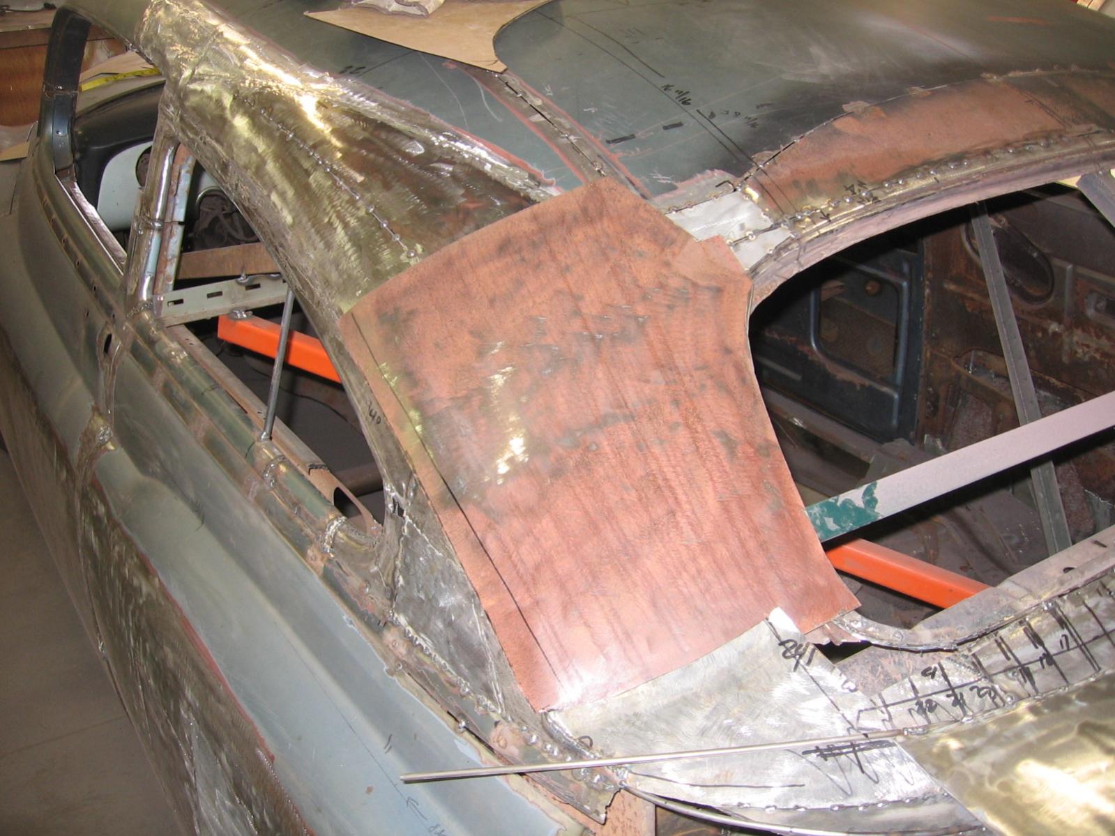

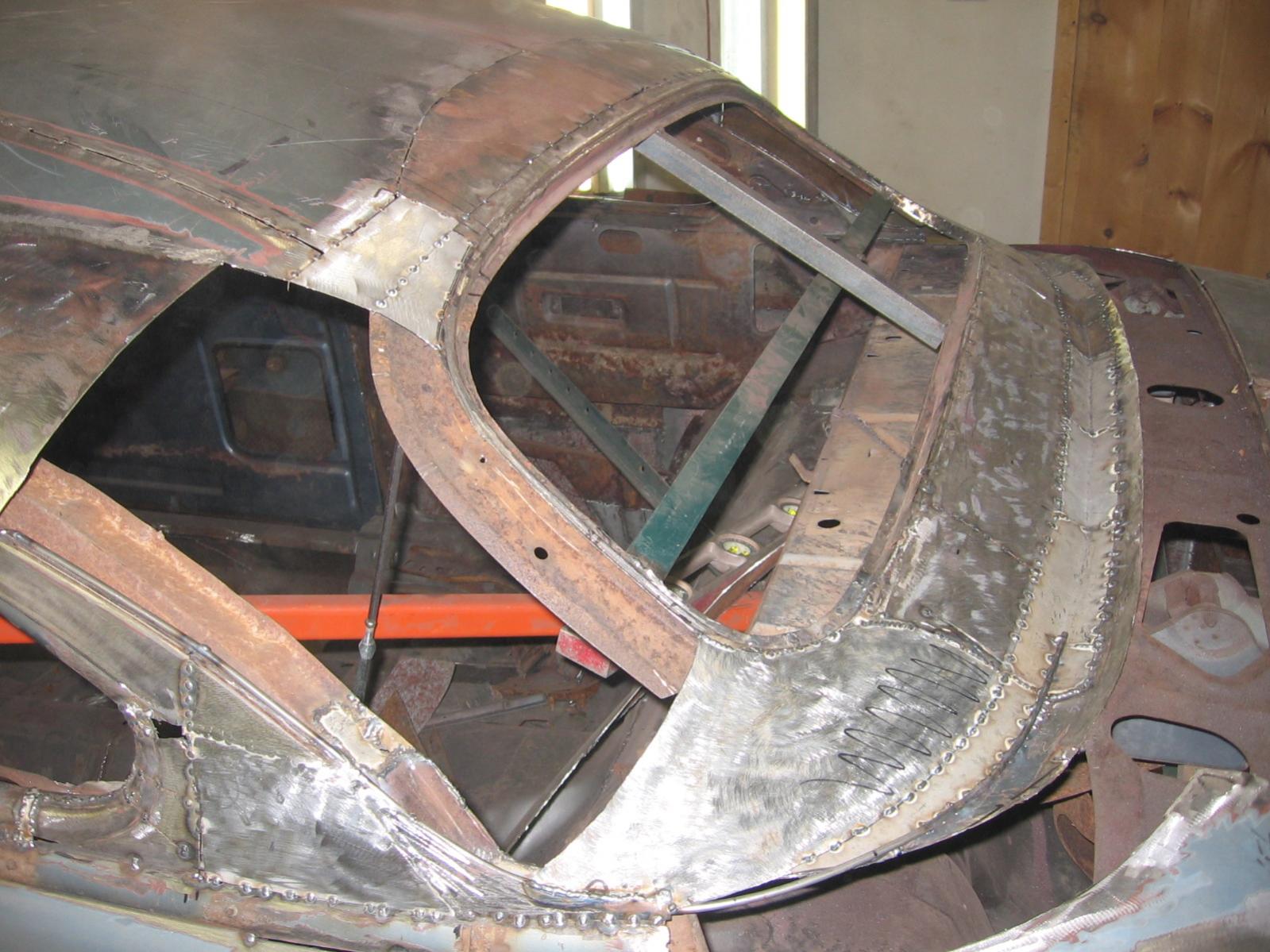

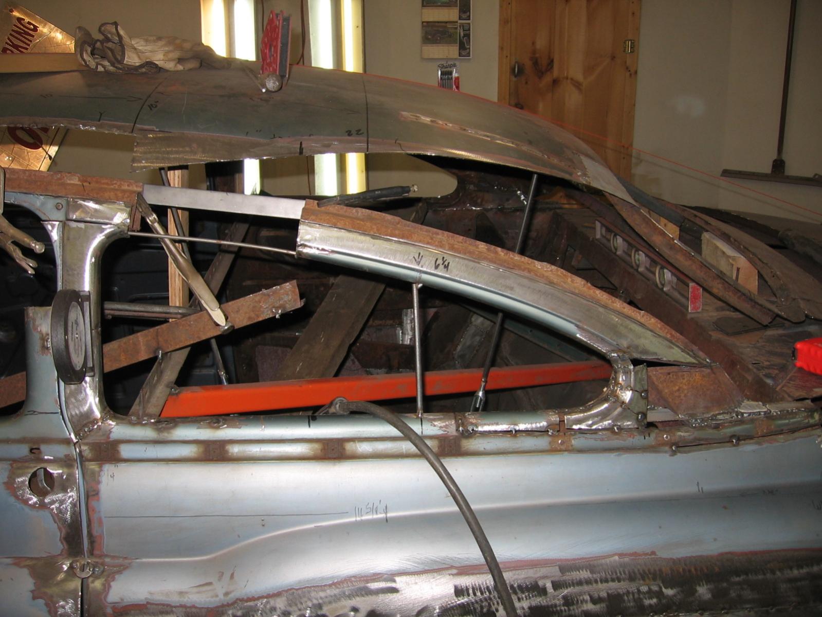

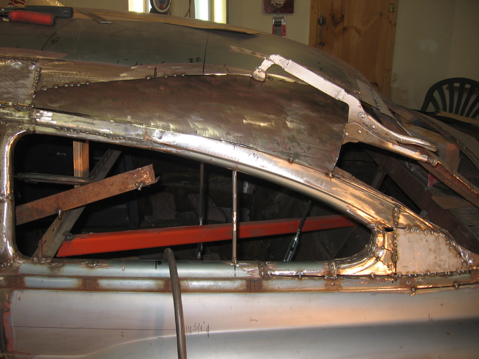

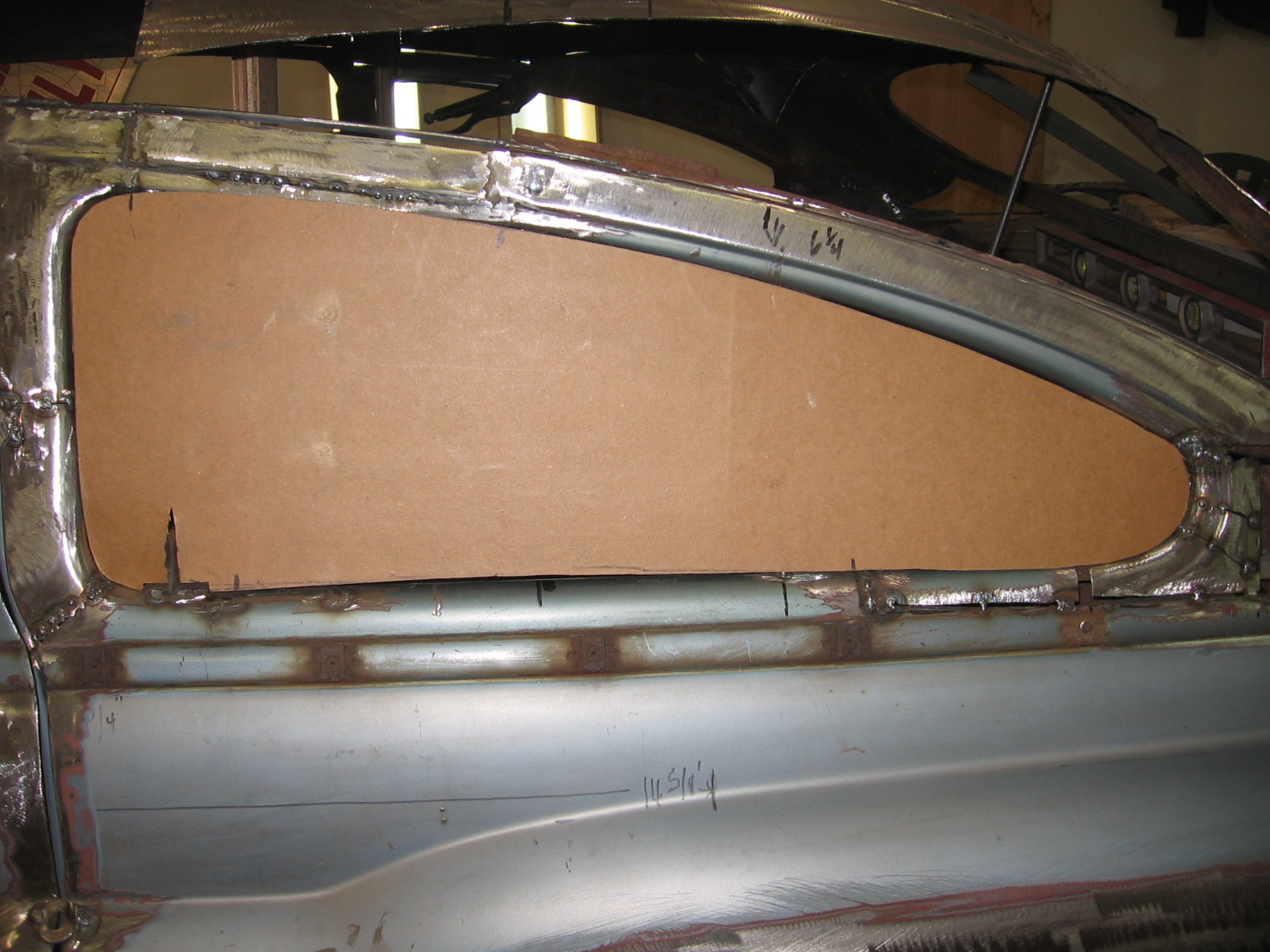

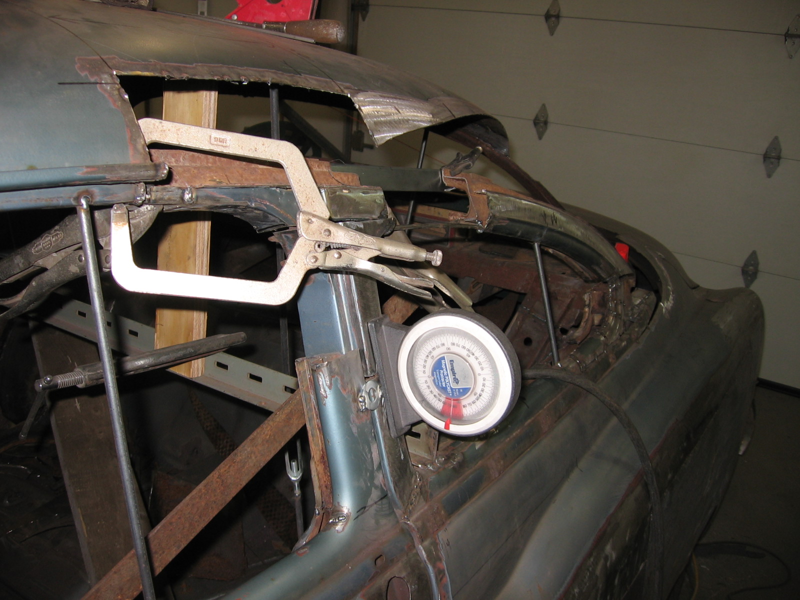

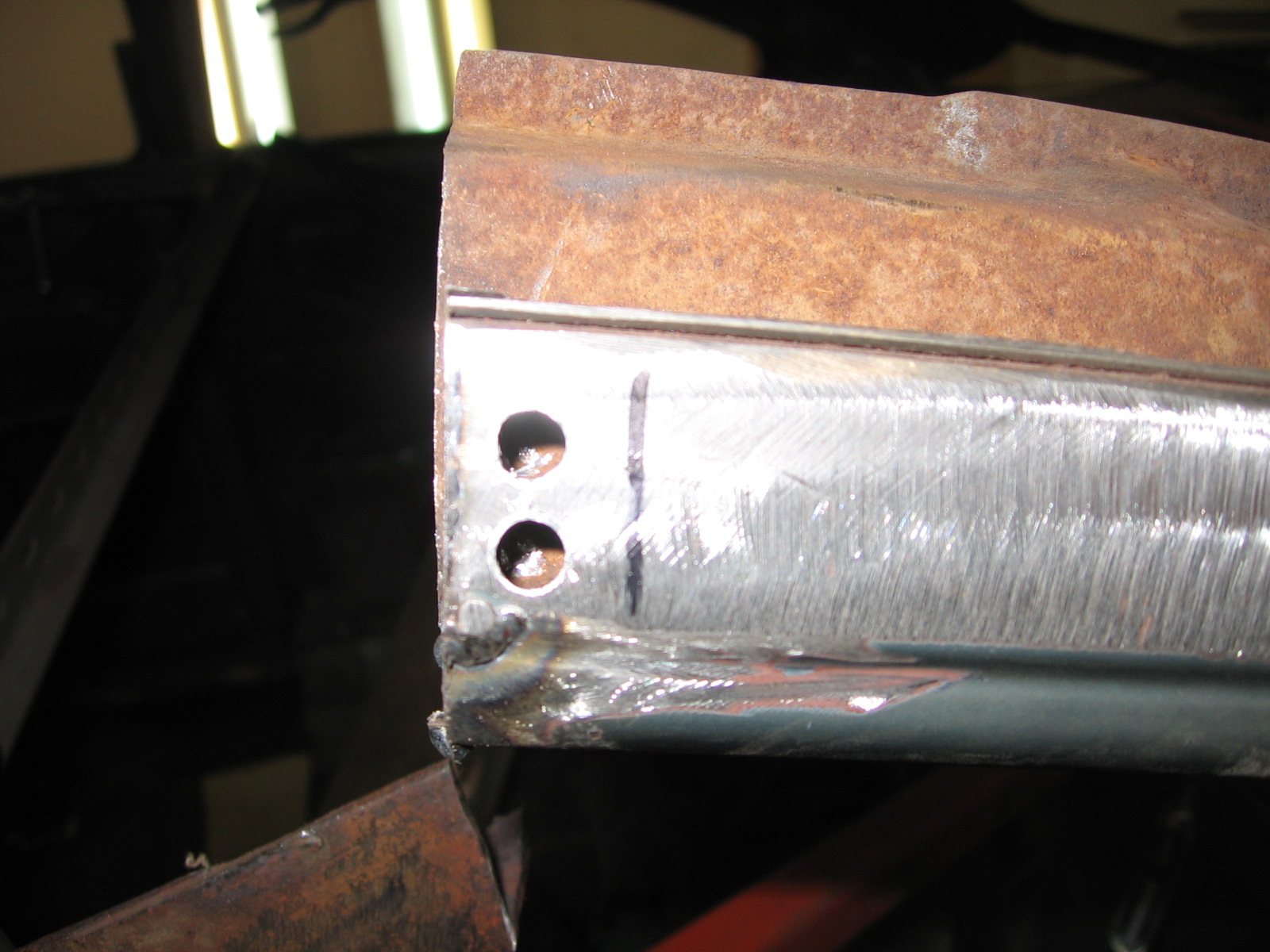

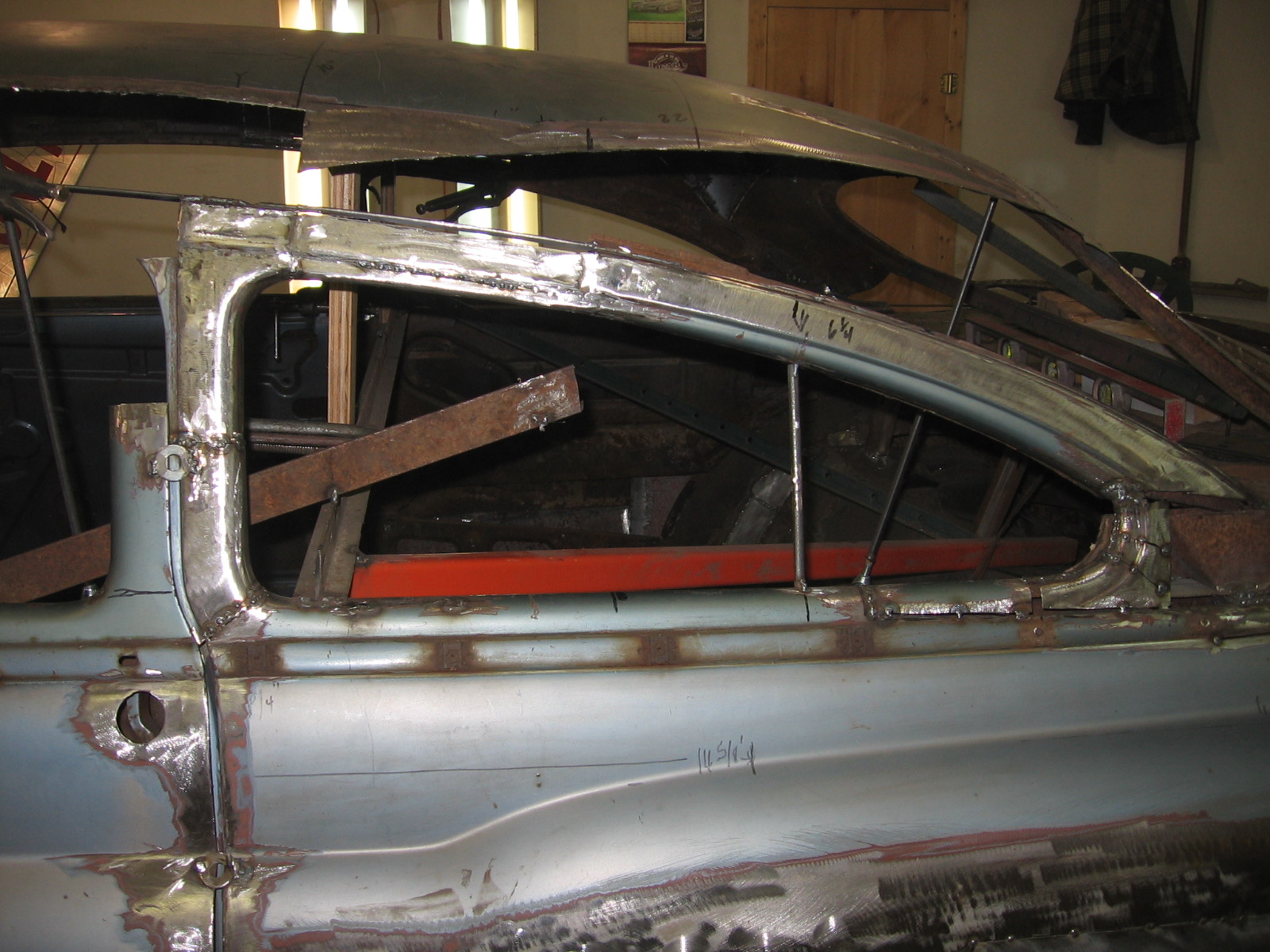

    Well I have found some time for some work on the car . It was a struggle to get the flow of the rear side gl*** opening right . I fought with it for 2 and a half days then realized the B pillar was twisted to the outside of the car and it and the main body window arch wouldn't line up . ***** .Word of advise , If something isnt flowing right or fitting right STOP and check everything over , you will probably find the issue that is causing the problem , Case in point my B pillar :mad: . Have it now though and the cardboard template from the other side is almost perfect . Can only see one side at a time anyways . I am probably being to fussy for my own good . Gene Winfield I am not :rolleyes: :eek: . Any way you can see the piece of roof that I saved from the 51 coupe thats going to cut down greatly on the filling process . Thats it for now

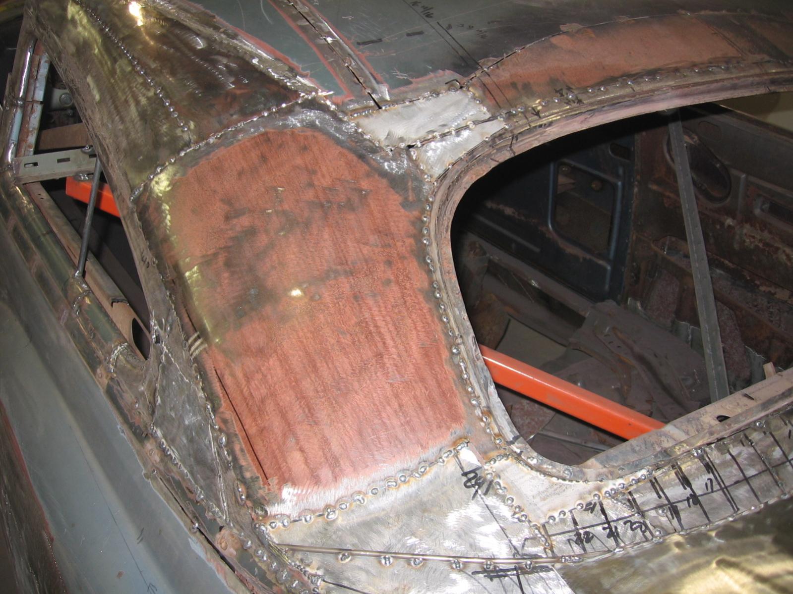

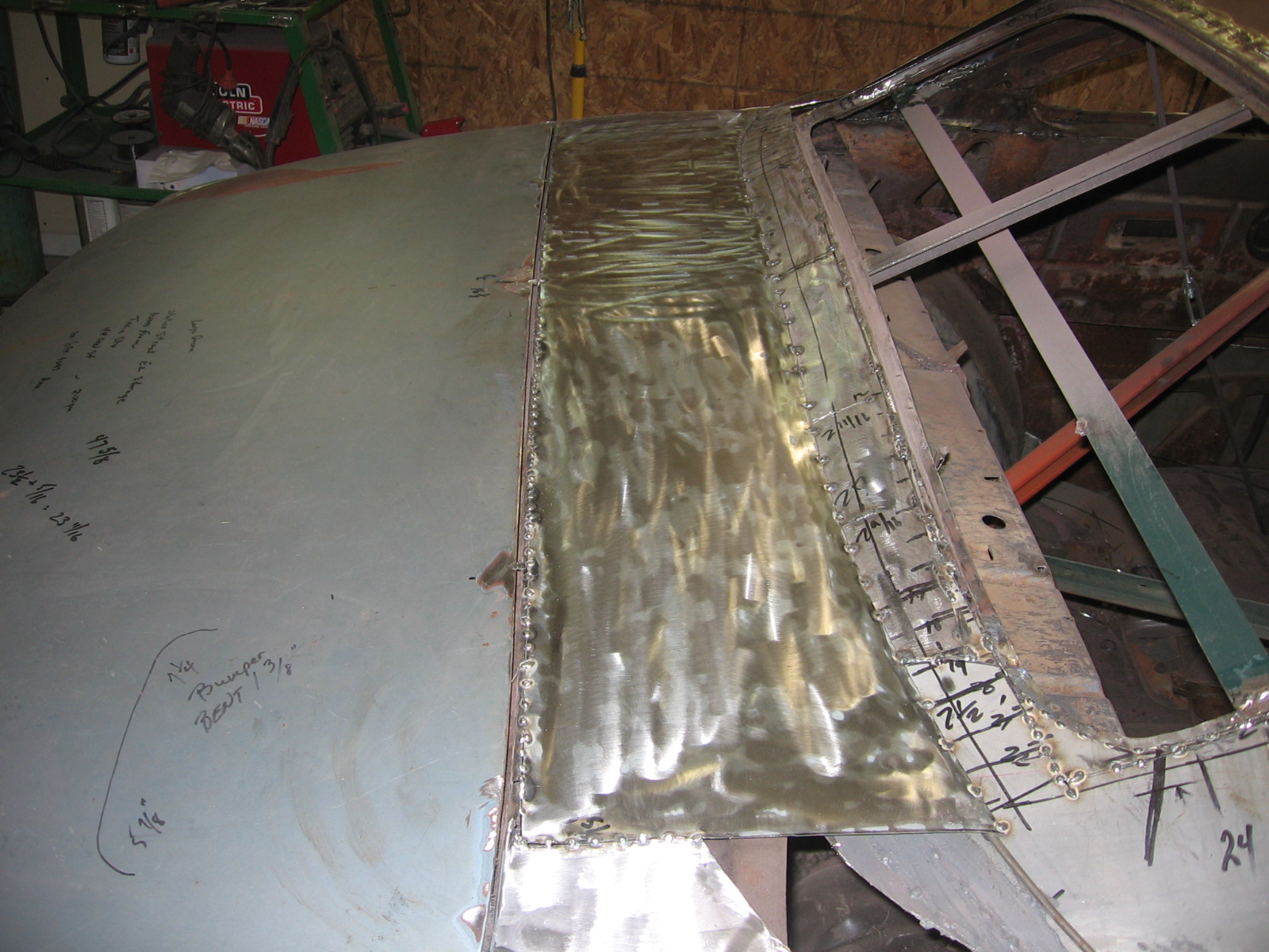

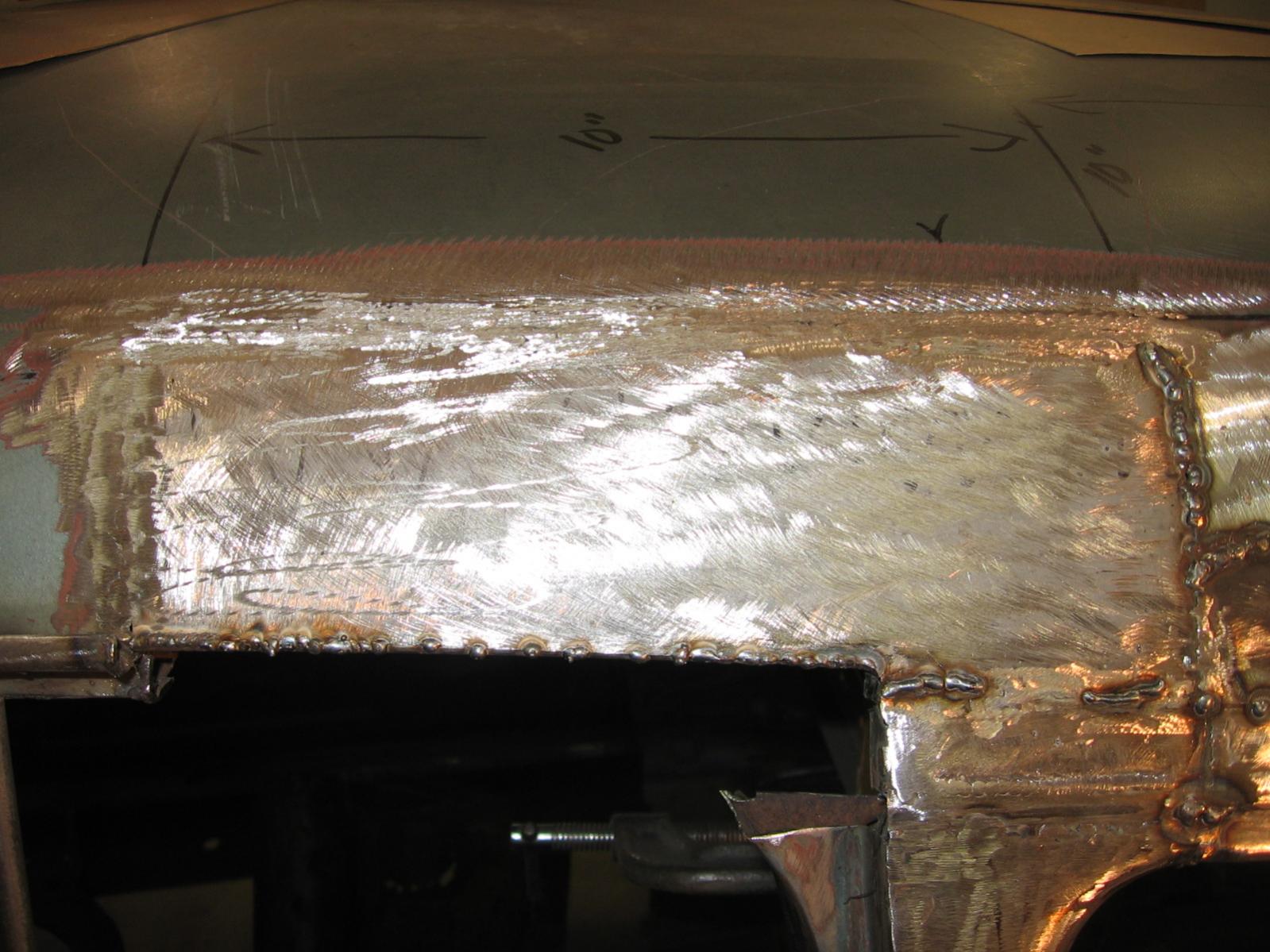

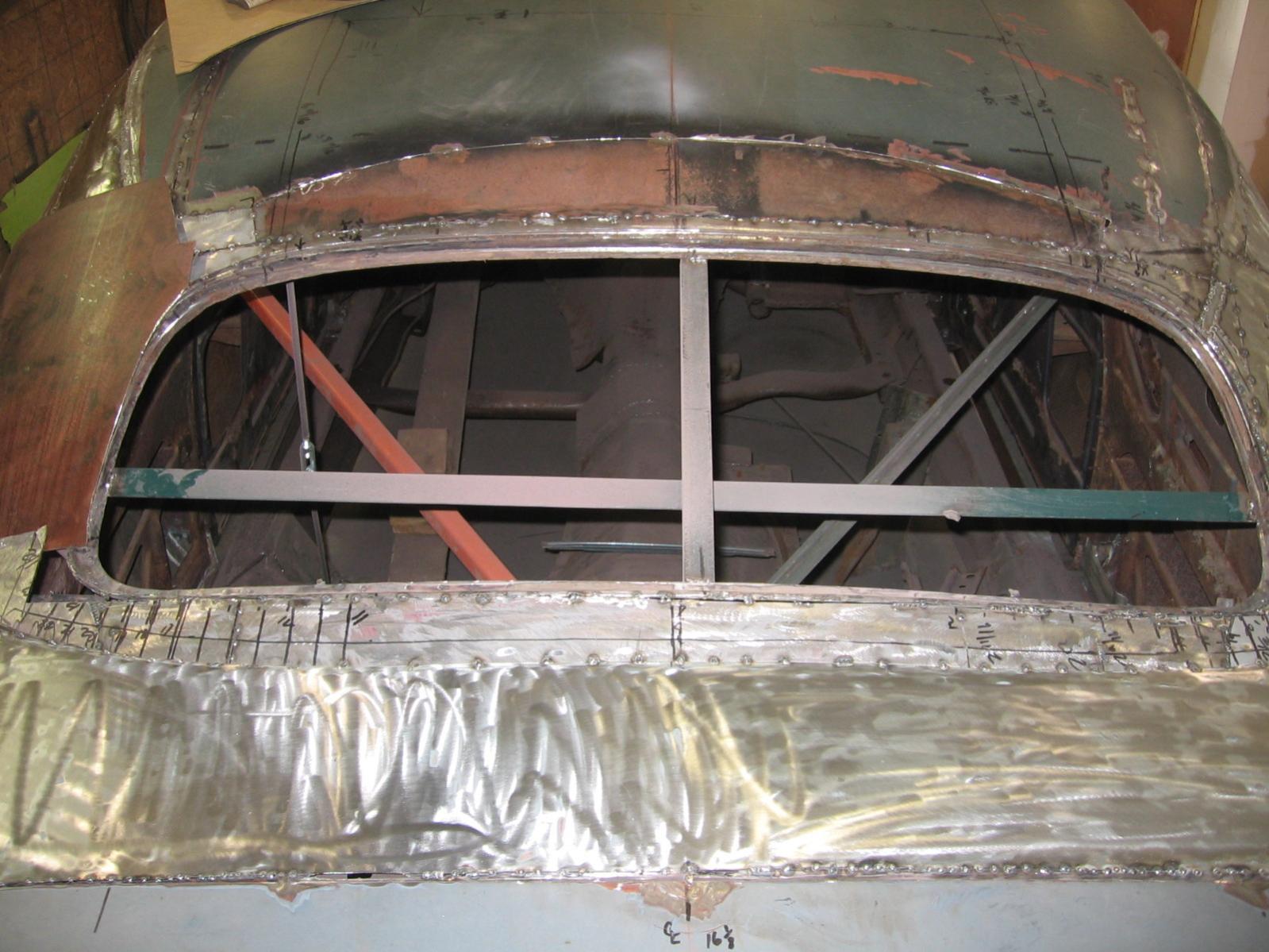

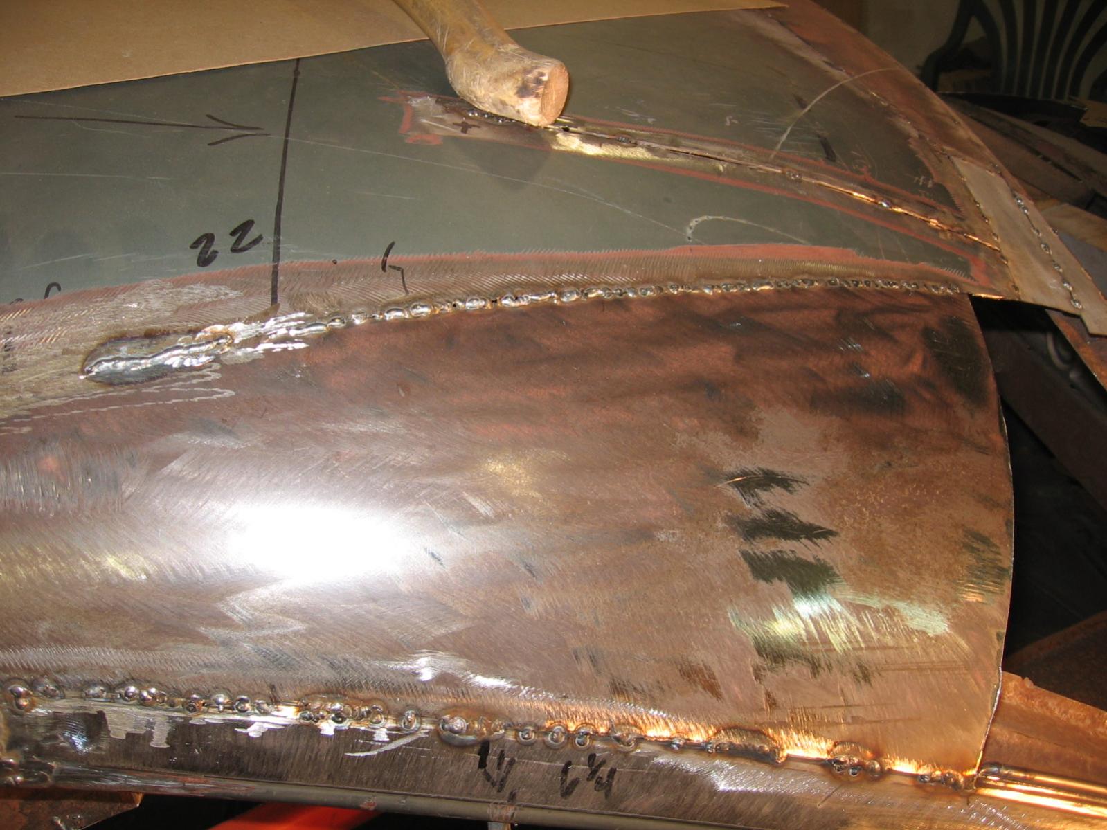

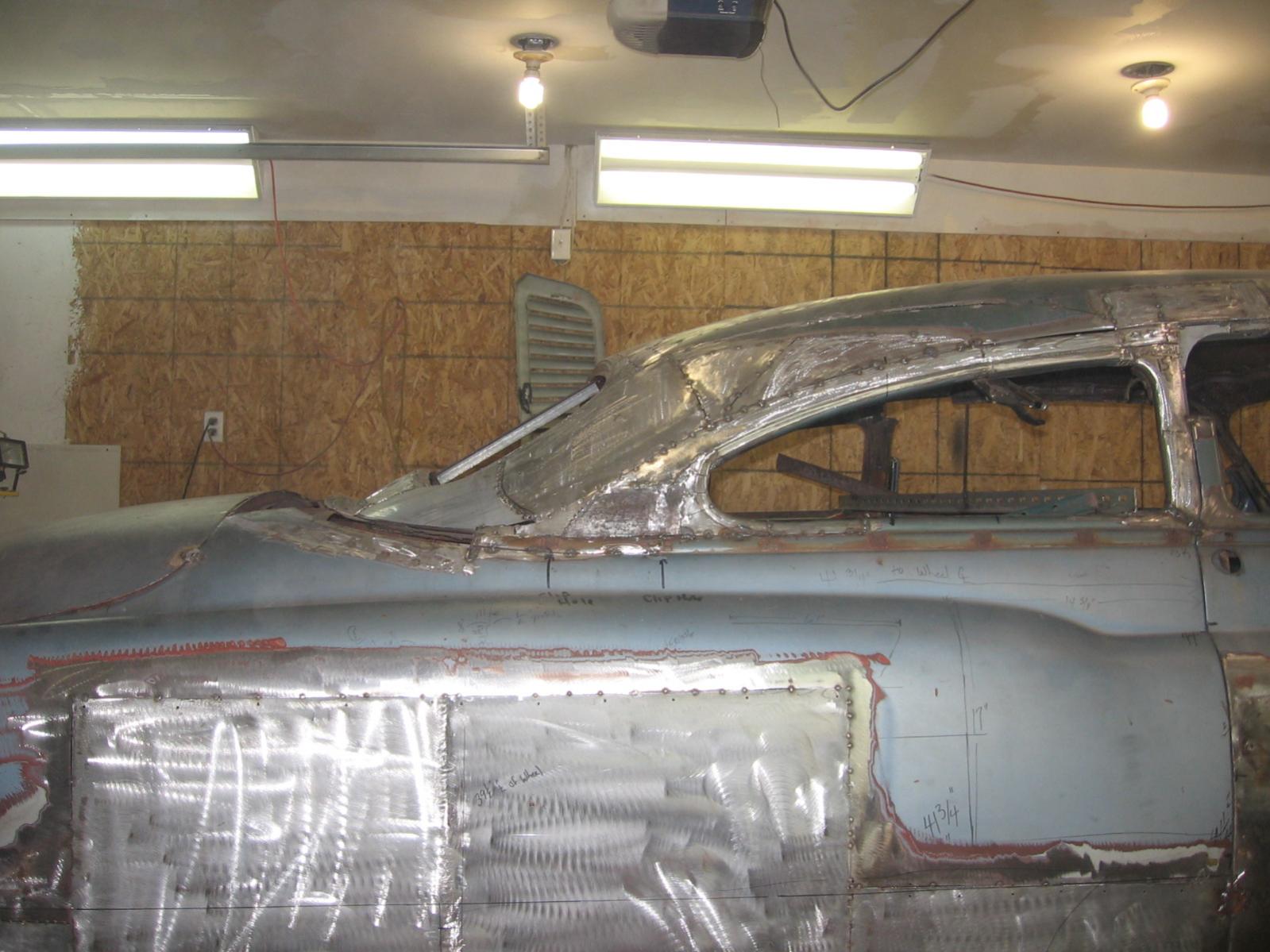

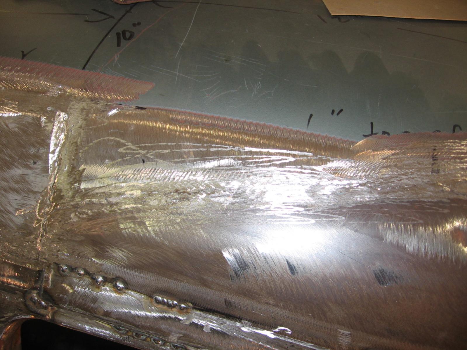

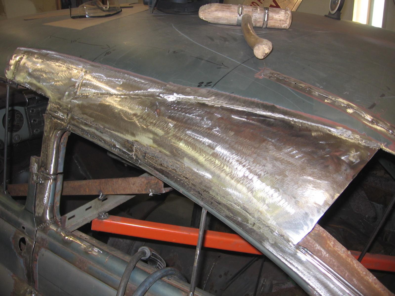

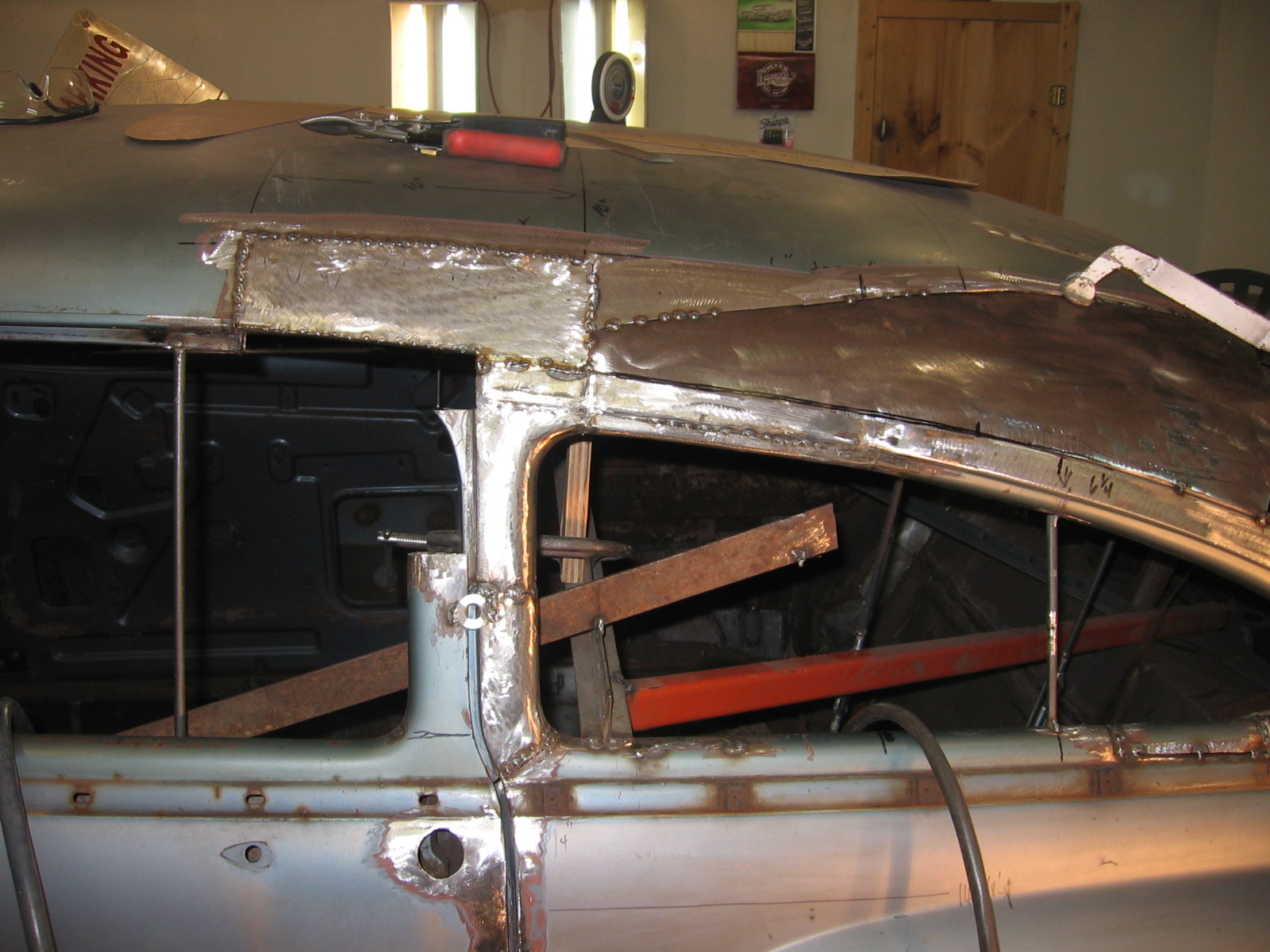

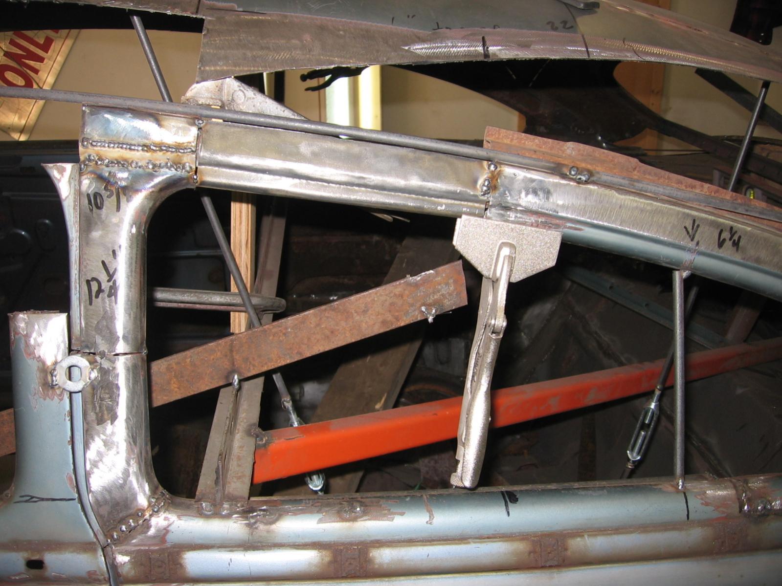

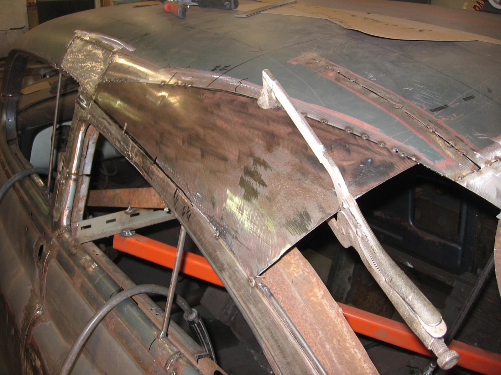

    Well getting some stuff done . In between lifes little interruptions I managed to get the B pillar filler panel at roof filled and welded and also the start to have the roof skin all tied together . I used my english wheel to make the B post filler panel . It works some fast so I have to be carefull when making panels . The large wedge shaped piece is from the donor roof . It sure made things go alot smoother . Hopefully tomorrow will be a big day and I will get alot of stuff filled in . Time will tell . I am hoping to get rid of an 2001 Ram 1500 that I bartered for tomorrow . The guy said he would more than likely be contacting me tomorrow . Heres hopin !!! We've all heard that line before :D

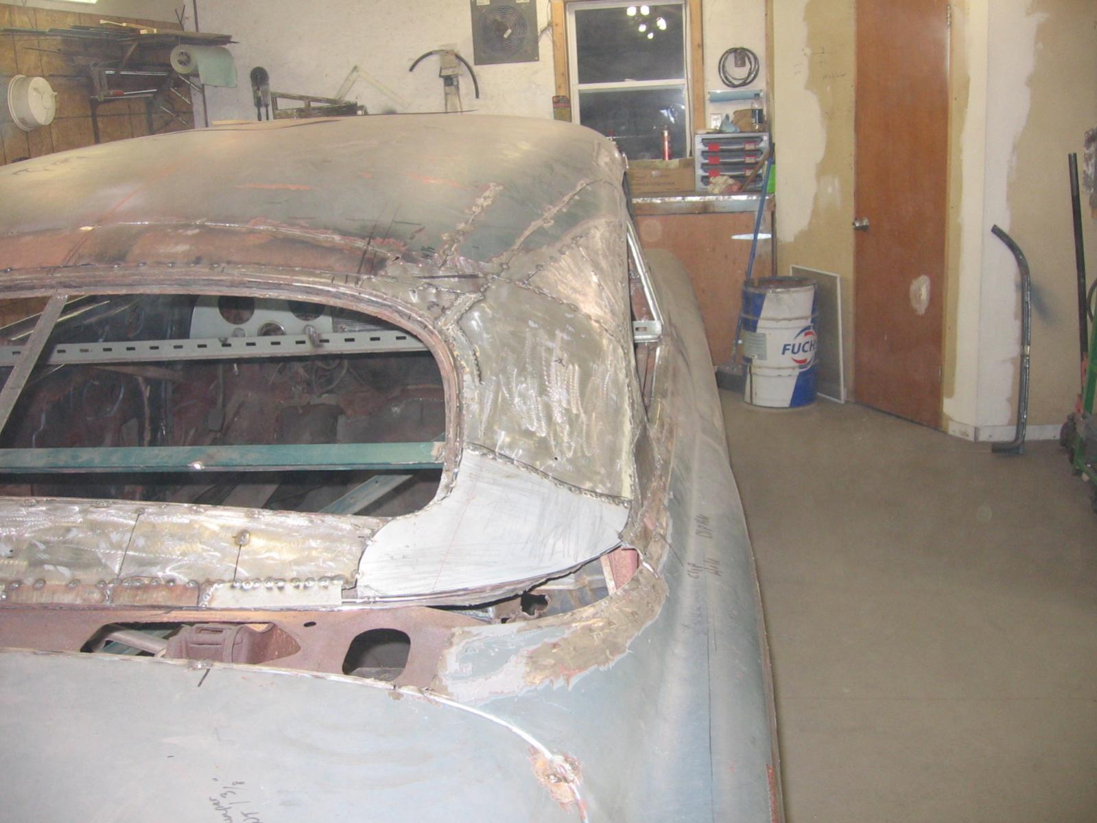

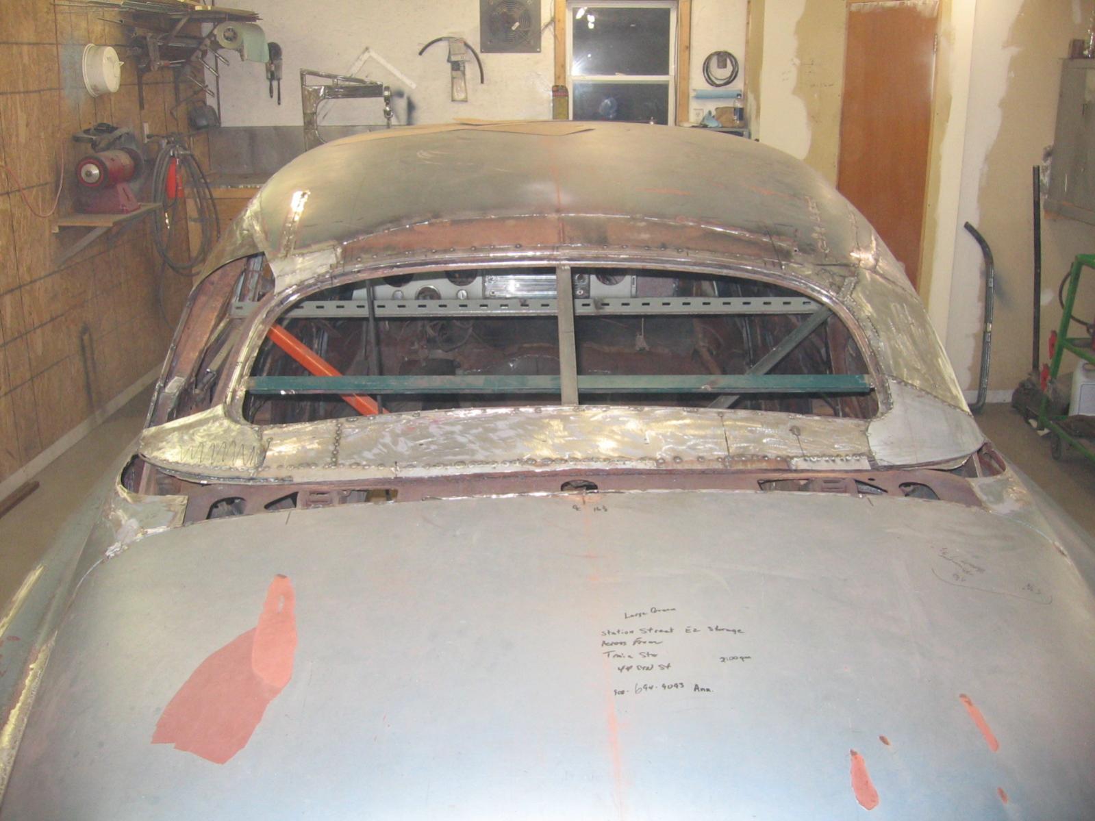

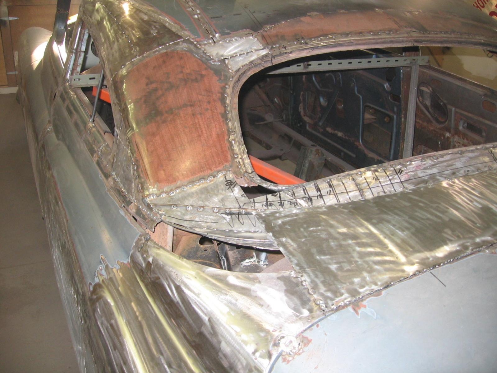

    Well stuffs rolling along pretty good now . I had to attach the rear window frame to the parcel shelf . now I have to make the transition from the back edge of the trunk opening forward to the rear window frame . This will tie in that rear part of the car . The flow is starting to really take shape judging from the two side shots . Day ended when I run out of wire . Damn . Anyway that was a long enough day for me 9:00 AM - 6:00 PM . I am a happy camper :) as the progress this Saturday was a lot more than last :mad: .

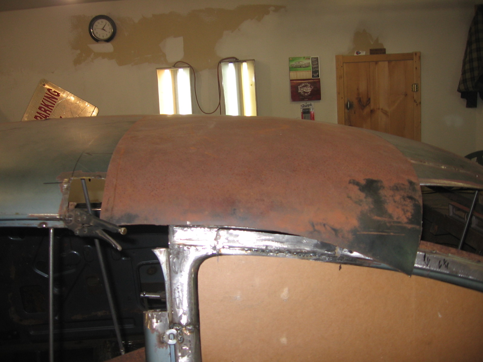

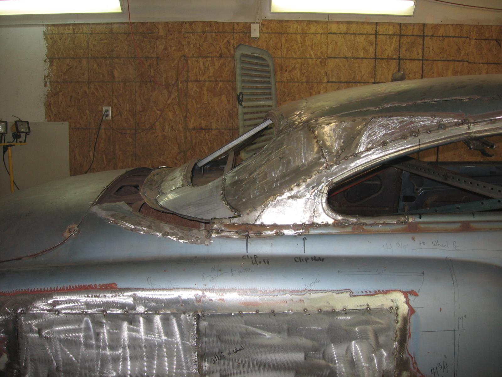

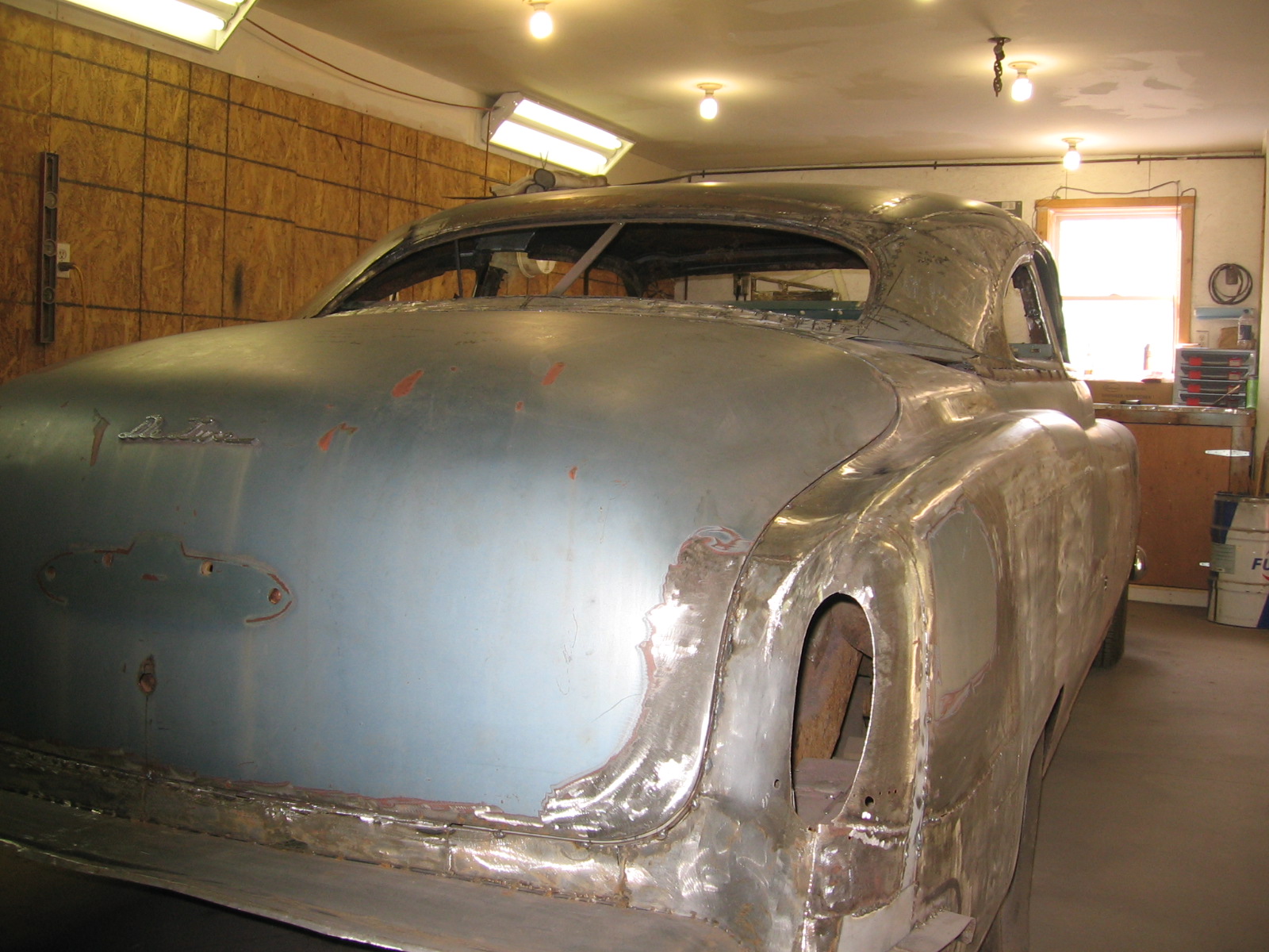

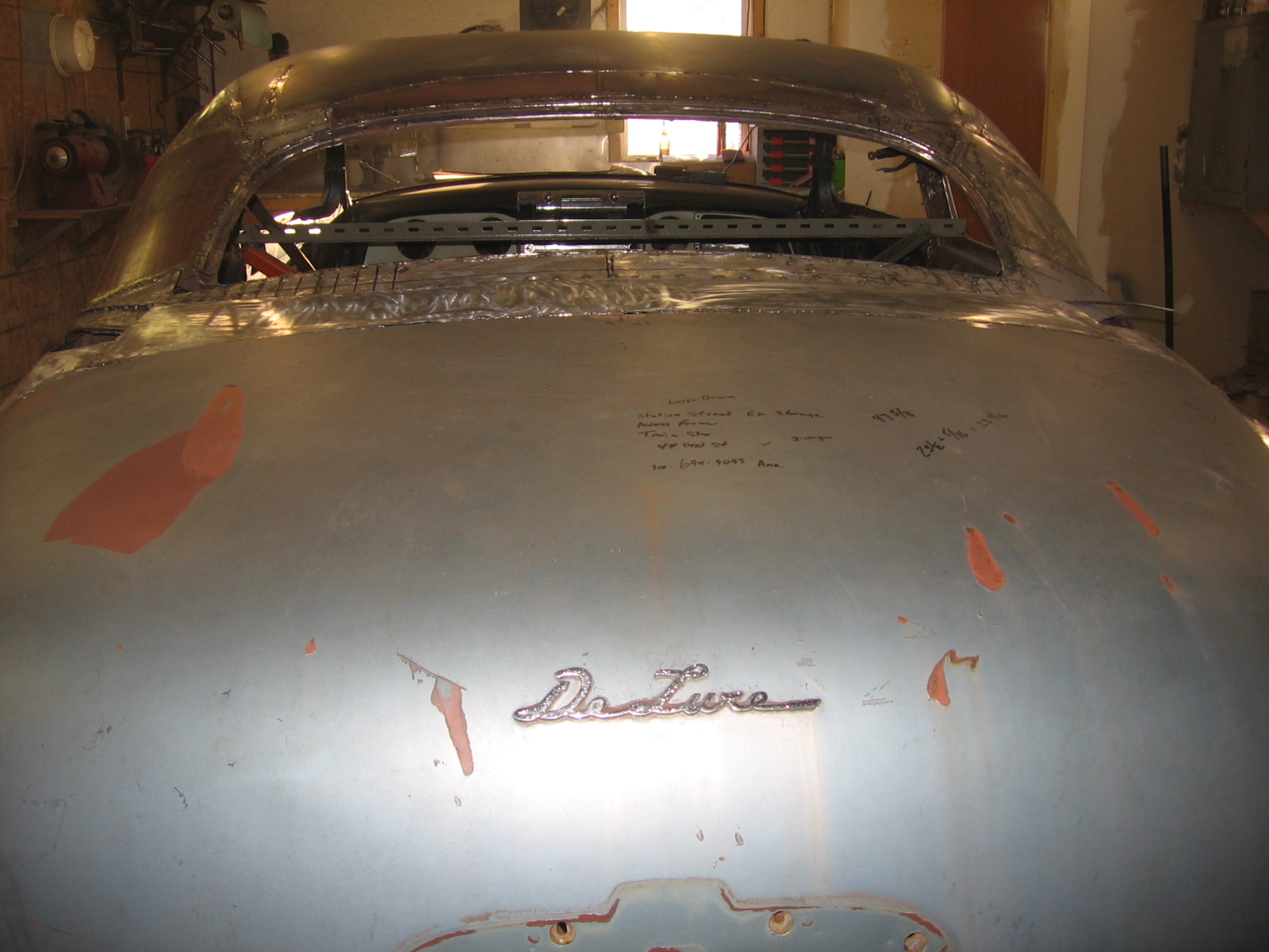

    Got some more done today . Am almost done getting the rear sailpanels closed in . I was able to get the rear catwalk all tacked in as well .This stuff takes some time I will tell you that much , Geesh !!! I am starting to see the flow coming together . Lots of welding of seams to do . Then on to the next big task ???? Andy
