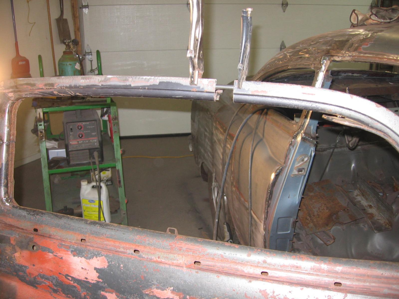

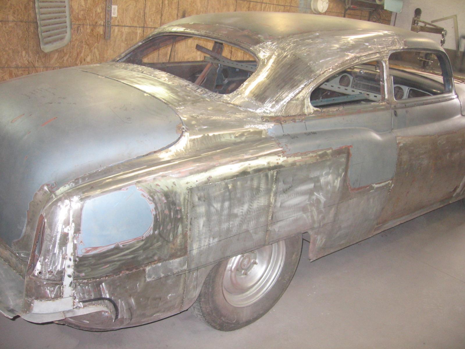

    Hope everyone had a good Christmas. I was able to get some more work on the roof done today .I know its a lot of the same but progress is progress. Have a look but , yawn even I am getting bored LOL!!!

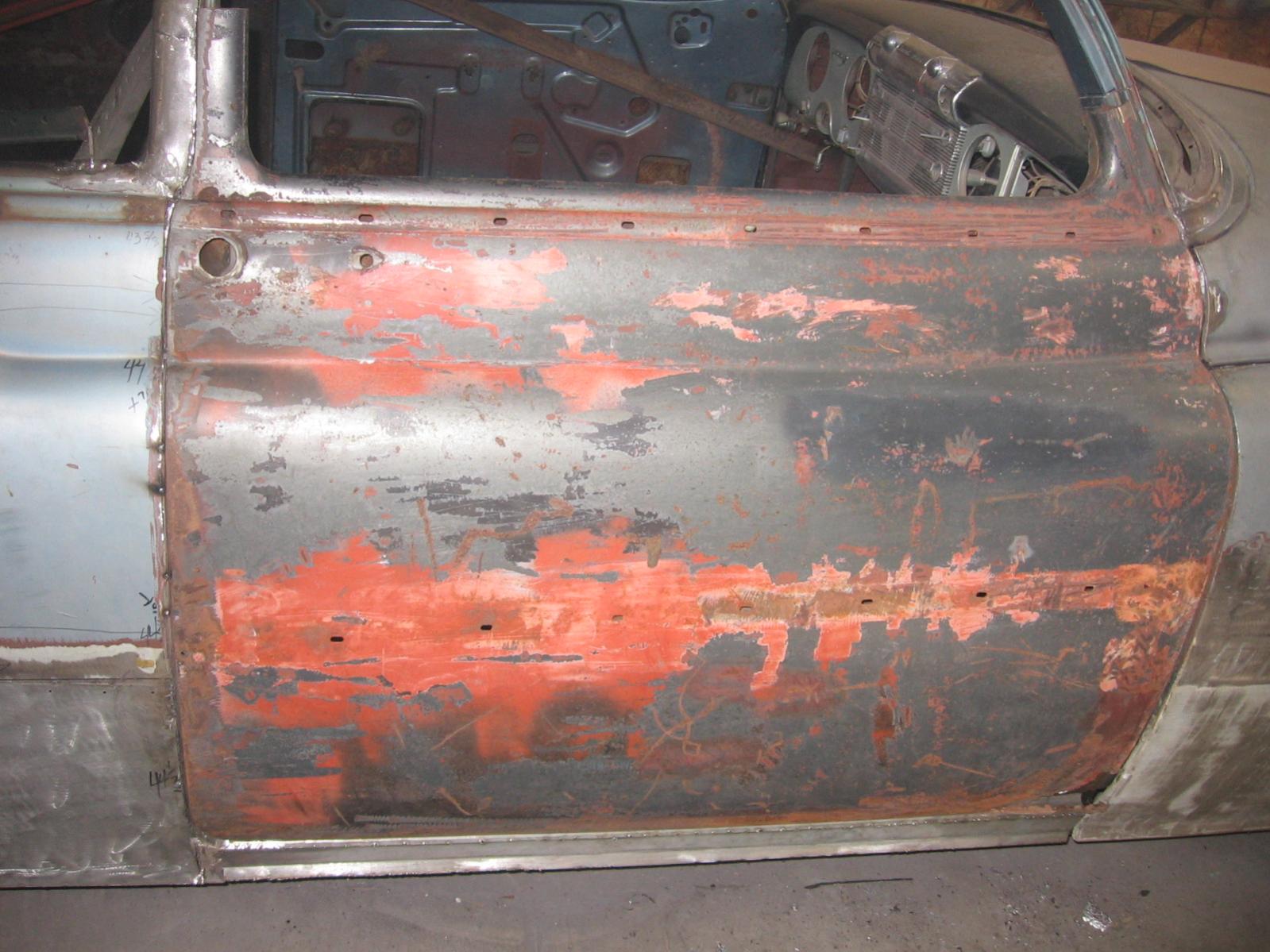

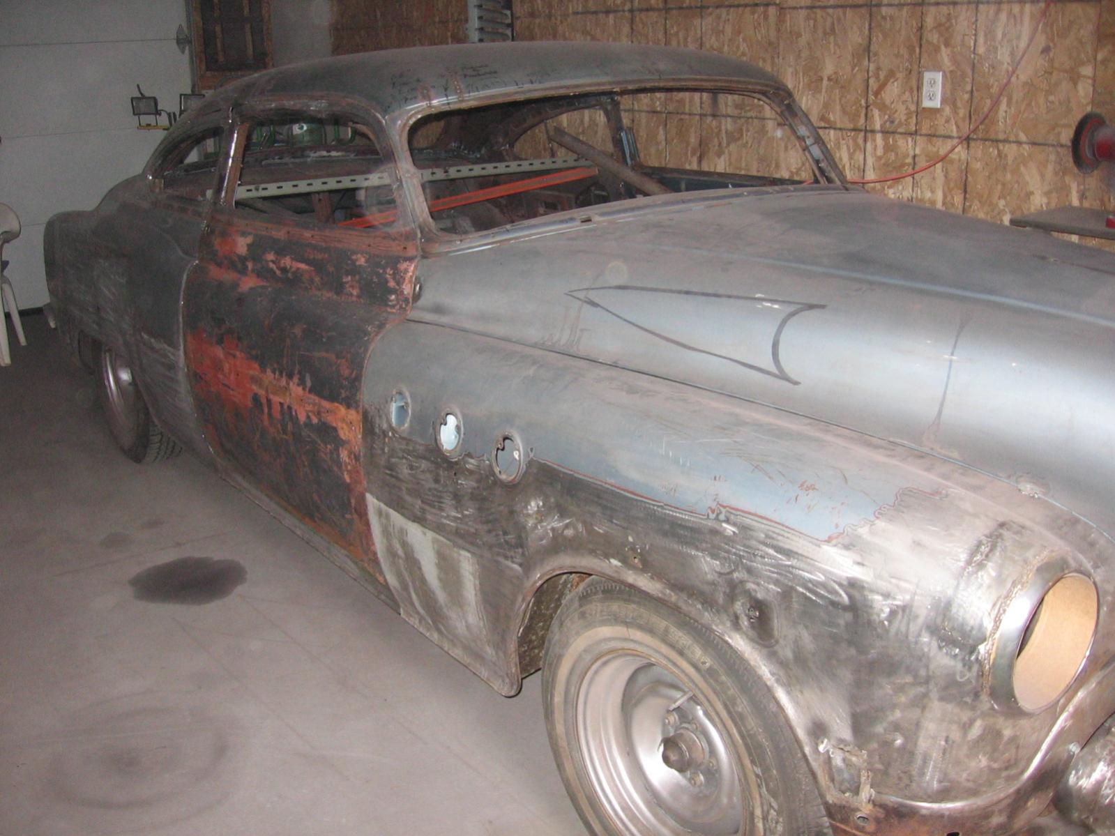

    Started fitting the new / old right door . It didnt fit well and I realized that the opening was 1/4 in narrower than the left side ??? Anyway got that figured out . I am going to try for 3/16 in gaps but at the front leading edge of the door to fender it will have to be a larger gap due to fender clearance issues when the door is opened . Any of you guys out there back me up on this . It seems logical enough . I tried running to close a gap on my 51 fleetline but by the time I did bodywork and paint, the paint would wear off at the highest crown point of the door . It was close . What are you guys running for gaps ? I dont know if you can see in the pictures clearly but the front is about 5/16 . That seems to me to be a little to wide ??

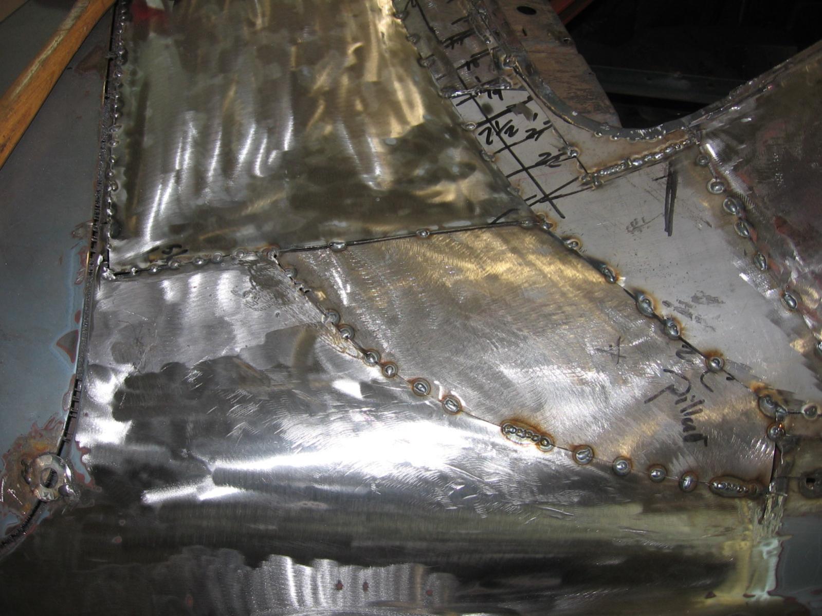

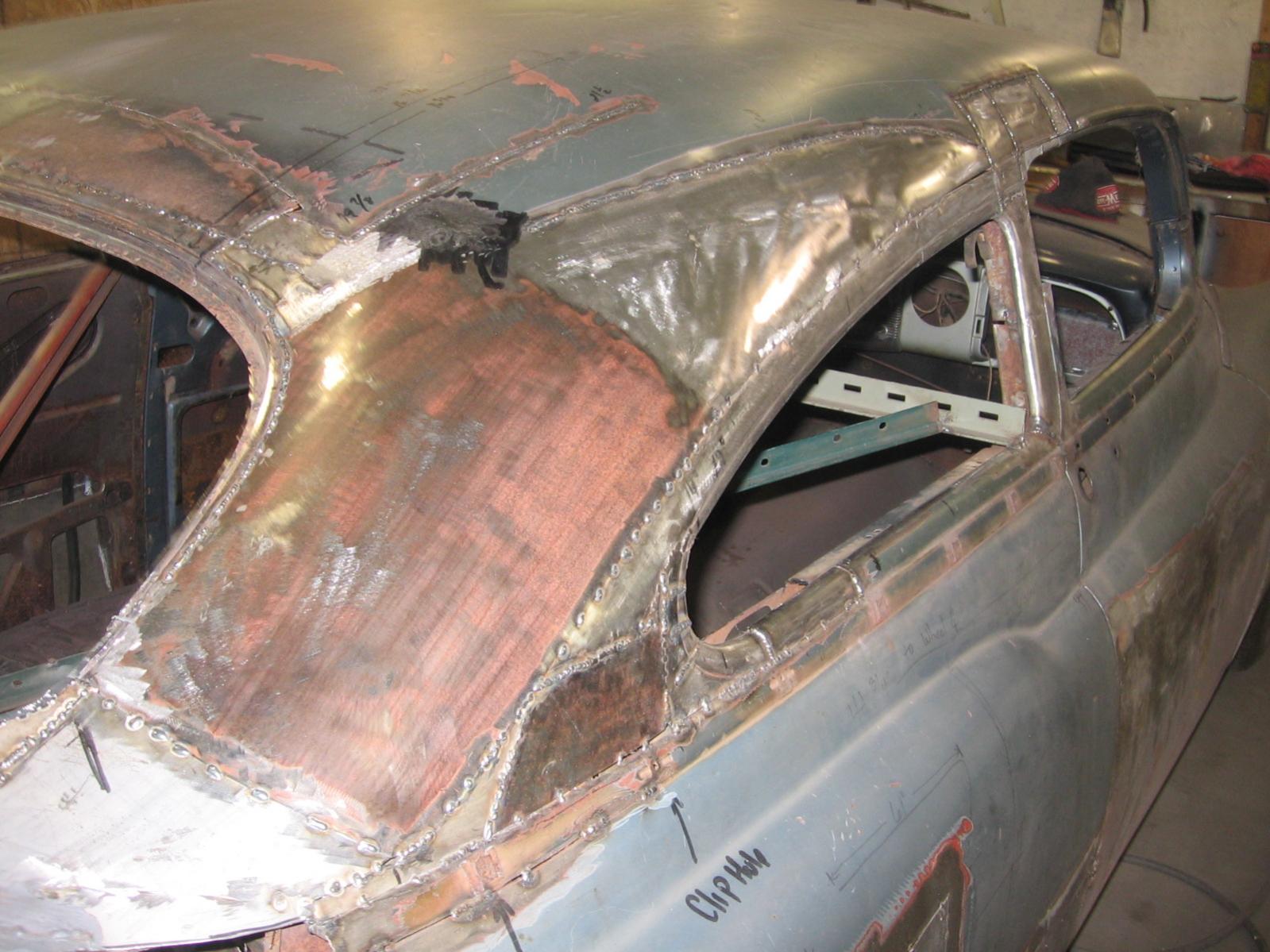

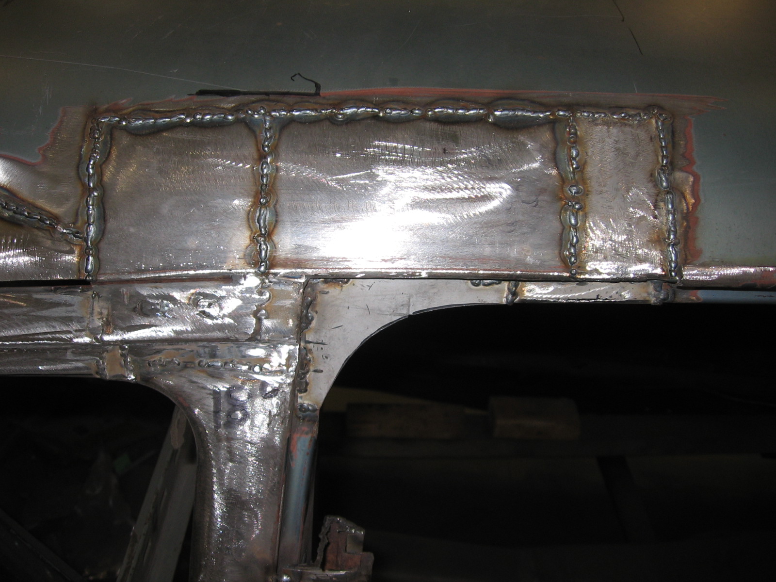

    Well the Buick is off to the side of the shop for now . Have some work to attend to in the house . So I have the window frame roughed in and the chop is about 85 % complete on the p***enger side . Have to put on a drip rail ( 5/16 CRS ) and make some more minor adjustments here and there . I now have that 1 1/4 gap filled with a donor piece from the old door . Andy..
