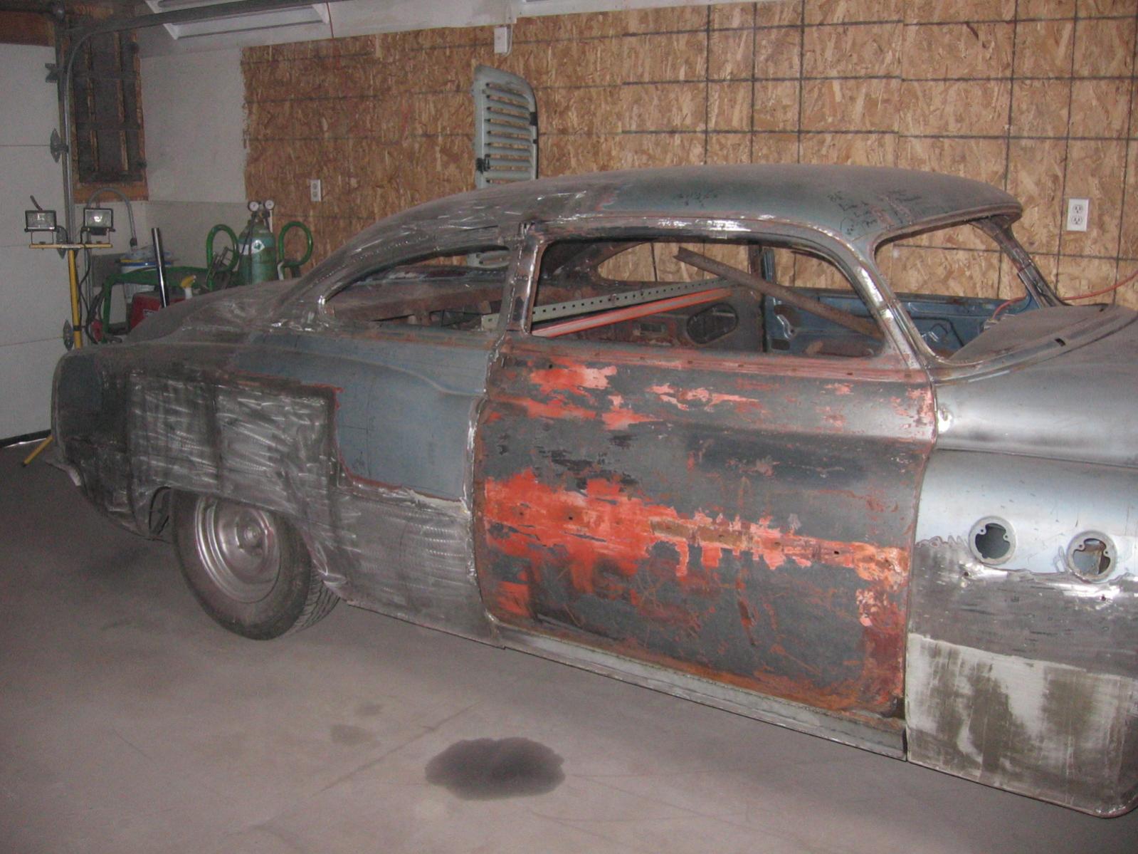

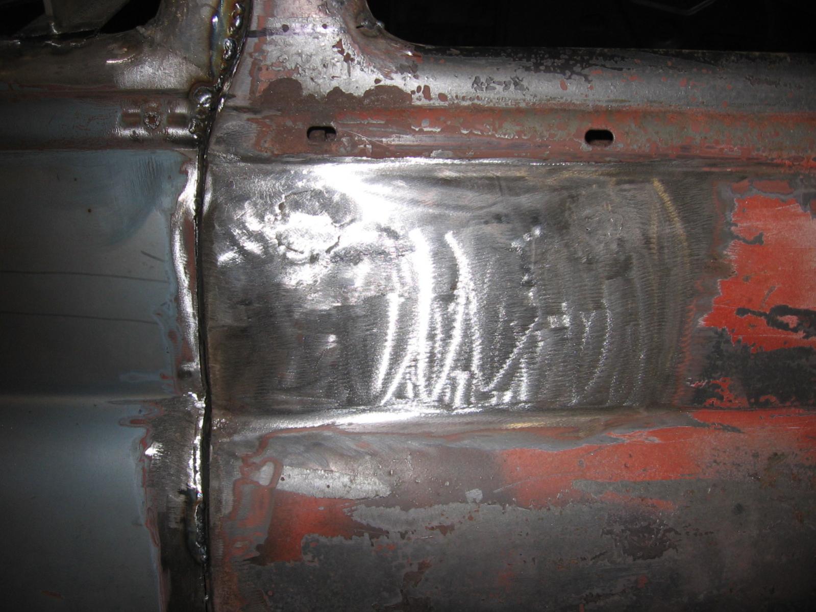

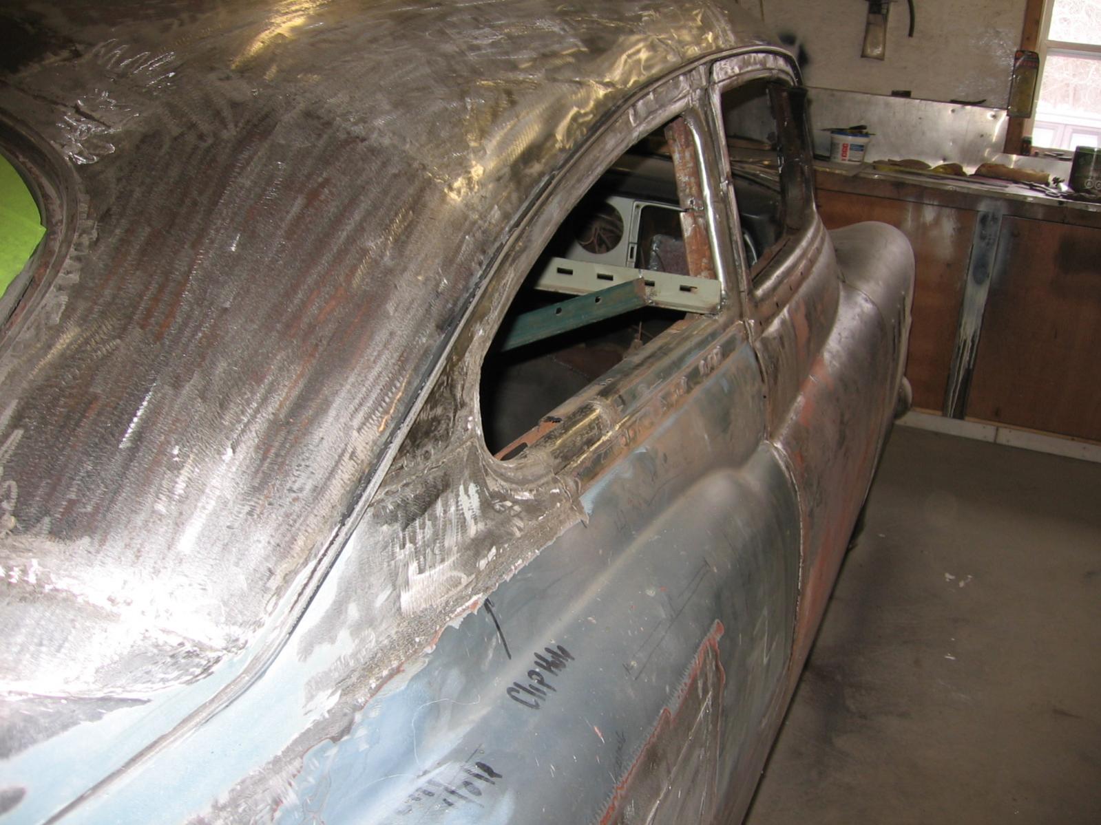

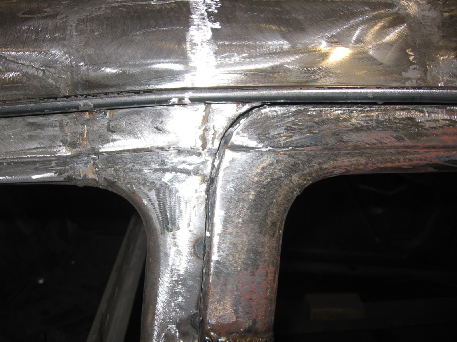

    try these . hope they show up I know it looks like some of the same pictures but the changes I am trying to capture are the reinstall of the driprail fading away to nothing and the rebuild of the rounded doortop opening . I also cleaned up the quaterpanel opening a bit . I will have to remove it again and run it through the english wheel to get the proper compund curve to the panel . Thats later though !! I am a little disappointed that I was not able to get out here at all since January as the wife and life kept getting in the way . I am sure you guys know how it is !! See ya for now , Andy...

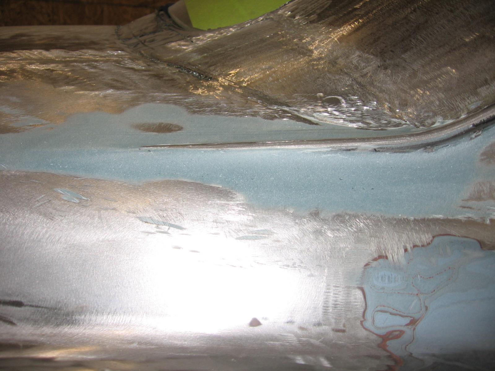

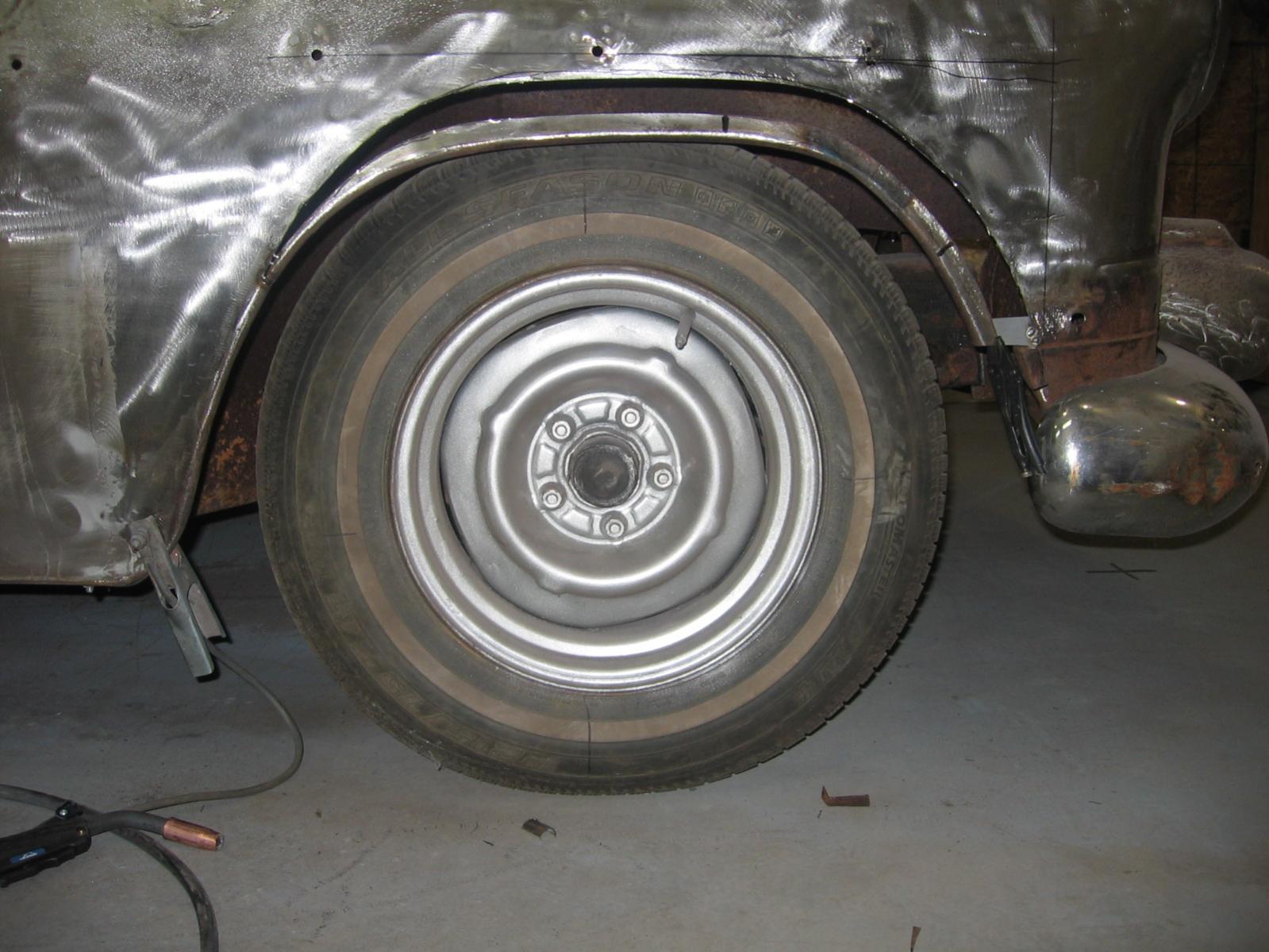

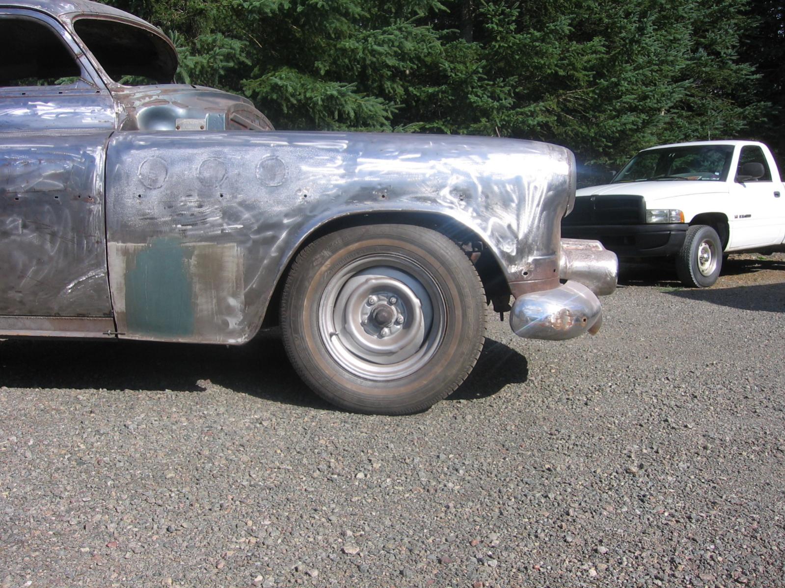

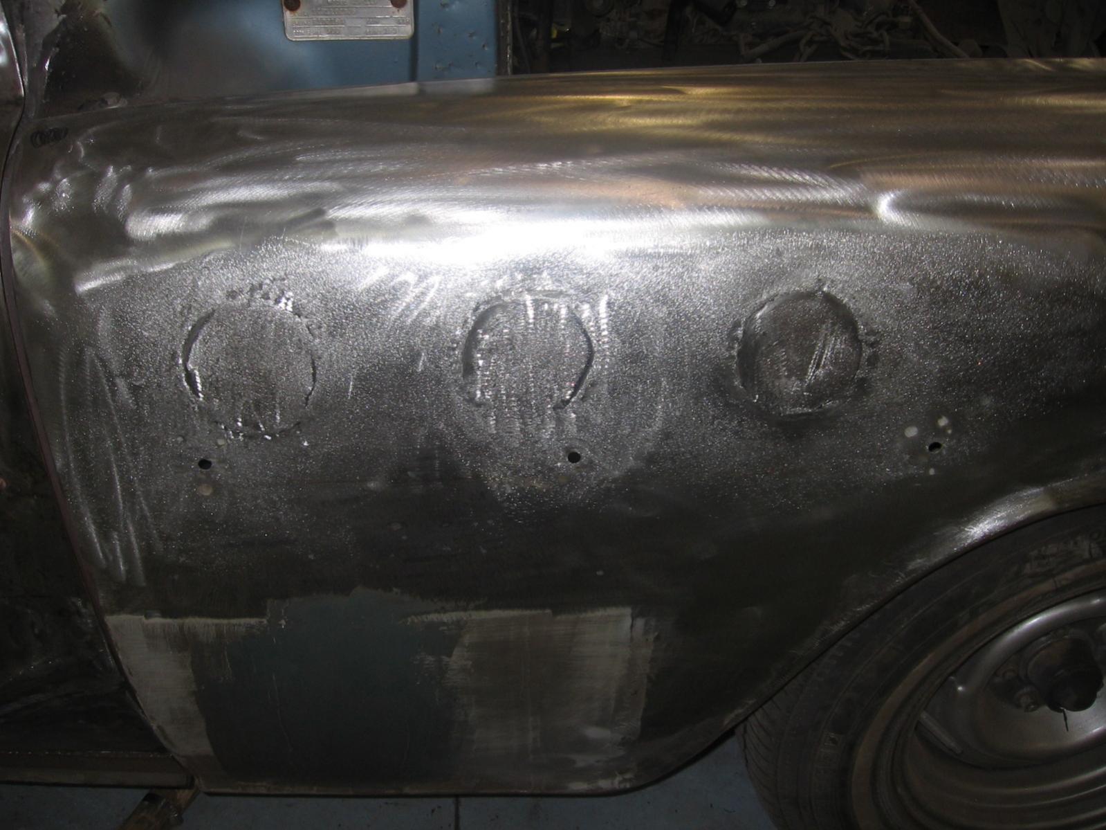

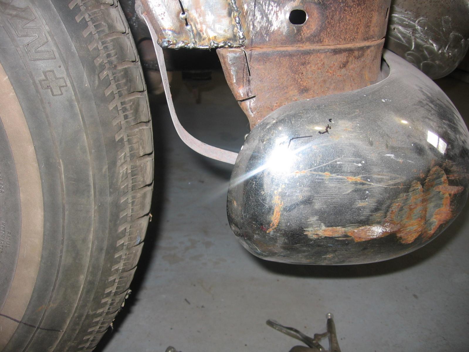

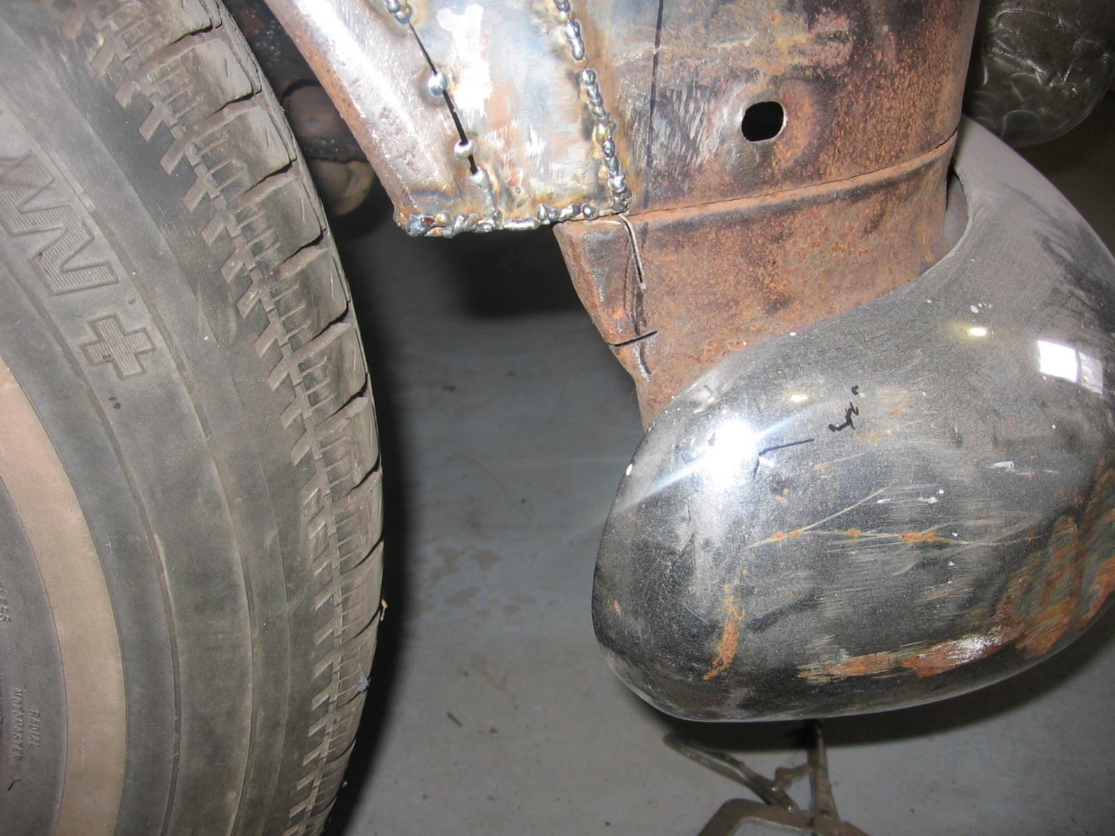

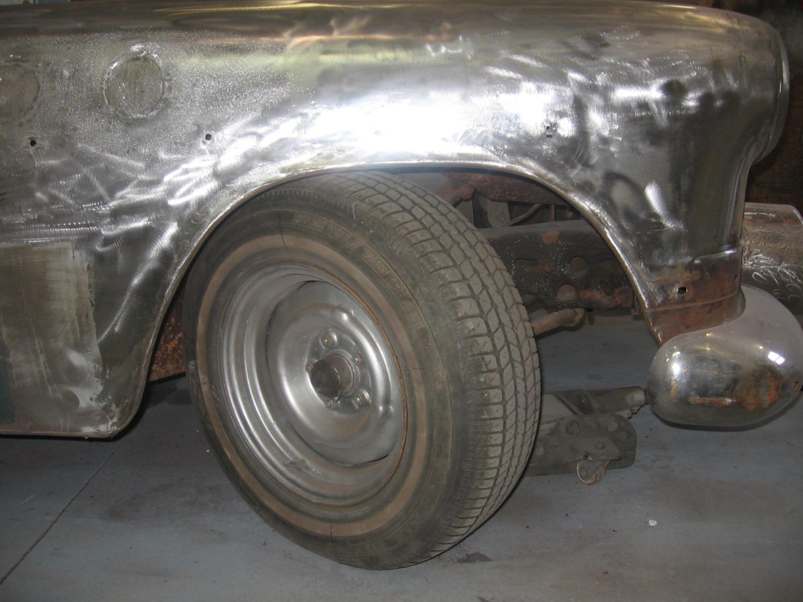

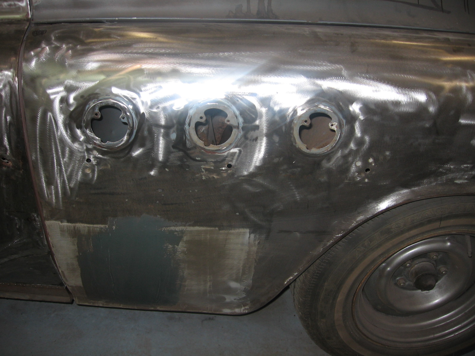

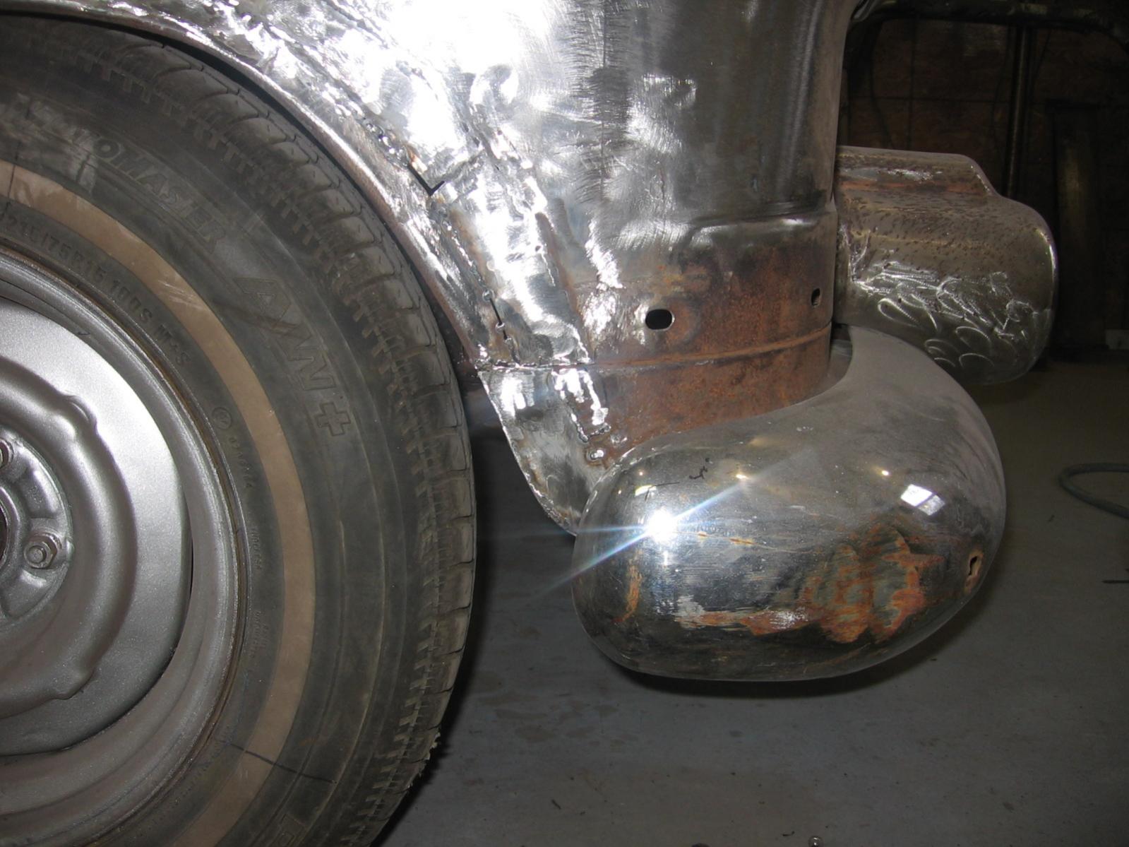

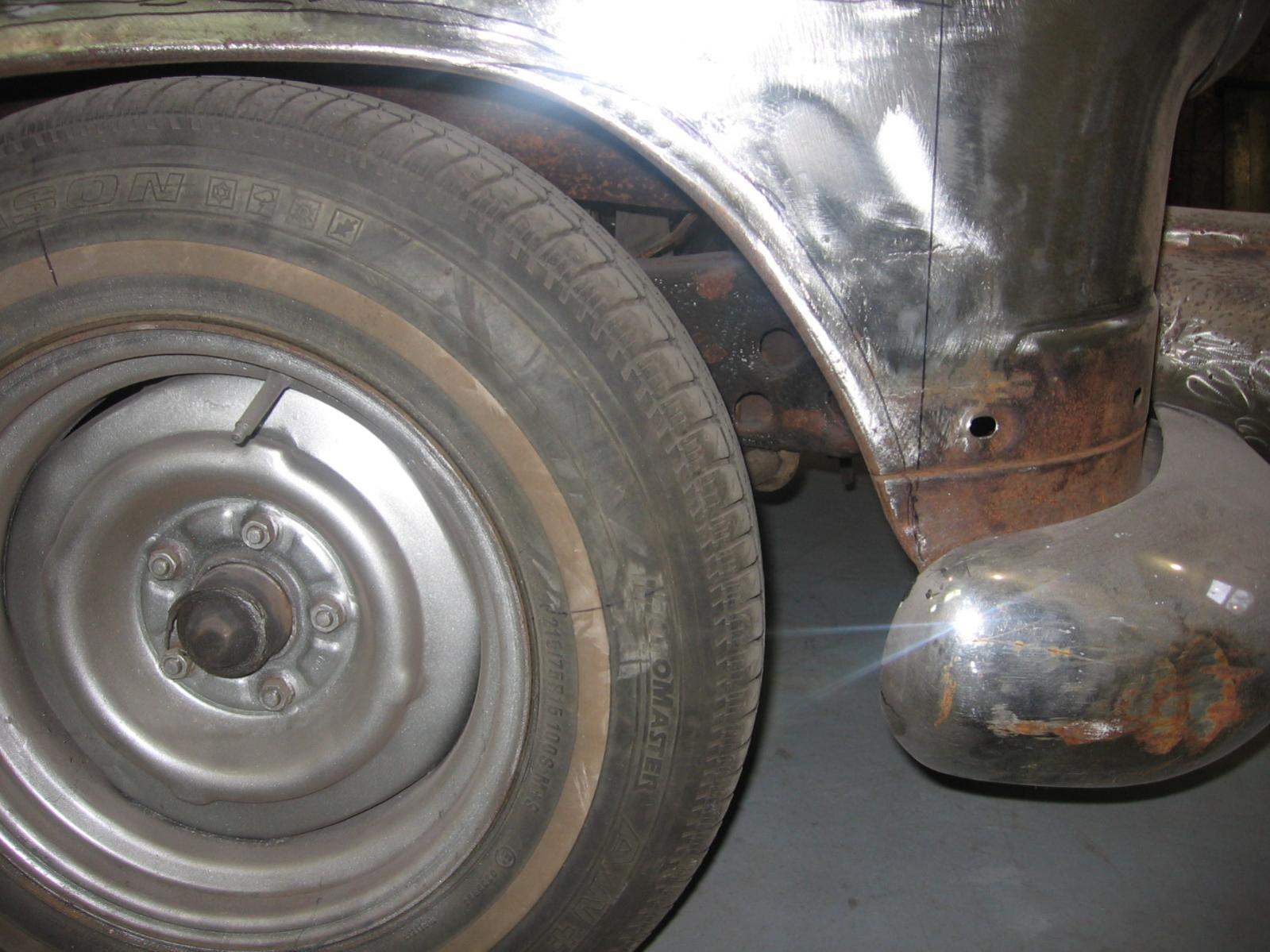

    Well its been since December 2012 that I have anything constructive to report on the Buick . I have now an update with some pictures. Stripped the car on the p***enger side of all the original paint . As mentioned before the car only had been painted once in its years on the road . I worked on the door front corner and patched that all up . Always more rust than expected , you guys know how that goes . Got the door gaps all aligned and the door fitting very well .

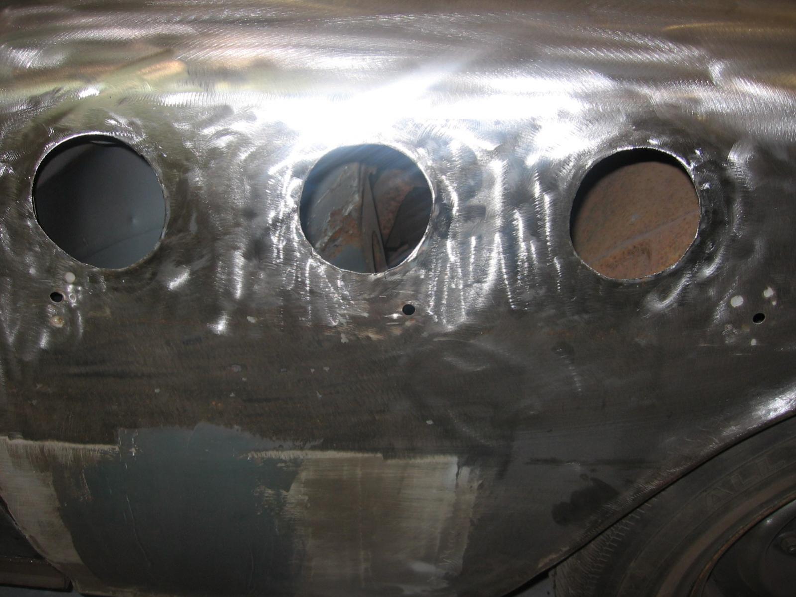

    I replaced the br*** bushings and now the door fits well . Moved onto the fender and removed the portholes . I like how it changed the look of the fender. It seems a mile long now . May do custom portholes later . I will see how this wears for a while ??

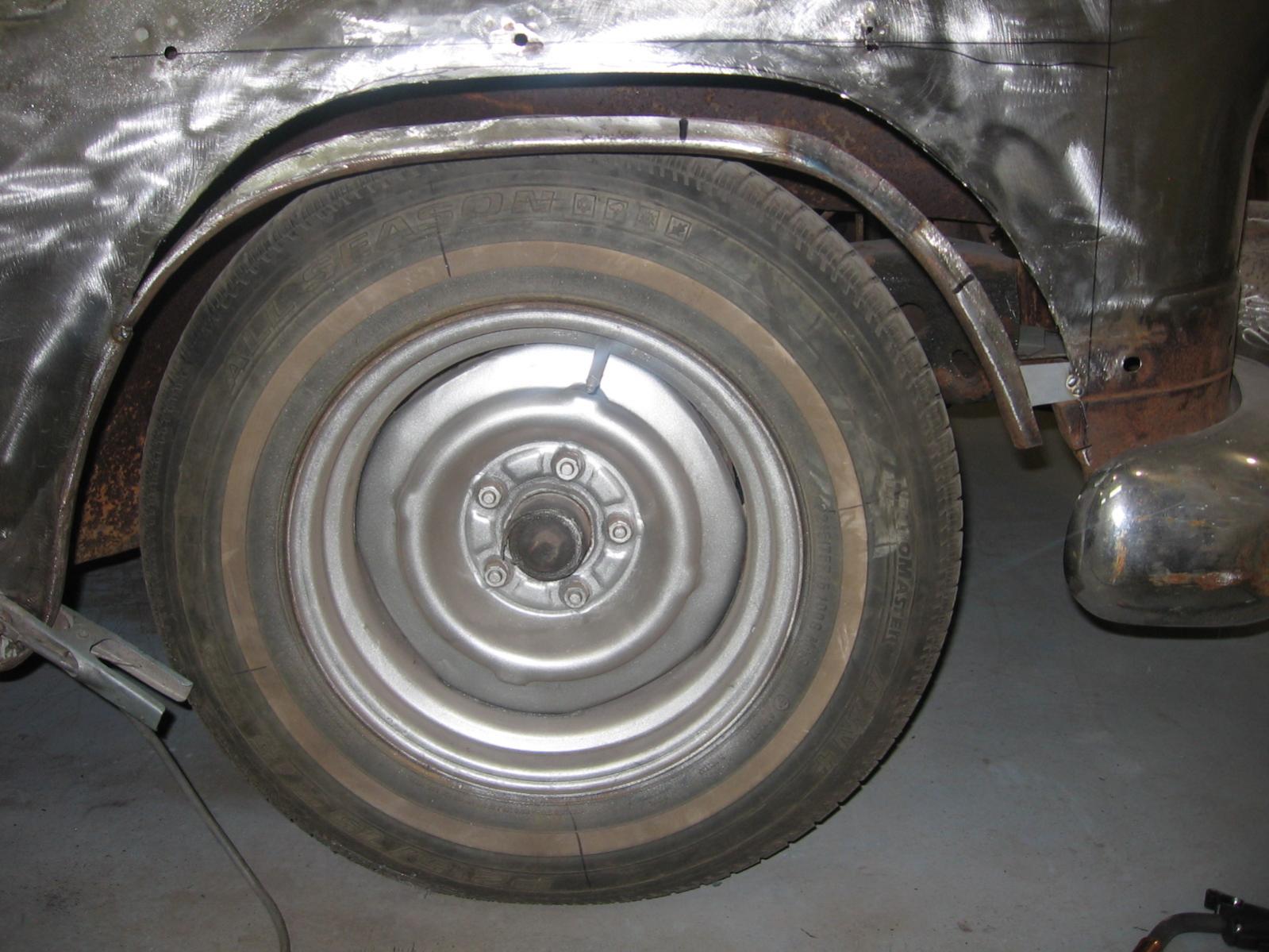

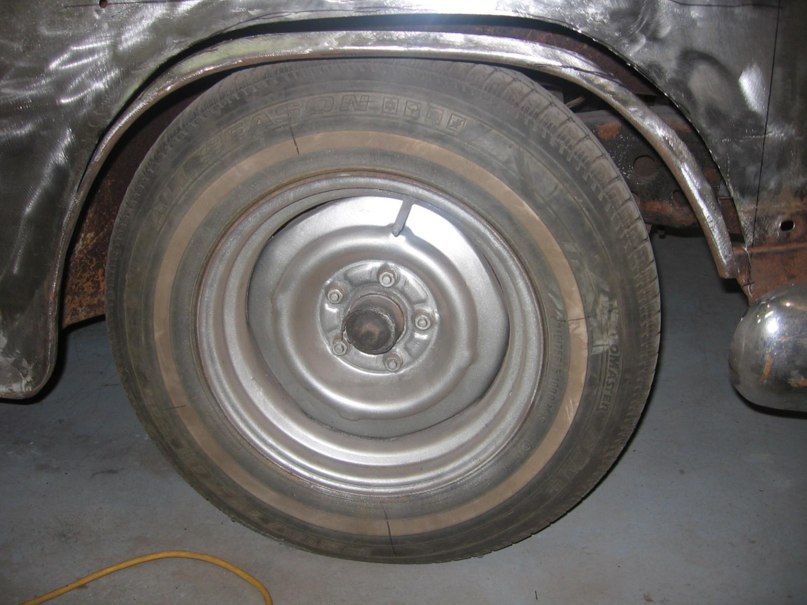

    I am thinking that I need to cut the front fender opening and m***age it a little so there is a more even space from the tire to fender . Look at the picture you will see what I mean .
  13. BrerHair

    I see it, think you're right. You could use a little more sheet metal work, why not?

    Yah Jimmy why not eh ! I like welding and grinding !! you know thats what it takes though . Come on I know you do LOL . Anyway I take it you see what I see ? Andy..

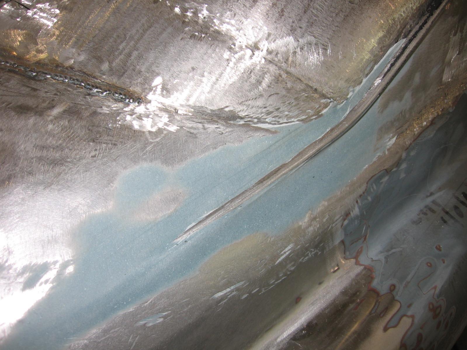

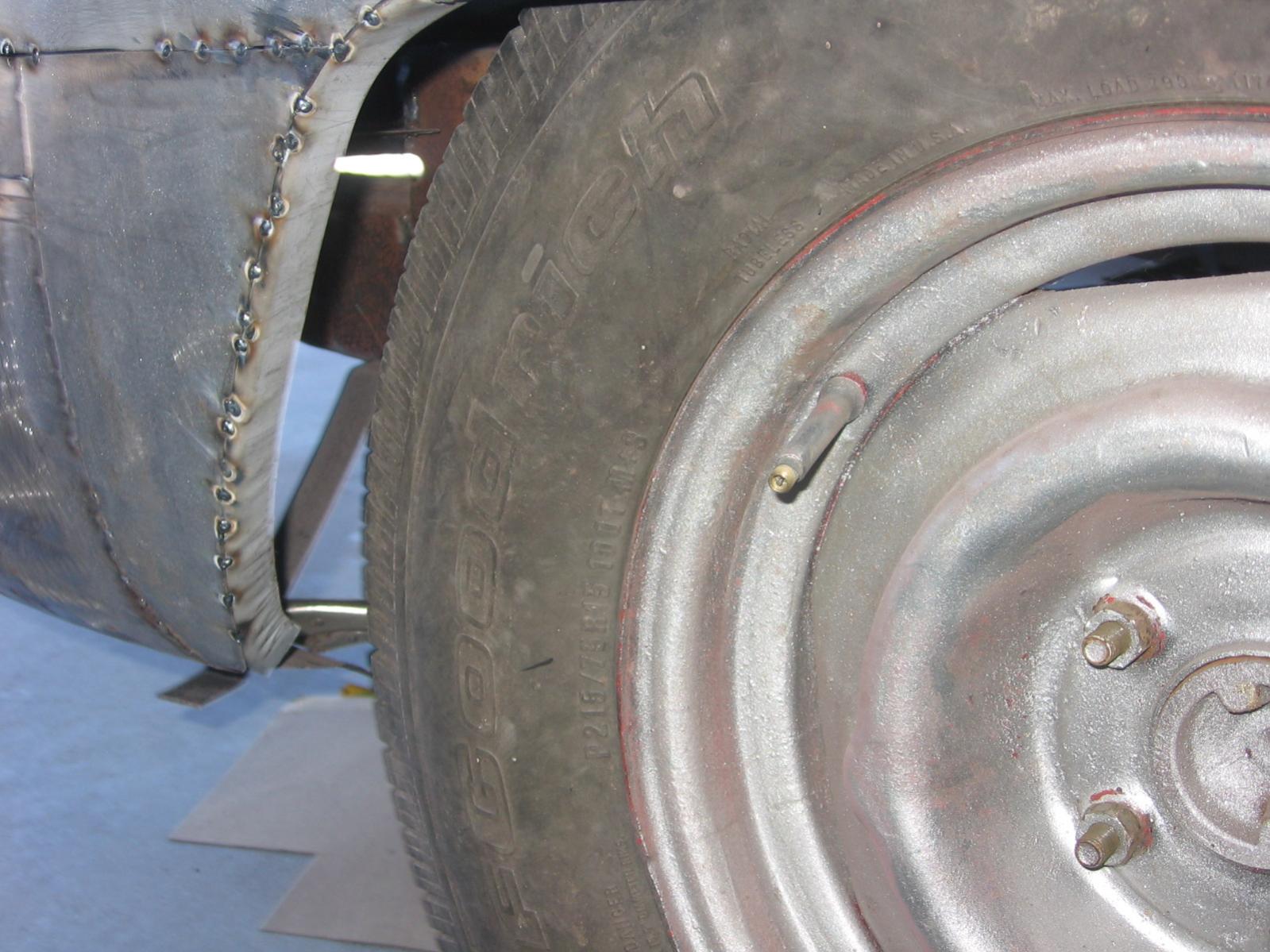

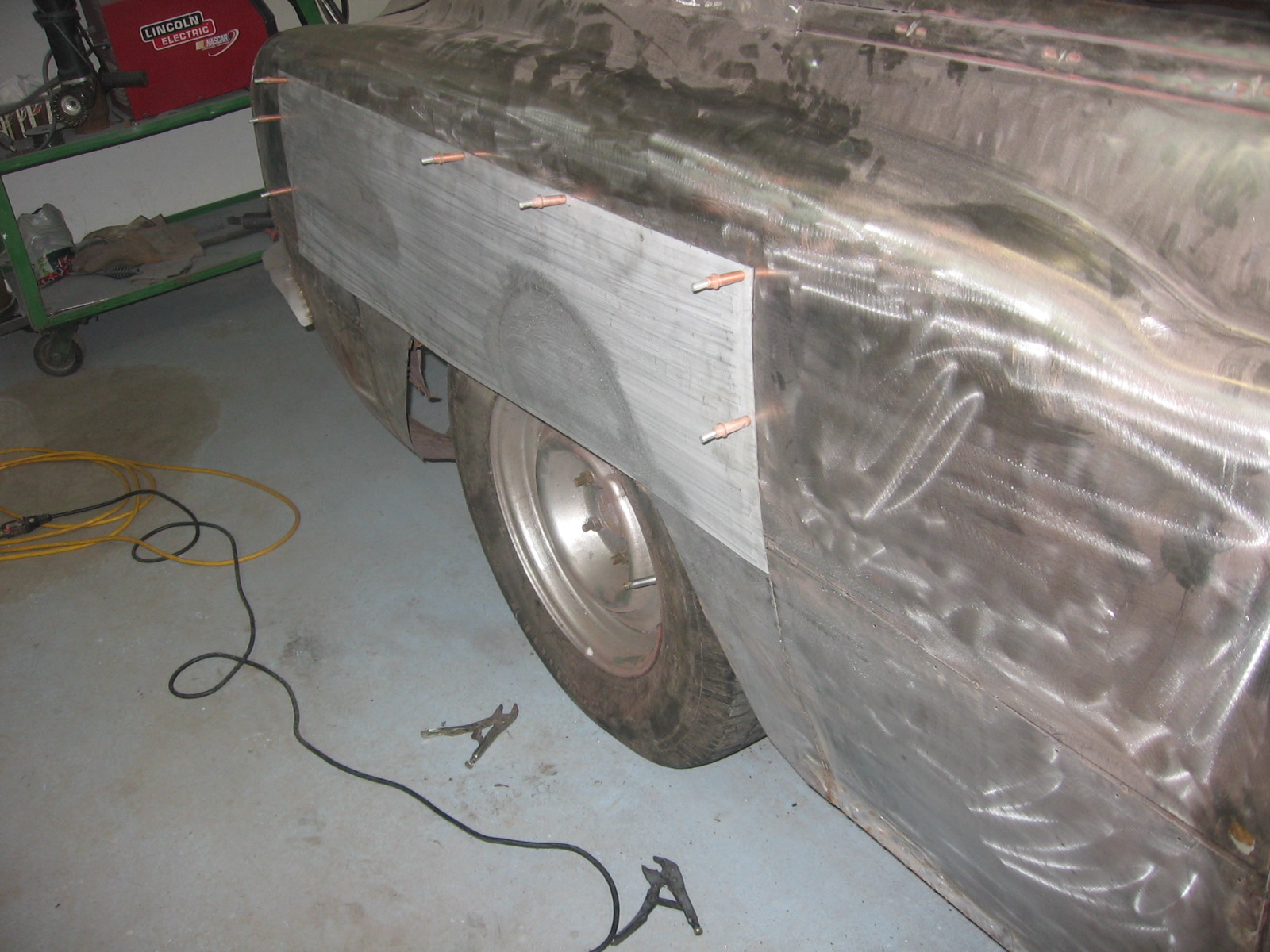

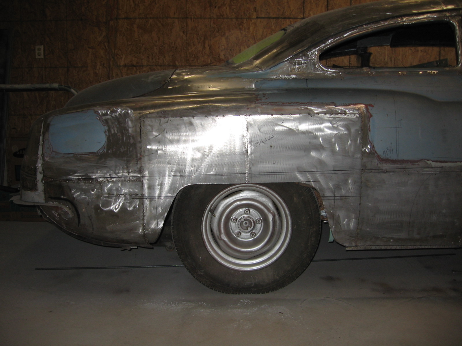

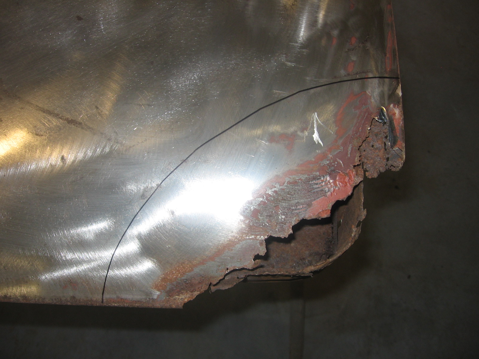

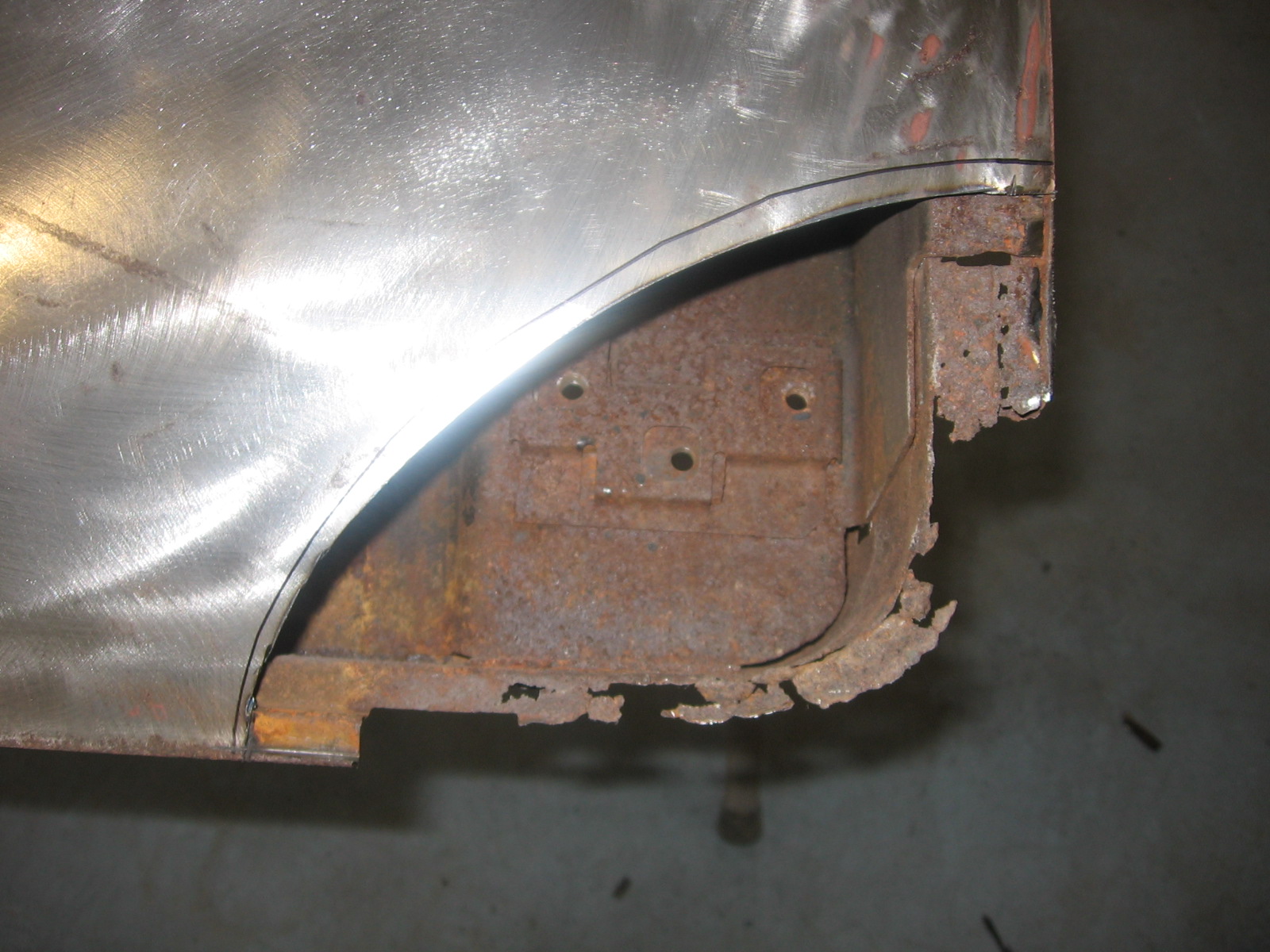

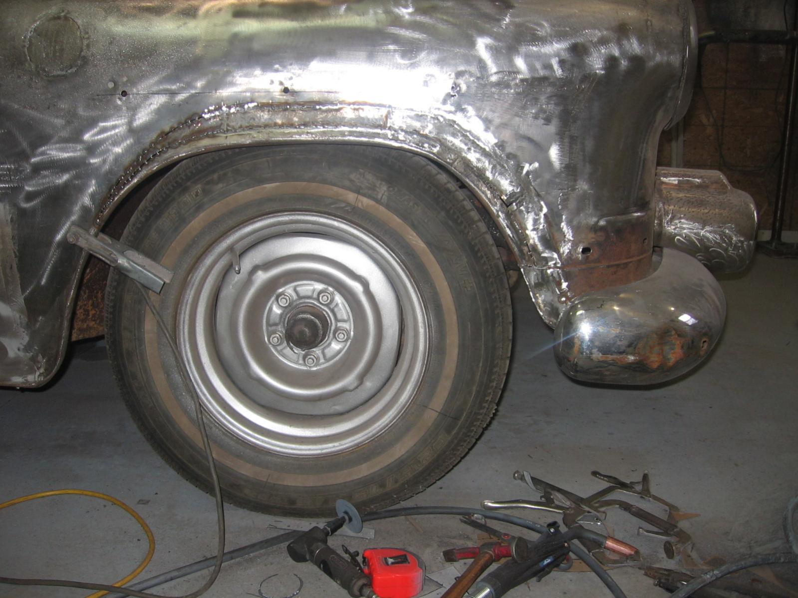

    Got a couple hours on the Buick tonight . Started on the front fender reshaping . Have a look . I think it will look better than before once all the new metal is in place . Later !

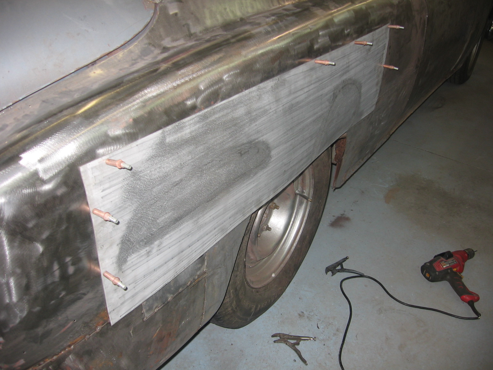

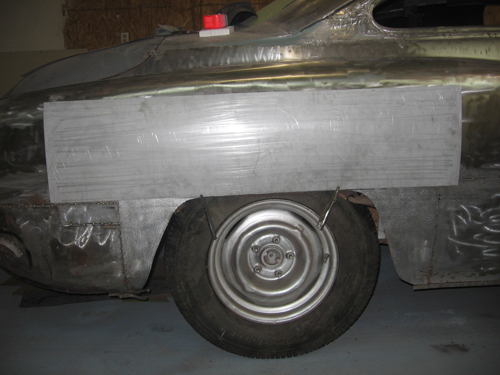

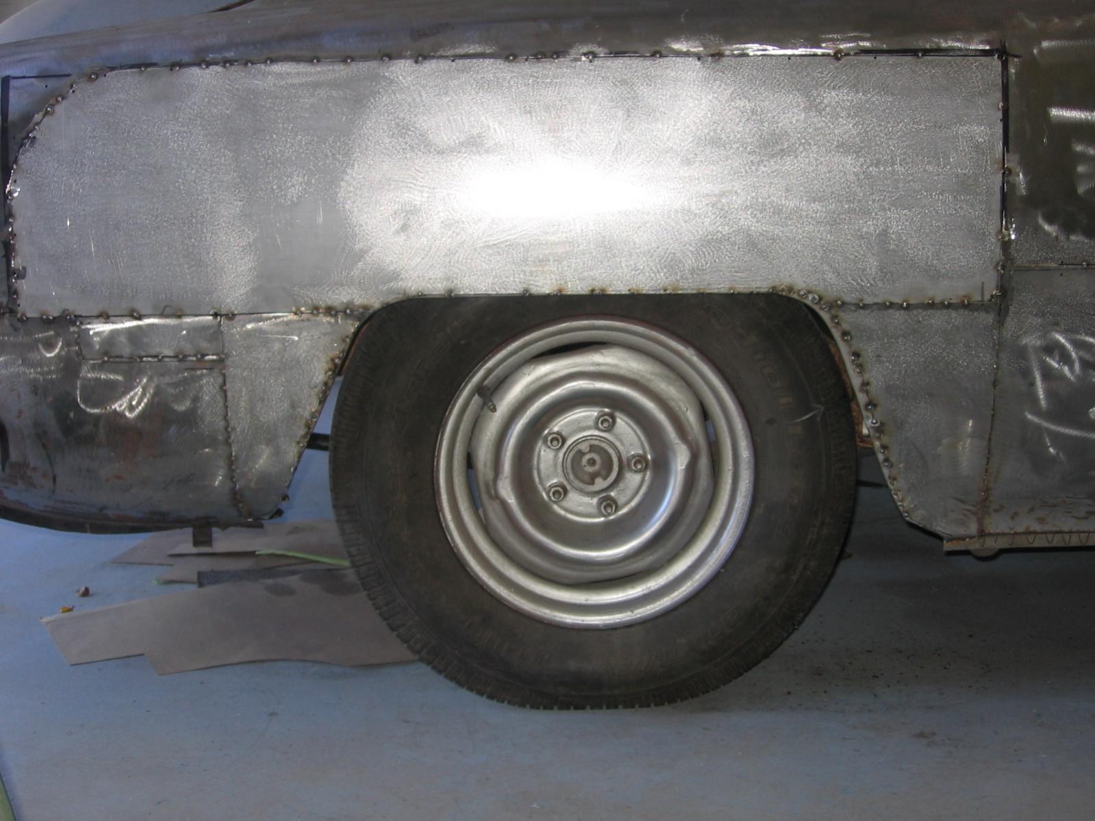

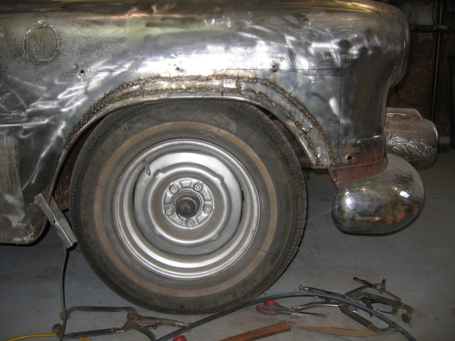

    Got some more done on the fender . Still some welding / grinding to do but that's all for now . Moved onto another section of the car . I am shaping up a new quarter panel panel as the old one I made had a joint in the middle and it had shrunk and buckled with the work on the roof months ago .:mad:

    Quarter panel pictures

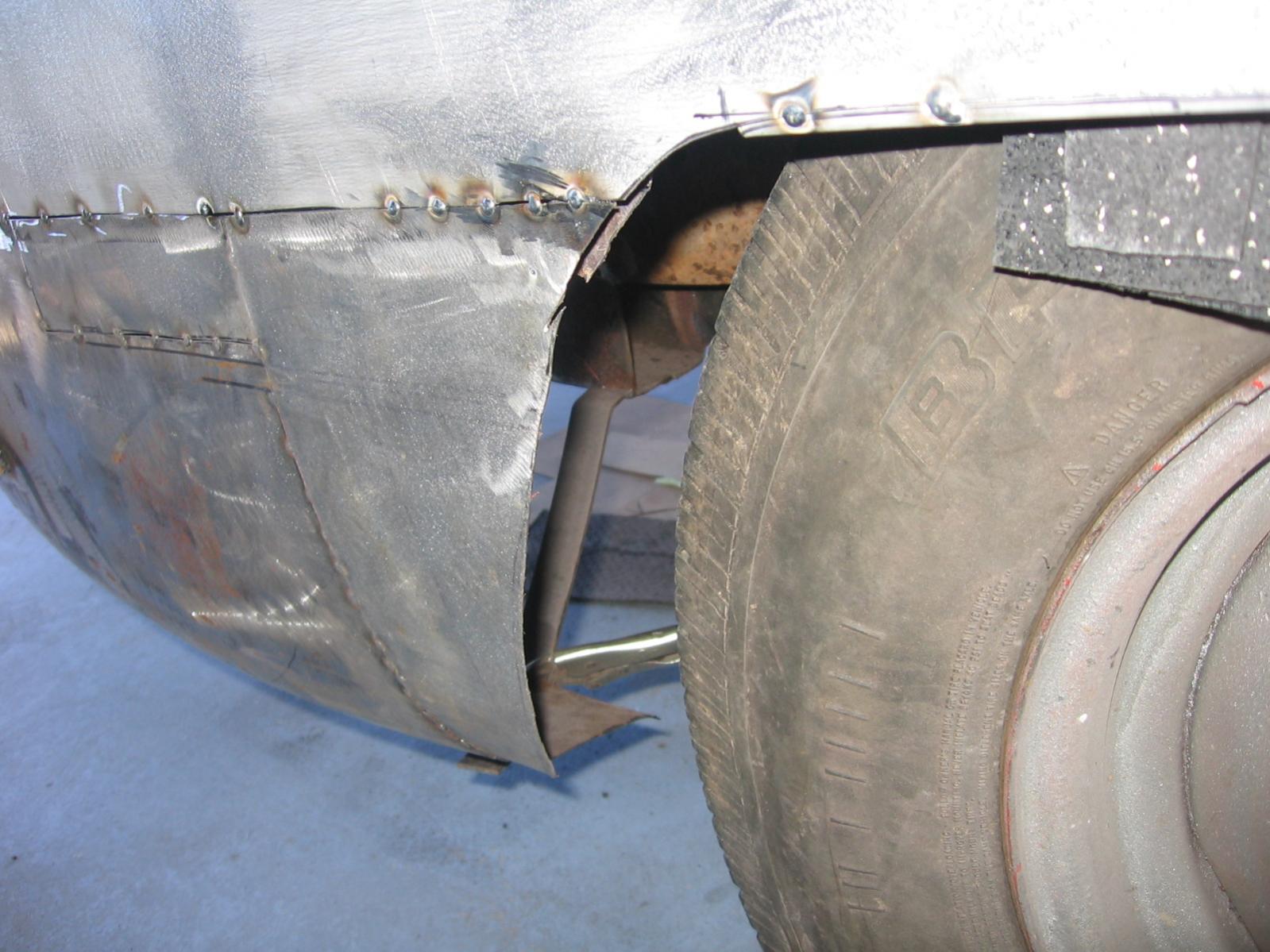

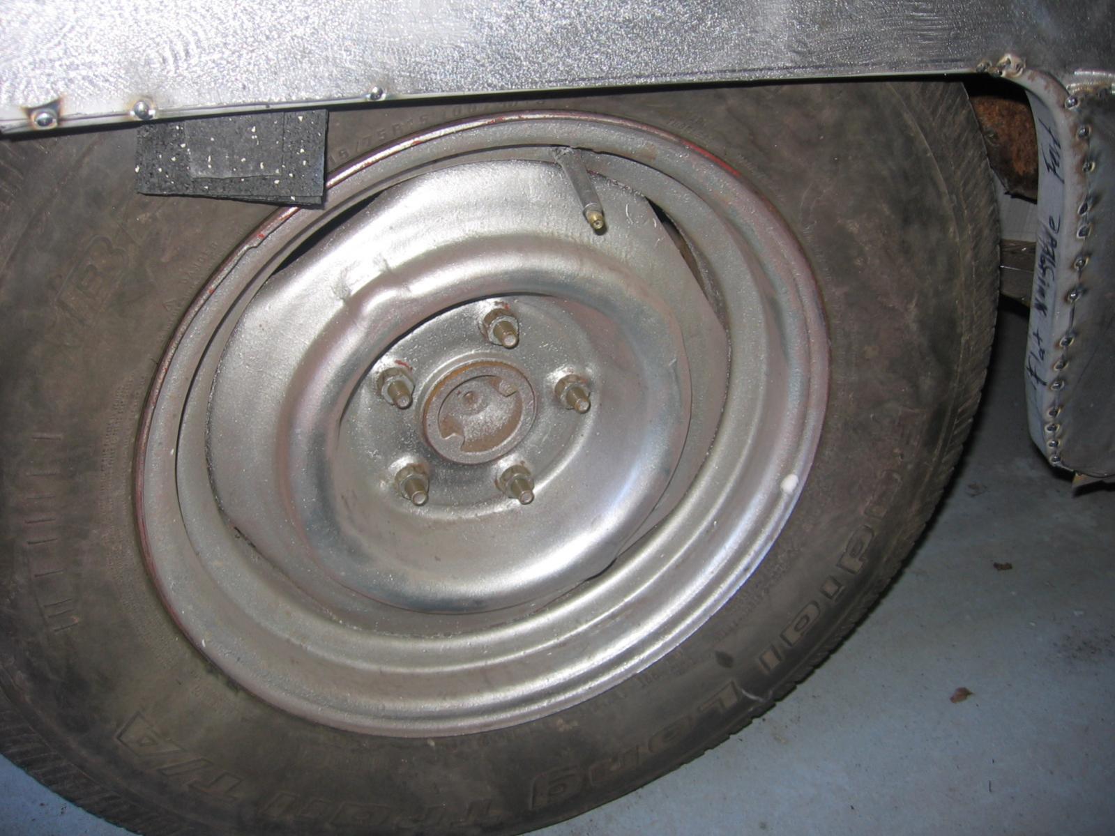

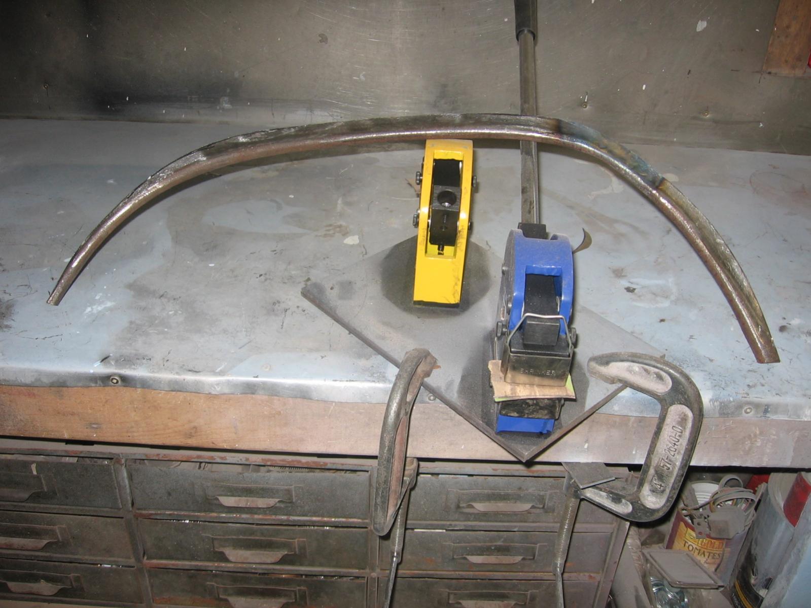

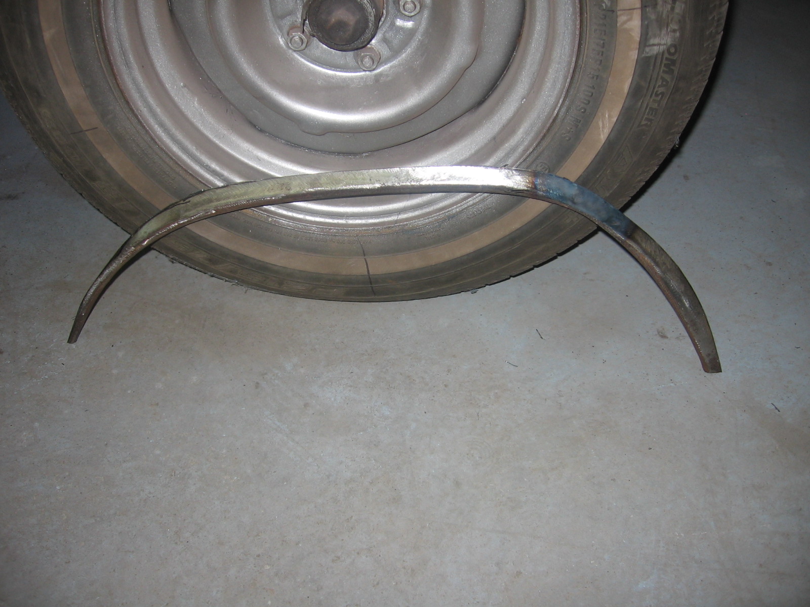

    Starting to get the hang of the shrinker stretcher that I bought a while back . Bent up new fender lip . It sure did add some shape to the quarter panel . It now holds some shape to it . I wll be able to fine tune the panel once the body goes on rotisserie . When that happens I will be able to tie in the fender lip with the outer wheel house . I am pleased for now . Lots of welding and grinding ahead of me now . :D That's the fun stuff ,, isn't it ? Andy...

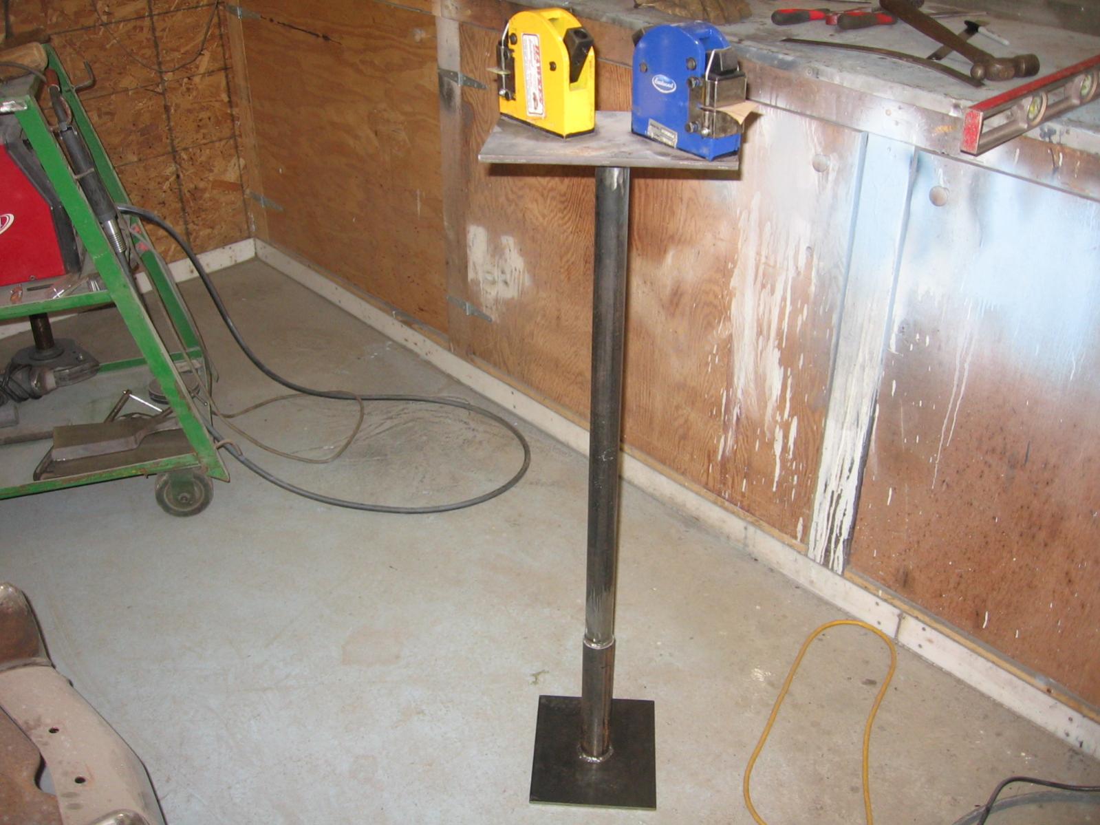

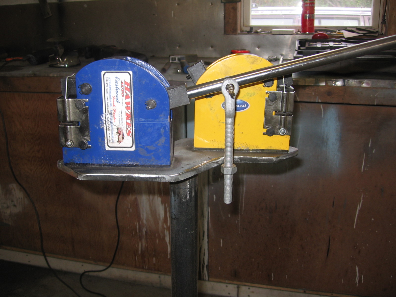

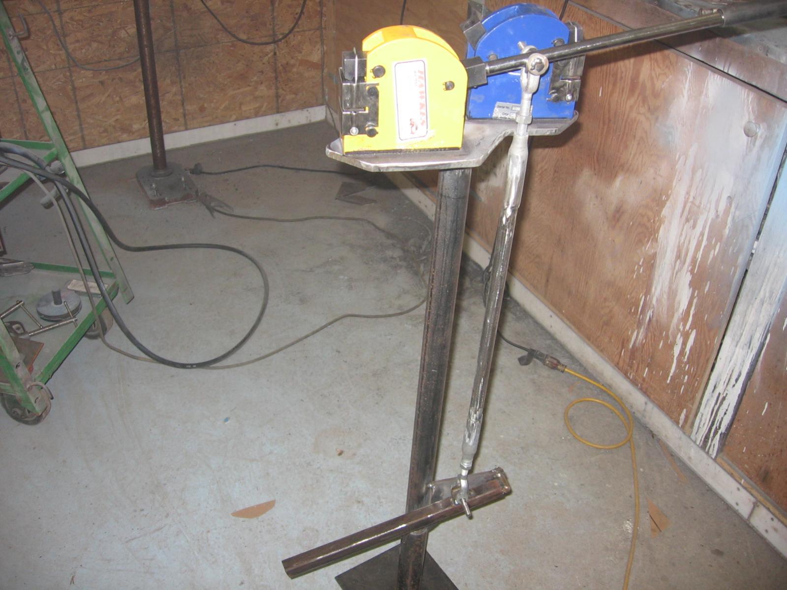

    Thank you gentlemen for the encouragement . I am in the process of building my shrinker / stretcher stand then I will get back on the Buick . Got to have a stand so I can apply foot pressure and manipulate the work piece as well . If your interested I can upload some pics of the process !! Maybe in a new thread !! we'll see . Andy..

    Nice to see your thread alive again.The shrinker/stretcher purchase was a wise move,it makes your life a lot easier.
    I dont know have you seen this,but i made a shrinker/stretcher stand:
    http://www.jalopyjournal.com/forum/showthread.php?t=622910
    It still works great,just used it at yesterday.

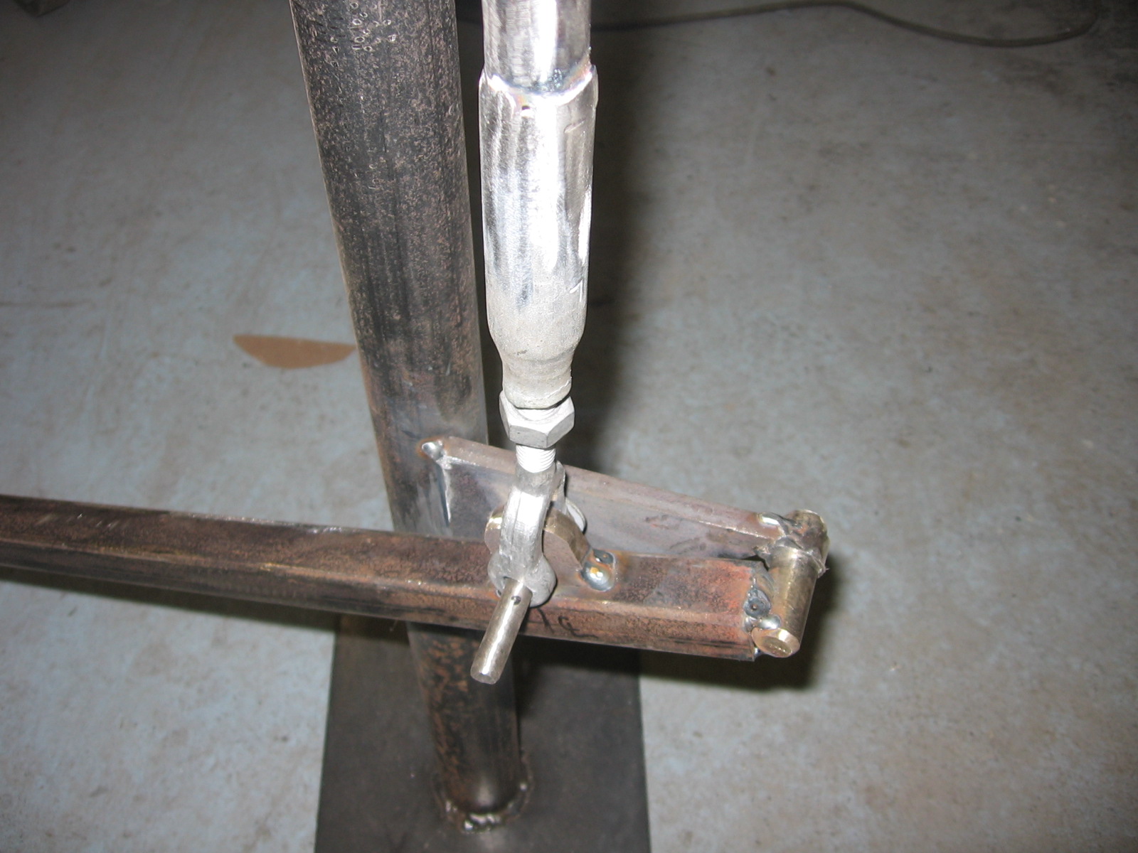

    I seen your thread on your shrinker / stretcher stand Antti . Excellent work . I don't have the abilities and access you have , lucky guy . This is what I came up with so far anyways . I still need some springs and to pull the foot pedal up . Have a look so far . Maybe I will even be so **** as to paint it !!
