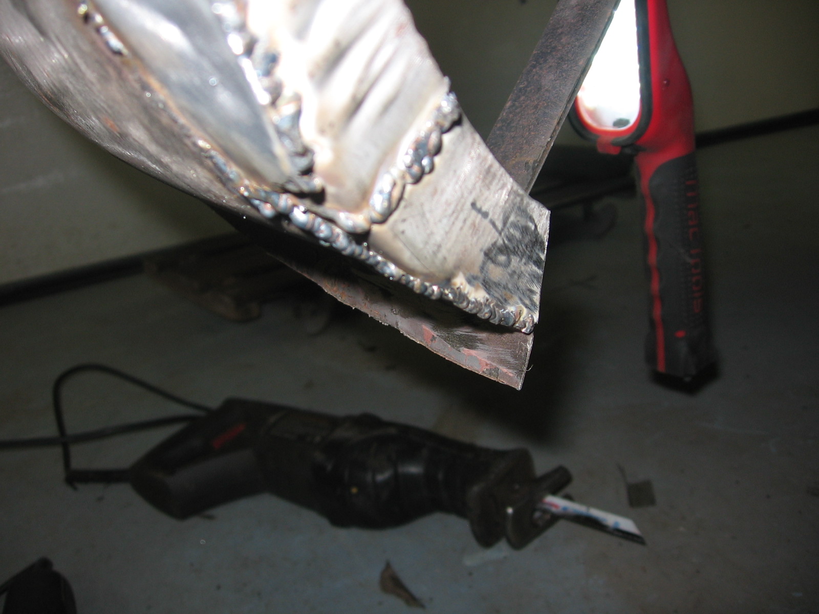

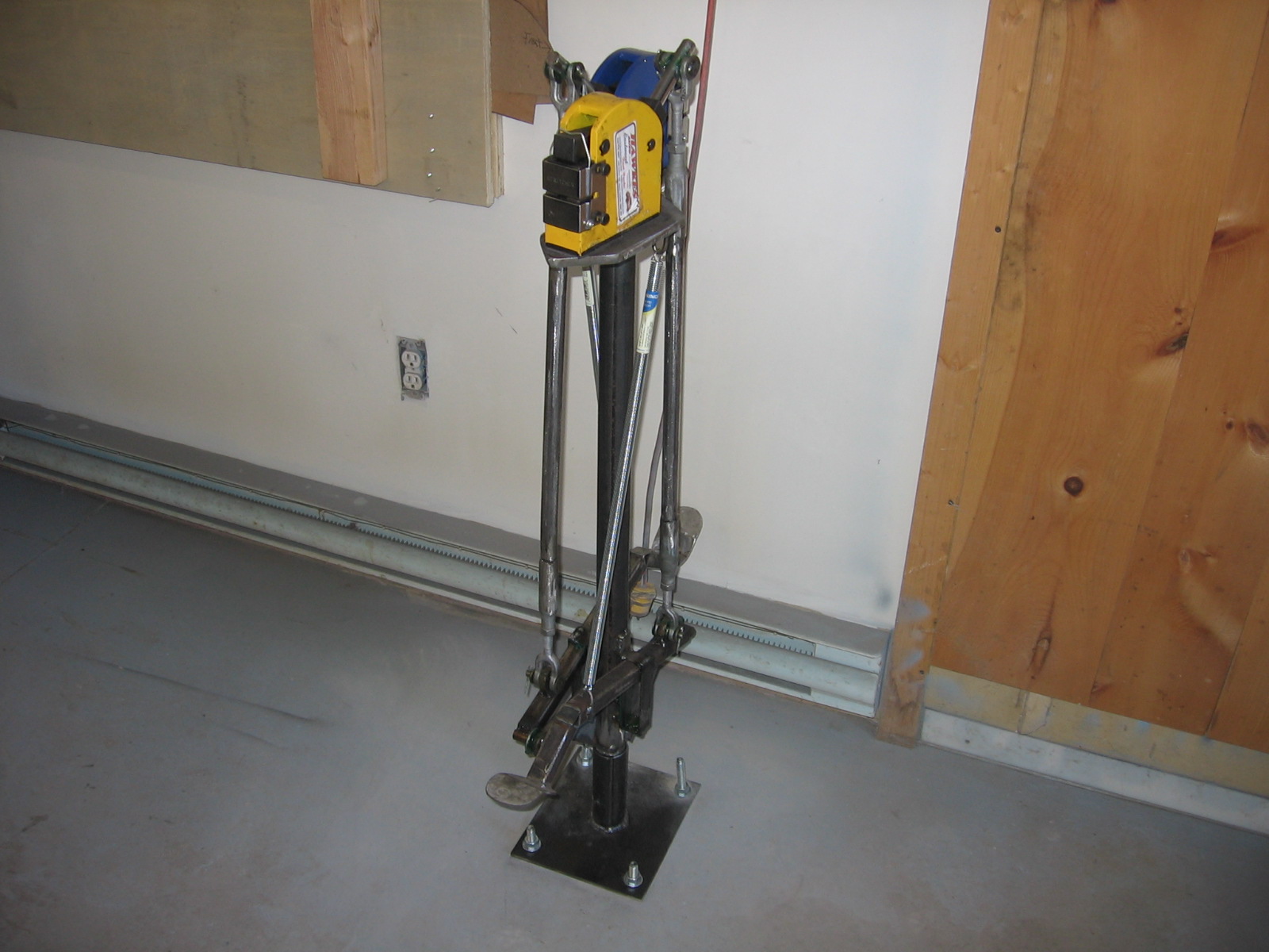

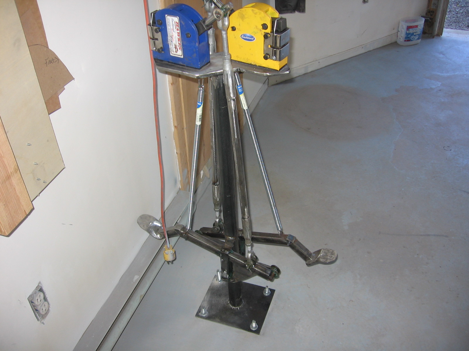

    Well finished the shrinker and stretcher stand . I made it so it turns 360 degrees so you can shrink or stretch . It takes up less space this way . Now I can get back to work on the Buick , maybe . A job just came into my shop . An off topic beemer came in with a large gash in the rocker panel . Some quick money for a relatively fast job . Andy..

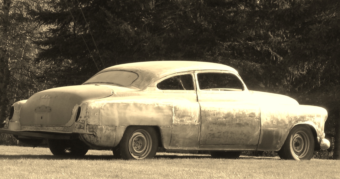

    Here's my 52 special. The drivers compartment floor boards are shot like yours.the trunk is solid, even the spare tire well. Aside from a few small areas that will need patch work on the exterior.the car is pretty solid. I got it back in August of this yr. It came from Alaska.

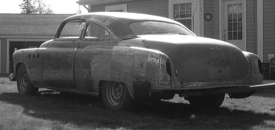

    Nice...really nice. Your first attempt had a hump at the rear, and that's ok if your a female..lol.but in all honesty, didn't flow right.
    You buford came a long ways and its looking mighty fine.keep up the great craftman ship.
    You re-chop looks superb. Esoteric!

    Yea the hump had to go . There was no flow at all and the sailpanel was way to fat . Thanks for the comments . Whats the plans for you ? Chop ?

    I love what you did with the shrinker/stretcher stand! So much better than what you can buy!
  17. Oh! By the way, how thick steel did you use for the tool mounting plate on your stand?
  18. aw1950
    Joined: Dec 21, 2008
    Posts: 1,511
    aw1950
    Thanks for the positive approval Kuztom . I used 3/8 or 10mm as the mounting plate for the shrinker / stretcher . Probably overkill but that's what was at the local metal supply house in the scrap section at the time. Definately wont flex under usage that's for sure .:D

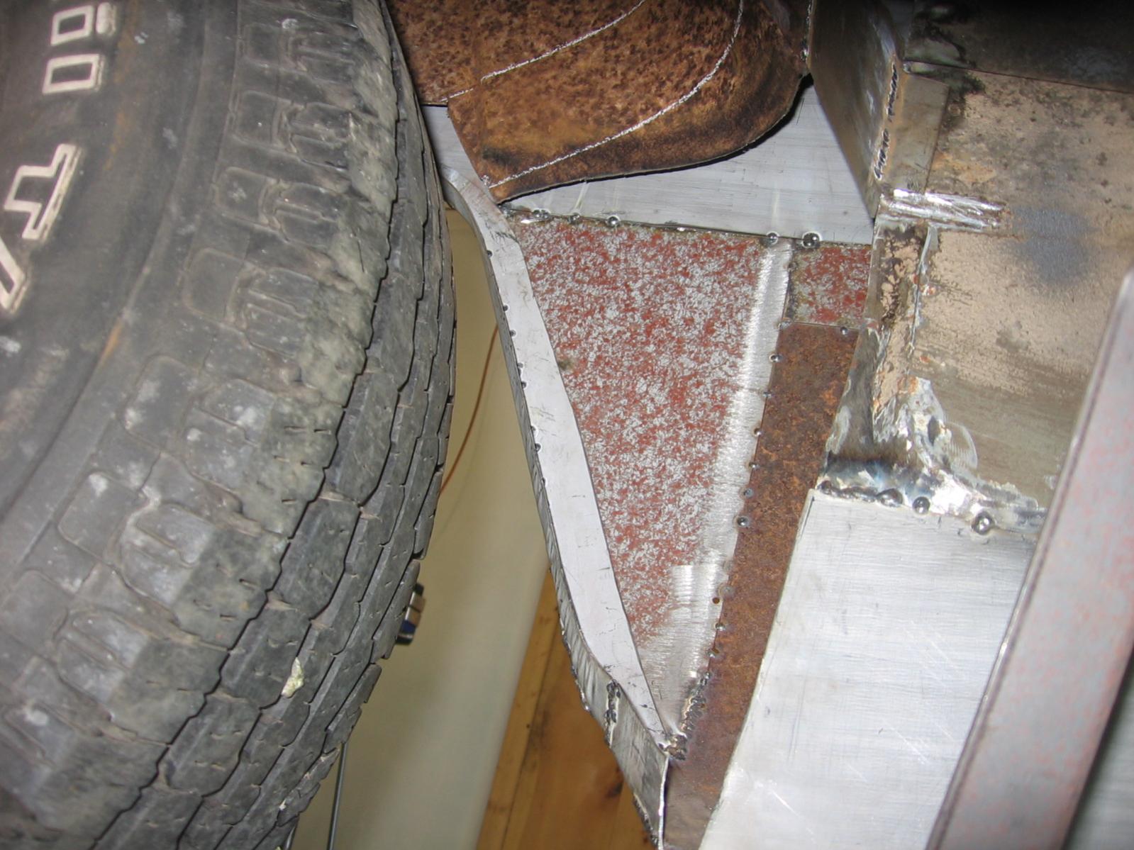

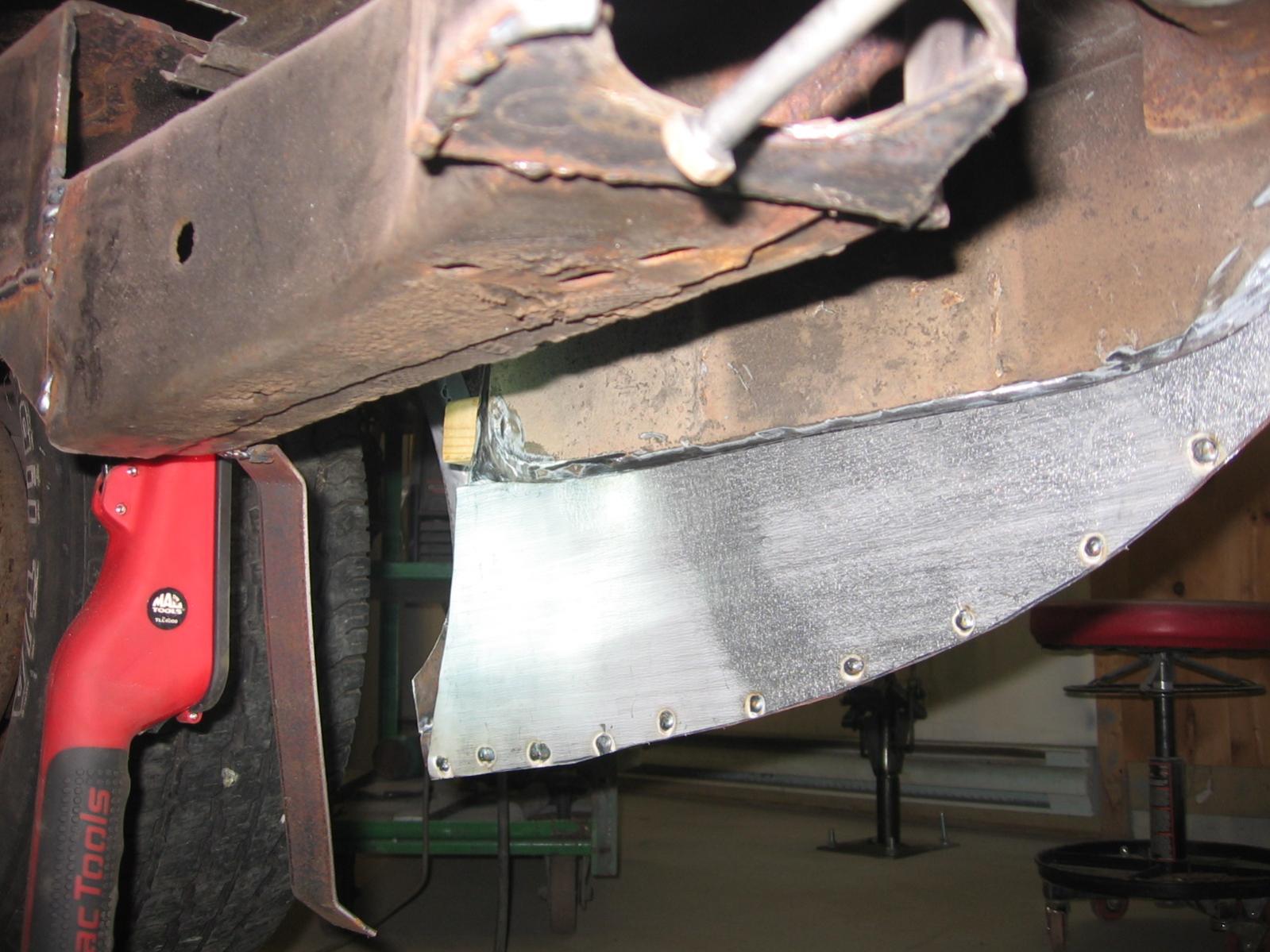

    Well here is all I could squeeze out for accomplishment on my week of holidays . My plow truck ate up most of my time last week .Winters coming :eek: . Anyway as I said before progress is progress . Started to tie in the quarter panel with the trunk drop off . I removed 3/4 of an inch of the old OT :rolleyes: trunk floor drop then made up this here extension piece . Also finished a short extension to finish off the quarter panel lip . 2 1/2 hours later and its time to pack it in . 2 1/2 hours in 10 days off !! WTF !!:mad: PS Got a little artsy fartsy with the computer program . I like these black and whites !!

    Well this stuff takes time , Inner wheel well . Right rear . 4 hours to make a panel 16" X 12" . Made the main filler panel then 2 other panels welded to the main panel to make the complete inner wheel well panel . The shrinker and stretcher is the ticket on stuff like this . I had to replicate the wheel arch lip so I could have a flange to plug weld to . That replicated arch is welded to my main panel and will be then plug welded to the quarterpanel wheelwell lip . First picture is the hole that needs repaired and the second , well it speaks for itself . Clamped for now maybe welded in tomorrow. This sure is starting to strengthen the quarter panel area that's for sure . Andy..
