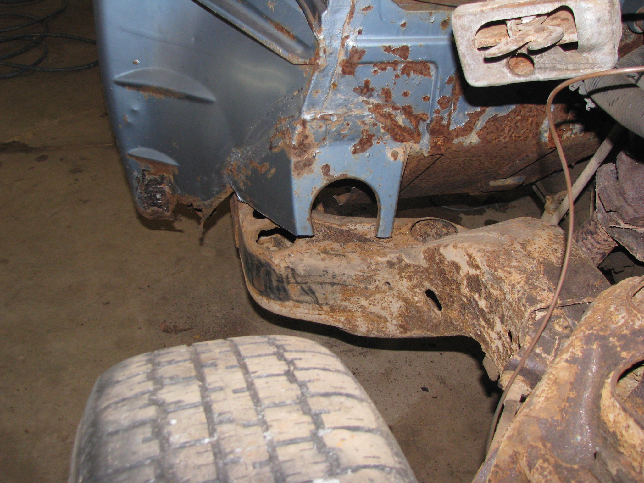

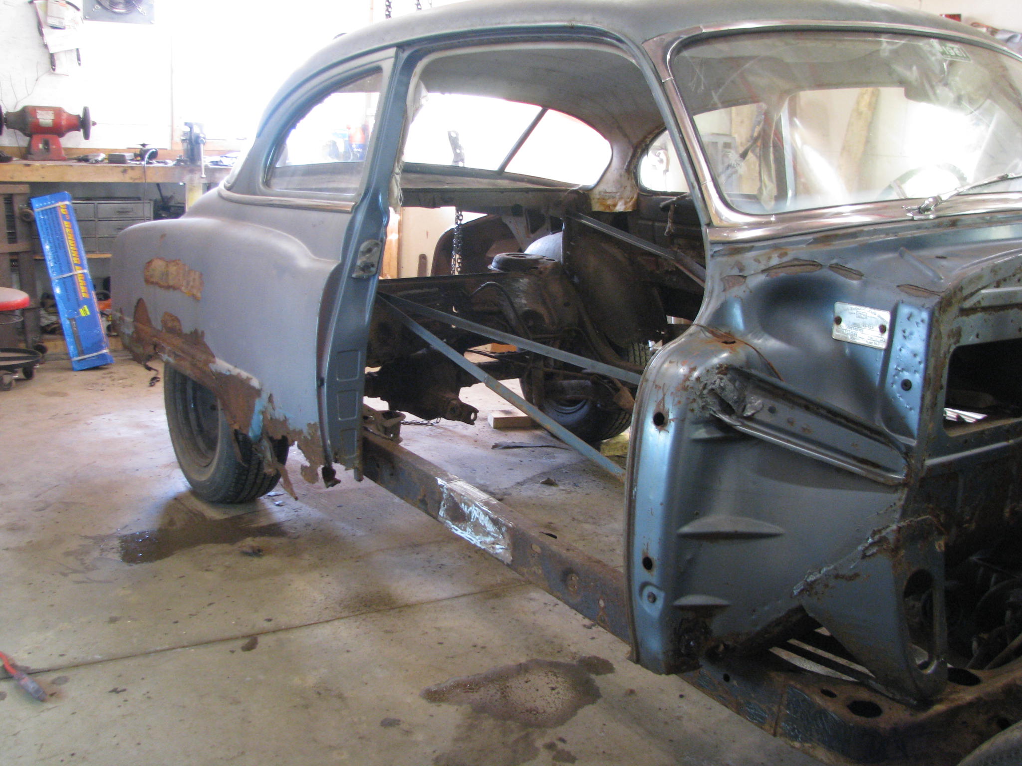

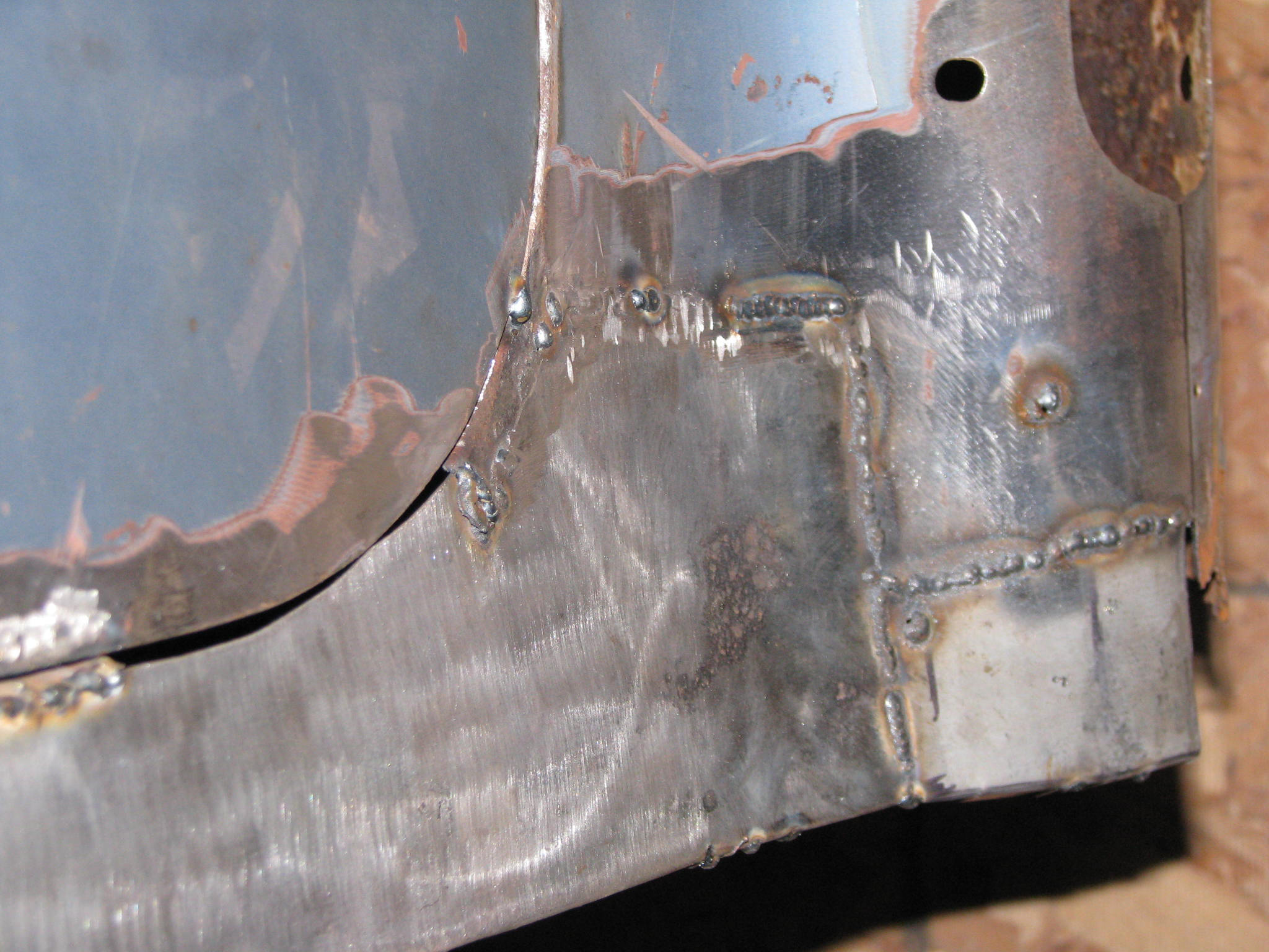

    At it again today . I had to cut out the remanants of the rear floor . I seperated the complete trunk from the wheelwells. I had to find centerline of the frame and of the body as well . Leveled the frame and made more measurments . I determined that 5 Inches out of the front bodymount would suffice but looking at it now I think that I will be putting a couple inches back in . I had to hang a front fender to get the wheelwell openings close enough . I can tweak them if need be . Remember I have to make my own rear quaters and I can adjust them as I need them . An inch front or back wont be hard to makeup . I ll post more in a few minutes . Stay tuned LOL!!

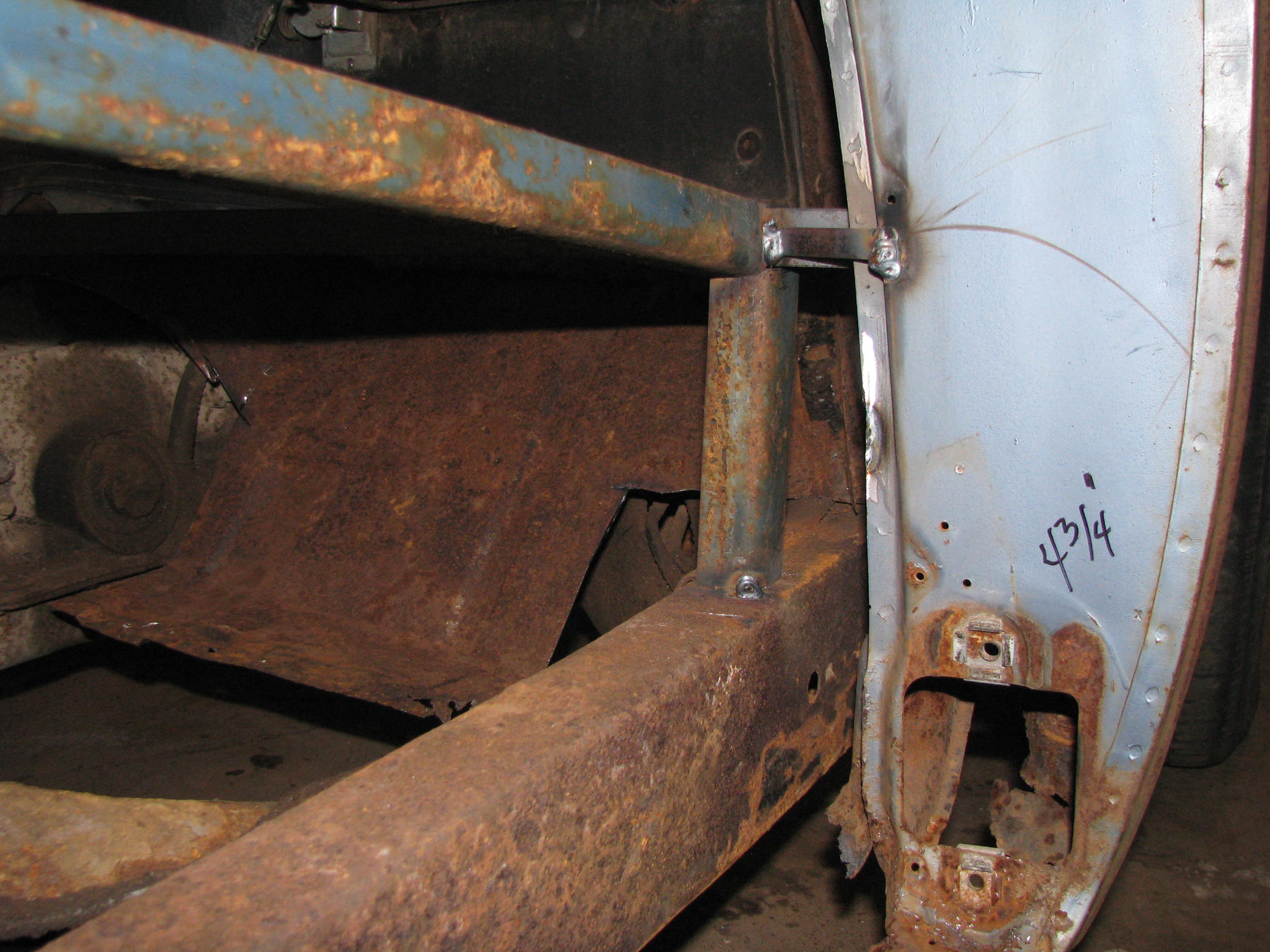

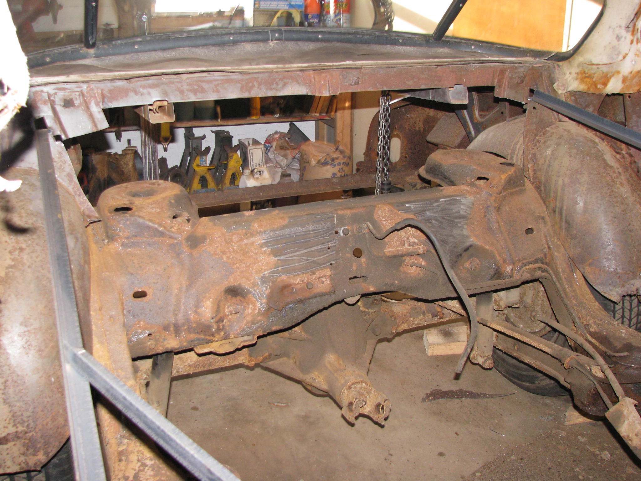

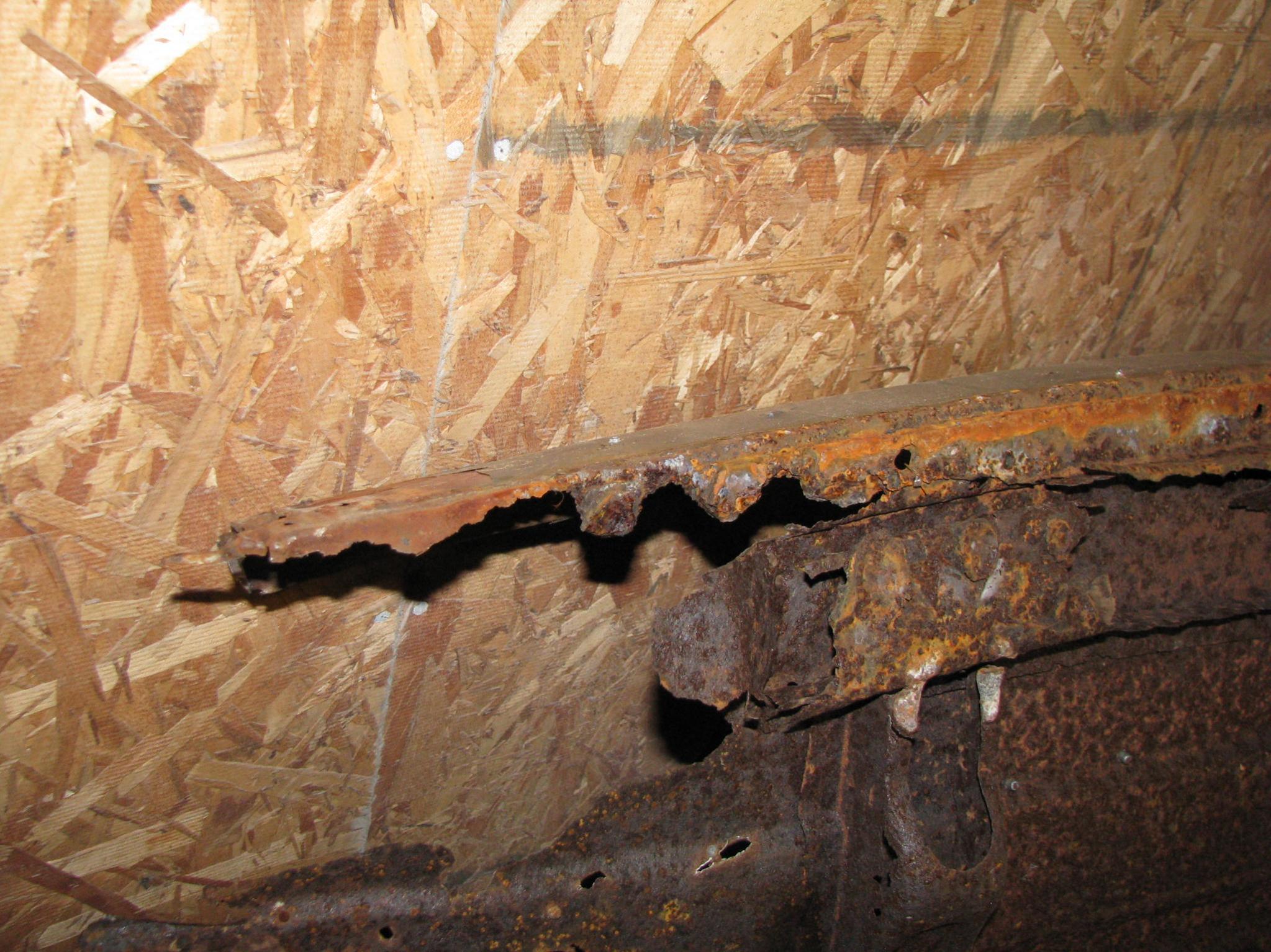

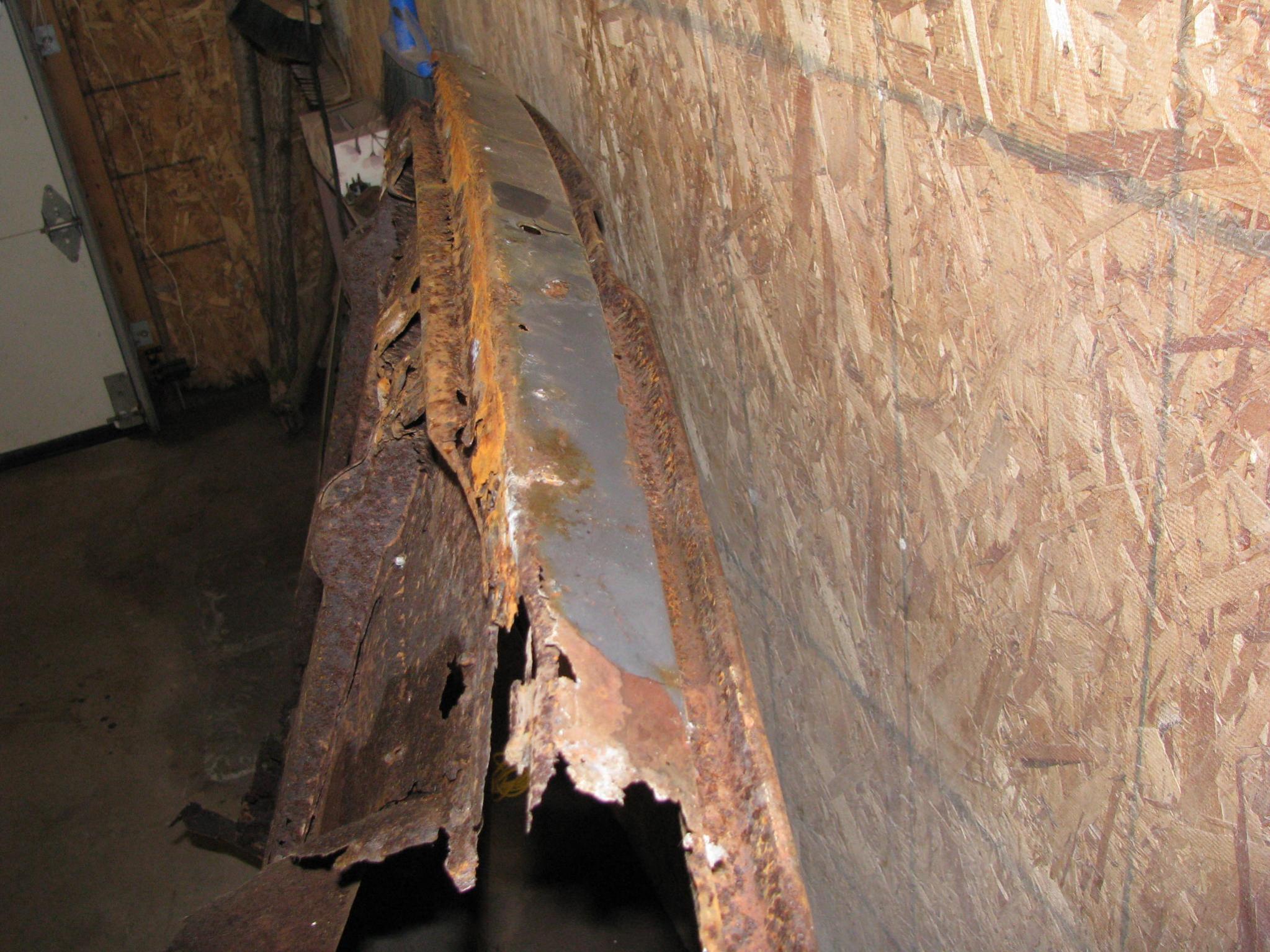

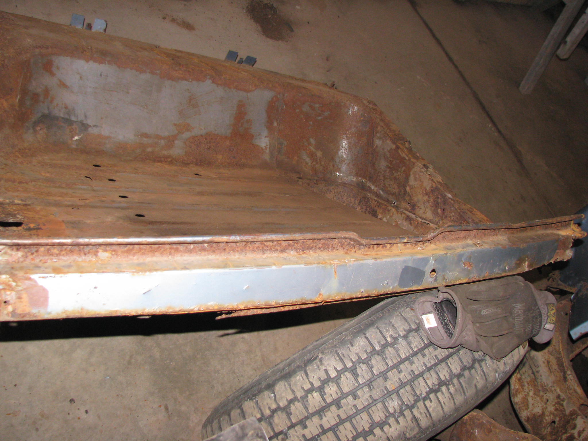

    So heres a few more pics. Whats left of the rear floorpan . Whew ! this thing was rusty . It only has to get better from here on in . One picture shows one of the legs that is supporting the body at the 5 inch mark . As I said I am going to have to add at least 2 inches to the height . Have a look :rolleyes: Hows that for centered and leveled ? Do you think that even todays cars are this close ??? I wonder !! Later , Andy...

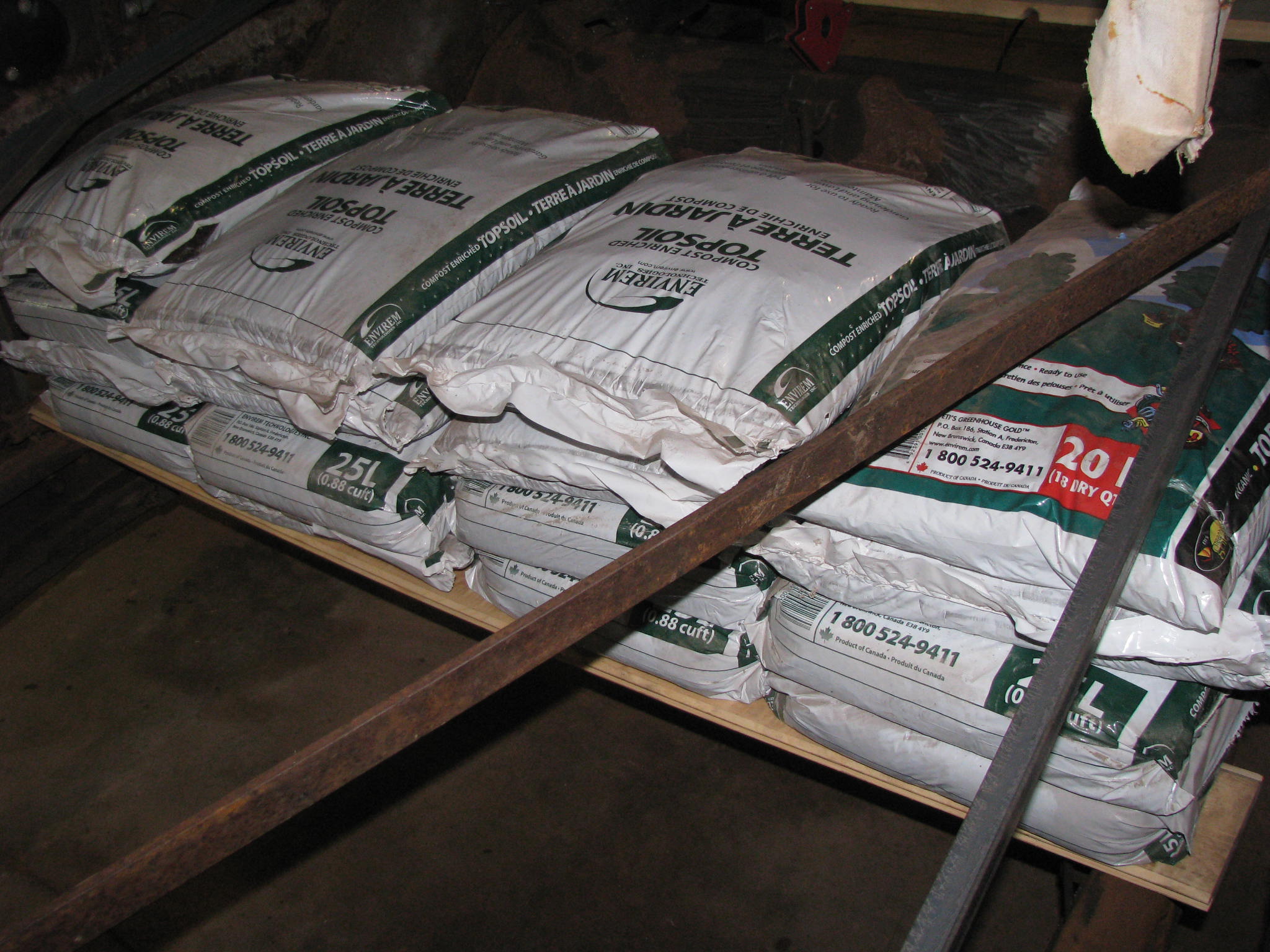

    Looking good. Are those bags of salt in the garage?
  6. koolkemp
    Joined: May 7, 2004
    Posts: 6,006
    koolkemp
    Probably dirt...too thin and flat to be bags of salt...ask me how I know lol :rolleyes:

    Brerhair , Kool Kemp was right , bags of topsoil but while they are in the garage I am going to use them to replicate a full tank of fuel ( 130 lbs. ) and floor panel weight. I would hate to set up everything , put all the floors back in and it then sit to low , that would surely piss me off as it would anybody right ? Thanks DVS things will be moving right along for the next week or two and then I am told by the wife get to the basement you troll and finish that room you started !! Damn, LOL ! Posts wont be as often unless building a bedroom in a basement is Hamb friendly LOL !!

    Update for today, I moved about 200 lbs of bagged soil to replicate weight back on the suspension . The suspension squated about 1 5/8 " in the rear . Better to do this now than later . Next pic is the amount I could set the engine back . I think I can gain the 5.5" back in the driveline . This will save $300.00 to have a driveshaft made .:) Its all about getting things done for as little $$$ as possible . 3rd pic is the increase of 2in" in the body stanchions . The body was channeled to much and by the time the front fenders would have went on the tops would only be 24 inches off the ground . To low !! It would not steer without hitting the fenders .

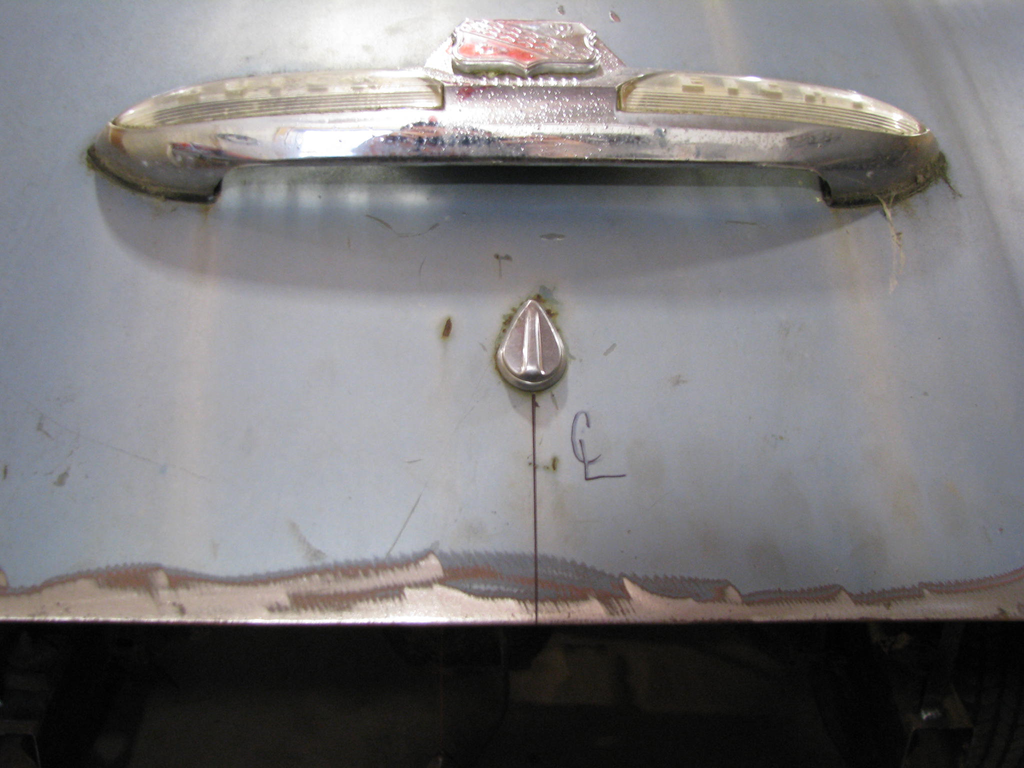

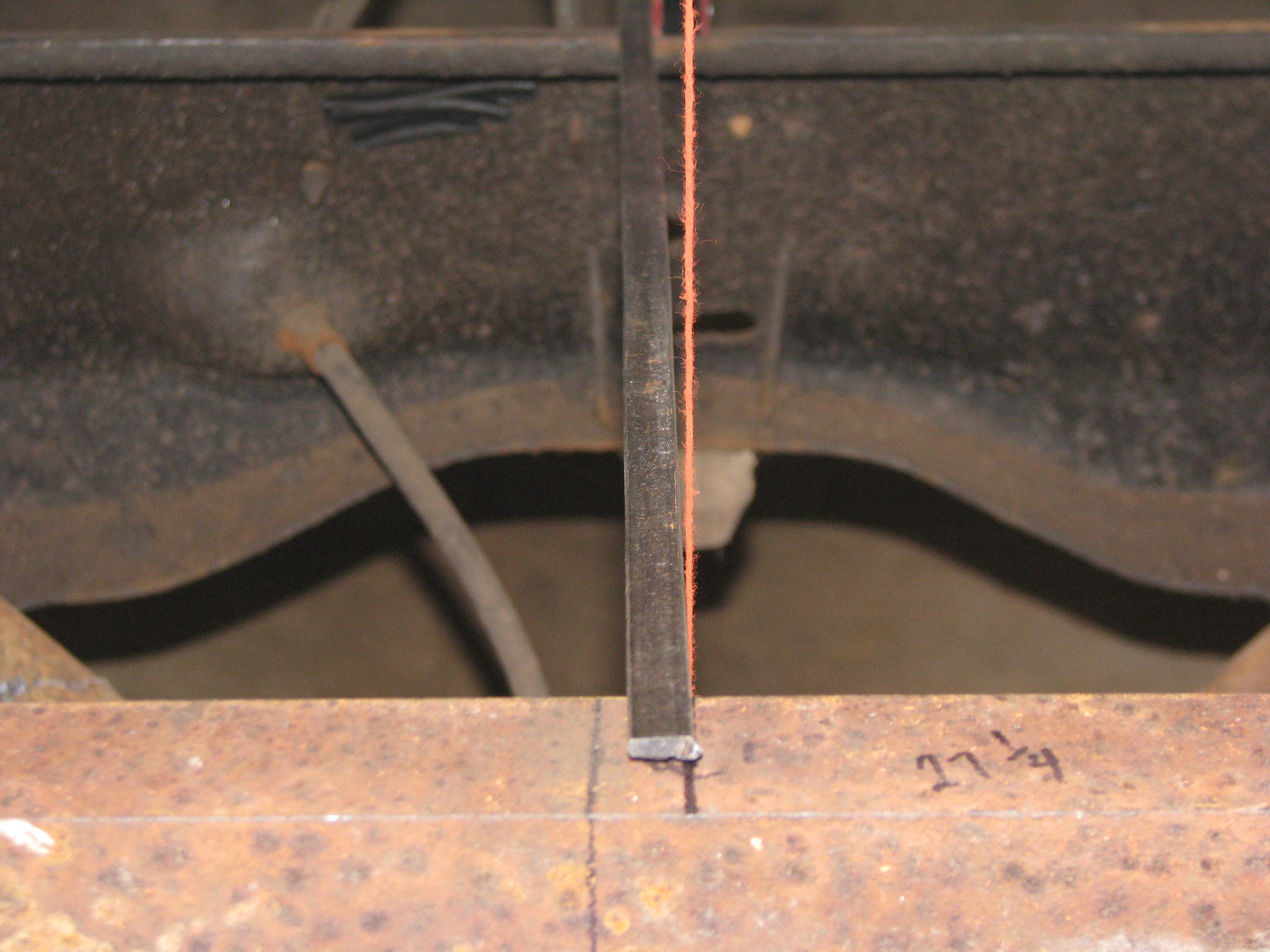

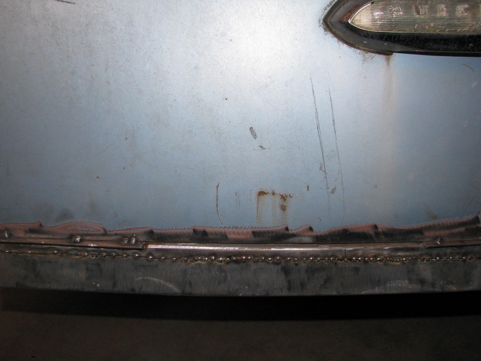

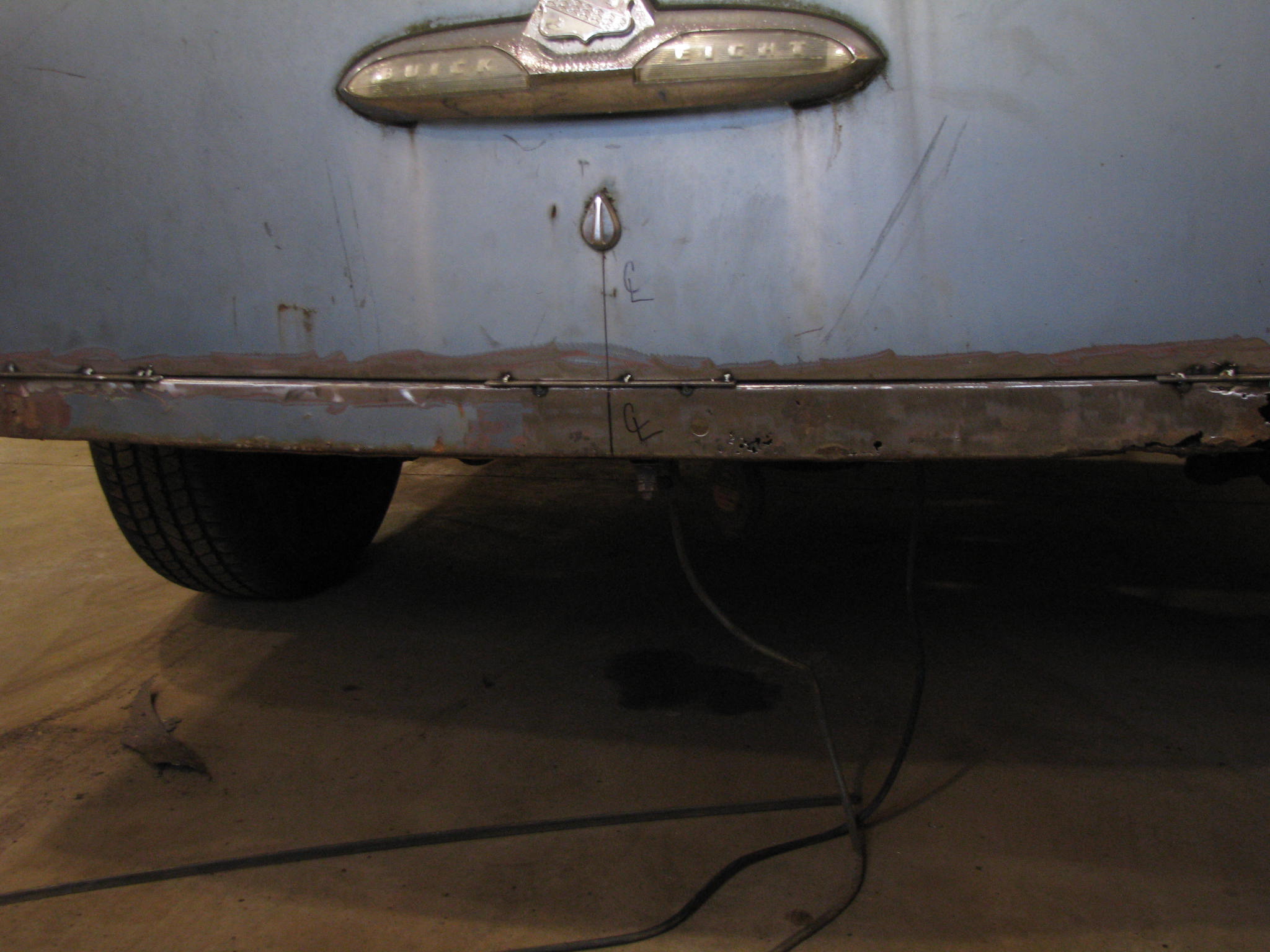

    Small progress .First found the centerline of the trunk . Started to tie the back of the car together. I took some 1/8 flatbar and tacked it to the bottom edge of the trunklid and then tacked the rear tailpan to the flatbar . This will give me a 1/8 gap at the bottom edge of the trunklid . When the new trunkseal goes on it will widen I am sure by another 1/8 at least . Should be just about right . Made a rough pattern and then clamped in place . Have to go now we just got 8" of fresh snow to clear from the yard . Damn :mad: !!!

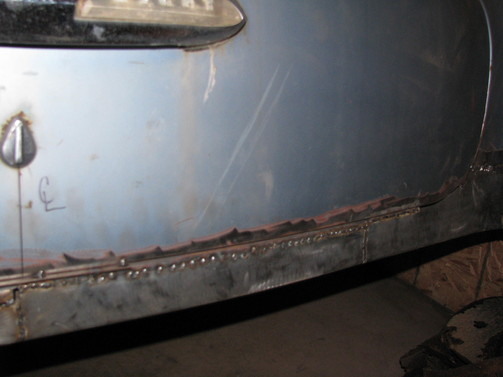

    Just a little update . Got out in the garage at 7:00 AM this morning . 5 hours later and this is the end result . This stuff takes time to get it right . A friend of mines father told me some time ago and I quote ( You fellas spend to much time trying to get all the gaps consistent . These cars weren't put together with that kind of precision ) After countless old car rebuilds I know what he means. Lots of work but well worth it in the end .1st picture is the patch installed from yesterday 2 & 3rd, the new tailpan section The last shows the driver side that is just as bad as the passenger side was . Each day a little progress and before you know it one of the many projects on this car done !!!

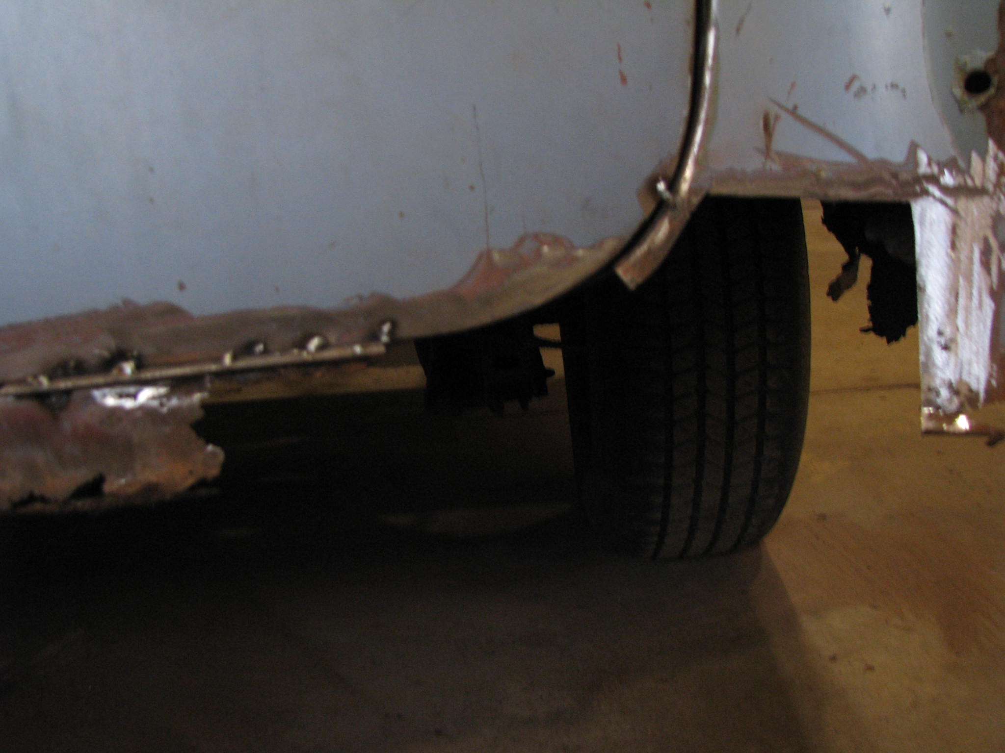

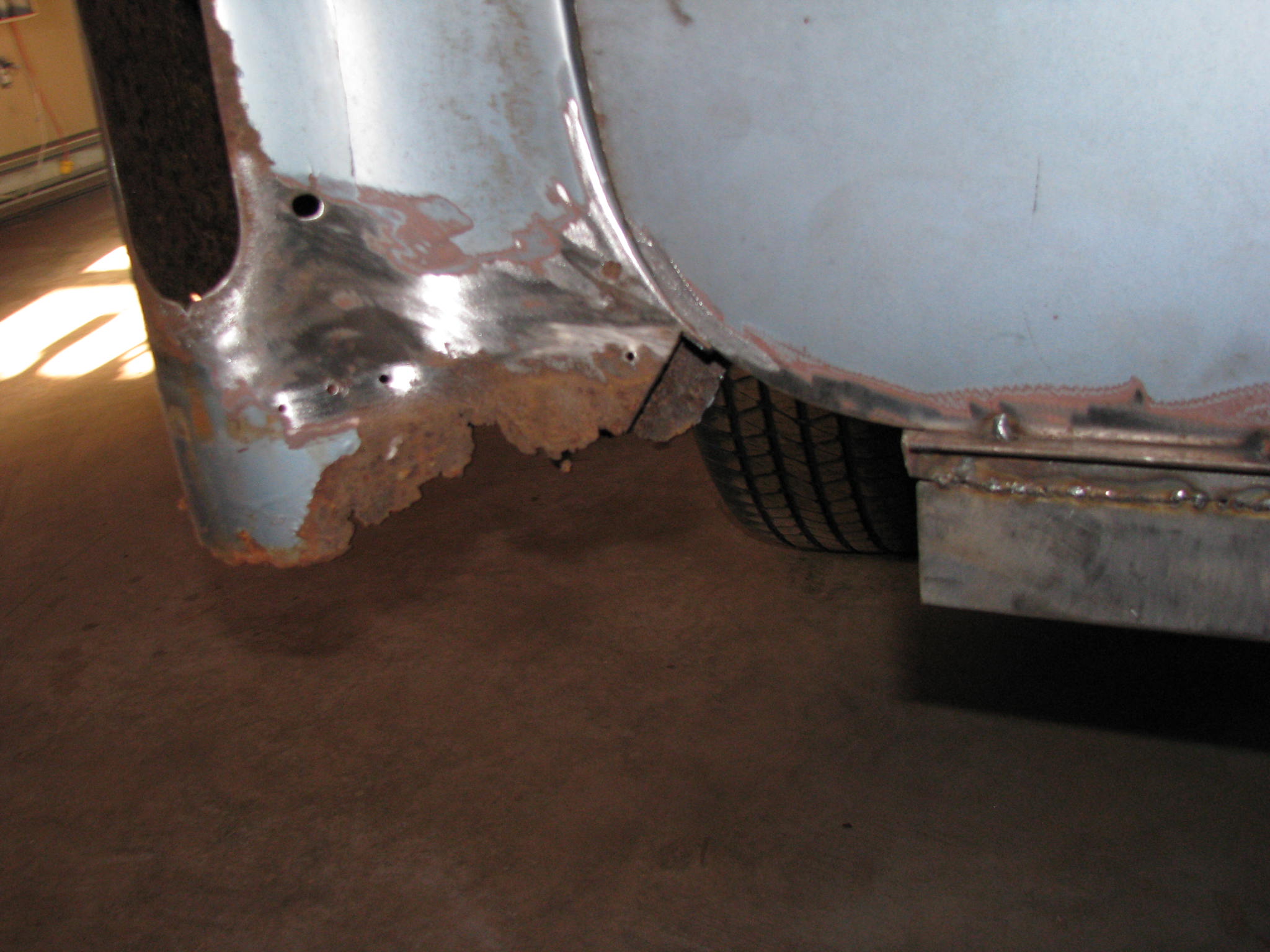

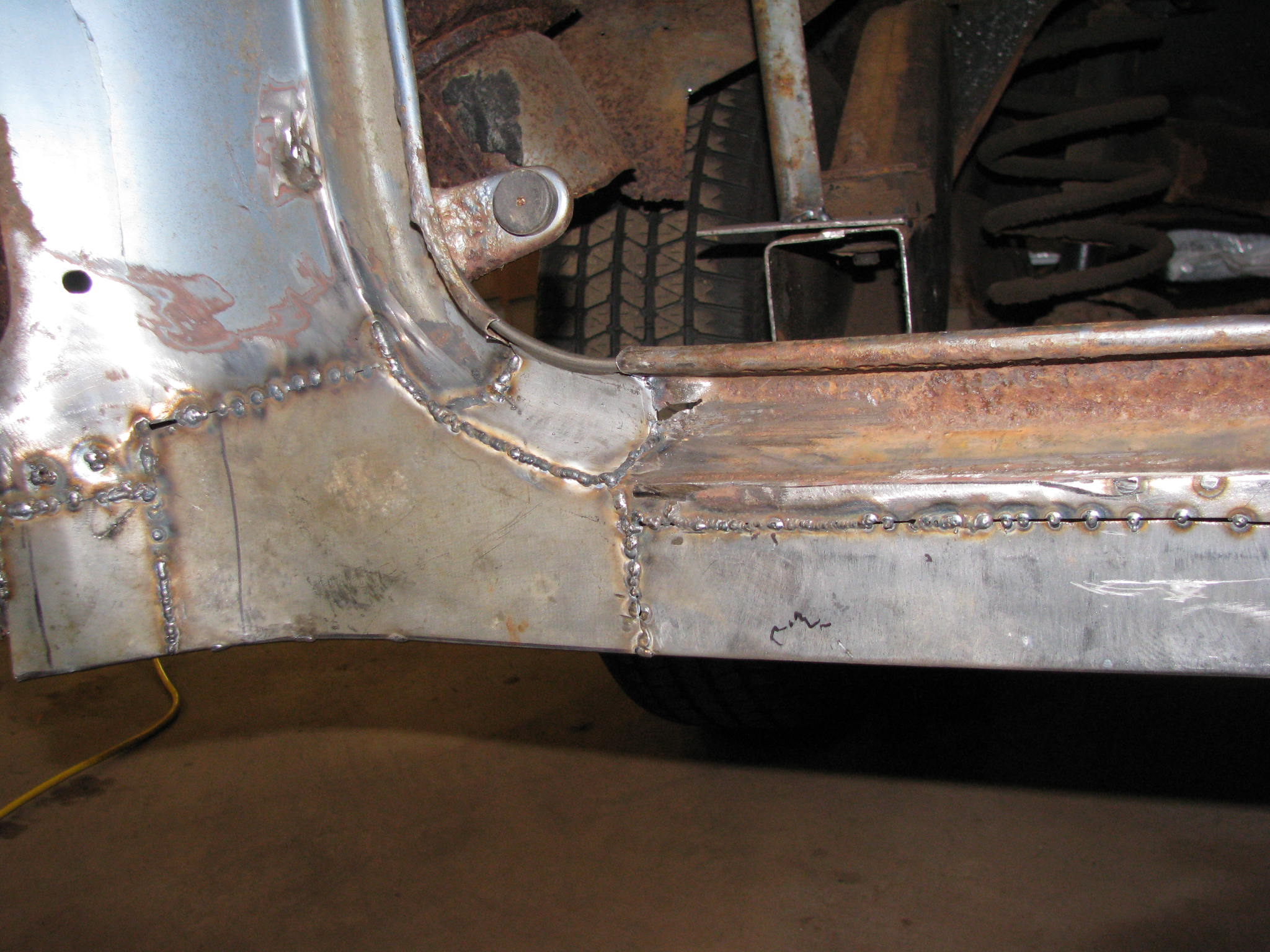

    More updates . Worked some more on the rear tailpan . It's tied from side to side now and braced somewhat . The repair panel on the drive side was in two pieces . Easier that way . Lots of welding and grinding to do yet though . The repair in the trunk channel was not to bad . Only about 15 mins to fix that . Last picture is of the rear with the trunk down and all the new metal . I know you all know what this feels like . The buick is on the road to recovery . :)

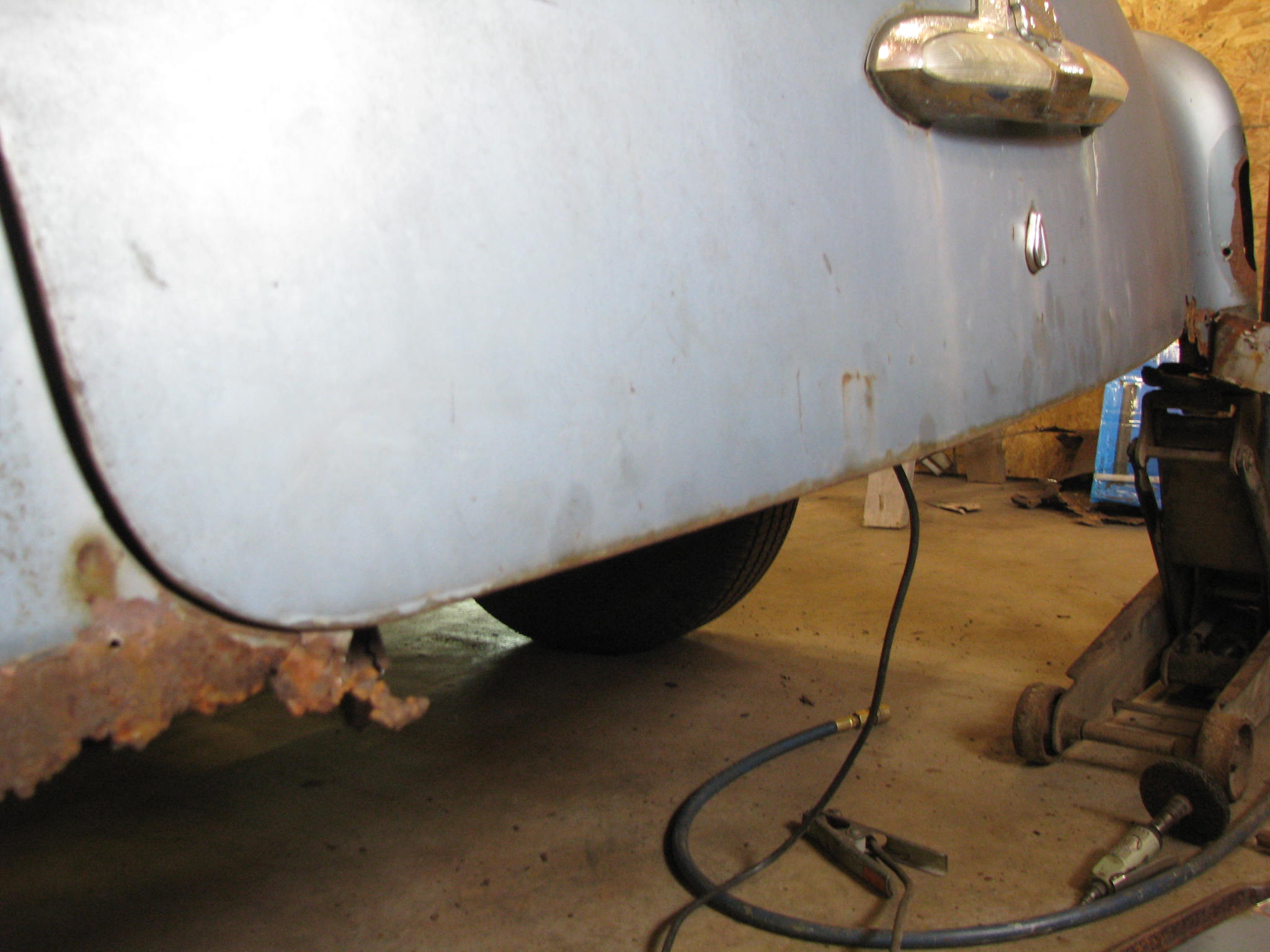

  25. aw1950
    Joined: Dec 21, 2008
    Posts: 1,511
    aw1950

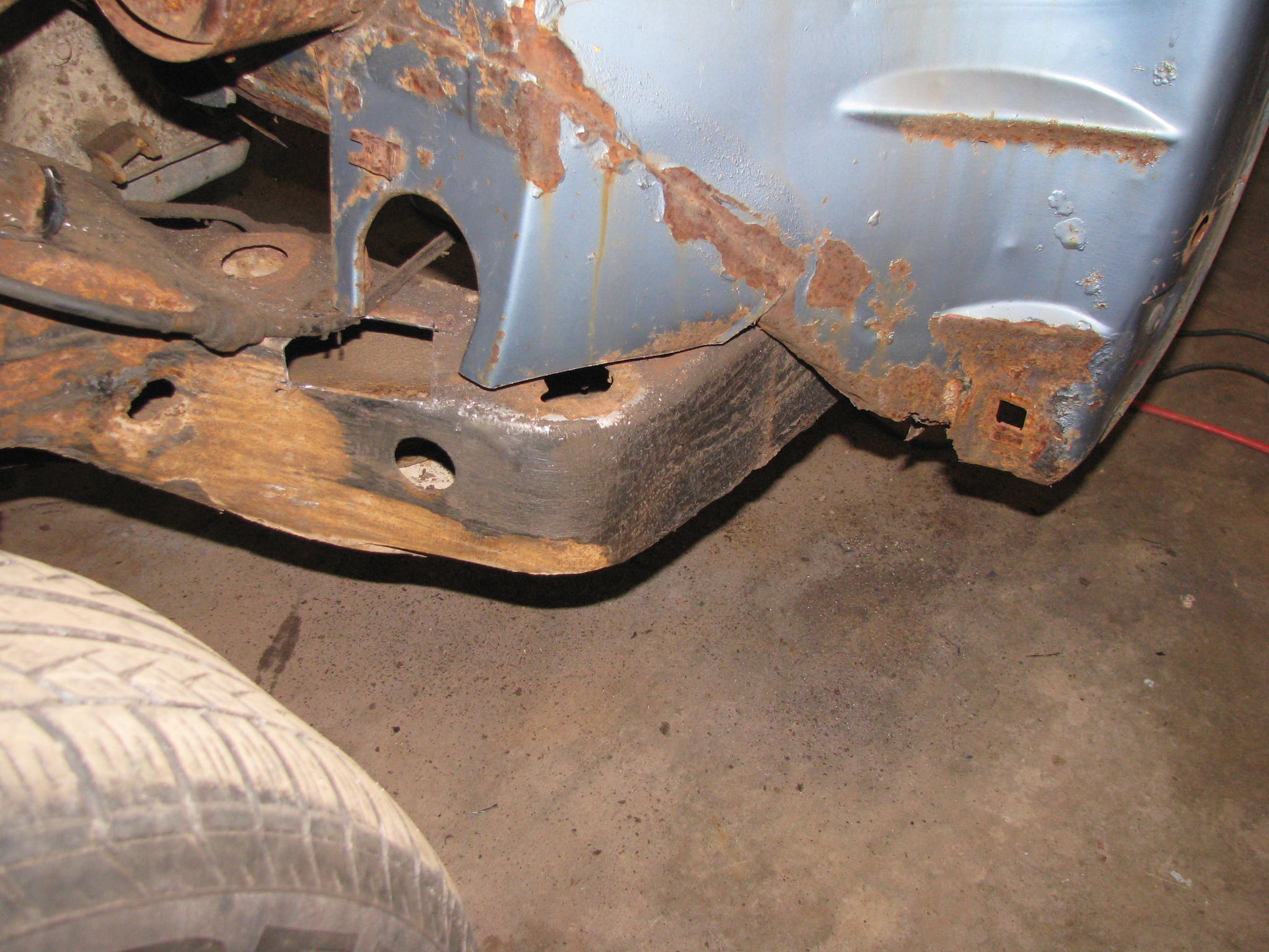

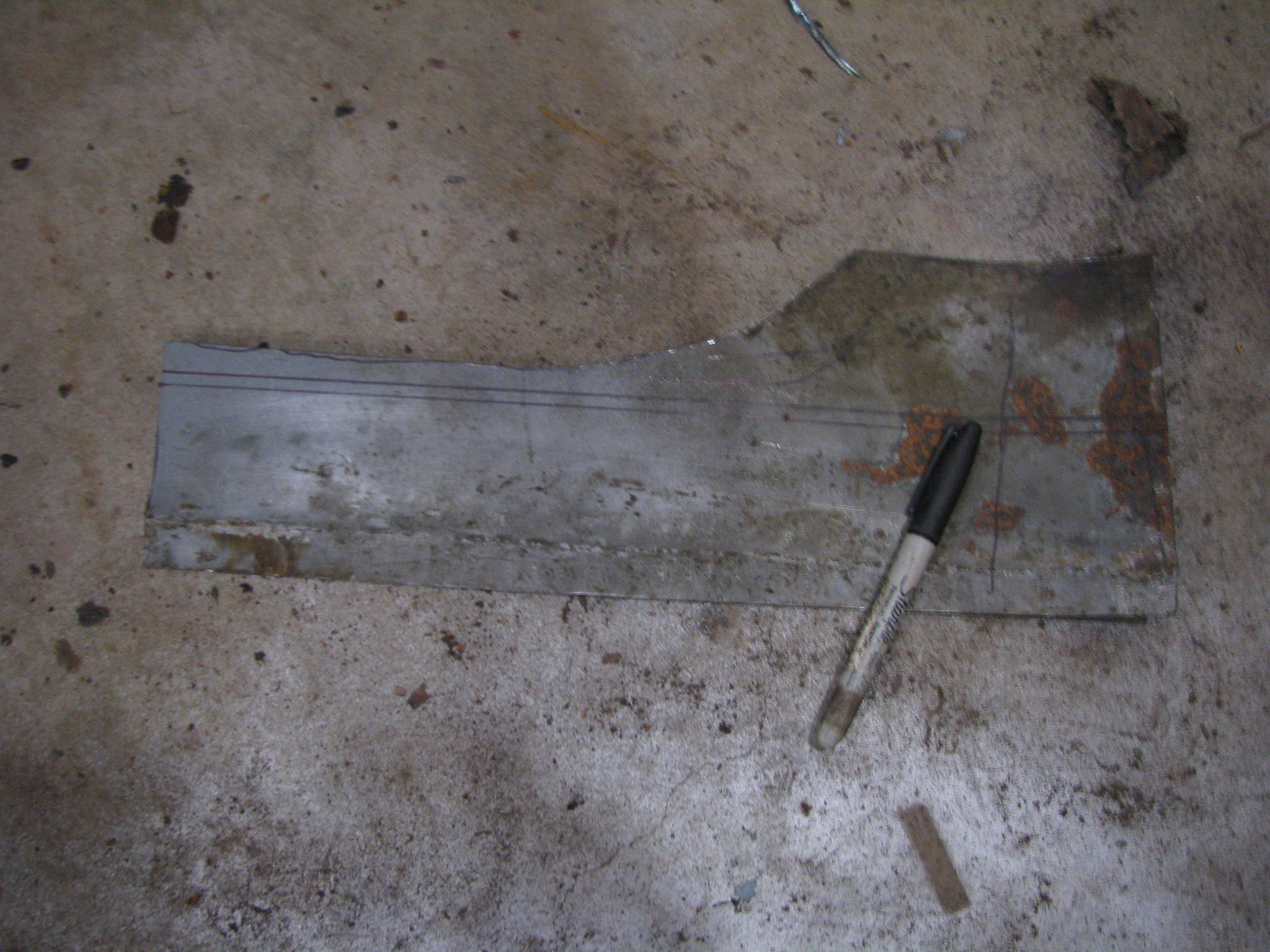

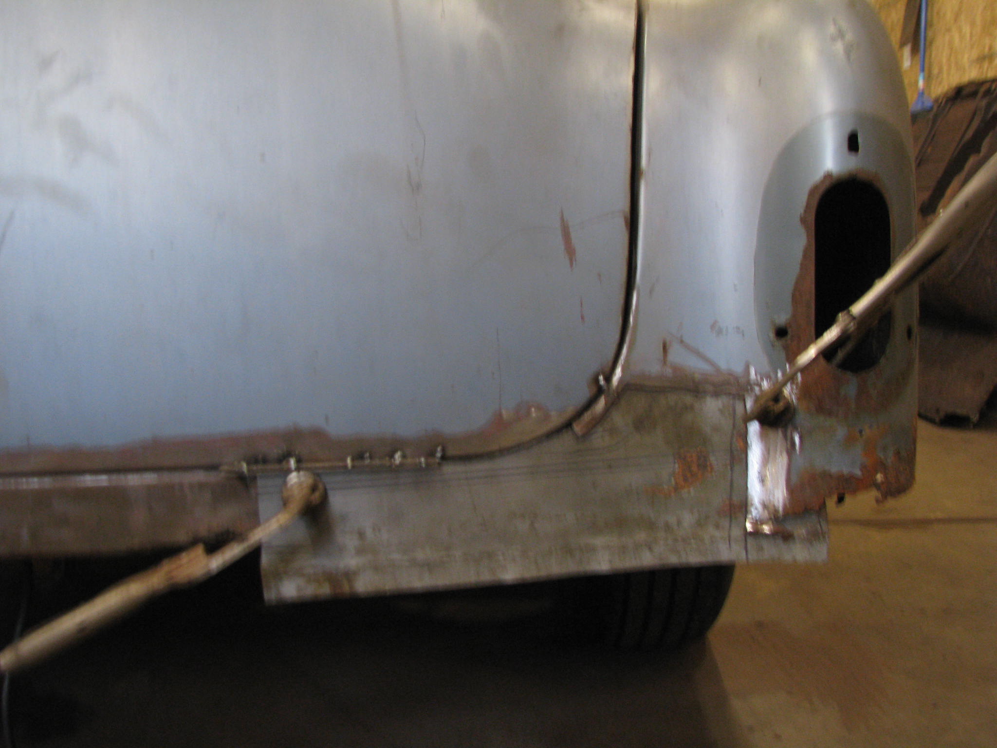

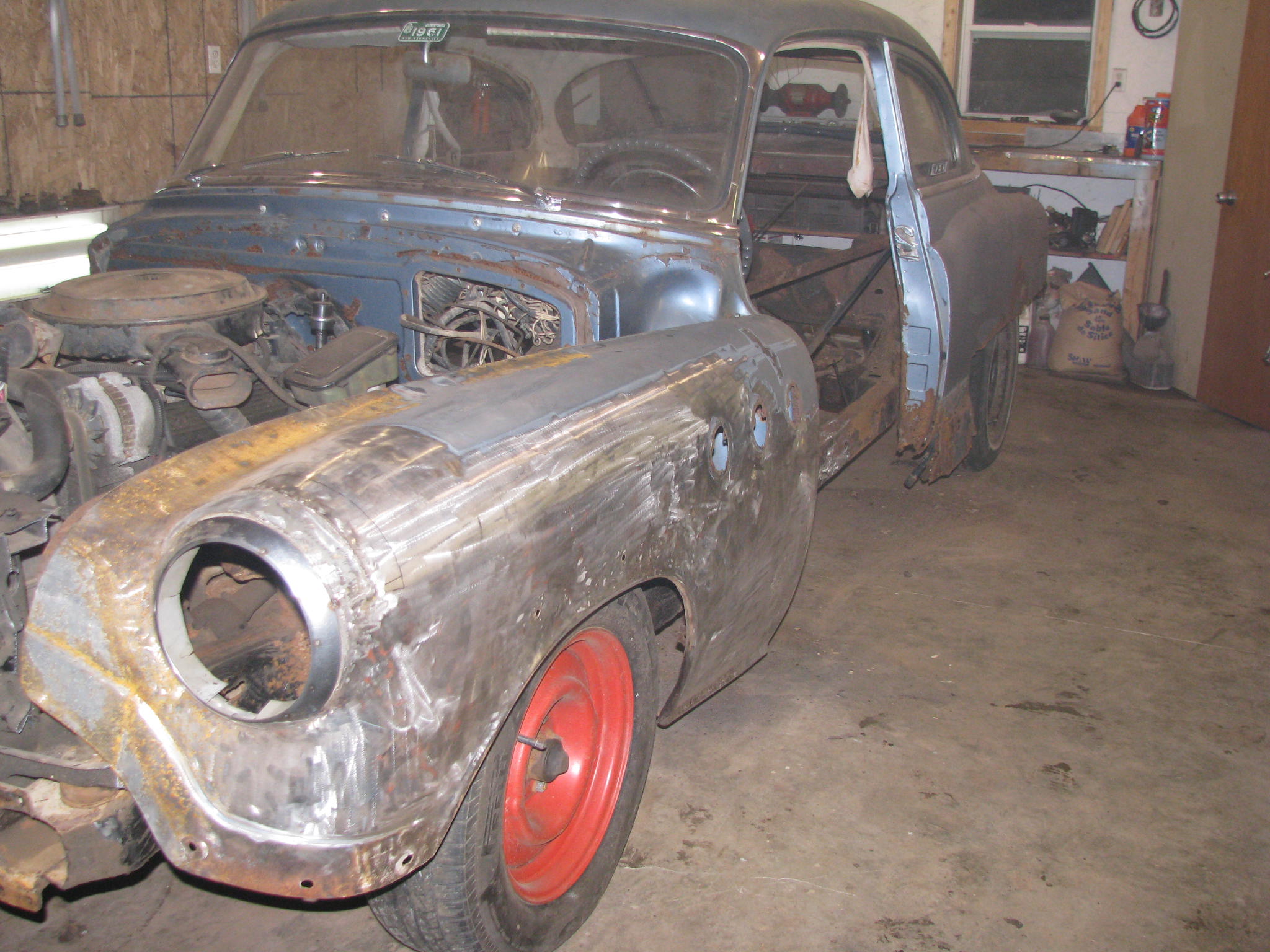

    Thanks Brerhair / Movin along on the build . When I picked up the roof in the summer of the 51 Chev I took the quaters as well . Glad I did . i cut them in half turned the upside down and what you see is the result . I have new rear quater corners . I will cut out the hole for the bumper bracket at a later date . Mocked up the bumper as well to see where we stand adn I realized that the bumper is badly bent on the Passenger side. I will have to deal with that later . Progressing along nicely . Comin to an end though because I have to get on that room that I mentioned earlier so the posts will be not so frequent. Later !!!
  26. aw1950
    Posts: 1,511
    aw1950

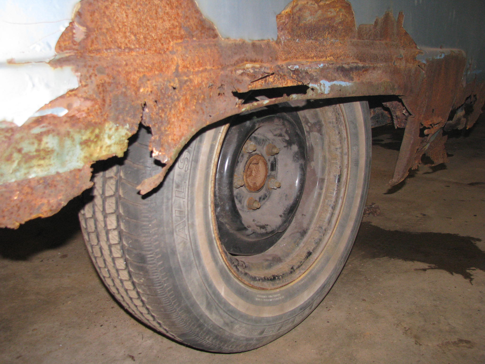

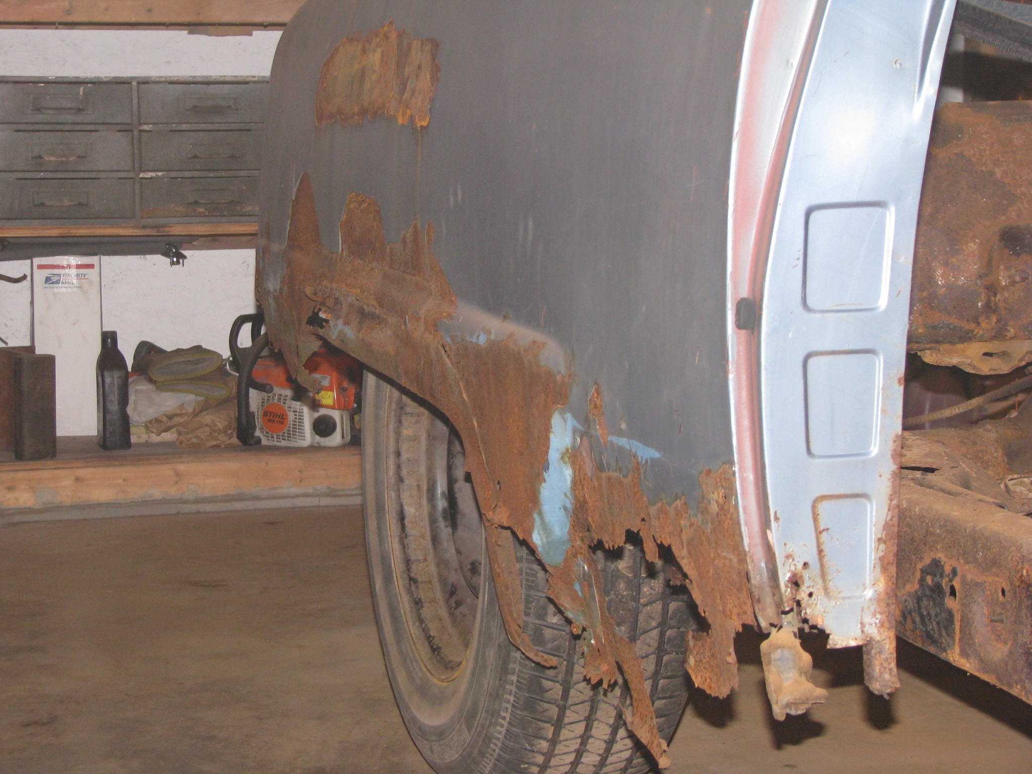

    Had to cut out the quaterpanel to get to the wheelhouse . Where to start ? Gotta think this one through. Wish I had some pictures of inside the wheel well !!! I think I have a few from the web of the trunk :rolleyes: . Wish me luck on this because after this I have to do it alll over again on the passenger side .....

    Holy crap! I will never bitch abot rust again, between you and Brerhair, sheeeesh! Stay after it man!
