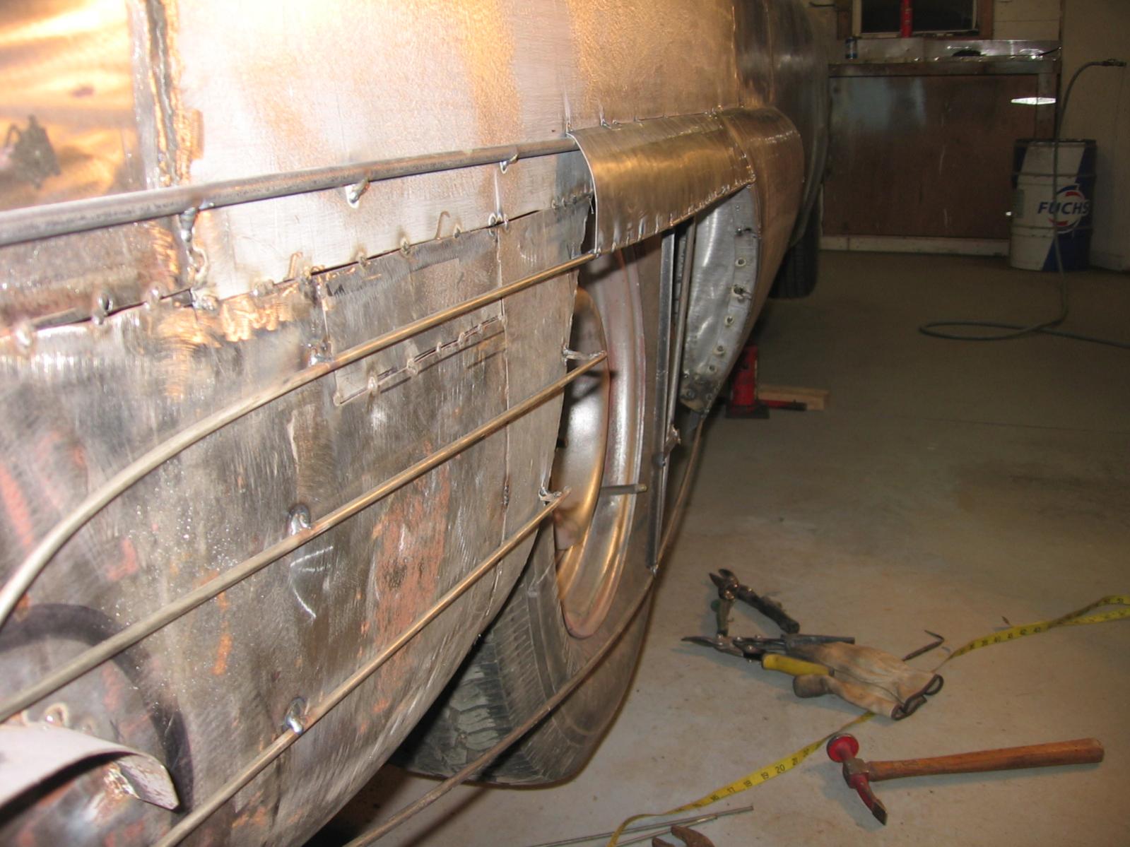

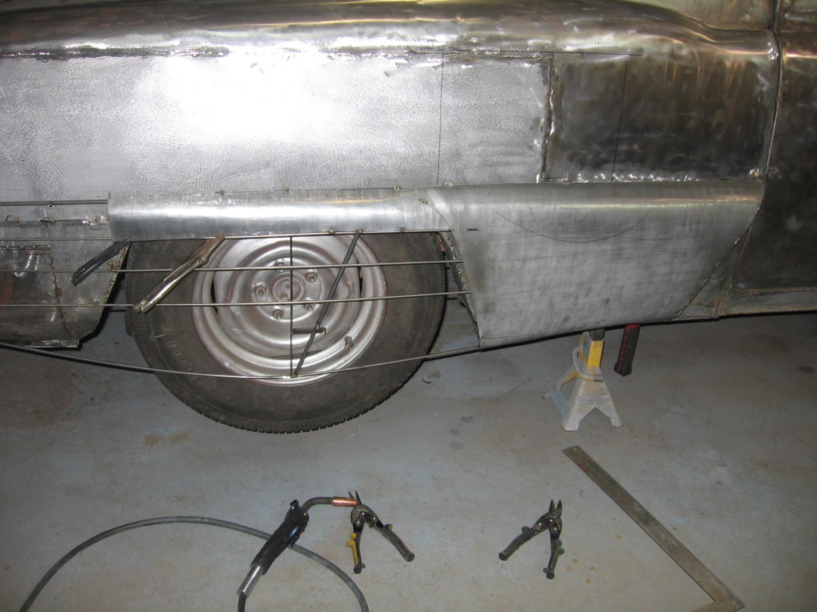

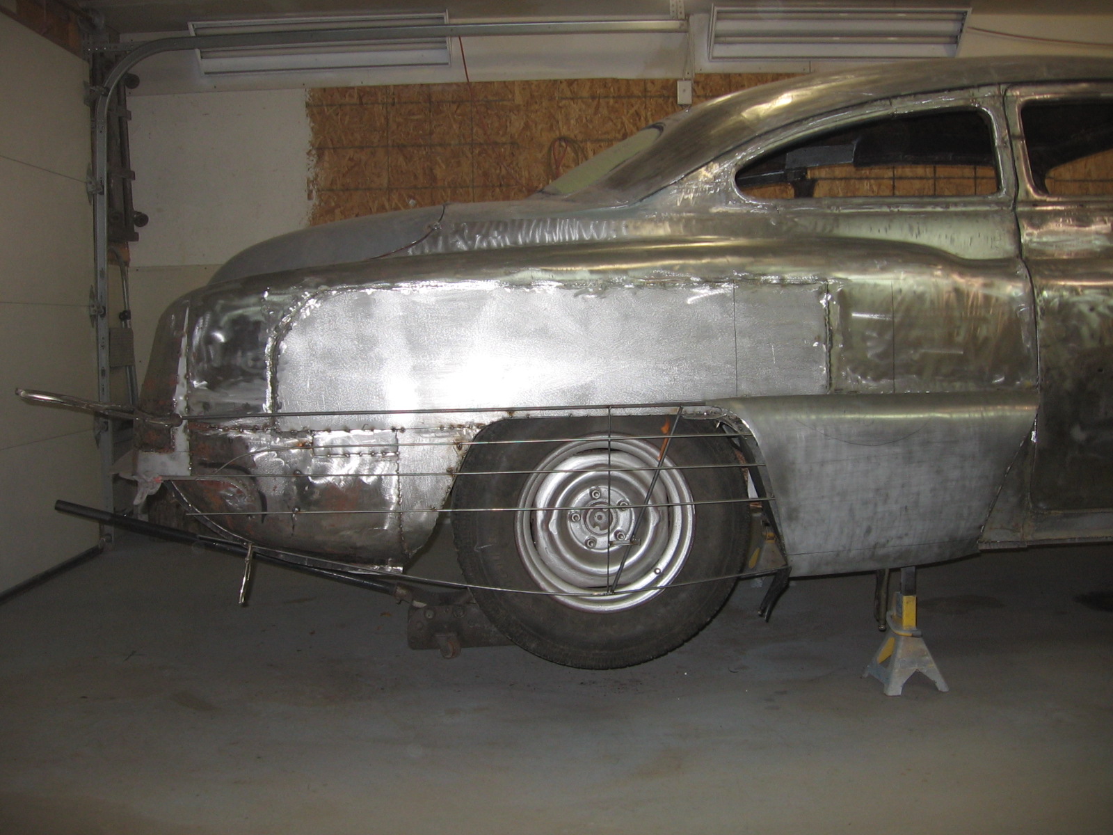

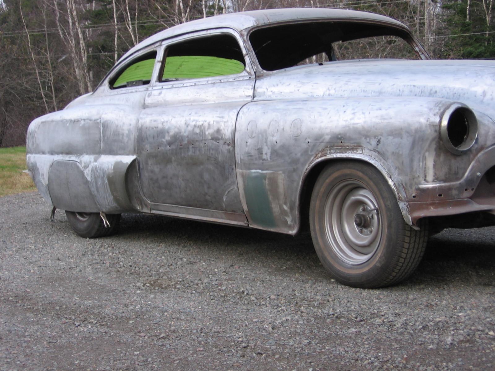

    Got a good jump on the skirts today . I sure am glad I purchased the English wheel dies last year ! Shaped up this panel pretty well ! I had a little done on the panel on Thursday but only got back to it today . Took about 5 hours of shaping and fitting to get it right ! I screwed up on my final measurement and cut it a little short at the front part of the wheel arch . I don't know if you can see the little blunder or not !! Wont take much to fix it but **** happens !! Oh well ! Andy

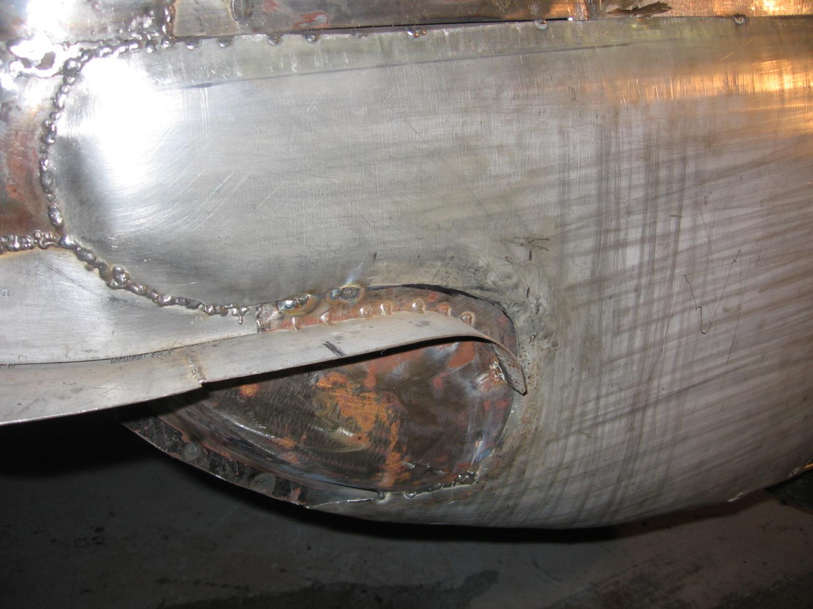

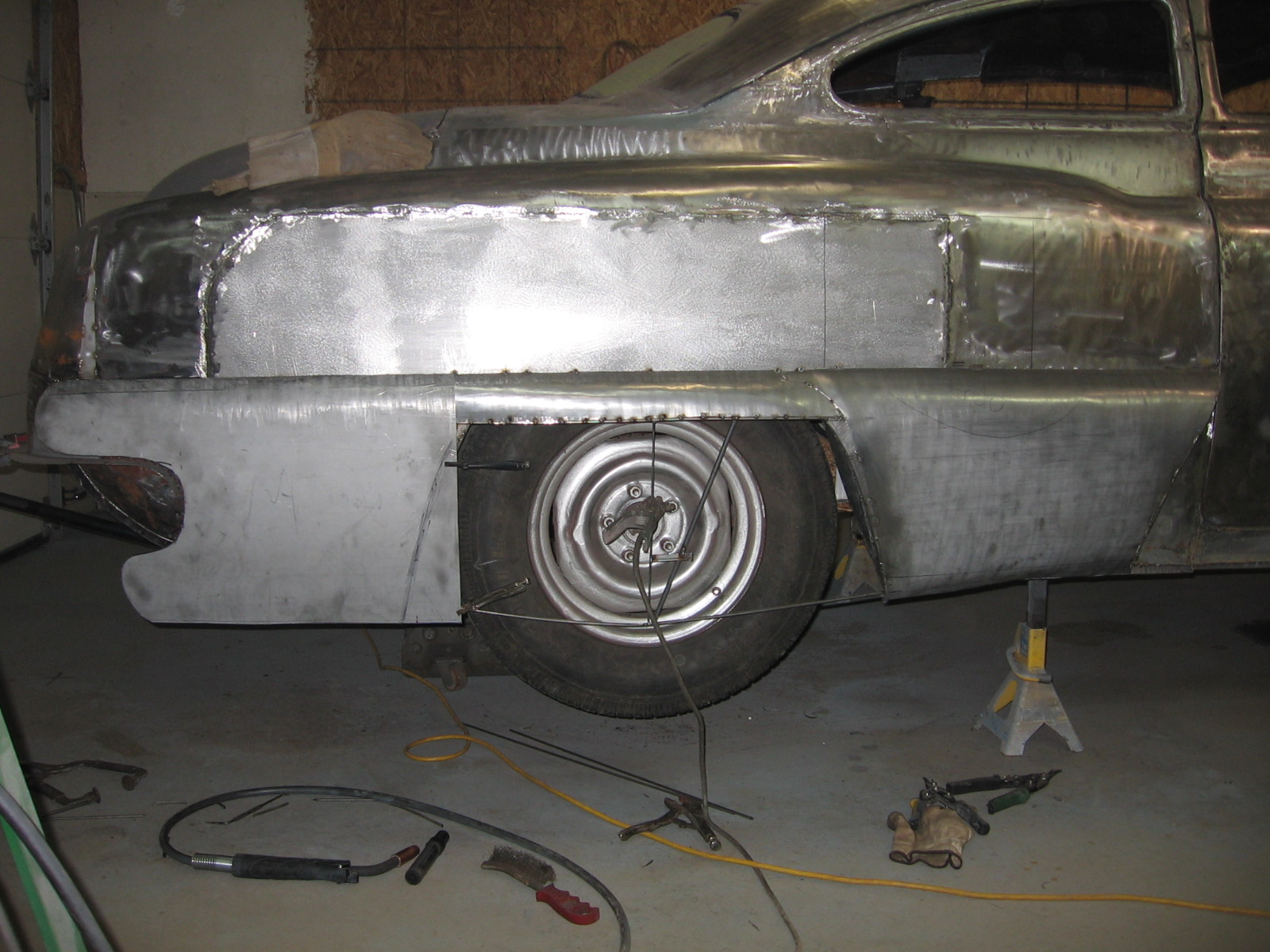

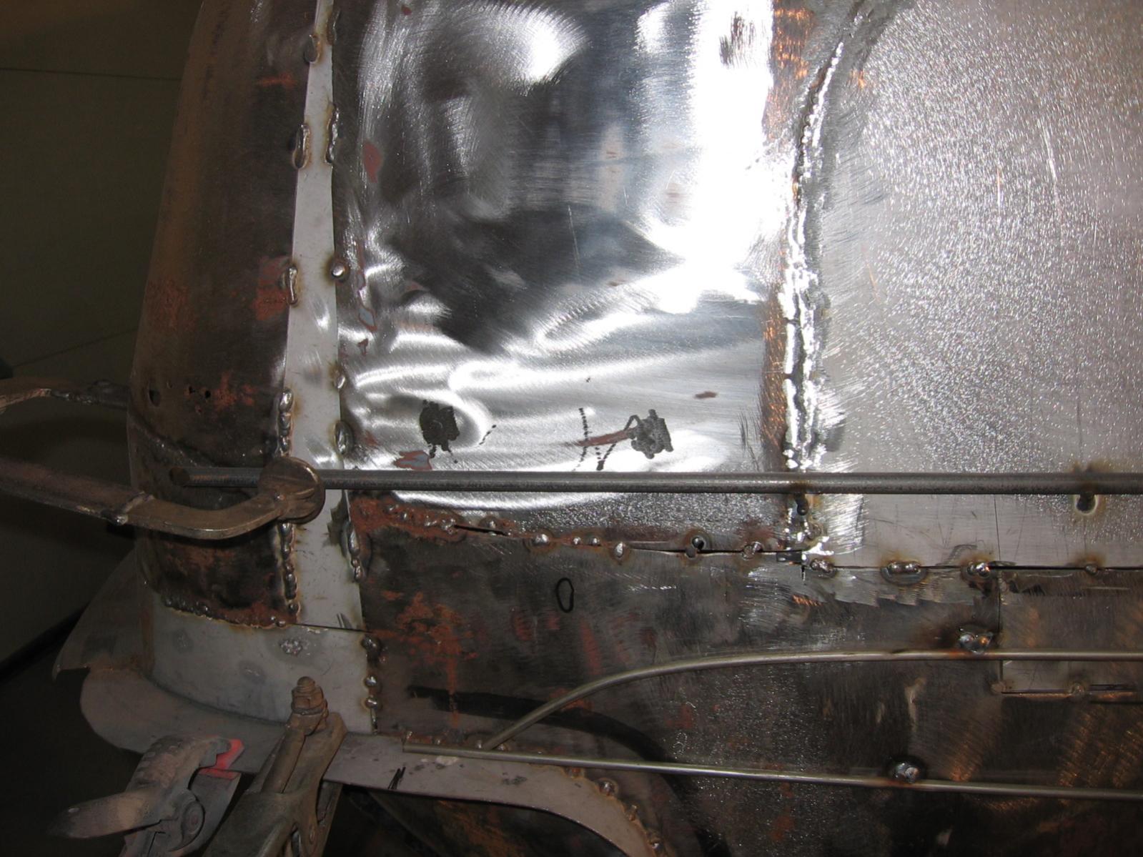

    Was in the shop again for a bit . I was able to get the arch shaped up and fit . 1st picture is the top of the skirt wheel arch tacked in as well the second . I used 5/16 CRS to establish my straight line at the top of the arch . I cut into the body so the 5/16 would fade away to nothing so that the skirt does the same , fades away into the body as well . Last picture is an attempt to visualize the whole panel !! Squint and maybe you'll see what I see . LOL !!!

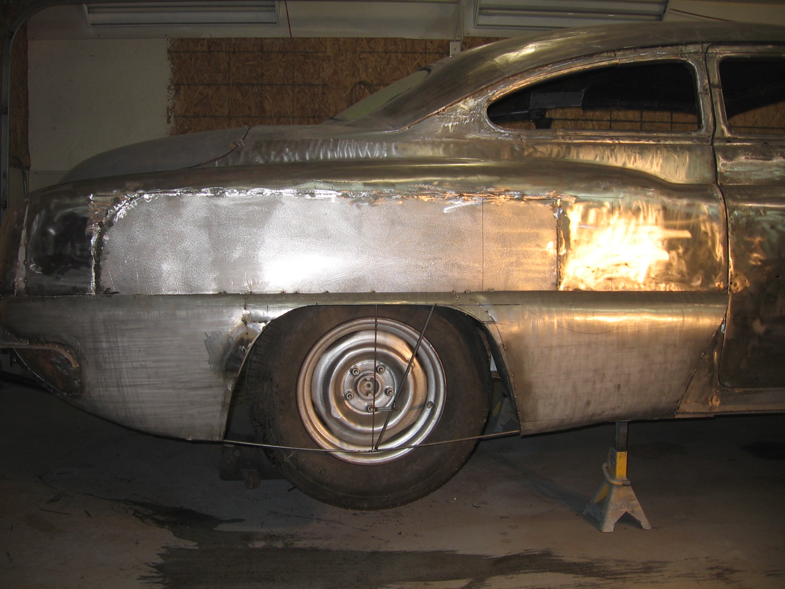

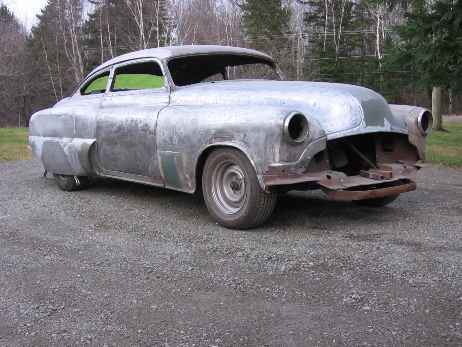

    Been a couple days and have a few progress shots . Starting to get there . Tieing in everything takes time but I think that I am moving along at a pretty good rate . I will and a filler bride from skirt to quarter panel to cut down on filler used . I shrunk the panel tight at the rear and it rounds into the body nice but I think that I am not done with it yet !! I still have to climb under the car and tie in the rear part of the quarter panel behind the rear wheel . This will stiffen everything up so I can m***age the part of the cruiser skirt that needs shrunk . Its just a little to much movement to put the heat and planish the area until its completely tied in . Have a look ! Opinions anyone good, bad or the ugly ??

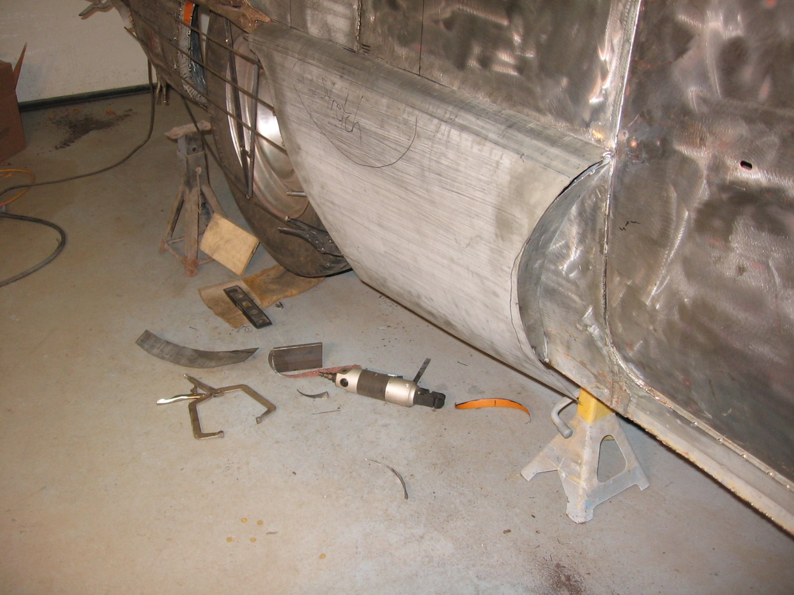

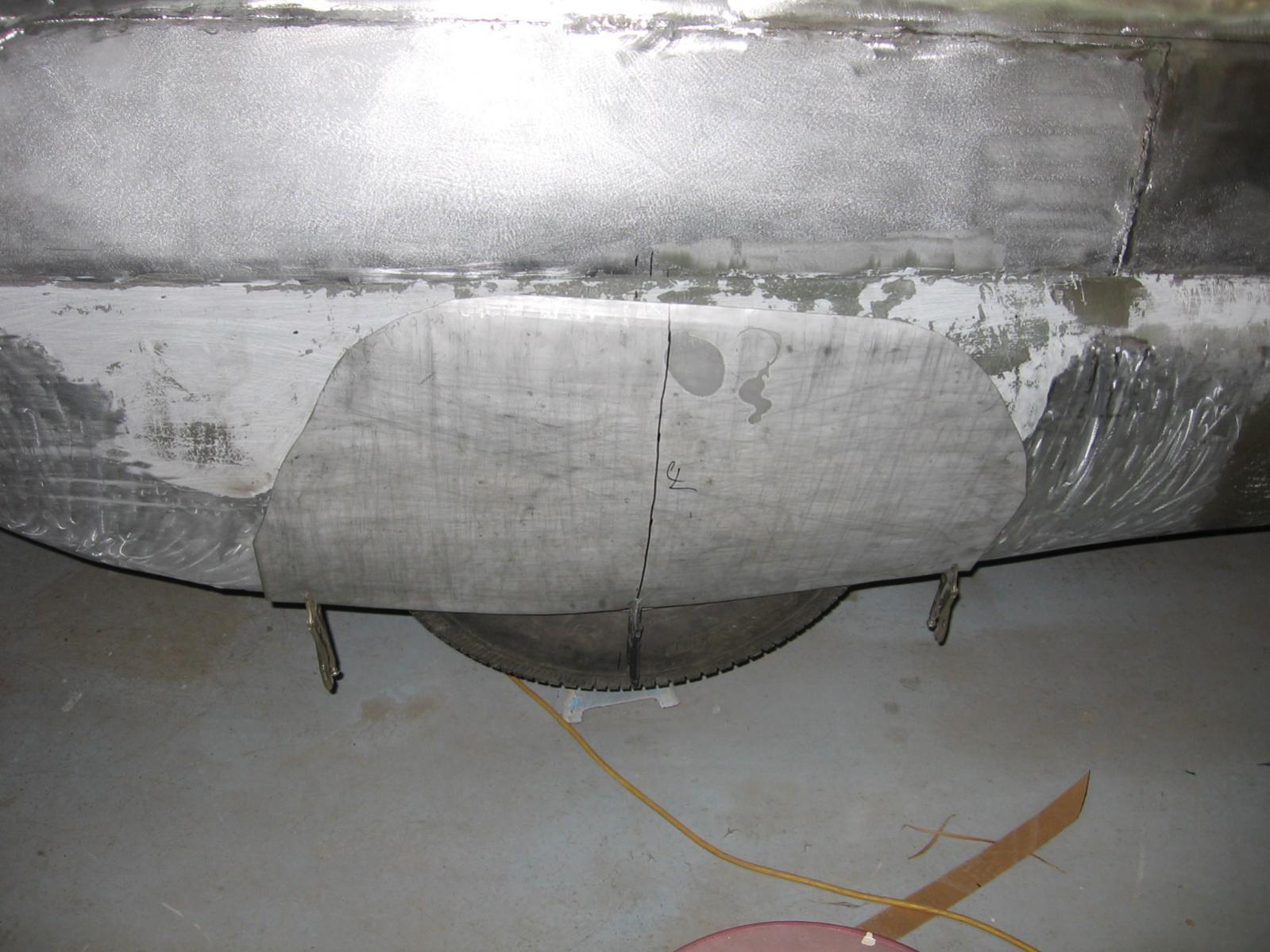

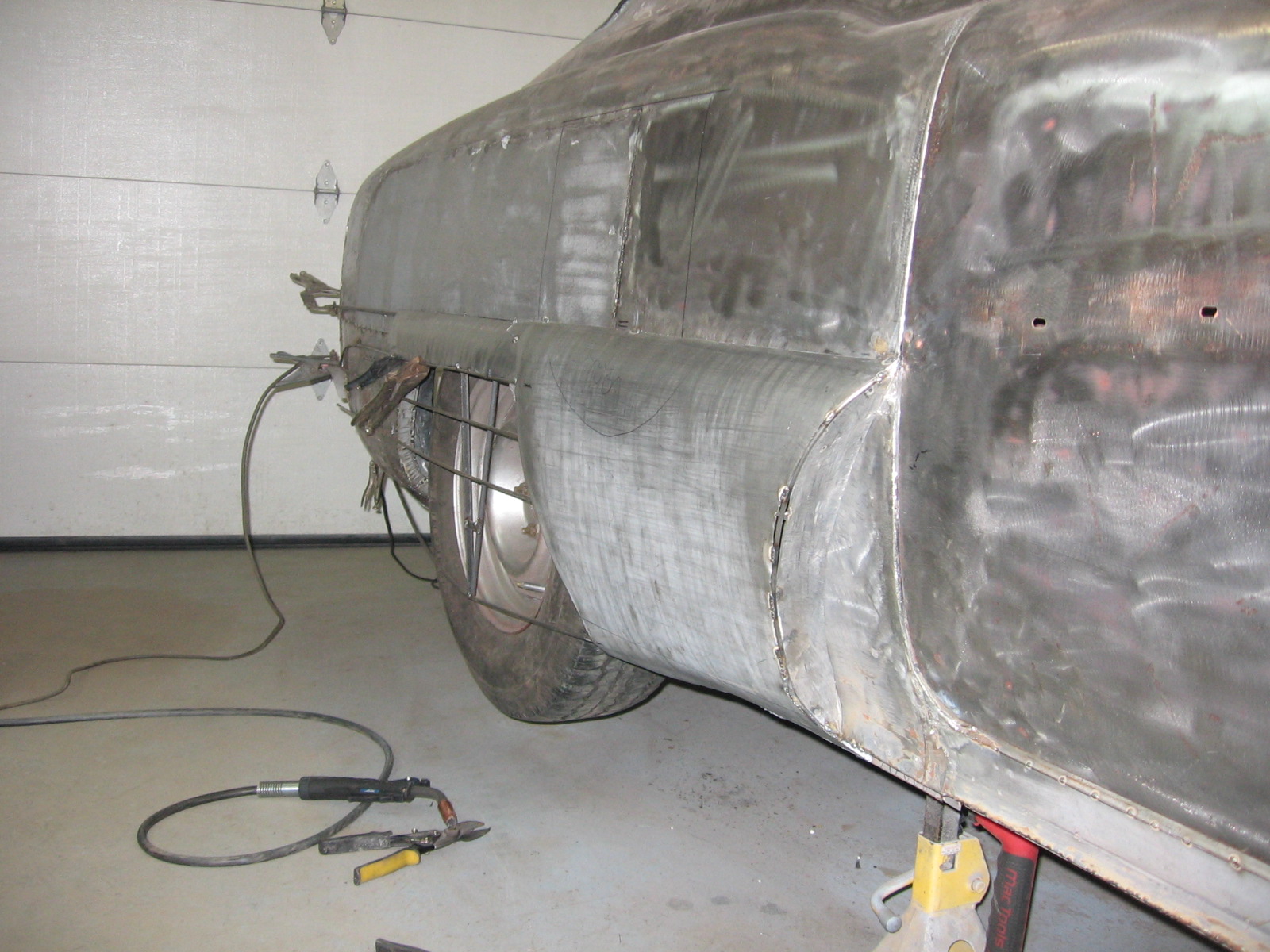

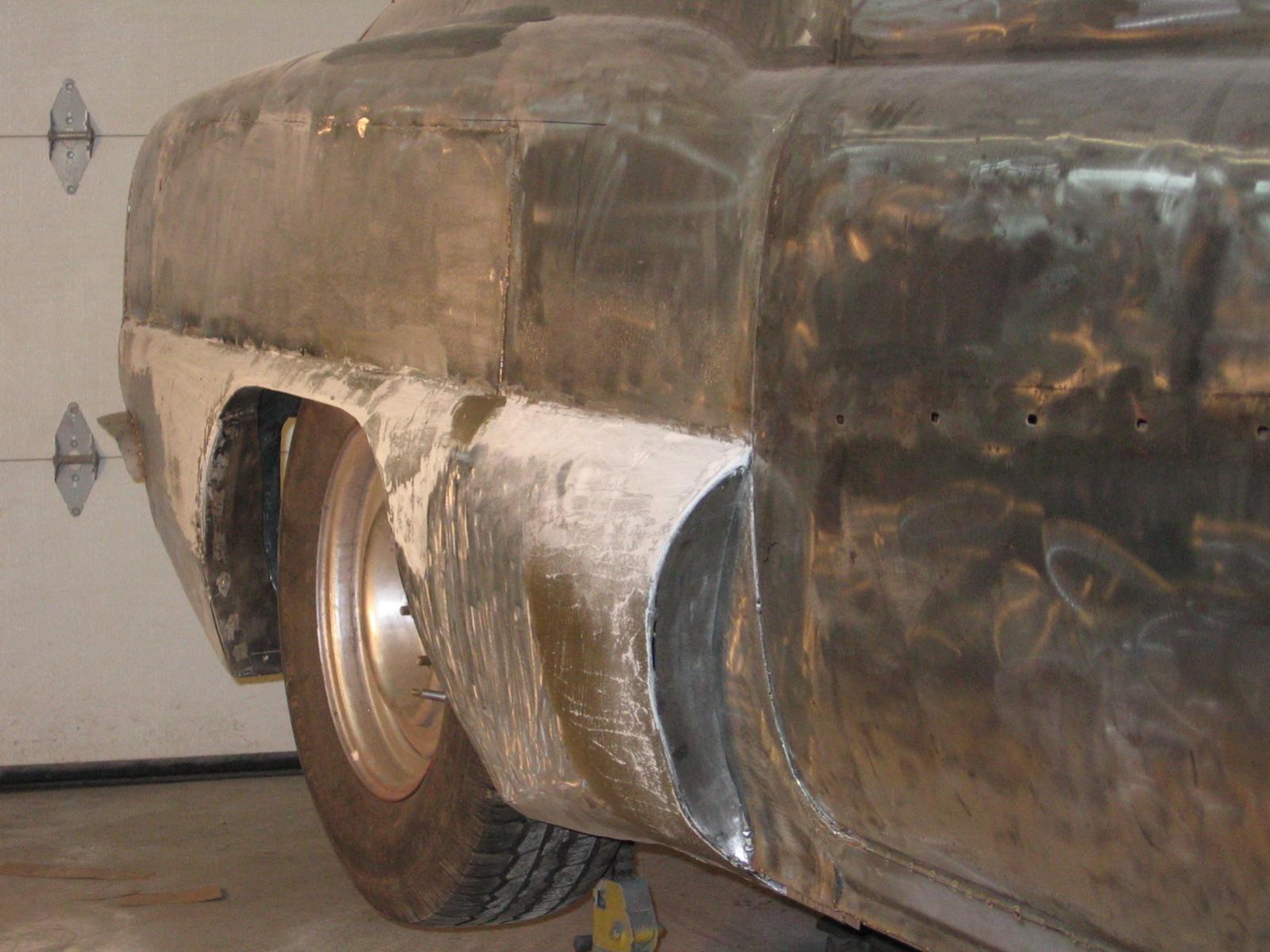

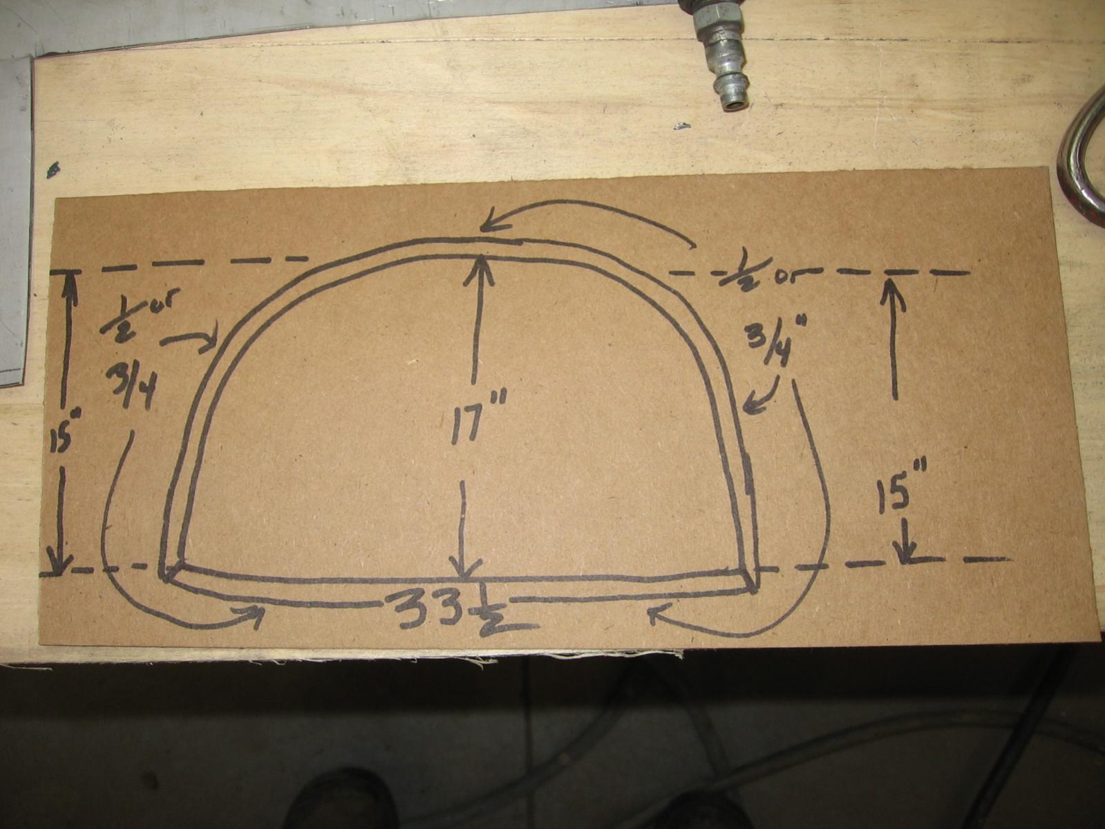

    Well that's it until next Saturday . I have to do some painting in the house before Christmas season is upon us . I started laying on some fibre gl*** at the skirt to body joint and also around the front leading edge of the skirt . Obviously the last picture is of the next step , the opening ! I need to get some MDF board and some wall grout to make my shape pattern from . Compound shape big time I am seeing here . This should get interesting . I wonder how many pieces of sheet metal I will go through ??

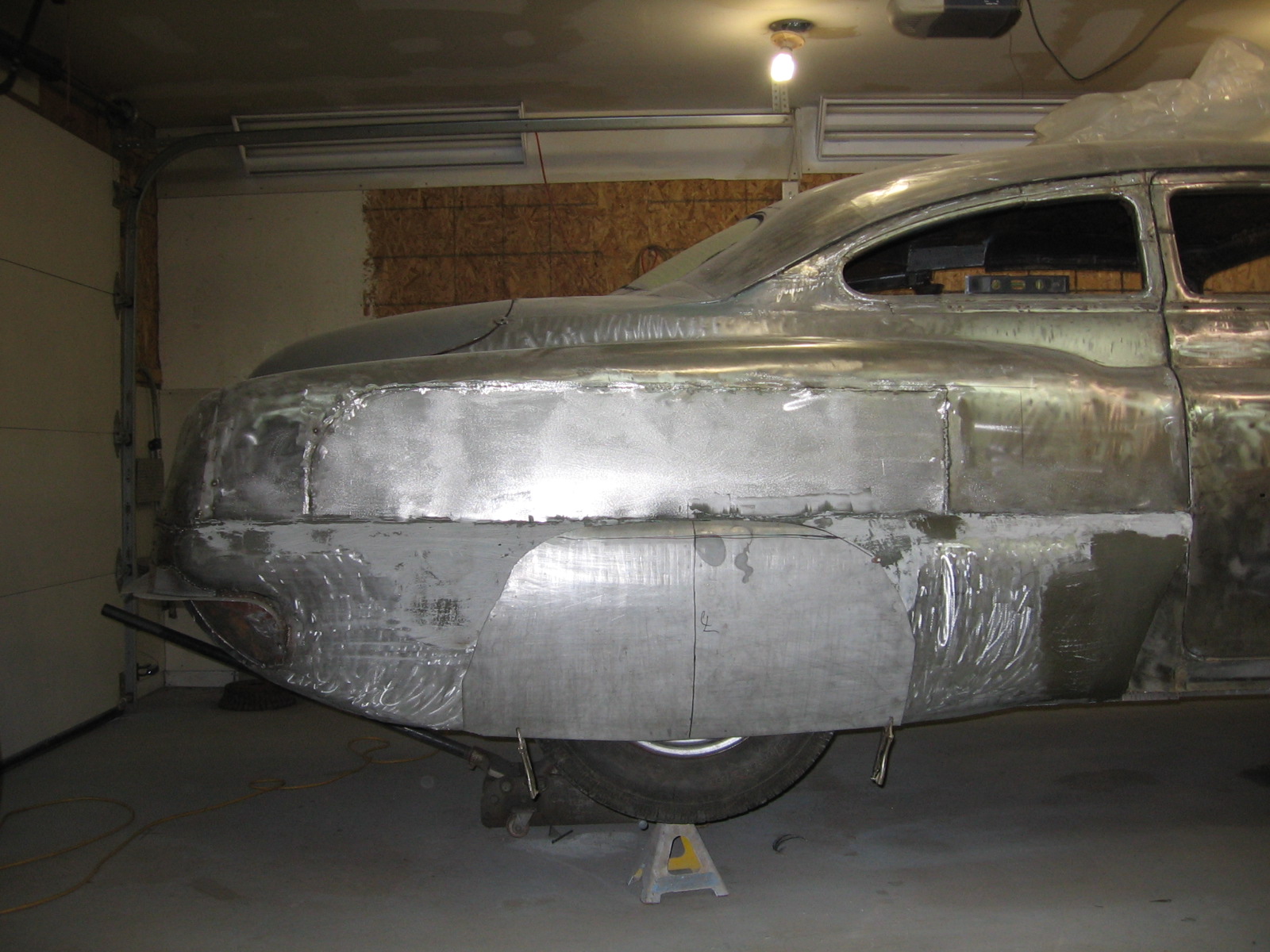

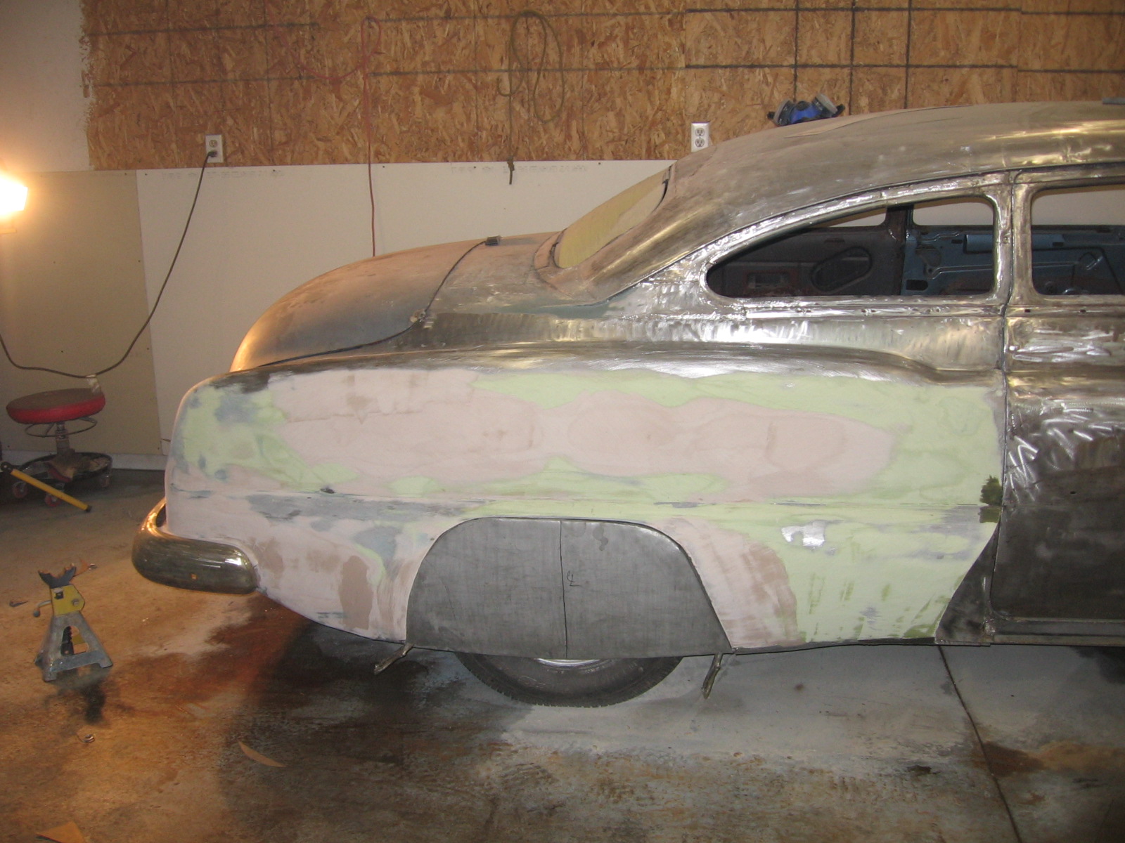

    Got a little farther along . Didn't get any time in the shop this weekend but a few hours this AM . From a flat sheet to a semi formed skirt filler in about 2.5 hours .

    Thanks Guys . Dave the look will be the same as a removable cruiser skirt but it will only be the wheel opening that will be removable . I will attach it the same way as fender skirts and keep the line at the arch opening as tight as possible so it looks like one big skirt . So think of the main skirt as a quarter panel and I am just making full fender skirts . I will have some out door side profile shots tomorrow with the wheel opening in tact and hopefully formed better to the opening . Right now it is over laid over the main cruiser panel . Stay tuned !!!

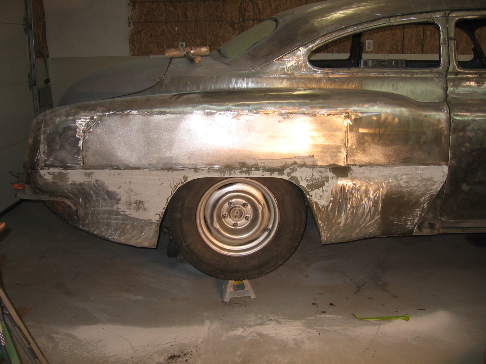

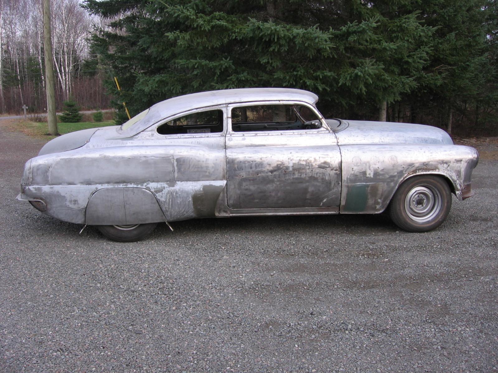

    Some profile shots from different angles . The look of the size of the rear panel will be interrupted once I get the rear bumper installed . For now it will have to be as I have a job coming into the shop tomorrow . Probably be at that for this week . Then back to the Buick . I haven't started bodywork around wheel arches or anything yet so the opening gap will get fine tuned once the filler process starts . Have a look ! Andy..

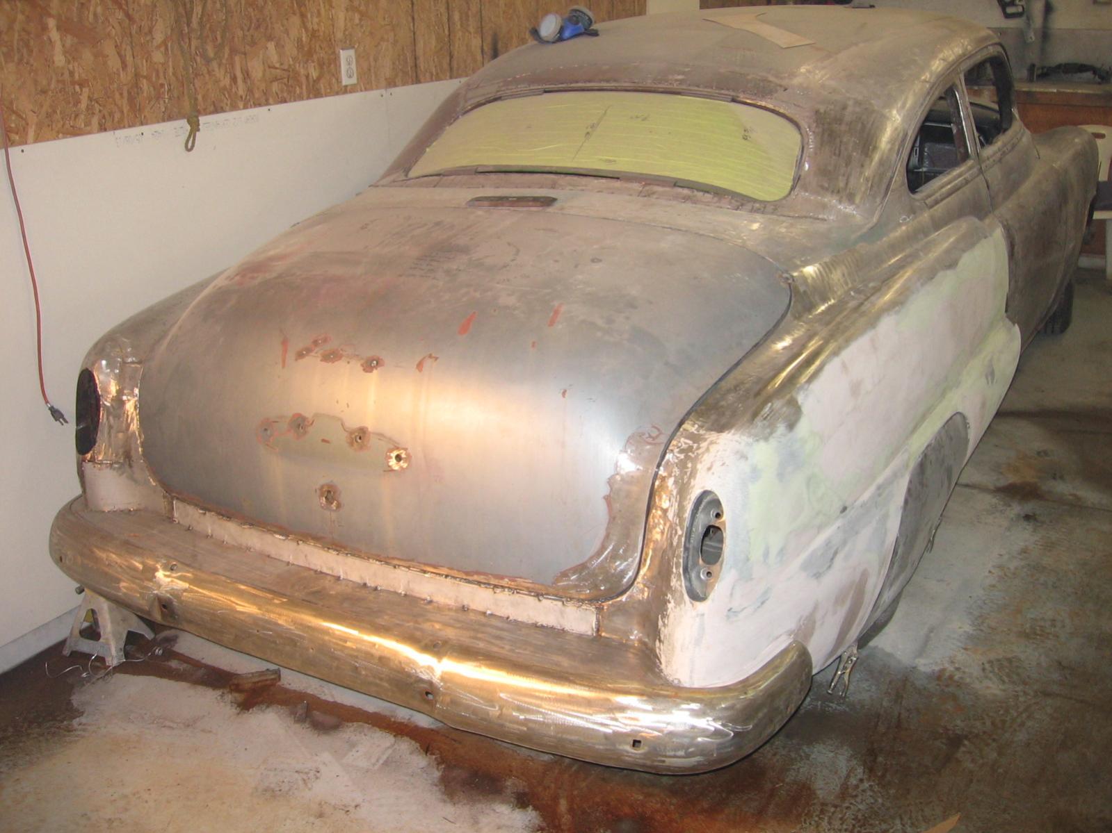

    Been plugging along . Nothing really worth posting in the last 6 weeks . But a little is done . Quarter panel right side 80% complete and I am working on the rear as well adjusting trunk gaps and such . Installed the taillight bucket also . Progress is progress . Hopefully into primer in these areas shortly . Starting the mock up of the rear bumper . Put it somewhat in place to make sure all is lining up , Looks good so far ! Later , Andy..

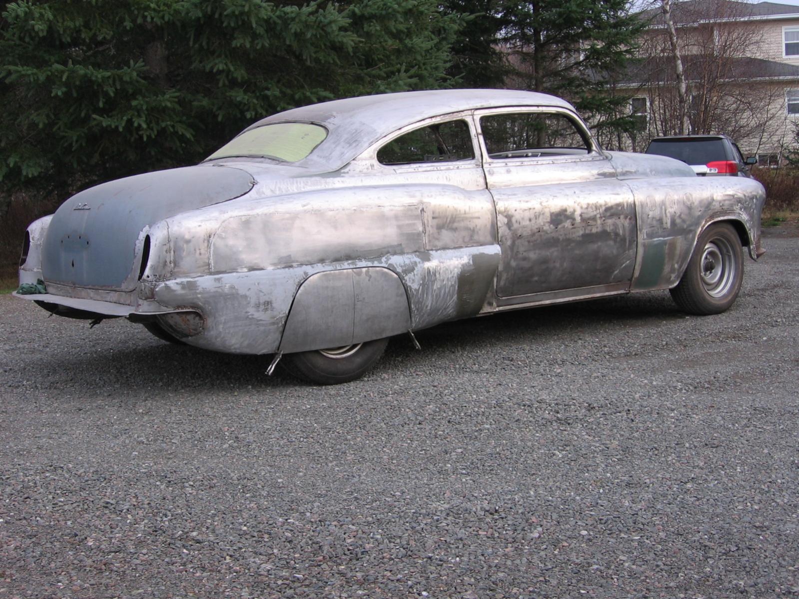

    I really hate to say anything as I´m really impressed with this build, but I have a little constructive criticism to offer. The lower edge of your quarters seems to take a bit of a dive down away from the line of the rockers and it looks a little off to my eye. If you lift it a little to line things back up, I think it would look rather better.
    Likethis....
    What colour are you planning?
  28. aw1950
    Joined: Dec 21, 2008
    Posts: 1,511
    aw1950
    James D I know what you are seeing . If I had better shot of the cruiser panel you could see why this is . I wanted to have the effect of being low cruiser but in reality it is the stock ride height . So when creating the panel I had to swoop it down from the rocker at that point back , across the opening to the rear of the wheelarch . The rounded lower rear panel is what I have to work with so the quick swing upward is what I will have to live with . Maybe there is room for a little manipulation of the panels ?? Criticism is always welcomed , especially the constructive kind . As for color I am kicking around a sunburst gold color or the other side of the spectrum a midnight teal metallic . I have the interior material already and it is two shades of creme . Feel free to throw something up based on the two color variations I am leaning on . Thanks again , Andy

    My first thought was the same
    As james comment. However a curve is necessary, how much is a matter of taste. Also considering how the bumper comes in to play , will be a big factor.
    I went the same route with full handmade cruiser skirts. Then backed off on the lower radius.
    Ending in a almost stock curve
    Just lower towards the rear. Balancing the upper and lower quarter lines is key. Coming from a guy that chopped his top three times. Do it till you like it.

    updates . Well I had quite a time to upload some pics. Anyway, resized and ready to go . I took JamesDs' advice and adjusted the line of the rocker panel to flow better into the cruiser skirt. The rear ? well that's another thing . I have to mock up the rear bumper and then mock up the exhaust . I may dump it out under the rear bumper wrap around . This will take some of the roundness of the quarter panel return away . The new panel for the wheel opening is a ***** to get right . I don't know how many trips I made from the English wheel to car and back . I spent 3 hours last night rolling this panel and welding it up and still not completely satisfied or done . :mad: The dark part under the skirt at the front is just fibregl*** that hasn't been sanded and top coated with Bondo yet . The wheel opening panel is coming though . I made the opening the same front and rear because I noticed that they weren't the same and I didn't like the looks of the panel .The front arc was , well not an arc but a straight line and the rear of the panel had I nice arc to it . All is good now ! I am waiting for some rubber fender welting that I will Bond onto either the body or the wheel arch panel . This will clean up the opening dramatically . Hope to be in primer on this panel by the weekend .
