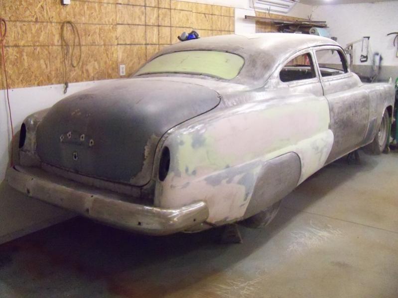

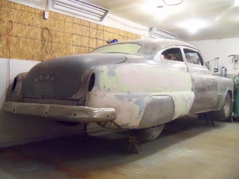

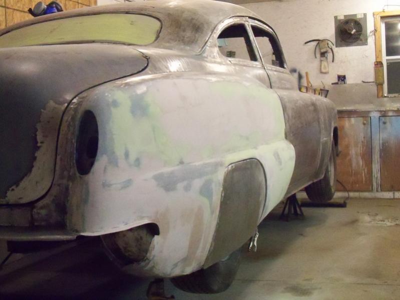

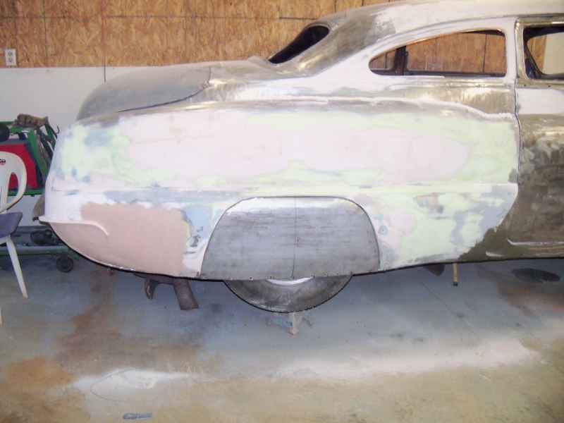

    Have some comparisons to show . I took some advise and I see now what that the extra time involved in fixing the observations made by fellow HAMB subscribers paid off. It changes everything in my opinion . The first and third pictures are of how it was. The rest are after the redo . What do you think ? Bodywork is next, then it will really all tie together . Andy
  8. fitzee
    Joined: Feb 26, 2003
    Posts: 2,862
    fitzee
    great improvment..takes the roundness out of the back and it flows nicer with the bumper
  9. That looks good. I agree with fitzee that it flows nicer with the bumper now.
  10. aw1950
    Joined: Dec 21, 2008
    Posts: 1,511
    aw1950
    I am glad that I took the time to do it . I will admit at first I thought I would leave it but looking at the comparisons I am glad I didn't . Thanks guys , Andy

    Definitely looks better ! I think lowering the bumper a few inches would ad to the look .... maybe James could do a quicky photoshop :)

    That's pretty much it Shane as far as lowering the car . I might bring the front down a little bit more but the car has a little bit of a reverse rake to it anyways . The Buick will not get bagged . Funds just wont allow it .

    Steve The rear splash pan is all welded on and in the stock position .It would be a lot of work to move it down an inch or so . I might be able to tweak the pan slightly to get the bumper 1/2" - 1" lower . Thanks for the input and observation . Andy.. PS You getting anything done on the 47 lately ?

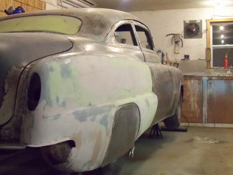

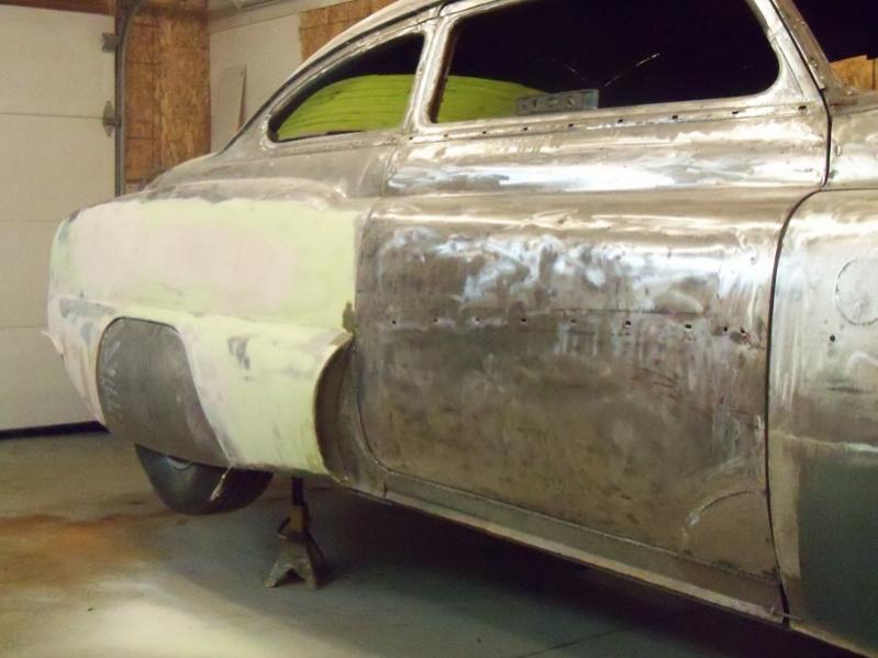

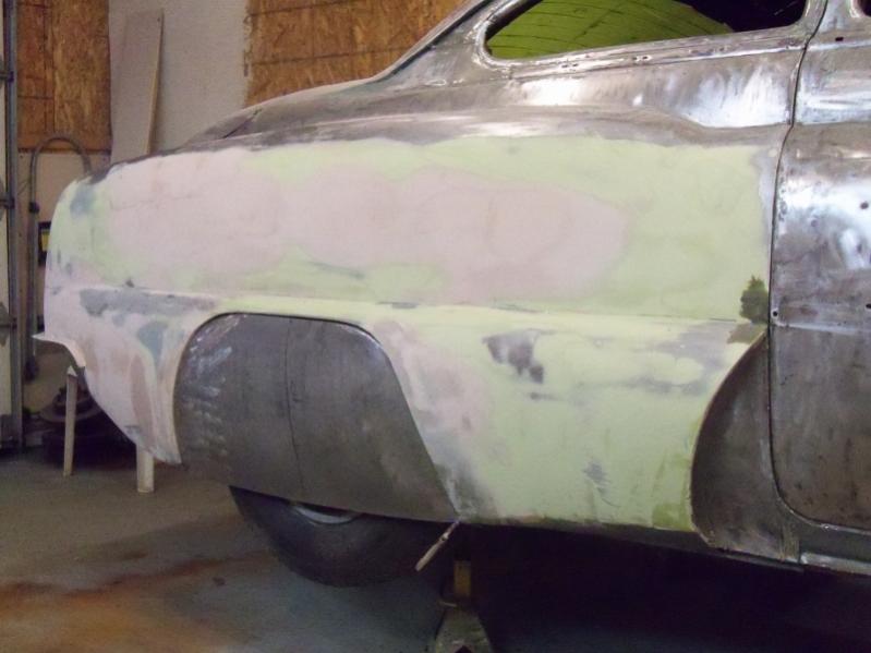

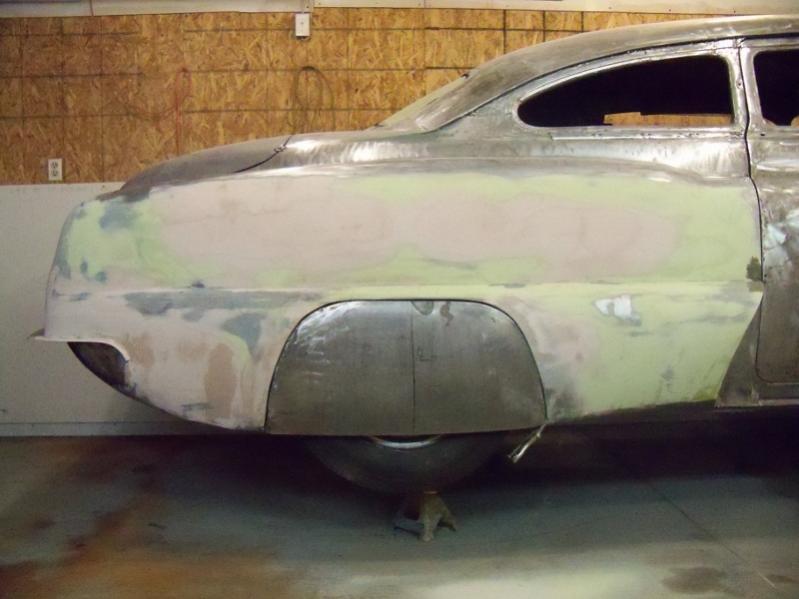

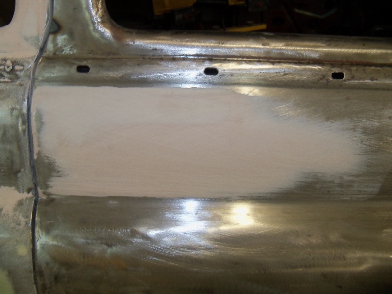

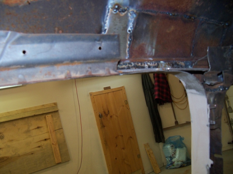

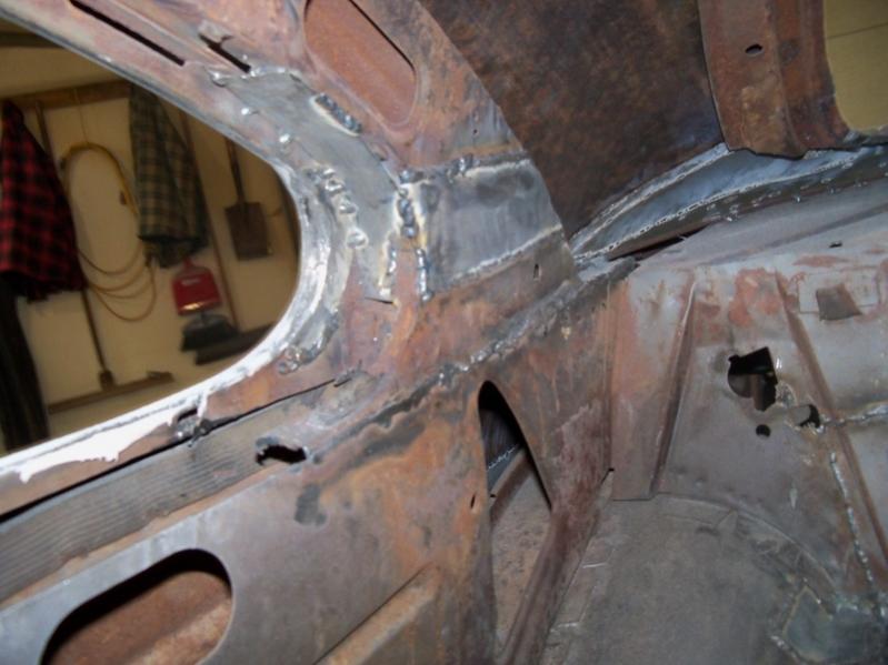

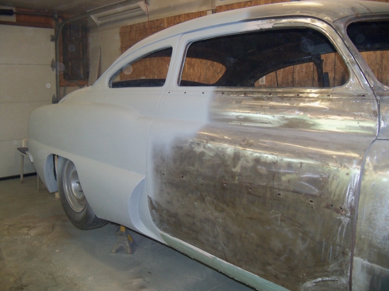

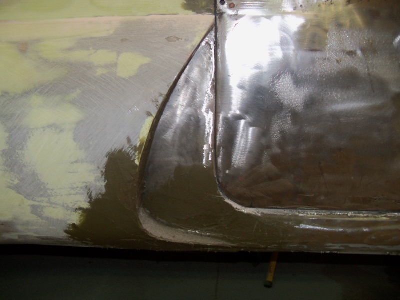

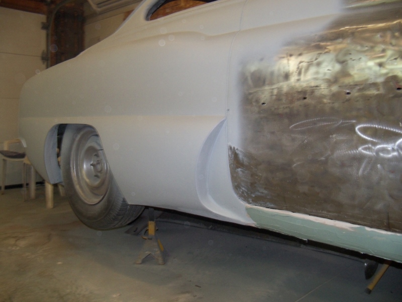

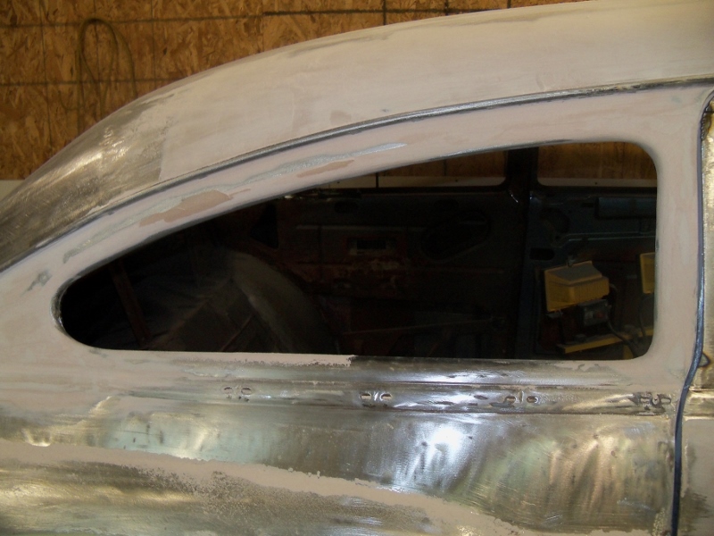

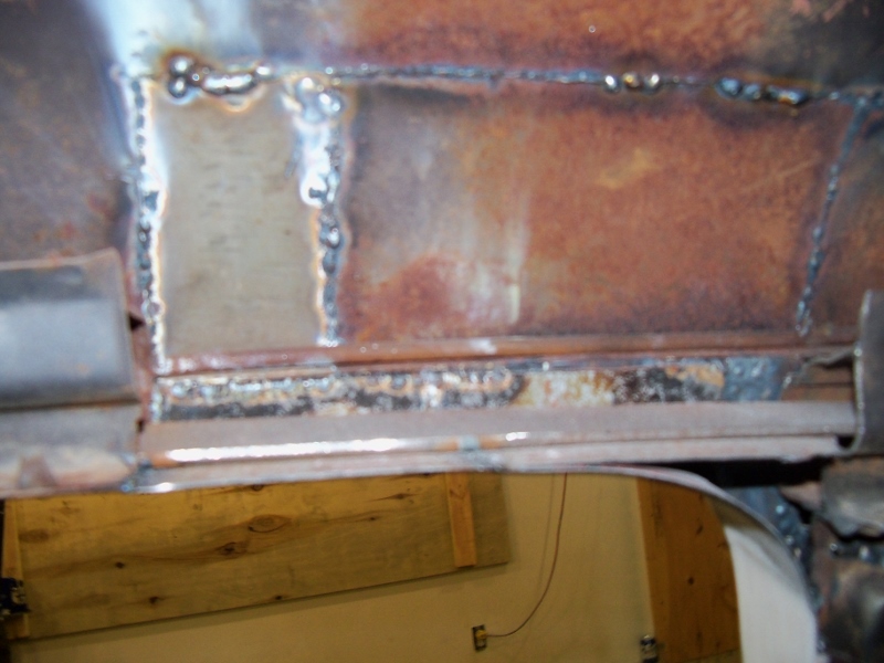

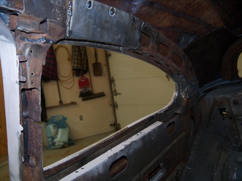

    Plugging away . I made a scoop return down low at the quarter panel ( The first three and the fifth picture ) . It fades away to nothing at the rocker panel .Other pictures are the elimination of the old door handle holes . Doing the bodywork around the rear side gl*** area . I removed the body reveal around the rear side gl*** area to give the body a more softer cleaned up appearance . More to follow in a few minutes . The last picture is inside . I have to fabricate a filler piece above the door opening to tie all the substructure all together front to rear again . Andy

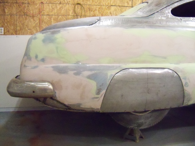

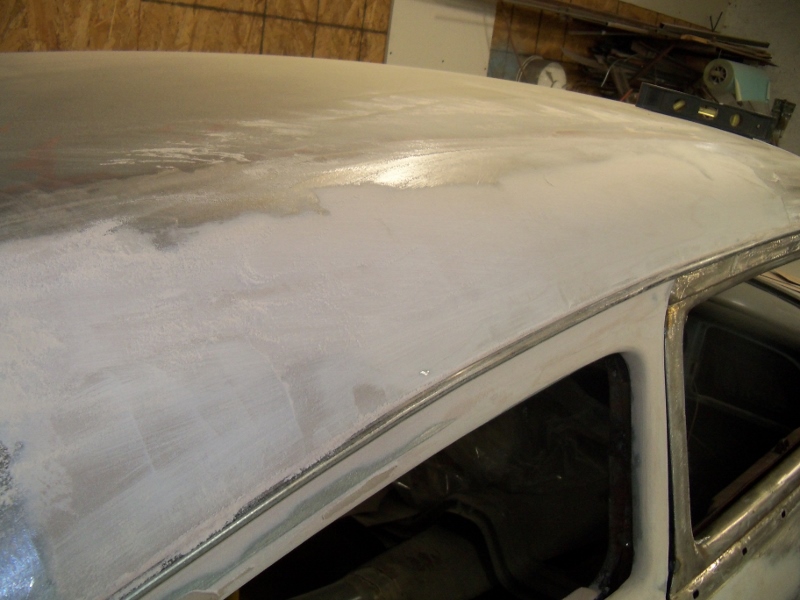

    Couple more , Getting the filler on the skirt extension that I did a few weeks ago . Showing more of the inner substructure tie in . And the same area as in the previous group of pictures . Starting to skim coat the roof as well . Primer is just around the corner . :rolleyes: Andy..

    OOPS ! Forgot one . This was the large tie in over the rear side gl*** area !Inner and outer panels welded in and the plug welded together . Andy..

    Well like I said primer around the corner . Lots of blocking out the filler to get it close . Shot some primer just for motivation . I had more pictures to show but the camera wont cooperate :rolleyes: 2 Will have to do for now , Andy...

  26. wow!!! It's amazing how primer makes a car look better. I was struggling at first trying to figure out the flow of the rear quarter panel. I asked you about it in an earlier post, but now with the primer on it....GENIUS!! Looks great!
