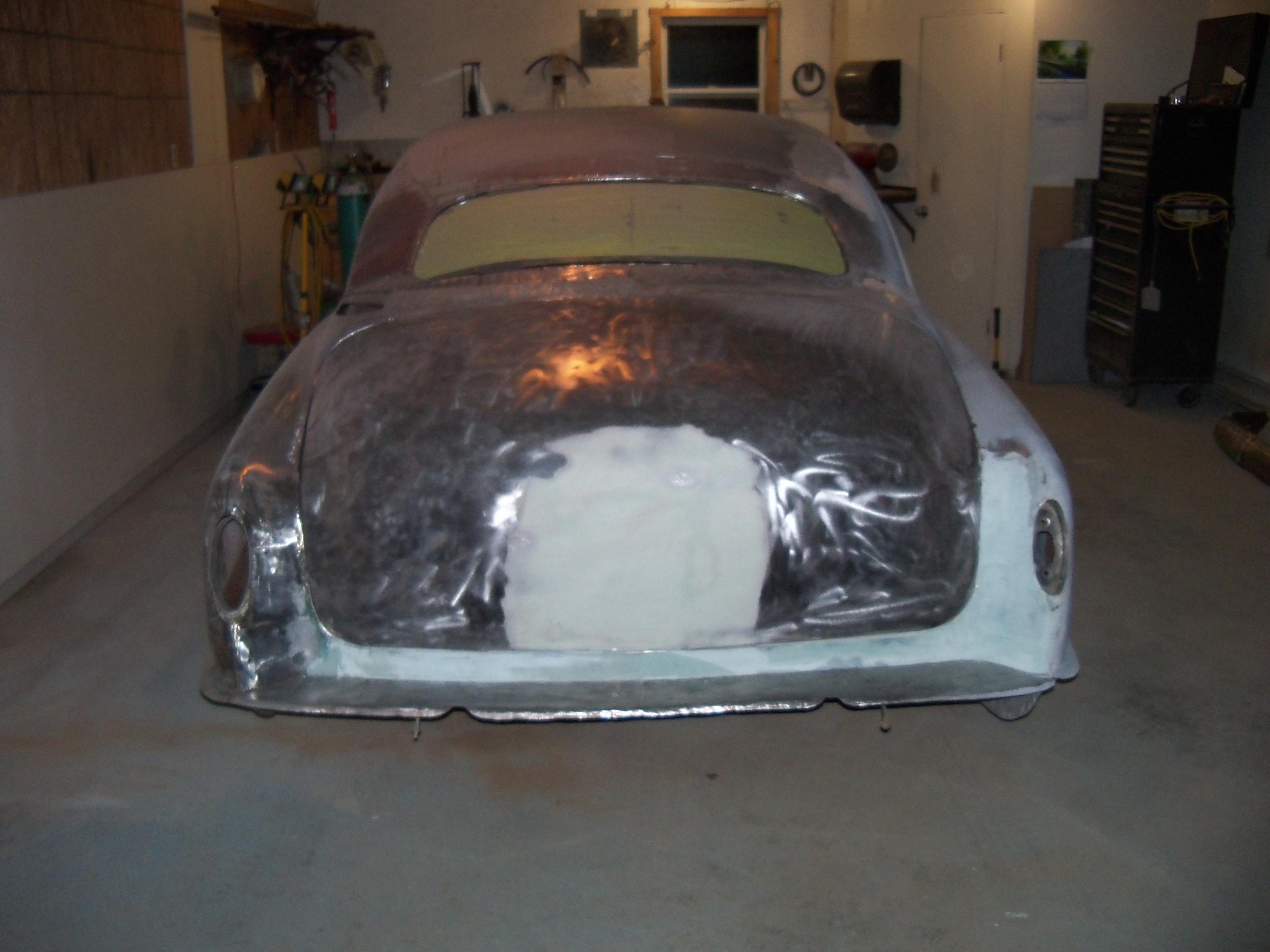

    The back end after todays progress I know it looks a lot like what has already been posted but there is progress none the less . The trunk gaps are coming along nicely although its hard to tell in these shots and I am in process of fabricating the second taillight bucket . These 49 ford taillights are frenched 1". If I think of it when I get back to it I will show how I fabricate a bucket . Its really very simple :rolleyes: Andy..

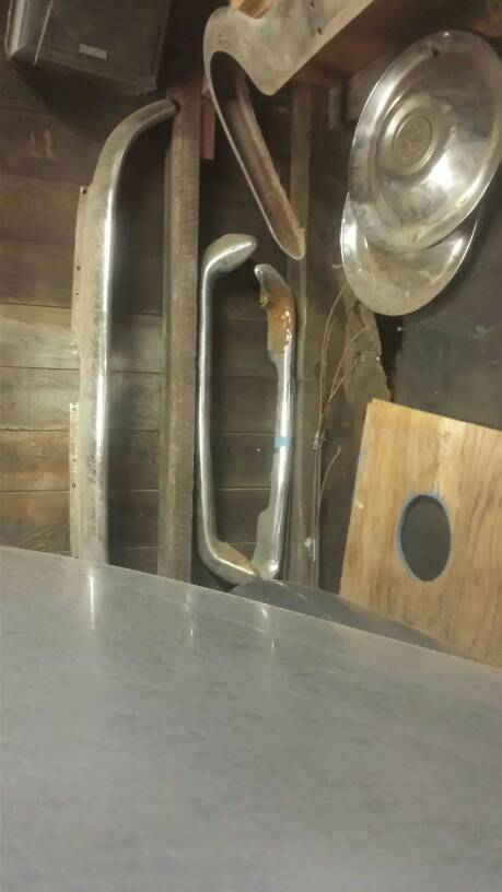

  12. Looking really good Andy! I'm torn on the bumperettes and overrider. I like it the look with and without them. I'm sure which ever you decide it will look great.
  13. hacknwhack
    Joined: Jan 25, 2006
    Posts: 481
    hacknwhack
    from mass
    Im torn on the bumperets. too
    If you must have a bumperett
    Maybe try something smoother.
    How about this one:
    Mid 50s pontiac split bumper centers with small dagmar bullets on each end?
    (IGot a pair on the wall)
    Similar to a keiser overider popular on mercs.

    I think I know who would win that one Shane :rolleyes: . I just bought two dividers and vent window ***emblies from a guy in Saskatchewan up here . Their in great shape , paid $50.00 a piece for them . I never thought of yourself , I guess I just ***umed that you threw out all the stock Buick stuff ! What would you want for the front bumper ? Is it straight? Pictures ?? Mine is tweaked and has a fair sized side impact dent on the right side . I suppose the shipping from you to me would be cost prohibitive for me . It would ship oversize , $$$$ Andy..
  15. aw1950
    Joined: Dec 21, 2008
    Posts: 1,511
    aw1950
    That's a nice looking smooth custom looking piece for sure . It would go well on mine for sure , $$ you would need for that over rider or were you just giving a idea for me . I have a complete 49 Mercury over rider but the bumperette profile does not even come close to the buick bumper profile . My luck ! It would take some ingenuity to reprofile the Mercury to fit . Interested in a trade straight up ?
  16. hacknwhack
    Posts: 481
    hacknwhack
    from mass
    I'll send pics asap

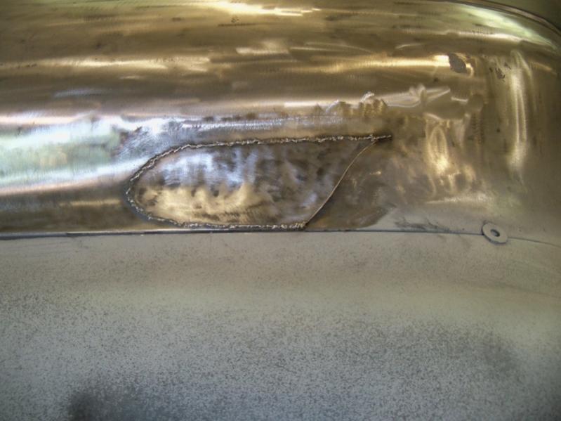

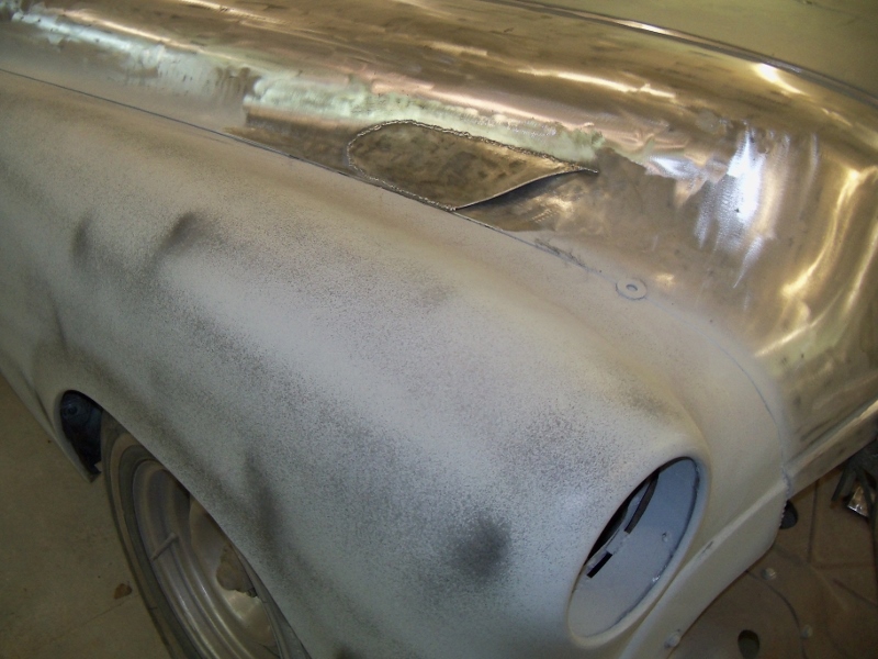

    Thanks Jimmy and Time lord . Hack and Whack has something he wants me to think about in the line of a lower profile Pontiac over rider . I will entertain the thought . In my pics I finished the rough out of the left rear taillight opening . There sure is a lot of work and measuring to get the sides to look even and the same contours . I am a happy camper as my profile gauge shows them to be very close side to side . Never be seen ! I finally jumped in and decided to do the custom scoops on the hood . Thought about it for a few months figuring that is was the only panel on the Buick that absolutely had no need for any kind of body work . So what do I do ? Can't leave well enough alone I guess ! :D I liked the lower flatter style as opposed to the type of scoops that are more vertical . What do you think ? Have a look . Of course it will look better once I get the fibregl*** knocked down and primer on the hood ! Hopefully this weekend coming .

    Ive been thinking about hood scoops also. f cuts pushed in with round stock edges.
    What kept me away was the flex and twist in the hood when opening, (side opening hood, for you non buick guys).
    You got a great solution Andy
    Strengthening vs weakening.
    Also moving forwawd out of the flex zone.
    Brilliant!
    :cool:
  24. aw1950
    Posts: 1,511
    aw1950
    Yeah Shane , when I looked underneath its right over top of the crossover brace . Flexing will be no issue . I will flip the hood over at some point and cut out the metal underneath following the weld line so the vents will draw in cooler air for the engine compartment . Also water and bugs wont get trapped in there either . I didn't use round rod I just made a buck , folded over the leading edge, planished it a bit and called it ready to install . C-Ya , Andy...

    Got a little further along on the Buick today .I couldn't get much else done than work in the garage anyway as we were dumped on with more of the beautiful white stuff . 4-5 inches to say the least . Anyway enough of that ! I blocked out the side scoop and I will put it to primer tomorrow. Earlier I had started to chemically strip the hood . Aircraft stripper spay bomb works some good on the 63 year old paint / primer . I then washed the hood with navel jelly and washed it down with soap and water . Some smooth , the hood is nearly flawless which is nice considering its size . The car will be likely, a very dark color( A dark burgundy , like a nice bottle of merlot , or a very dark green , like a midnight teal metallic ) ( Don't know if I am ballsy enough for a black paint job :rolleyes: )Regardless those colors will work very nicely with the two tone crème interior that is planned !
