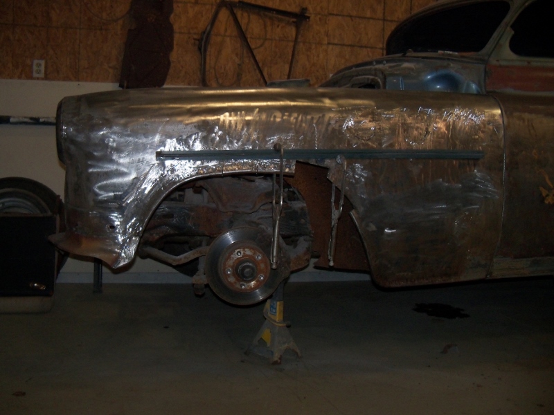

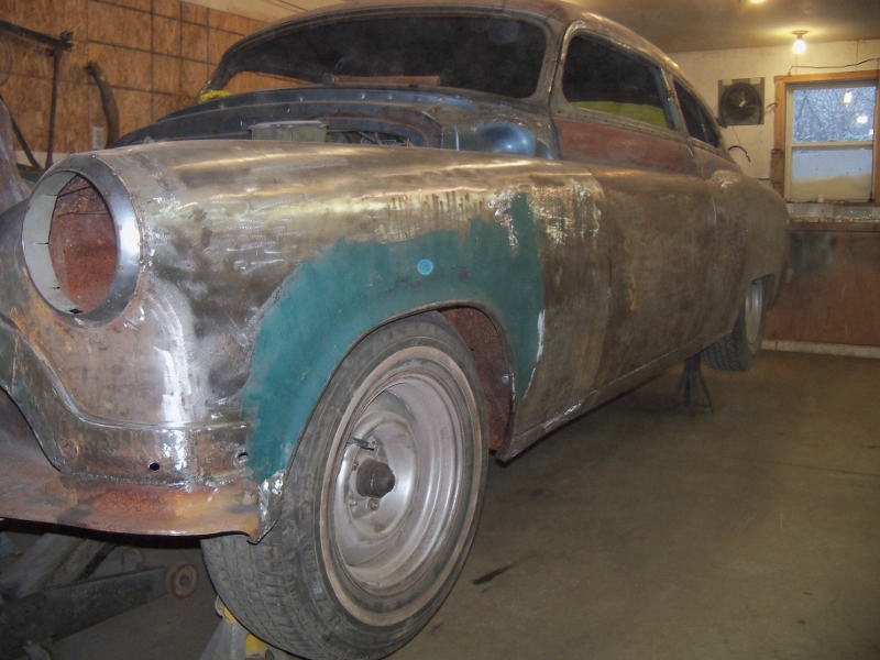

    Well I am not proud to say but this fender is kicking my *** . It had previously been hit in it's former life and hammered back into good enough shape . Fast forward and now I am trying to lower the arch opening and I filled the portholes . In that process I received a big *** low spot from heat draw and the older damage .What you see cut out is the offending drawn metal that was causing the issues (I think) LOL! . The bar you see is there to hold a relatively straight line to the fender . I beat and pounded on this ***** until I had to walk away and leave it for another day . Anybody been there ? I am sure I am not alone . Started working on boxing over the frame . I guess as it turns out that's the first picture . Got this far with it and called it a day . Have a look . This **** takes forever ! Andy..

  5. Andy, what do you mean by "heat draw"? sorry for the novice question.

    No problem Dave . When your welding , as the weld cools the area has a natural tendency to shrink (draw in) . That's why you see videos of guys hammer and dolly their work area that they just finished welding .My issue is that the fender being previously damaged, already had tension in the fender . I compounded this fact once I cut the fender apart and welded and ground on it . All that tension let out and caused the fender to oilcan , bad .This can occur if you are to aggressive with a grinder as well .
  7. Thank you for the explanation Andy. It's interesting how your current work affected prior repairs from years ago. So how would you fix the "oil canning"?

    Well Dave I am going to cut most of the lip off that I had altered .This will remove the biggest cause of the shrinking. Hacknwack here in the HAMB ( Shane ) has ponyed up some Buick wheel arches he cut from a 53 Buick ( Thanks again Shane ). He sent them to me last week and I am expecting them on Monday or Tuesday at the latest . I will trim them and fit them to my fender . Go slowly and methodically to reduce any potential of warpage . Stay tuned Dave .

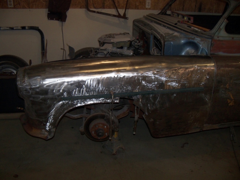

    Thanks be to Shane for the save on my front fender . I installed the fender lip he sent me to get me out of my jamb. 53 Buick fender lip he had cut off doner fenders at some point . Last two pics are showing the floor all welded up one is way over exposed, sorry. Getting closer to rotisserie but I have the cruiser skirt and chop to finish up on this side before that happens .

  12. hacknwhack
    Joined: Jan 25, 2006
    Posts: 481
    hacknwhack
    from mass
    Glad it worked out.
    And saved some time and grief..
    Did you get less warpage this time?

    Thanks again Shane . Very little warpage as most of the stretched metal on the old lip was on the lip itself . As mentioned earlier it had been hit pretty good on that side at one time and it was bent to begin with . My limited skills in working metal back to normal come shining through . So your donation was a Godsend ! I like the cleaner smooth look of the rockers as well . I did make them a little wider @ 3.5 inches as opposed to 2.75 inches that were on there . Andy..

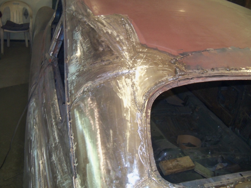

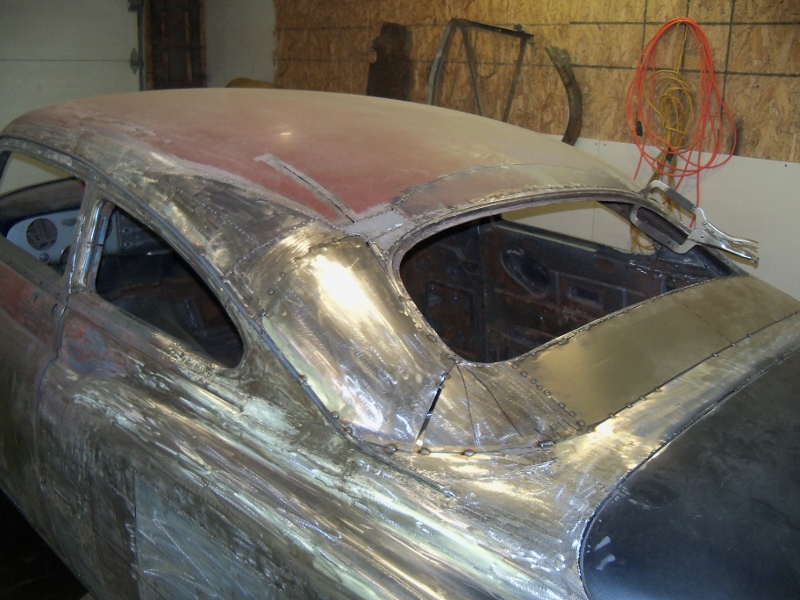

    I have been plugging away as time permits . Have the door top back on the drivers side. I have installed the drip rail . ( 3/8 CRS) Filled the last part of the catwalk and a few other places . In the process of finally trying to close in the sail panels I come to realize the back window needs more slope , to me anyways . I lost 1/2 the width of the rear catwalk area and the window is now laying @ 25 degrees instead of 16 degrees that it was . I like the look a lot better . It flows from the roof on down to the catwalk more fluid . Have a look ! Still plugging away in the great white north . Nothing else to do, seeing that we have gotten 13 feet of snow since the beginning of January . PISS ME OFF ! Andy...

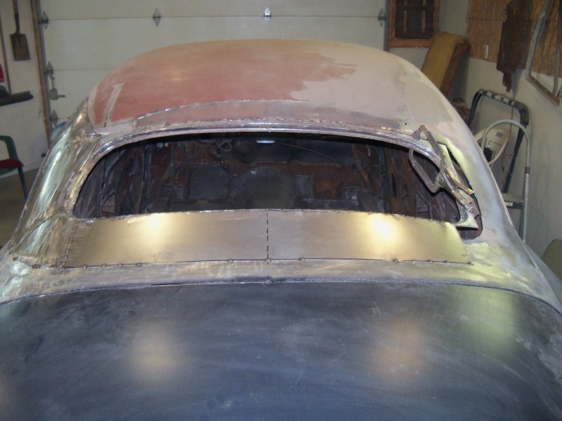

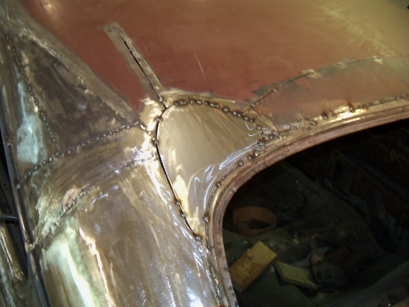

    I had more time today . I wheeled up this panel to fill the sail panel area . I cut out the old and worked in this here panel . You will notice that I ended up cutting it to get it right . I am really liking the flow of the window . I cant wait for fabrication to end on this car . I am driven to see this through to the end .. Andy..

    Well moving along on this adjustment . The angles were wrong . Witnessed by the first picture . I cut out the whole area . Wheeled up a new piece and commenced to weld it in . A little grinding left to do then onto the other side . I know the pictures all seem the same but there are slight changes none the less . You may have noticed some subtle changes as well. I am getting the alignment slits all welded up as well . I think if its nice out ( Sunny Saturday ) I am going to roll the car outside for a new profile shot of the car we'll see . Andy....
