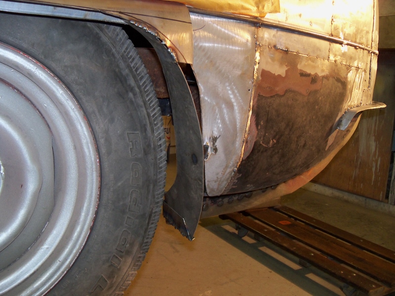

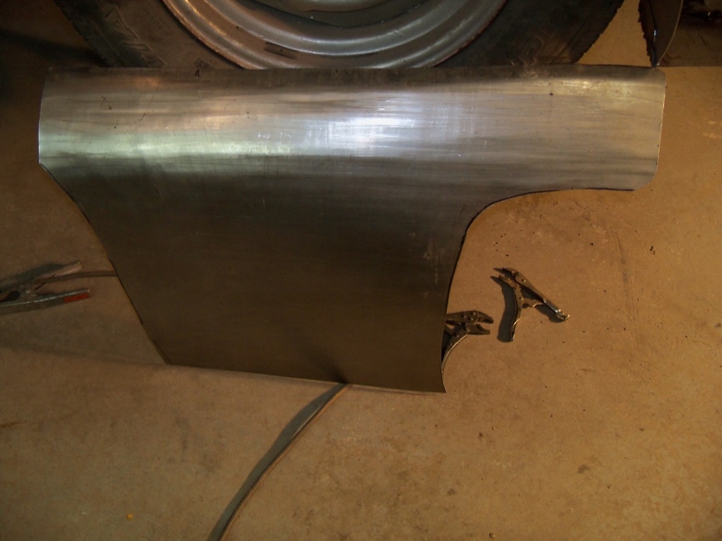

    Moving forward on this skirt for the drivers side . 5/16 CRS and 18ga. sheet metal . Wheeled up the first panel moving rearward . For more detailed description look up Cruiser skirts A to Z here on the HAMB . Thanks for your interest all , Andy..

    More progress but not as much as I would have liked . Oh well better days ahead . Andy..

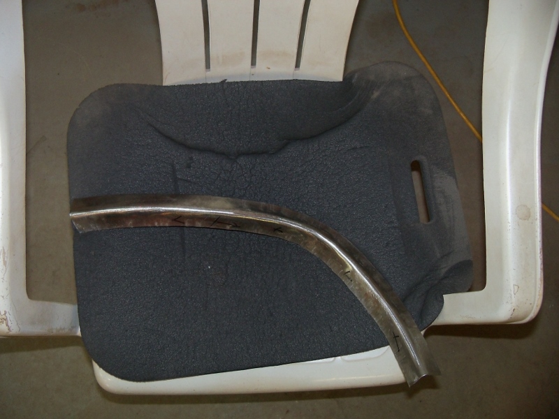

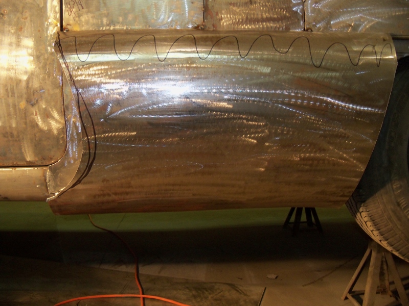

    More progress in closing up the driver side of the car and building the cruiser skirt . Made an exact duplicate of the other side out of paper . Lots of measuring , and attempting to mimic the right side. This gives an excellant guide as to what your after in regards to duplication of one to the other . As you can see even through that process I am still off at the front of the wheel house . That don't matter none as this will be covered by the transition part of the skirts anyways . It's just, will my OCD allow me to leave it alone ?? Time will tell . I wheeled up this here panel as well . I have to shrink that discolored area that you see there as there was a slight bulge that developed there . It's not to bad though . I was attempting to build all in one piece but a man needs to know his limitations ! Andy...
