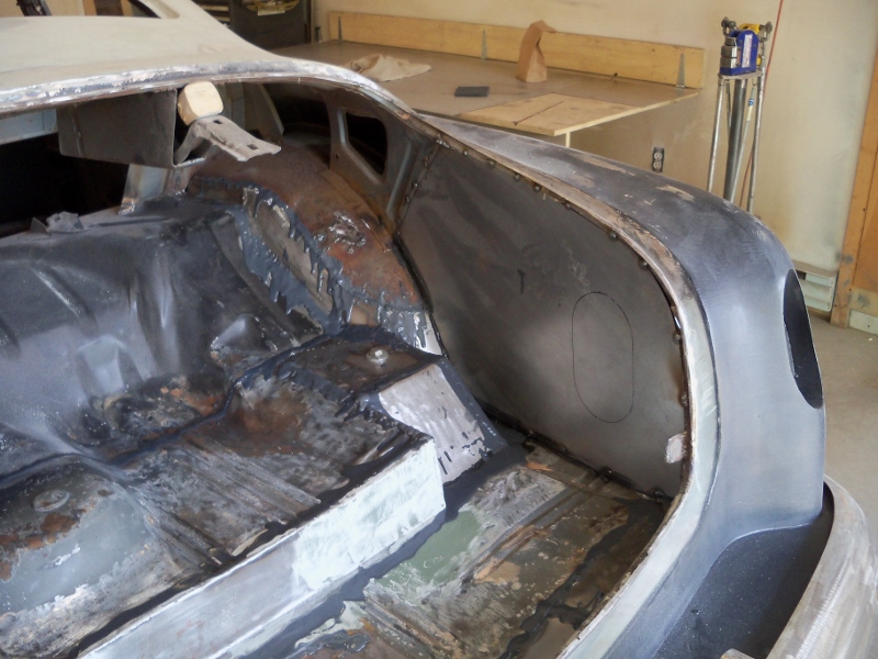

    Been at it since July 24th . Trunk is all tied in . I opted to make a left and right side panel . I will cut out the access panel that you see identified by the marker outline . This will give me access to bolt the taillights in and install the drain tube that allows the water to escape at the back of the frenched taillights . The grey you see is seam sealer . Tip for anyone following along . Buy a can of brush on seam sealer . Get a separate container , old pint can from a previous paintjob what ever . Scoop some out , reduce it with reducer say 30% by volume and take a hardware purchased paint stirrer and attach it to a drill . Whip it up until it is runny but not to as it wont hold any kind of shape . You will know when you get it right . If it's to runny add more to the mixture and whip it some more . Vise versa if it's to clumpy add more reducer . Pour it over your joints . It self levels and has a more factory appearance to it . You see in my pictures I have not yet painted over the sealer areas as I want the reducer to be able to evaporate before top coating it . 12 - 15 hours to fully flash off and then your good to go . It will flow into voids just like factory and will seal things up nice and water tight . Put the POR 15 to it , and your ready for Dynamat or whatever your want to do with your floor . Me I think I am going to go with some truck bed spray liner . It can take some wear and tear . Of course it will get all covered with carpet anyways .
    Andy...

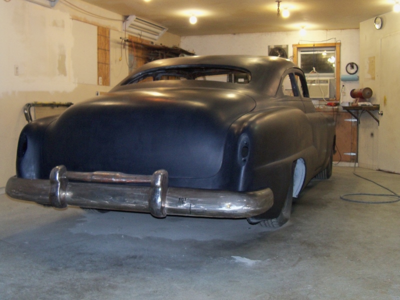

    These pictures give a better idea of the car without the distraction of the primer soak . I am starting to get a little more excited . If all continues to go well , next summer will be a lot of shakedown runs . Fix what needs fixing and then onto paint that winter . Andy..

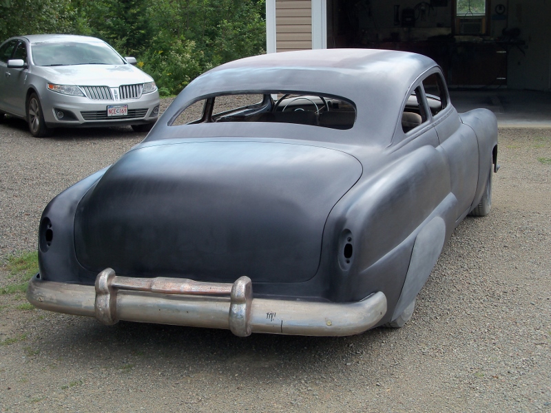

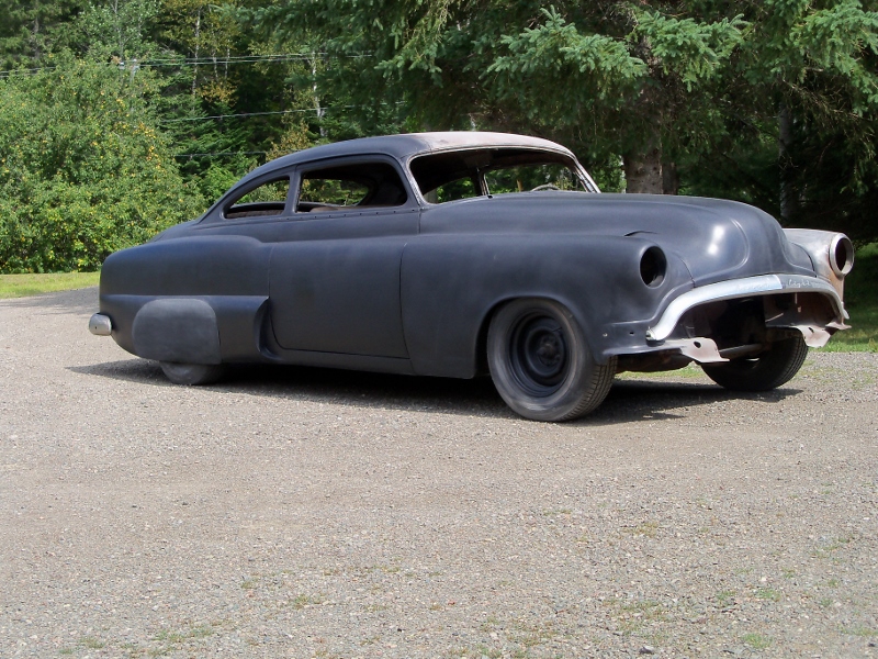

    Finally got the car pushed outside . What a difference it makes other than the shots in the shop. Still a little rear rake and the full round flowing lines are starting to take shape . What do ya do when your in a build ? Start to blow it apart again . This time to hook up some steering so bay moves are easier . I will be doing an off topic paintjob in the next week or so , so I have to switch the Buick to the other bay . have a look . I am pleased with what I see so far ! Andy..

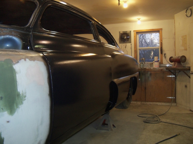

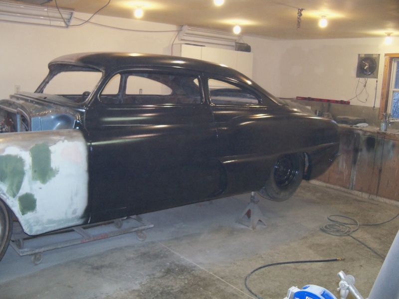

    Well after 2.5 months I finally have something to show for my effort . The driver side is starting to pull together as well . This is 5 minutes after I shot a coat of epoxy primer . Shiny cause it's wet . Good chance to see how straight that long quarter panel is . It looks good to me . Lots of block sanding ahead once I get a good coat of high build on it . Still have the front fender to work on . After that its then time for some more fabrication , IE seat risers , steering , mounting brake booster and master cylinder , pull engine , get onto the firewall geesz and that's just to name a few . I am sure you guys know what I am talking about . These lists are endless it seems . Have a look ! Later , Andy..
