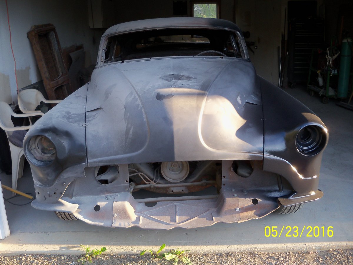

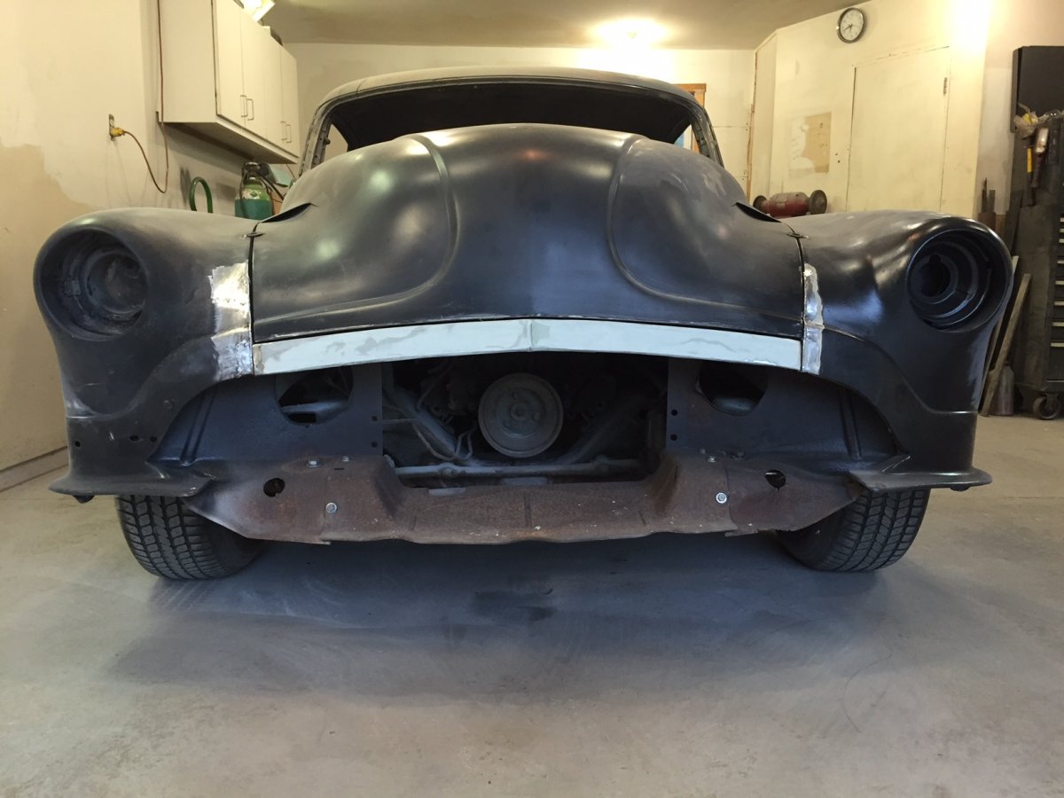

    Here is what I am up to at the moment when I get a minute . Filling in where the Buick Eight mustache trim used to reside . Kustoms is all about changing up a stock appearance so this is the first step . Built a frame first and then I skinned it . There will need to be lots of massaging of this panel to get it right but in the crude form I believe you get where I am heading . Andy..

    Will the hood gap be at stock height or will the hood be welded and extended downward to the grill opening?.

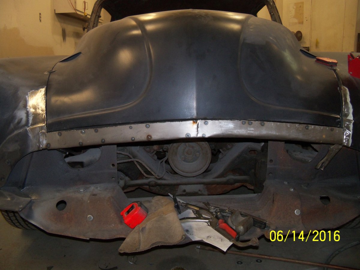

    Hey there Shane ! The panel will be bolted to each fender . This will facilitate setting fender / hood gap . So you could say it is a header panel . The gap at the hood to new header panel will be 3/16" . Later man , Andy...

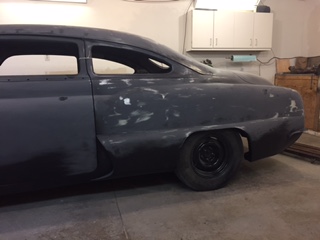

    Upon much consideration I have come to the conclusion that the static height in the rear was to low . Put a couple people in the back and 16 gallons of fuel and it would be an**** dragger . Compromise was to fabricate 2 new coil spring hats that moved the body up 2 1/4" . 1 piece of pipe 2" ID to fit over the receiver pad on the differential and then a 2" OD pipe slid into the larger pipe . Welded all around and then made a pad that the pigtail end of the spring sets on . I left another 2" of pipe that you can see up into the spring that you could easily put spacers on to raise the car more if need be after some of the tension leaves the new coil springs . Over all the car sits better , it's more level front to rear . Hard to tell in the picture I know but maybe a new side profile shot in the near future . On another note I have something new coming for the car that you will have to wait on . Picking it up tomorrow . A big thanks to Koolkemp in advance of tomorrow ! Do I have your attention yet LOL !!

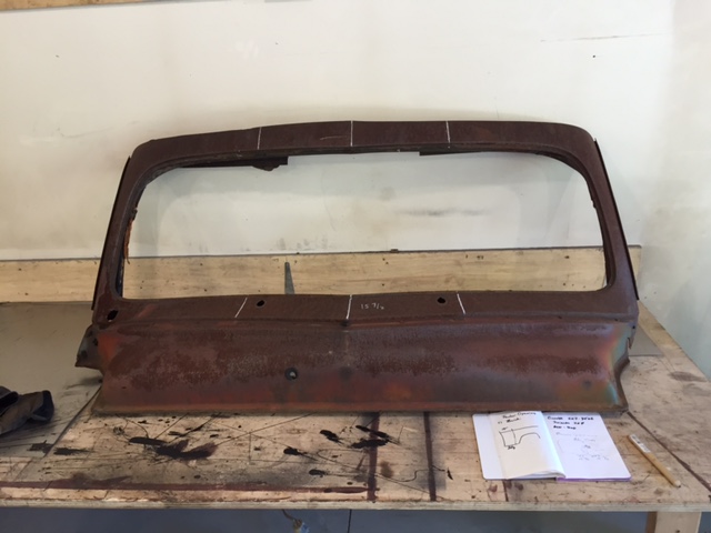

    Well this is what Koolkemp brought me up from Nova Scotia . A 49 Mercury windshield opening for my Buick . It's a lot cheaper going with templates for flat glass such as the Mercury's than potentially paying 450.00 for a new windshield , then have it cut and possibly crack it at the local shop , or me , trying my hand at it and breaking it myself . Anyway , that's what custom car building is all about . Taking from one cars design and applying to your current build . Obviously the second photo is of a Thunderbird back seat that I picked up today as well at a local swap meet . Initial fitment looks good . I will have to fabricate a center divider for the space between the two seats . Not that big a deal !

    header panel.jpg Finally was able to squeeze some time today and finished up the header panel . This is bolted to the fenders with 1/16" washers in between acting as a spacer for the time being . I will eventually put some welting in between. If you are looking at header and see something is outta wack on the left side you would be correct and I will address that small job later . . No pictures but I was ab le to move onto mounting the front seat . This will take some engineering as well . You will see in the coming weeks as I dig into this aspect of the project . Need seat in place before I install the swing pedal for the brakes . Everything has to make ergonomic sense .

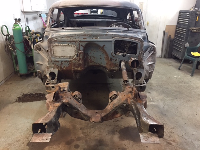

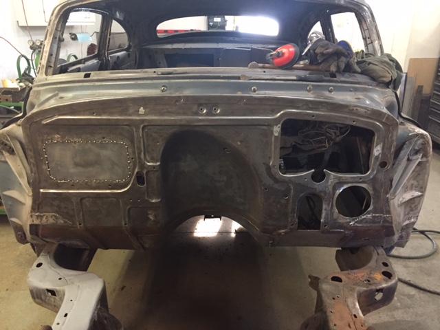

    Well it's definitely been a long time since I have been able to touch the car but my wait is over . Made short order of blowing the front sheet metal off the car and stripping it to frame . I am off tomorrow and will spend my day in the shop . I want to wire wheel the frame . Prime it and hopefully get to the firewall and start the process of filling unnecessary holes . We will see how far I get !!! Andy...

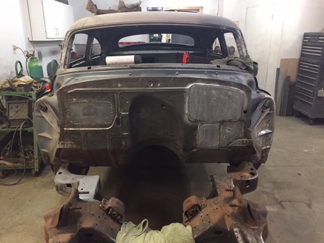

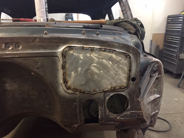

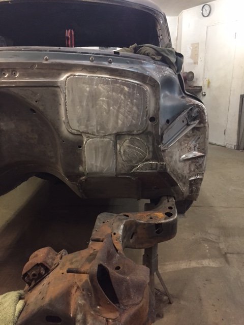

    Big gapping hole is now gone . I used 10 gauge sheet for the area that was an access point for the back of the dash . This area will be accepting the master cylinder / booster shortly and needed to be quite rigid to reduce flex of the firewall . I will cut a new hole for the steering shaft shortly as well ! Little bit at a time !
