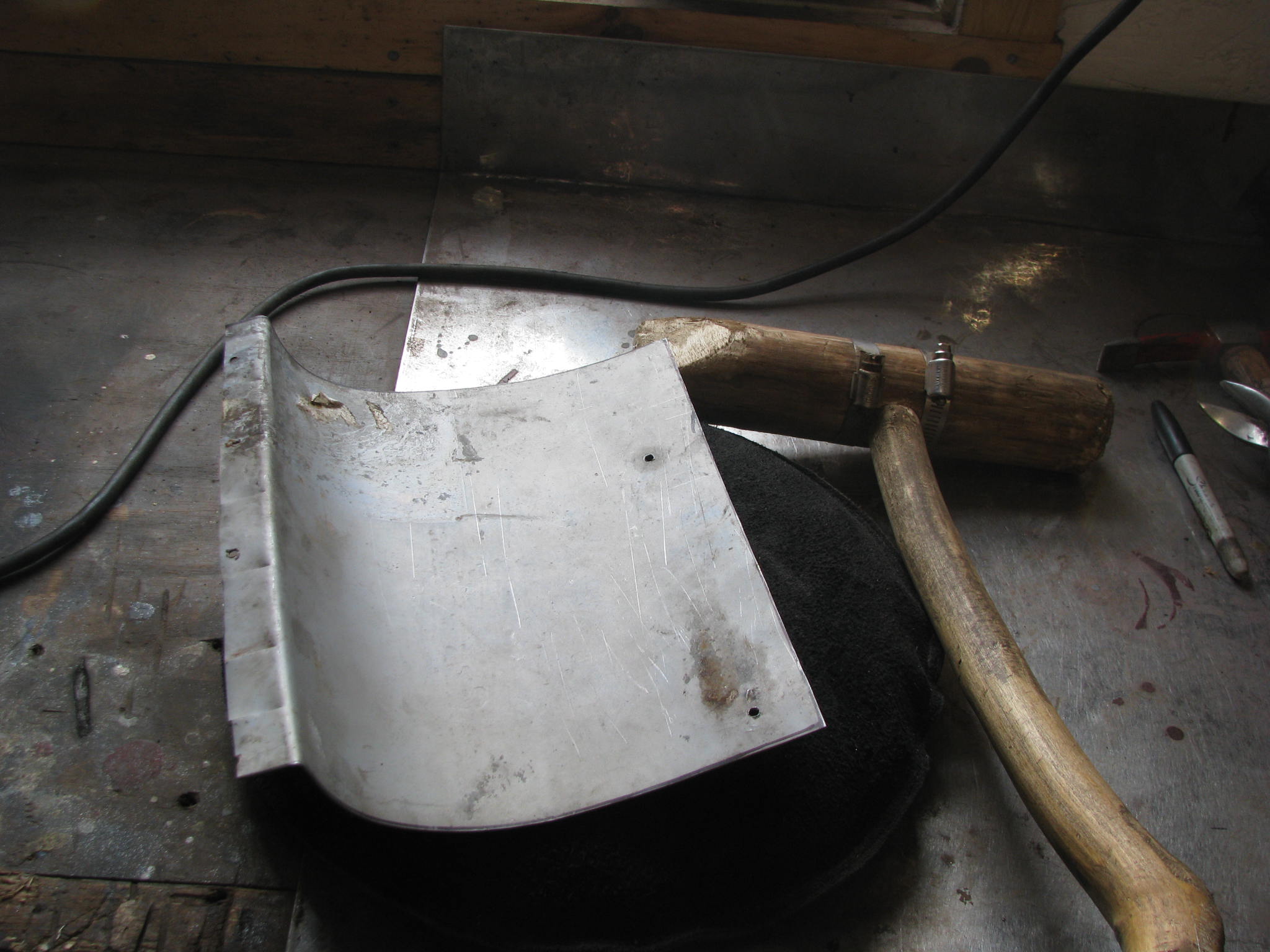

Have some more for you thread junkies . Picture 1 is a piece of sheet metal that is representative of the inner wheelhouse to quaterpanel reveal line . Pic.2 is the wheelhouse repair starting point . This will be cutout and a new piece formed for that area . Moving to the 3rd pic we have the panel ready to be welded in place . 4 welded but not trimed yet . 5 shows that I need a big panel made for this area. Next is the roughed out panel needs more shapeing though . Last is the panel clamped in place . Once this is welded I need to make the bottom part of this panel . That piece will have to duplicate the yet to be made quaterpanel outer skin . This in turn will be welded by spotwelds around the wheelhouse lip . Thats it for today the wife says playtime over .
Thanks boys for the words of encouragement . Brerhair I made that hammer in about 30 minutes and it sure works a piece of metal into submission quickly . Later !!!

Screw the ba*****t! Thats some nice work you did on the inner fender well that no one will ever see except us! I'm going home and build me one of those hammers!
