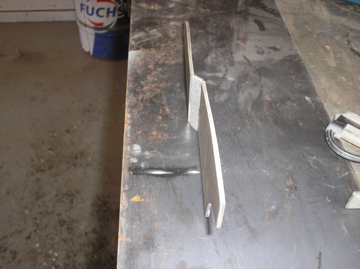

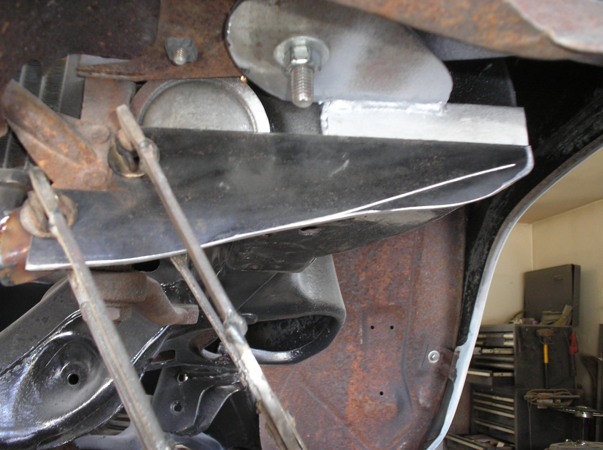

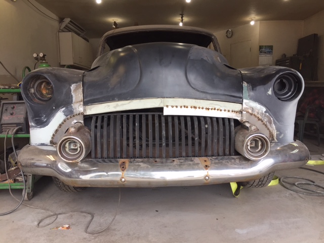

    Have done some more, along with more blocking . No sense posting that tedious stuff , but be****ured its coming along even though I not posting much . Small project this week end , as the wife owned my**** . Not much shop time due to a room needing painted in the house . I am sure you have all been there LOL ! These few pictures are of two plates I fabbed up one I hat to make a 9/16" jog in it so it would transition from the frame to the rad support properly . I decided to weld them onto the end of the frame instead of bolting and I also welded the plates right to the radiator support . I have all new frontend parts arriving Monday or Tuesday .This will change things as the car will be a roller again .

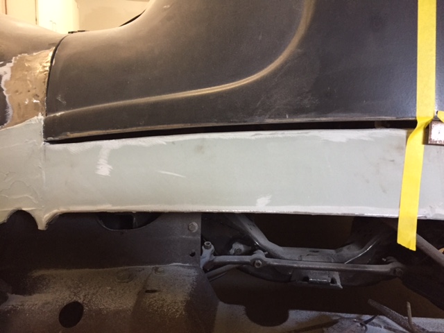

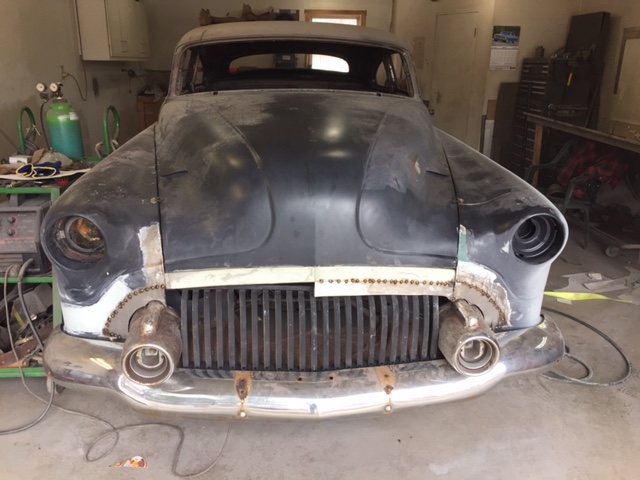

    Was able to fabricate the filler pieces and the header panel cross over . This ties in and cleans up the front for sure .

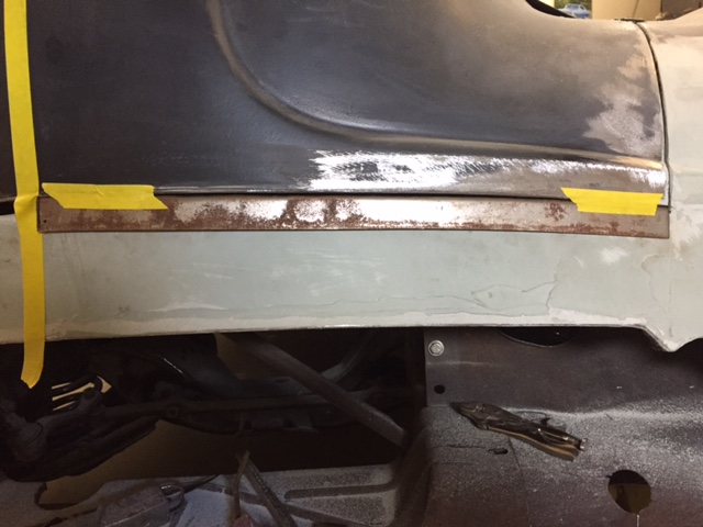

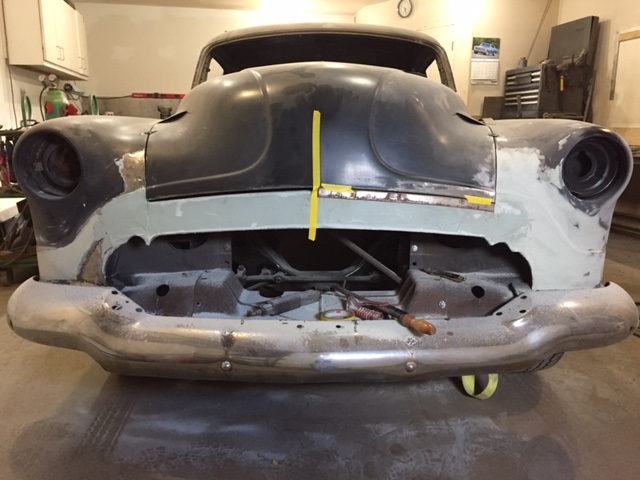

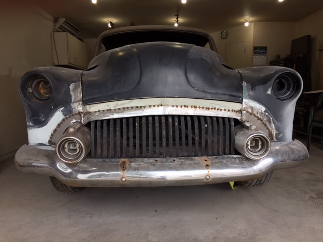

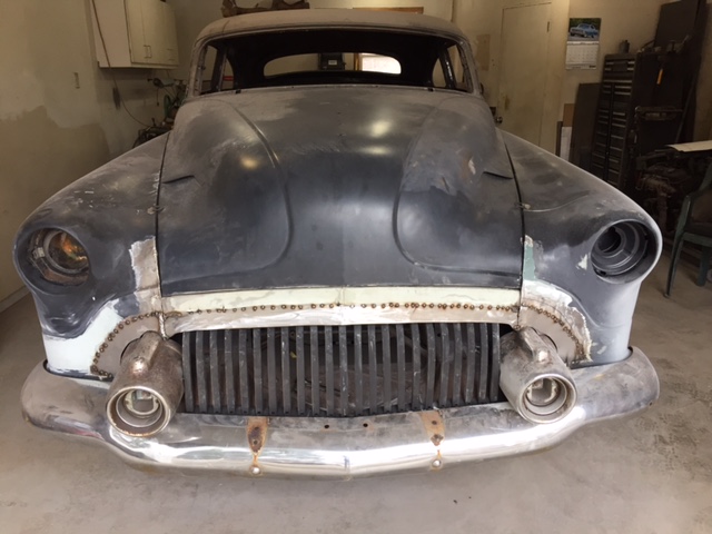

    Hood gap 2.jpg Hood gap1.jpg Need opinion on the gap . I am contemplating having the hood close down over the header panel . The 1st picture shows a nice tight gap . This will be welded in and is not indicative of what the final look will be . The new leading edge of the hood will overlap the panel . Not sure if I like the look !! What say you ?
  20. Hey Andy, I'm no expert on this but I think having a gap would look better than an overlap. My $.02. Loving this build!!
    koolkemp and LONG like this.

  22. aw1950
    Joined: Dec 21, 2008
    Posts: 1,511
    aw1950
    That's the way I am leaning as well Dave . In my mind it was good but once mocked up I am not so sure . It kinda looks odd ! I will let it rattle around a bit more . Lets see what Shane has to say after a day of thoughtful reflection LOL !!!

    I agree...and don't forget to round the corners too ! You probably don't have enough body work left to do lol!

    Geez , stop thinking of more***** to do would ya ! Seriously though, I have thought of it but decided against as I don't want to mould everything as one piece at the front . You know the piece removed from the hood becomes part of the fender. And it goes on and on . Just more work than I want at this time .

    I'm thinking you should leave the gap. With the current style you have going.
    Without an upper grill bar, the lip would just stick out. Not really smoothing things out.
    If you did ad an overhanging lip, I would think it would need to be extended into the fenders.
    The other option would be to delete the gap by extending the hood all the way down to the grill opening.. then adding a quarter inch round stock bead along the upper grill shell. Creating a little shape.
    I like the ideas you have framing in the signal housings.. however the lines viewed from the sides look a little flat.
    I have a 51 upper bar that's rough and could be moulded in and painted. If you need one and decide to go that route.
    In the end it's yours do it your way..
    I'm guessing you have been looking at customised mercury grill shells.
    My 2 cents.
    Cheers Andy
    Sent from my SM-G920P using Tapatalk

    Extend hood into 1 piece.
    Flush with fenders.
    Sorry no photoshop... big fingers little phone.
    Sent from my SM-G920P using The H.A.M.B. mobile app

    Thanks for your thoughts change the header panel that I made basically holds the two fenders in place and yes the hood still opens left right so that long deep hood extension although looks neat is not practical . That said , I will leave a gap as I think that is the best look .

    Yeah.. wasn't sure if you had changed the hood hinges.
    Without that mod .it just won't work.
    Leave the gap.
