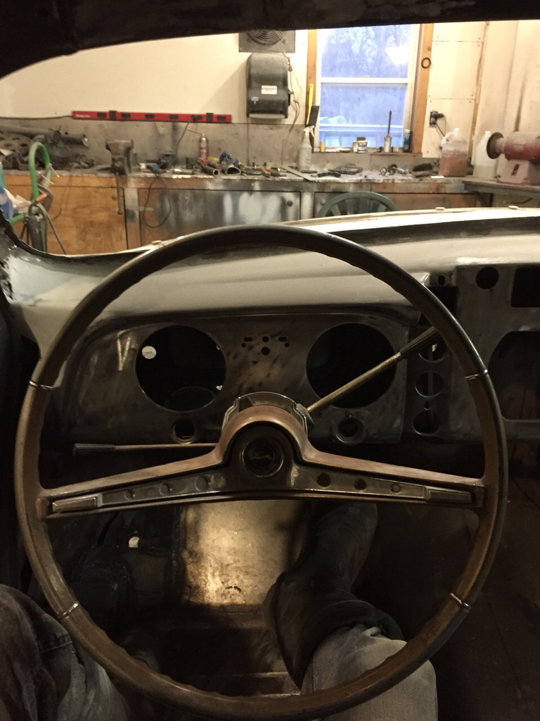

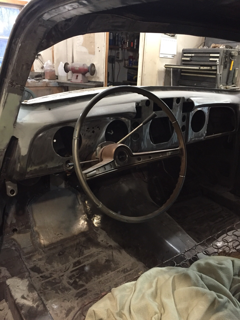

    [​IMG][​IMG] Here’s a couple shots of what’s happening . I now have the column in place . Some of you may think big deal but others know that that is a big hurdle , fitting newer stuff (1962Impala) in my case . Lol ! Maybe just maybe ? It will turn a wheel this summer . 1st week of May off for a weeks holidays . That will be a big move forward ! Here’s hoping .

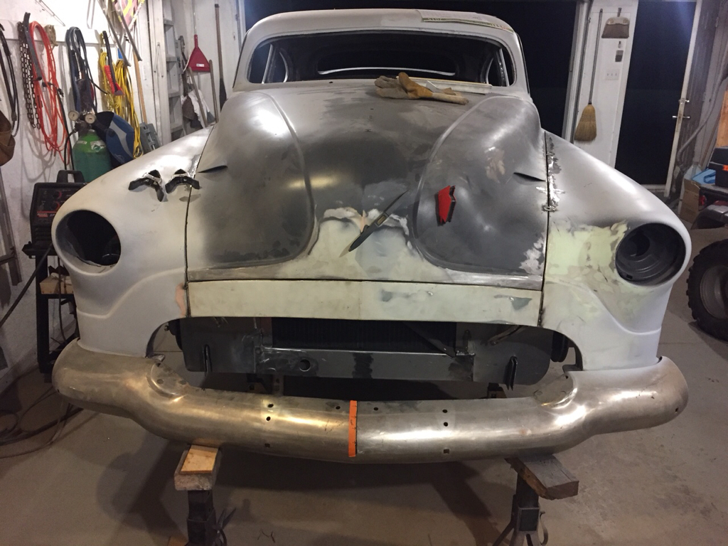

    Coming along a little , have to trim the bottom transition plate a little and do a fold over for strength . Then mock up the grille and front bumper .

    Some more progress on the Buick . Have the gaps set and am in the process of welding up the new fender support sheet metal I am constructing . I still need to louvre this piece but that comes later . Pretty hard to get time on the car but here and there gets stuff accomplished .

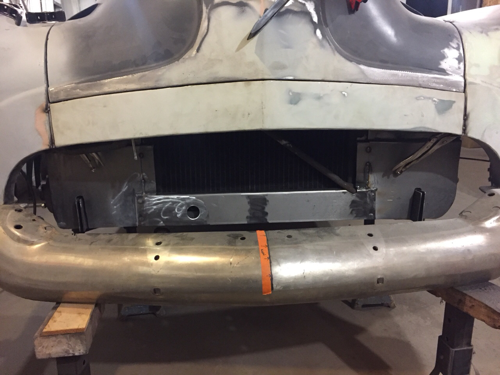

    Thanks guys for hanging in there . I know this is a long drawn out build but life has a way of sending this to the back burner . On the last few items to deal with as far as fabrication goes . Mocked up bumper so I can make new bumper mounts . Next will be inner fender fabrication .

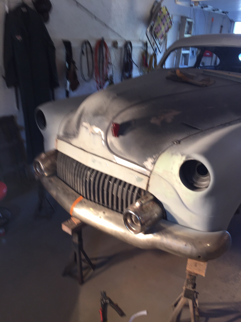

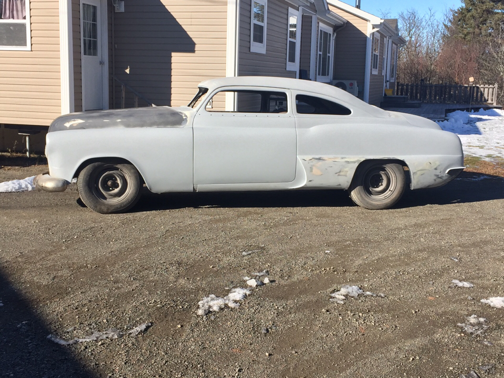

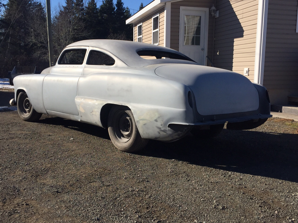

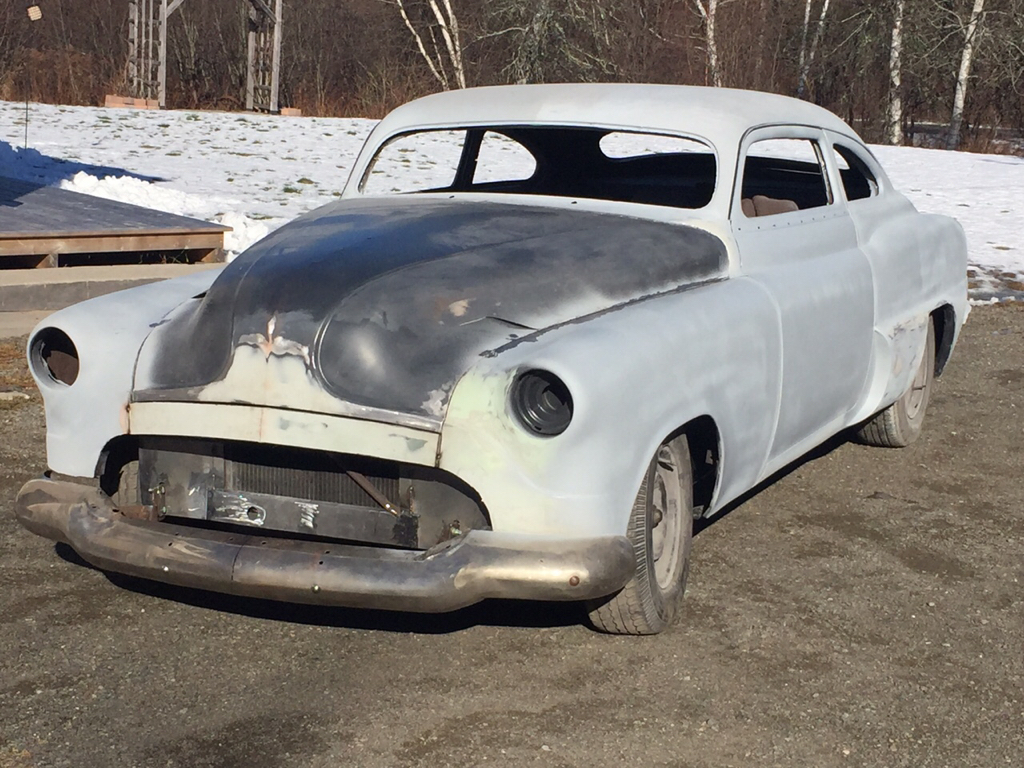

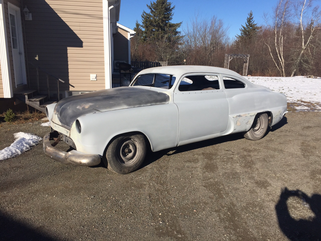

    First time out in daylight for a few months . 80 % mock up complete . I think it’s stance is dialled in just about right . Profile is good . Front tires are a little tight but these are 7" rims with 215 /75/15 . I will replace with 6" rims and 205/70/15 . That should correct the potential for rubbing issue up front on turns . Now if things returned to normal ( Whatever normal is LOL! ) I could get some more work done [emoji57]

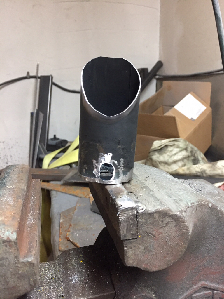

    I recently was able to get 1.5 hours in on the car . Went from nothing there to a frenched antenna in a hour and a half . 2” muffler pipe , weld bottom , opened a drain hole and a hole for mountain an antenna . I like using VW Rabbit antenna as they are compact , work good and retract into itself easily so nobody can mess with it .

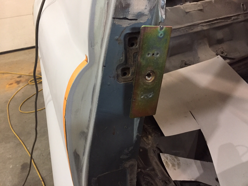

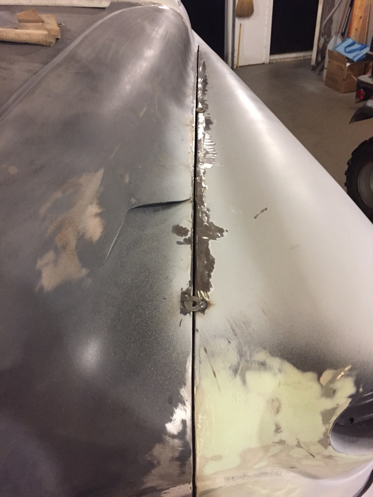

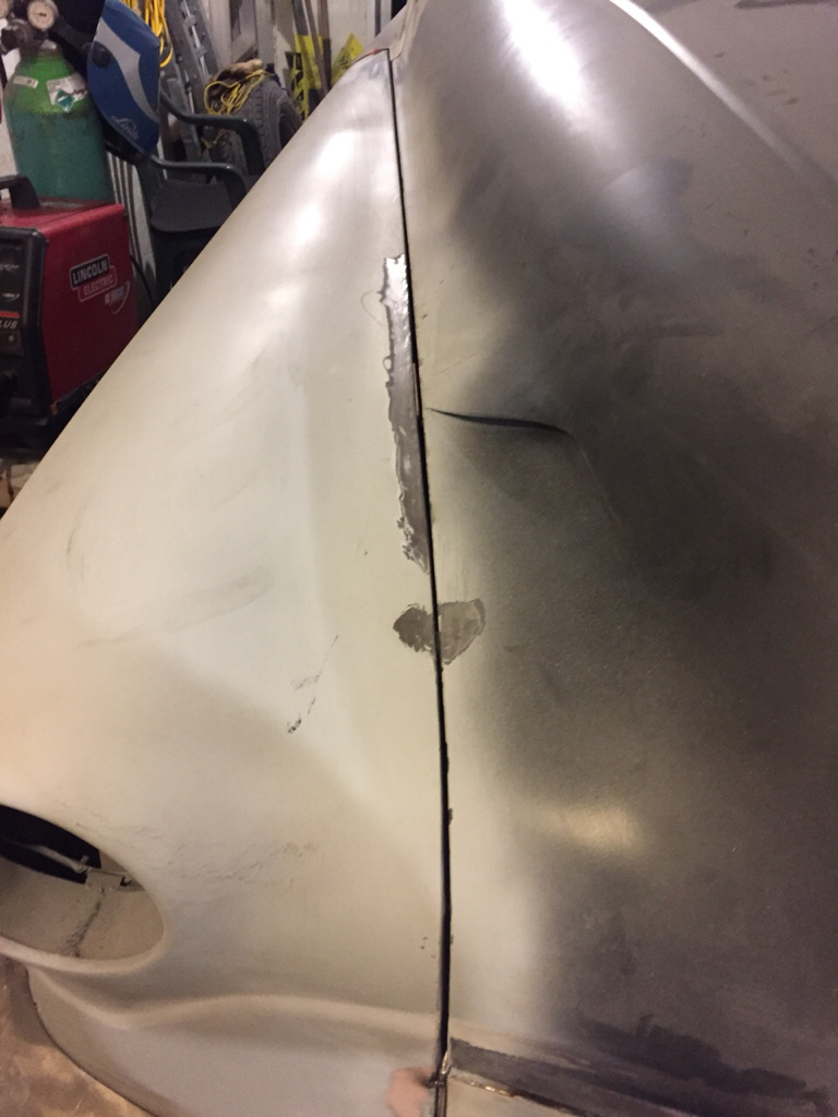

    Still picking away . Got both bear claw latches installed , just a couple of progress shots . Also , sometimes you have to take a do over . Was trying to set up the grille ***embly and the front fenders weren’t working out . So 10 minutes later the front sections were on the floor . I had two spares ,cut off what I needed . I will run stock openings this year and French them out next winter . I have to move on I want to drive this thing this summer . 9 years this August , time to drive it finished or not .

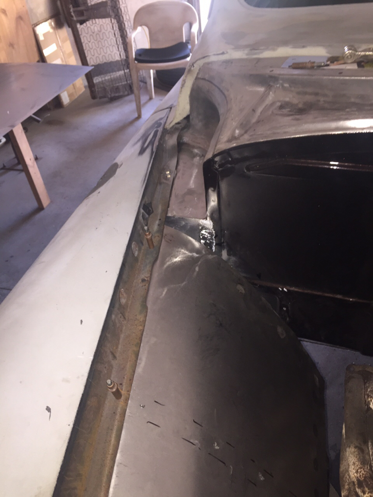

    If anyone is still checking in once and a while I am still plugging away . Been on my back for the last 6 weeks tying in the wheel houses and going overboard with the under neath of the car . I know whose gonna see that . I’ll feel better about it . These pictures should tell you what I am up to at this time . Bought a fuel cell for the car and am in the process of cutting it in . It will be half sunk under the floor . Stay tuned , getting there .

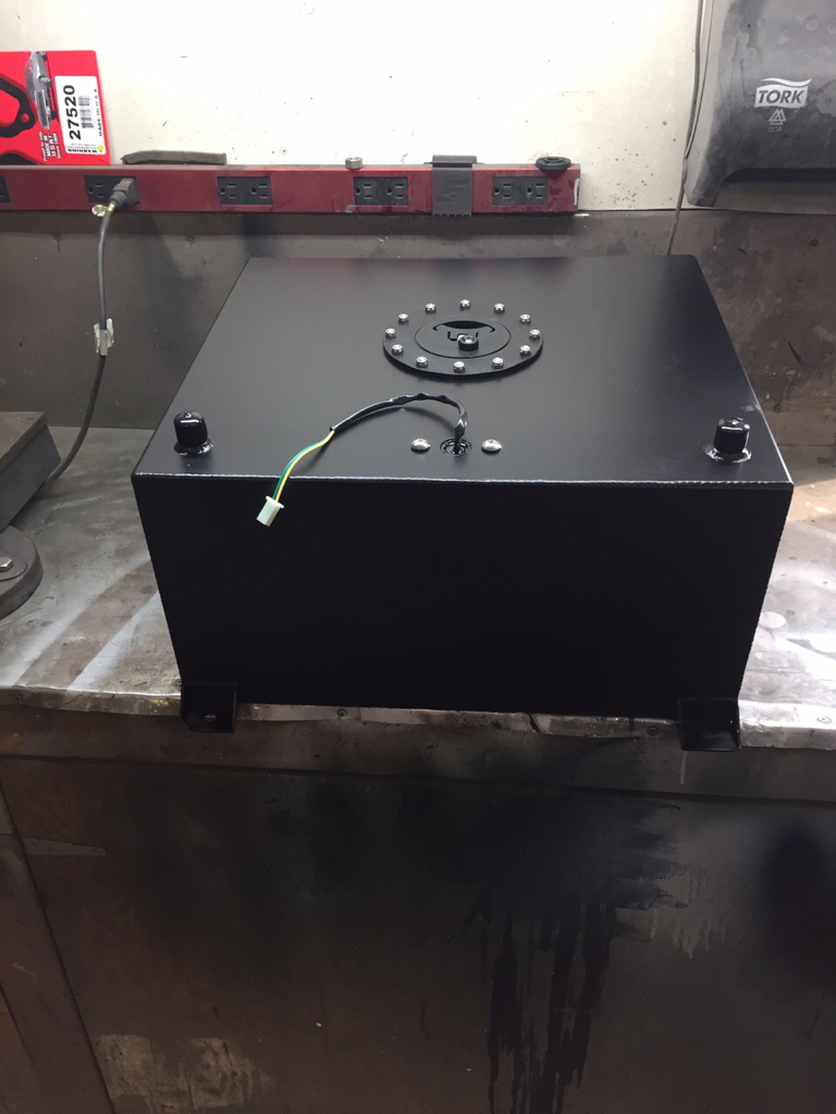

    All mocked up , I have it fitting with very little gap around it but enough to seal with seam sealer to avoid exhaust fumes and keep it from chaffing on the sides of the tank . I will be welding up mounting bracket next .

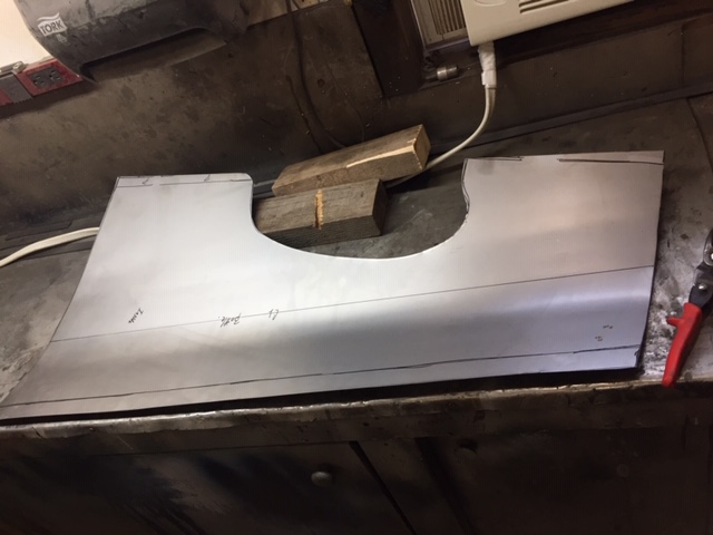

    [​IMG][​IMG][​IMG][​IMG][​IMG]

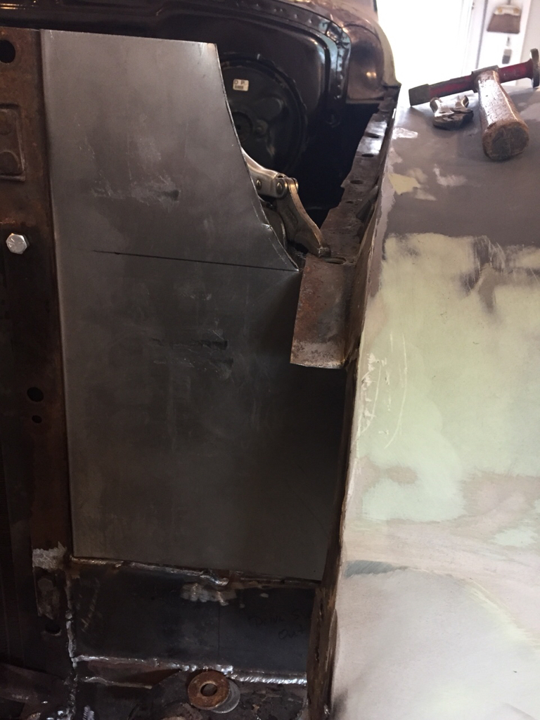

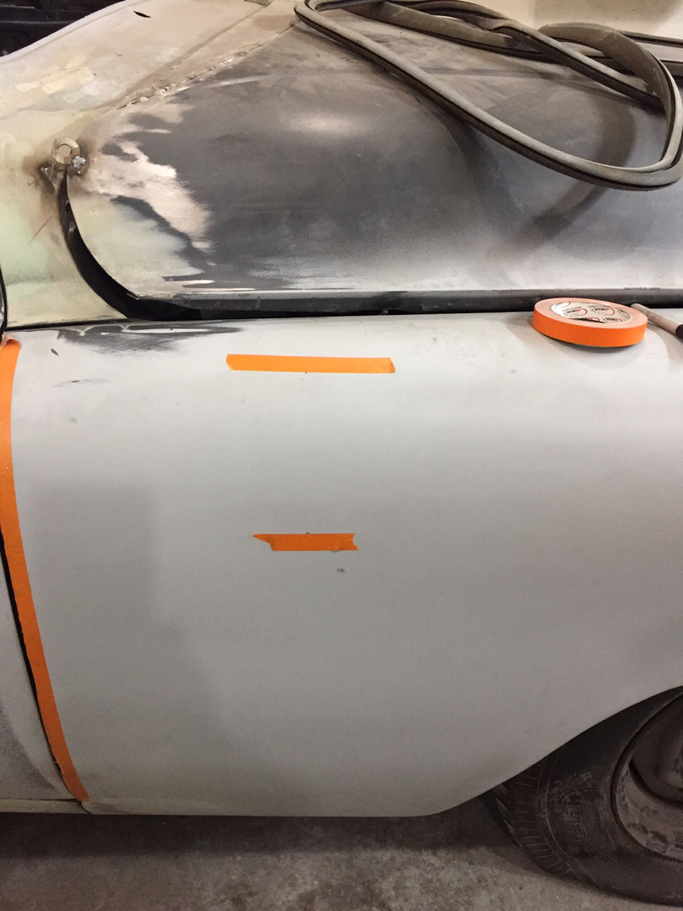

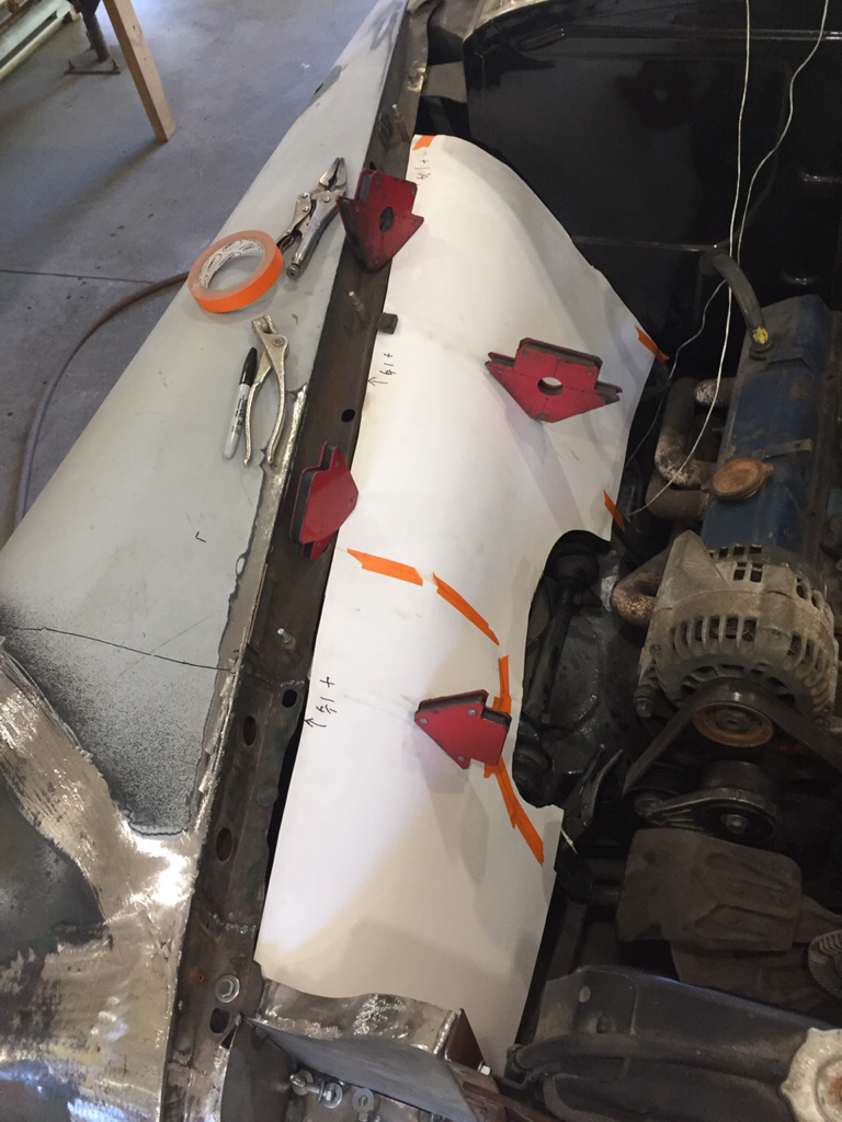

    From pattern to sheet metal . Inner fenders getting there

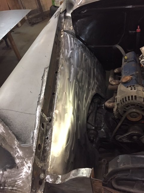

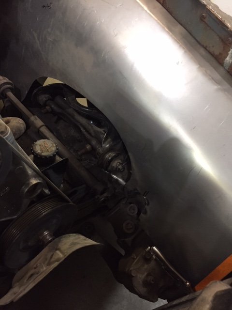

    [​IMG][​IMG][​IMG][​IMG][​IMG][​IMG]

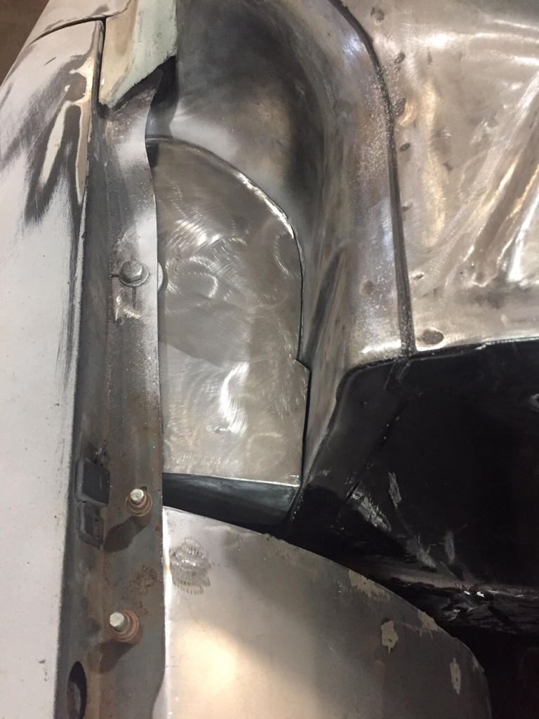

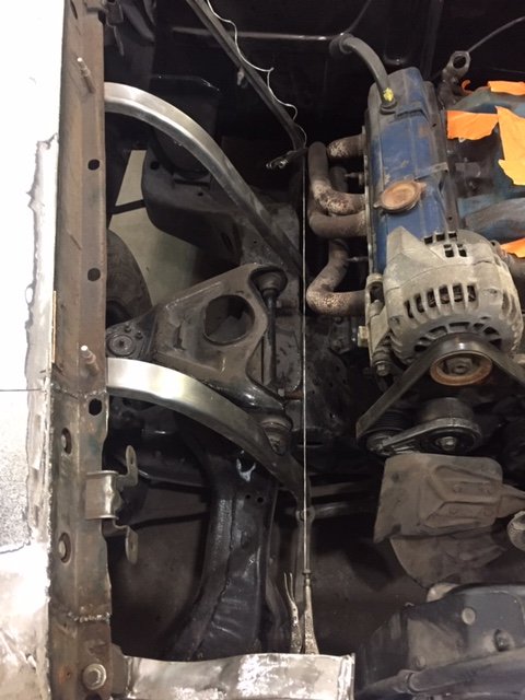

    Able to get a few hours into the inner fender fabrication today . Finishing off a void that looked out of place under the hood back corners . Getting some braces up under the inner fender , not pictured but using 1” x 1/8” flat bar . Screwed the paint up some so will have to paint parts of firewall again . Maybe opportunity for a color change . Not sure about the root beer brown . IDK !!!
    Hivolt5.0 likes this.

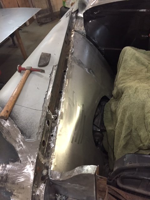

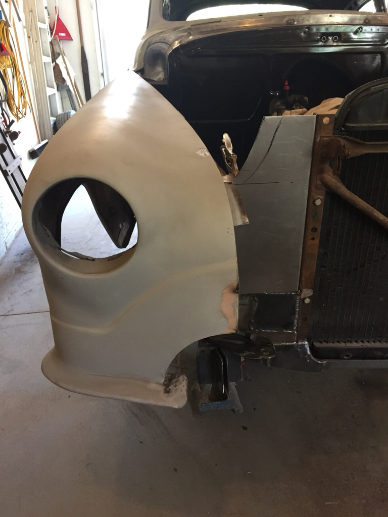

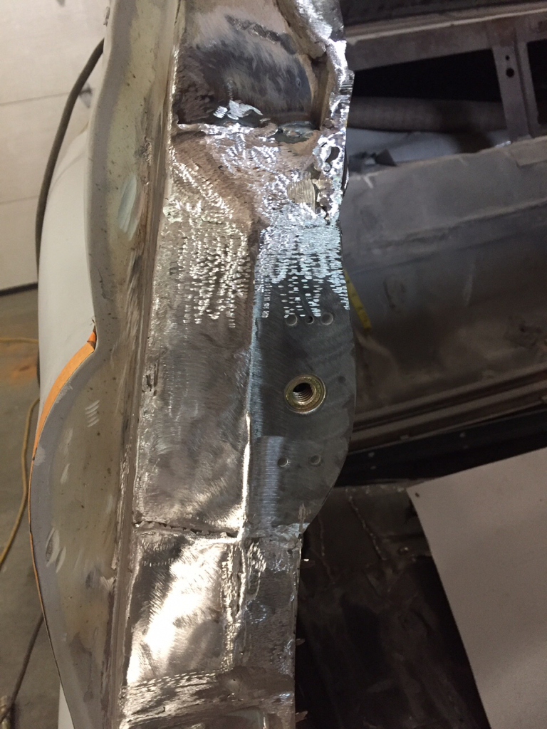

    IMG_1555.JPG IMG_1556.JPG IMG_1558.JPG IMG_1559.JPG IMG_1560.JPG IMG_1561.JPG IMG_1562.JPG View attachment 4387125 View attachment 4387126 View attachment 4387127 View attachment 4387128 View attachment 4387129 View attachment 4387130 View attachment 4387131 View attachment 4387125 View attachment 4387126 View attachment 4387127 View attachment 4387125 View attachment 4387126 View attachment 4387127 View attachment 4387128 View attachment 4387129 View attachment 4387130 View attachment 4387131

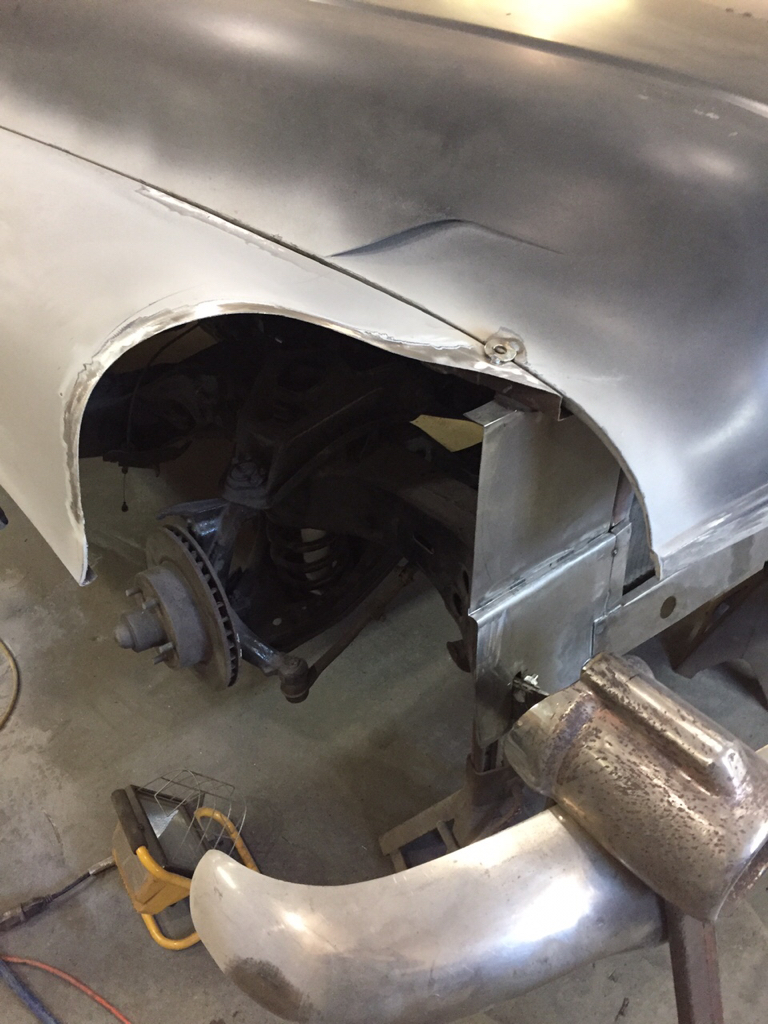

    On holidays this week , am able to get some time in on the car . Was able to finish welding up the entire p***enger fender and inner fender . That side is pretty much tied in . On to the drive side and progressing nicely . Starting to weld in a access escutcheon for the power steering return line . another 8 hours and this side will be ready for body work as well . Slow but sure , still going .
