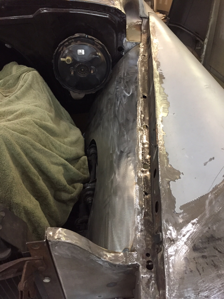

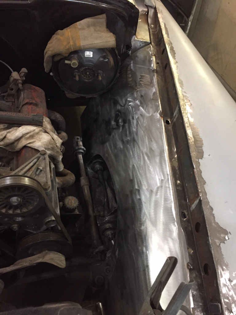

    [​IMG][​IMG][​IMG][​IMG][​IMG][​IMG]

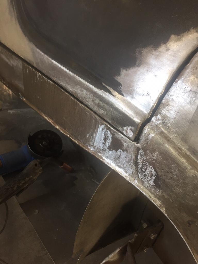

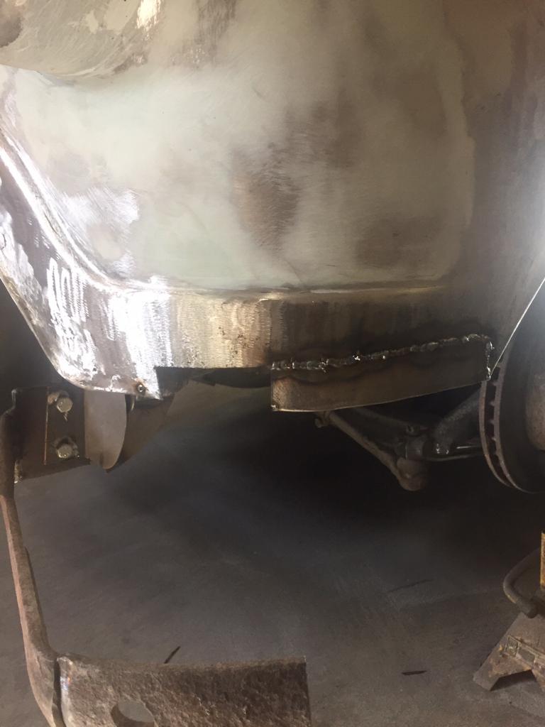

    Still getting after it . Finished up the power steering return relief . Welded up and ground the welds on the inner fender to fender transition points . Also laid up a pattern for the inner panel as well. This will keep water and dirt getting thrown back onto the front edge of door and back of fender area . Figured id weld everything all together , what the hell , my car my way .

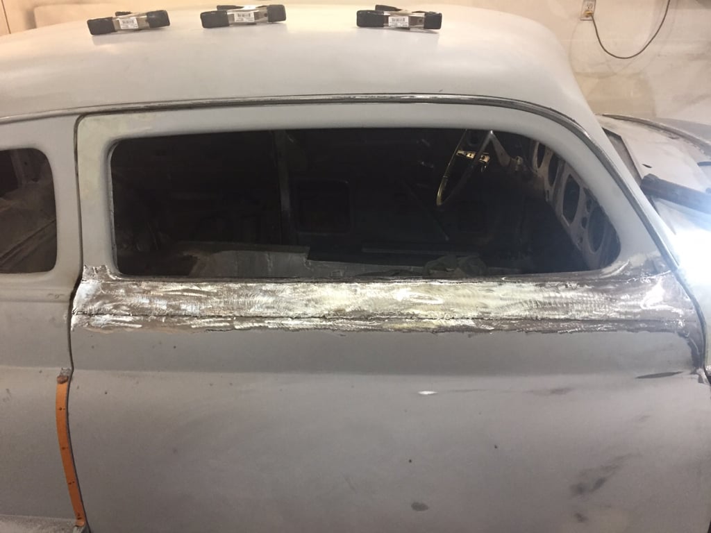

    So , if anyone is still hanging on to this thread what your looking at in the 1st few pictures is 40 plus hours of hood aligning and getting proper gaps . Running beads of weld along fender edges to correct gaps . These Buick’s have 4 hinge mechanisms that have to work integral with one another. It was a ***** to get right . Also decided to remove beltline nickel as well . It wasn’t going to work for this build . Last photo shows the effect quite well . Kustom all the way !

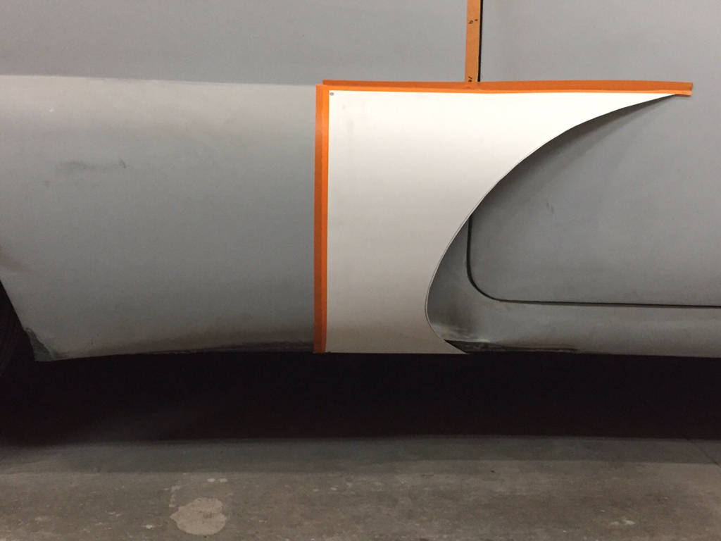

    Now , being the type I am , never satisfied until I am , this is the next part of this long puzzle . The quarter panel needed , in my opinion , to flow into the door some . What do ya think ? Metal work to commence later today .

    ^^^^^^ I like it.

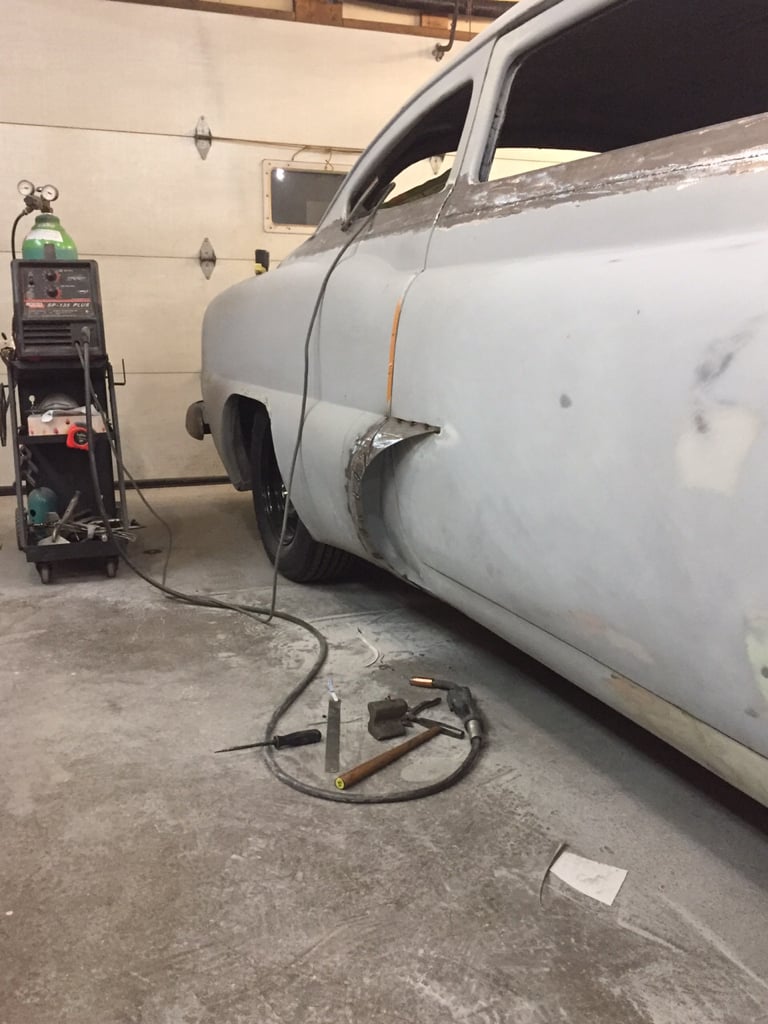

    As mentioned, metal work started so this gets addressed! Still another day of fabrication at this point but heading in the right direction !!

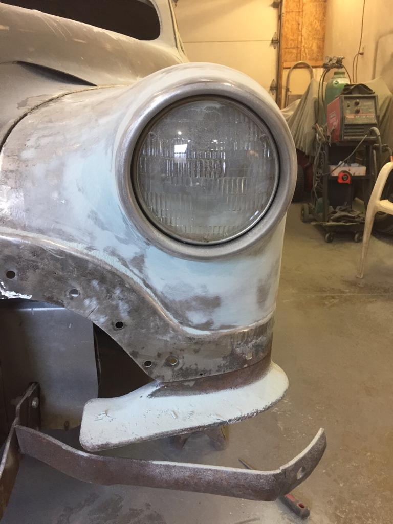

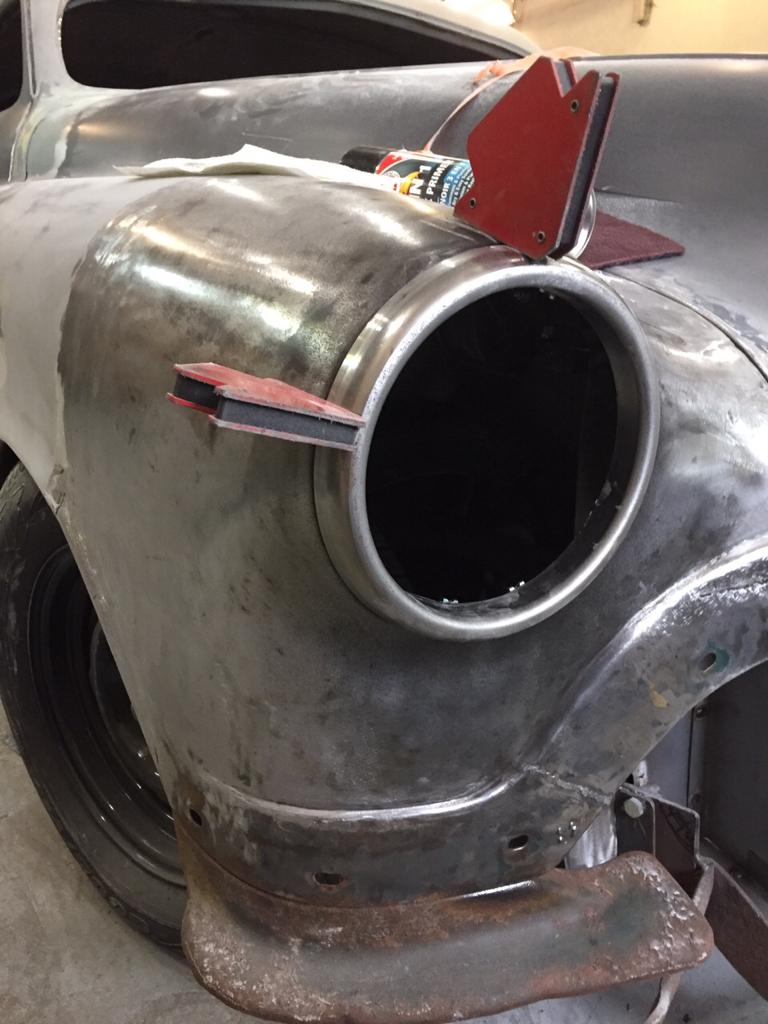

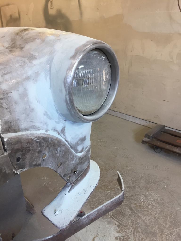

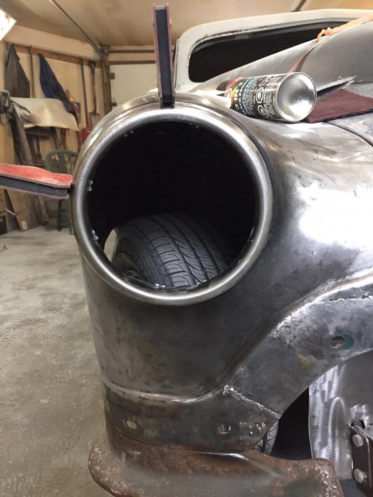

    Update , picked up rings from Jeff Spence. Modified them to have a deeper frenched effect . Coming along , off next week so I should make big progress . Stay tuned

    [​IMG][​IMG][​IMG][​IMG][​IMG][​IMG][​IMG][​IMG]
    Found more rust , go figure , part of the process . Both French rings done , and I added a 3/16" flange that runs from fender to fender that fades away into the fenders . You will see it better once we get into primer .

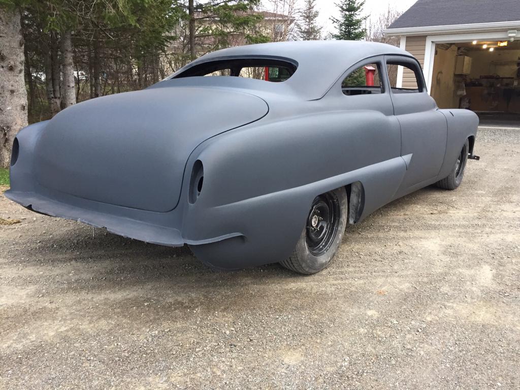

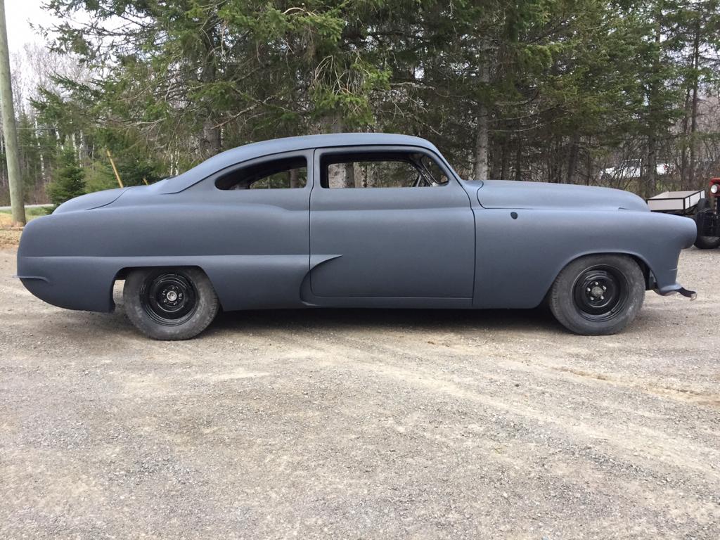

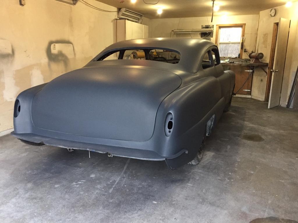

    Well here’s where I am now , exterior 98% complete , just a few minor issues . Now out with the engine , reshoot the firewall in final colour , on and on and on , you get it ! [​IMG][​IMG][​IMG][​IMG][​IMG][​IMG]
