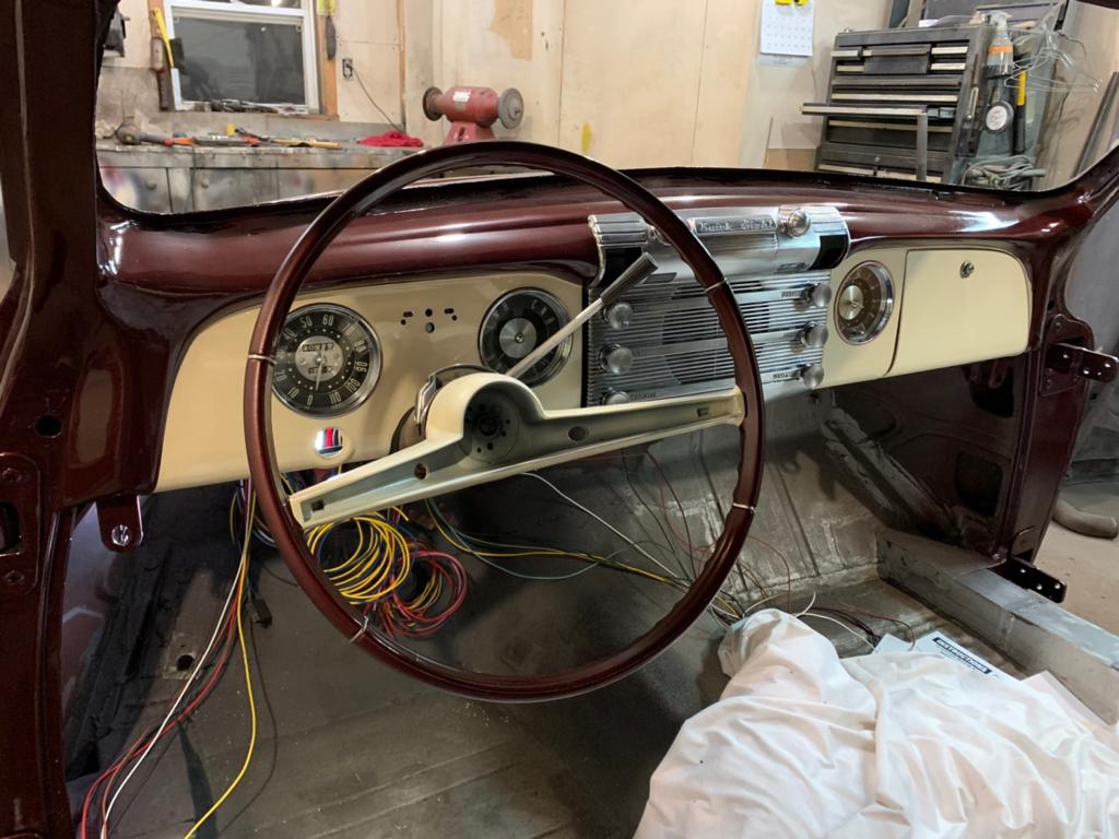

  11. BJR
    Joined: Mar 11, 2005
    Posts: 11,370
    BJR
    Looking good. Buicks have great looking dashboards.
    aw1950 and loudbang like this.
  12. aw1950
    Joined: Dec 21, 2008
    Posts: 1,523
    aw1950

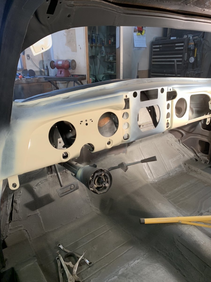

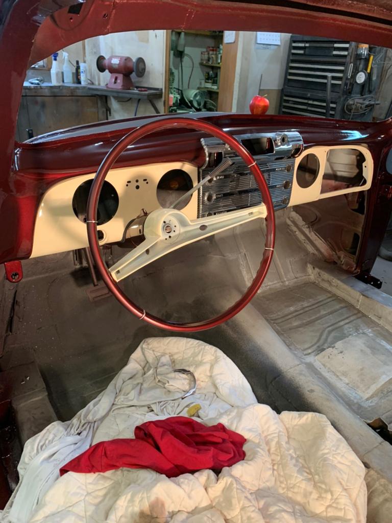

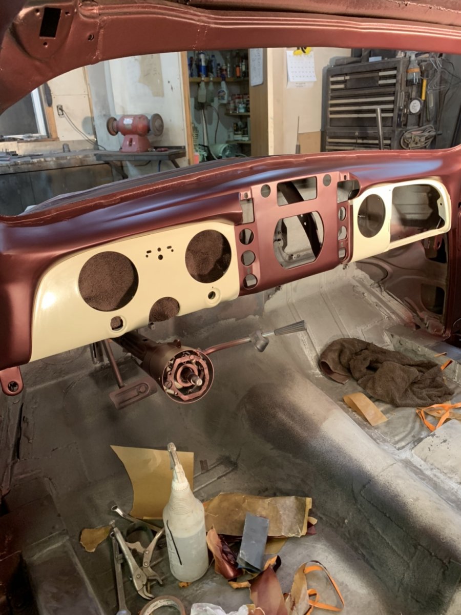

    A little more detail , steering wheel two toned , and the grill insert cleaned up some

  13. aw1950
    Posts: 1,523
    aw1950

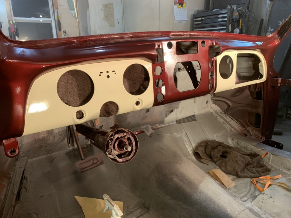

    Dash complete

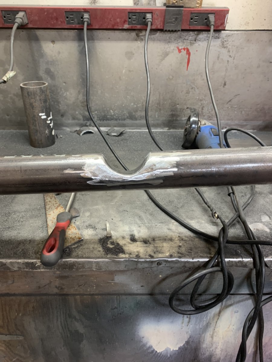

  14. aw1950
    Posts: 1,523
    aw1950
    Getting at it still , had to notch my trans crossmember for clearance. Without it my exhaust would be susceptible to road rash

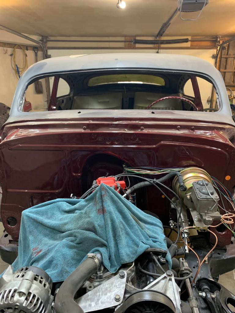

  15. aw1950
    Posts: 1,523
    aw1950
    She’s a runner now and one side of the exhaust is complete to the differential

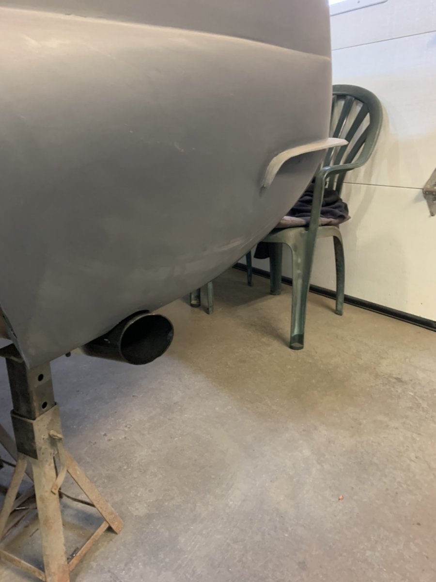

    Dropping the exhaust out the side at back of quarter panel . 30 degree flute 3” dump pipe . I might sink it into the body some more yet say another 1/2"!

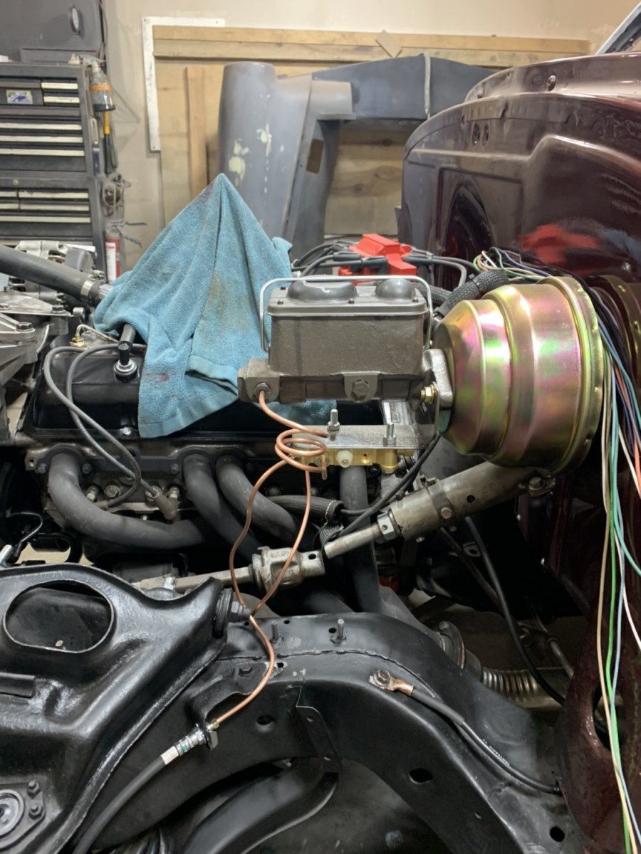

    Getting it knocked out , front end all together , brakes are mounted and plumbed , just gravity bled at the moment. Getting there !

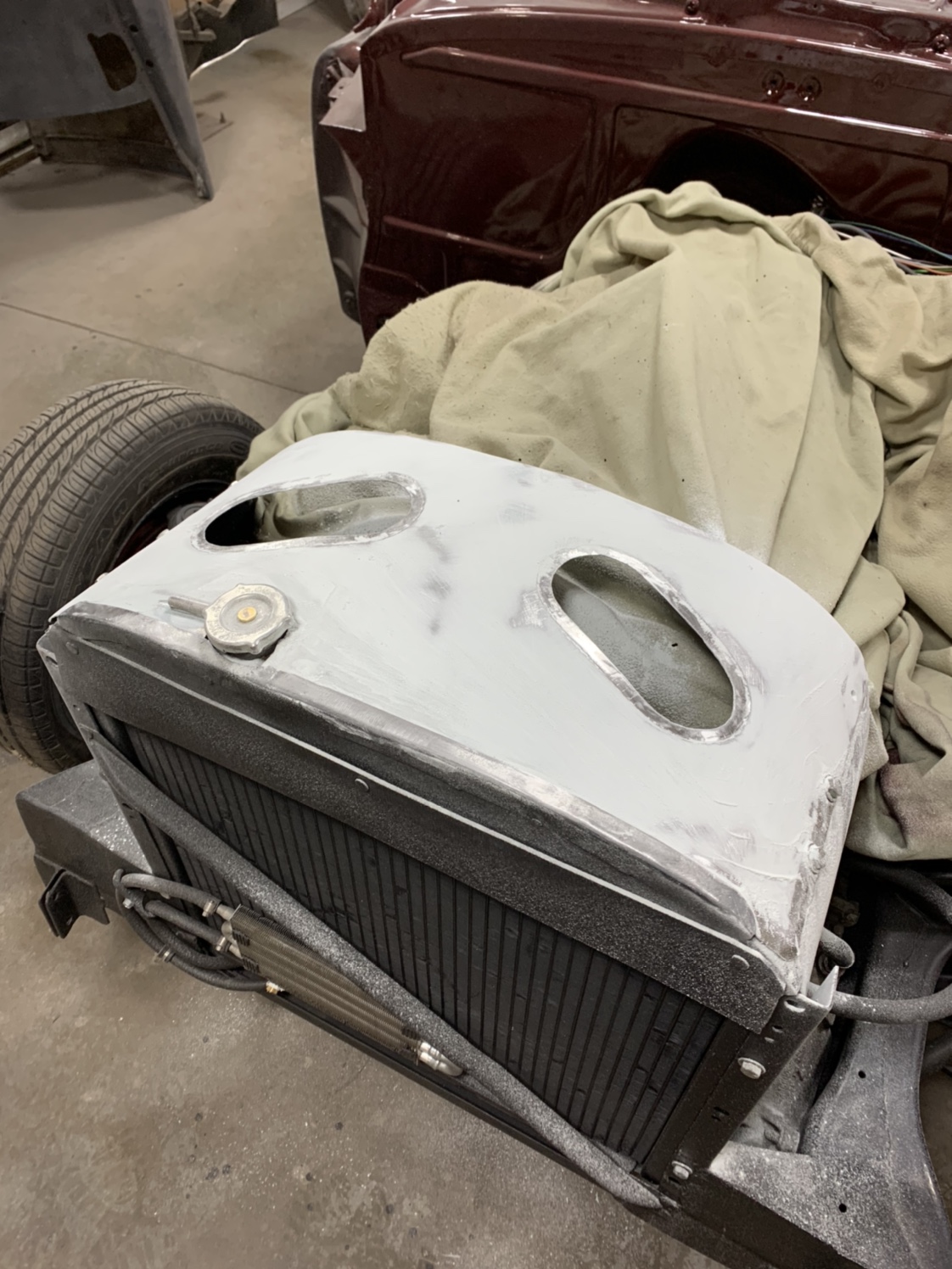

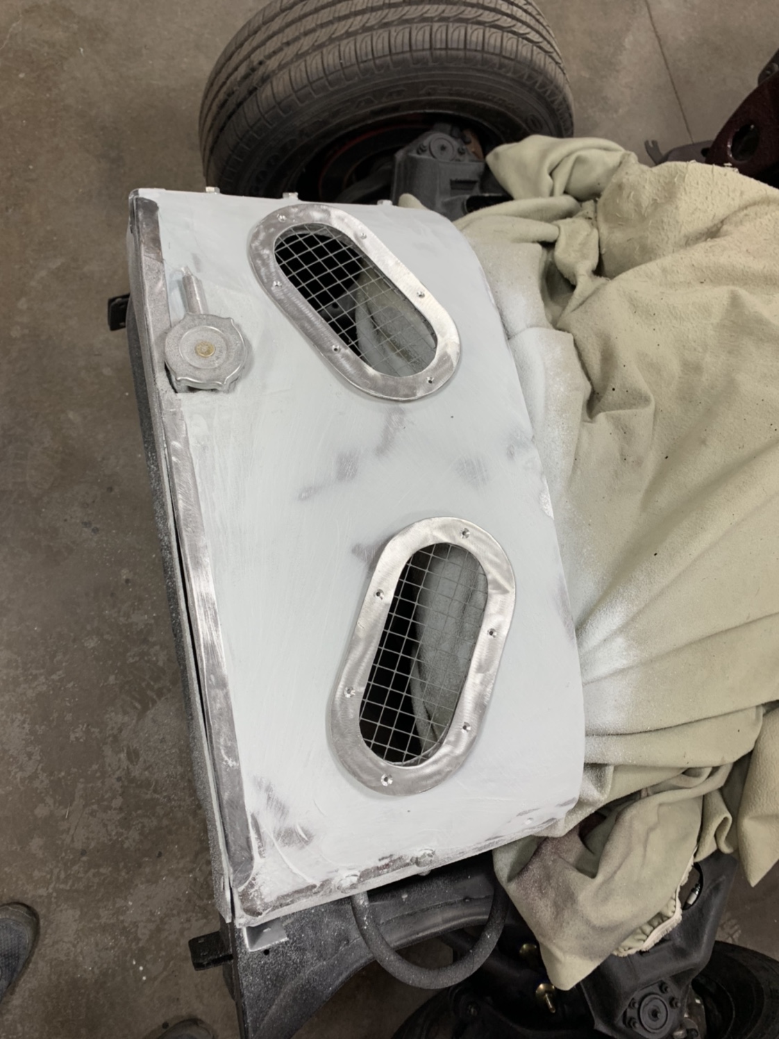

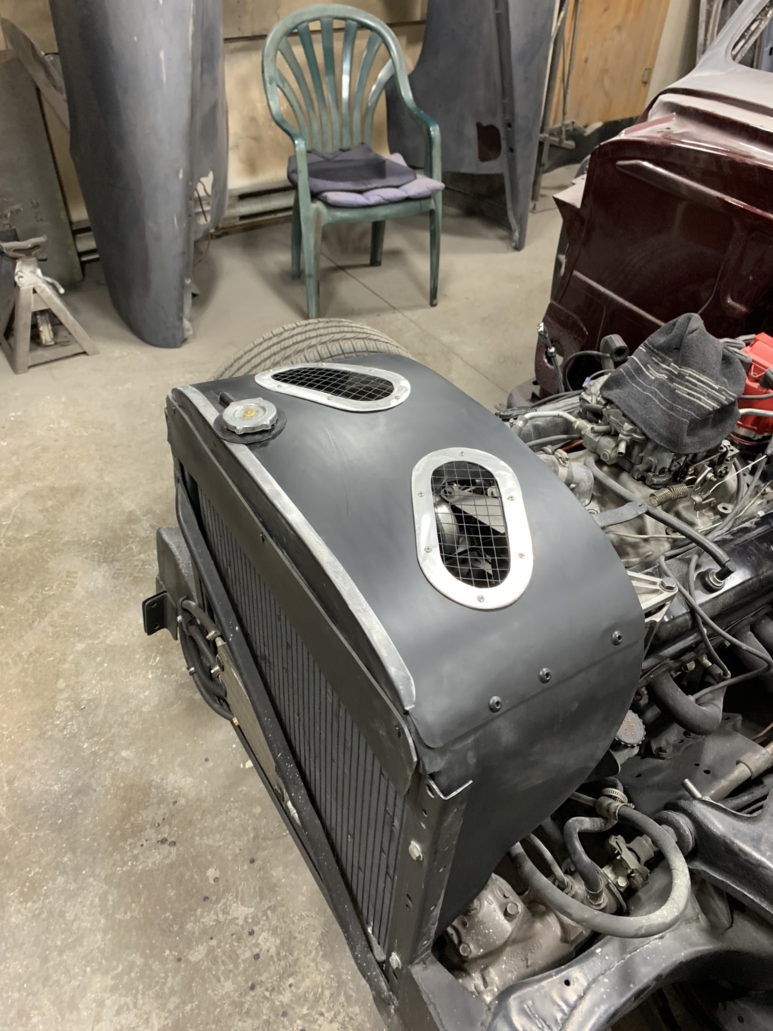

    Not a lot of progress but it is what it is . Needed a way to keep the fingers in tact . That fan spinning without anything around it is a serious safety issue . A shroud will help with cooling as well .

    Annddd done , now moving on to throttle linkage as the off topic cable is to short to reach to the firewall . Thinking old school bell crank setup , we’ll see !!

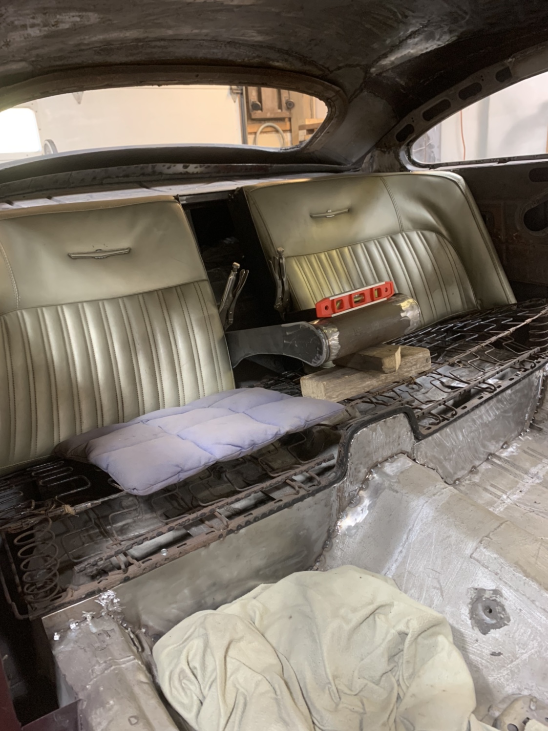

  27. aw1950
    Posts: 1,523
    aw1950
    IMG_2835.JPG IMG_2836.JPG IMG_2837.JPG 65109778496__B6679BDB-D5DD-48EB-A0D3-2587140D9CF5.JPG IMG_2840.JPG IMG_2842.JPG IMG_2844.JPG IMG_2845.JPG IMG_2846.JPG

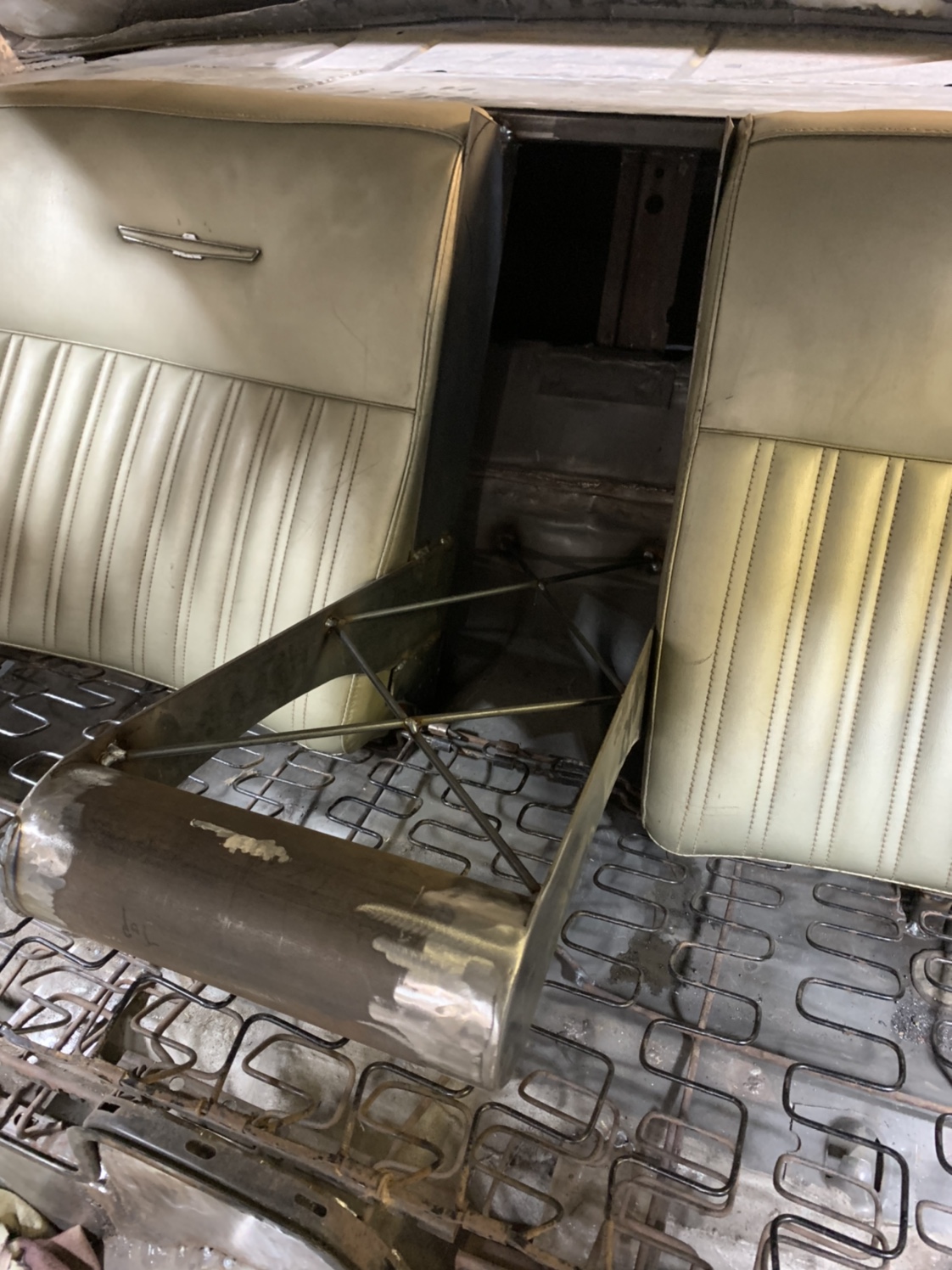

    Some progress for the devout followers to the end of’ say . Fitting in the TBird rear seats . Had a 7” void behind the seat backs that required the rear parcel shelf to extend . As you can see I created a floating console and a water fall armrest flowing from the rear parcel shelf . It’s a great grab point to lift yourself out of the back seat as well . It’s strong and sturdy . Will pull my 225 lbs out of there with no deflection . More progress to come , stay tuned !

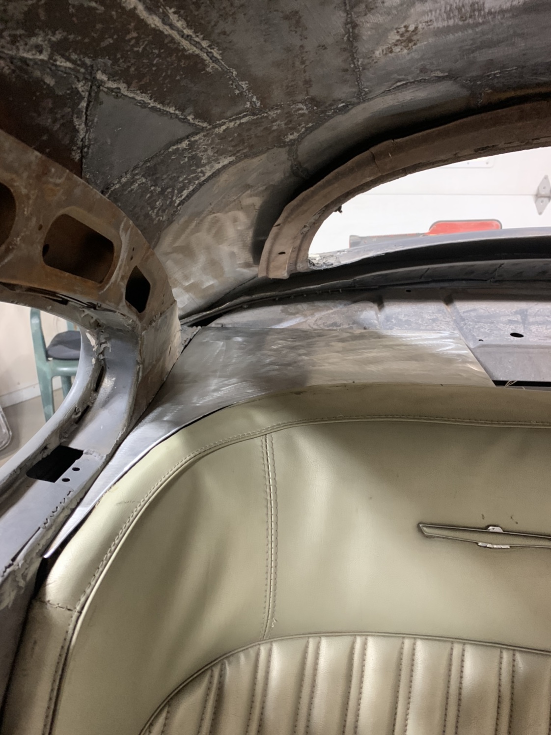

  28. aw1950
    Posts: 1,523
    aw1950

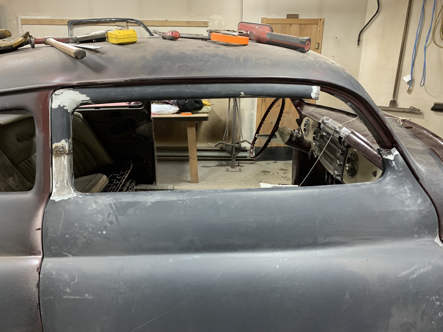

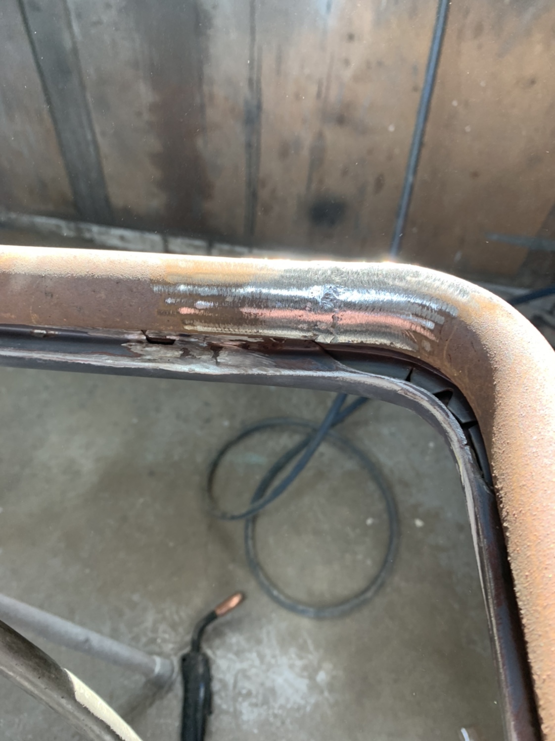

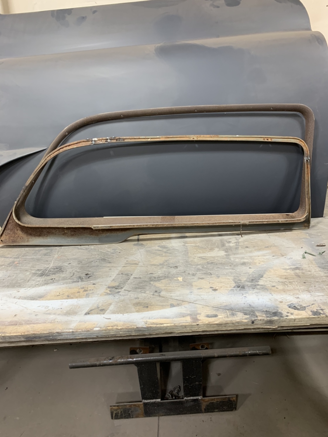

    65791033861__65CEBA8A-B9F0-483F-86F3-270DFC44B8C1.JPG IMG_3019.JPG IMG_3020.JPG IMG_3021.JPG IMG_3026.JPG IMG_3028.JPG IMG_3031.JPG IMG_3032.JPG

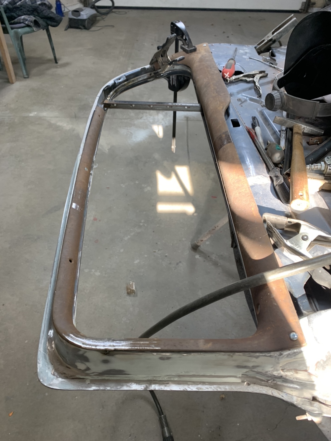

    Okay it’s been a while , here is what I am at now . Cutting down the window surrounds and touching up on some welding that was left undone on the door bottom when repaired a while back . First coat of etching primer applied . More to come . Slow and sure .

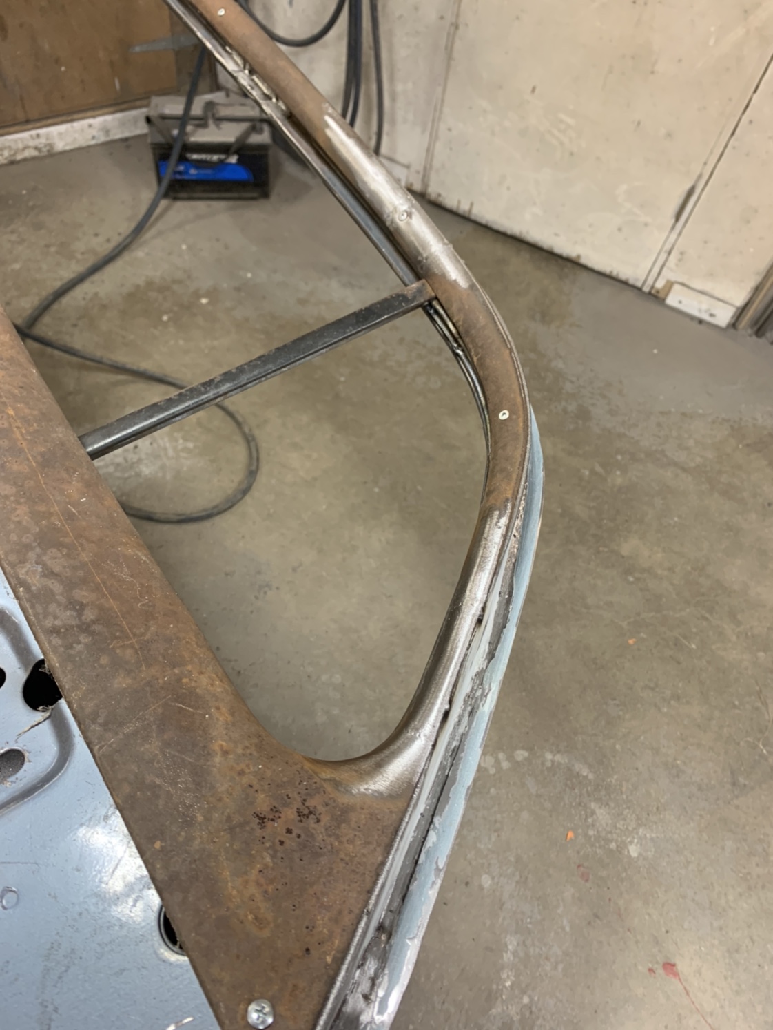

  29. aw1950
    Posts: 1,523
    aw1950

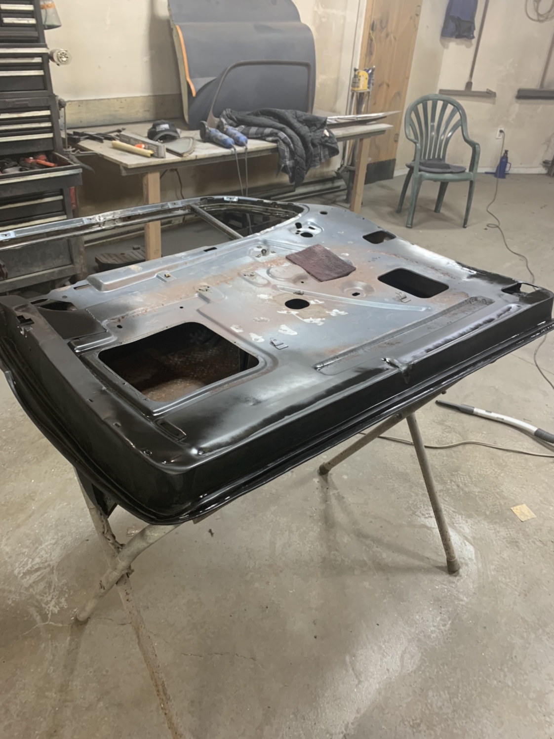

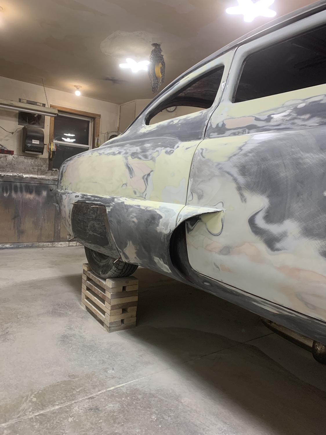

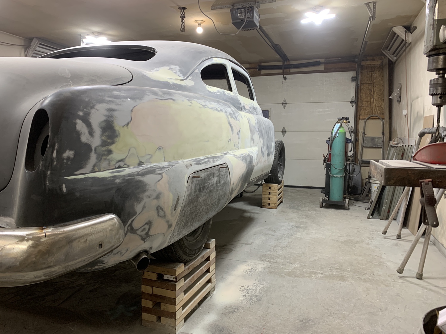

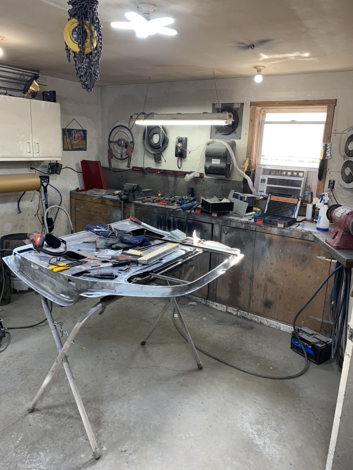

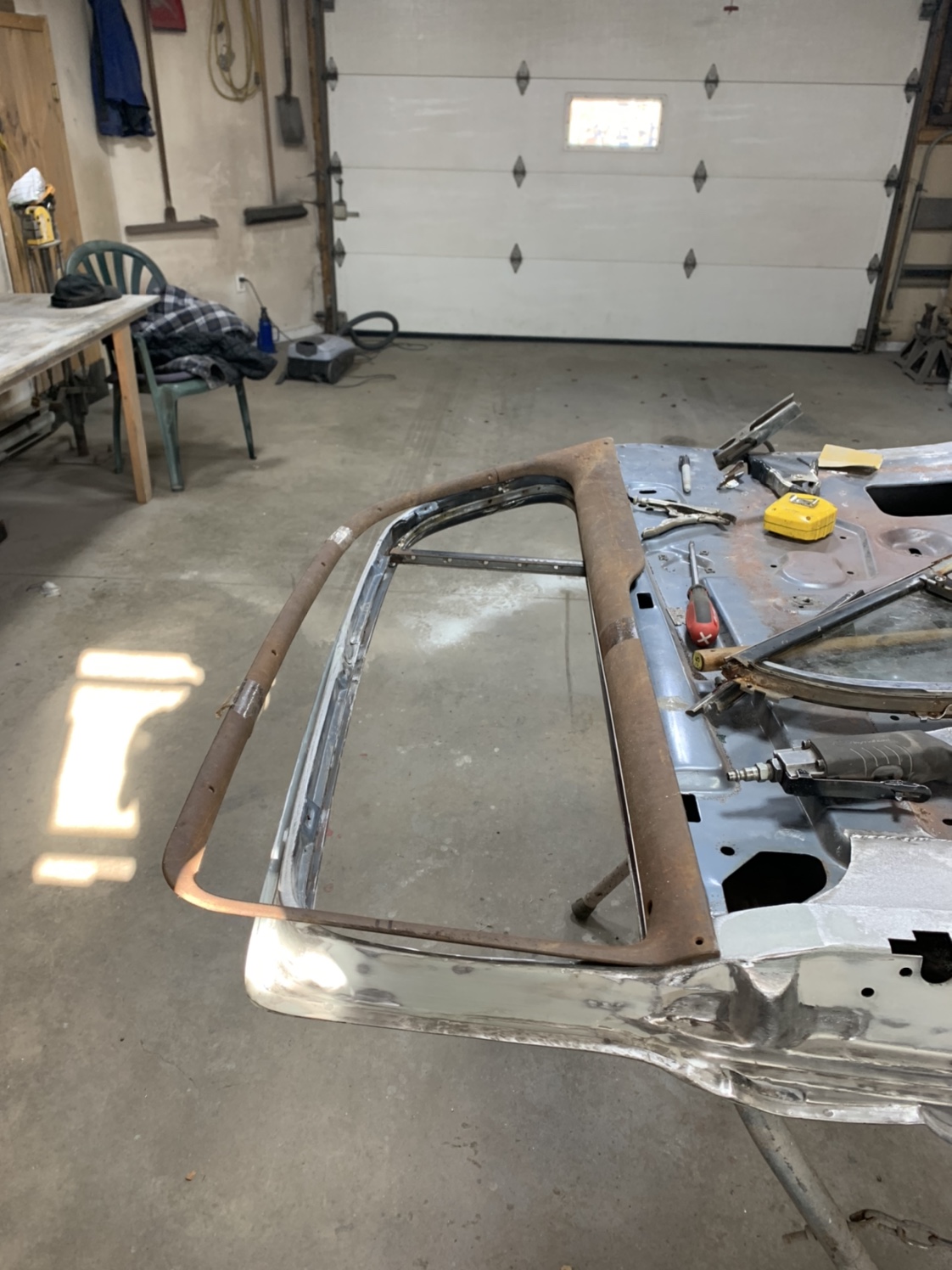

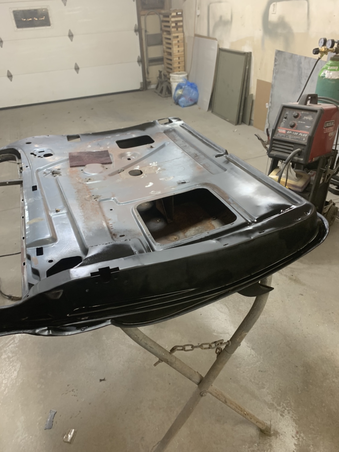

    So, after the last comment above, of the doors in etch primer I was moving the p***enger door around on the panel table , it got away from me , fell to the floor and bent the upper window frame backwards as it landed upside down on the front upper corner. I had to cut the door top off again and reset everything.
    Unplanned weeks of work as I don’t get a lot of time out here .

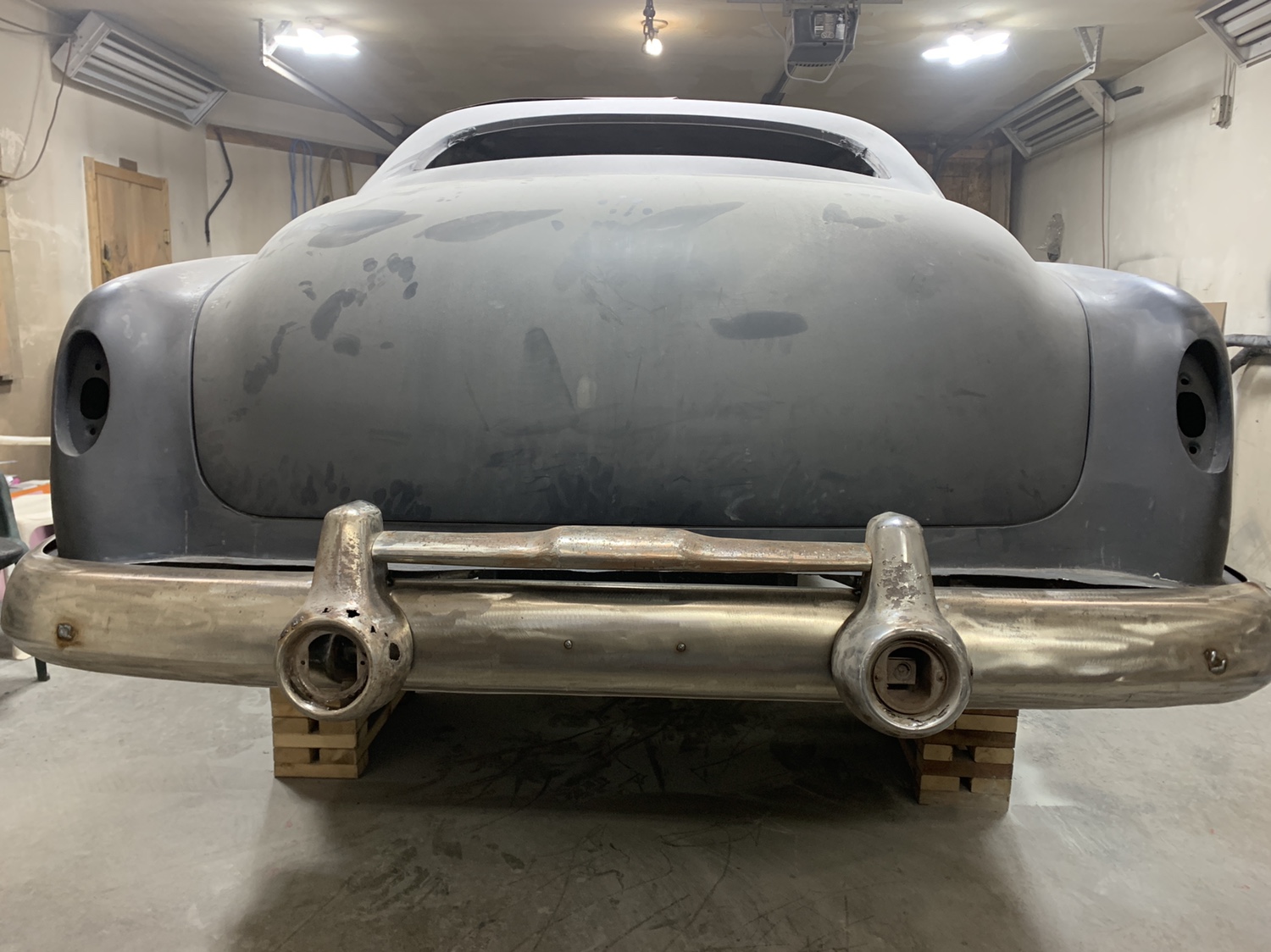

    Needless to say it was repaired, and I moved onto blocking the door to quarter panel and fine tuning . Was able to get the fender skirt mocked into place as well . I blocked at least a quarter of a gallon of filler off the side fine tuning with more to go .
    Was able to start the final mock up of the rear bumper with a 1950 overider ***embly. I like it a lot better . They need repairs but try and find ones that don’t up here in my neck of the woods!
    That’s it for now , later !
