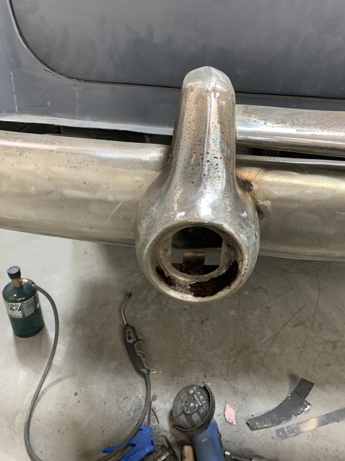

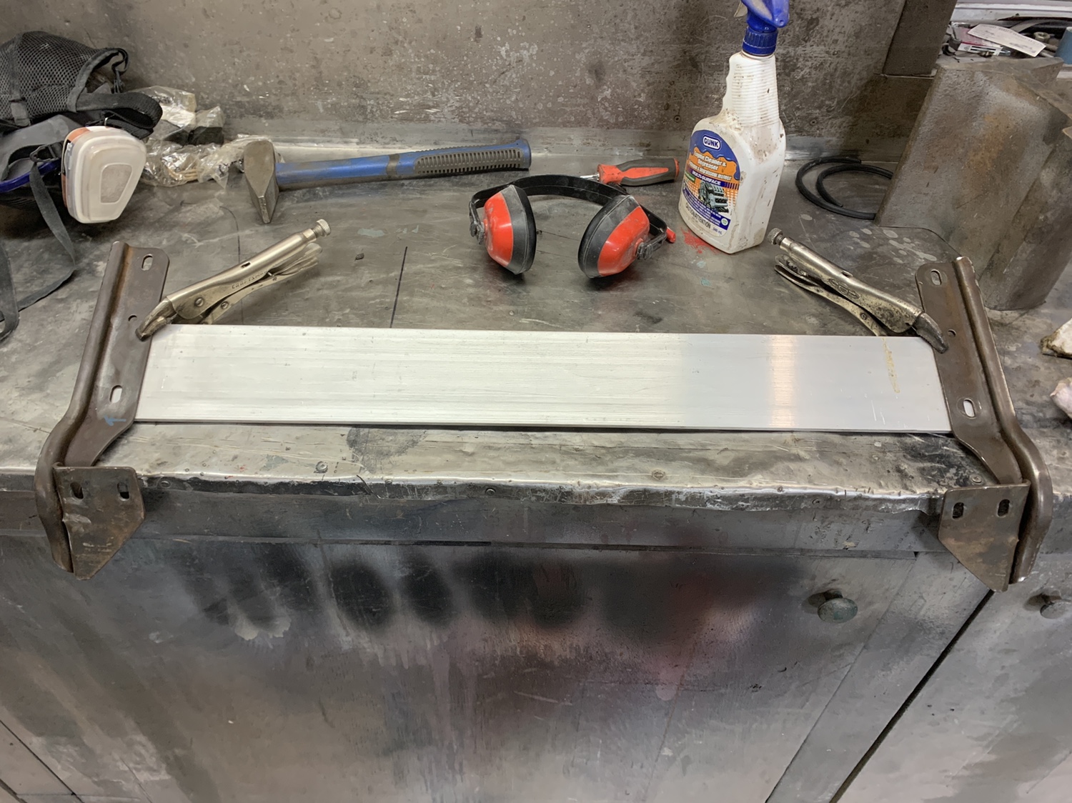

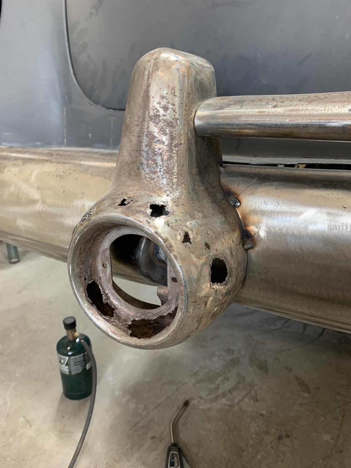

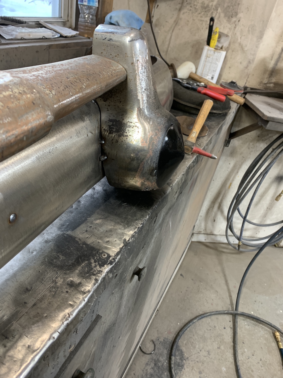

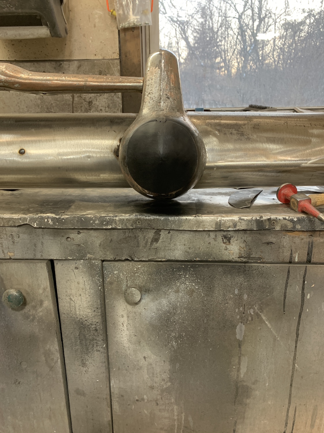

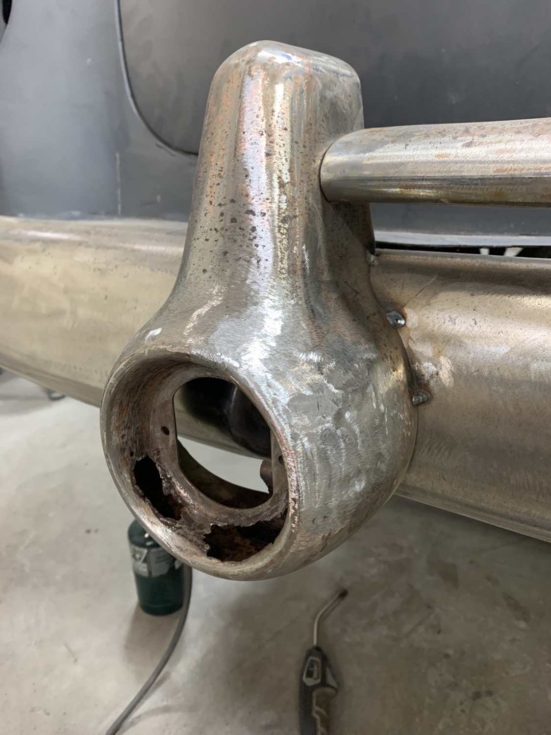

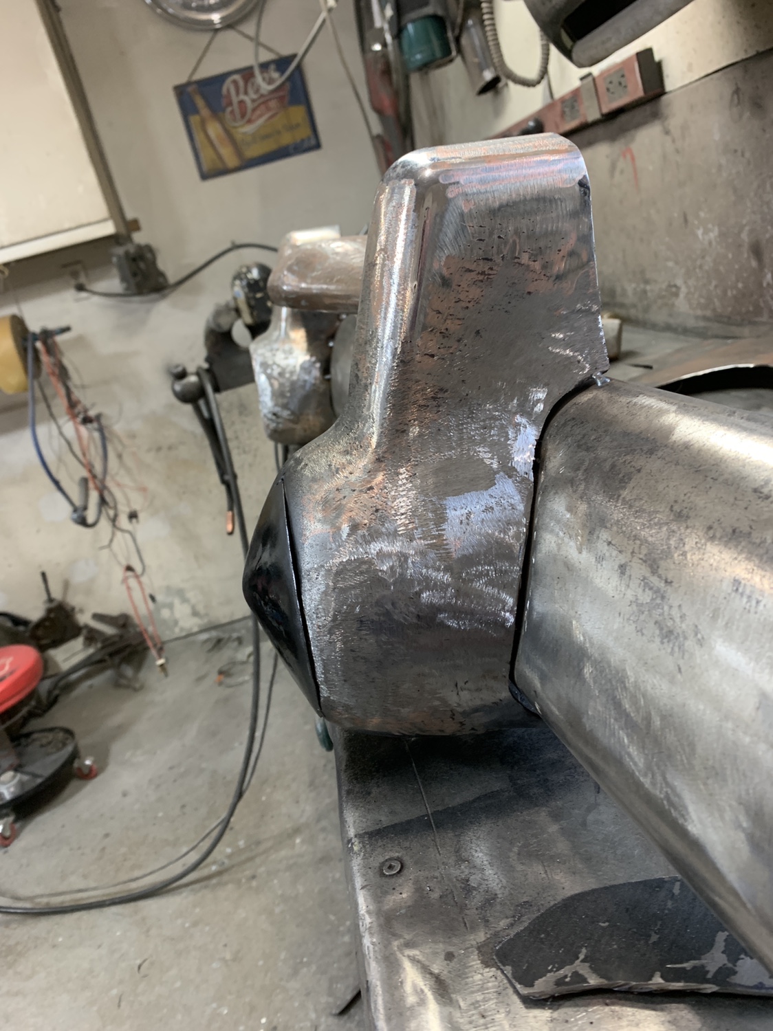

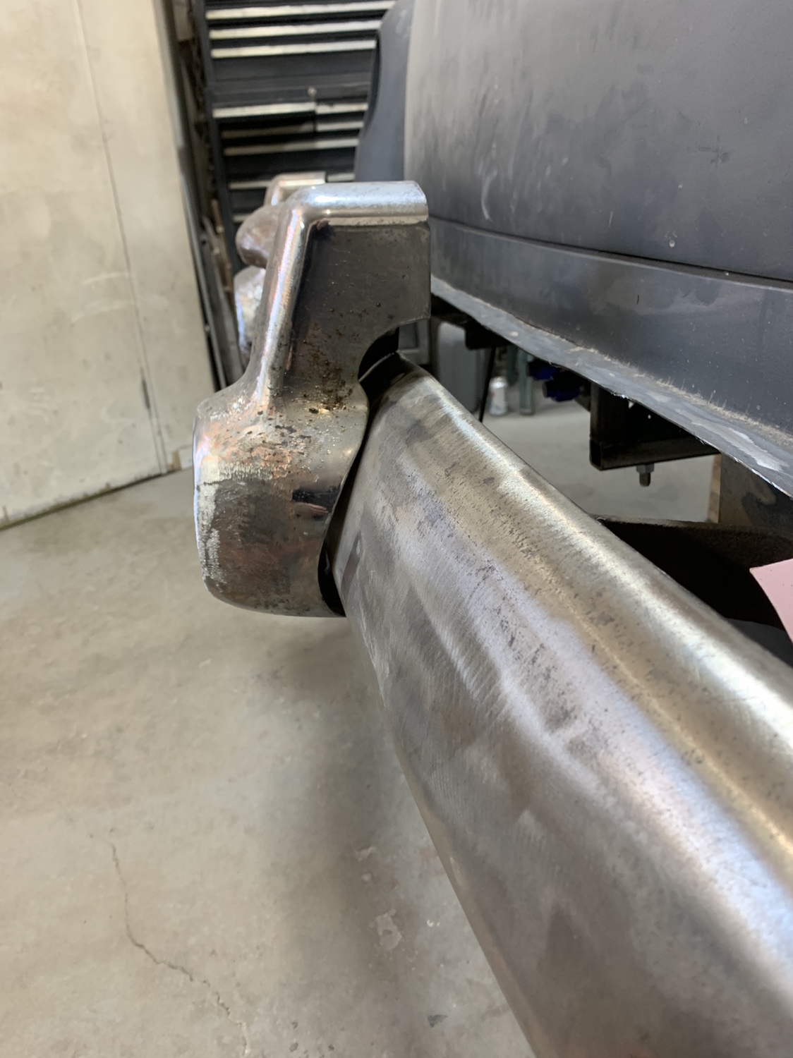

    IMG_3223.JPG IMG_3224.JPG IMG_3226.JPG IMG_3248.JPG IMG_3250.JPG IMG_3251.JPG IMG_3254.JPG IMG_3255.JPG IMG_3256.JPG

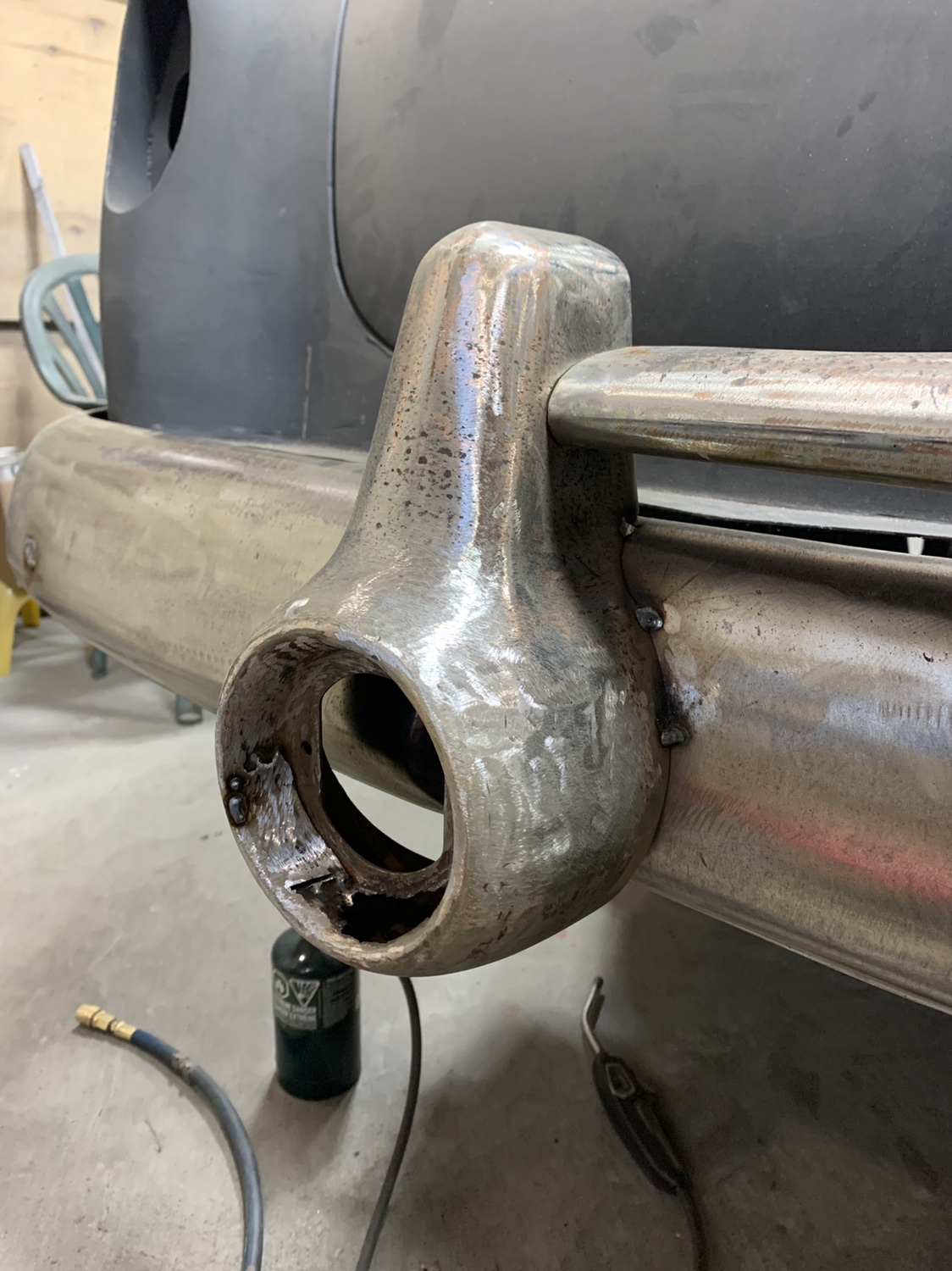

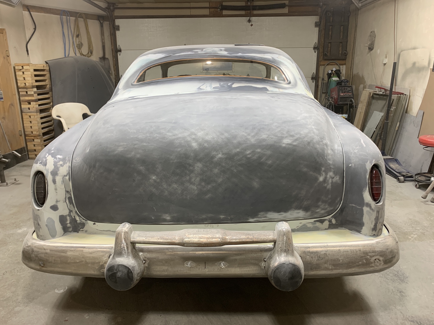

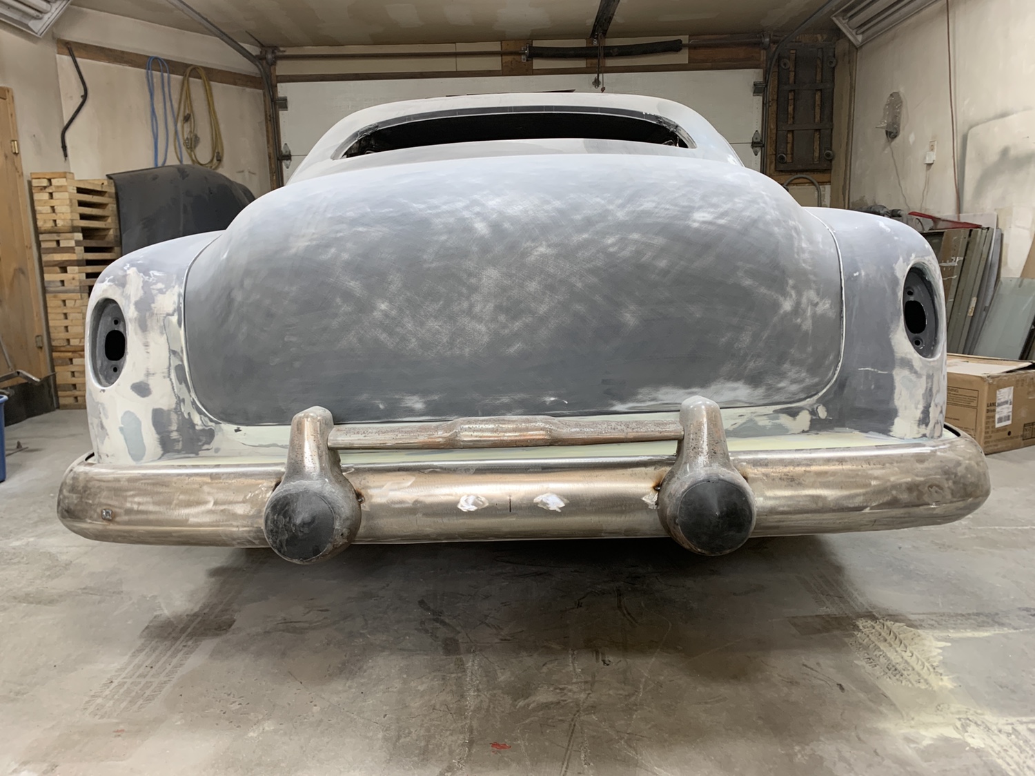

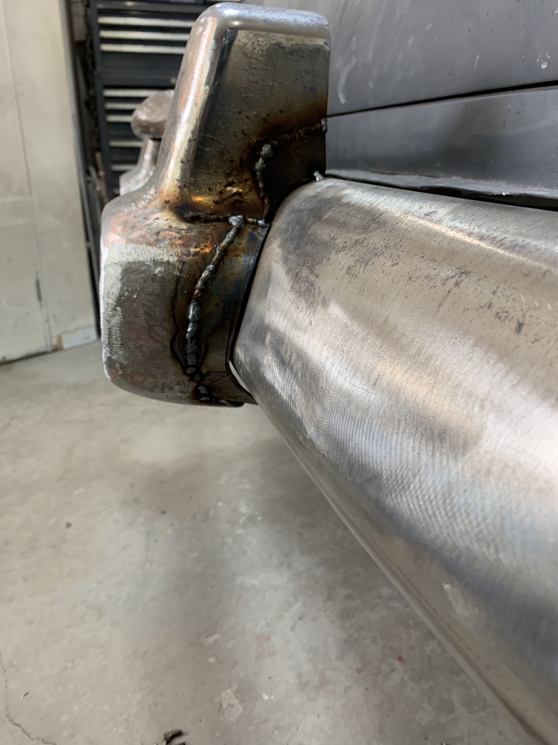

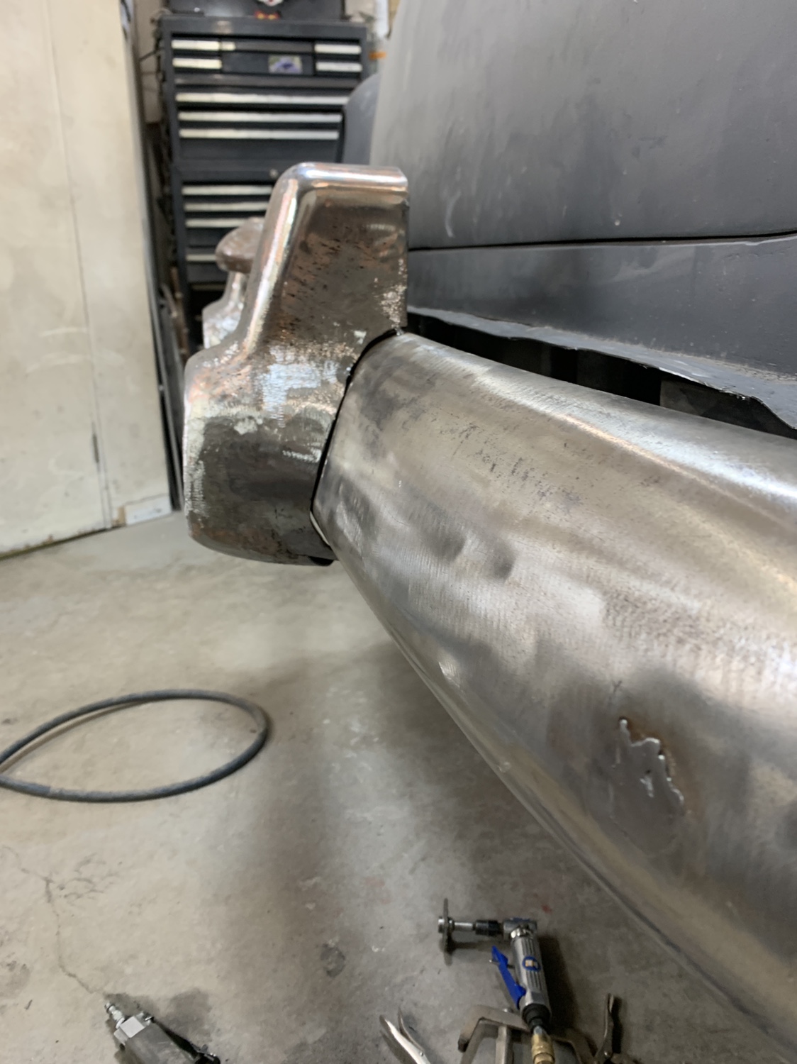

    Okay been working on the rear stanchions . Have them about 90% repaired. Now I don’t know if I want to keep lights in the pods or put dagmars on and call it done ! Opinions?

    Great to see you picking away at this yet. If the diameter was right, a pair of '57 Chevy front bumper rubber tips might look cool in that rear guard, but I could see them being reverse lights, too. Either way an impressive amount of work it took to fix those things!

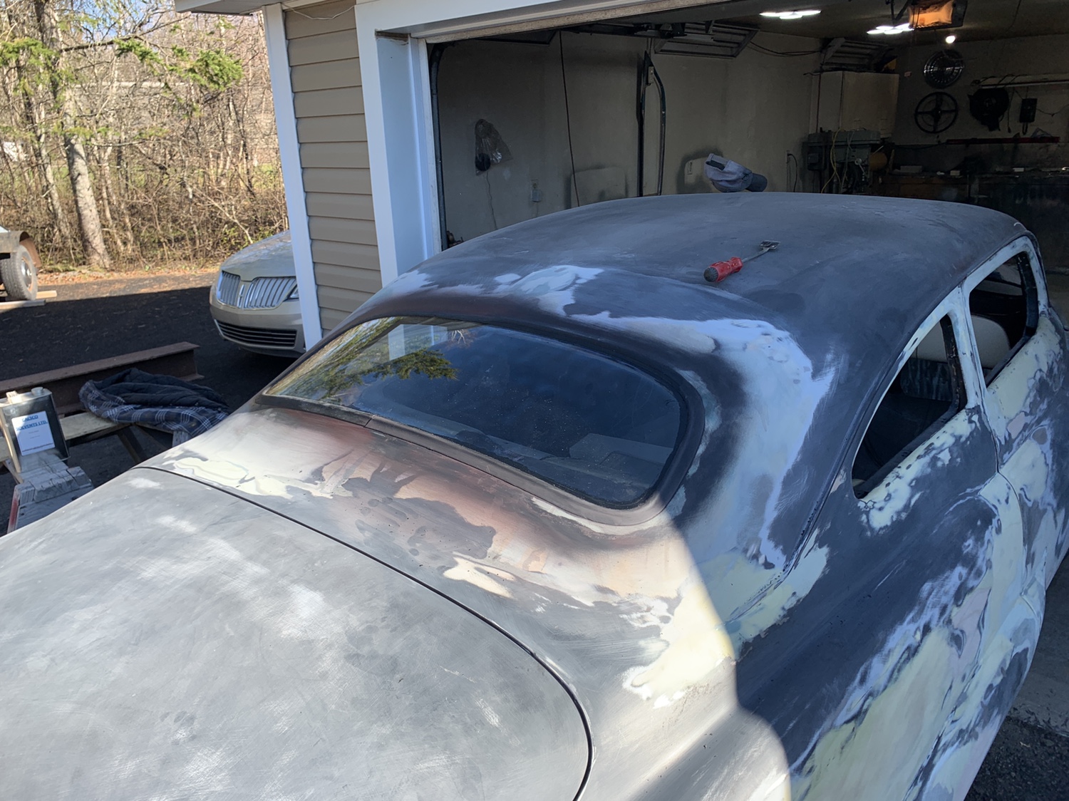

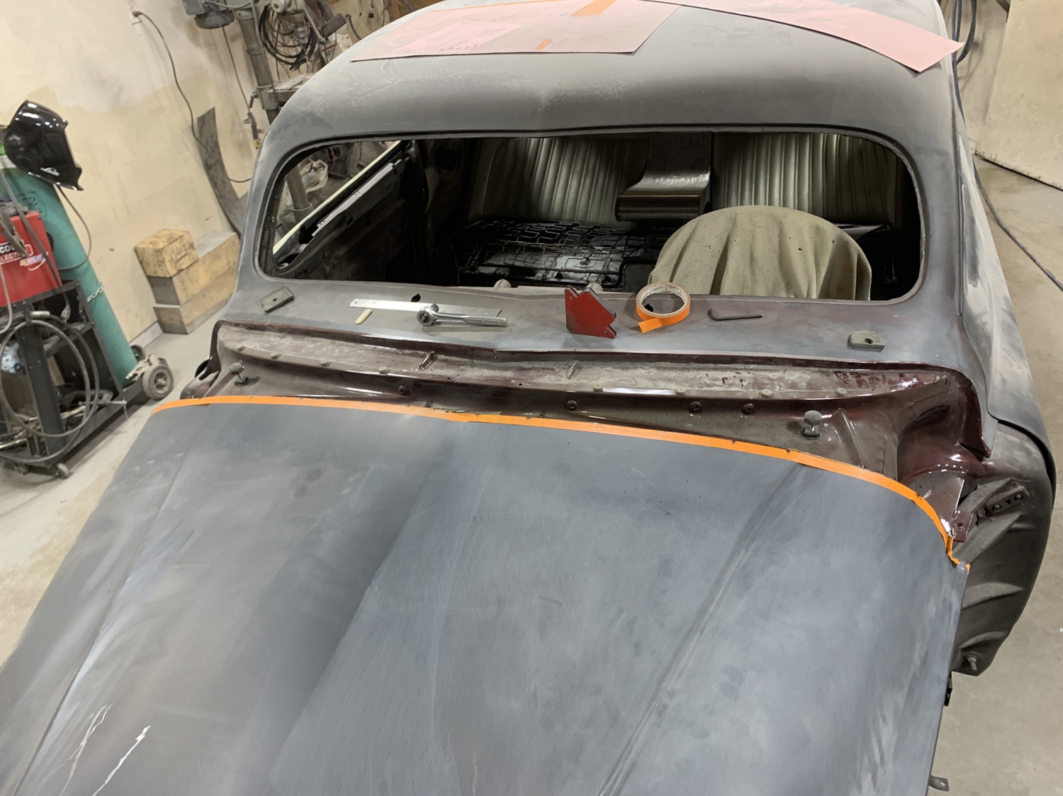

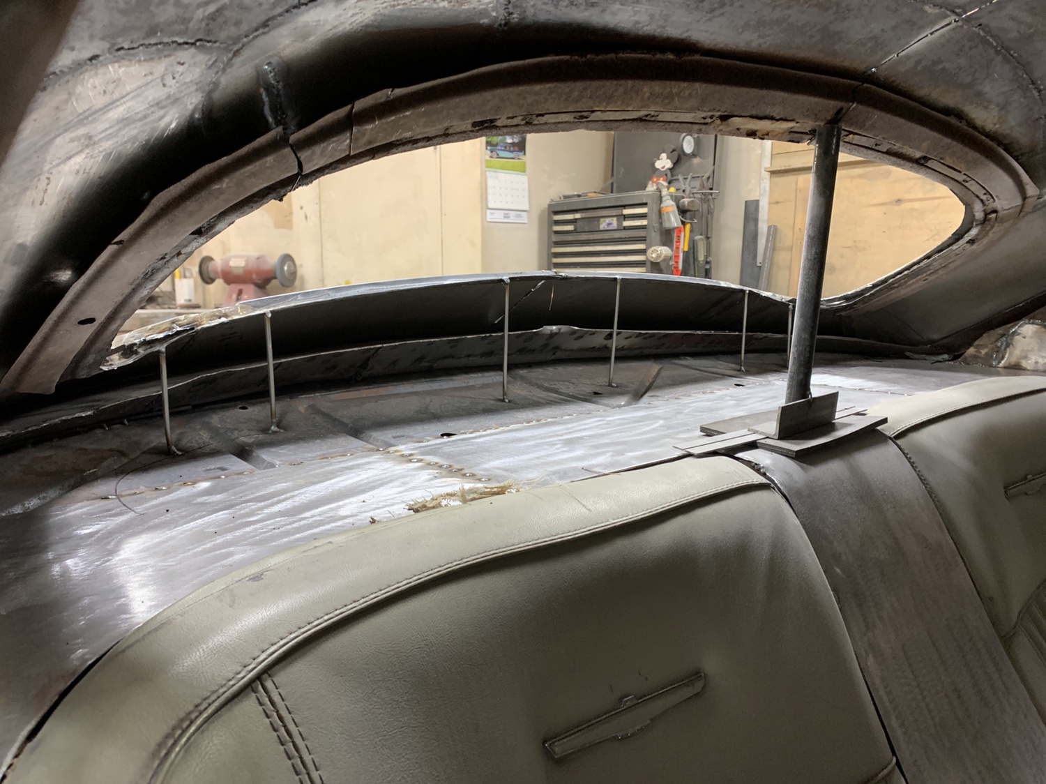

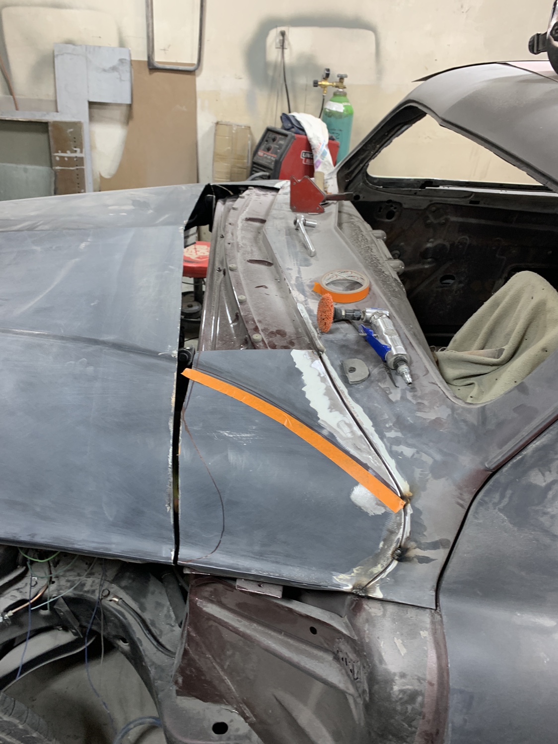

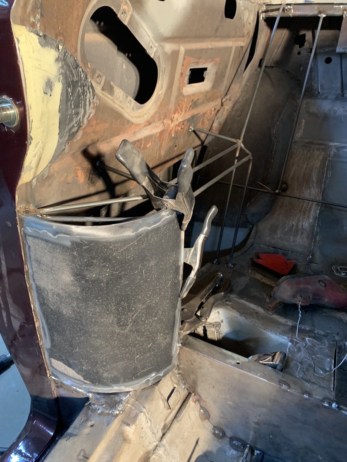

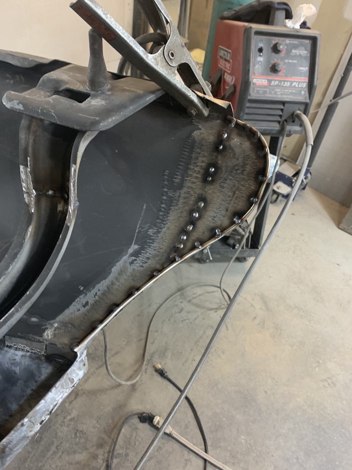

    So , been working away again . Took three days off last week plus the weekend . Knocking stuff out quite quickly . Amazing how if uninterrupted what you can get accomplished . Although you can’t see it in th pictures I got the filler panel between body and bumper done , blocked the trunk and back of the car , ready for the final coat s of high build . Worked on the rear window surround , had to slice it open to adjust for final window fitment. It’s better now .
    Made the start of a filler panel inside around the rear gl*** as it hide all the inner structure of the gl*** frame . Couple pics for the faithful . IMG_3284.JPG 66870772621__5A41C177-7E1D-4FD8-8685-483483129DC0.JPG IMG_3287.JPG IMG_3288.JPG IMG_3289.JPG

    That Tetris game of sheet metal seams on the inside of the rear window really shows how much work went into making that right, very nice looking results though!

    Since you asked... Ditch the Dagmars! They make the rear end look cheap and plastic-y somehow.
    If it was me, I'd make them back-up lights, auxiliary brake lights, or exhaust exit surrounds.

    Thanks for input , the jury is still out on these I ll see as I get closer to completion . The exhaust is dumped out the side quarter panel behind the wheel opening . Reverse lights may still be the option . Time will tell .

    Turn them into tail lights and fill in the tail lights. Dare to be different?

    LOL the whole car is the definition of different . Seriously though I have thought of that as well , a little concerned of them being so low . ??? Not completely convinced yet on what direction ! Thanks for input .

    Fantastic work! I really like the tail lights you have now.

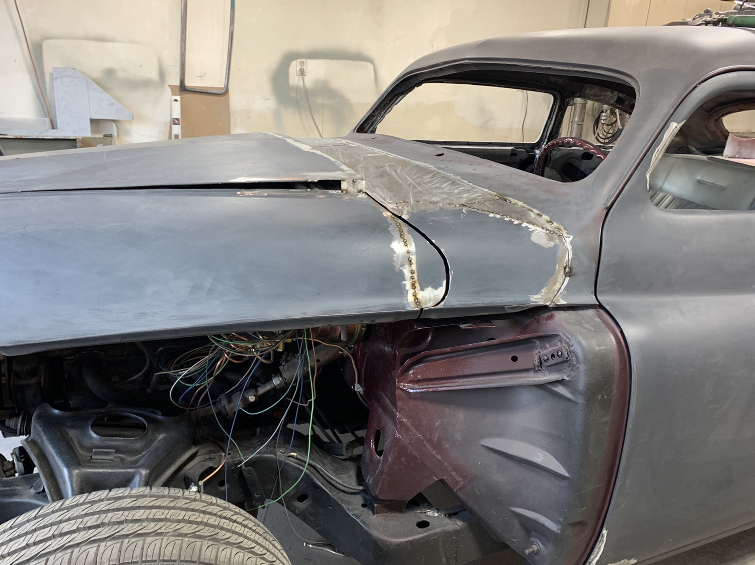

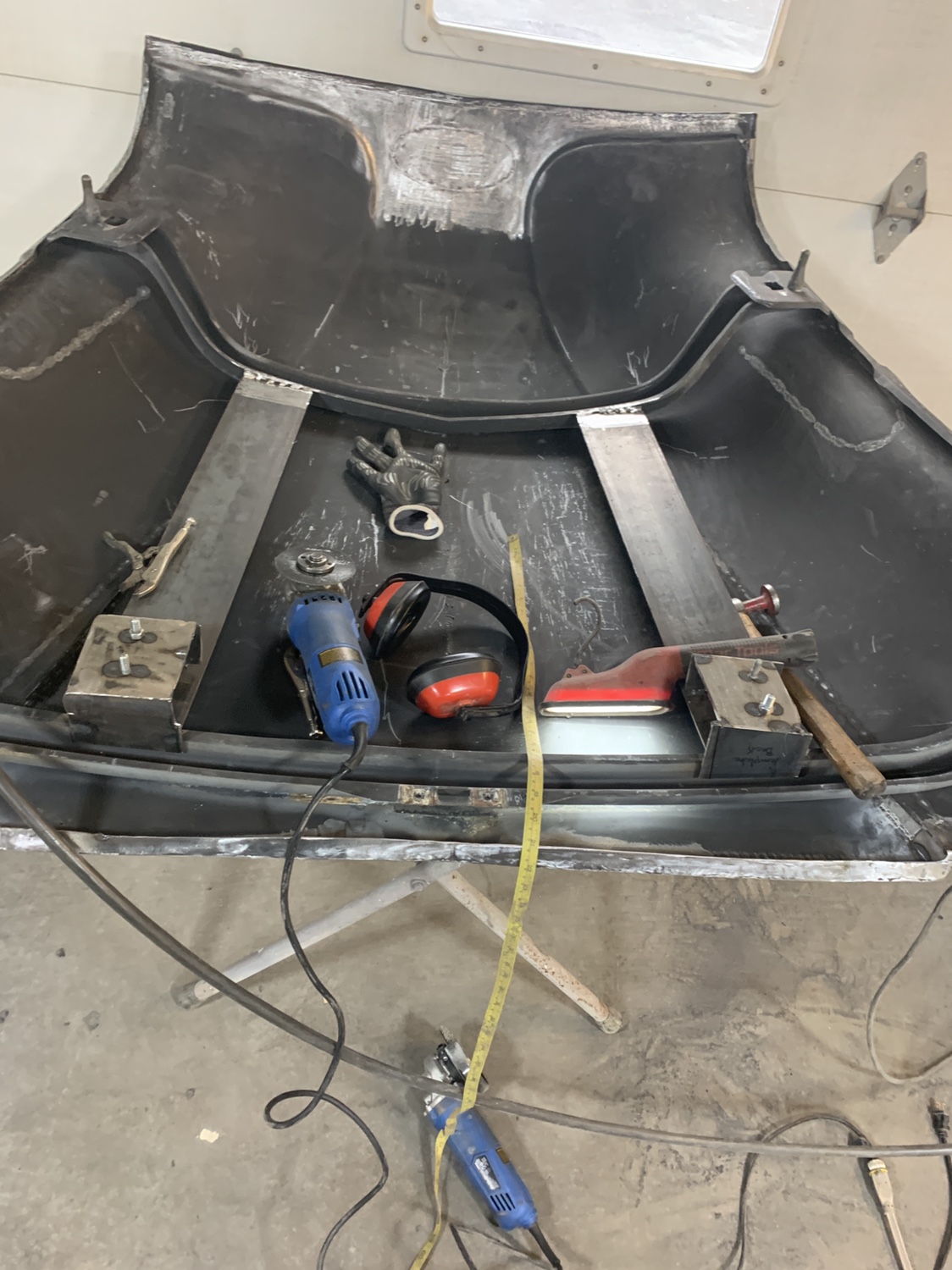

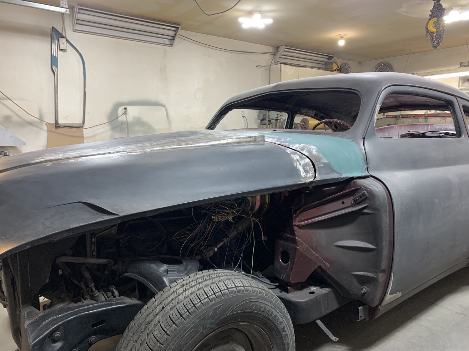

    So , next on the agenda ,hood . If I have attention of long haulers I wanted to have my hood open conventionally. I used 87 F150 hinges . Very basic hinge . Put them on and , no go . Lots of scratching head on that . Voila the centreline of the hinges are inboard 8” . All that is on the backside of the hood past pivot point wants to cantilever down into the cowl . No good . Sooo off come the back portion of the hood to be grafted onto cowl and move the break point closer to the front of the hood . I’ll will make more sense as I move along . In the meantime have a look .

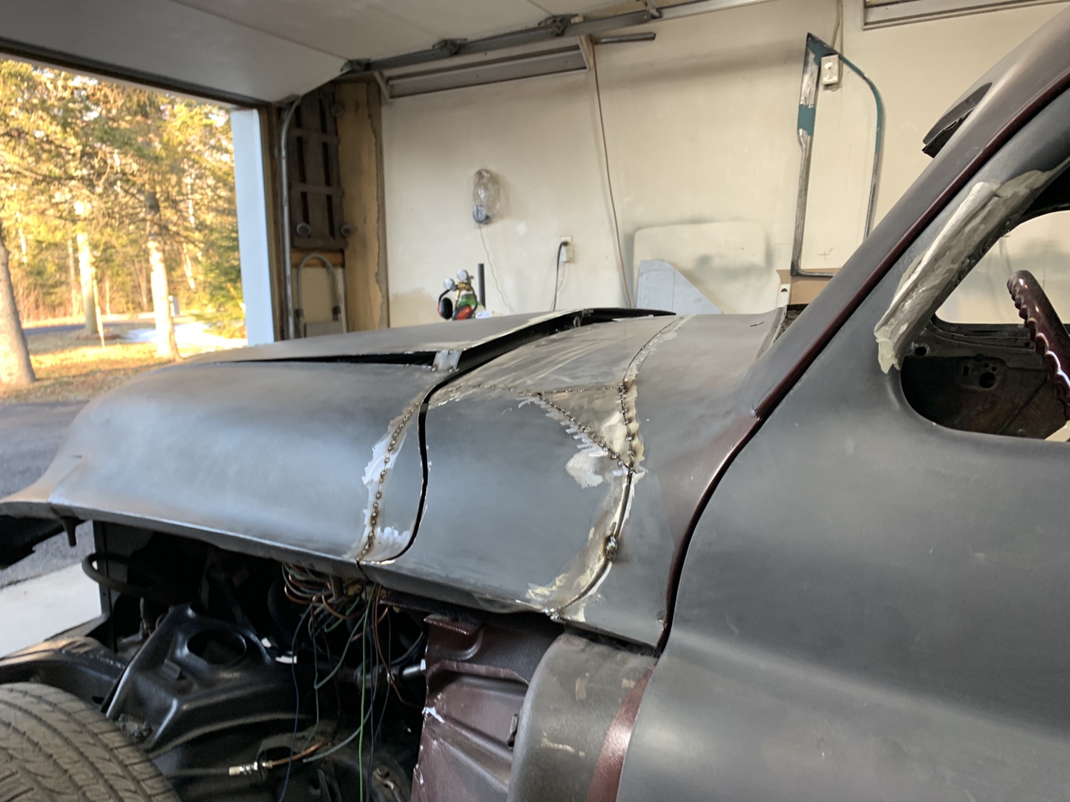

    More progress shots . This ole sled is getting a little hot rod touch as well . Slight tasteful induction. Serves two purposes. The first is a way for the hot air under the hood to evacuate once I cut open the hood scoops . Air in air out principal. Secondly, it’s to facilitate the opening of the hood without binding at the cowl area . Get it all welded up and ground it’s going to be killer in my opinion !!

    So here we are , showing what I did under the hood to hinge brackets. Tied the two hood inner structures together . Cowl pretty much done . Showing side profile of hood . Also rear gl*** is installed. Lots of time just for this . I have two months left to have ready for our main event car show here in town . Clock is ticking .
  19. I'd say use (kind of) dark lens in the bumper guards with LED lights. Ya can't have enough brake light in today's world of dumb*** drivers!!

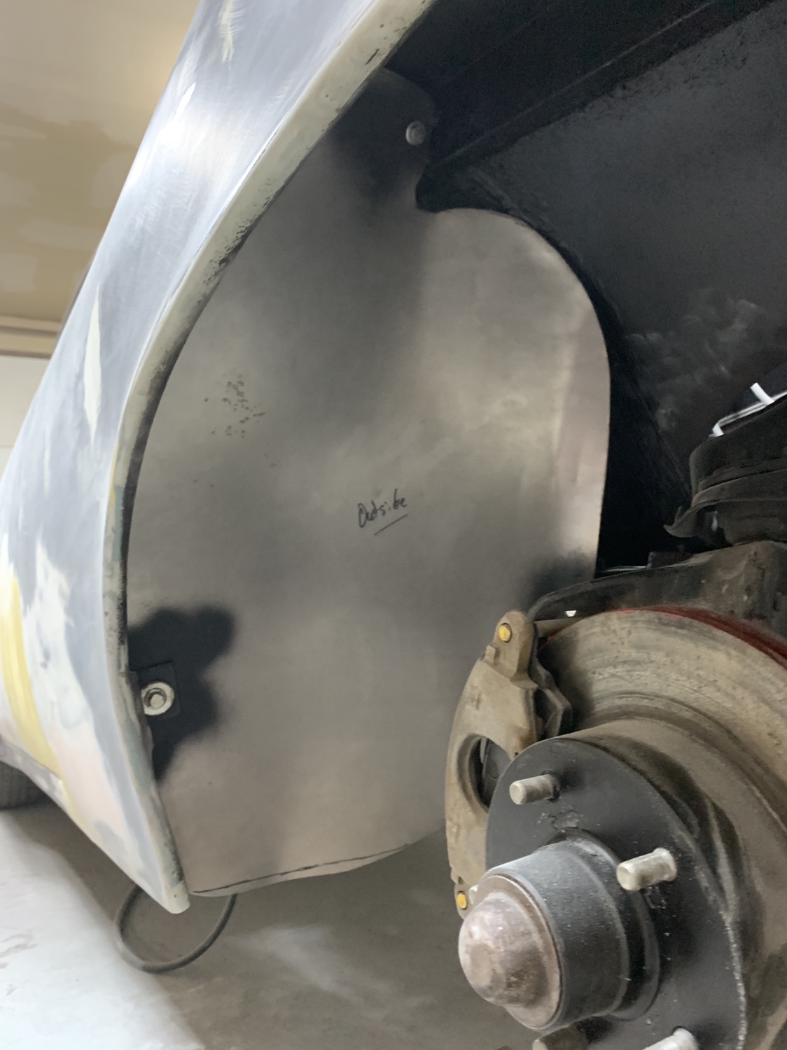

    Starting to see some paint finally . Getting the inner fenders wetted out and the headlight opening painted . Will be able to final ***emble the front clip next weekend . Wire the heads and directional lights . Get that stuff crossed off the list .

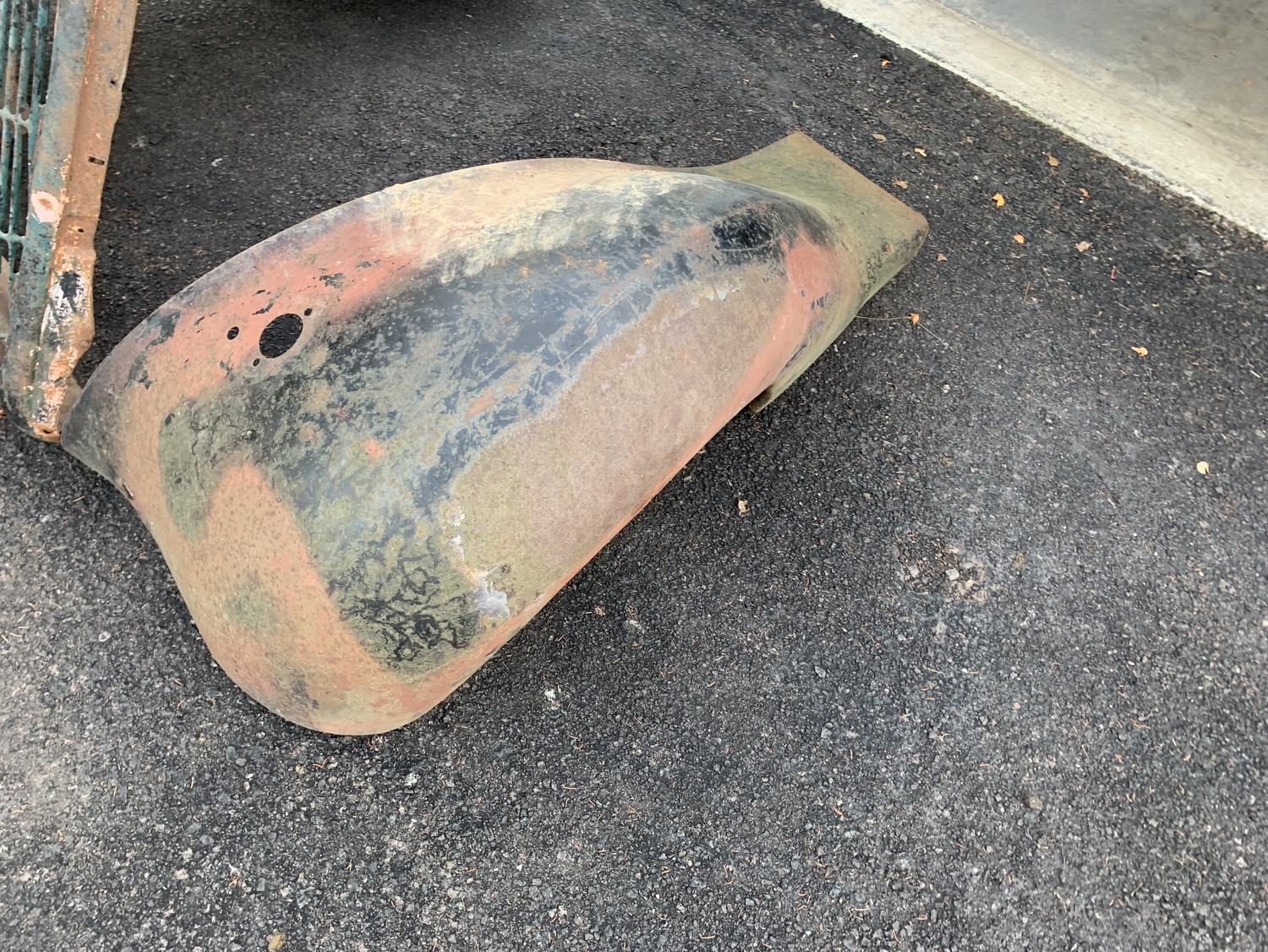

  29. aw1950
    Joined: Dec 21, 2008
    Posts: 1,523
    aw1950

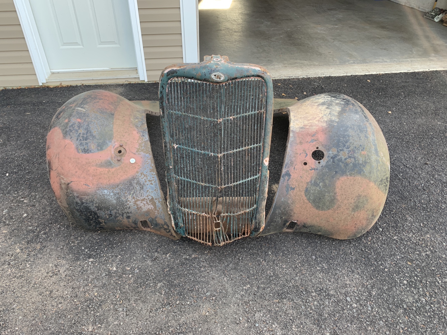

    Okay so just a hint on what’s happening later. Buick isn’t done yet but sometimes a deal comes along that just needs to be grabbed , more pictures tomorrow. Just a teeze for tonight LoL
    impala4speed likes this.
  30. aw1950
    Posts: 1,523
    aw1950

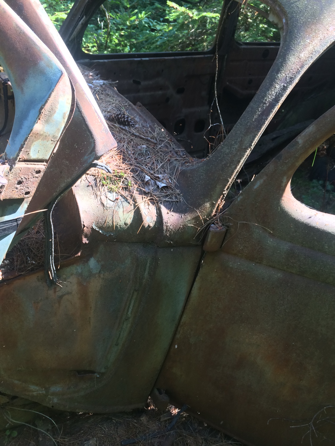

    Couple more from its resting place of fourty years . Resurrection is in process !! Going to be my retirement project . As mentioned above more clear pics tomorrow
