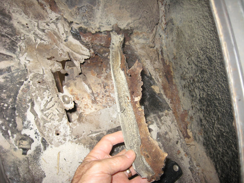

I need someone that is in the process of rebuilding one of these Buicks to take a picture or two of the trunk floor out by the quaterpanels .Does the trunkfloor attach to the quaters in some way or is there just a rubber dust seal up against the quater ? Mine are completley shot and I dont know what this area looks like . Please help with this issue if you can. Thanks

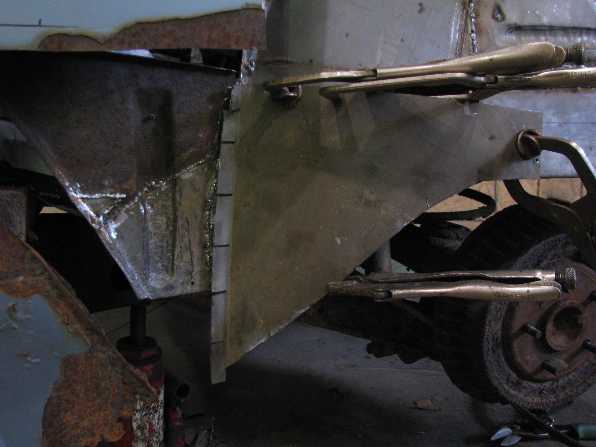

Well I feel better this weekend as I think I accomplished something .Have a look . The first pic is of the repair area. Also the well / floor bracing is bad . #3 Wheelwell panel welded in place also another shot of the bad wheelwell / floor brace. Brace repair panel to large next is the same cut down to a more managable size. Really that was all I needed to fix the area. # 7 is a part of the inner repair panel It was cut at the visible line . More to come . Hang on
In this pic you can see the panel welded in place that I had made in pics 5 and 6 I forgot to take pics of this process . It sure is hard to remember to take pictures of all the steps especially when your on a roll . Last is just another shot of the same panel . To get the coutour right on this repair I used 3/16th CRS as a wire form that you cant see . It goes from the welded inner wheelhouse down to the inner wheelhouse down where the inner rocker will be welded on . I will use 1/8" x 5" steel plate for the inner rocker . That will be beefy enough to weld anything to . Maybe next weekend who knows ?

Looking good!...you should start keeping track of how much mig wire you use on the car its a good conversation piece at car shows ! On my 47 project , I replicated the inner rockers ( they were a rectangular box) with 2x4 1/8th steel tubing, damn thing is stronger that when it left Oshawa in 47 lol .
Andy, I nominate you for President of The HAMB Weekend Hacker Brigade. Your candor is refreshing. We've certainly (us hackers) all been there. Hard to tell in this photo, but I'm holding what's left of the rubber piece that fits over the edge of the trunk pan where it meets the quarter. '51 Chevy, quite certain Buick would be the same. Yea, like maybe a booster rocket. So much for keeping it lightweight, eh Andy?
Brerhair . Hey hows the project comin . Yeah the 1/8 is a little beefy but easy to work with . The weight issue ? No issue at all LOL, shes a long low custom cruiser As for the trunk seal thats what I thought as well , That the Buick would be the same as the Chevs and Pontiacs of the era. I am waiting on some pics from a guy that has a buick as well that will put this issue to bed for good . I am not to the point of trunk work yet but it is coming fast . See ya ! Andy
