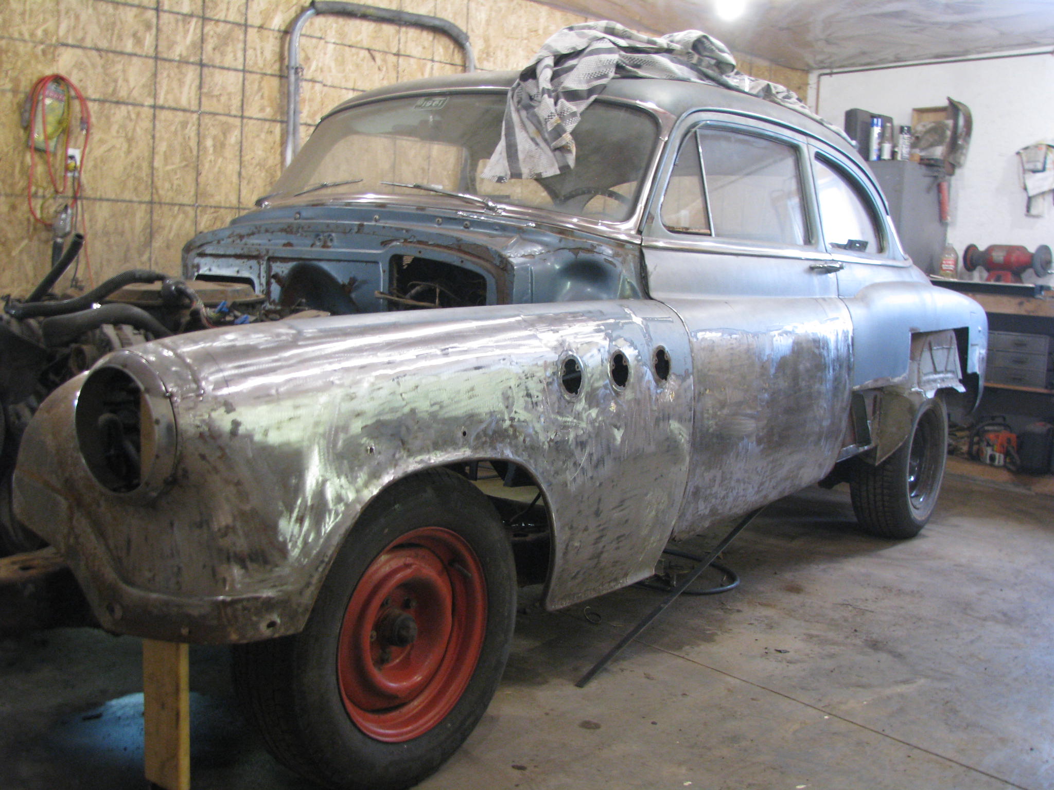

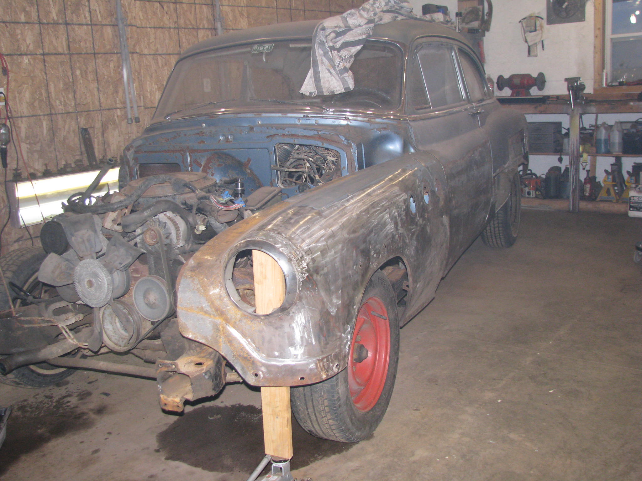

    Well I am pleased with todays progress . The last few saturdays have been, well to put it bluntly f*#ked up days , 8 hrs. and not much for progress . Thats in the past . So moving on I took the front rad support off so I could mock up the front fender to see if the wheelbase is correct.
    I noticed the WB was off and had to shift the body once again front to rear to get it to come into specs. # 4 pic Starting to get a feel for the look but must admit it ,it dosent look like much with no rockers or quaters on . Those will come . Maybe rockers next weekend ??? #5 Set the side width . Thanks Special Sam for all your help in the pictures and measurements # 6 is the bracing that was needed to keep the body in place front to rear . Should have thought of that earlier :eek:

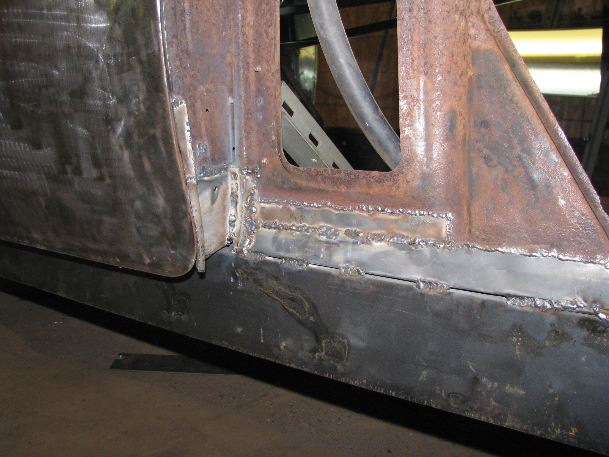

    A few more from today .Made up and installed the inner rockerpanel . It is a piece of 1/8 x 4 in plate with a 1 in x 1/8 plate as a floor return and this is all welded into the wheelwell and along the new panel made a few weeks ago . That represents the floor height. So when I am done the body will have a 3 in channel over the frame (Thats the plan at this point anyway ) # 10 Is what was left of the B pillar at the bottom rocker return 1/2 hour of shaping and it was ready to be put in place for the next 50 years . The final picture is just another side shot . Its hard to tell but the rake seems to be good at this point anyways . Thats it for now . Later !!!!
