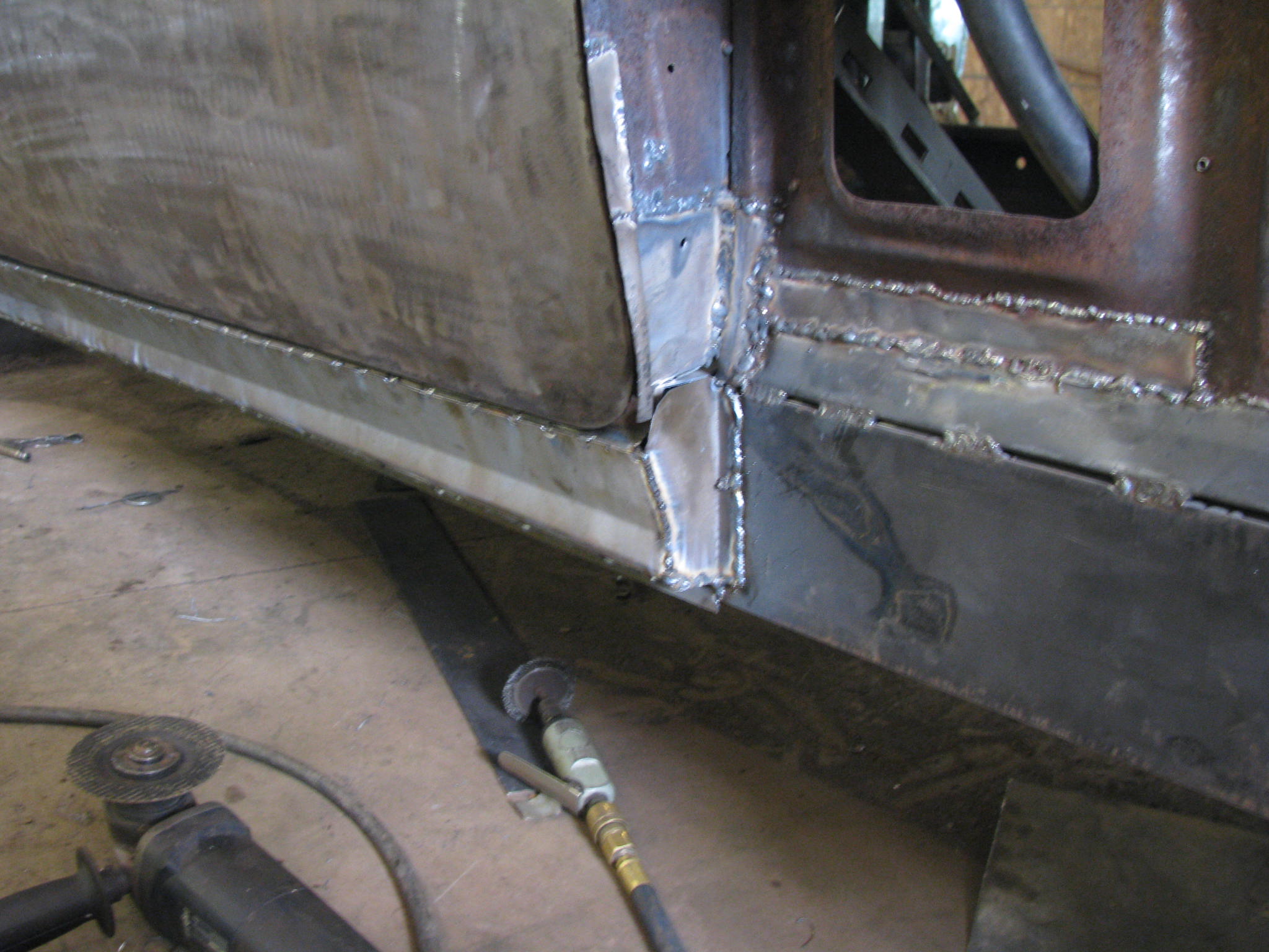

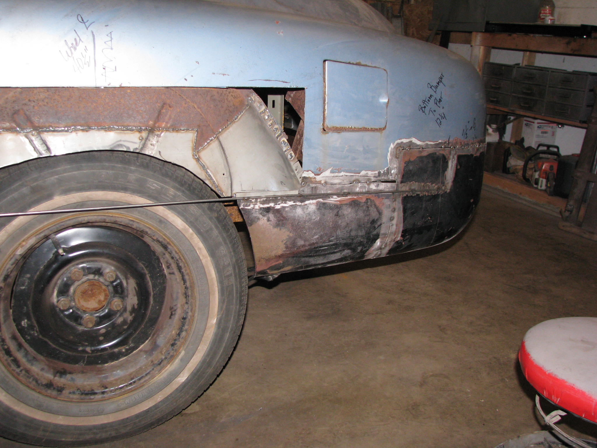

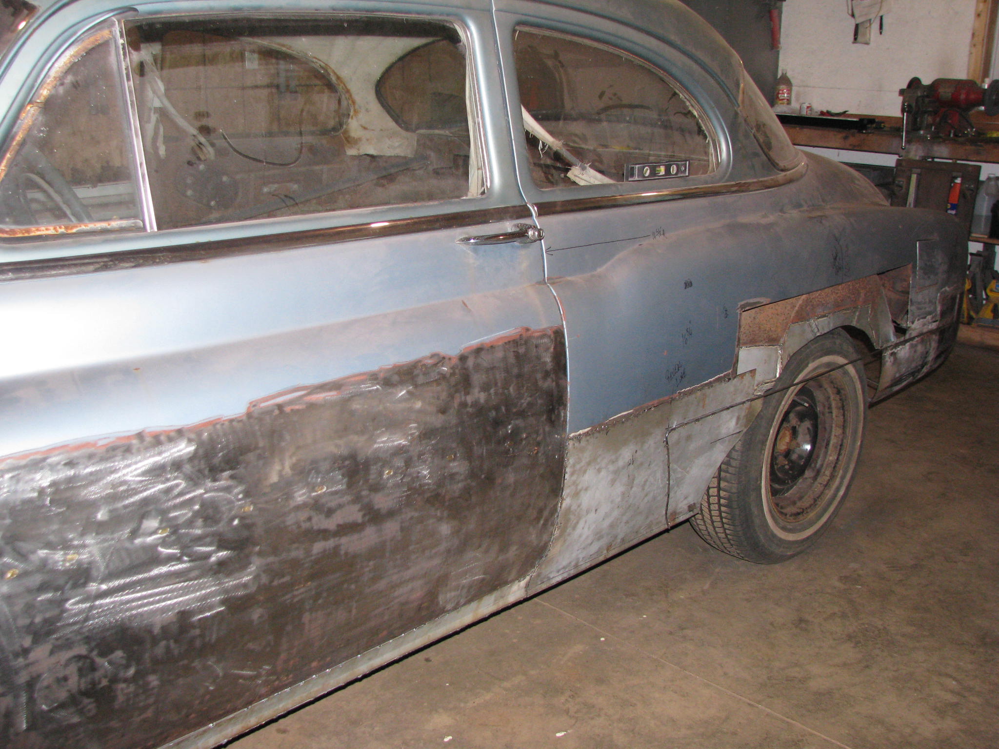

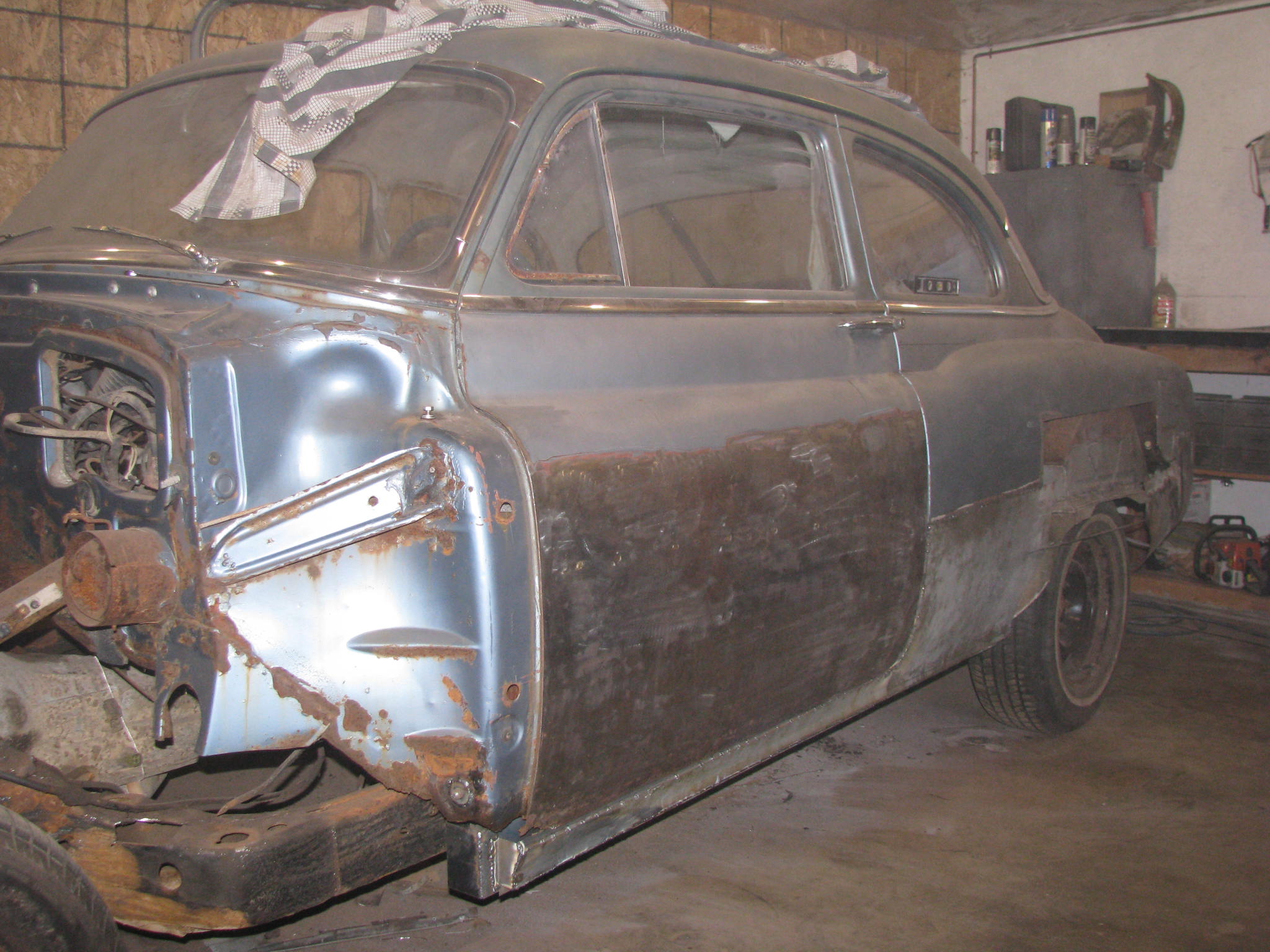

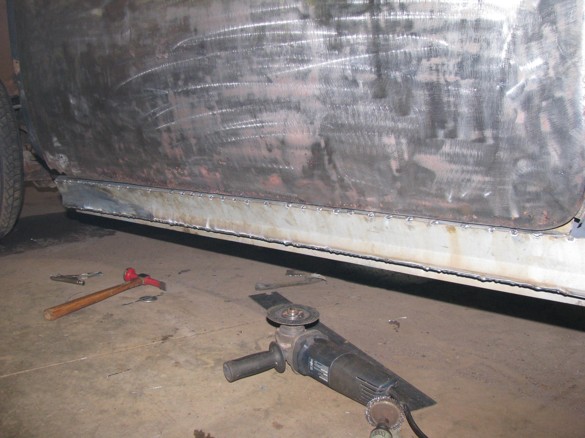

  5. Hello All. Its been a couple weeks and I have a little more progress on the buick. The first 5 are the rockerpanel in various stages of repair . I capped both ends of the panels for more strength . After the car is painted these panels will get a healthy dose of dripless undercoating to protect them from rust for a long time . :) Pic#6 is the panel I made for the front section of the quaterpanel . Its tough to see but I had to form a rolled lip on the bottom . These Buicks had a flare at the bottom from the front fender all the way to the wheel opening . I formed it with my wooden mallet I made and a beater bag . I wish I had an english wheel to smooth out some of the small bumps in the panel. #7 Is the panel clamped in place and ready to be trimmed to fit around the door opening . More to follow in a few minutes . :D

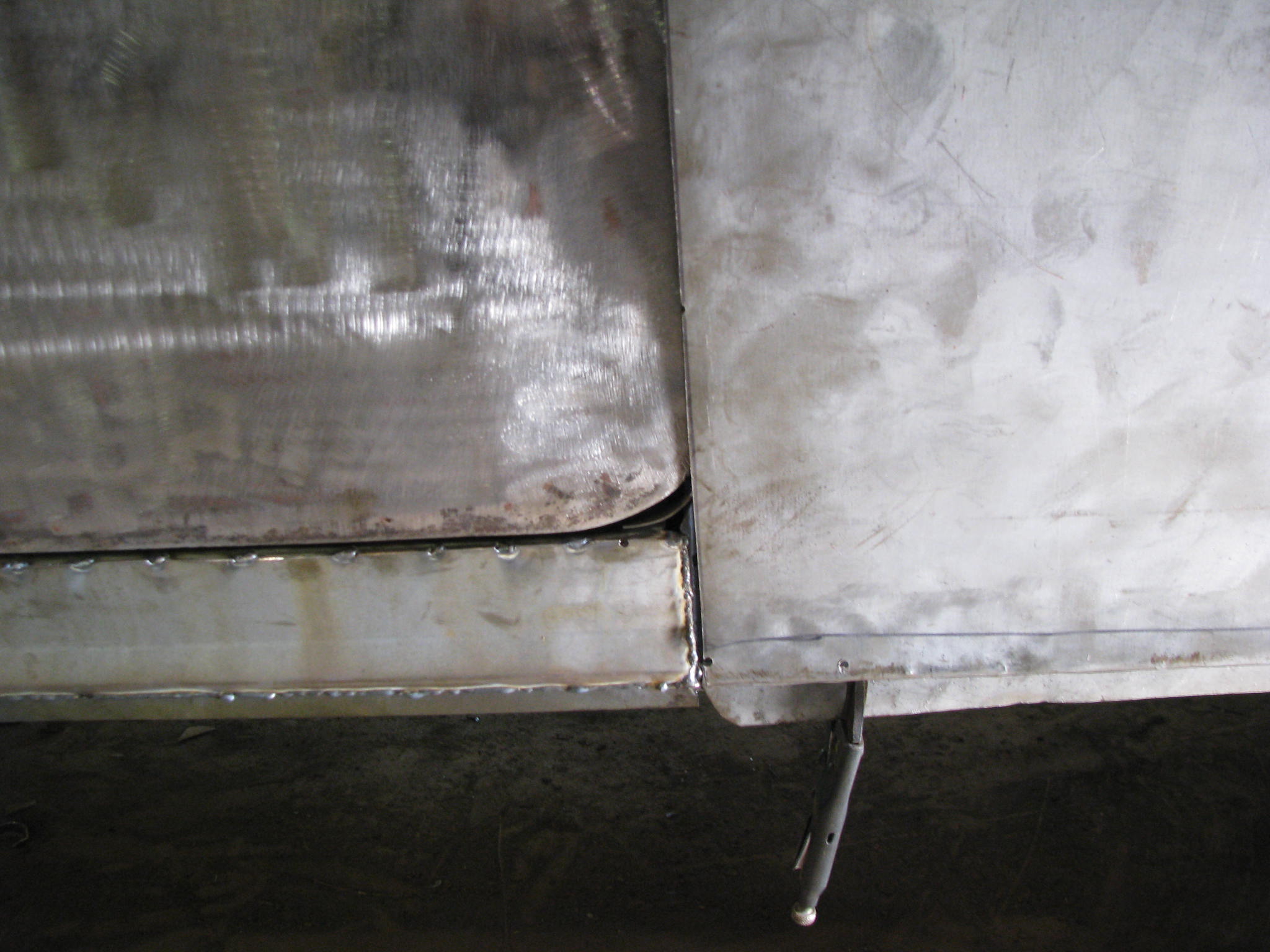

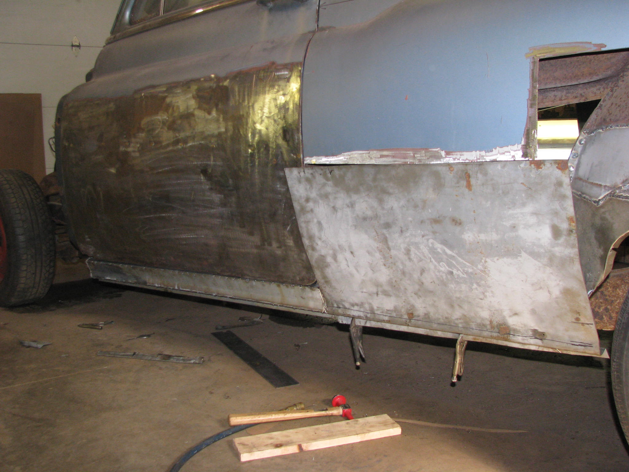

  6. Heres some more for you thread junkies . :rolleyes: The panel is trimmed for the door opening . I am going as slow as I can when it comes to this stuff to cut down on the warpage issues that come with impatience . Ask me how I know :( . The 3/16 CRS is reference lines for the body panels yet to be made . Pic # 4 is another piece of the 1951 Chevy quaterpanel. Its the same car I cut the roof from . I will use this in the chop I have planned for the Buick . I dont know how much I am going to cut at this moment maybe some of you guys can give some advise . What do ya think ? Anyway the piece is from the topside of the chevy quaterpanel and now its the bottom sid of the Buick quaterpanel . I am glad I took these panels last summer :) . Pic # 5,6 The car is starting to look like something. Cant wait til next saturday . Maybe the rest of the quater and wheel opening will be done . Or at least tacked all together ??? Later , Andy...

  13. Yeah Fitzee you could be right on that one . Anyways , the cars quater panel will be finished somewhat like a chevys quaterpanel, like yours but I will add the reveal line that these cars had as a reference . The reason for that is I am going to run Cruiserskirts on the Buick . No need to go to all that work and then cover it all up with skirts . The plan for the car is , Chopped top , Frenched Headlights , 49 Ford Tailights Frenched Verticly, and a quaterpanel stretch of 2-3" This will give the car an even longer and lower appearance . The skirts will be made with a wireform and a lot of shaping by hand , sandbag and hammer and the good old knee . This is the plan of attack anyways . Later ,

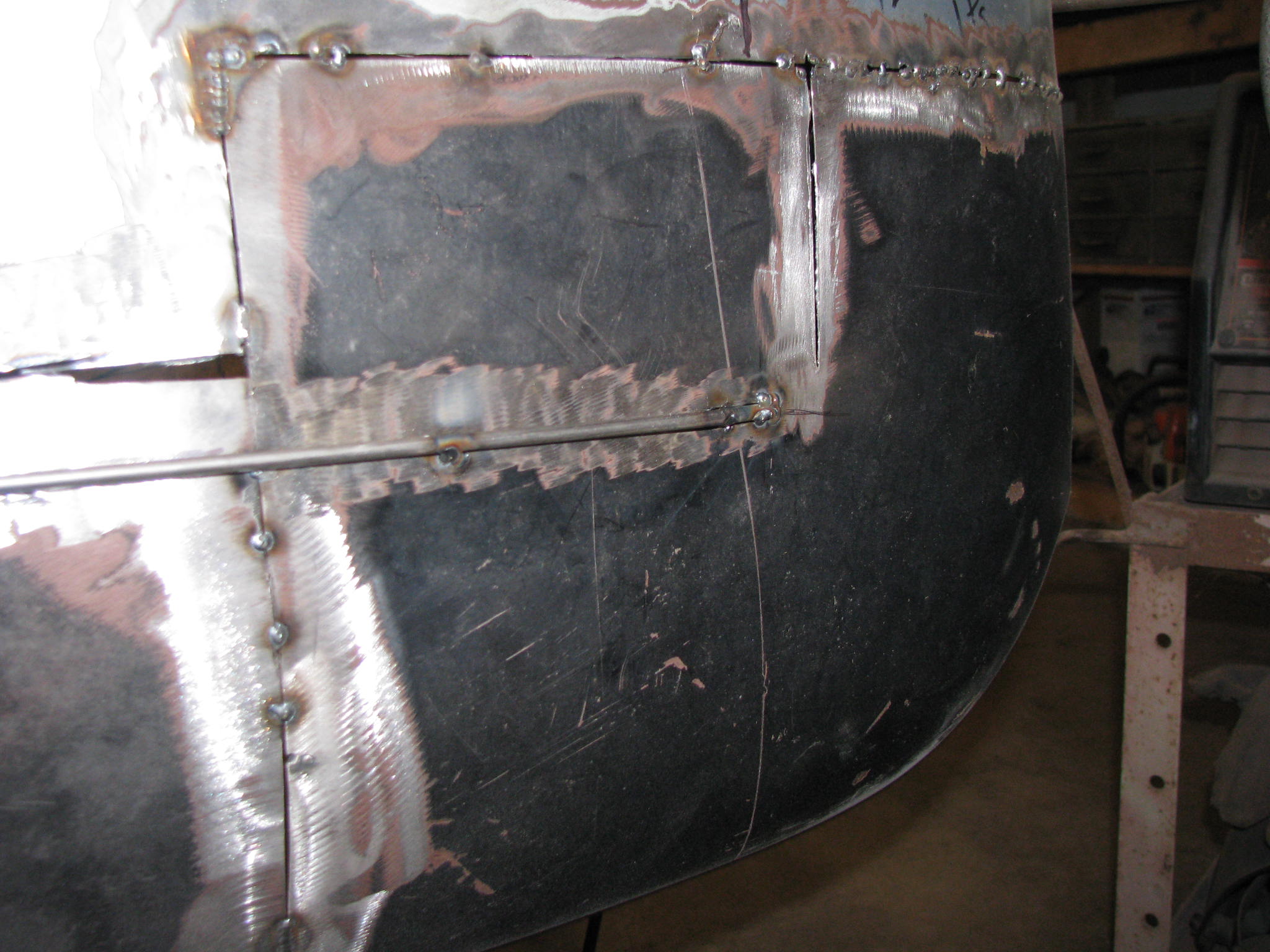

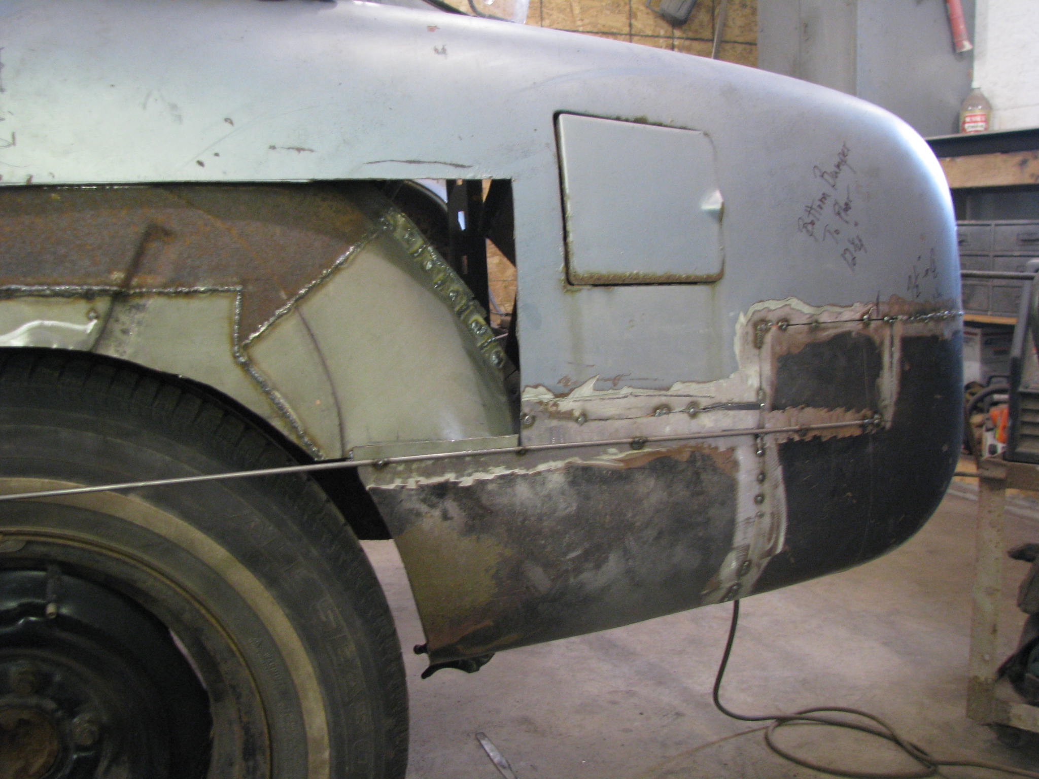

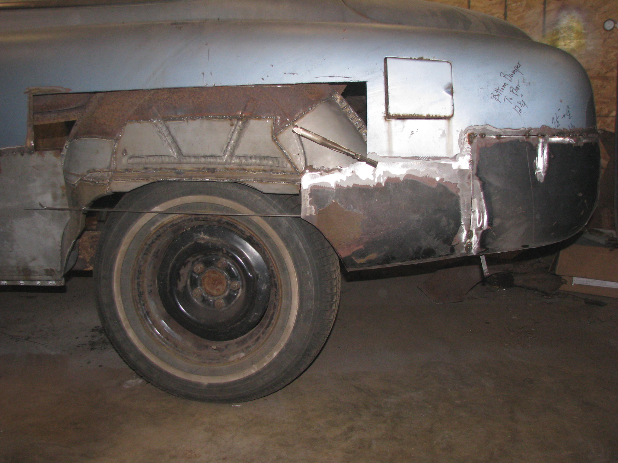

  22. Starting to come together . I had to remove some of the inner wheelwell as I was not going to be able to take the rear wheel off if I had of left it that way . I kinda like the radiused look of the wheelwell . Anyway the 3/16 CRS is the starting of the reveal line that fades into the rear quater. I think that I have to cut off the spotwelds of the reveal that reverses to the wheelopening . I believe that it should be at more of an angle , I think right to the wheel opening ??? More to come ...

  29. Thanks for the input guys its invaluable , but I think I am in for more cutting of the quaterpanel at the back if I want to run skirts . See in the first set of Pics , The no. 3 photo and also 2 of 5 in the second set ? In your opinion would you think that the quater needs to be cut and lowered to the same plane as the quarterpanel in front of the wheel to get the right flow going on cruiser skirts ? Let me know if you agree with me on this. Maybe I am not seeing something ??? :confused: PS that CRS 3/16 is the reveal line . The actual fender lip is another 2.5 inches lower . I believe that there is a sharpie line in one of the pics that represents the quarterpanel wheel opening . Andy...

    That is how I would do it drop the back of the quarter down, its only tack welded eh :rolleyes: . You could always make them a little higher than the"stock" body reveal also,to help with the tire clearance issue every little bit helps! This would also alow you to mount the back bumper a little lower which will also give a visual illusion of the car being a bit lower than it is. I am gonna build some long flush fit skirts for the 47 based on the style of original 41 Fords but they will be flush fit which will give me a lot of room to help getting rear tires on and off. It can be hard to visualize with the car sitting higher than you will have it at the end. You could take the wheels off and set it on blocks at your desired ride height, it might help you with your design....
