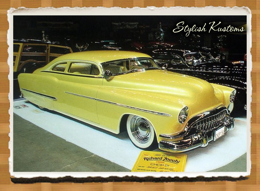

    I think that the rear section should of been lower behind the wheel anyway. Seems ever one i look at had a mild up hill flow to the lower side of the car. I found some pictures,Hare to find Buicks but olds has the same quarter lines and you can get the idea from them. I think a Cruiser skirt would save you a lot of work. Can you take a full side shot of the quarter and post it. You have some pics and they are chopped off. Would like to photo shop a set of skirts on the car.

    Yeah Fitzee I will try and get a full shot in the next day or two , but will try to fit in a few minutes for a side profile shot . Probably have to roll it outside . Andy.. PS Those are very nice examples of what could be . HMMMM !

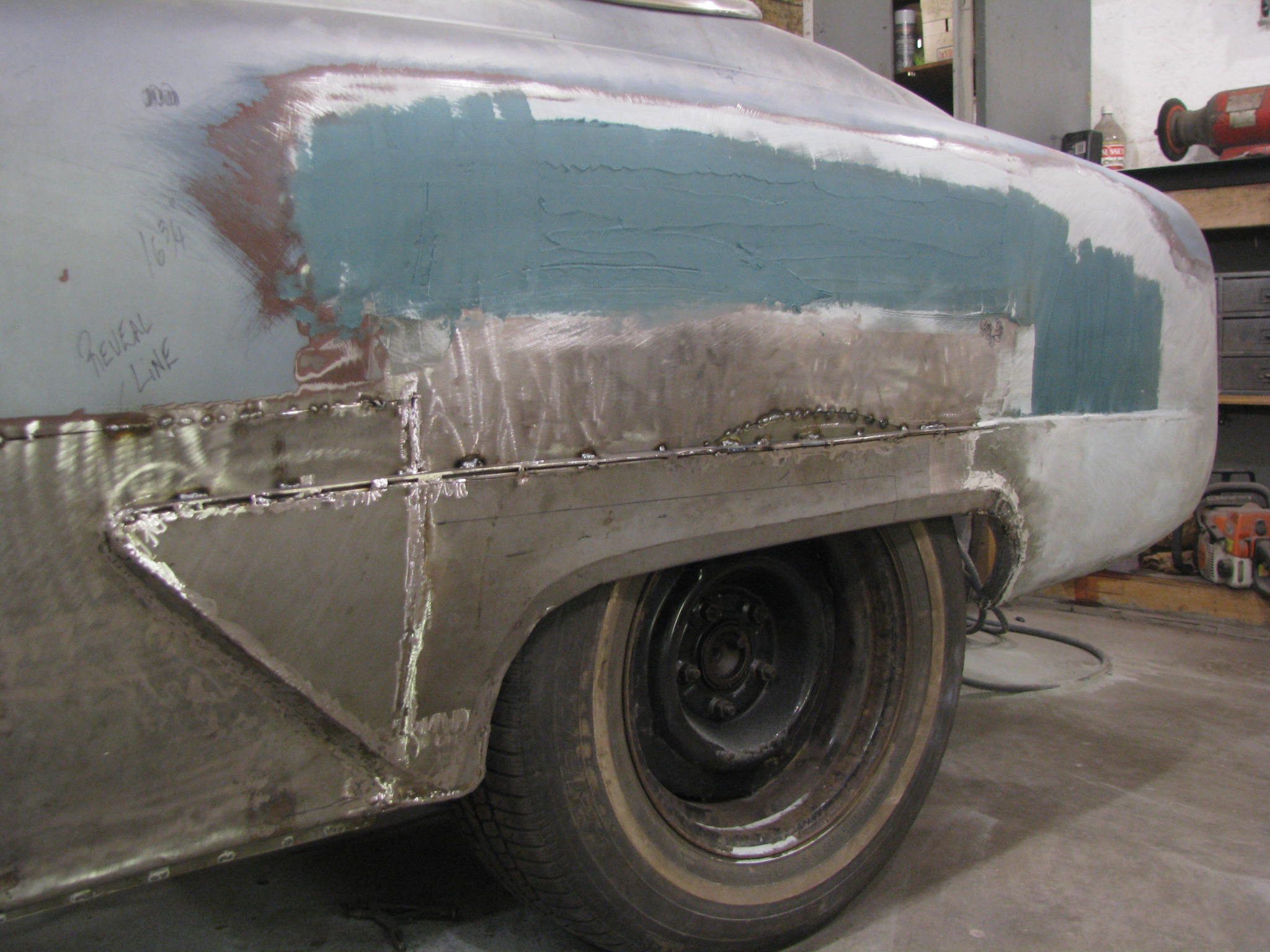

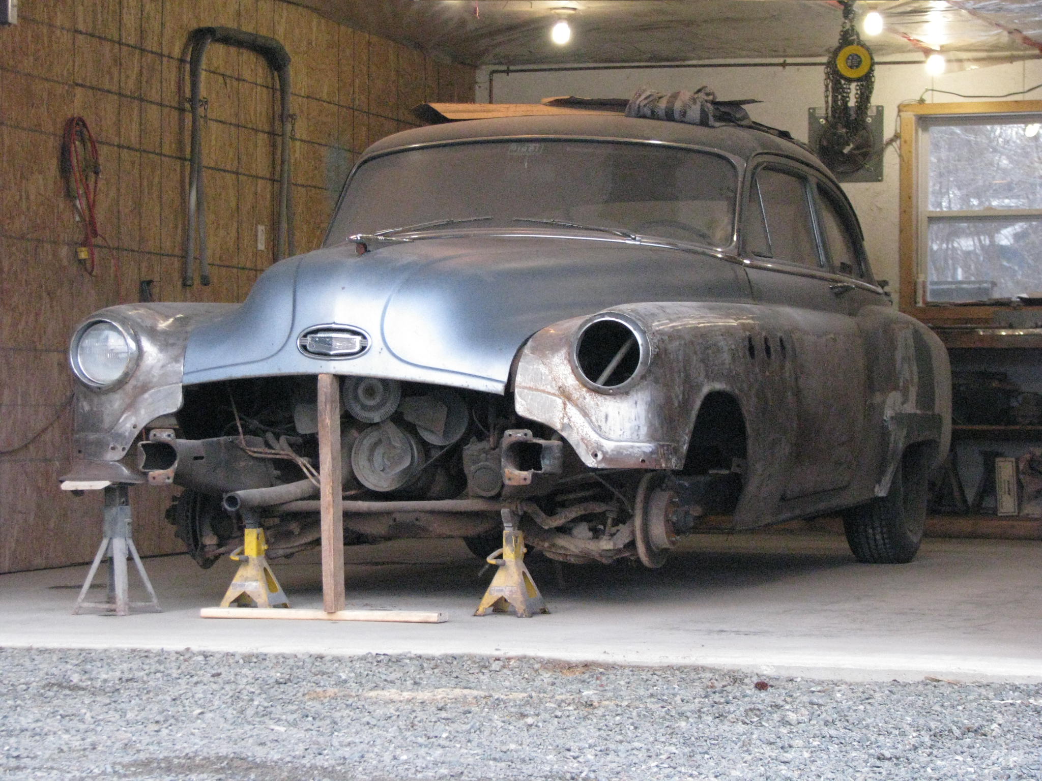

    Was able to take a few hours tonight and worked on the quarterpanel. I used some of the quarterpanel from the donor Caprice . Go figure I had to grind 3/8 of an inch of fill out of it as well . Have a look . Getting closer to the building of the body swell and wheel opening .

    Looking great Andy! I have had that happen too using a piece of some donor car :p noting like having mud on your patch panel before you weld em in !

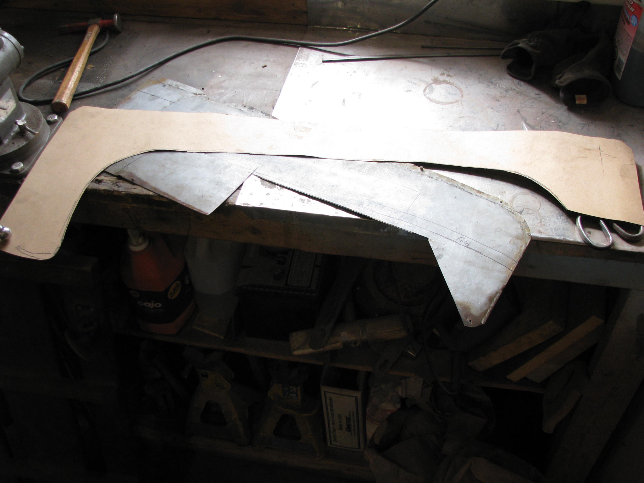

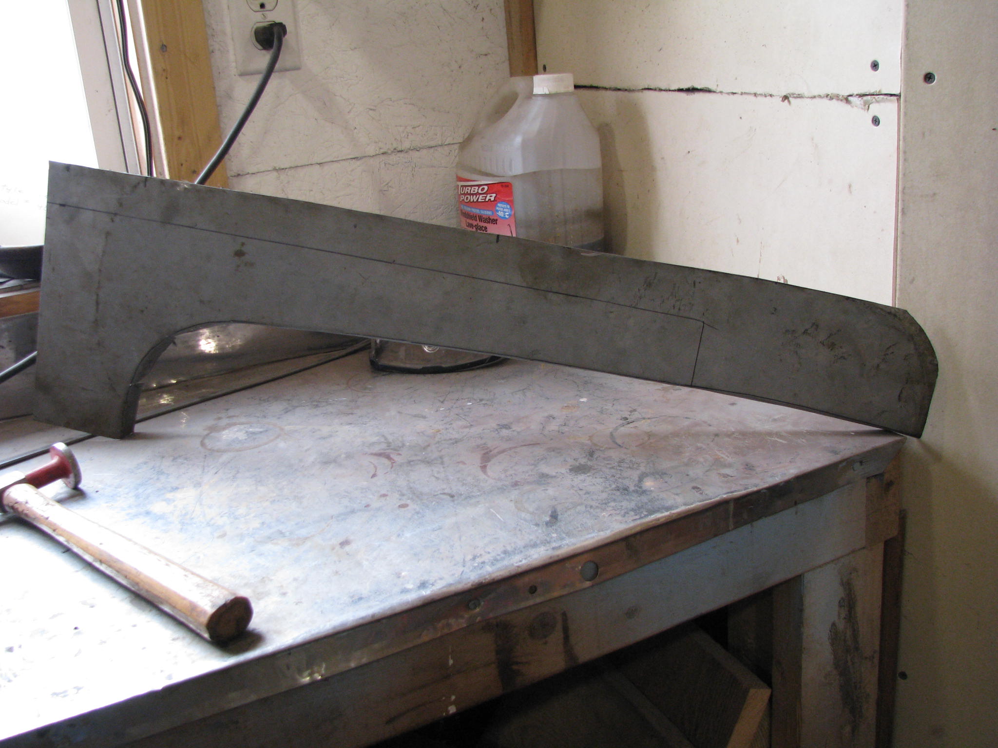

    Made up a wheelhouse outer panel . Took some carboard . Made a template from what was left of the other side . Cut it out and started forming . Sandbag and blocking hammer this is the result . I made the profile for the wheelwell opening with a chisel on the backside . This also straightens out the panel as well . I changed the sweep of the profile . It runs at more of an angle to the front of the rear opening . Pleased with the way it turned out . :D later , Andy... PS thoses of you that are following along you will see my direction has changed a little . Cruiser skirt issue has gone to the wayside ( For now anyways )

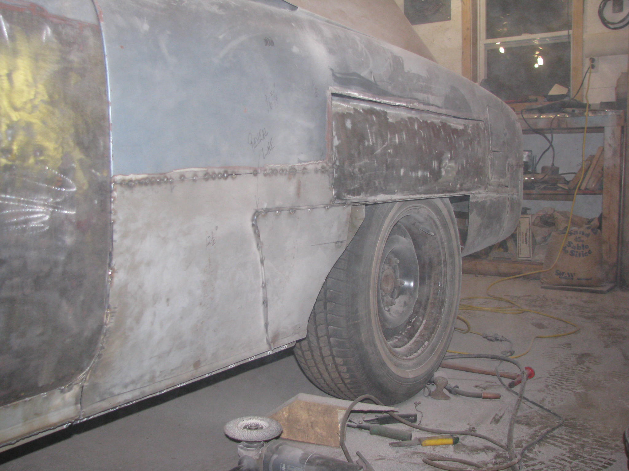

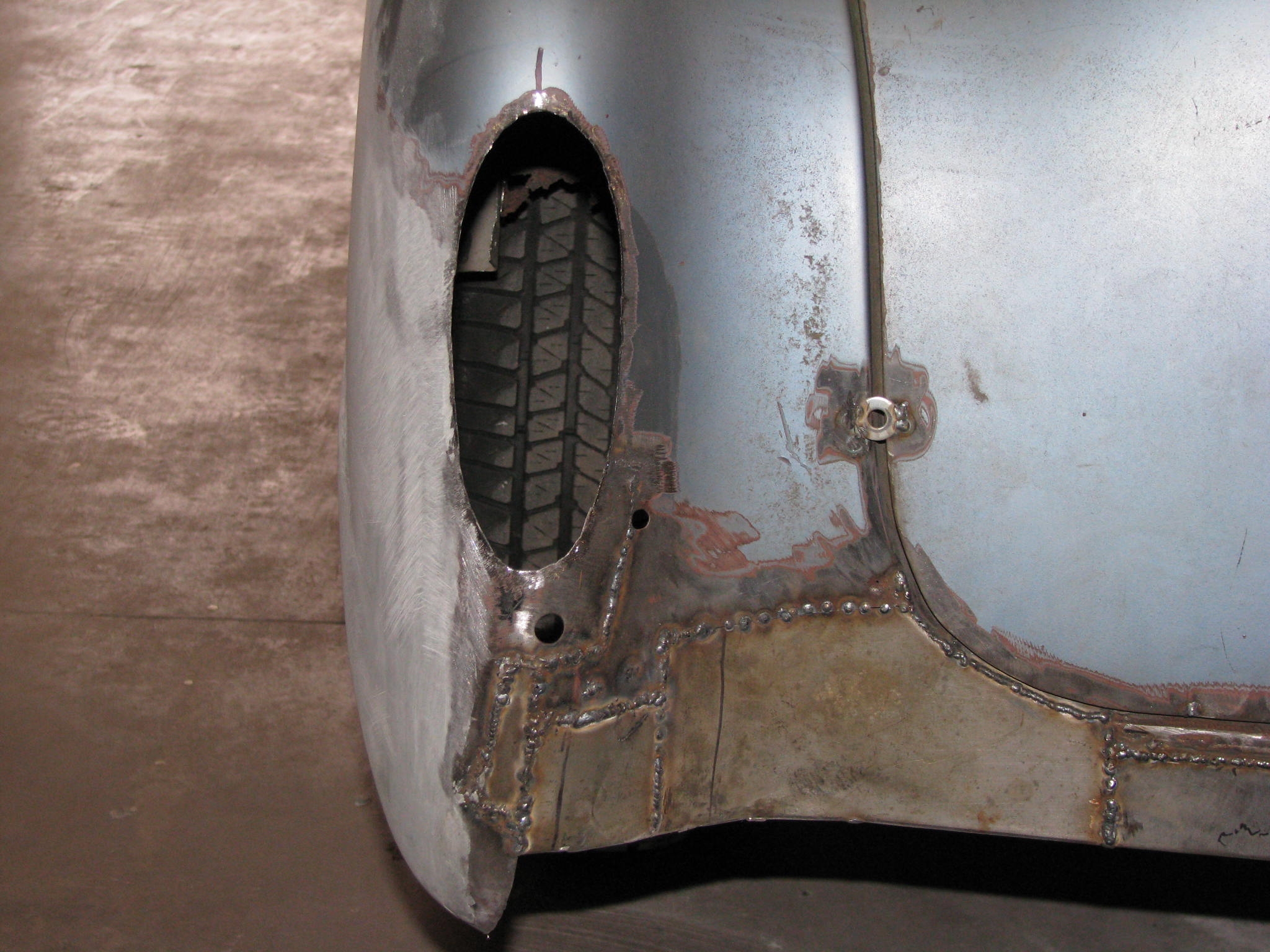

    A little more done filled the gas door in and put on a body reveal line. Fit a wheelwell rear piece . Now for lots of weldind and grinding . You cant tell in the picture but I have major warpage issues around the gas door opening . There are multiple panel in this one area and that causes a major issue . They all have to be welded and they all need to be ground. This is tedious stuff . :confused:

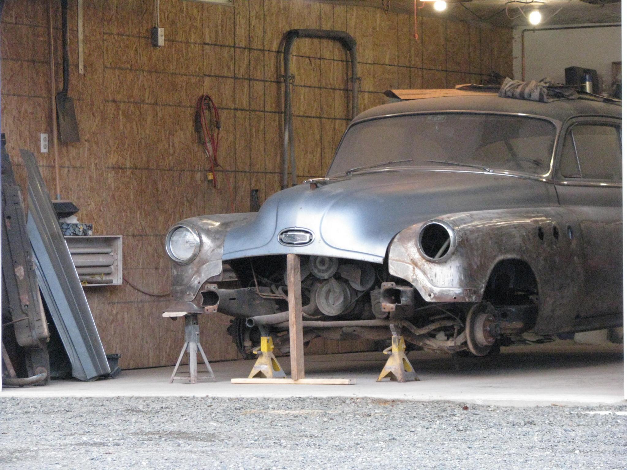

    Just a couple of pics for now . The quarter is starting to get there .

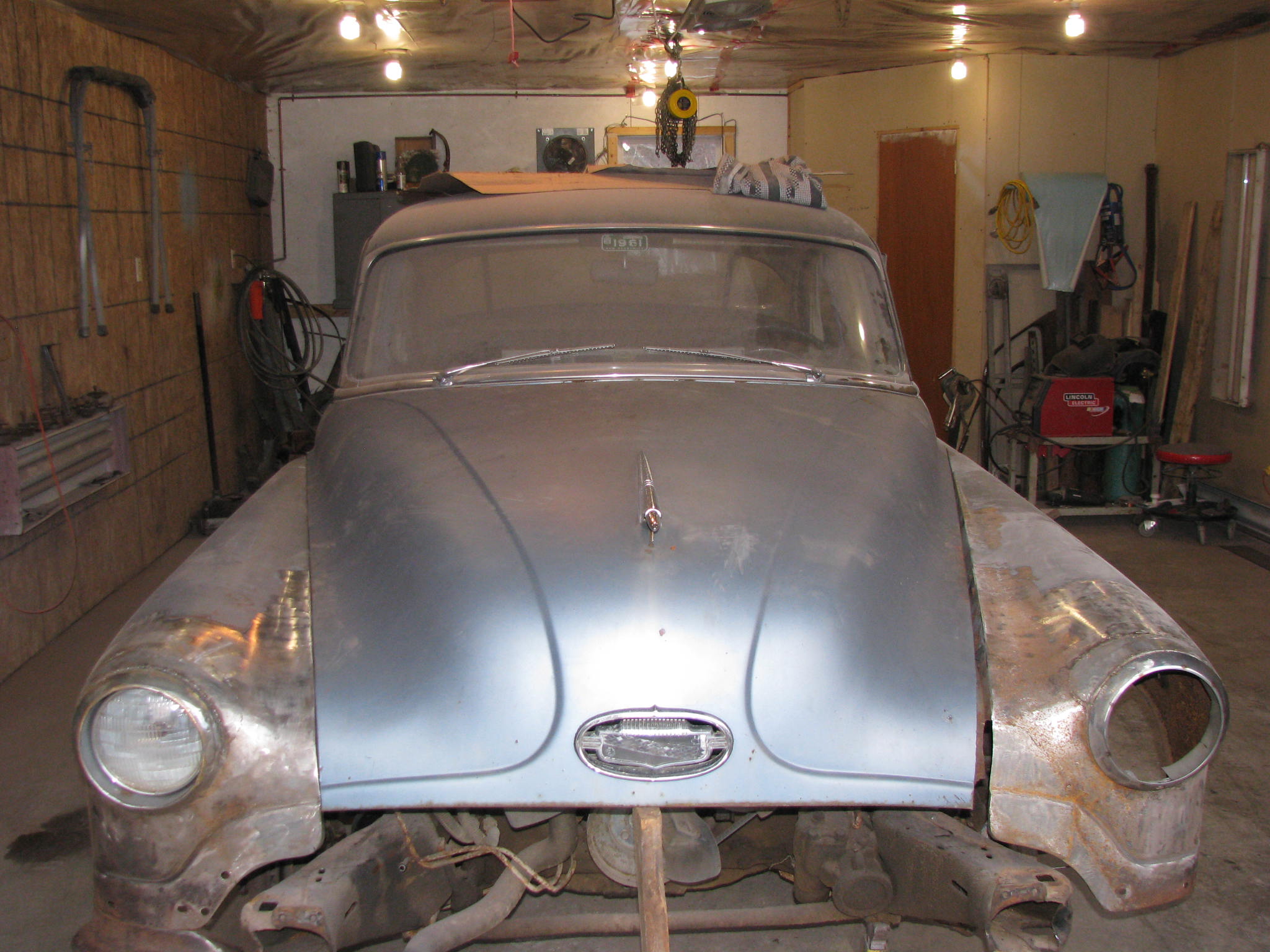

    A little more progress today . The quarter is comimg along , still a lot of blocking though . Have the roughed out hole in the rear quarter for the 49 ford tailights ( Thanks Rob ) Stuck the p*** fender and hood on just for some looks . I need some motivation sometimes . Not to many pictures to show as I have been working mostly on the rear quarter sanding . We all know thats about as much fun as watching paint dry . Later , Andy...
