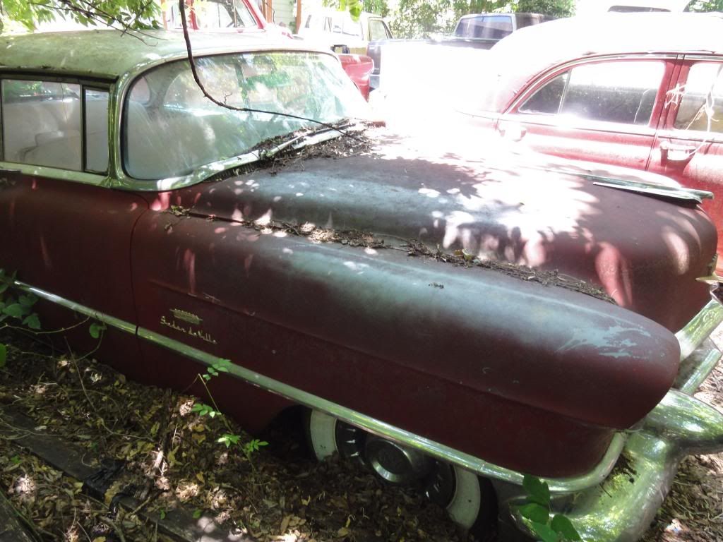

    While I was waiting on the compression tester to come in the mail (hopefully tomorrow), I decided not to waste any time and clean up the white paint on the caddy. The white roof and tops of the doors was about the only paint that could even be saved. Ill have to paint the rest of the car. Take a look at the before and after pics:
    BEFORE:
    AFTER
