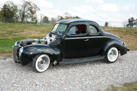

    I have been looking at ‘40 coupe threads for a few days and there are so many nice 40’s out there it’s hard to decide exactly what I want to end up with but I really like Gary’s (Hot-Rod Roadsters) Black 40 and will probably try to follow that look.

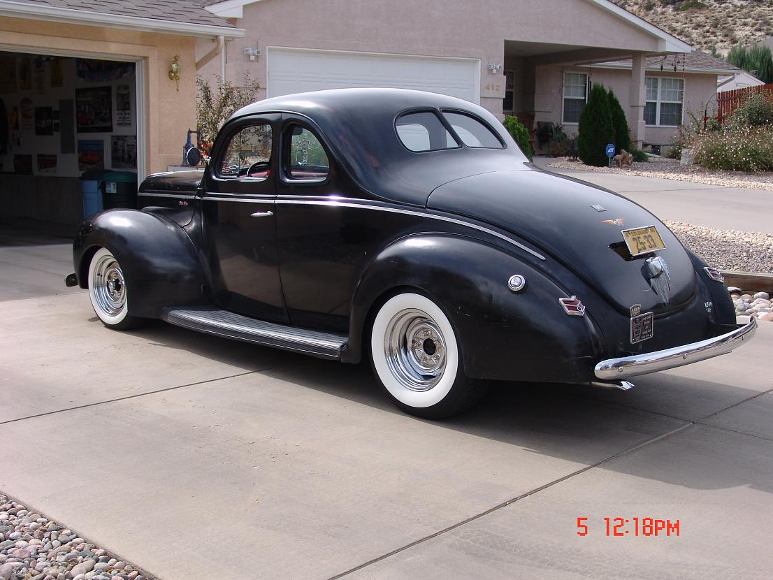

    While its a driver, it's not what I have in mind. The interior is the original rotted out mohair stuff. I've already pulled it all out of there. It is a pretty unmolested car though. But this is more like what I have in Mind

    Oh my...that is nice !!
    Good luck, and anxious to see what you do with it.

    a good looking coupe. I would lose the whitewalls

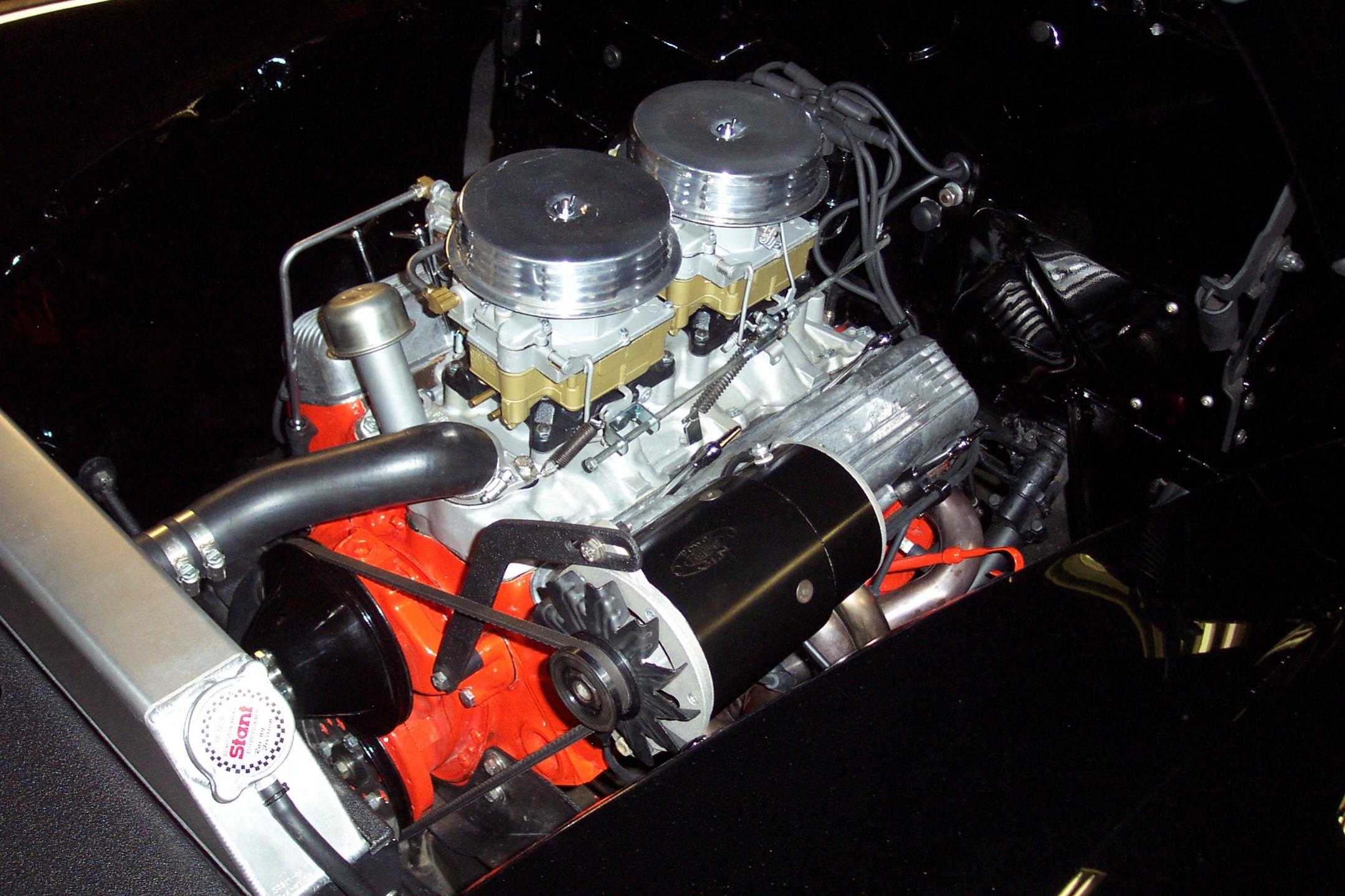

    Love your thinking....here is what I put in my old (since sold) 40 sedan....

    Pat I'm sure you'll find something cool
    Thats NICE!!!, Do you think there would have been enough room in front to fit a 2" blower drive in there?

    You would certainly have to measure, but I think so! Lots of room under those hoods! Good luck with your build! I may have a set of side chrome for a coupe if you need it.....Eric
