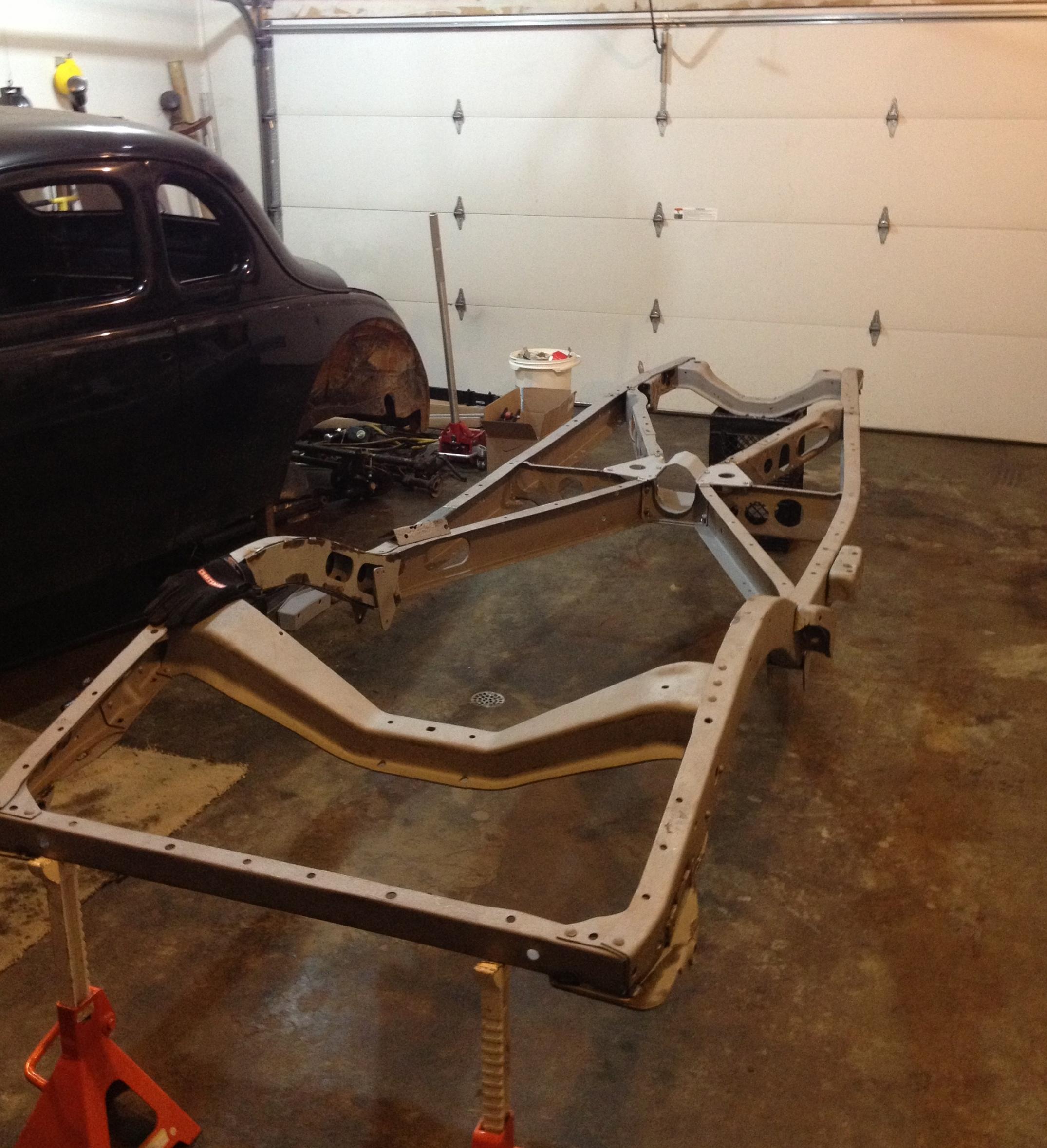

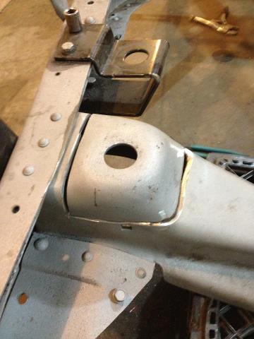

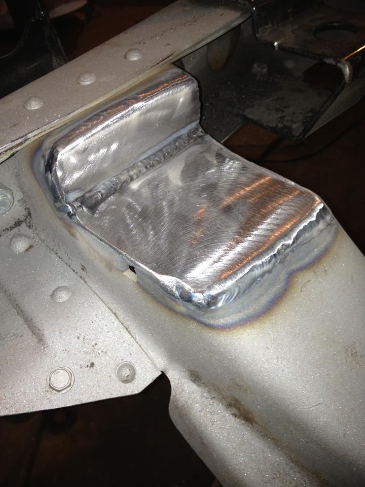

    Little more progress so far, frame is back from the blaster. Got the Ch***is Engineering Parallel rear spring & suspension kit installed. I decided to weld them on rather than bolt on. I also used a set of their rear boxing plates too. I have the transmission center X member kit also installed. Removing those rivets and the factory center piece was no fun at all. Cut, drill, heat, then airchisel the remaining rivet out. Then repeat about 20 more times! The CE stuff is awesome! Everything fits as it was supposed to and is all high quality stuff. I had to cut out and replace one small section of the ch***is right where one of the body mounts is located CE also has the body mount to replace it with too.

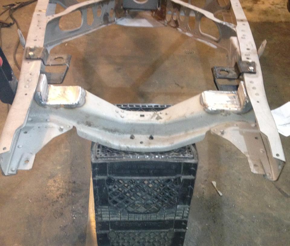

    I got the Ch***is Engineering SBC motor mounts and the front shock brackets on. These are Bolt-on and only required locating and drilling the holes.
    I also notched both sides of the stock crossmember to accomodate the fuel pump on the right and whatever may end up located on the lower left of the engine.

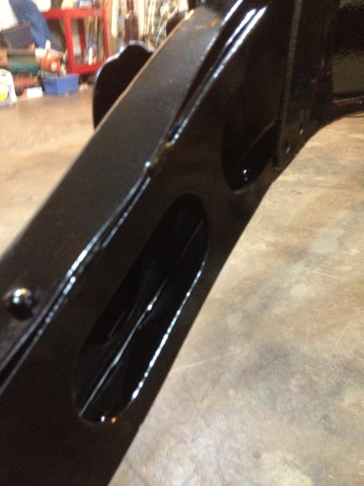

    Got the Ch***is back from the Powder coater today. It turned out great, seems to be much more durable than paint. I can reach my finger in behind the boxing plate and feel the powder coating on the back side which I dont think is possible with paint either without dipping, so I am really happy with the out come. The cost was $200.00 for blasting and baking it twice and $250.00 for the powder coating so $450.00 total.
