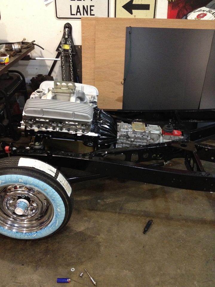

    Little more progress but its a big step towards completion. Motor and trans are in the chassis. I couldn't find much information about the Tremec 5 speed into a '40 so I'll post a few pictures of what it took to fit it with the CE split bones and X member kit. The upper portion of the CE loop had to be notched back as well as the bottom plate. I ordered my bottom plate without trans mounts and just drilled for the trans mount which was further rearward than the TH350 would have been. The shifter location may vary too. I'm going to run 65 Mustang bucket seats. For a bench seat the shifter location may be moved forward.

    Man Mike, you sure do nice work. I'll be anxious to hear how that Tremec works for you. I'm not super confident with the T5 in my truck. First sign of trouble and I'm taking the plunge.

    Looks good Russco, I'd like to see where the shifter is in relationship to the seats. It looks like even if you buy the kit to move the shifter further forward you would still have to trim the top cross member support due to the casting and plate on top of the trans.
    I really need to get working on my 40's too damn many projects not enough time nor cash!
    I installed a Richmond 6 speed in my 66 El Camino and the shifter is 2 1/2 inches further back from the stock 4 speed location, don't think that will work plus that puppy is quite large.

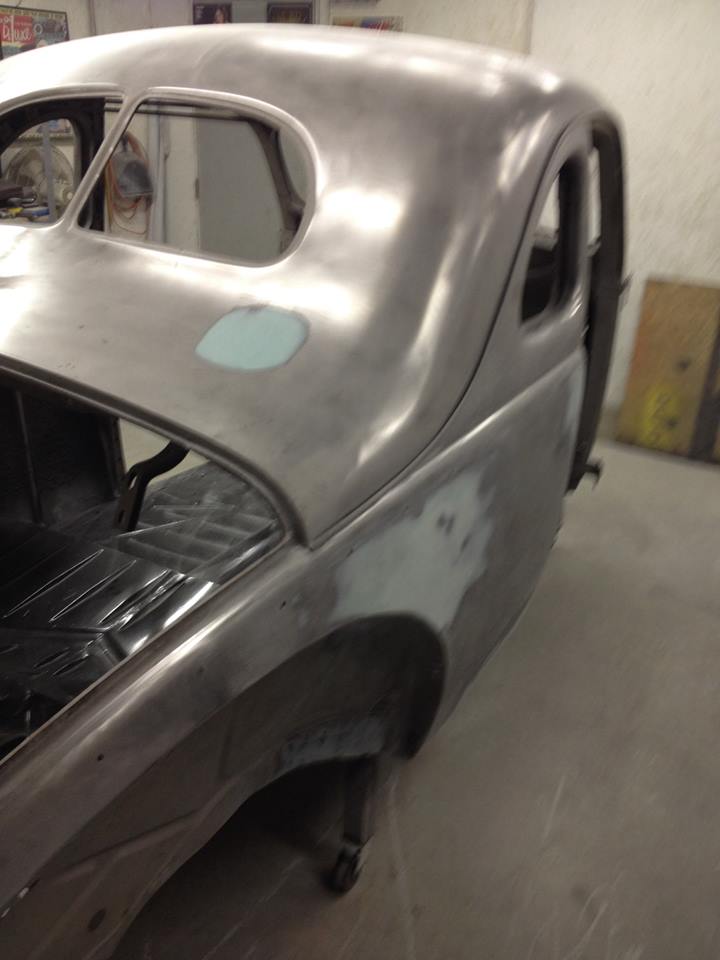

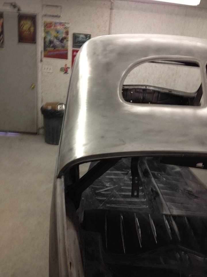

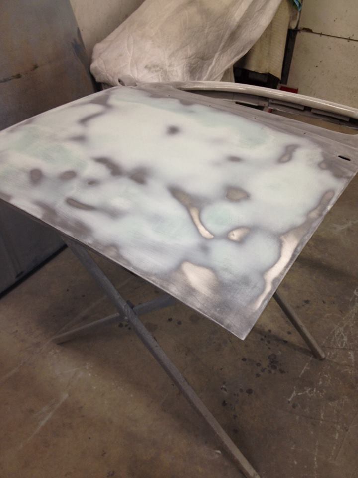

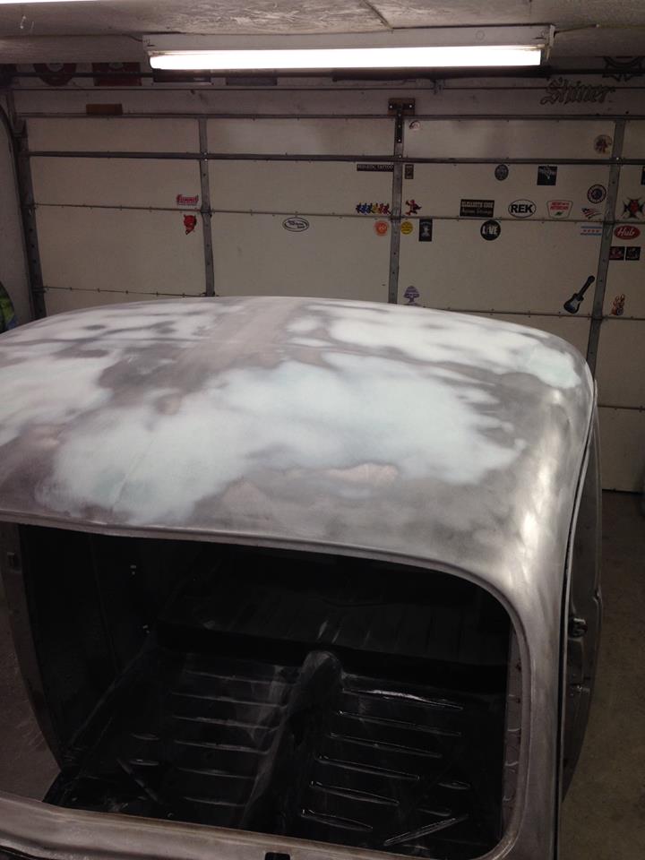

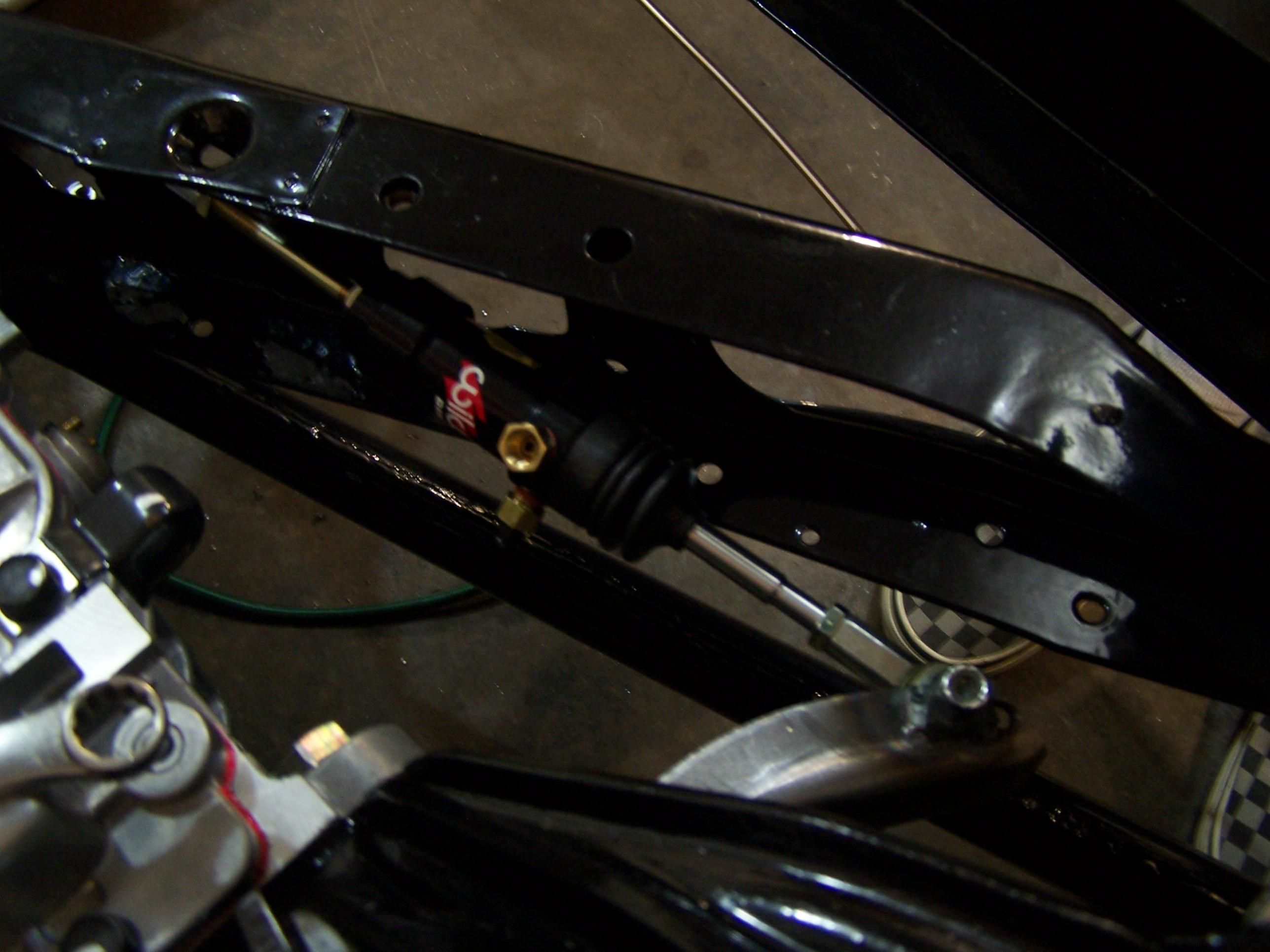

    Went to my buddy Brad's to check on the bodywork progress. Its ahead of schedule and looking pretty nice. Its ready for a coat of Slicksand a final sand and Prime for paint. I also got the hydraulic slave mounted for the clutch and am running brake lines now. I am using the Nickel/Copper alloy line man that stuff is nice to work with.

    damn that thing is clean looking!

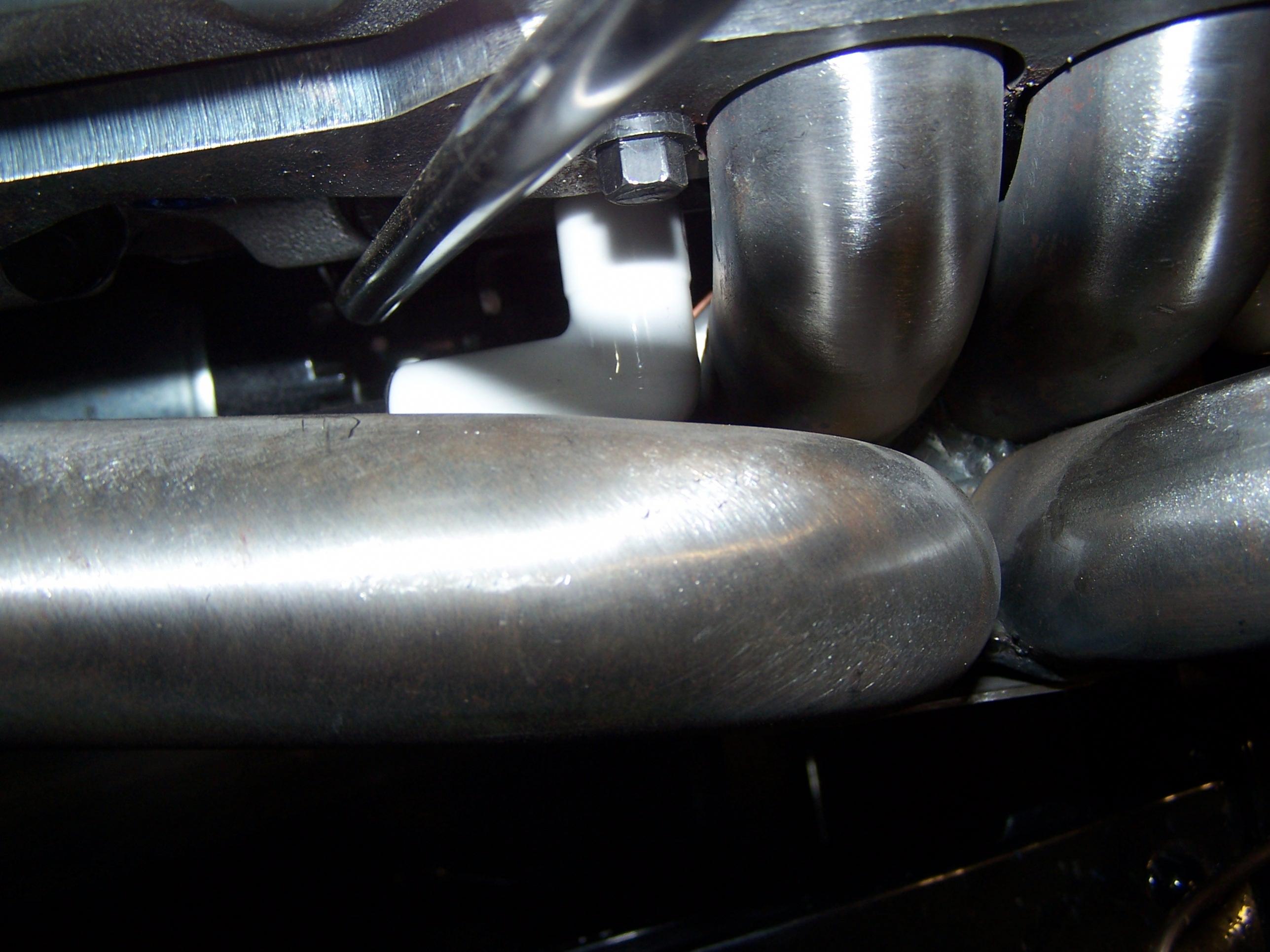

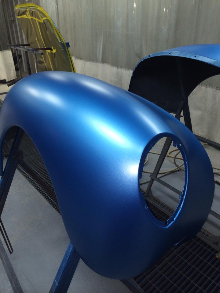

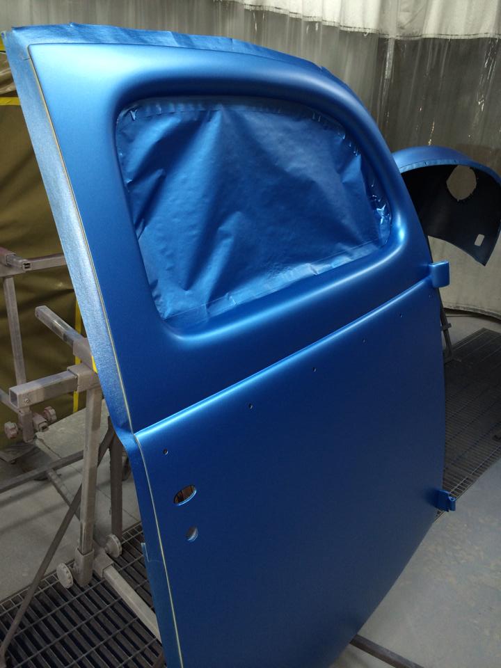

    Finally some more progress. Got the exhaust done back to the mufflers. Drive shaft done and installed. Plug wires and distributor installed. I had to use ceramic wires due to the Sanderson's headers being way to close to the #6 plug boot. I don't understand why they didn't run the header tubes out farther like on the drivers side to avoid this? Pre lubed the engine to make sure I had good oil pressure and flow to all 8 rockers. That was good, 50 PSI with 5-30 oil. I'm almost ready to fire the engine now. And the biggie I've been waiting a long time for. The body is now painted! It will have shiny clear on it but the satin look in the pics made me think twice about flat clear.

    Got it cleared and brought it home today. Now I should be able to really get moving on it. I'm glad I went with the shiny clear, the satin looked good too but in the long run I think going with the shiny is the right choice for me.

    I sure like the color, what color is it?

    It's called Surf Blue Pearl, it's a Mopar/Jeep color and this is a lighter variant of the code PQD in the Lesonal product line. It's also what they are calling B5 blue on the new Challengers but it's not the same as the original B5 color.
