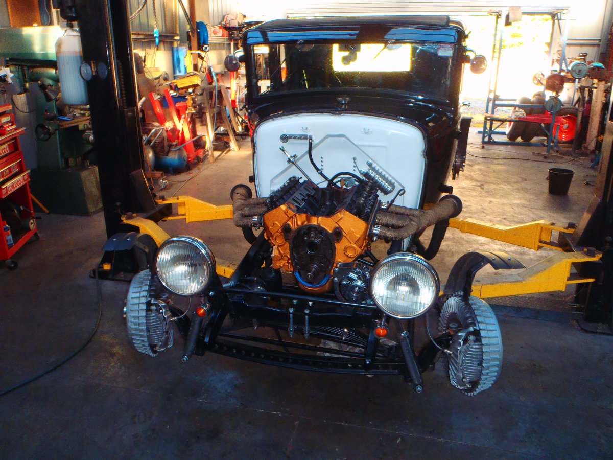

    I built my exhaust today, happy with result although mufflers hang down a bit due to brake booster location. Tomorrow I will finish weld and paint black. A few pics Glen 290.JPG 292.JPG 293.JPG 288.JPG 283.JPG

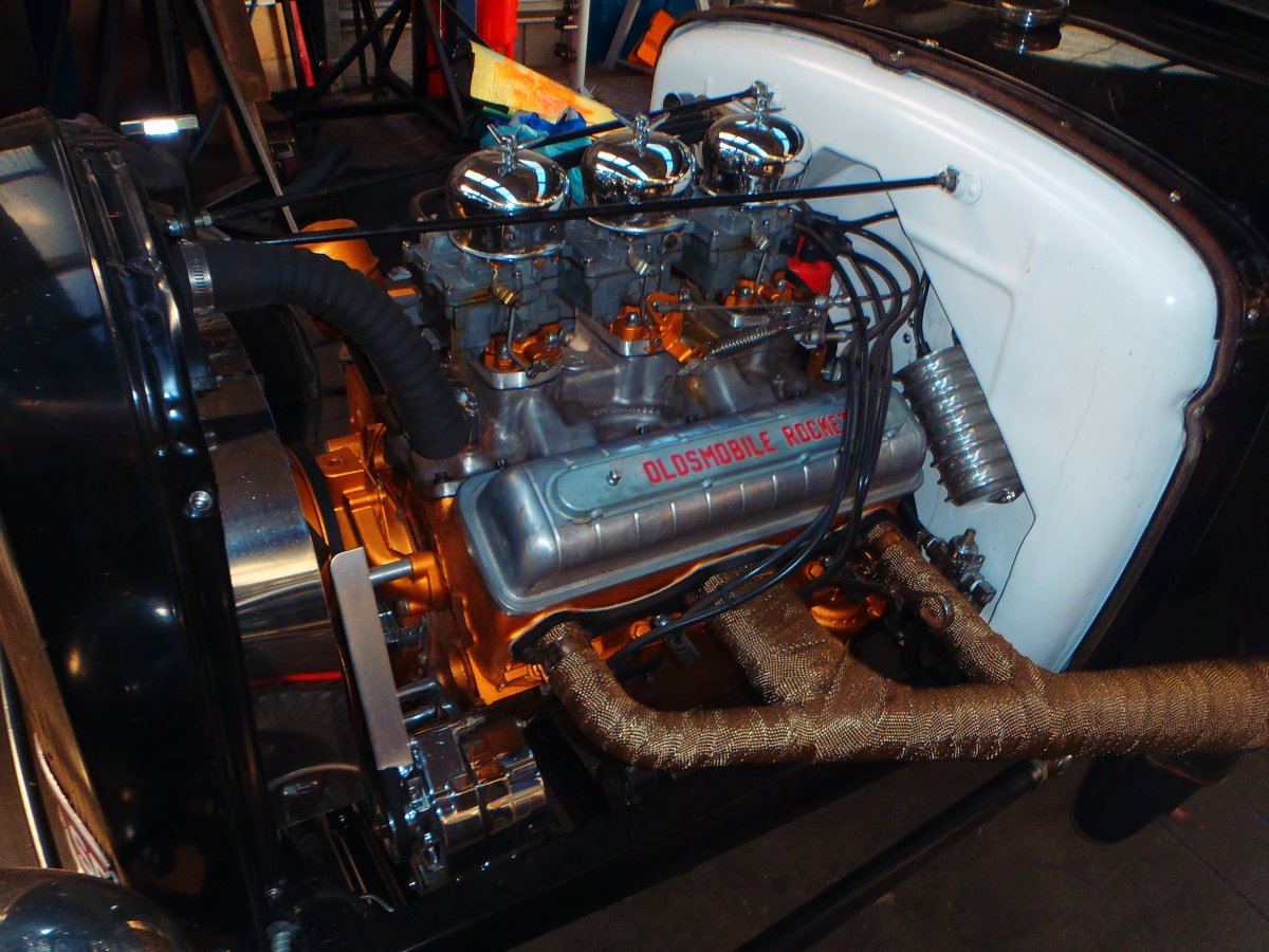

    Wrapped headers, welded pipes and painted them black, a few pics. Glen 310.JPG 313.JPG 314.JPG 315.JPG 306.JPG

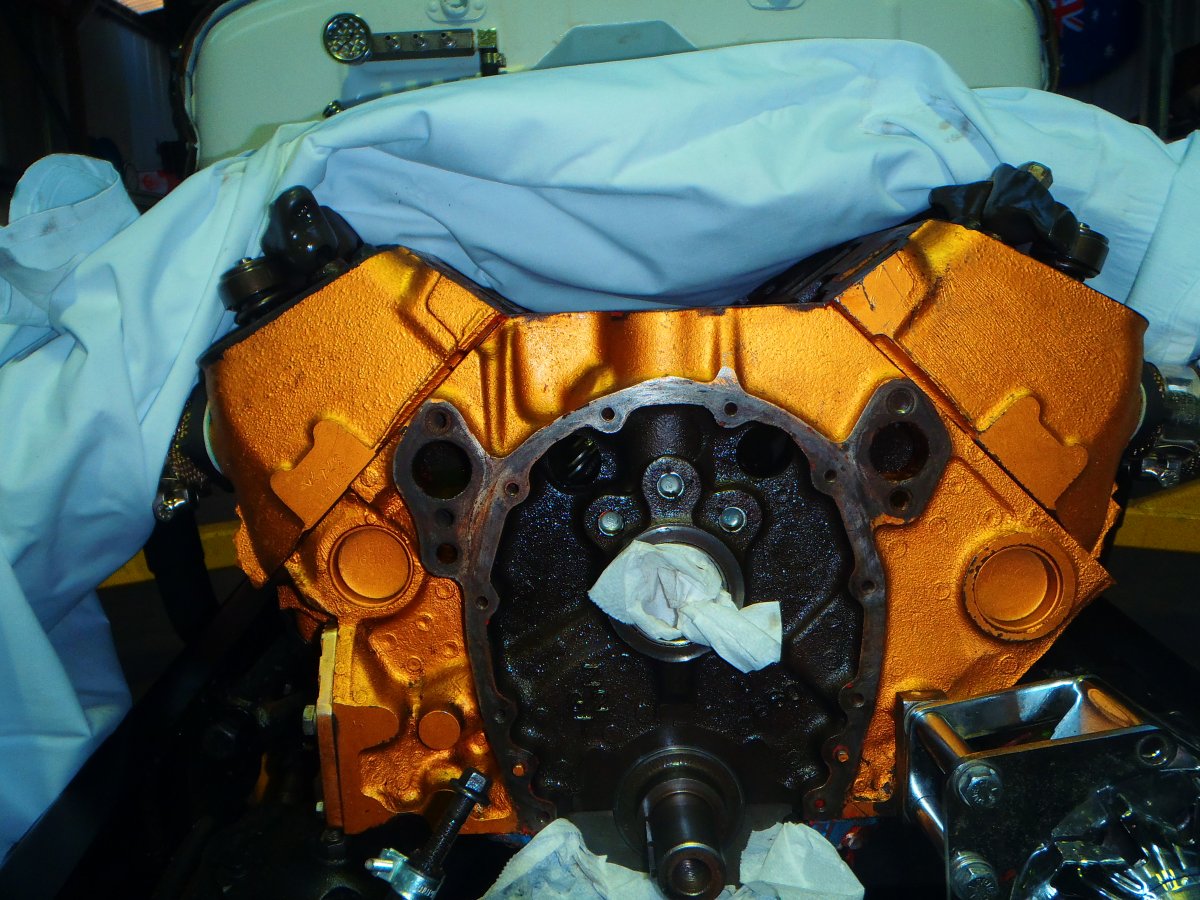

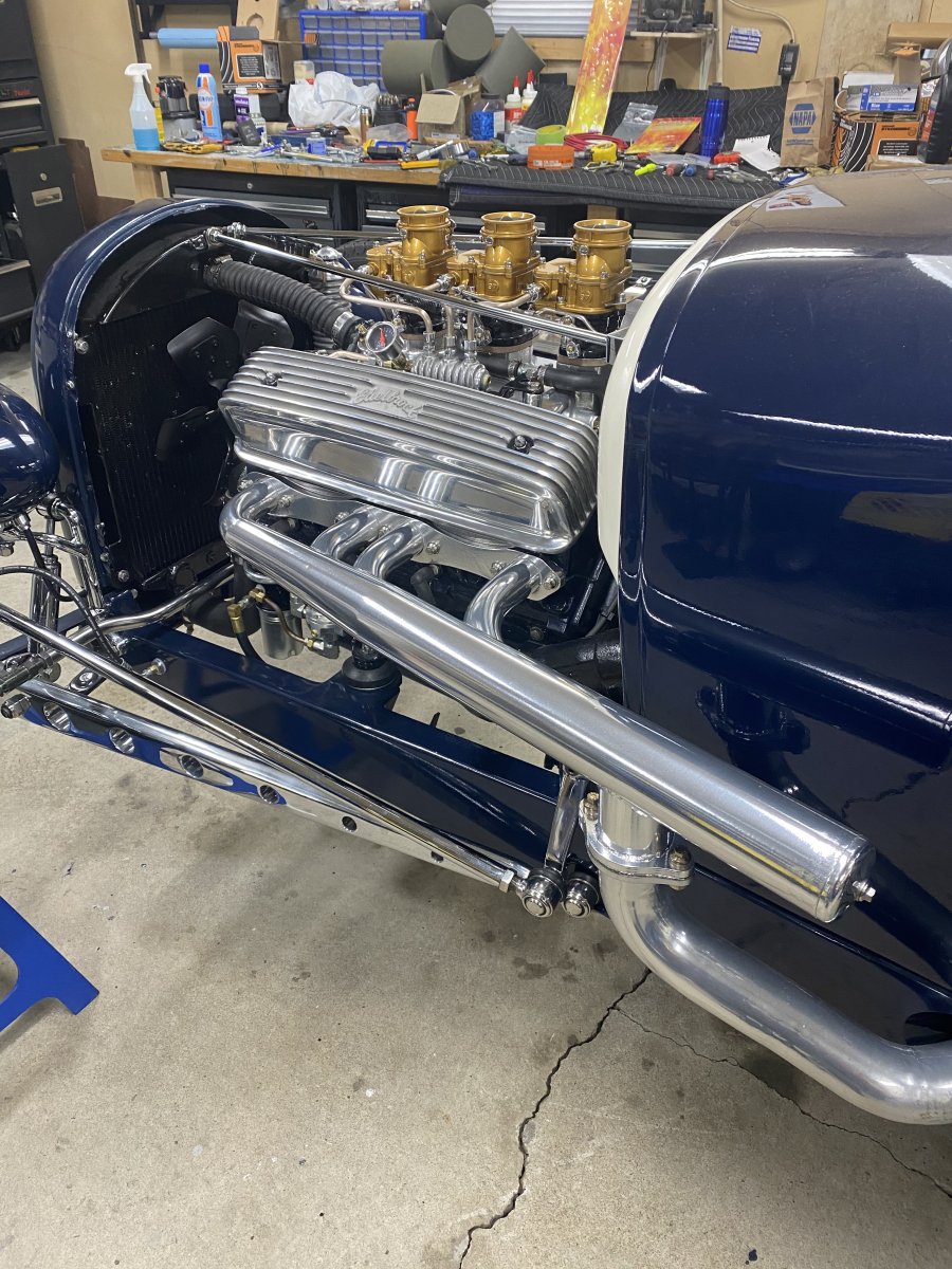

    That header wrap looks awful.
    My headers are ceramic coated as is my exhaust which I ran through the frame .
    The headers and pipes are close to the body and frame and there is no paint damage.
    D2327A9E-F4E2-4F9C-8EB6-35A02F1BB9F6.jpeg 132405AA-3299-4309-8475-8E772A06084F.jpeg 80C51D6D-34A4-4E12-A8A9-7FEEAFCDAD59.jpeg

    Installed camshaft today, sealed and ****oned up engine, just need to install accessories to start and run in motor, you are right loudbang - engine nice and easy to work on. Blue one, I love your ride but I am not a fan of keeping my rides clean. I drove a 66 T- bird daily for 10 years here in OZ and only washed it approx twice a year, car lived outside and was my only ride. Stock standard T bird coupe, red with bone vinyl top, original hubcaps with white wall tyres. My kids grew up with this car. (wish I still had it) I know my current ride has turned out sort of pretty but with use it may not shine so much. I feel the wrap gives the car a sort of Bad / race look - my take on things. I am open to all opinions but just letting others know, how I like my own personal rides. Glen

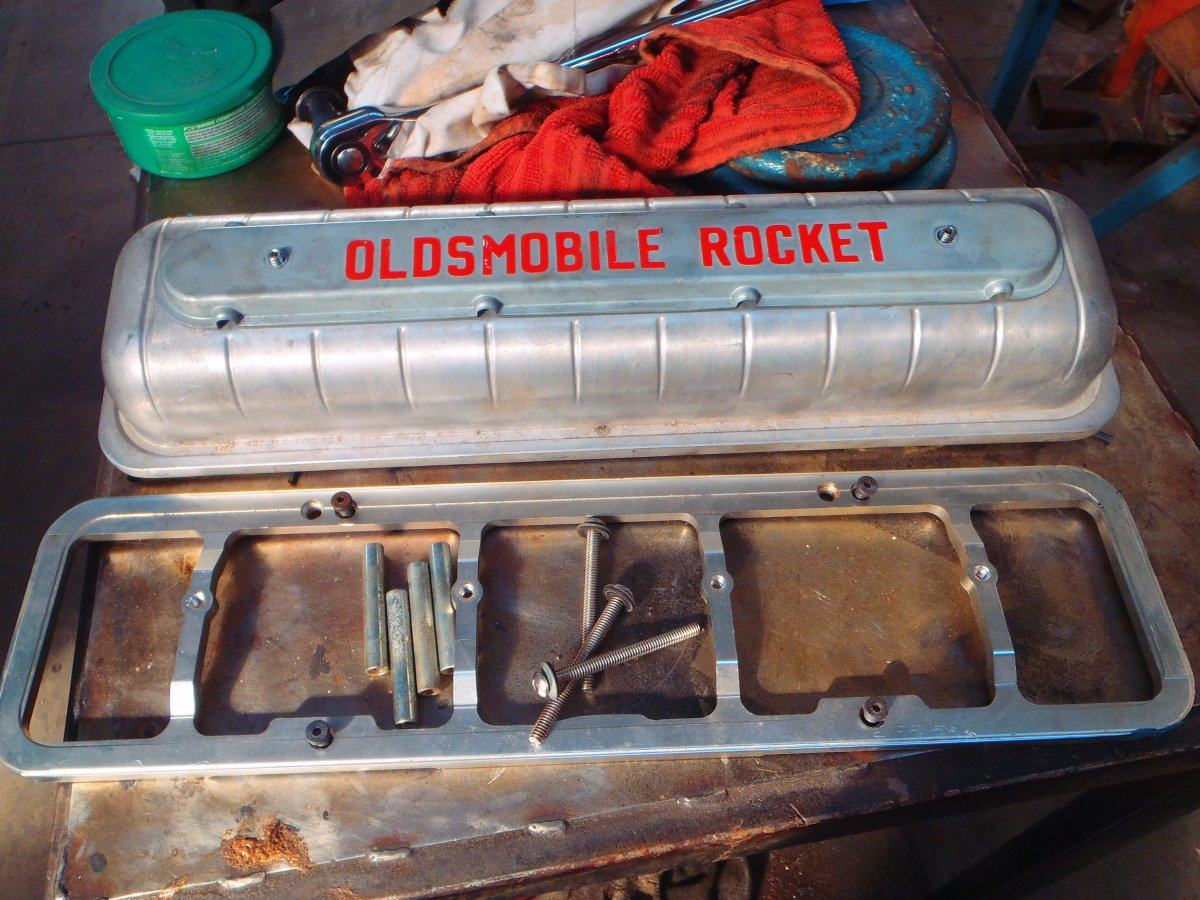

    Been enjoying my ride lately, done almost 3000km of trouble free cruising. I recently purchased these oldsmobile rocket valve covers with adapter plates for a sbc, will clean them up tonight and install them for a different look. Glen 341.JPG 340.JPG

    Thanks guys, I happy with car so far, Trolls don't bother me they just disappoint me with there negative **** that doesn't really matter. Anyway a few pics with rocker covers cleaned up, also a pic of car with black wheels with baby moons. Glen 346.JPG 348.JPG 343.JPG
