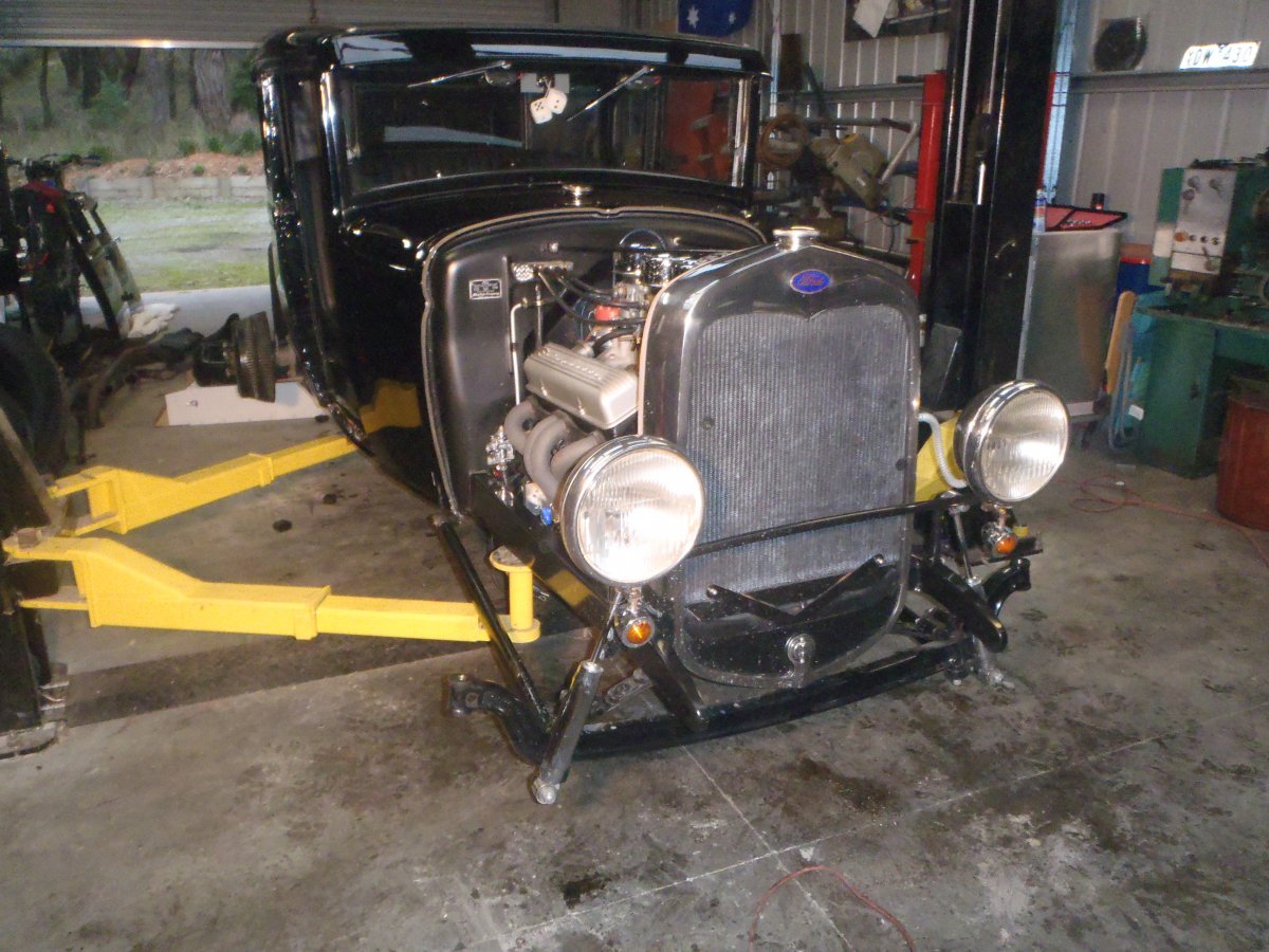

  2. grdra1
    Joined: May 20, 2013
    Posts: 686
    grdra1
    Polishing shroud was out of the question, first my alloy welding is ****, second I'm not into to much bling, I feel it go's unnoticed painted black. I have only tested by holding a sheet of newspaper up to grille, paper gets ****ed to grille at engine idle, now all I need is a hot day. Glen

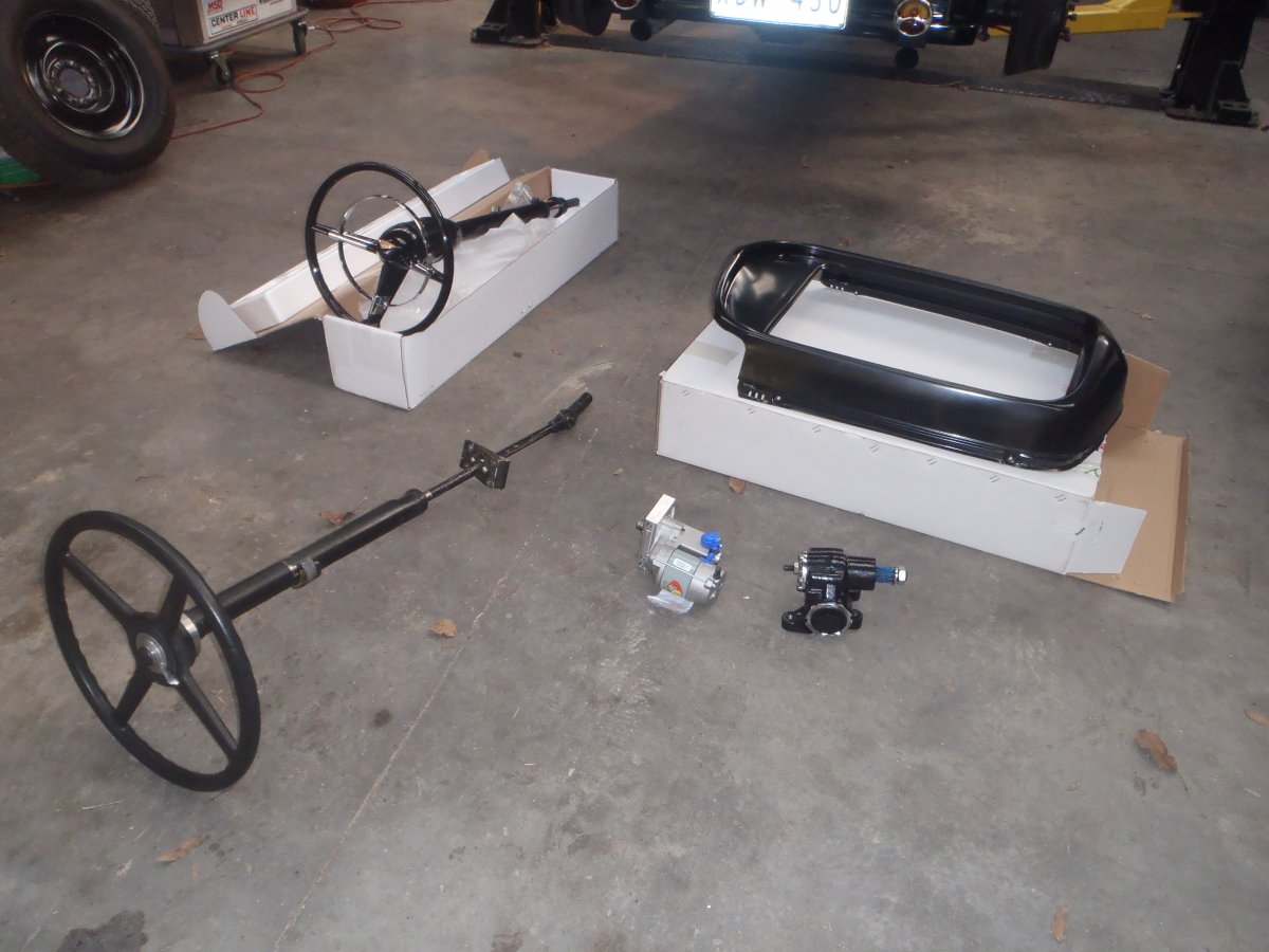

    Were did you get the rhd Vega steering box? Thank you
  9. X38
    Joined: Feb 27, 2005
    Posts: 17,498
    X38
    RHD 'vega' boxes are MIC.
  10. grdra1
    Posts: 686
    grdra1
    Purchased Vega box from a shop in Quensland - rod and custon { I think ), they are on Ebay. But I ended up using a HQ Holden box as some others had bad reports with the Vega one. Glen
  11. X38
    Posts: 17,498
    X38
    ...which is basically a RHD Saginaw 525.
    I can give examples of others who have thrown the 'vega' in the rubbish with frustration and ended up replacing it with a Holden box.

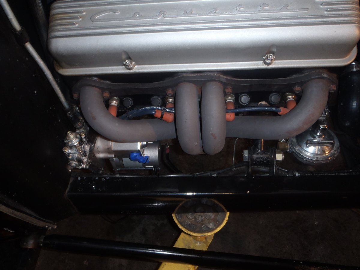

    Recently had a leaking exhaust that I could not find until I removed some header wrap, my cheap Chinese headers were rooted after only 18 months and approx 5000kms. I plan to make my own headers in the future but for now I welded up these units until I decide what type I will fabricate. ( I plan to keep the same style of header but would like to use a straight pipe instead of a cone, or maybe a torque tube type ). A few pics, Glen 20220618_154717.jpg 20220623_142324.jpg 20220623_142331.jpg 20220623_144105.jpg 20220625_102850.jpg 20220625_113817.jpg 20220625_150724.jpg 20220626_124827.jpg 20220627_090034.jpg

    Had more header issues recently, more cracks in cheap Chinese headers. Wrap removed and headers repaired, hopefully good enough to last the summer - I plan to fab my own headers soon. All I had was white high temp paint but I think it looks ok. Glen 20230109_120417.jpg

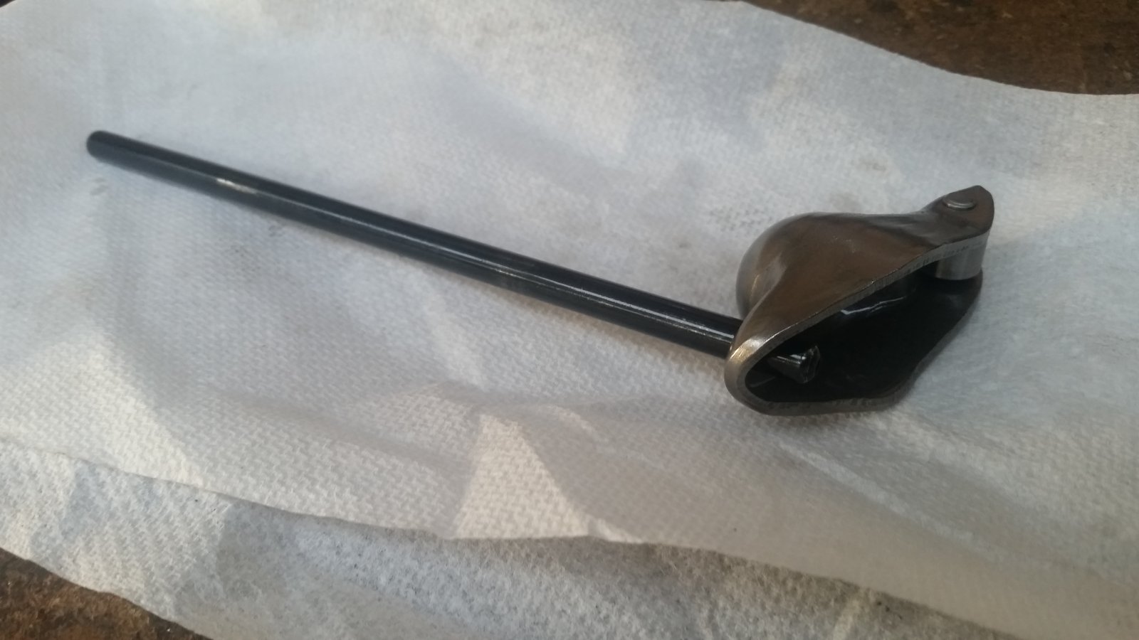

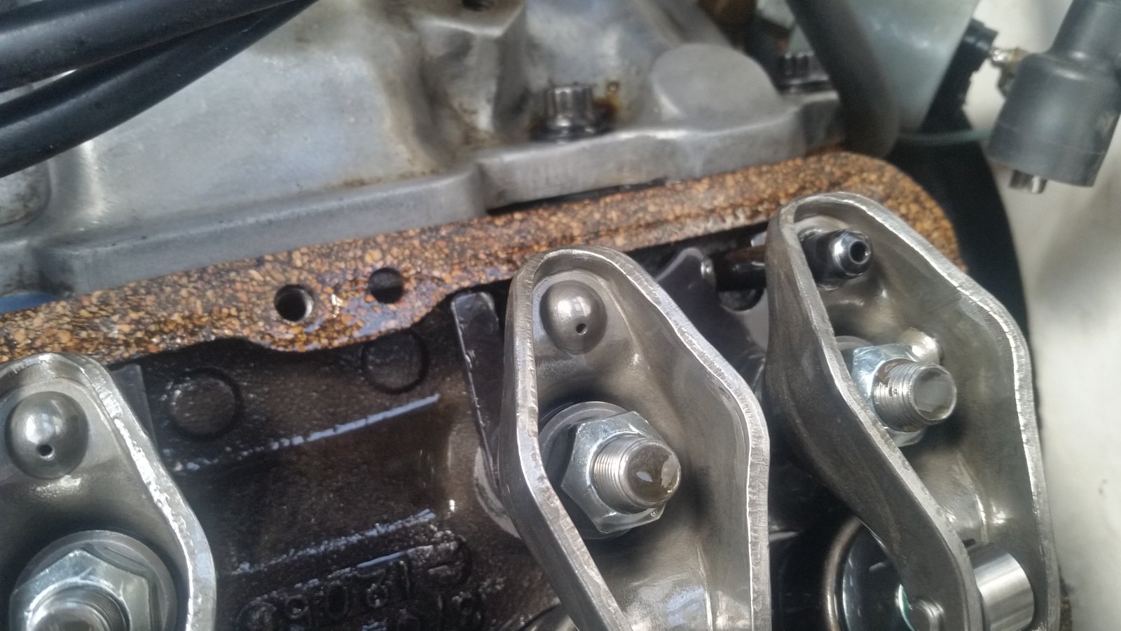

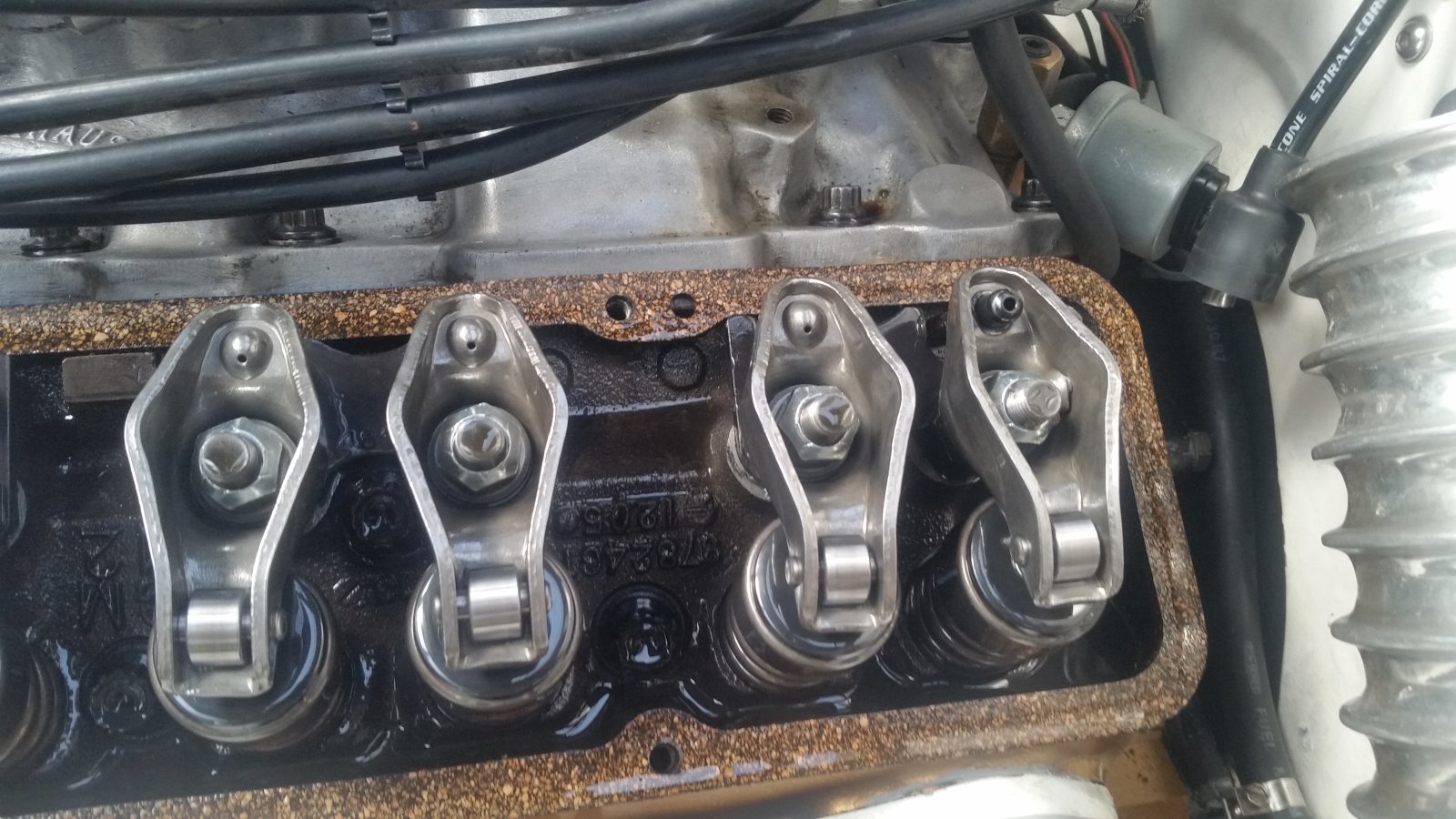

    Had a problem tuning new engine the other day, initially there was a horrible knocking / slapping sound followed by severe back firing through the center carby, initially I thought the worst as engine was still running in, I eventually found the issue, cheap ****ing Chinese rockers ( I thought stamped new steel rockers would be strong enough for a mild engine and the rollers would be the weak point not the steel itself ). Anyway pics tell the story. I ended up putting the 55 year old rockers back on the engine and now its running ok - defiantly dodged a bullet this time. A timely reminder that cheap isn't good and good isn't cheap. I know its my own fault and should have known better but sometimes budget and common sense evade me. Glen 20240111_164621.jpg 20240111_164627.jpg 20240111_165909.jpg

    Just qurious, what brand, if any, was the roller rockers?
    I was about to order a similar Comp Cams set….
    Great car!
  30. X38
    Posts: 17,498
    X38
    They don't look like Comps. My guess is Chinese comp-a-likes.
    Testing my memory, but I think I've seen that injury before.
