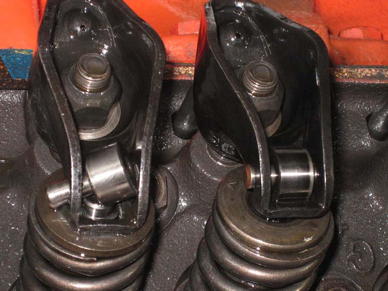

    My advice, only buy brand name USA items, ****, eagle etc, If there are cheap, do not purchase. I feel embarr***ed to mention that I purchased a set of pro comp connecting rods, that were absolute ****ing junk and required me to purchase **** products - eventually costing me double the initially purchase price. Any questions please ask. Glen

    Rockers were Proform.
  5. X38
    Joined: Feb 27, 2005
    Posts: 17,498
    X38
    Ah, that brand. This can happen with them too...

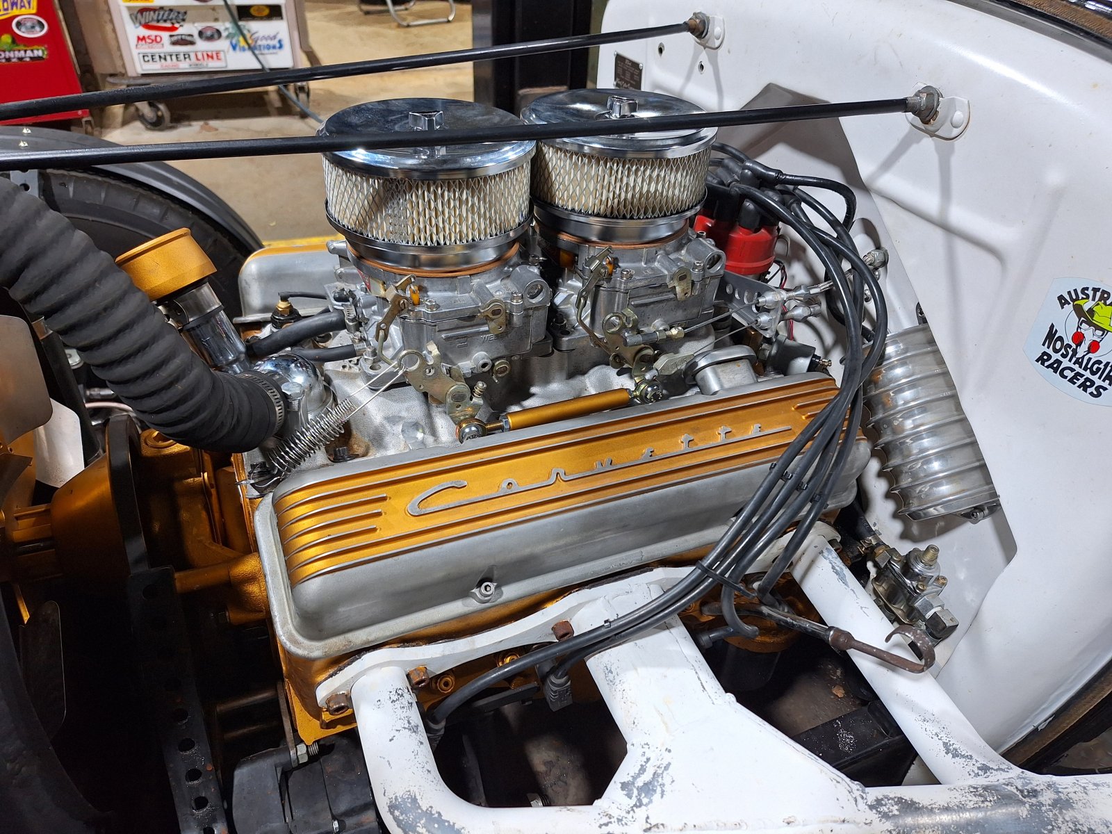

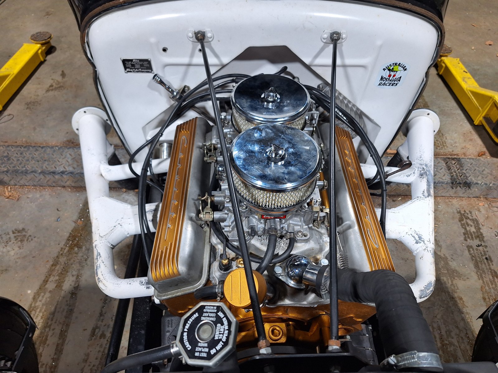

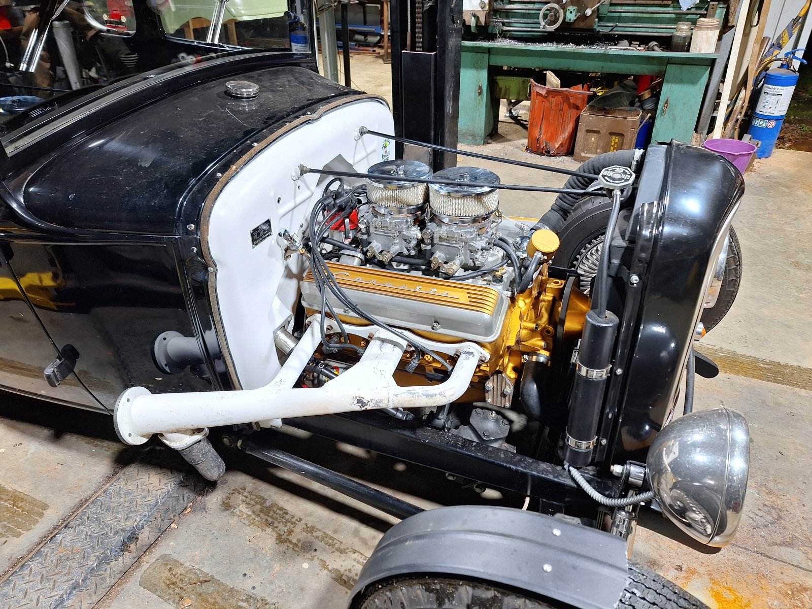

    I was having issues tuning an off idle stumble, felt the triple carbs were holding the engine back. I wanted to maintain the nostalgia look so I installed a pair of Edelbrock carbs, WOW, what a difference, engine now revs fast and clean, no stumble, sounds real strong, and that's without tuning - mixture screws 1 1/2 turns out. Yet to drive the car as a few little things to do and the weather is ****, cannot wait to tune and drive. Glen 20240711_154444[1].jpg 20240711_154437[1].jpg

    Took car for a drive a couple of weeks back, ran like ****, way to rich and not wanting to idle. Pulled the top of the carbs to check float level etc. Both carbs were full of **** (obviously been sitting for a while) and the front carbs metering rods were bent, also one carb was a 1406 and one was a 1405. I ended up rebuilding both carbs and now they are identical in specifications. It started up first go and runs like a dream, took it for a short drive and its so much better than before, from standstill it fry's the Tyres. Yet to dial it in but more than happy with the result. Glen 20240726_174911.jpg 20240726_174925.jpg 20240726_174930.jpg

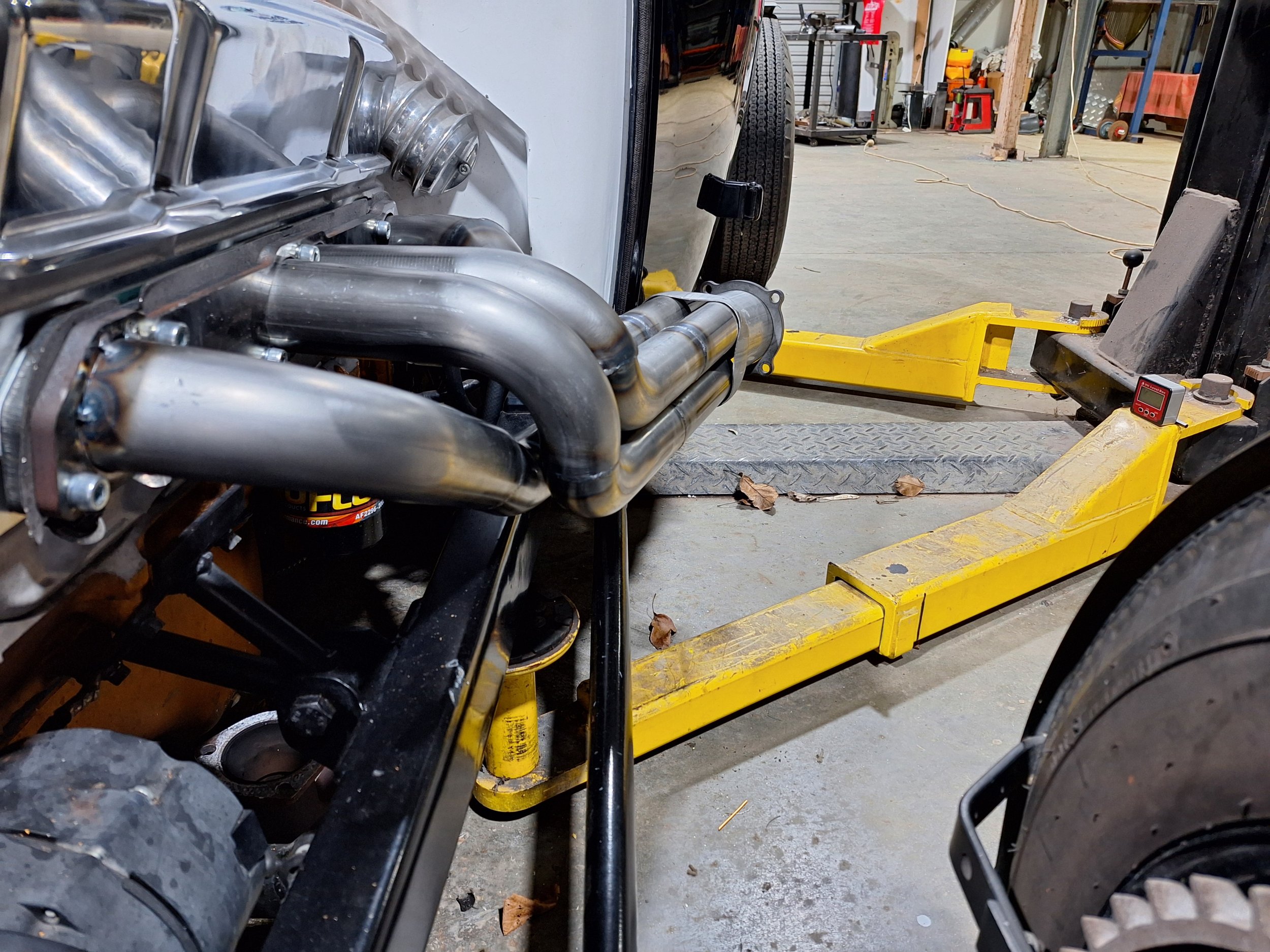

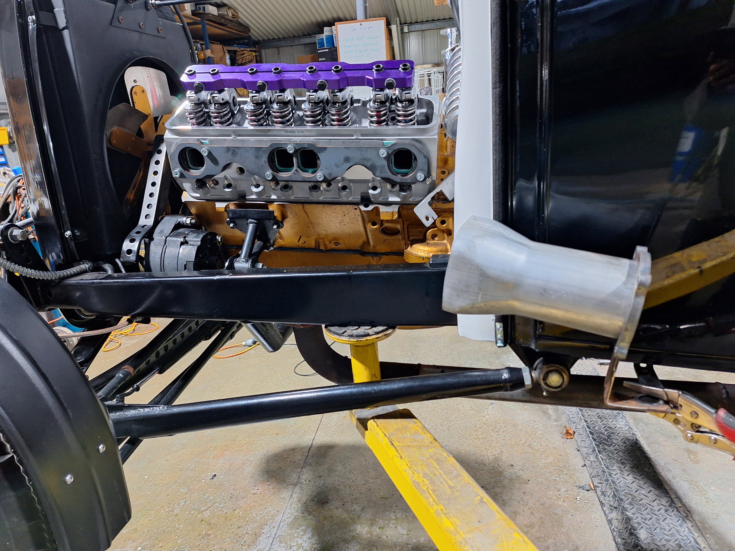

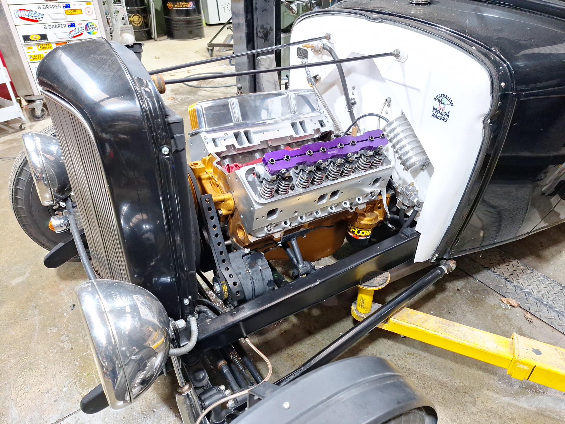

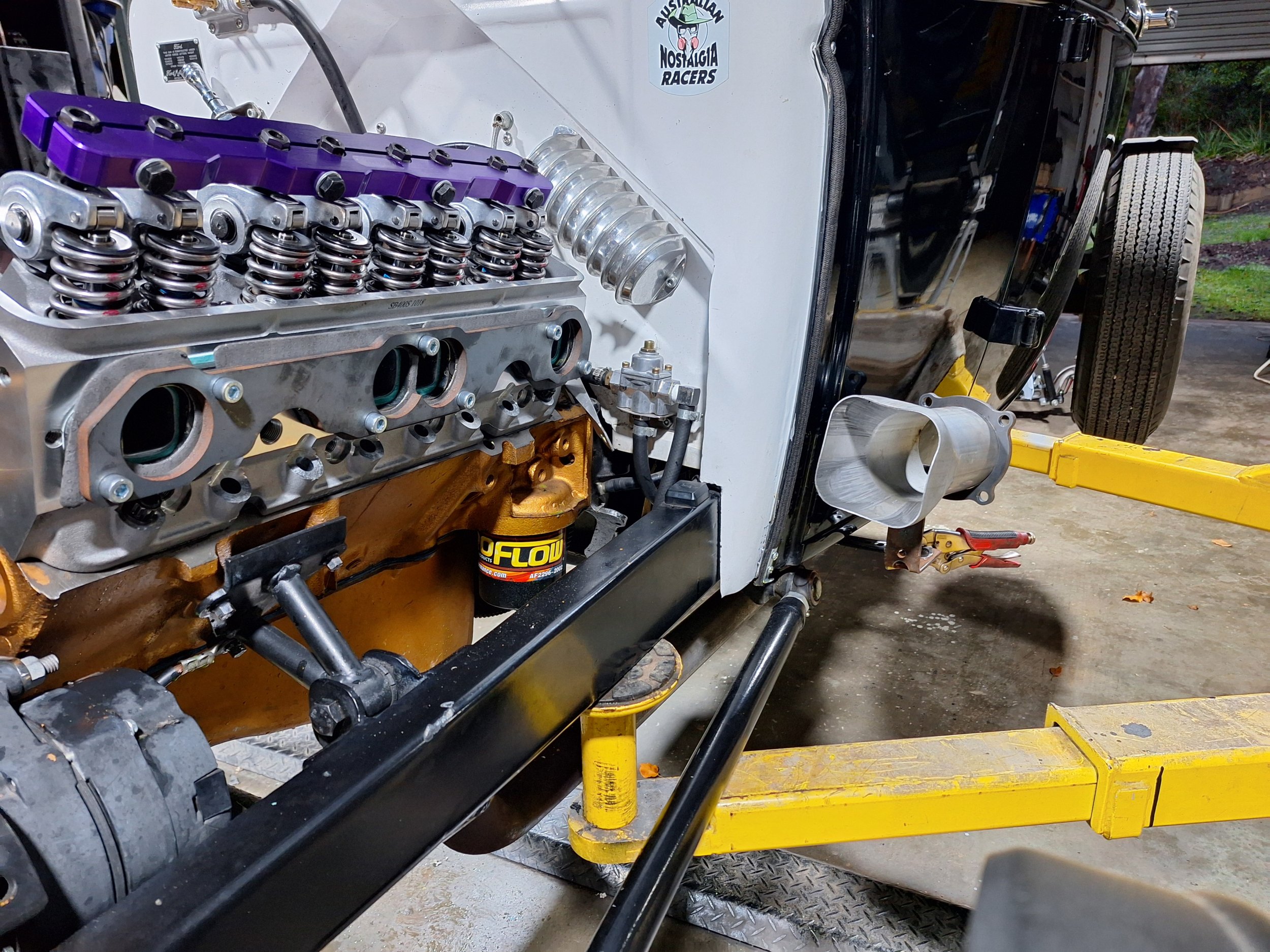

    My 31 recently had cylinder head issues, heads are tired so I decided to replace with some alloy units. I purchased a set of cheap heads from Skip White ( whiteperformance ) on Ebay USA, they look all right for cheap heads, I plan to clean up the ports a little and maybe port match to intake. I also needed roller rockers and a stud girdle and tall rocker covers to compliment heads. While I'm changing heads I decided to fabricate some new headers as well, today I worked on collector position, pipes will be 2 inch and use header plates to suit my SBC, a few pics Glen f6db5457-8336-4f4a-b8e8-6df97c7f5055.jpg 20250711_170545.jpg 20250711_170549.jpg 20250711_170554.jpg 20250711_170600.jpg 20250711_170605.jpg

  9. catdad49
    Joined: Sep 25, 2005
    Posts: 7,072
    catdad49
    You better close those ports up quickly, it looks like an invite to multiple Mouse Houses!

    A few pics of recent progress, Im so happy with how they are turning out. Glen 20250720_184822.jpg 20250720_184829.jpg 20250720_184836.jpg 20250720_184841.jpg 20250720_184848.jpg 20250720_184859.jpg

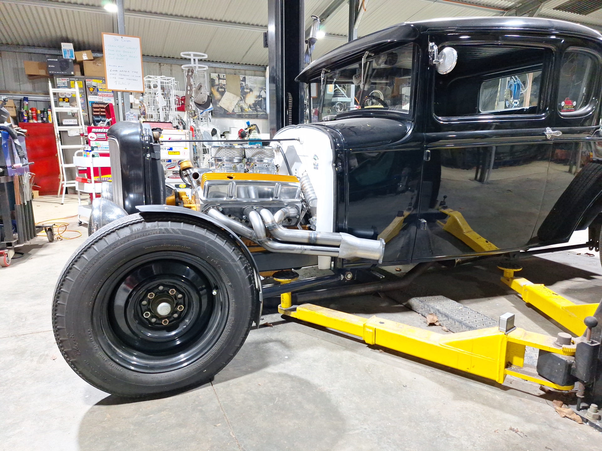

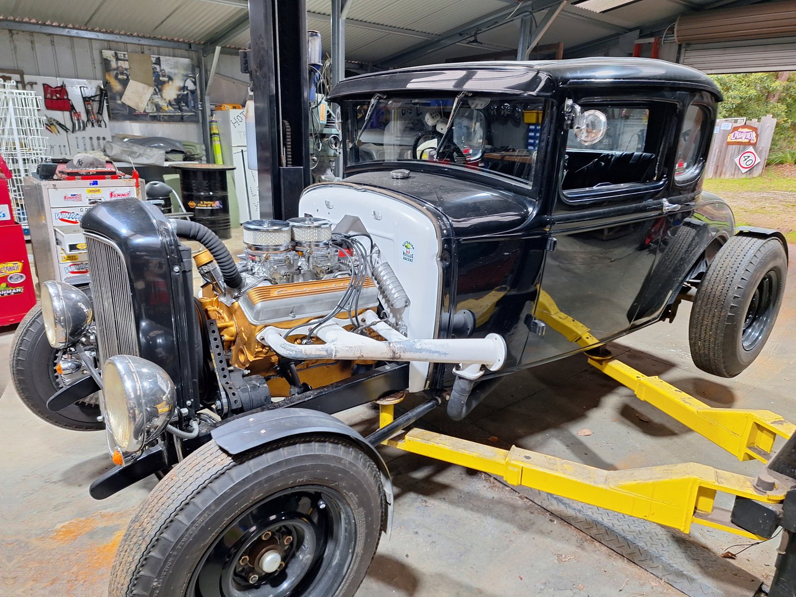

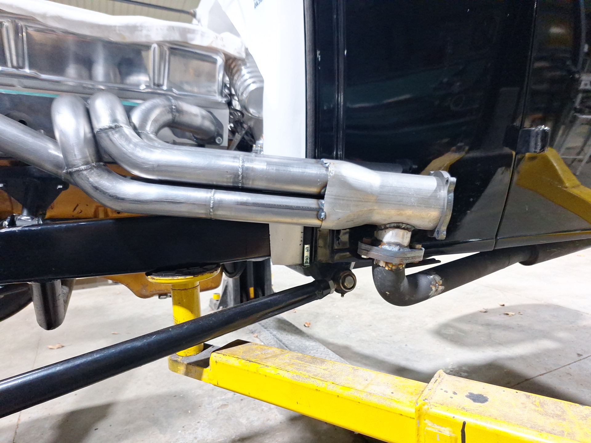

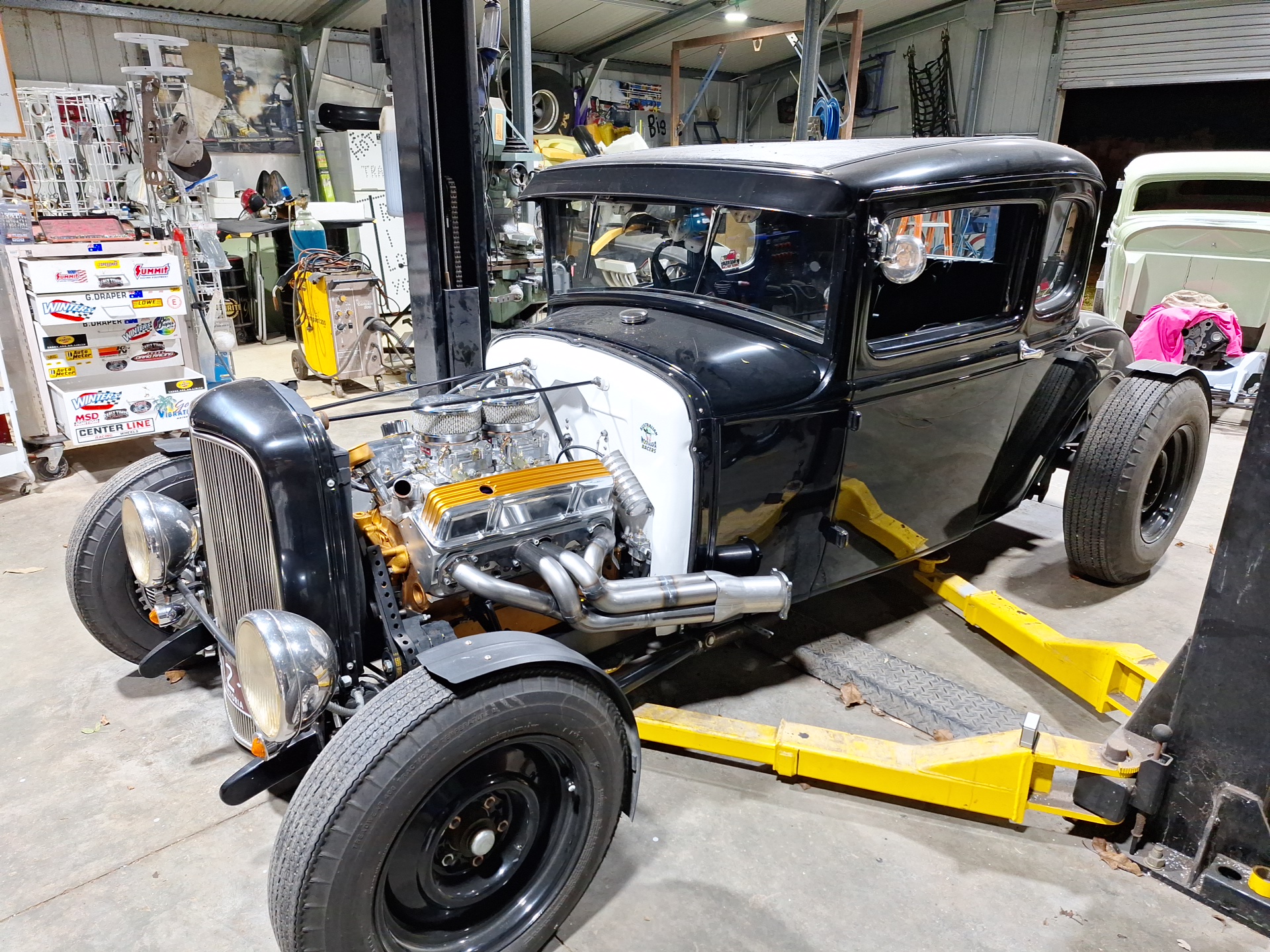

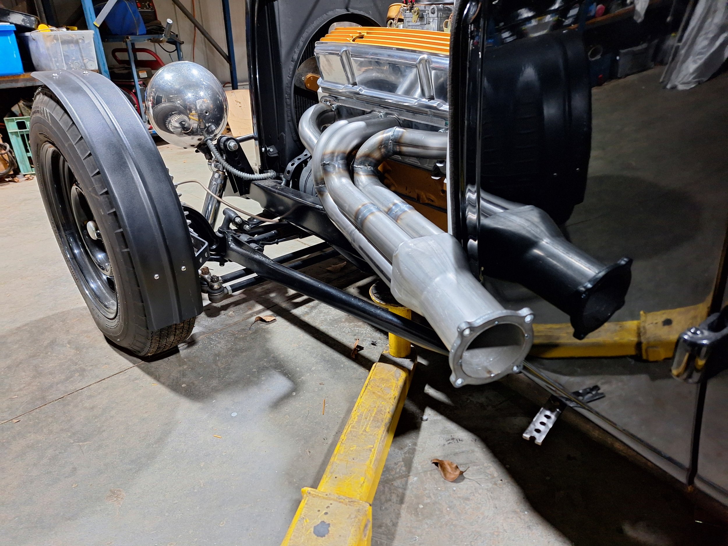

    A few pics of recent progress, welded up headers and modified exhaust to suit. Still a lot of work to go, but so happy with how they are turning out. Glen 450ff518-13d6-4795-aa53-89bd6c92fac6.jpg 20250724_201812.jpg 20250724_201817.jpg 20250724_201823.jpg 35997133-616c-4d0c-bc4b-cb4ec922c6a6.jpg

    Thanks Outback, pipes are finished now, next job is to match port heads and intake as well as clean up intake and exhaust ports, a few pics. Glen 20250728_154624.jpg 20250728_154700.jpg 20250728_154705.jpg 20250728_154724.jpg 20250728_154731.jpg 20250728_154742.jpg

    Started porting heads and measuring spring pressures etc, using my home made equipment, my spring tester may not be 100% spot on but it gives me a guide on how all springs compare to each other. Also adding 1 inch spacers under Carby's, a few pics. Glen 20250731_175321.jpg 20250802_165204.jpg 20250802_165209.jpg 20250802_165220.jpg 20250802_165241.jpg 20250802_173257.jpg 20250802_173306.jpg
  18. grdra1
    Joined: May 20, 2013
    Posts: 686
    grdra1
    My car is finally on the road again, lots of little dramas during the rebuild but Im overall happy with the result, This hotrod pulls like a train in any gear, has more down low power and more legs up top, and I feel the new pipes look the part as well. A few pics, Glen 20250824_165945.jpg 20250824_165954.jpg 20250824_170019.jpg 20250824_170024.jpg
