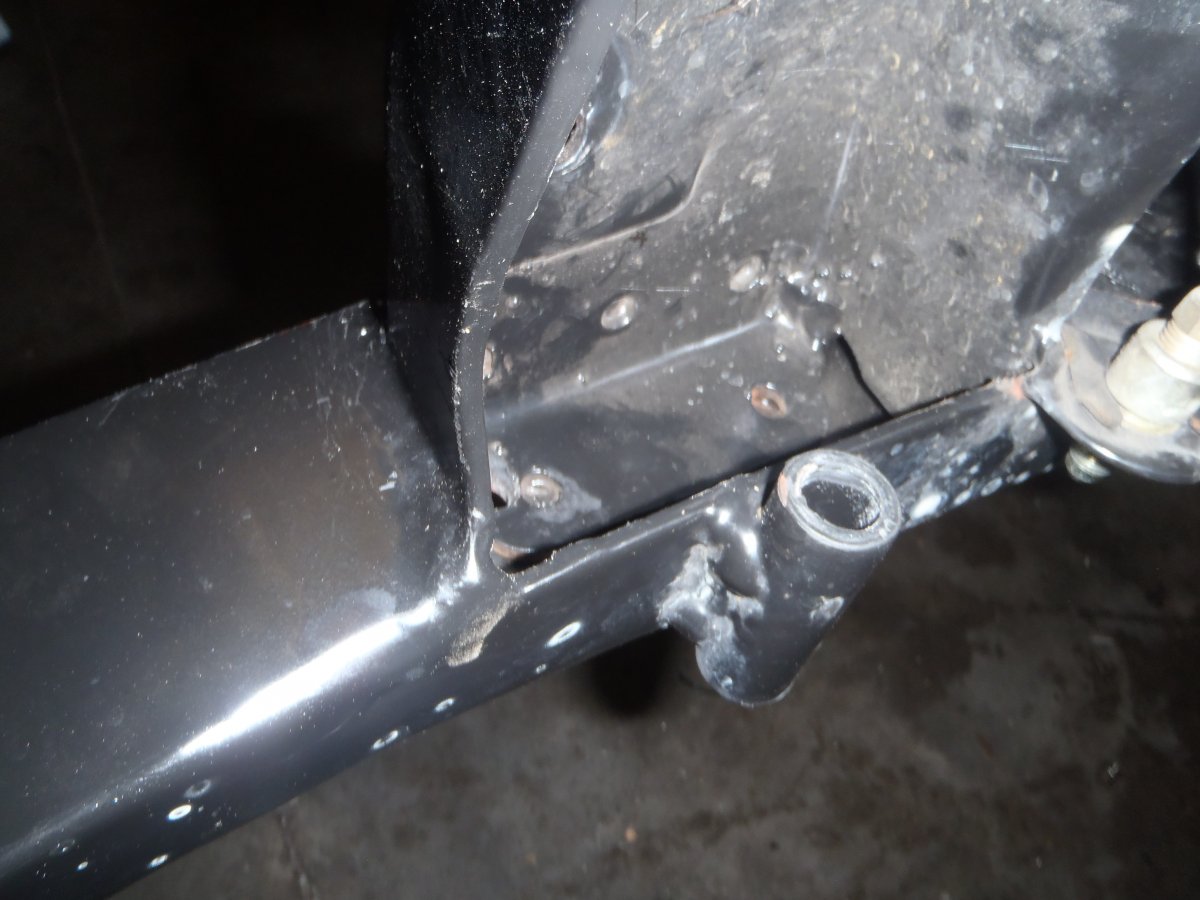

    Thanks for reply, my engine mount is in the way and limits where steering box can go ( I probably will have to make new engine mount ). Dimpled grille came out P5010447.JPG ok but not sure about shade of paint - used black hammer tone, may change to a gloss black similar to body color, What do others recommend. Glen P5010440.JPG P5010443.JPG P5010444.JPG

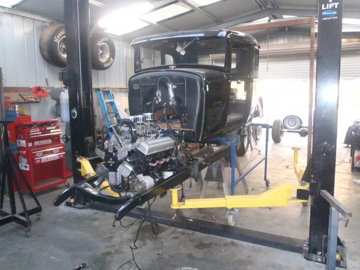

    grdra1
    Pulled body off yesterday, not easy by myself but I got there in the end after I made a table / trolley, now the fun begins. Also received my rear disc brake kit a few weeks ago - I might change the bolt on caliper mounts to a weld on unit. A few pics of progress. Glen P6210453.JPG P6210456.JPG P6210457.JPG P5190452.JPG

    grdra1
    Cleaned shed yesterday, removed engine from ch***is, ran a tape measure over ch***is - all ok so far. Found number on ch***is, left side on bottom. A4 106478 anyone no if this is a original number, I no its not in original spot on ch***is. Glen P6210461.JPG P6220462.JPG P6220464.JPG P6220465.JPG P6220466.JPG P6220467.JPG

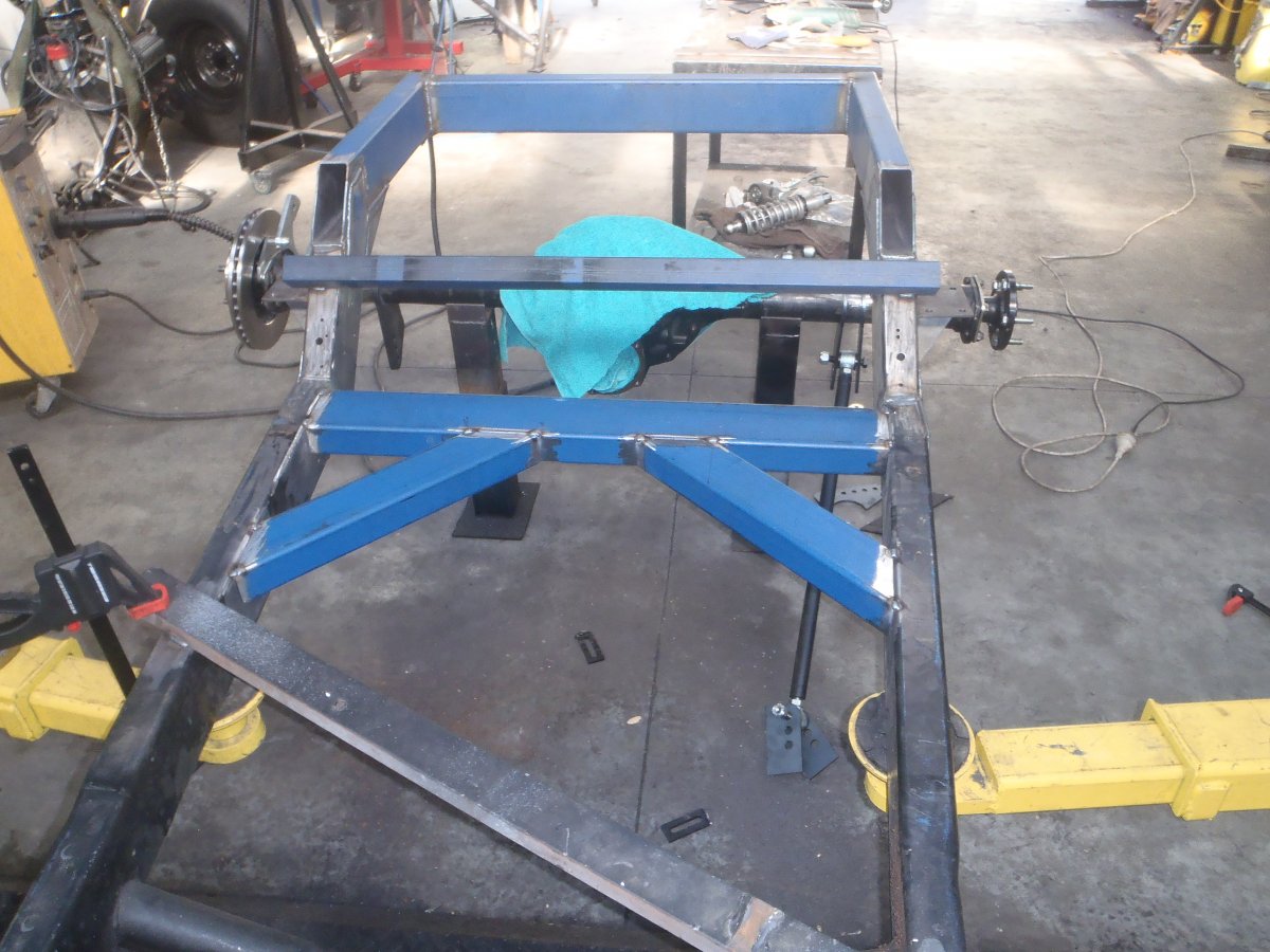

    A few pics of today's progress, removed old cross member and installed a new K member. Put front end and engine back in to determine pinion angle and check wheel base, will probably need to make some new brackets to mount the rear as the ones supplied with the 4 link kit may not be suitable. Glen P7020486.JPG P7020487.JPG P7020490.JPG P7030493.JPG P7030494.JPG

    A few pics of today's progress, set up pinion angle and wheel base then tack welded housing in place to make it easier to fab mounts / mount 4 link. Glen P7040495.JPG P7040496.JPG P7040497.JPG P7040498.JPG

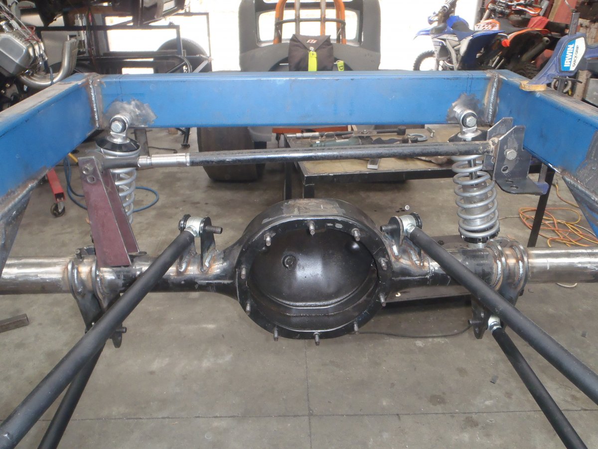

  16. grdra1
    Joined: May 20, 2013
    Posts: 680
    grdra1
    A few pics of latest progress, all working out ok so far. Glen P7070506.JPG P7100509.JPG P7110512.JPG P7110514.JPG P7110515.JPG P7110516.JPG P7110518.JPG P7110519.JPG

  17. grdra1
    Posts: 680
    grdra1

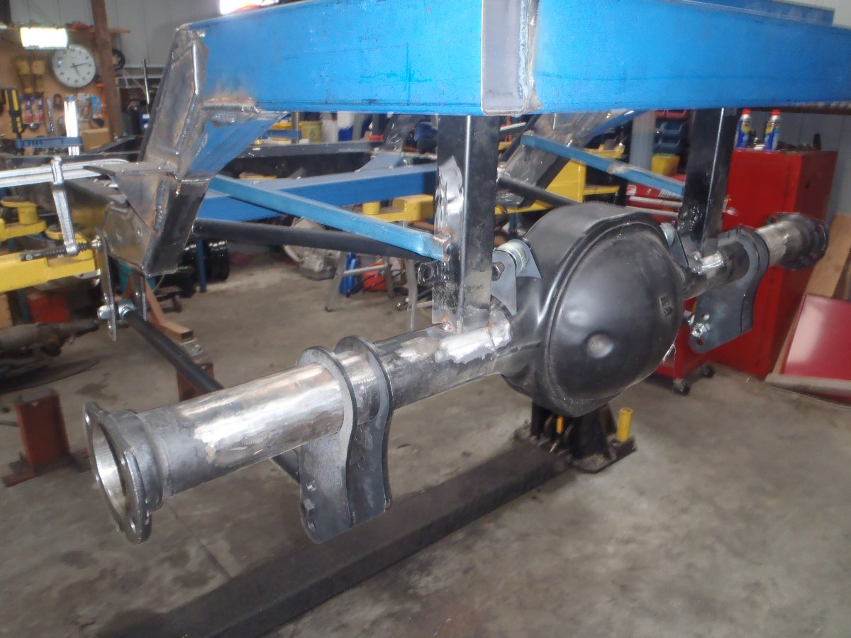

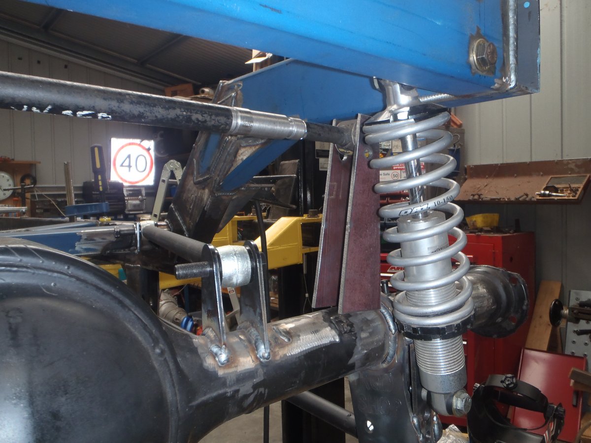

    Finished mounting shocks today, now need to finish weld everything. Happy with result, all working ok - no binding and all square. Rear end is currently set at the height of old unit, I can move up or down by one inch. Glen P7120522.JPG P7120521.JPG

    Finish welded the rear housing and K member etc, also machined up some plates to make my gearbox cross member removable. Glen P7160525.JPG P7170529.JPG P7170533.JPG P7170535.JPG P7170536.JPG P7170532.JPG P7160523.JPG P7170531.JPG P7170534.JPG

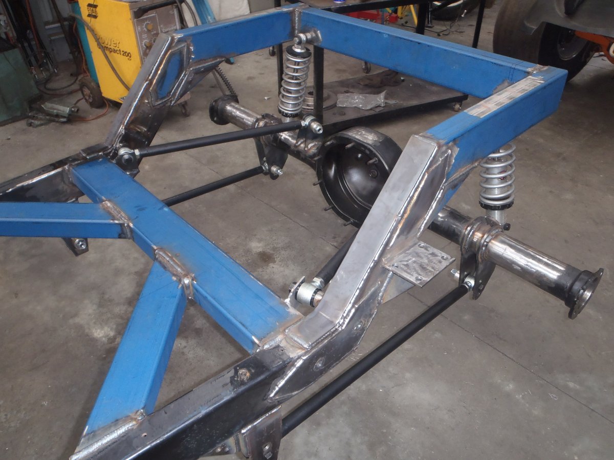

  21. grdra1
    Posts: 680
    grdra1
    I will be adding a panhard to front suspension and will add to the rear if required - easy to do at present, better now than later. I have been looking on google for minimum and maximum angles for top bar bar placement for triangled four link suspension without success. I feel what I have will be ok, but am willing to add panhard if others have had issues - please let me know. I always appreciate advice from those that have experience - and been there before. Thanks again, here are a few pics of today's progress, I managed to complete gearbox mount and start on installing new front cross member - will lower front approx 1/2 inch and with removal of he first small leaf spring total amount lowered with be approx 3/4 of an inch. Glen P7190541.JPG P7190542.JPG P7190543.JPG P7190544.JPG

  24. grdra1
    Posts: 680
    grdra1
    Thanks for info, looks like my upper bars are approx 20 degrees when the minimum is about 30 degrees, will need to add a panhard bar now. A few pics of todays progress, got front cross member where it needs to be and started making boxing plates for underneath, here are a few pics. Glen P7200545.JPG P7200547.JPG P7200548.JPG

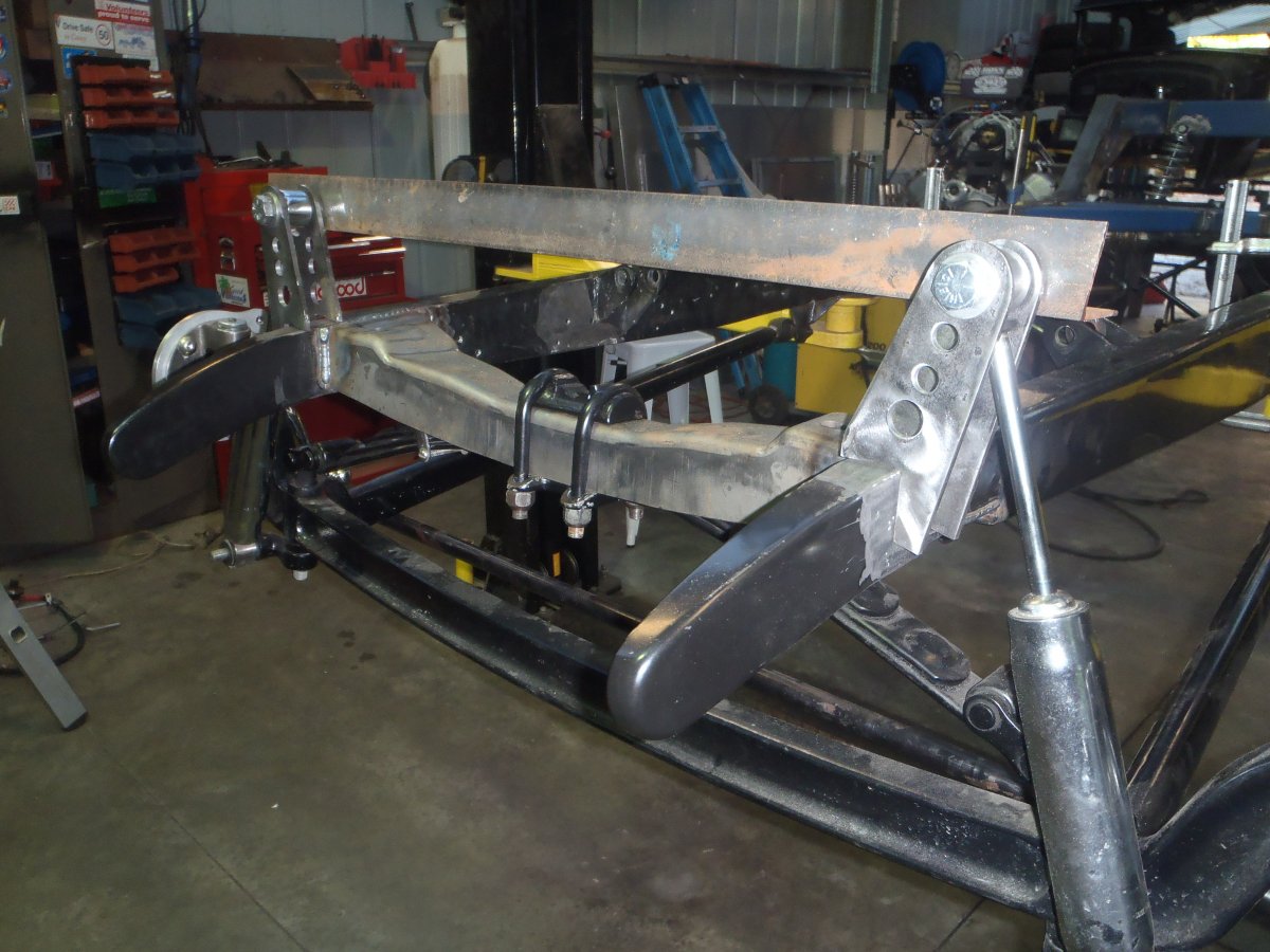

    Finished mounting front cross member today, now need to make new shock mounts. A few pics Glen P7210551.JPG P7210554.JPG P7210558.JPG P7220563.JPG

    Made some shock mounts, happy with result so far. Also needed to make a new spring mount as radiator was hitting the U bolts due to new cross member. I Also brought some used panhard bars from local wreckers to make front and rear units. A few pics, Glen P7220564.JPG P7220565.JPG P7240569.JPG P7240571.JPG P7240572.JPG P7240573.JPG P7230567.JPG

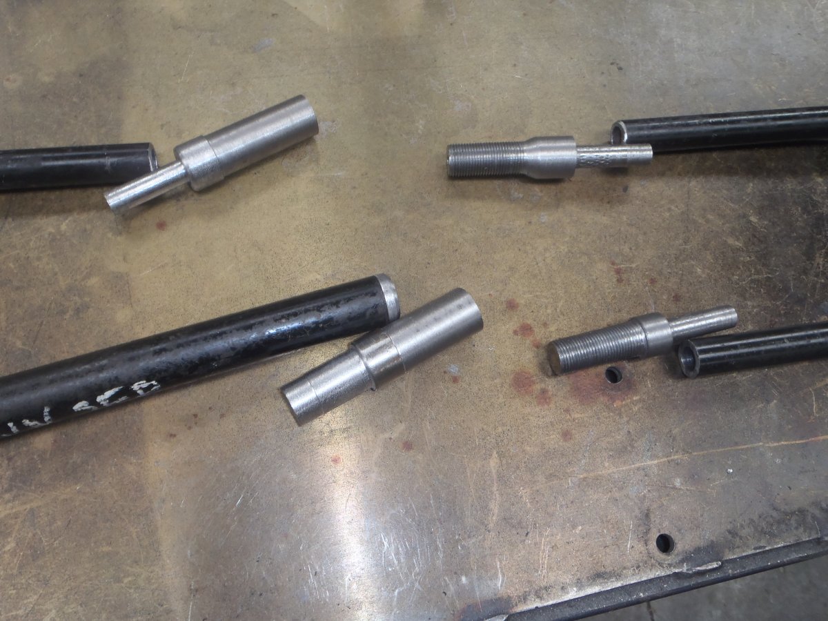

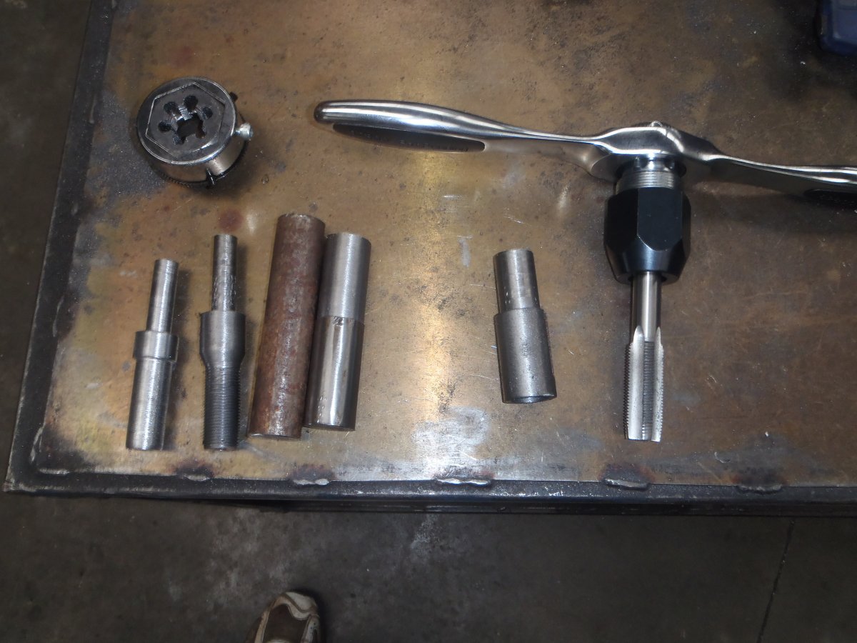

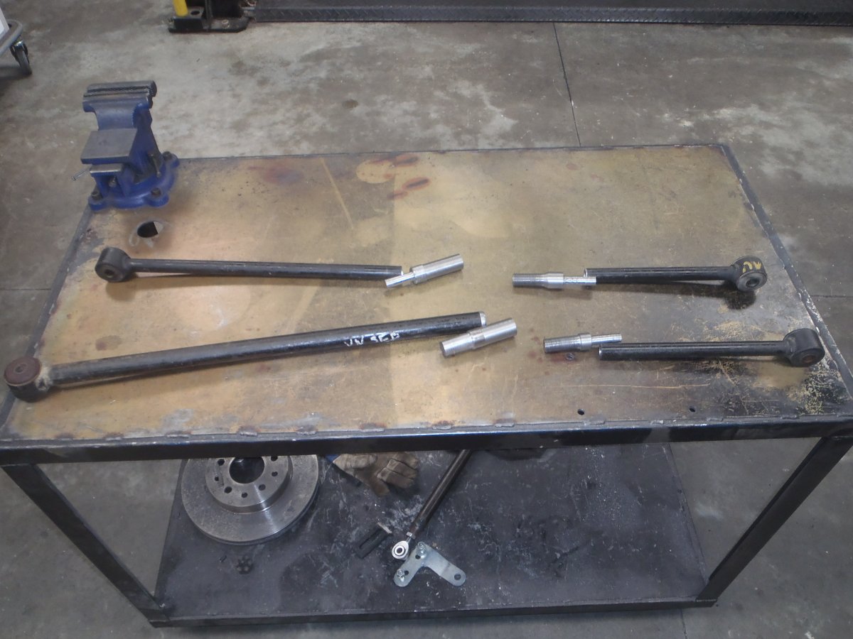

    Posts: 680
    grdra1
    Machined and threaded some bungs today and made two adjustable panhard bars, will make mounts soon on my next days off. I will then cut them to length and tig weld bungs in, a few pics Glen P7280574.JPG P7280575.JPG P7280576.JPG P7280577.JPG

  30. grdra1
    Posts: 680
    grdra1
