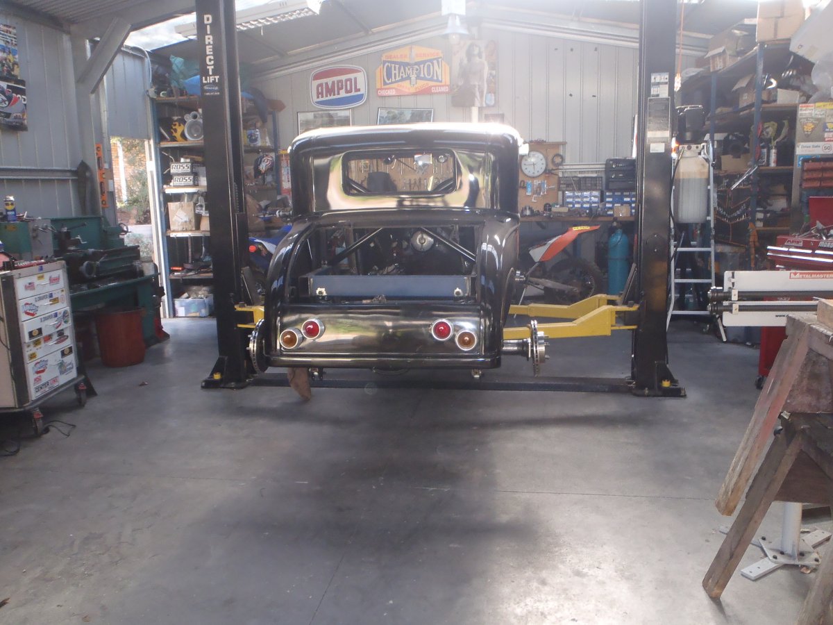

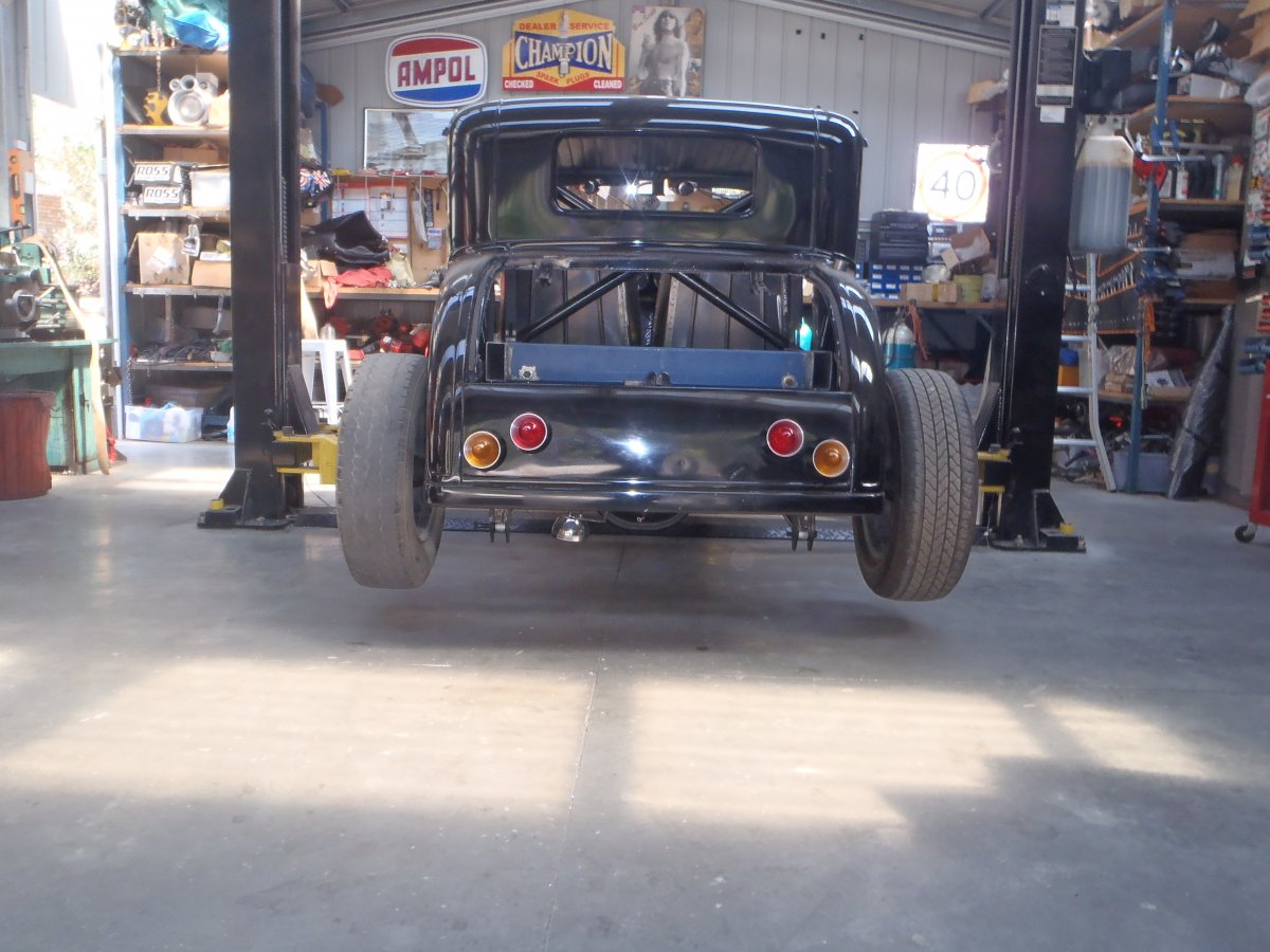

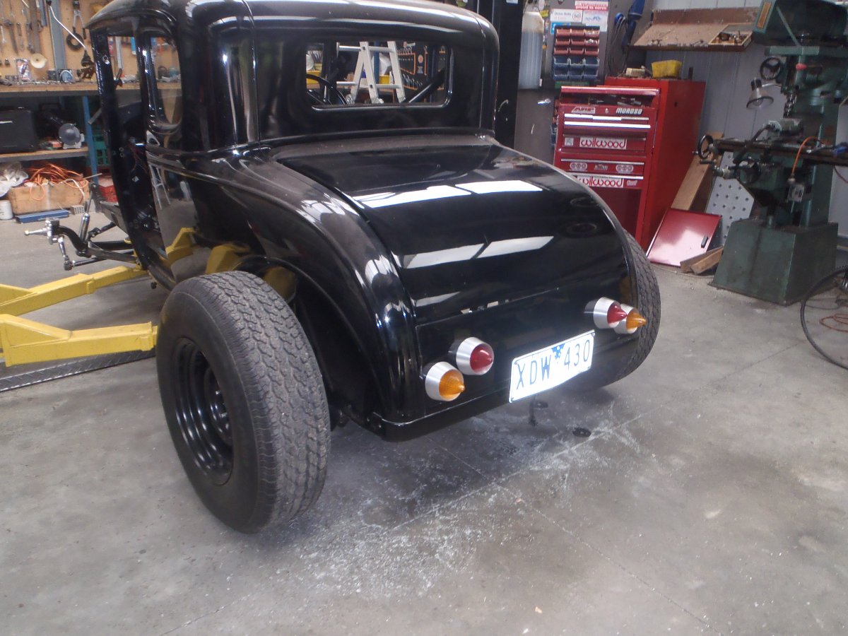

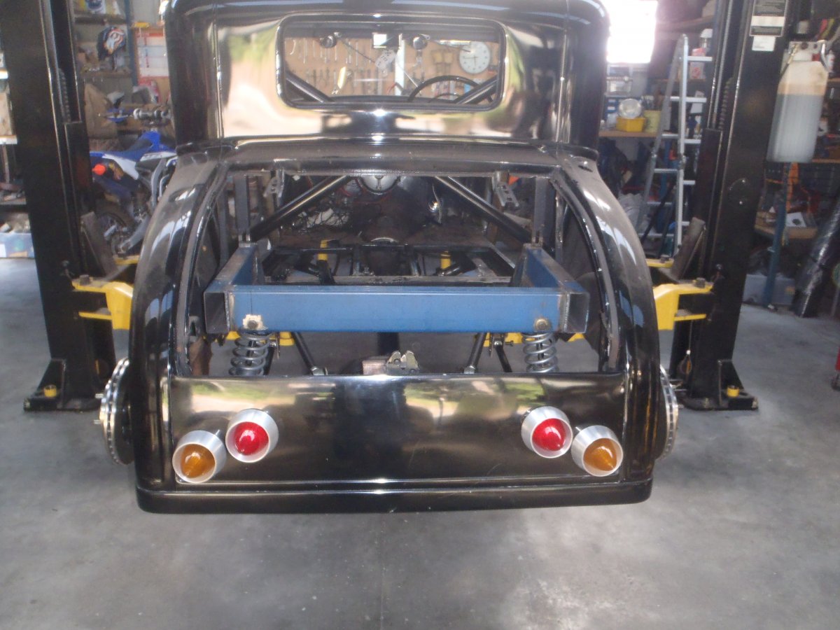

    They are not on the car yet, keep talking. I have been looking for a while for suitable tail lights, round Pontiac and rectangle units are very commonly used, I even purchased a pair of teardrop Zephyr style ones. I decided to make my own bezels and use caddy lenses because I like them, I feel they will give a 60s look to the rear of the car - and no one else has tail lights the same as mine. I made these with my own hands and a little help from the lathe. Glen

    Yeah, I see you’ve spent quite a bit of time at the lathe. Good effort. I just see them as more of a custom touch. The 39’s have been beaten to death, but for good reason. They suit damn near any vehicle. The zephyr style look good. Could always just drill one hole either side and have a play with the various units you’ve got. End of the day, your car, so you decide.

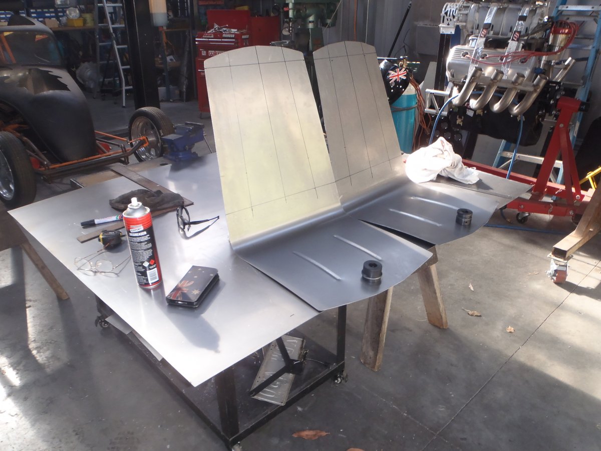

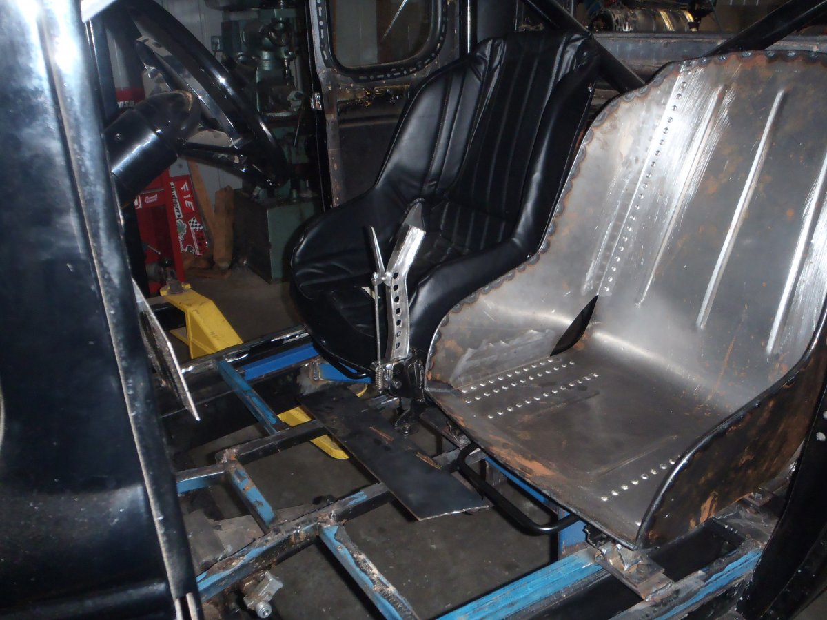

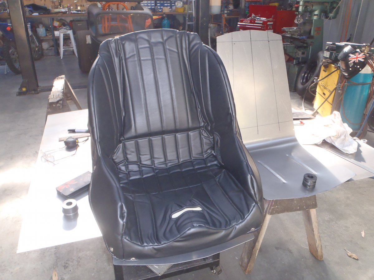

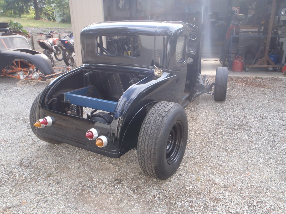

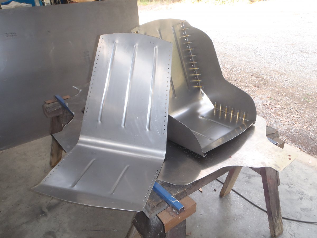

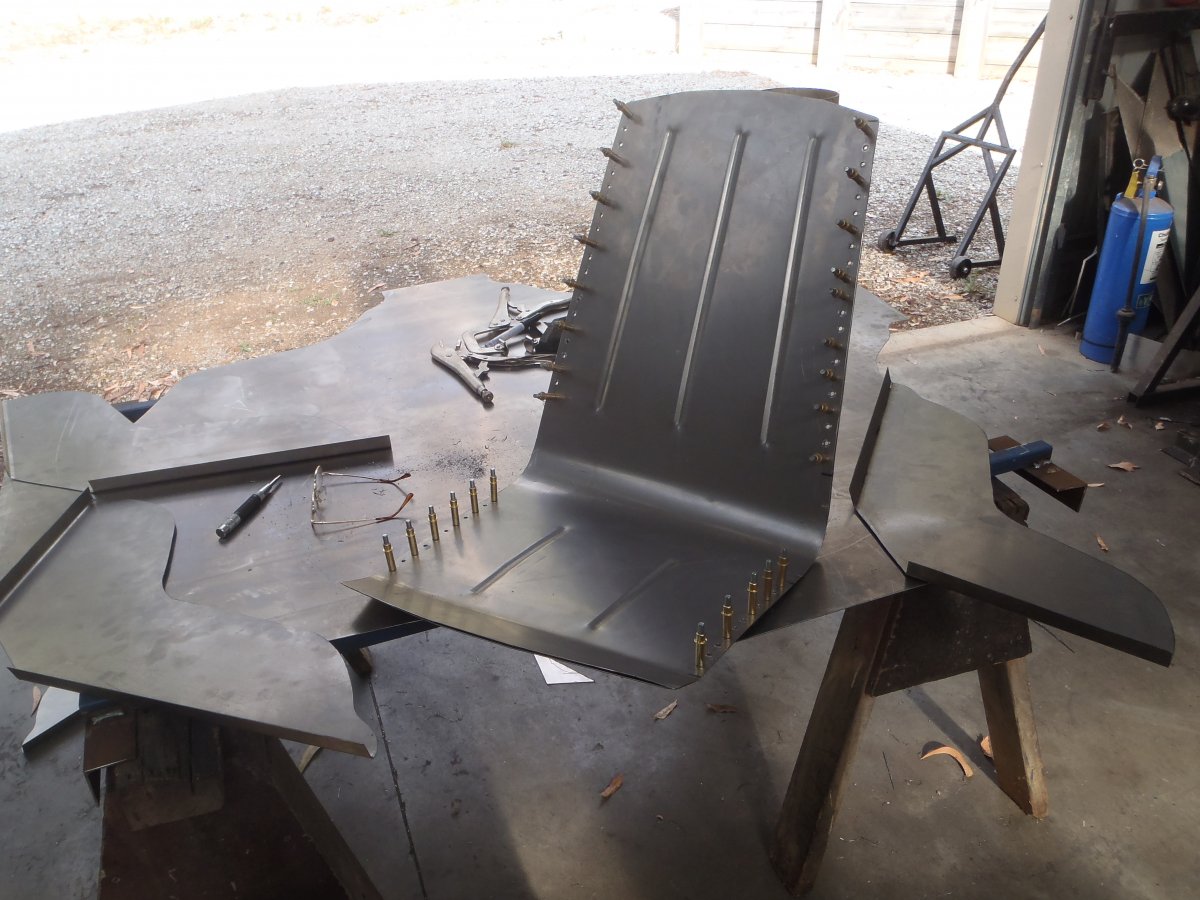

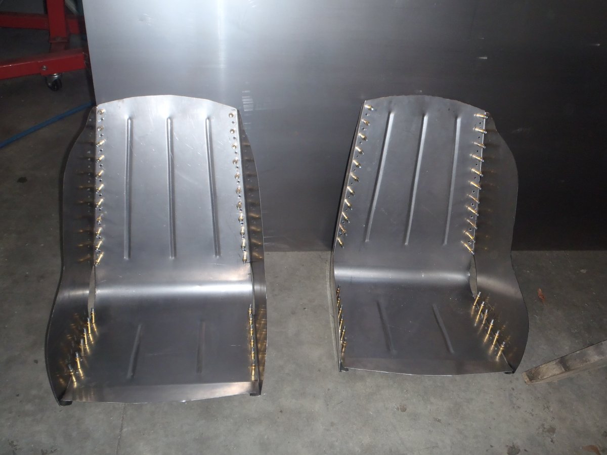

    Decided to install tail lights recently, happy with the result, initially thought it was a bit over the top but its growing on me. May paint the bezels black but undecided at present. Also started making the seats - I needed to finalise seating position before I make the pedal assembly. The seats will be mounted on sliding rails and the existing subframe will be modified to suit, I will also fabricate new floor panels etc. Glen P9260670.JPG P9260673.JPG P9200667.JPG P9260668.JPG P9260669.JPG
    catdad49, loudbang and Shadow Creek like this.

    The more I look at the rear lights the more I like em, anyway a few pics of today's progress. Glen P9290678.JPG P9290679.JPG P9290682.JPG P9290685.JPG

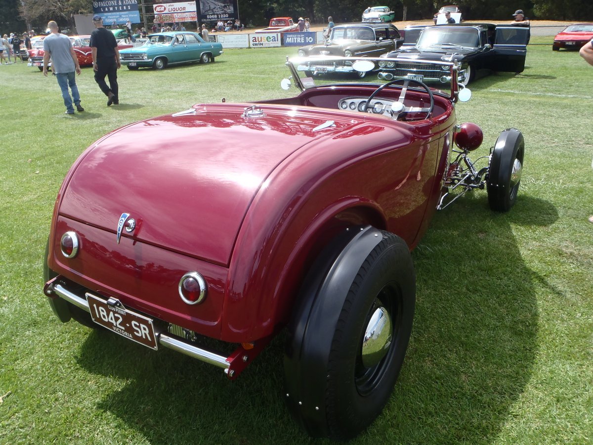

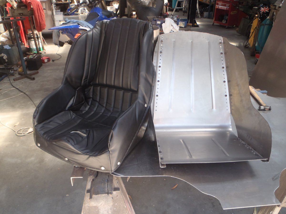

    Seats coming along nicely,I'm taking the coupe to a car show tomorrow, first time car out of shed since rebuild began. Event is an all American car display that I first attended about 30 years ago in my GT falcon - pictured in this thread, lately Ive been taking my Topolino altered but thought that I should take my coupe this time. I will take some pics of the show and post tomorrows. Glen P9290686.JPG P9290687.JPG P9300689.JPG P9300690.JPG P9300691.JPG P9300692.JPG P9300693.JPG P9300695.JPG P9300699.JPG P9300700.JPG

    I think I can get behind the rear lights, but I agree that the bezels need to be painted. Seats are coming out great.

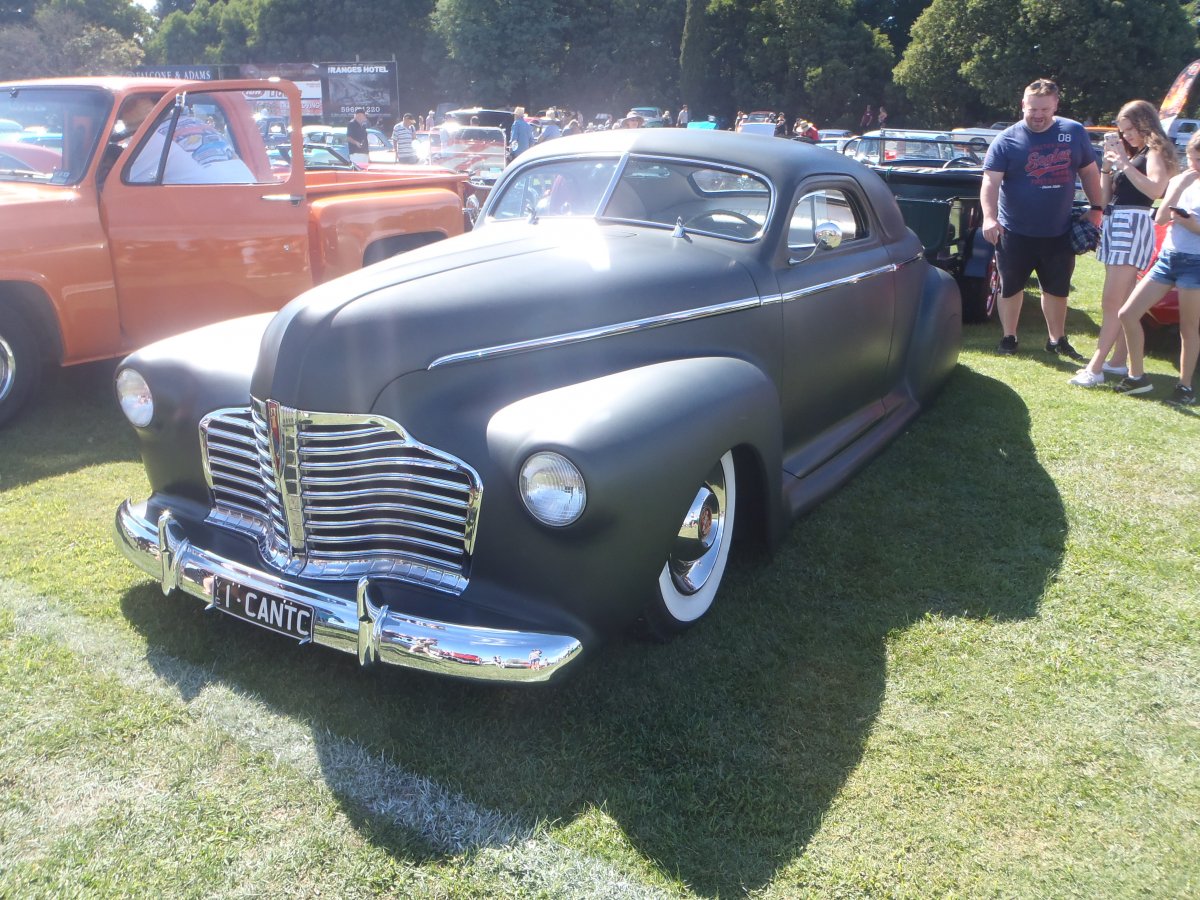

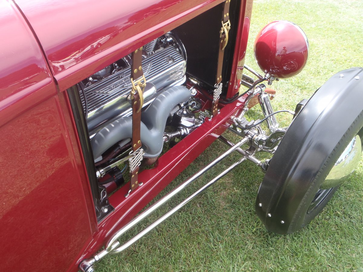

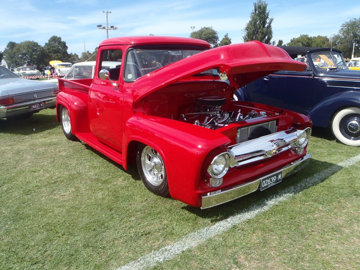

    Displayed car at local show, lots of positive comments on build so far. I also blacked out my tail lights with black tape to see how it would look. A few pics, Glen P9300756.JPG P9300755.JPG PA010789.JPG PA010792.JPG P9300701.JPG P9300703.JPG P9300704.JPG P9300706.JPG P9300707.JPG P9300708.JPG P9300713.JPG P9300723.JPG P9300726.JPG P9300727.JPG P9300745.JPG P9300746.JPG P9300747.JPG P9300718.JPG P9300734.JPG P9300736.JPG P9300777.JPG P9300753.JPG P9300787.JPG P9300775.JPG P9300758.JPG P9300759.JPG P9300760.JPG P9300761.JPG P9300763.JPG P9300762.JPG

    A few more rides P9300779.JPG P9300780.JPG P9300767.JPG P9300774.JPG P9300751.JPG P9300773.JPG P9300740.JPG P9300769.JPG P9300782.JPG P9300783.JPG P9300784.JPG P9300785.JPG P9300786.JPG P9300709.JPG P9300711.JPG

    Lights look better blacked out. :)

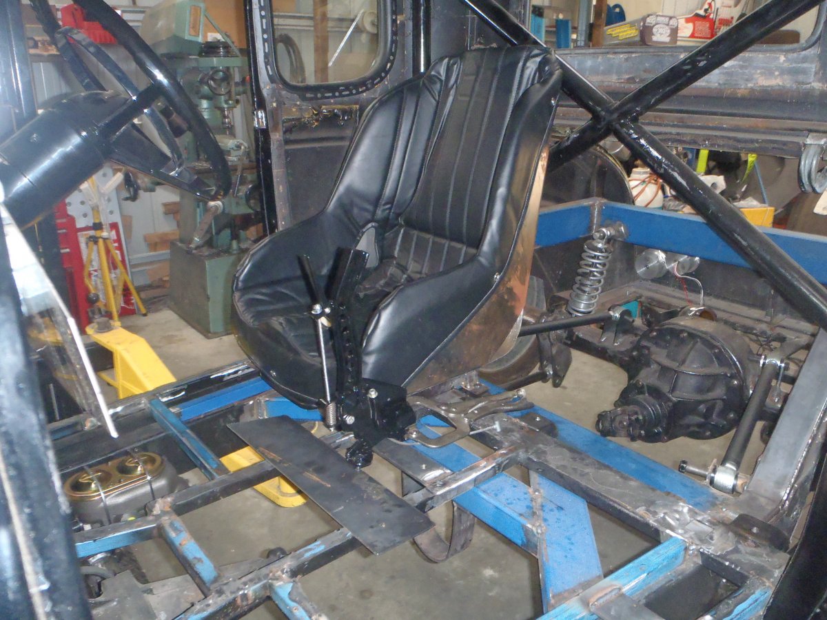

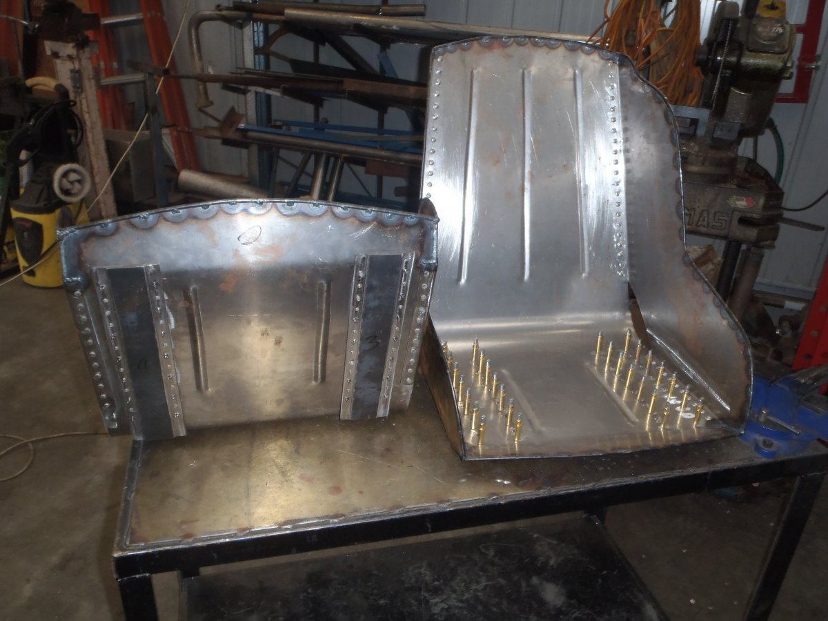

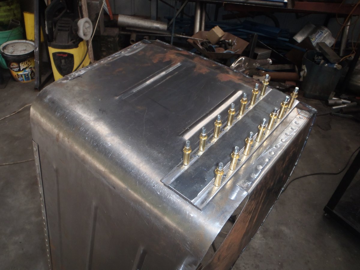

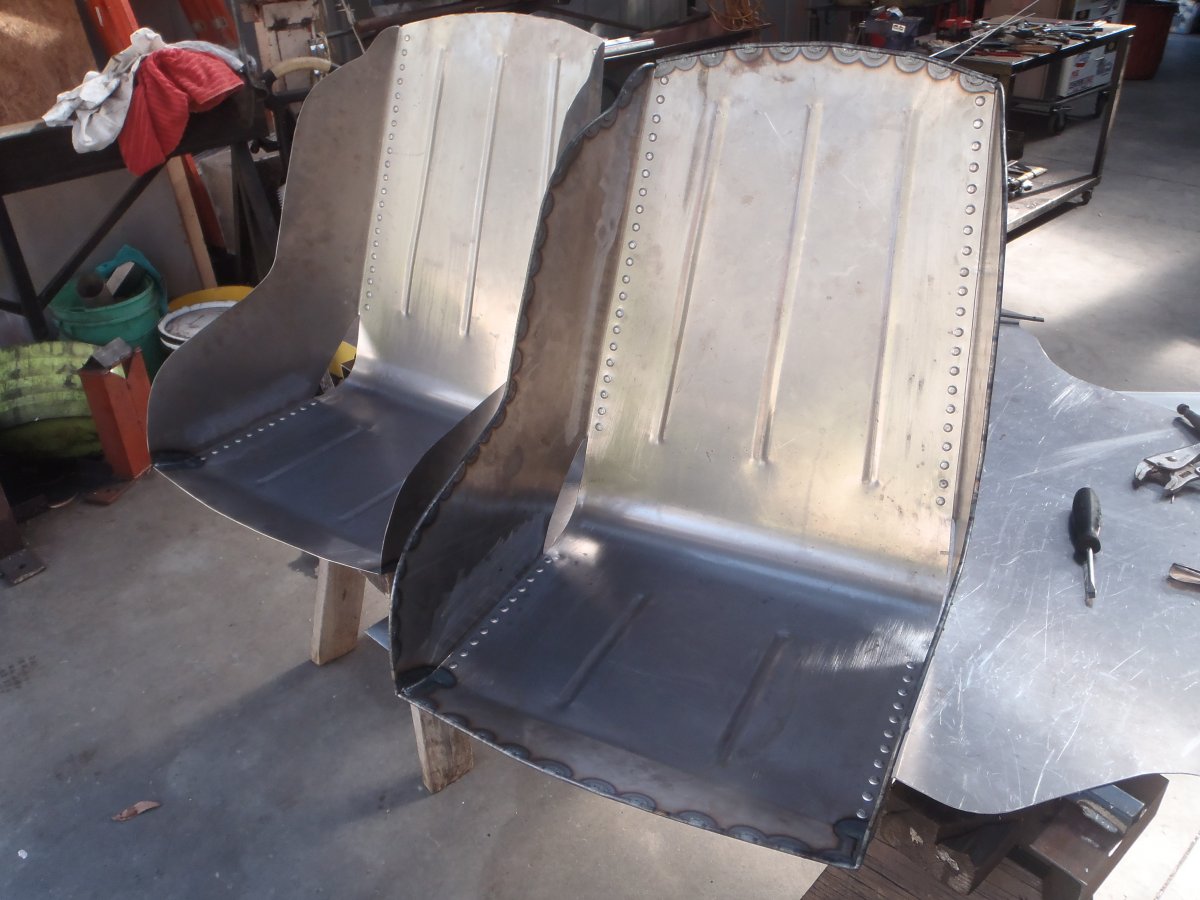

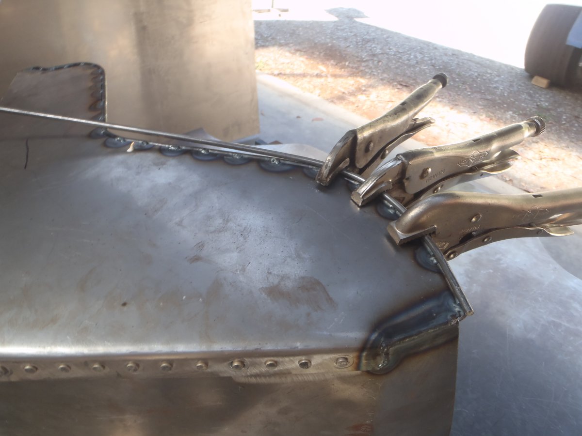

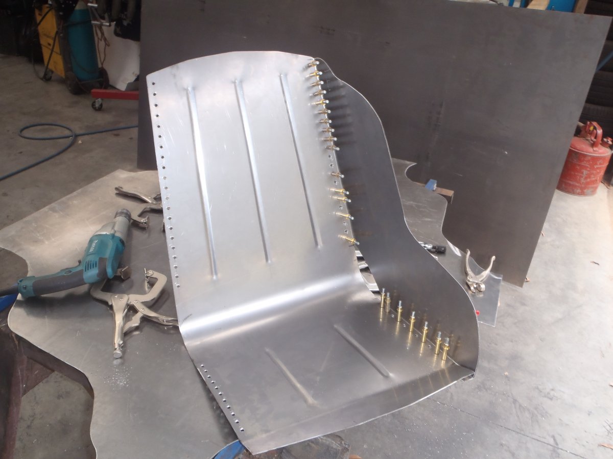

    I riveted seats and welded some rod around the sharp edges recently, still need to mount seats on sliding bases and modify subframe to suit. Happy with seats so far, Glen PA050797.JPG PA060798.JPG PA060800.JPG

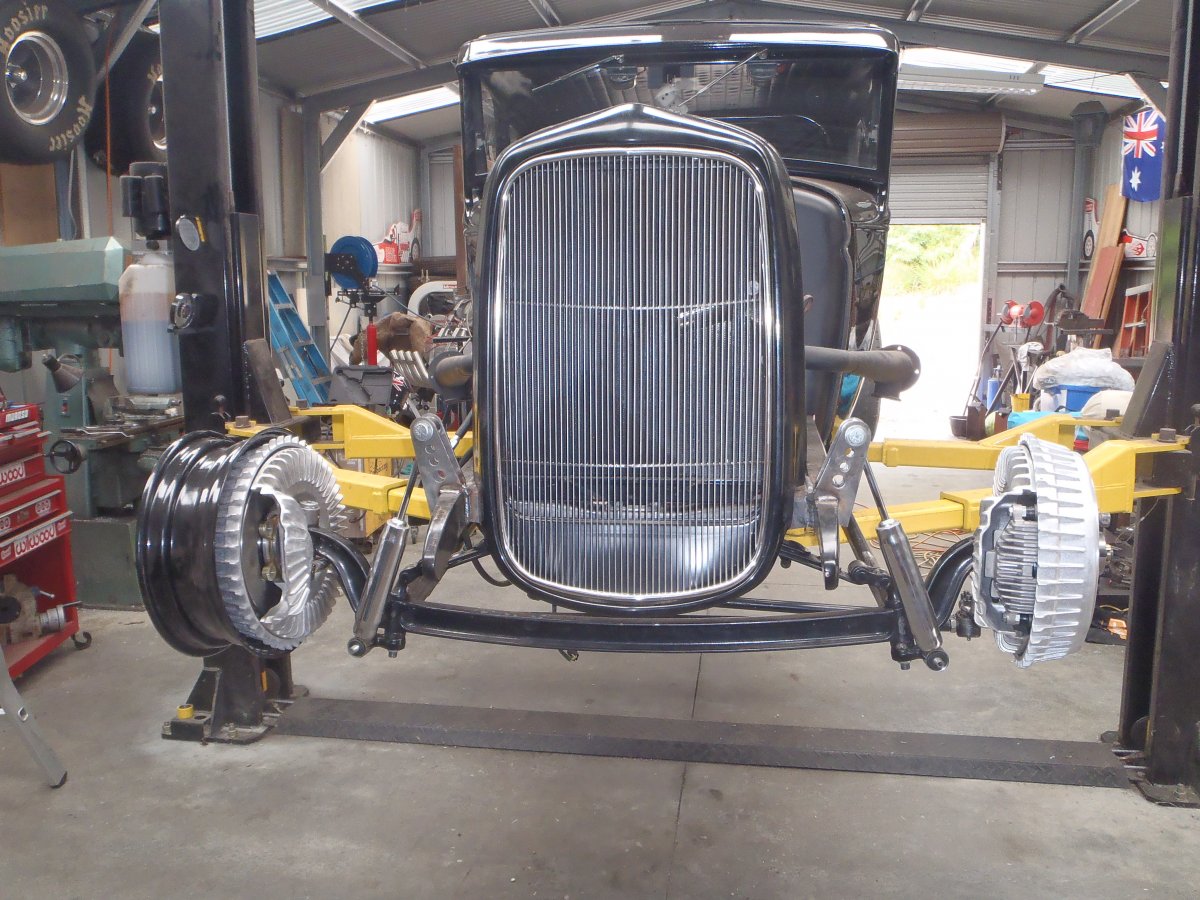

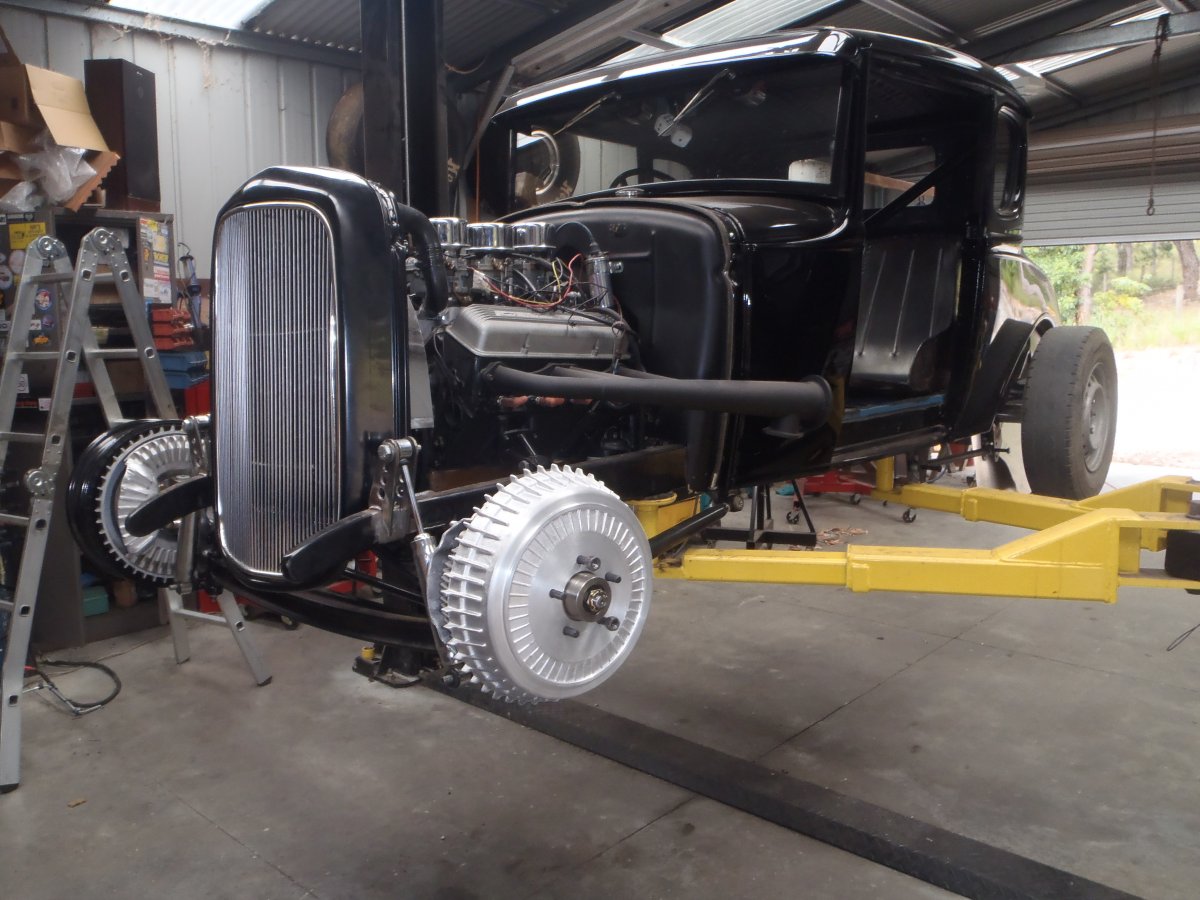

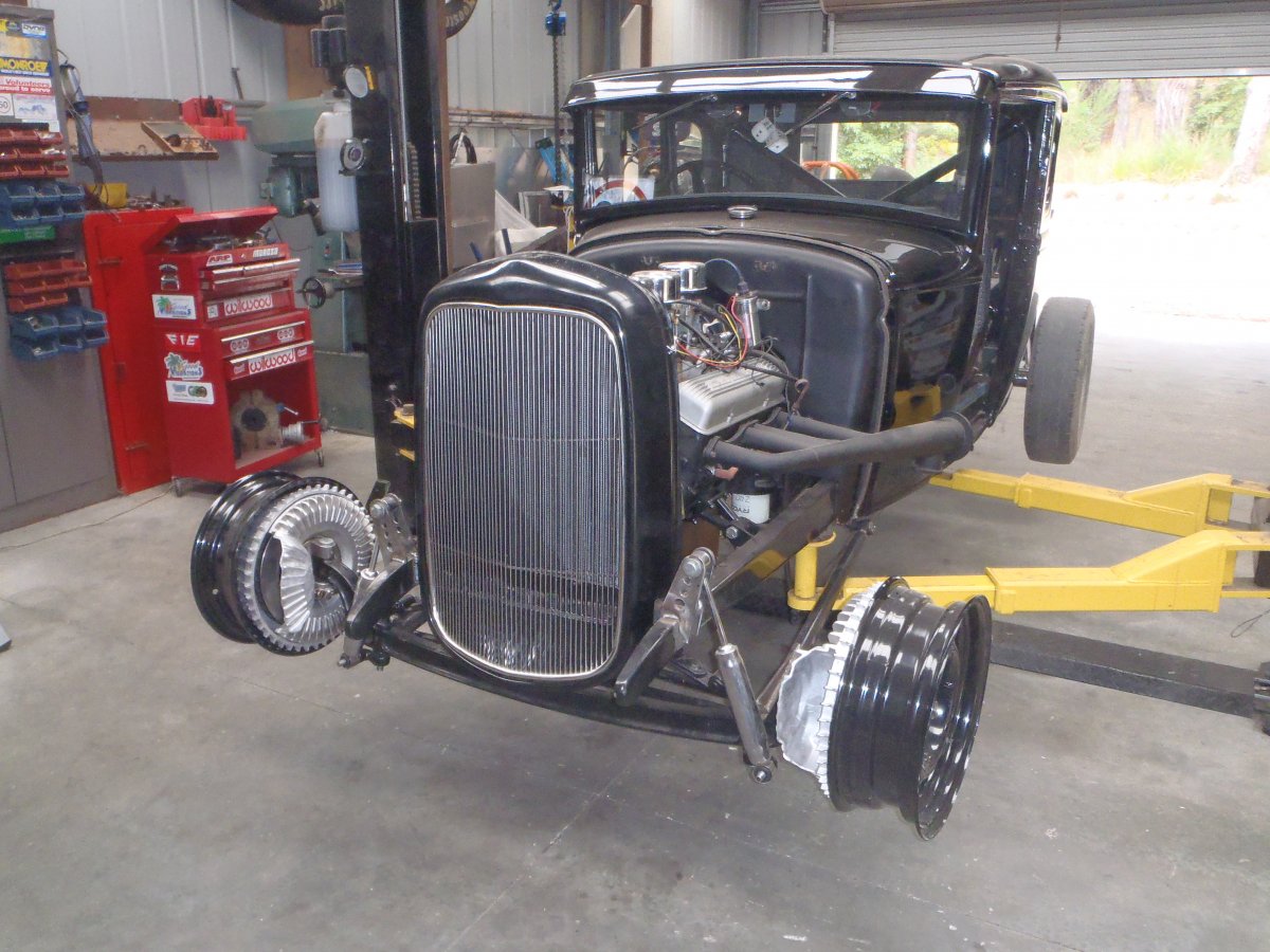

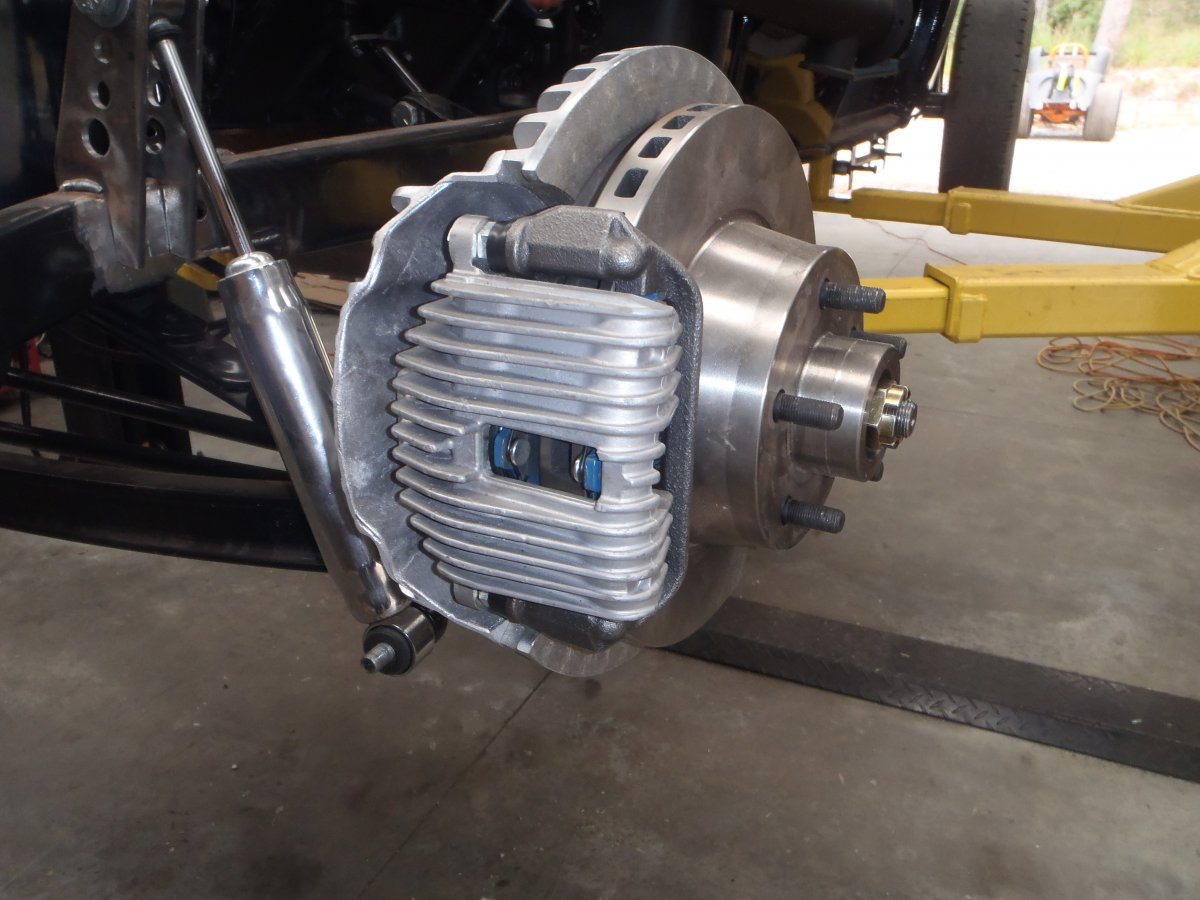

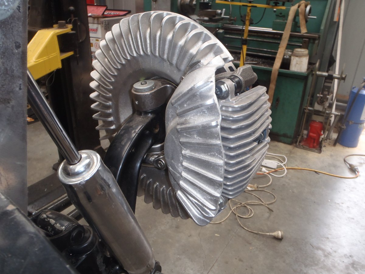

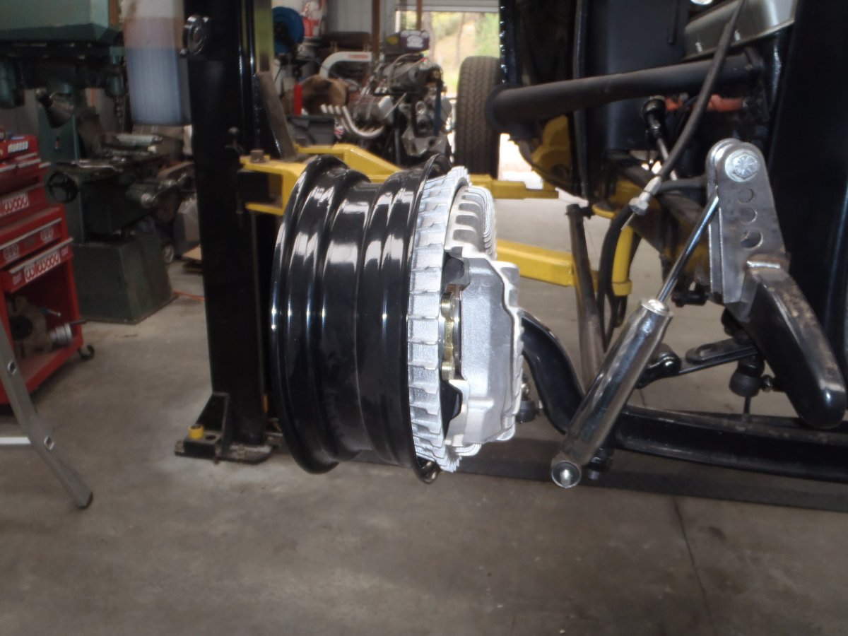

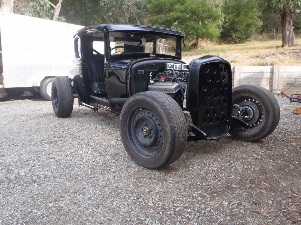

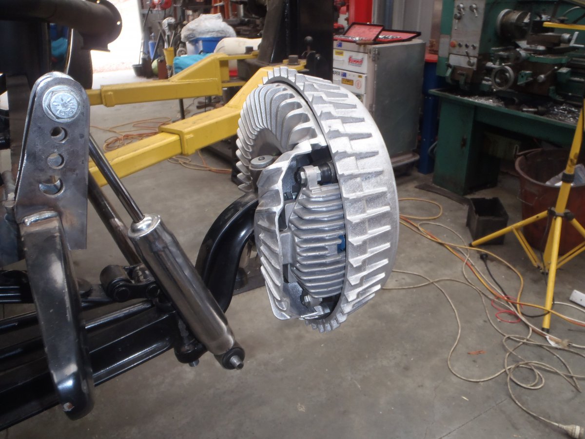

    Brought some Aussie made finned drums recently, good quality units, also purchased a 32 grille insert, check out the pics. Glen PA190805.JPG PA190806.JPG PA190807.JPG PA190808.JPG PA190809.JPG PA190810.JPG PA200811.JPG

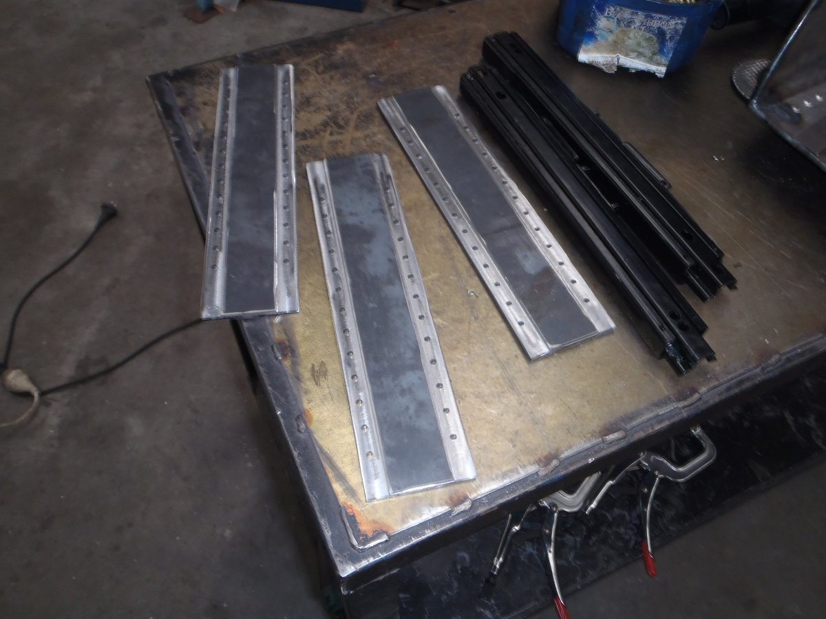

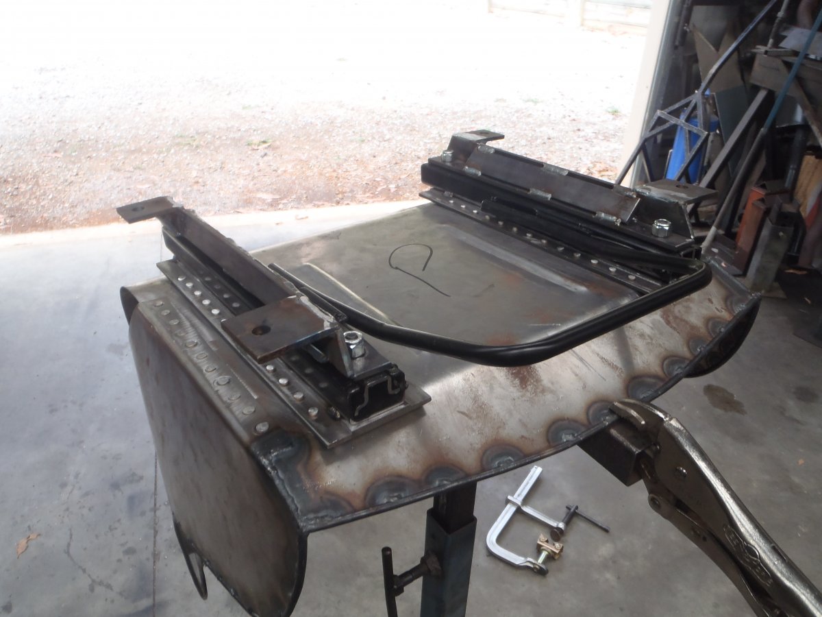

    Yep thats them, google Hot Cargo Engineering, Craig Fountain is the guy to talk to. Here is a few pics of today's progress, made some 1/4 inch plates to rivet to bottom of seats for the track to mount on. Glen P1010812.JPG P1010813.JPG P1010814.JPG P1010815.JPG P1010816.JPG

    IMO the taillights blacked out for sure and the new grill over holes:cool:

    I will be blacking out lights soon just looking at paint options, I like the new grille as well - I have 3 grilles now to mix and match. Drums come with backing plate, caliper mount, nuts and bolts and drum, you need your own disc and calipers. If you google Hot Cargo Engineering it will go to there face book page, they are in NSW. Glen

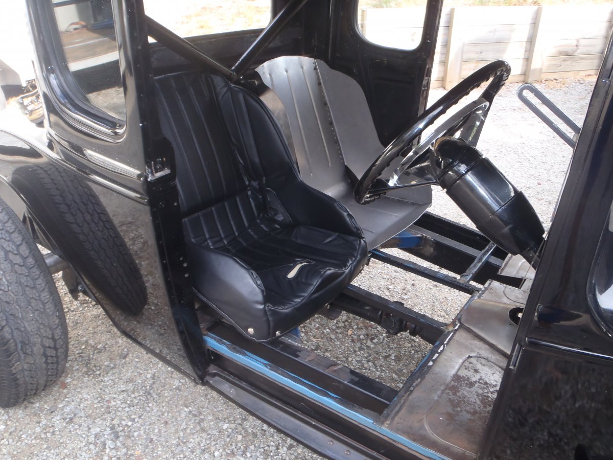

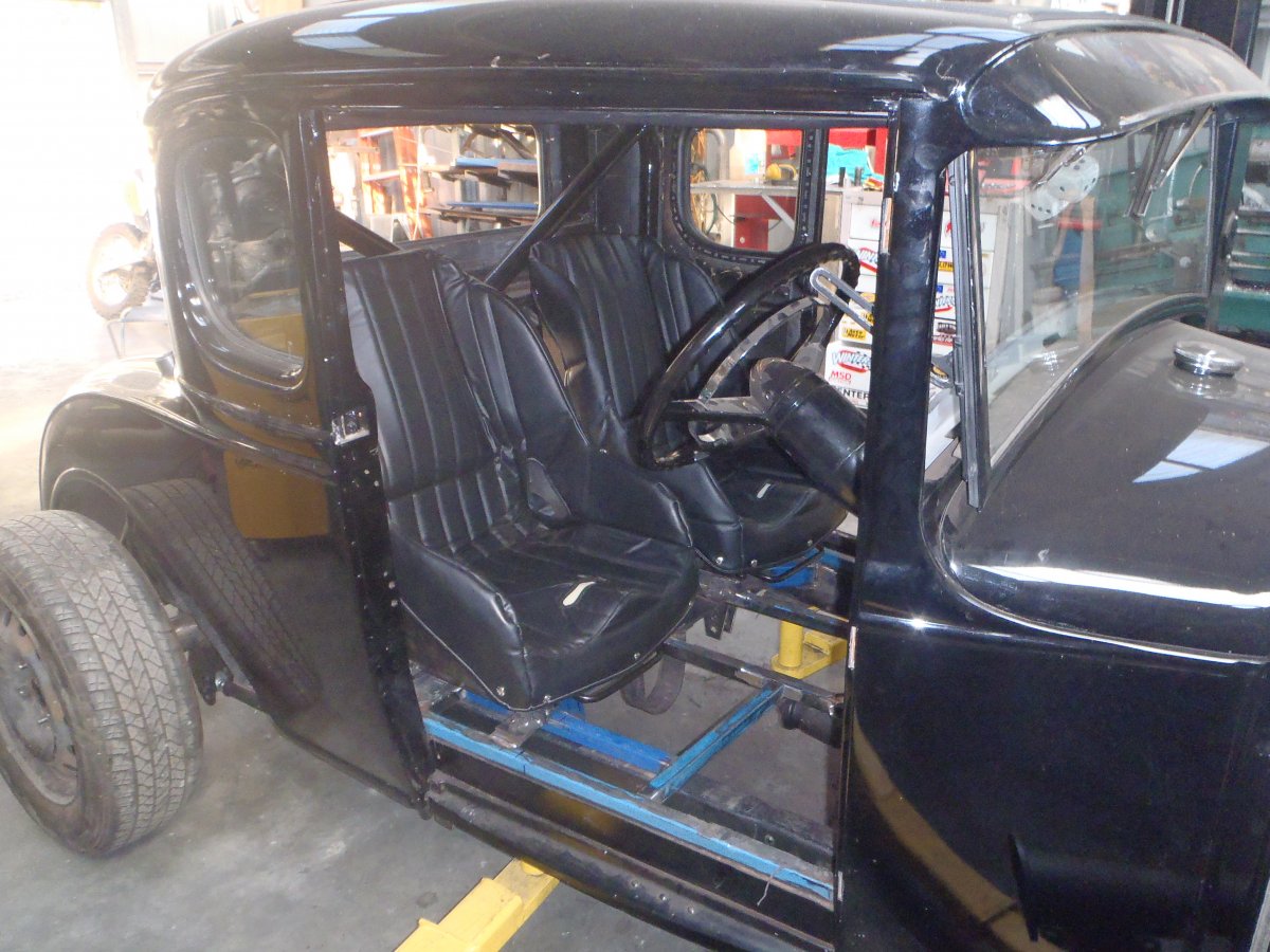

    I will try to make the seats as comfortable as possible, I will be adding extra padding to the seat covers. I was unable to use original seat as it pushed my legs to far forward and I had no room for the pedal assembly. This is because of the roll cage taking up valuable space, also the original seat had a wooden base and was bolted to the floor with 2 bolts. I needed to modify original or make new ones to gain more room and comply with regulations for seat mounting. Its not all about comfort for me, this is a hotrod and will be getting a tuff engine and will probably only do short trips of 1 -2 hours at a time. If its a to harsh ride I can always make or modify something more comfy, time will tell. Glen

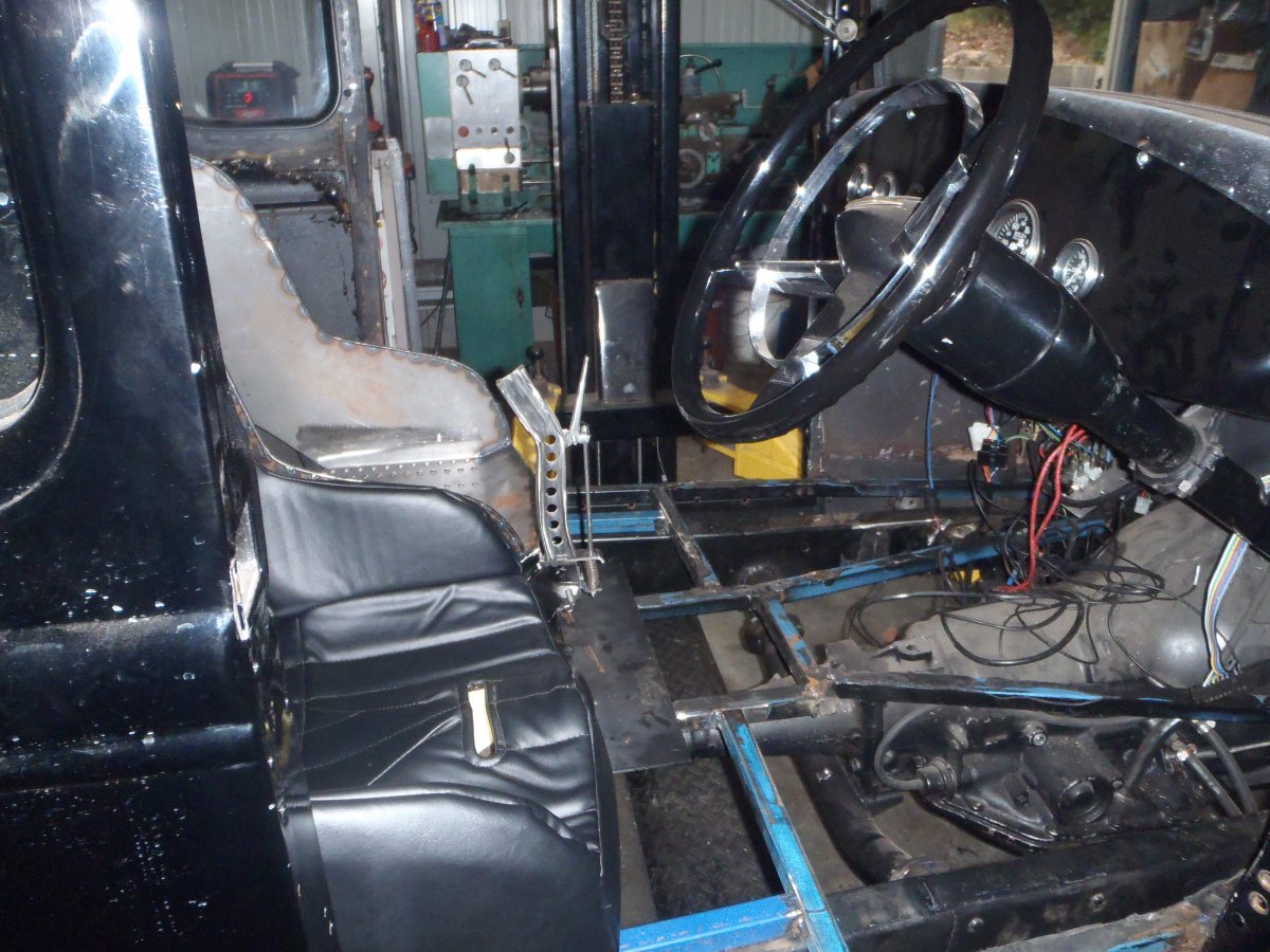

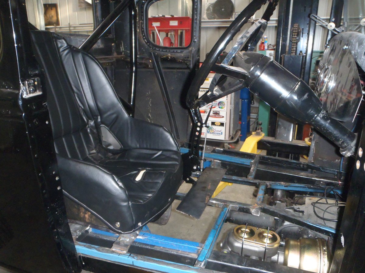

    Finished mounting seats today, I needed to make them bolt in from inside and had to make brackets to suit, also pulled out rest of floor so I can mount brake booster and make pedal assembly. I painted taillight bezels black as well, check out pics. Glen P1010826.JPG P1010827.JPG P1010828.JPG P1010829.JPG P1010831.JPG P1010832.JPG P1010819.JPG P1010820.JPG P1010821.JPG P1010822.JPG

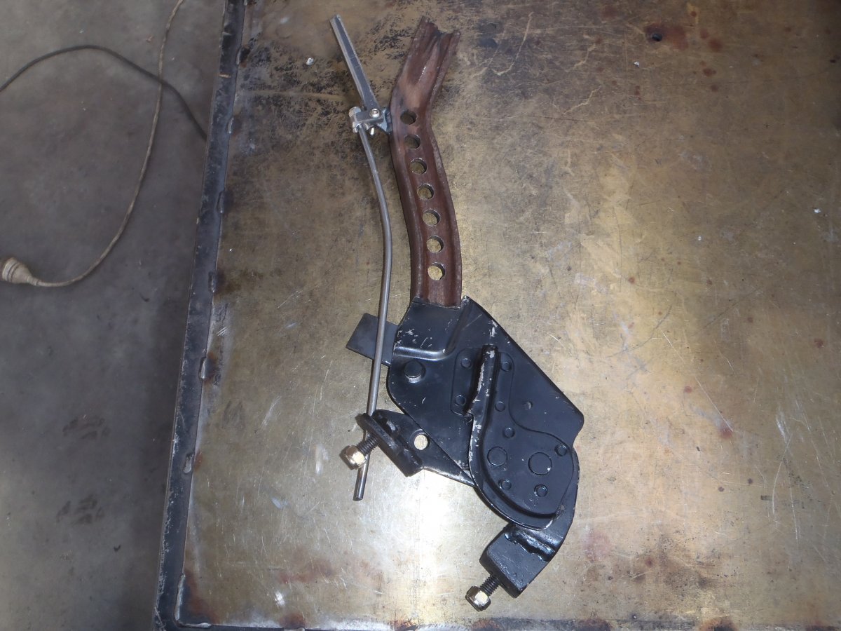

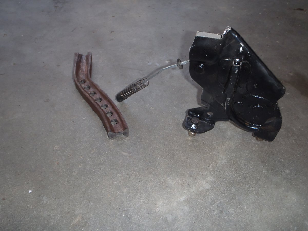

    Decided to modify my handbrake today, early days yet but you get the idea. Glen P1010834.JPG P1010833.JPG

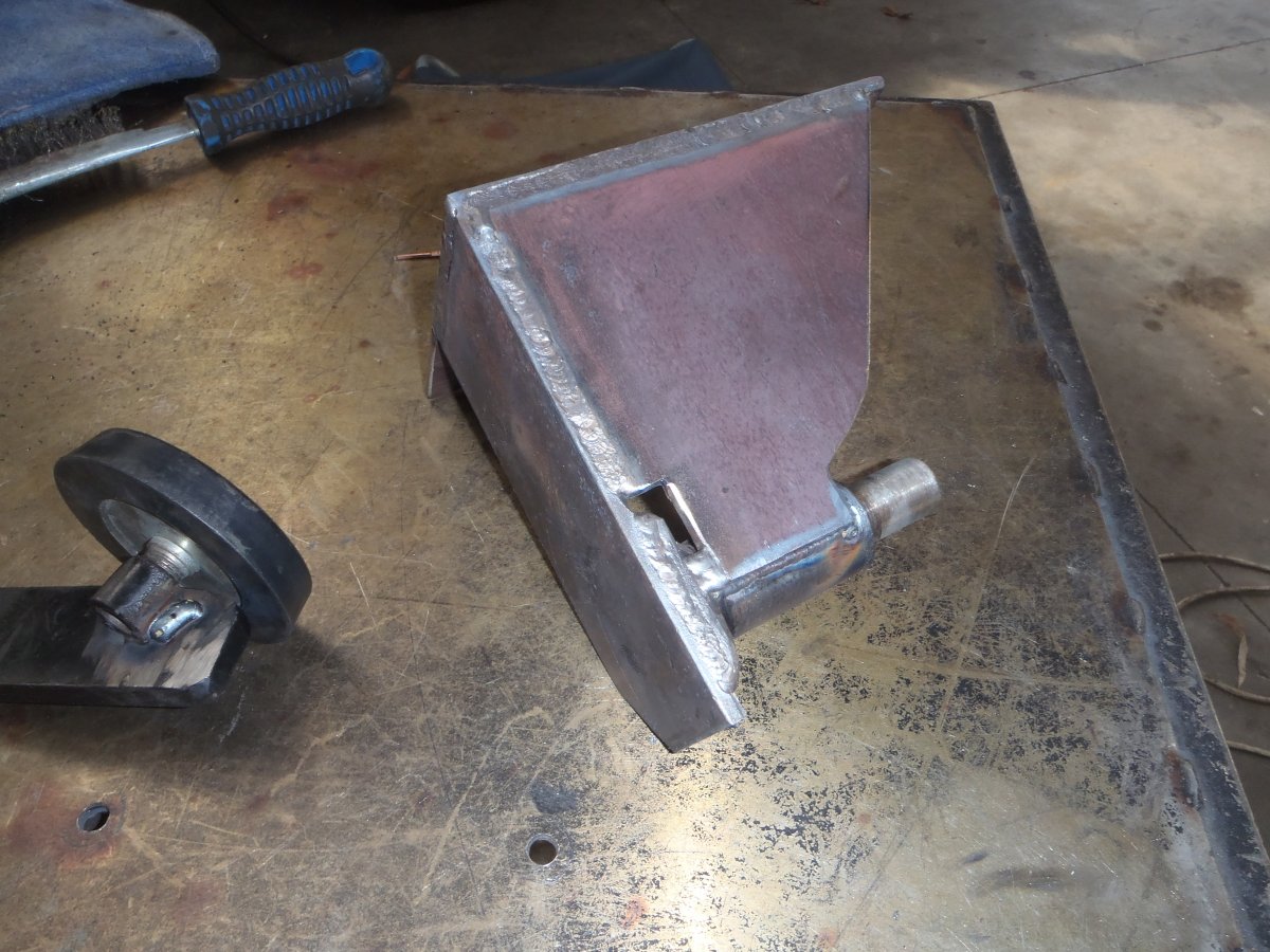

    A few pics of todays progress, took a while to sort it out but it now works fine. Need to finish weld and mount in car. Unsure weather to make some sort of handle or leave as is - leaning towards leaving as is. Glen P1010840.JPG P1010843.JPG P1010844.JPG

    I think they look better under a cross-member where it's designed for. I like that you're thinking outside the box, just careful on R-rod design.
    Have you enquired about rules for head restraint. Here, if your 12'' or closer to anything behind you, headrests are required for compliance.

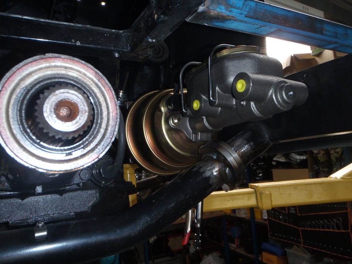

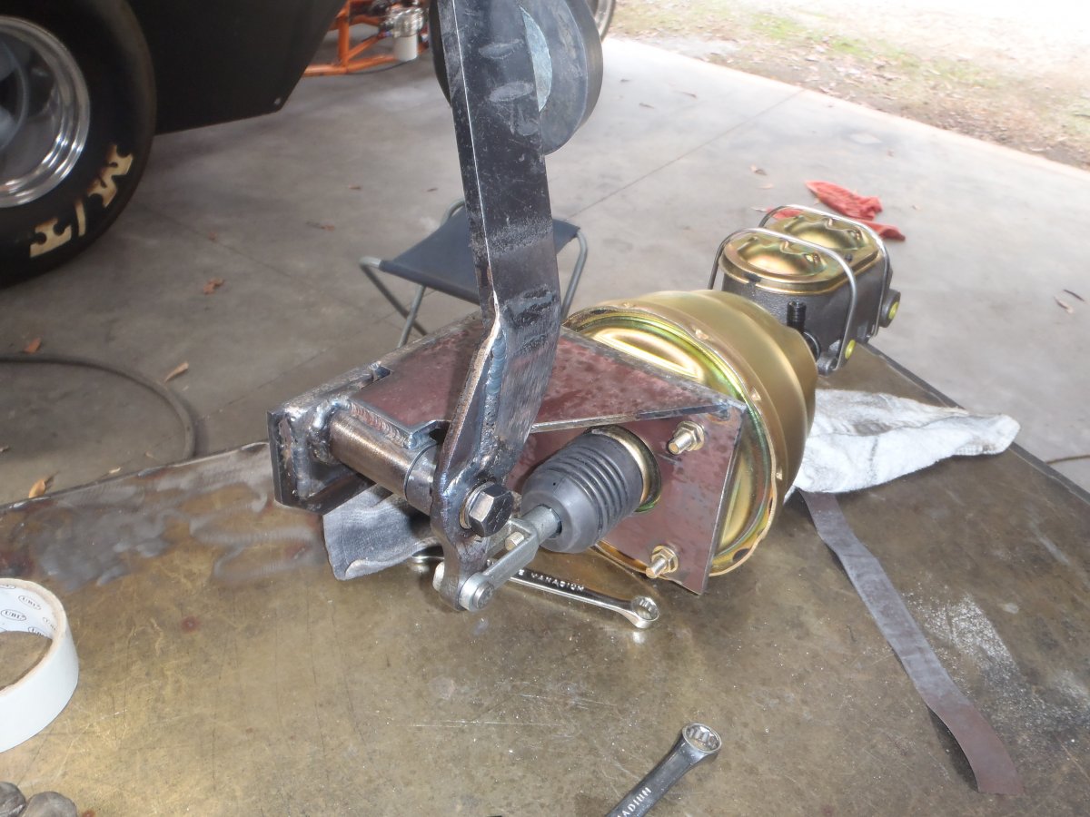

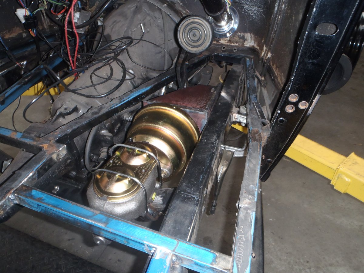

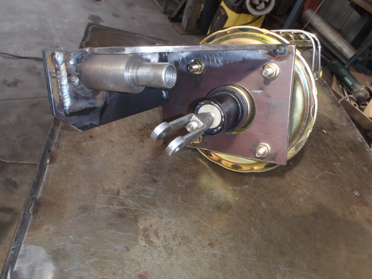

    I forgot to include pics of todays progress, fabricated my brake pedal and booster / master cylinder mount. Glen P1010851.JPG P1010858.JPG P1010860.JPG P1010861.JPG P1010863.JPG P1010862.JPG P1010866.JPG P1010868.JPG P1010870.JPG P1010871.JPG P1010872.JPG
