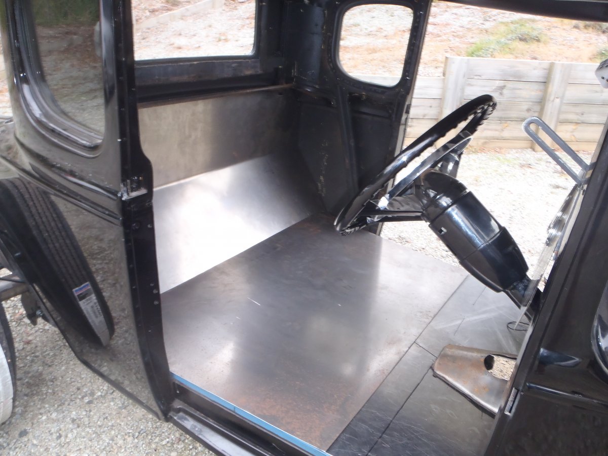

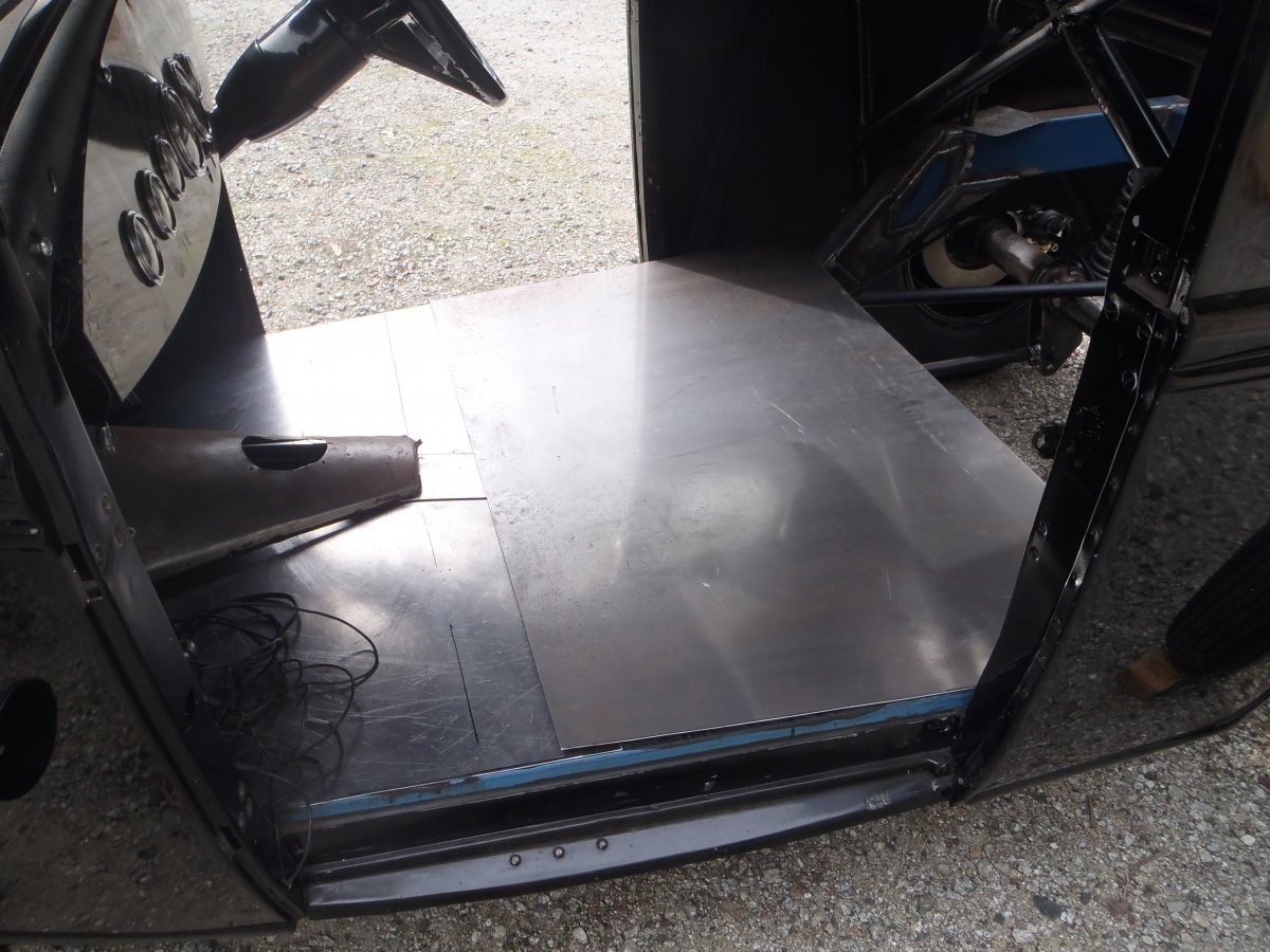

    grdra1
    Started fabricating new floor today, was going to use old piece covering gearbox ( just clean it up and add some beading ) but unsure, may make a new one. A few pics, Glen P1010904.JPG P1010905.JPG P1010906.JPG P1010907.JPG

  4. grdra1
    Joined: May 20, 2013
    Posts: 681
    grdra1
    Fabricated rest of floor today, only mock up stage but getting there. Glen P1010909.JPG P1010910.JPG P1010911.JPG

    grdra1
    Started mounting floor this week, the old floor was glued down and had to be destroyed to get out. I decided to make new floor removable and just happened to have lots of dzus fasteners laying around. Early days yet, will need to make opening for brake booster / master cylinder access and put through bead roller to make them pretty - will be painted black when finished. I have also decided to fabricate new transmission tunnel instead of using old one, I'm unsure whether to run carpet or not, at this stage I won't be. Glen P1010920.JPG P1010922.JPG P1010921.JPG

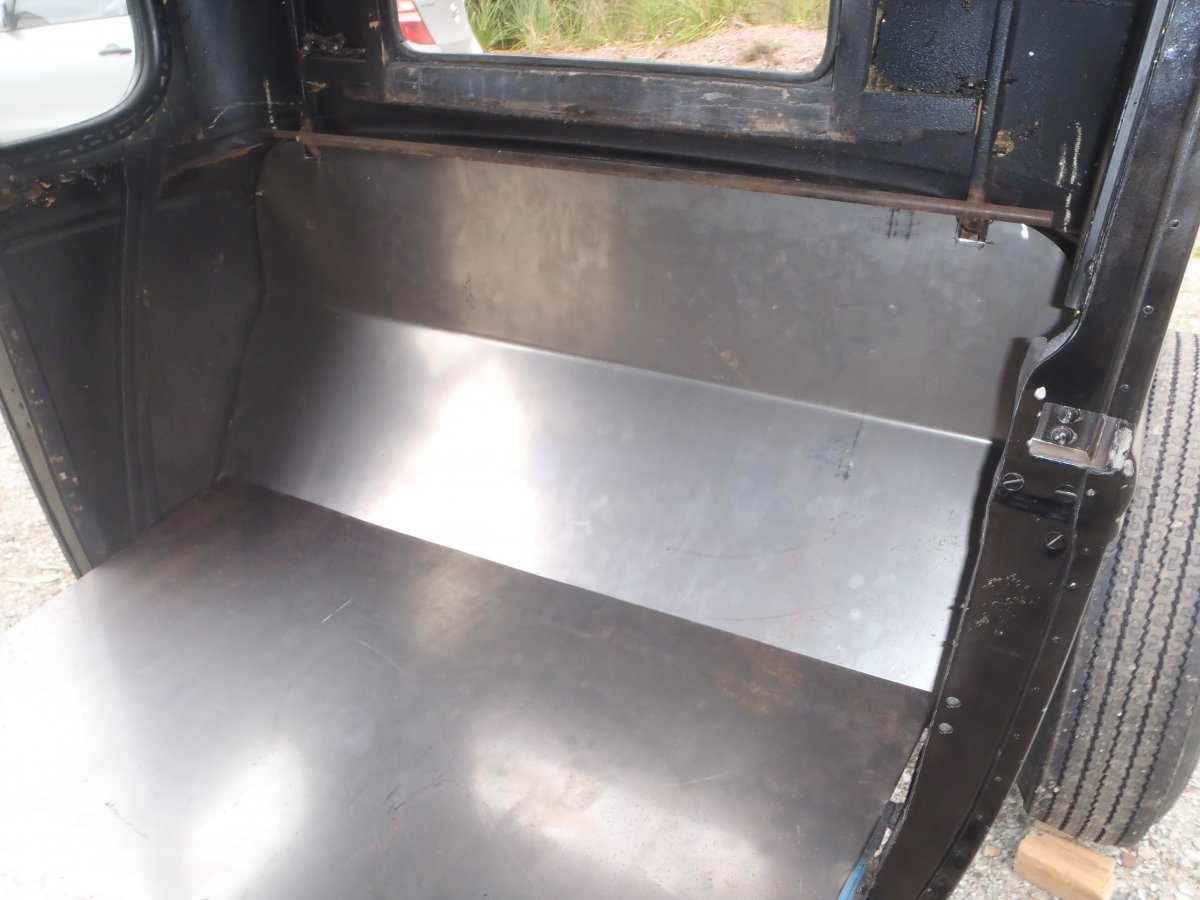

    grdra1
    Thanks for kind comments. A few pics of today's progress, rolled some beads in rear interior panel - not perfect but bead rolling is harder than it looks. Lucky for me they wont be seen, using experience as practice. Glen P1010950.JPG P1010952.JPG P1010954.JPG P1010955.JPG P1010956.JPG P1010957.JPG
