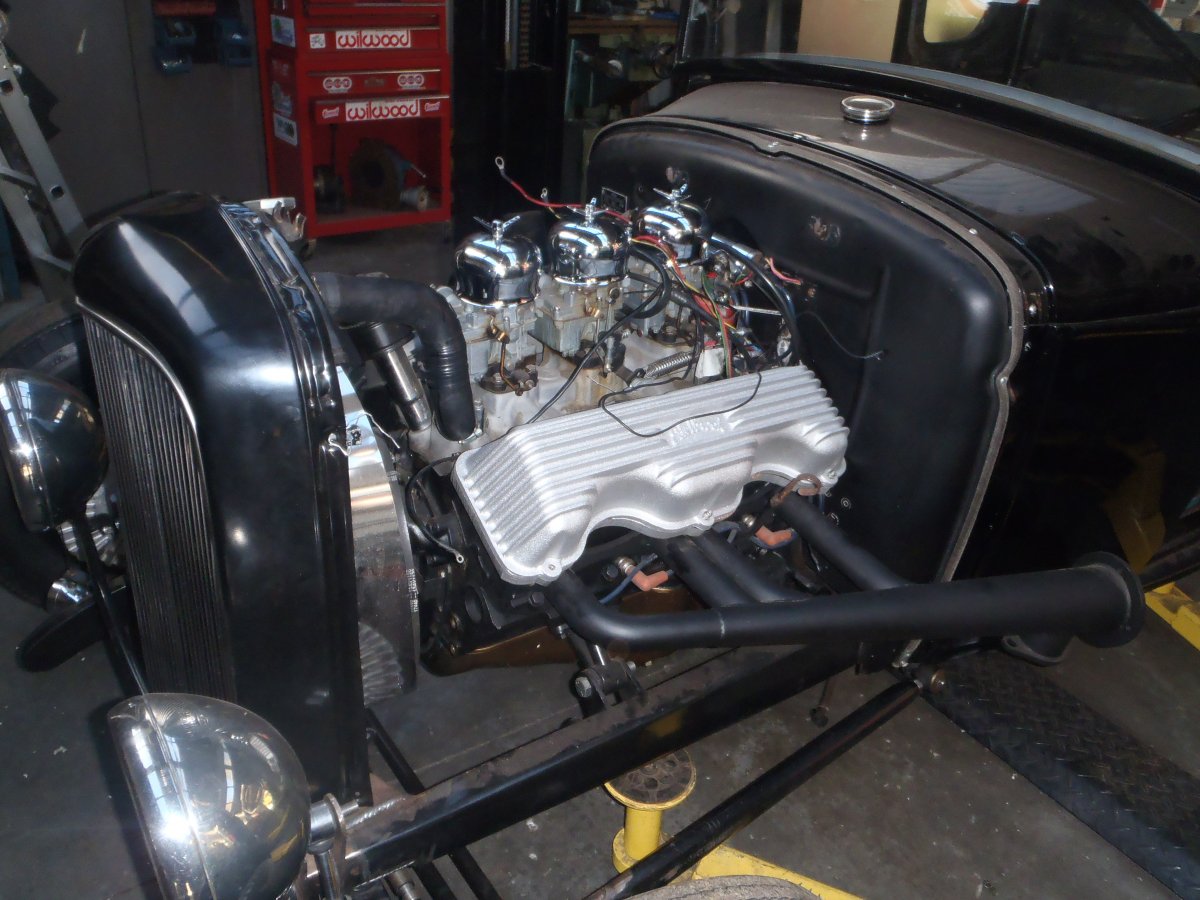

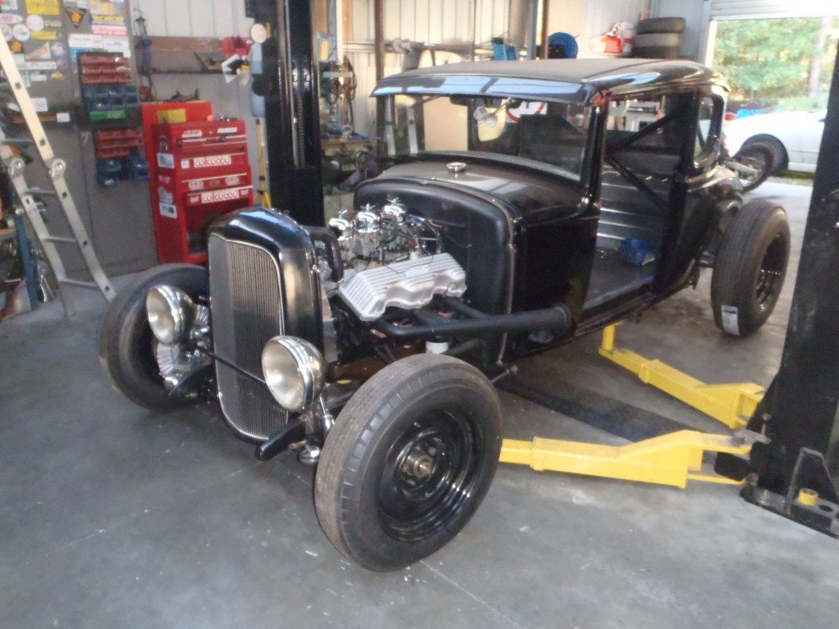

    Yep BigMo original ch***is was pretty ordinary but should be ok now and up to the task of a mild SBC. A few pics of my new air cleaners installed today. I still plan to make adapters to raise carbys approx 1/2 to 1 inch. Glen P1011009.JPG P1011008.JPG

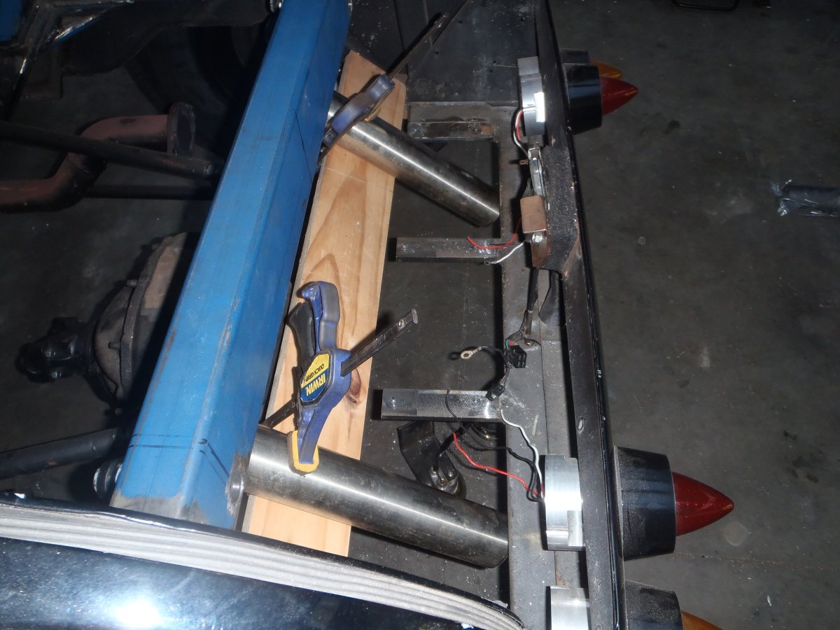

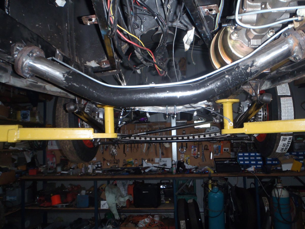

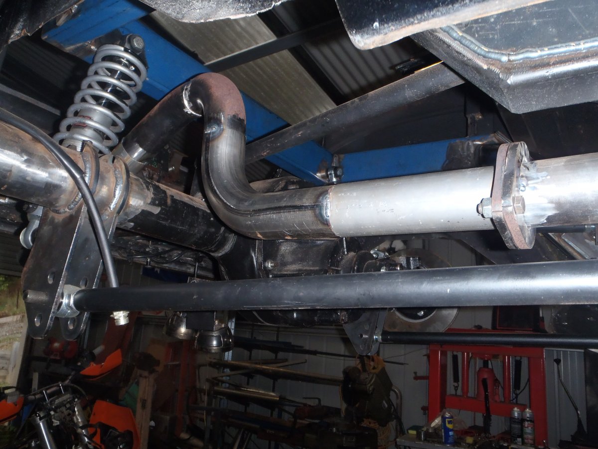

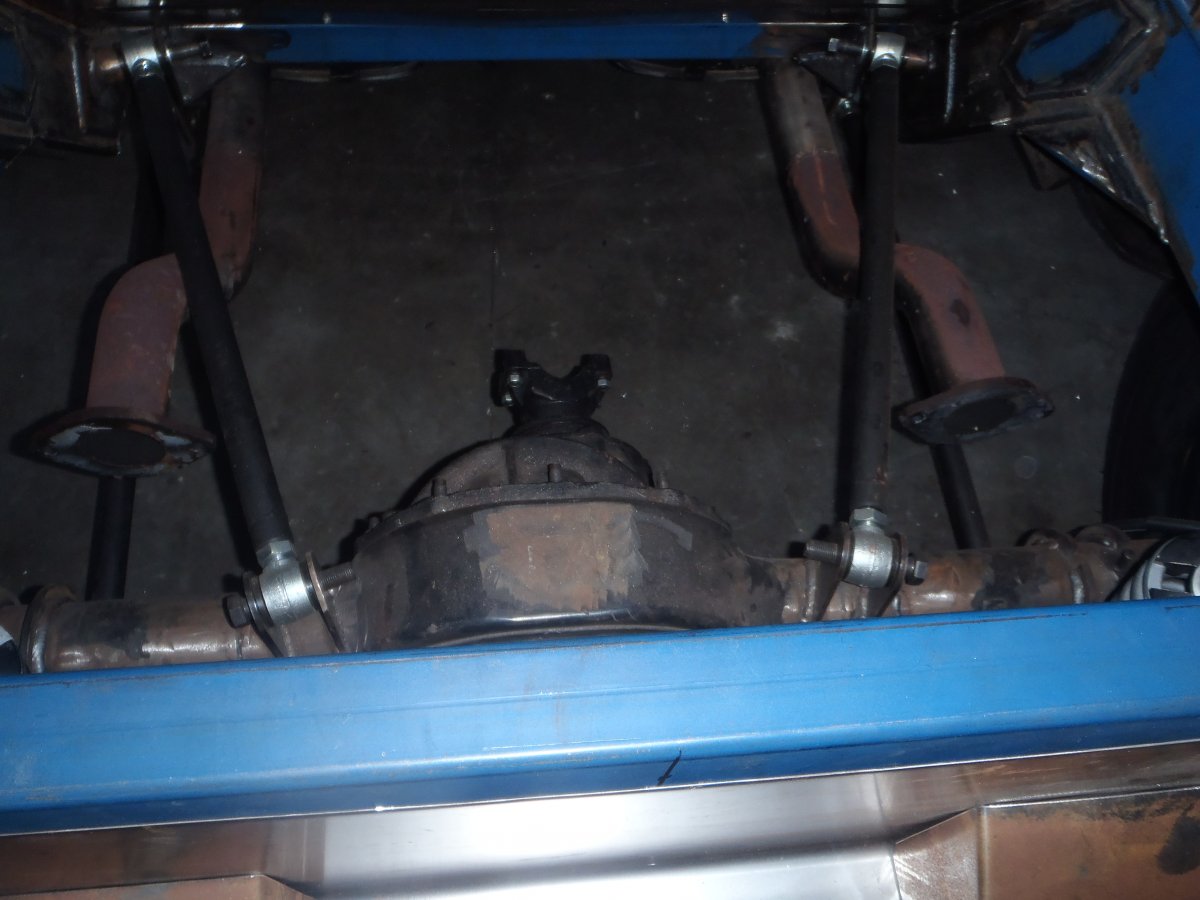

    Trial mounted exhaust today, I was pleasantly surprised with how the system fitted prior to the rear end. All I will need to fabricate is from mufflers back. Check out pics, Glen P1011012.JPG P1011017.JPG P1011019.JPG P1011030.JPG P1011025.JPG P1011027.JPG P1011028.JPG P1011021.JPG

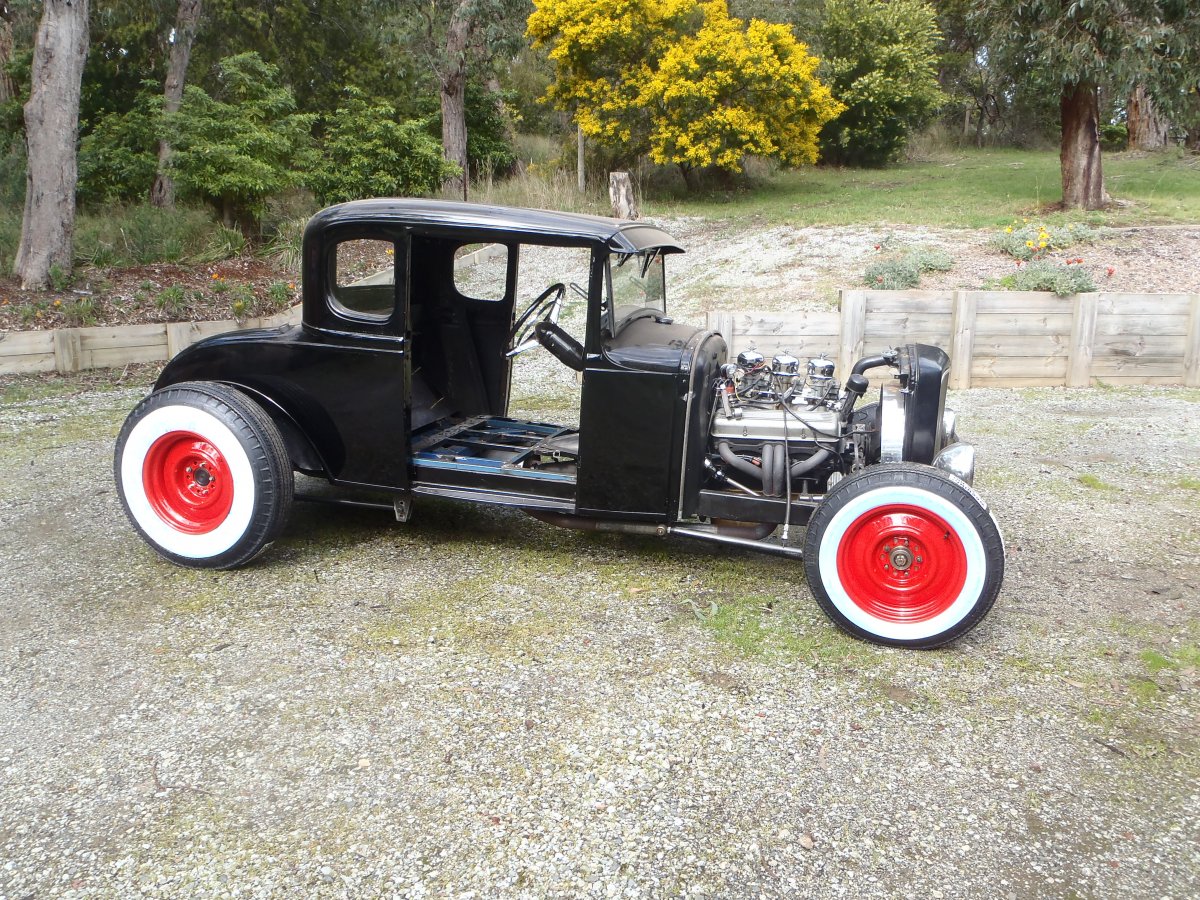

    I took car for 1st engineer inspection recently, all work done so far is ok so now its full steam ahead with aust street rod guidelines in hand to complete this ride. Stay tuned. Glen

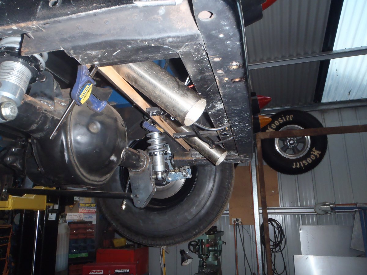

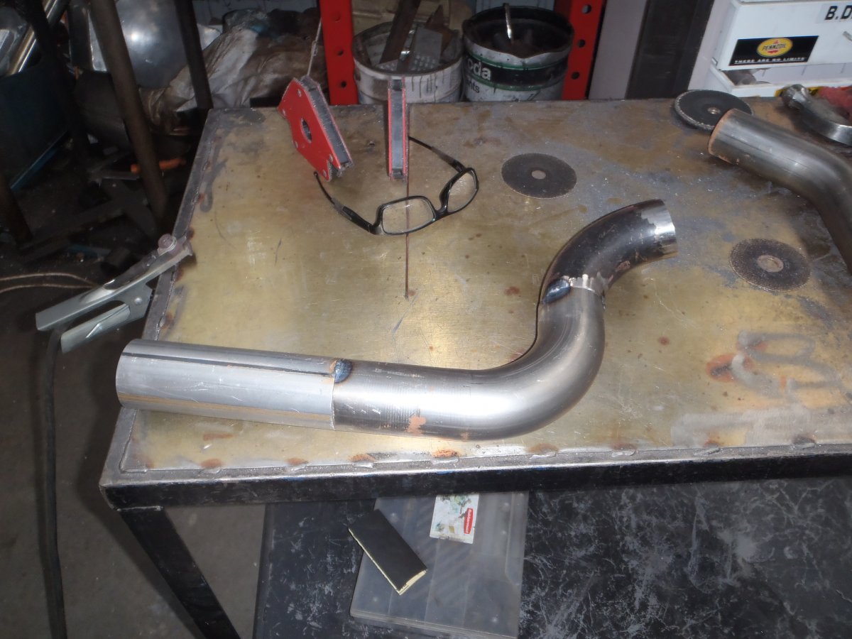

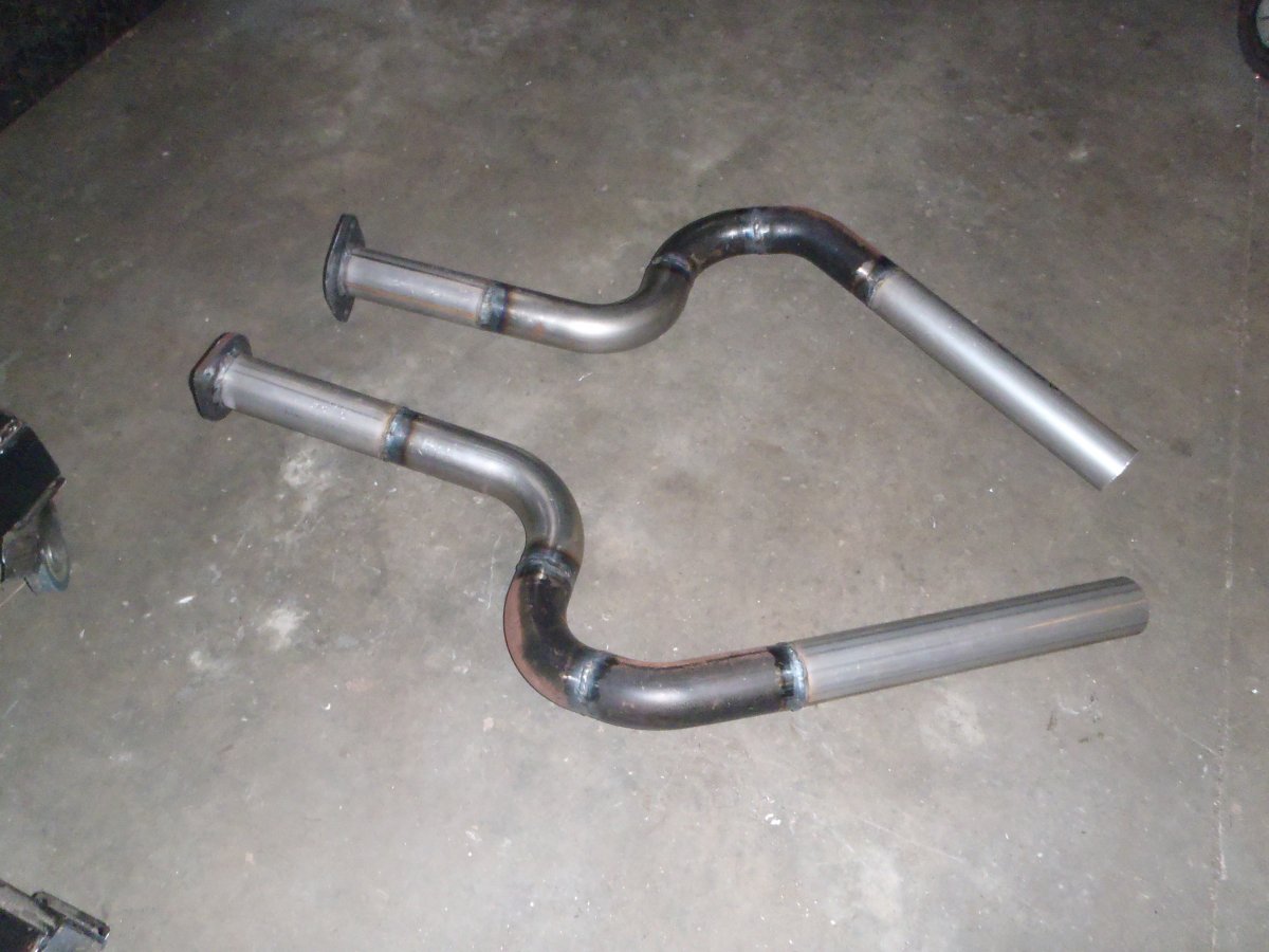

    Nearly finished exhaust, just need to mount hangers, also been working heaps lately and purchased some new wheels - plan to run whitewalls on new rims, then I will have two sets of wheels / tyres to play with. Glen P1011031.JPG P1011032.JPG P1011034.JPG P1011035.JPG P1011039.JPG P1011043.JPG P1011042.JPG P1011044.JPG P1011040.JPG P1011041.JPG

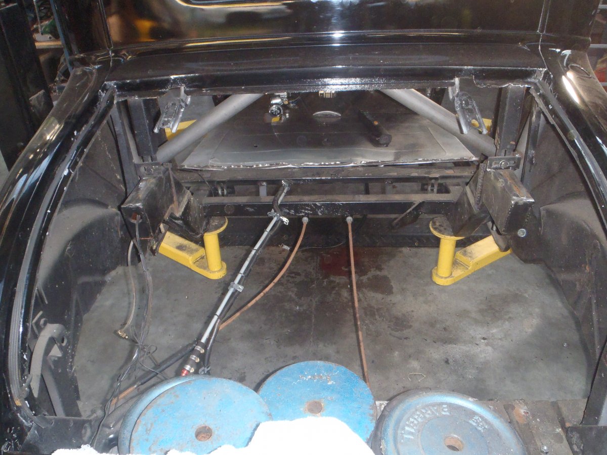

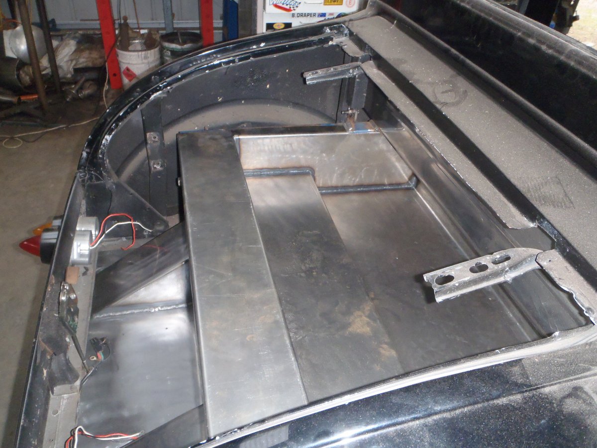

    Been working on boot area lately, so far so good. Glen P1011061.JPG P1011064.JPG P1011066.JPG P1011070.JPG P1011073.JPG P1011077.JPG P1011078.JPG P1011079.JPG P1011080.JPG

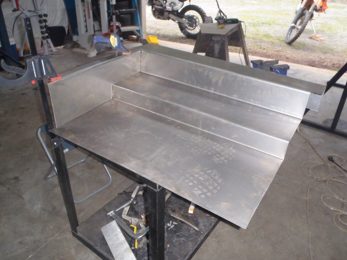

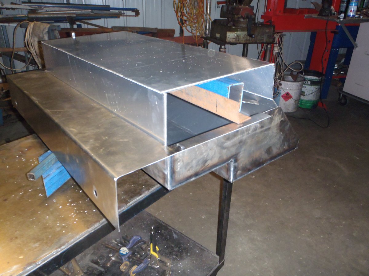

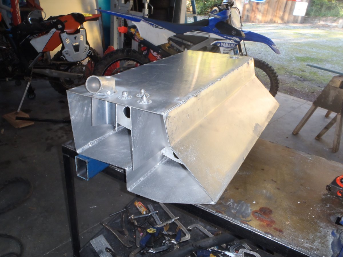

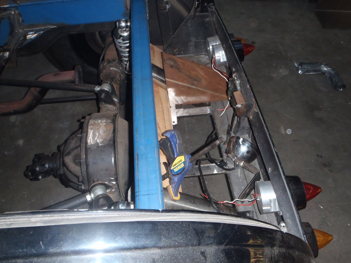

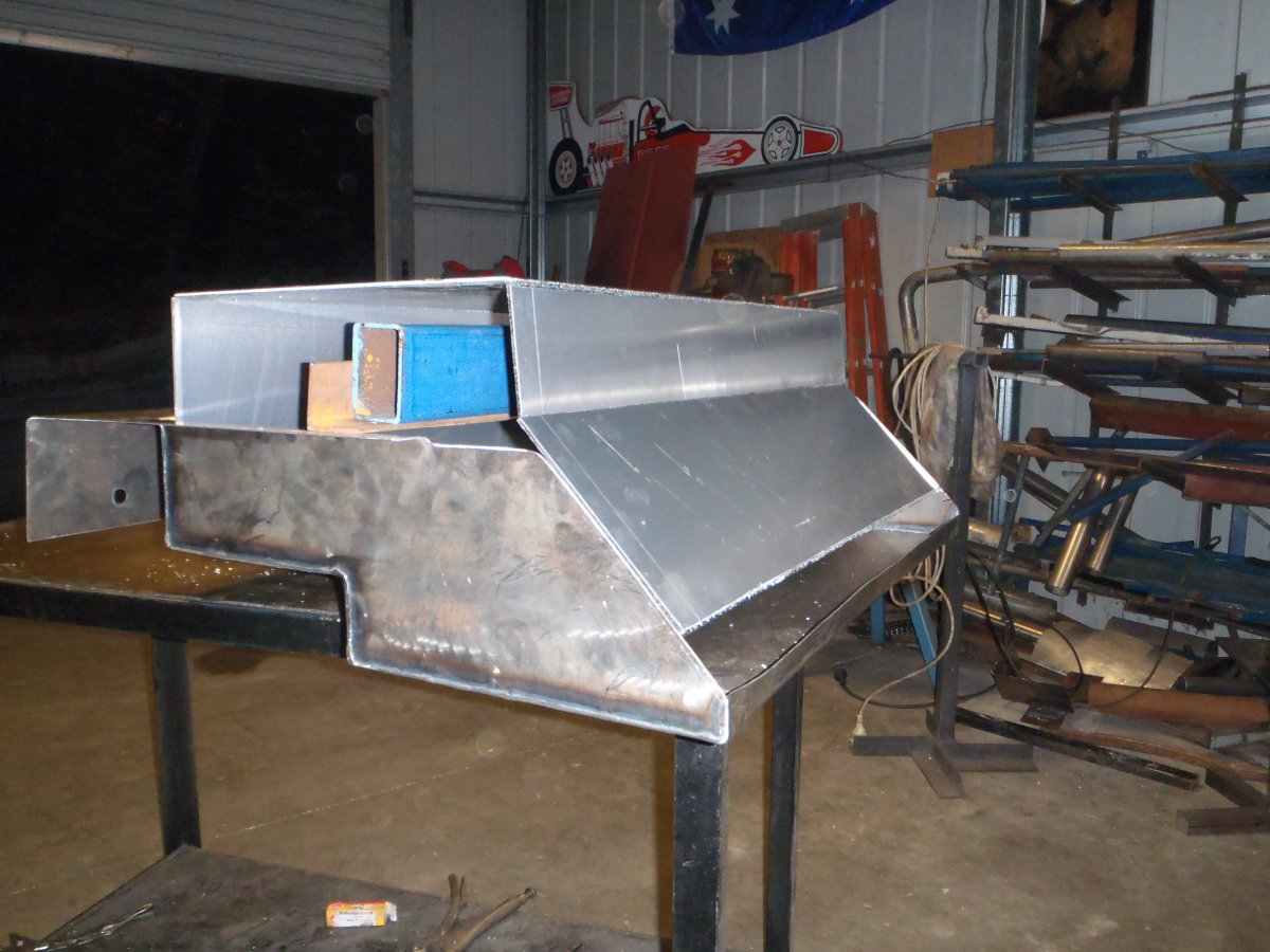

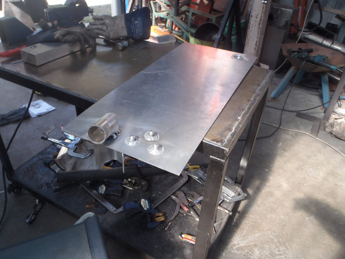

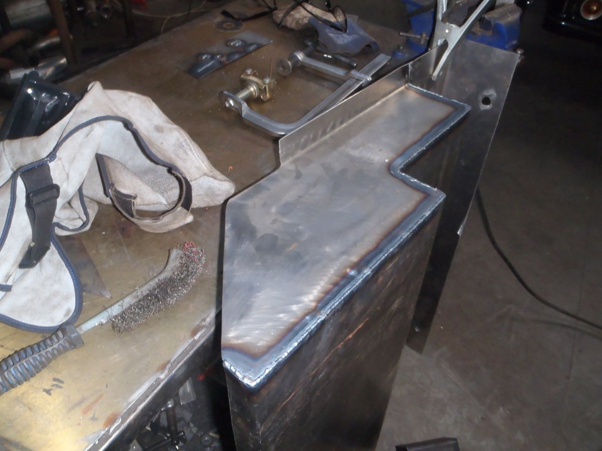

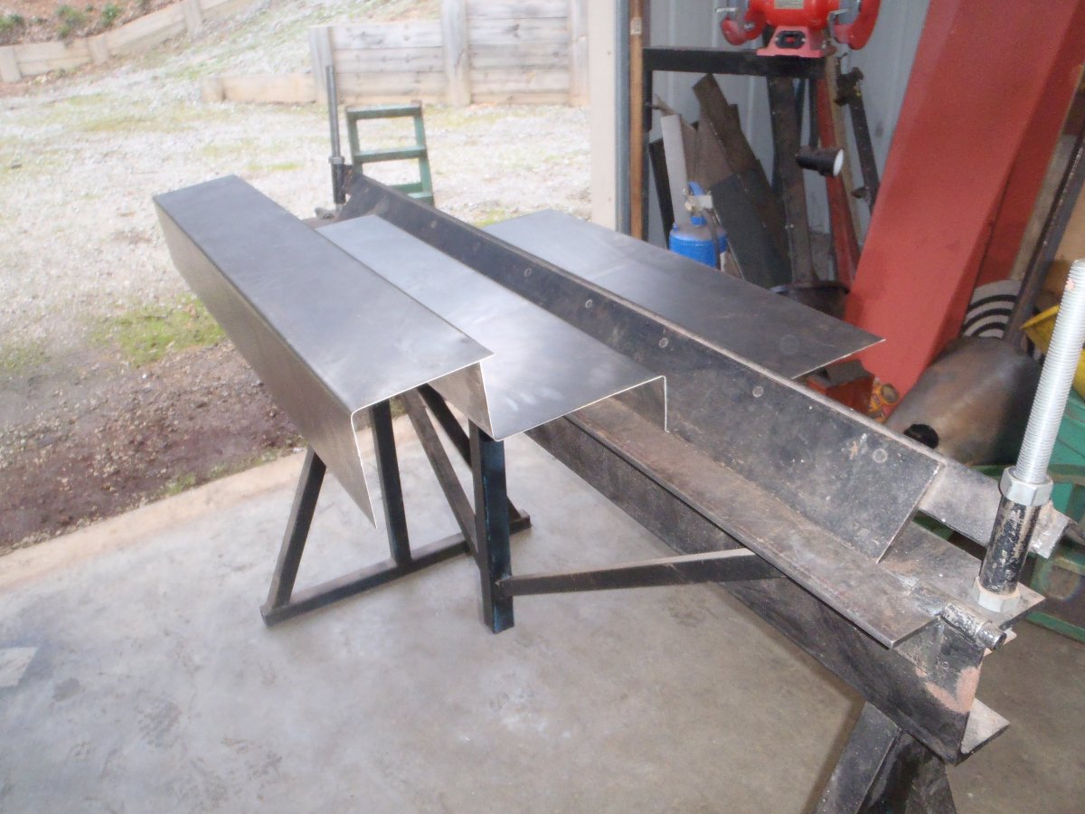

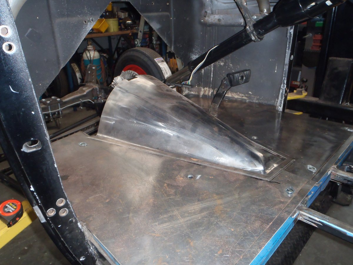

    Ok guys, there from my runners, not my boots, Anyway a few pics of todays progress. I purchased some 3 mm alloy sheet to fabricate fuel tank, my bender unable to fold so I will have to weld together. Glen P1011082.JPG P1011083.JPG P1011084.JPG P1011086.JPG P1011081.JPG

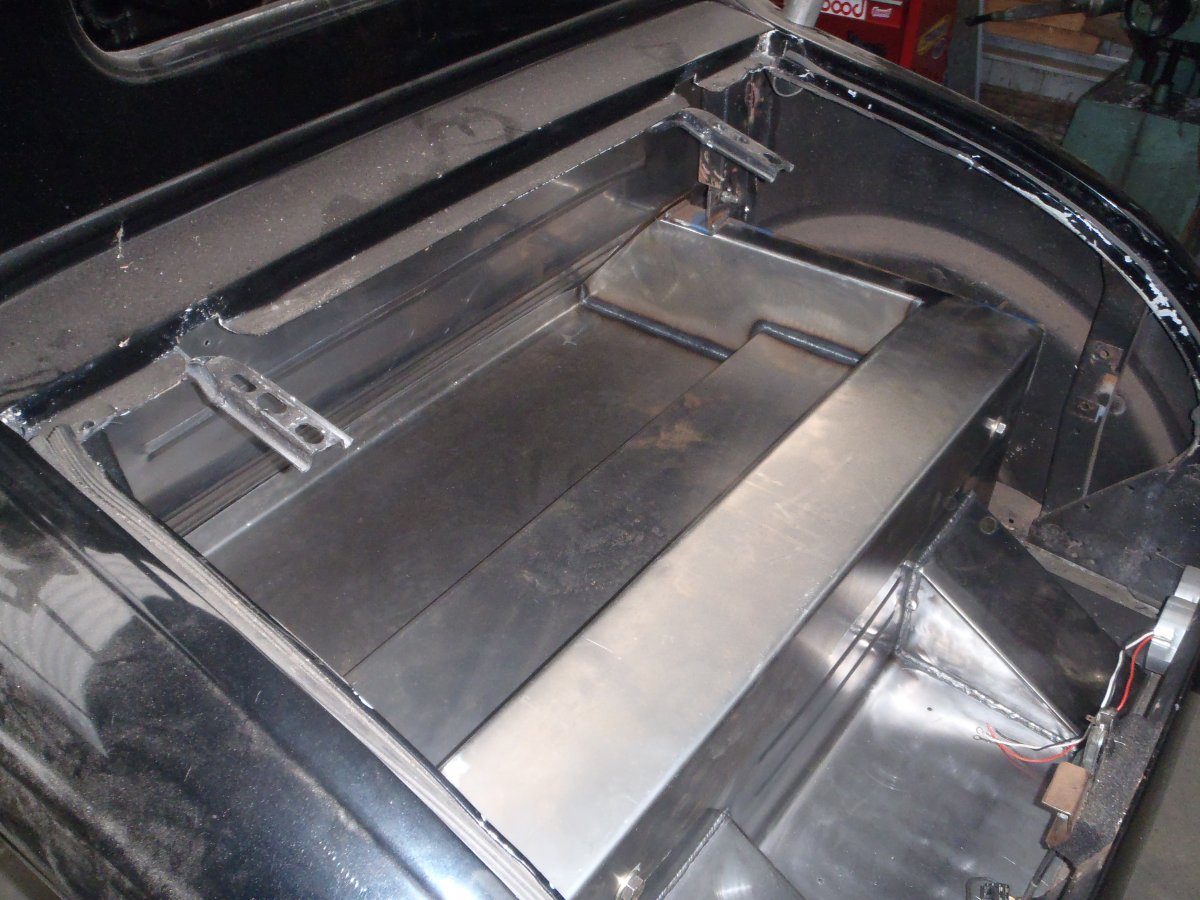

  12. grdra1
    Joined: May 20, 2013
    Posts: 680
    grdra1

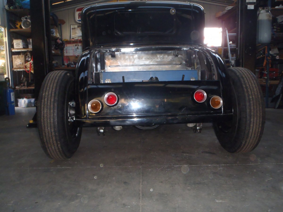

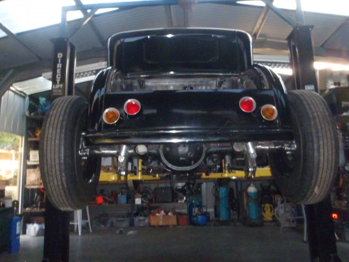

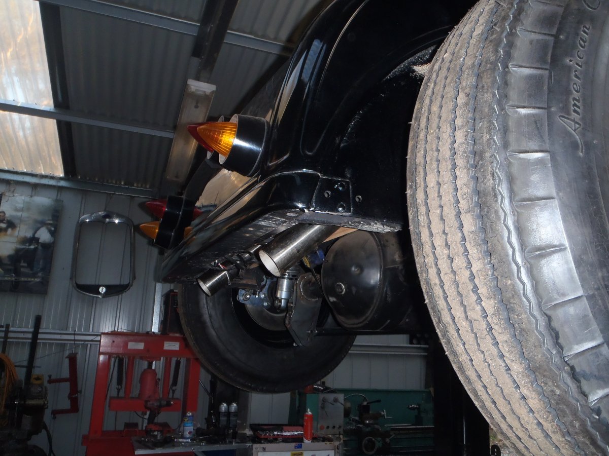

    Still working on fuel tank, practicing my alloy welding at present, but today I modified my taillights to accept 62 chev lenses. Also purchased my new whitewall tyres, now just need to have them fitted to rims. Glen P1011092.JPG P1011098.JPG P1011096.JPG P1011095.JPG

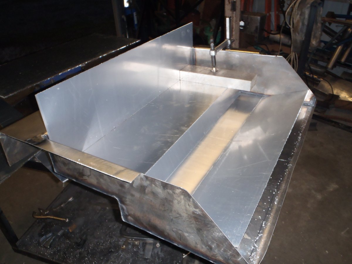

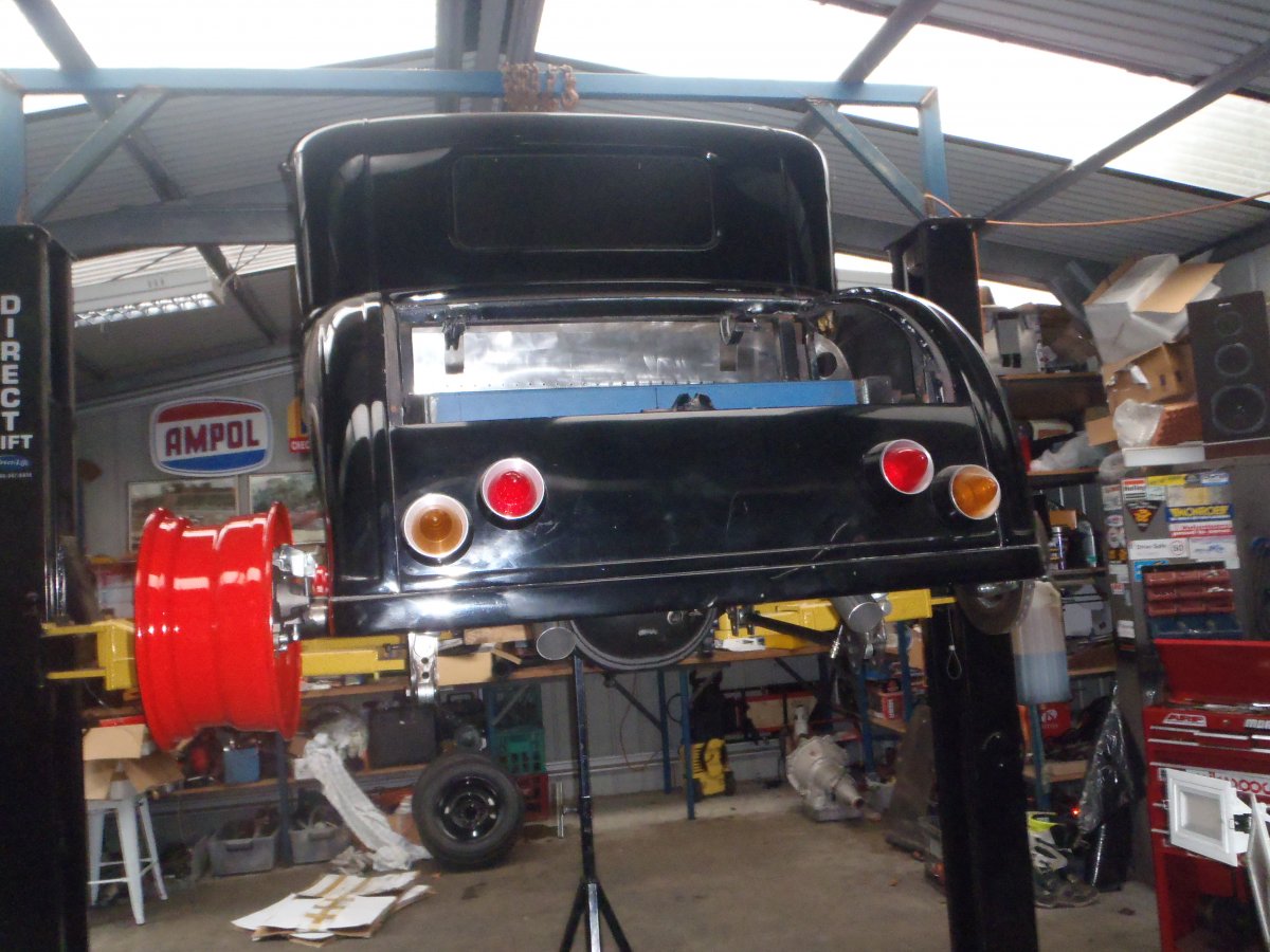

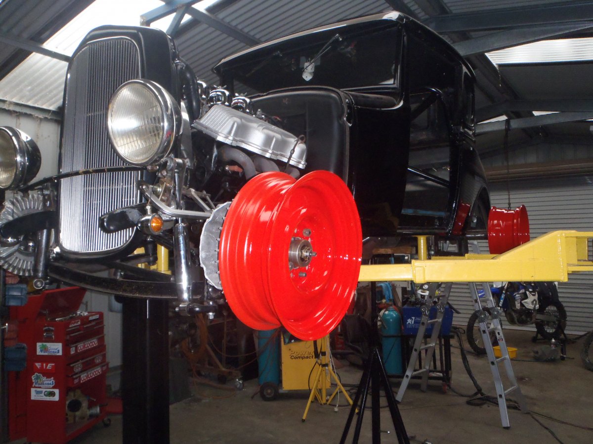

    Put new wheels / tyres on today, I like it, now I have two sets of wheels to change the look of car. Also been working on fuel tank, a few pics. Glen P1011099.JPG P1011101.JPG P1011104.JPG P1011116.JPG P1011117.JPG

    Worked on tank today, getting there slowly. Glen P1011119.JPG P1011122.JPG P1011122.JPG P1011125.JPG P1011127.JPG P1011129.JPG P1011130.JPG P1011131.JPG

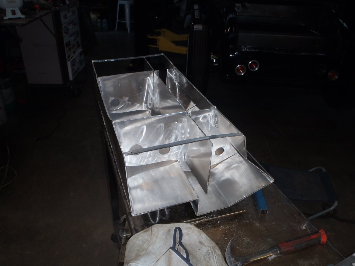

  15. grdra1
    Posts: 680
    grdra1

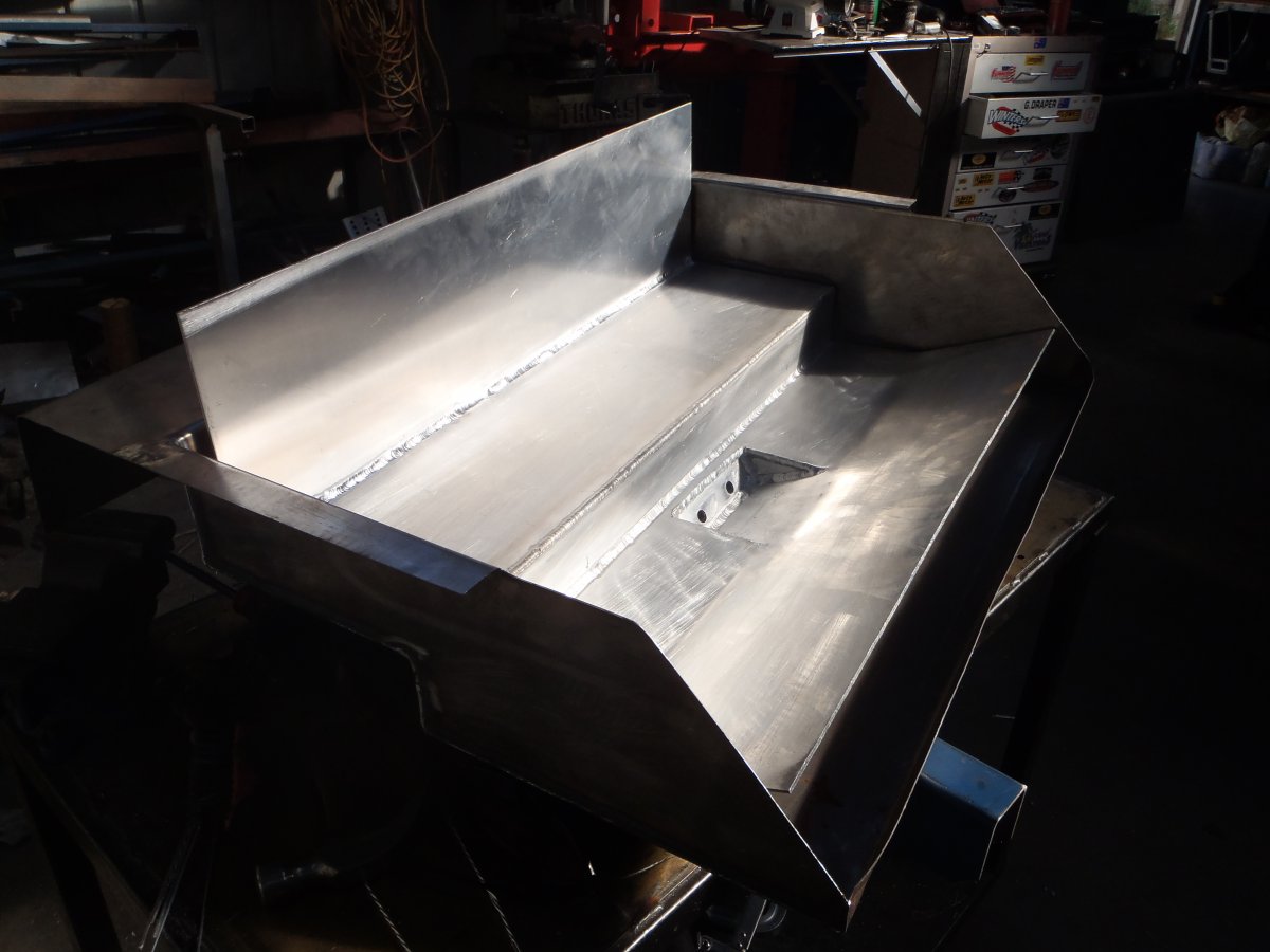

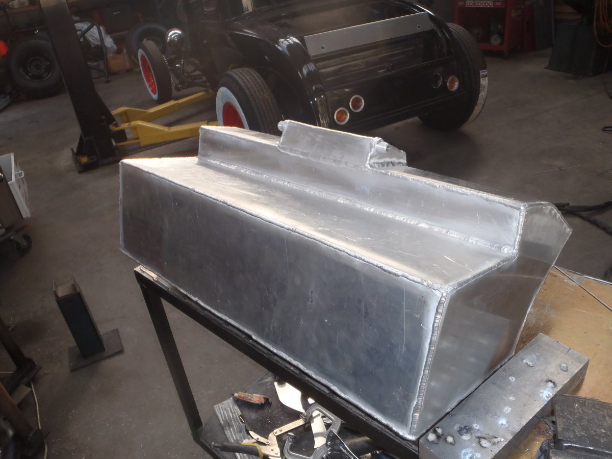

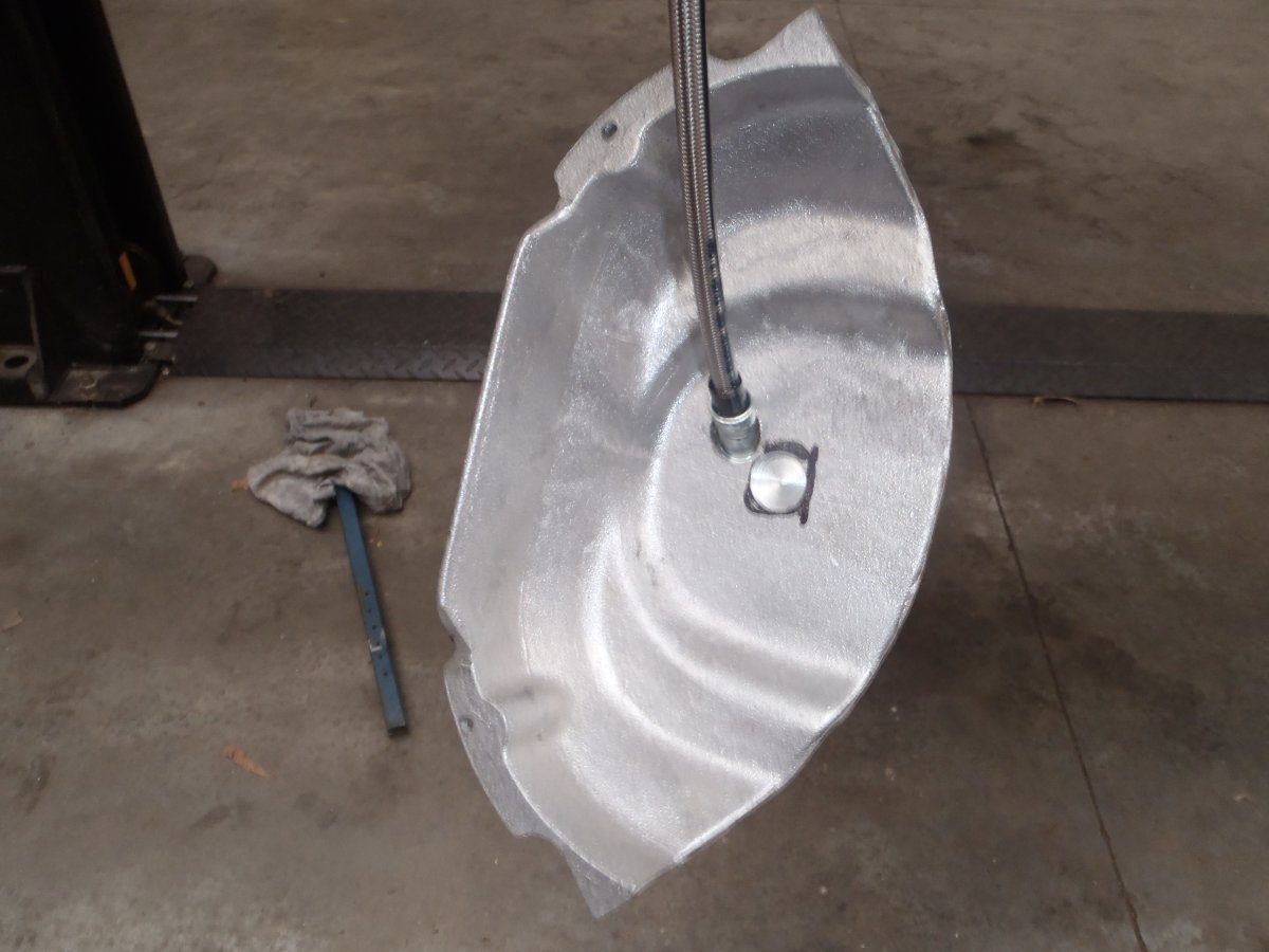

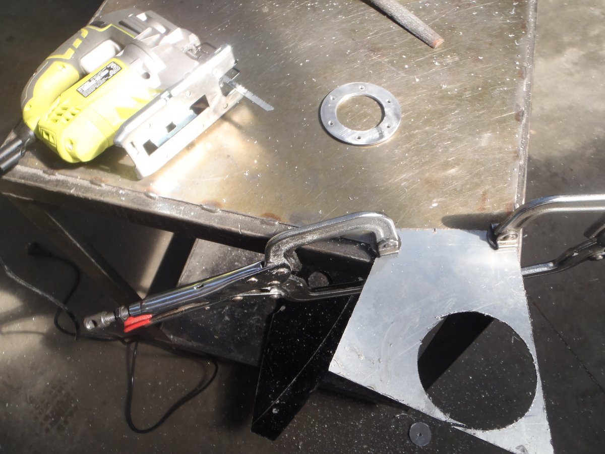

    Baffles welded in today, made provision for sender unit, just need to clean up inside tank before closing for good. Glen P1011133.JPG
  16. grdra1
    Posts: 680
    grdra1

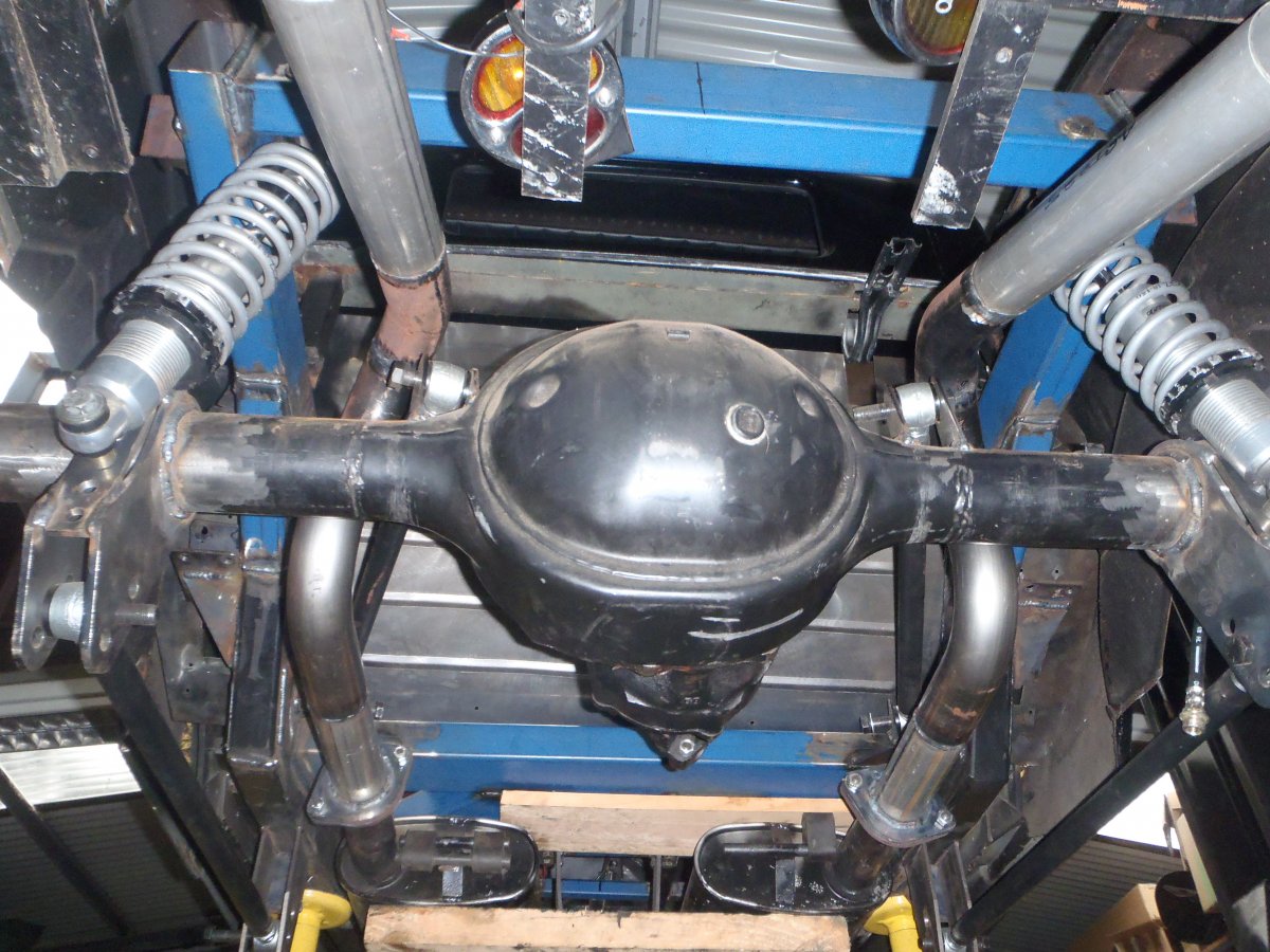

    Tank nearly finished, my new drilled axle arrived today, check out pics. Glen P1011134.JPG P1011137.JPG P1011135.JPG P1011139.JPG P1011144.JPG P1011149.JPG P1011147.JPG P1011152.JPG

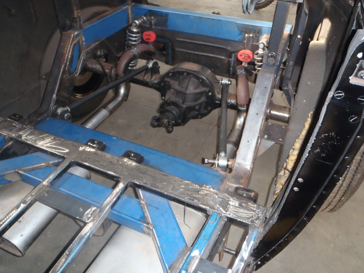

  17. grdra1
    Posts: 680
    grdra1

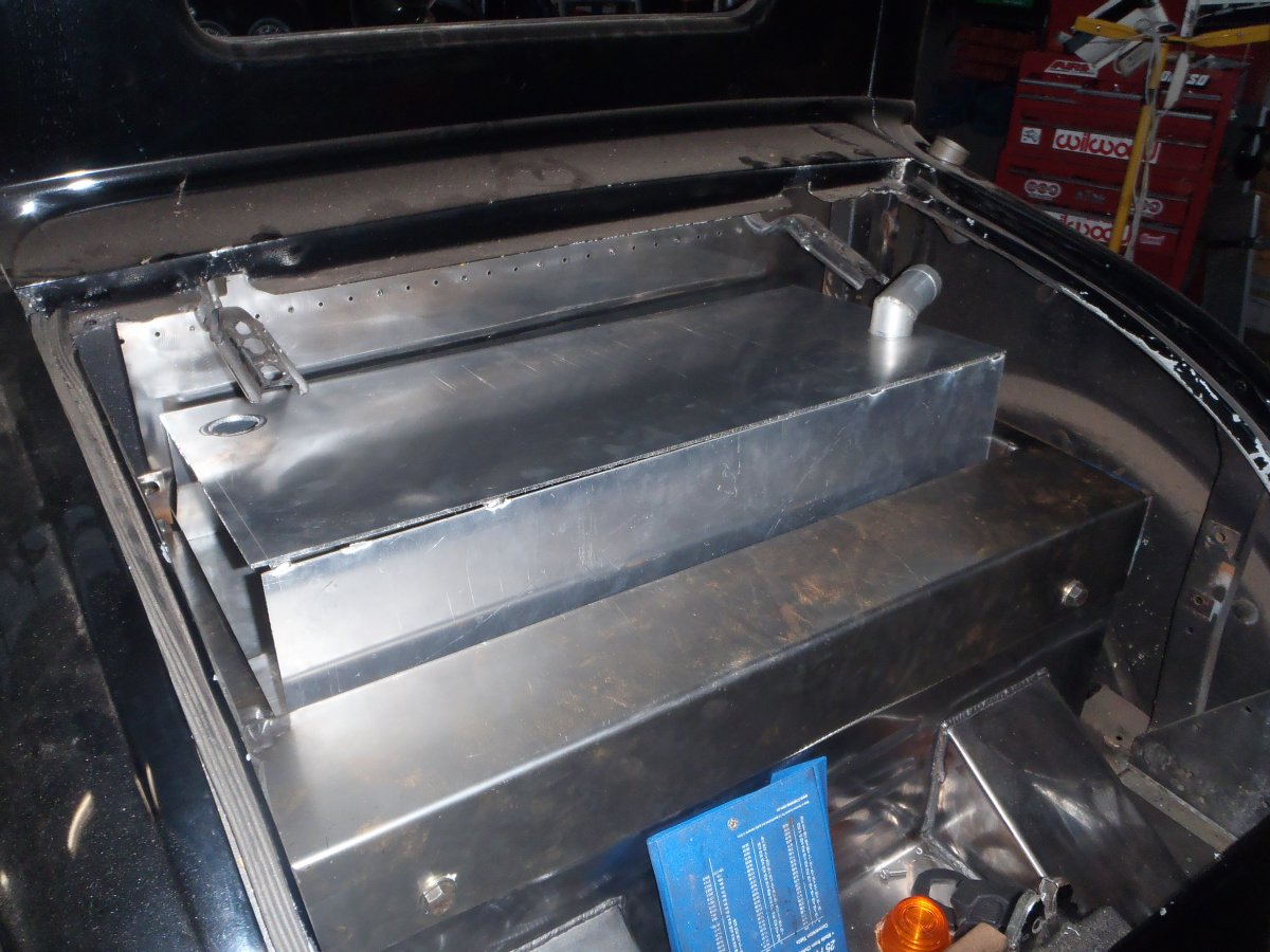

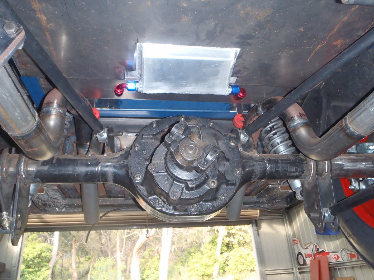

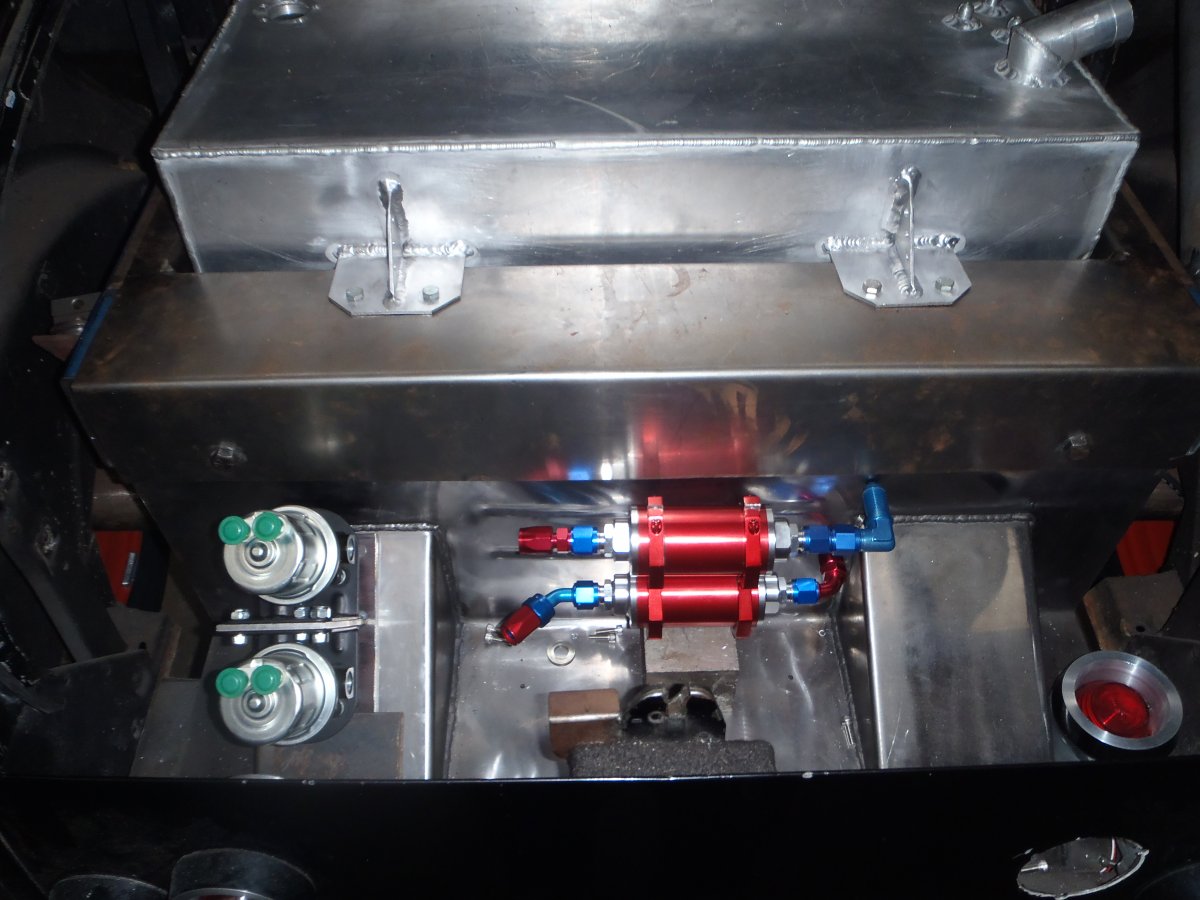

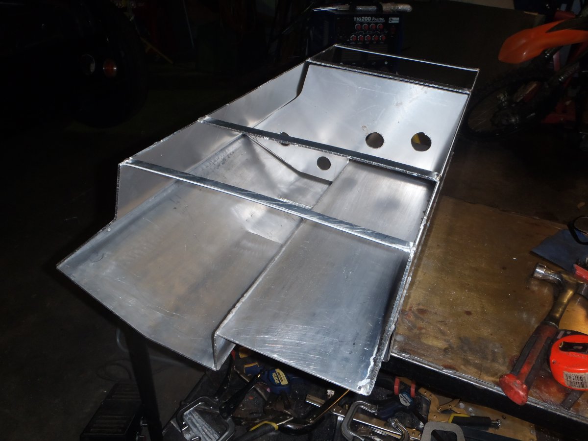

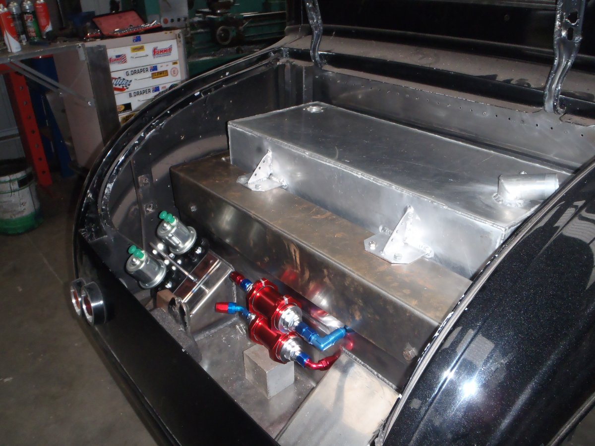

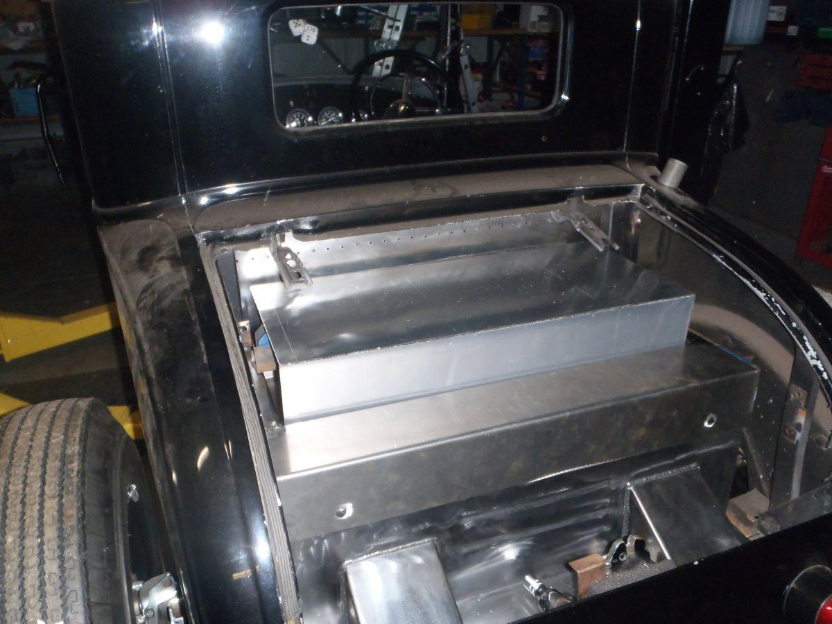

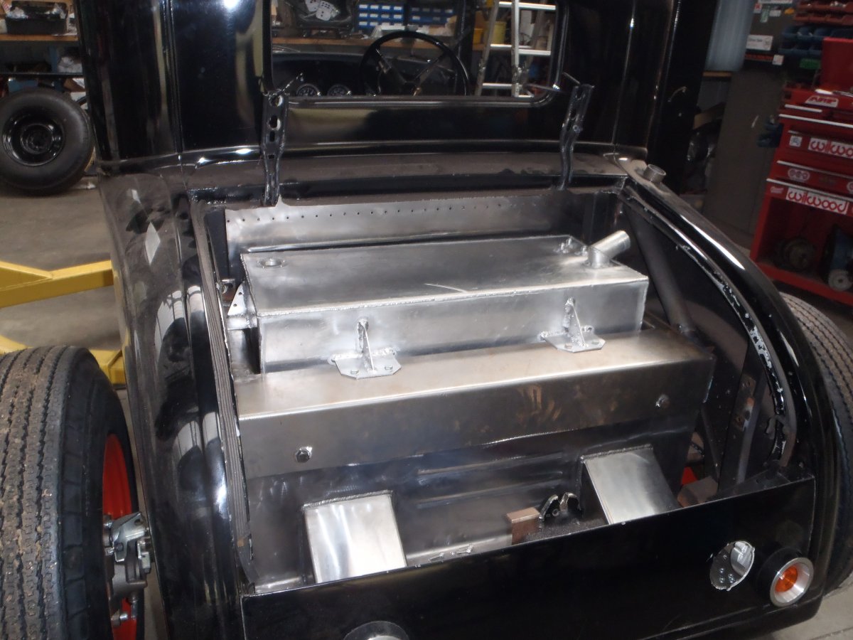

    Tank finished, had to change outlet section for better clearance around diff center, just needs testing and sanding /polishing. Next step is to mount filters, pumps and lines - I will be using 2 x carter electric pumps, one for the nitrous kit I plan to install later on. There will be 2 supply and 2 return lines, stay tuned. Glen P1011158.JPG P1011160.JPG P1011163.JPG P1011165.JPG P1011167.JPG P1011170.JPG P1011171.JPG

    Interesting build up. I can't say I like the fake 409 valve covers. Reminds me of the fake blowers with carbs hidden inside and the fake quick change rear ends etc.
    Another one that comes to mind is Rocket valve covers on a SBC to try to make someone think you have a cool vintage engine. Or Y block valve covers on a SBF.
    Fake is fake and is never cool.
  21. grdra1
    Posts: 680
    grdra1

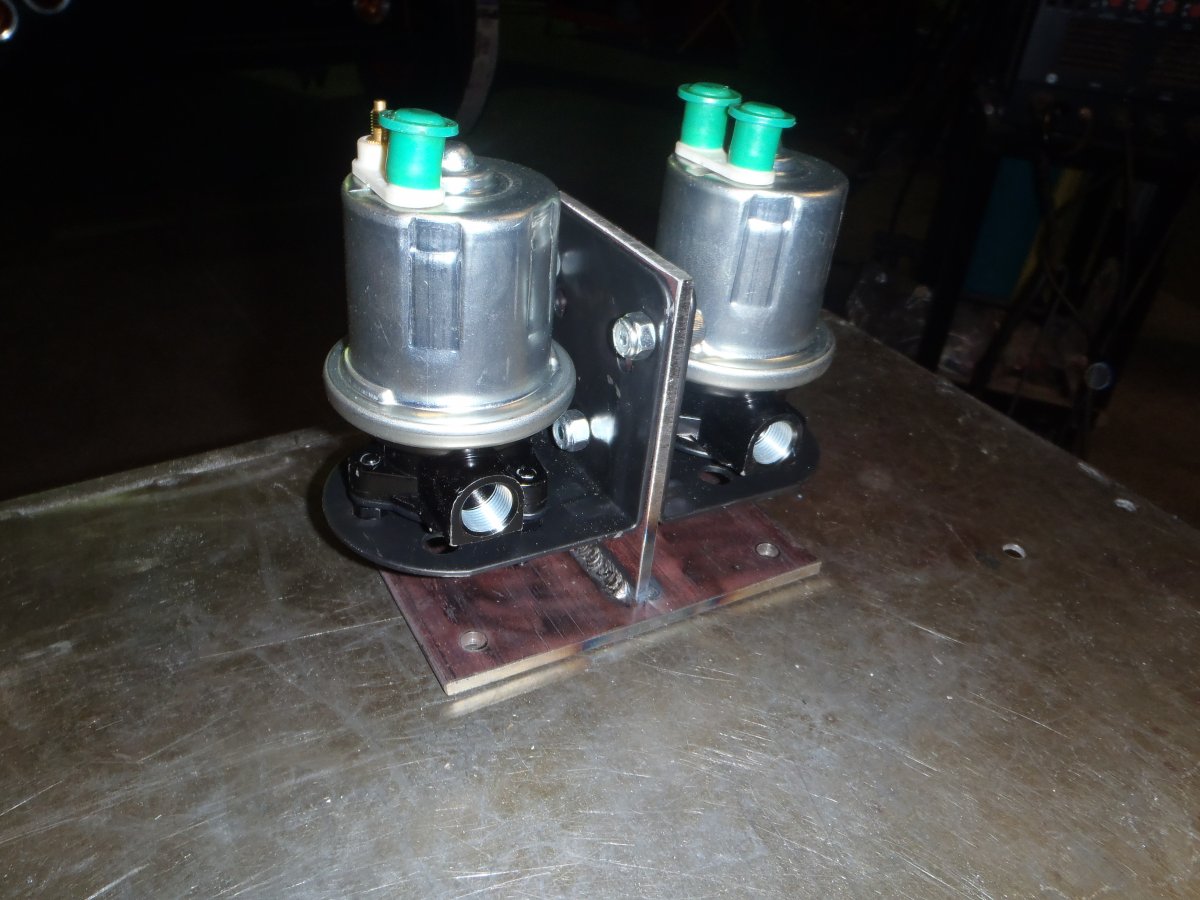

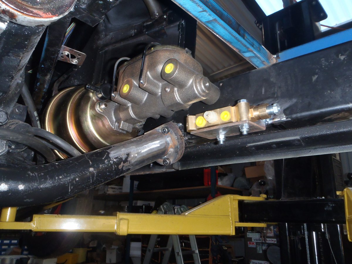

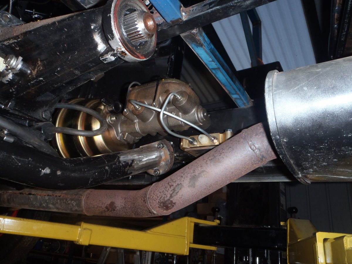

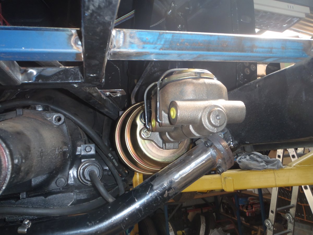

    I scored the 409 covers cheap and thought why not - I enjoy making stuff, it gives me another look for the car. I plan to run different grilles / wheels / exhaust at times to change things up a bit. I think if fake is done tastefully it can be cool but thats just me. Anyway a few pics of recent progress, started playing around with pump and filter mounts / placement, also mounted brake booster and modified brake pedal, check out pics. Glen P1011175.JPG P1011177.JPG P1011178.JPG P1011179.JPG P1011184.JPG P1011181.JPG P1011185.JPG P1011187.JPG P1011188.JPG

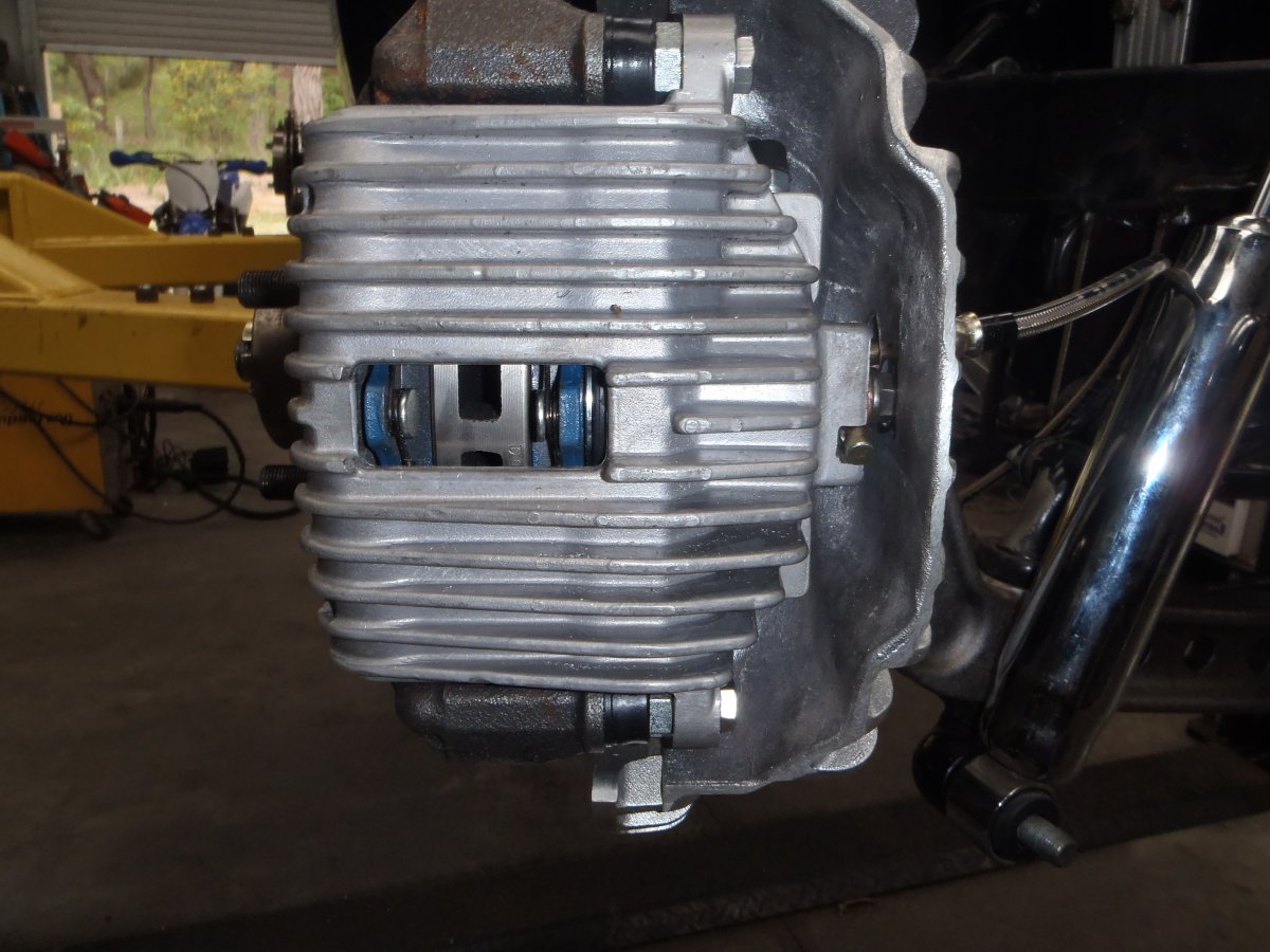

    Mounted proportional valve and started making brake lines, also had front brake lines ( braided ) made by local brake guy. A few pics. Glen P1011194.JPG P1011196.JPG P1011197.JPG P1011194.JPG P1011196.JPG P1011197.JPG

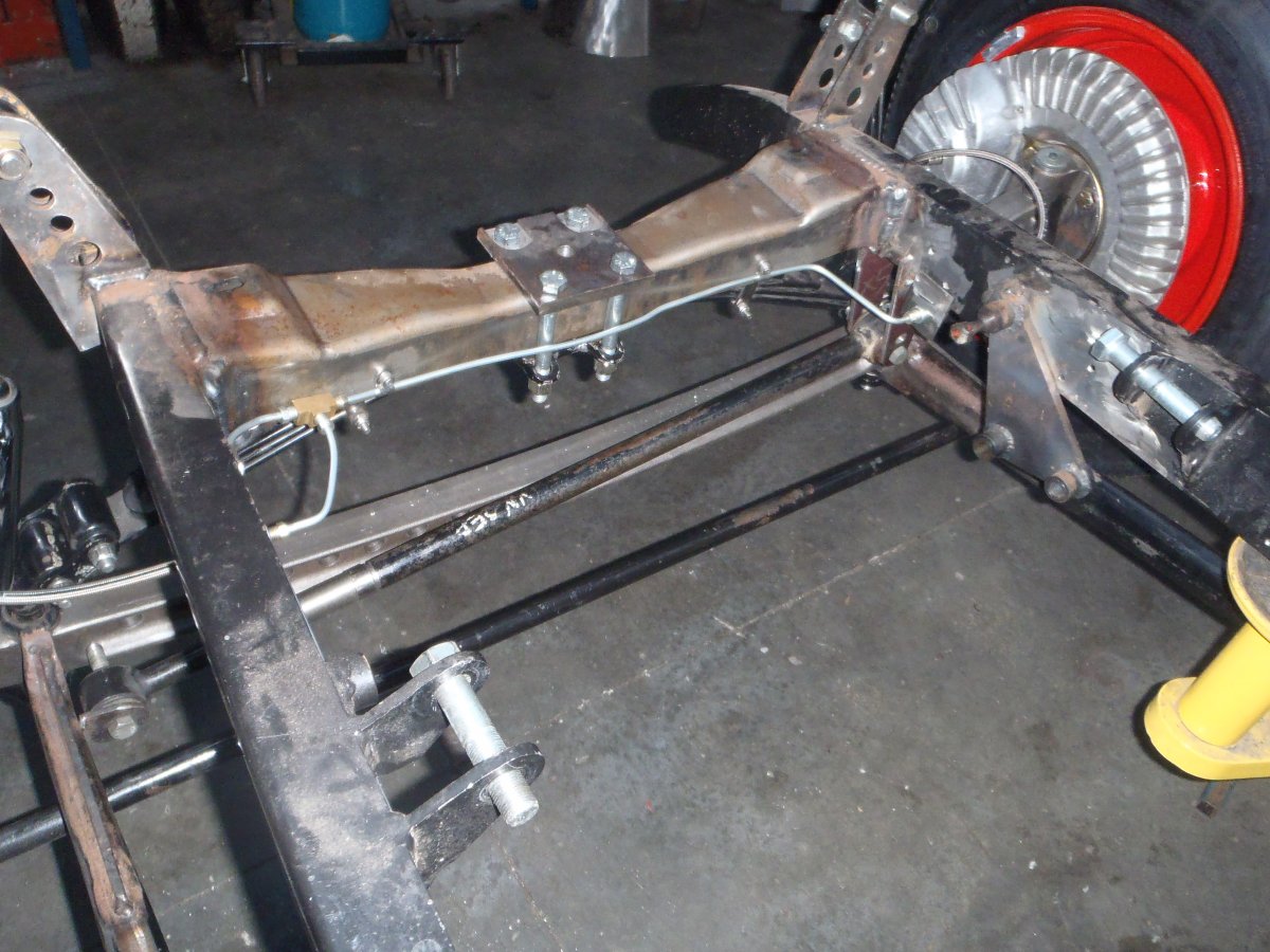

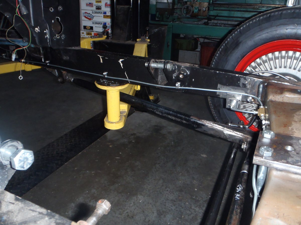

    Mounted front disc brake lines and started fabricating rear brake lines, also had to remount exhaust as to close to ch***is rails. Glen P1011199.JPG P1011200.JPG P1011202.JPG P1011203.JPG P1011204.JPG P1011205.JPG P1011206.JPG P1011207.JPG

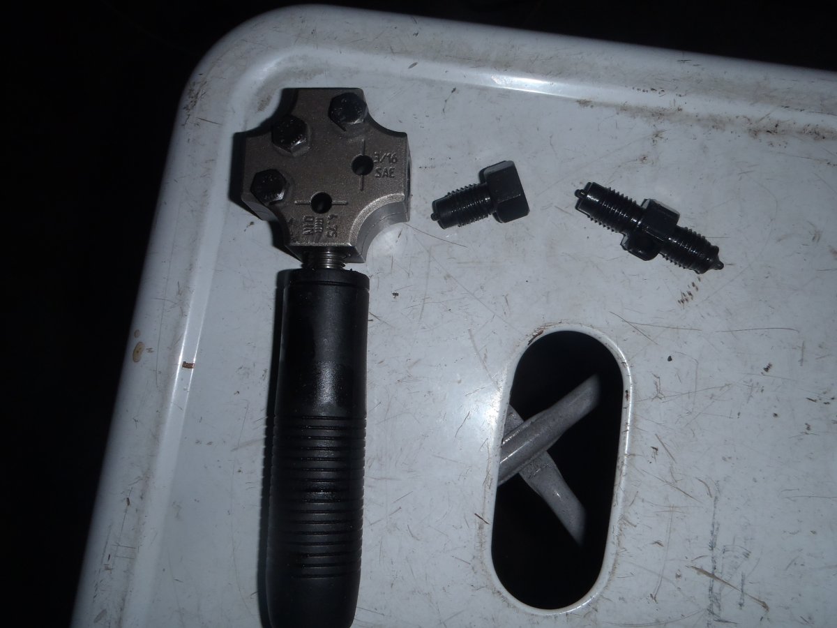

    Finished brake lines for now, brought a cool flare tool - perfect flares every time. I will do some firewall mods tomorrow - I plan to make recess a little deeper, fill LHD coloum hole and move RHD coloum hole a little, pics to follow. Glen P1011224.JPG P1011210.JPG P1011213.JPG P1011214.JPG P1011226.JPG P1011227.JPG P1011228.JPG P1011222.JPG

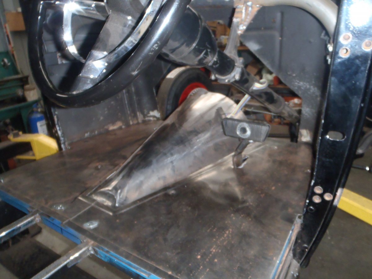

  25. grdra1
    Posts: 680
    grdra1

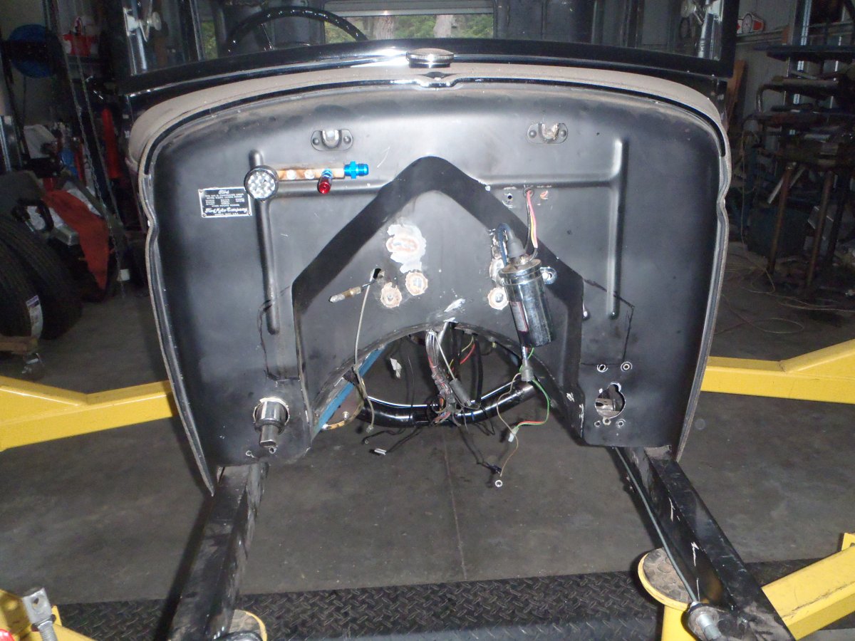

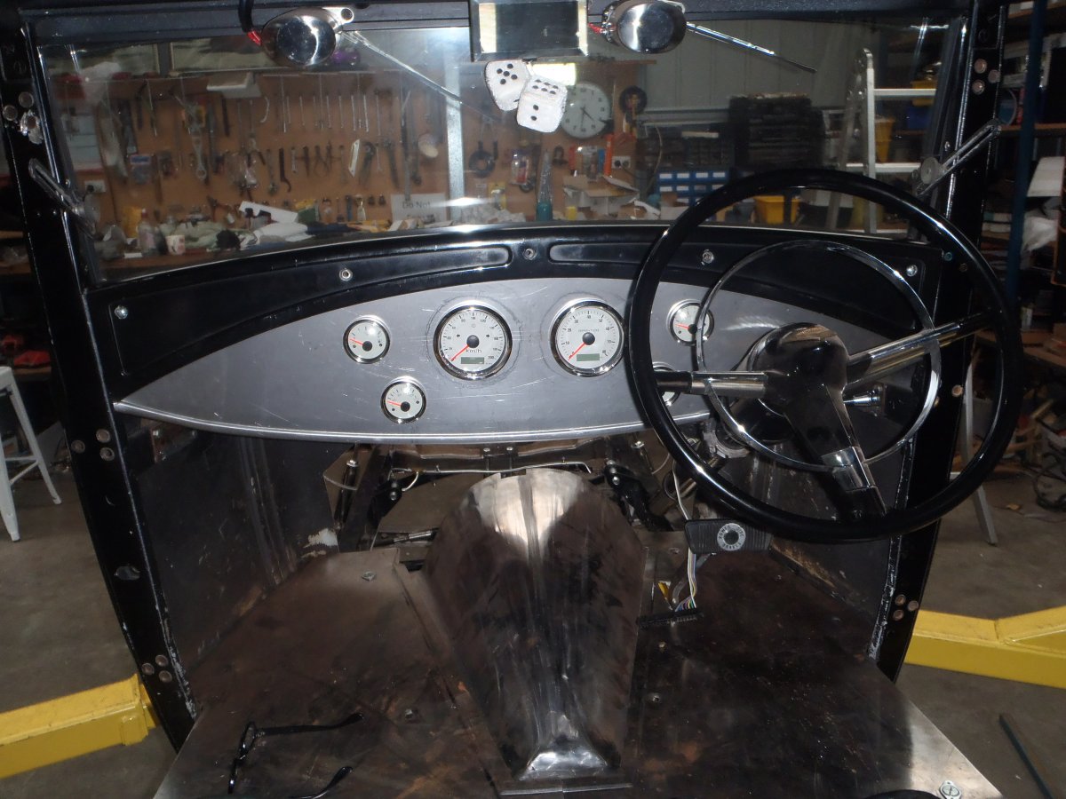

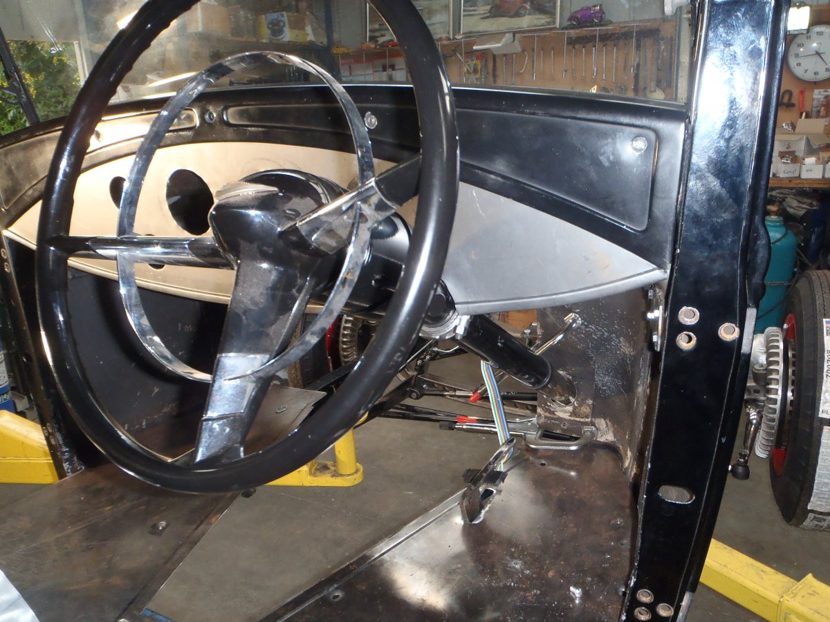

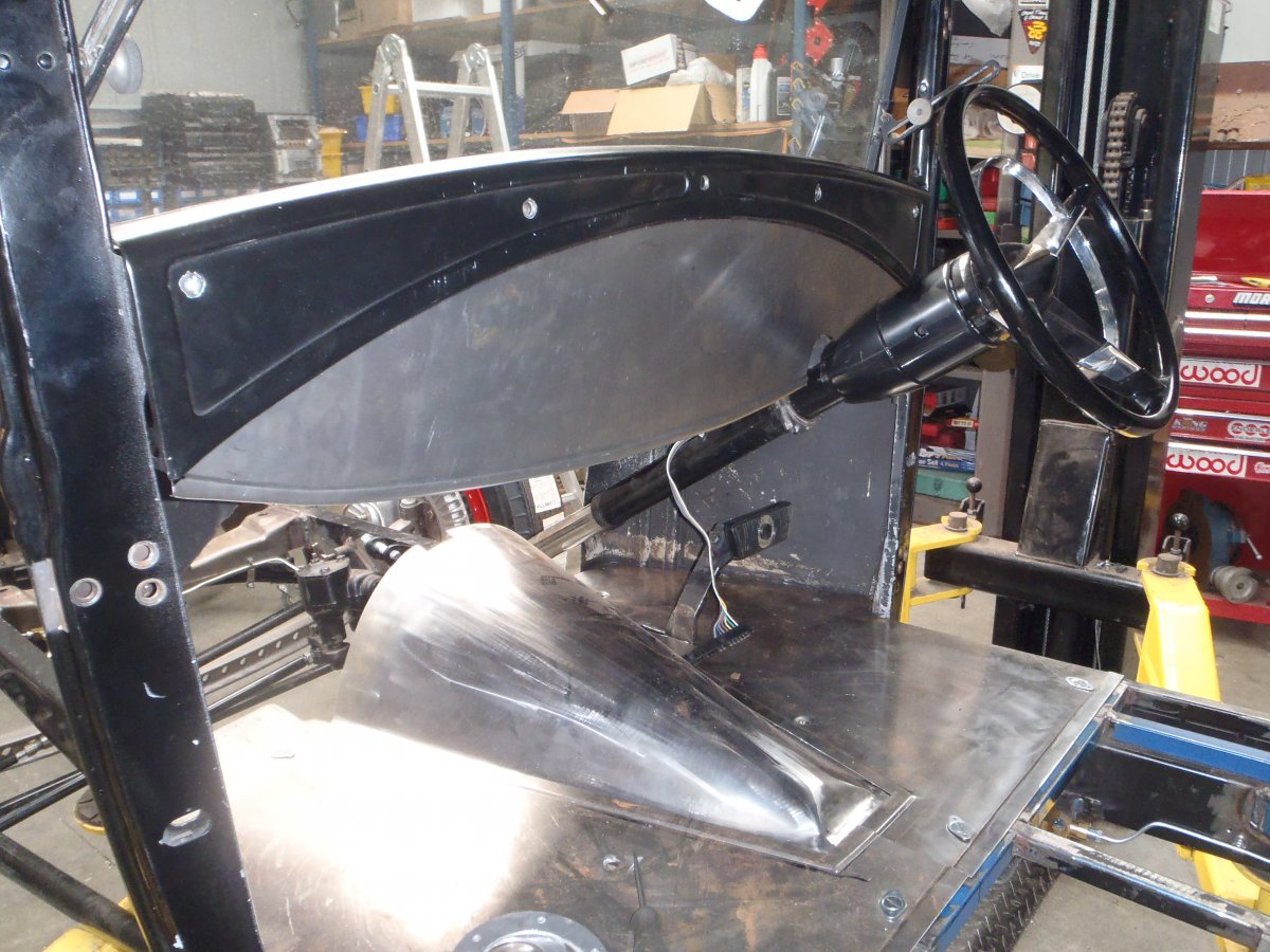

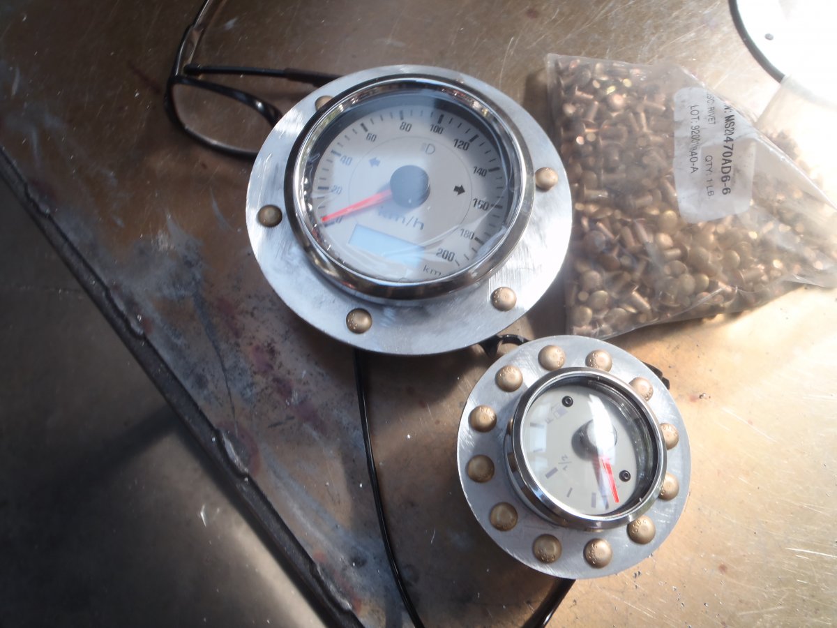

    A few pics of todays progress, cut firewall, plan is to move steering coloum a little for more brake pedal clearance and install coloum break away mount required for engineer report, also needed more clearance for 409 rocker covers on left and right side. Removed all wiring and will install a new 12 circuit kit as well as new gauges, I have an awesome easy to follow auto wiring book as my guide. I will fabricate a new dash panel as well and probably mount battery under dash on some sort of adjustable mount - not sure of design yet. Glen P1011242.JPG P1011244.JPG P1011248.JPG P1011247.JPG P1011236.JPG P1011245.JPG P1011246.JPG

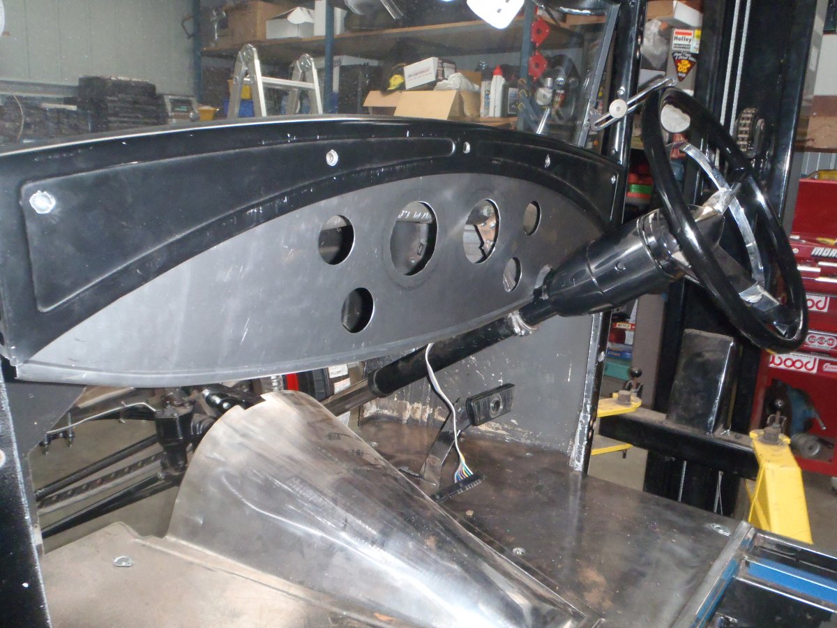

  26. grdra1
    Posts: 680
    grdra1

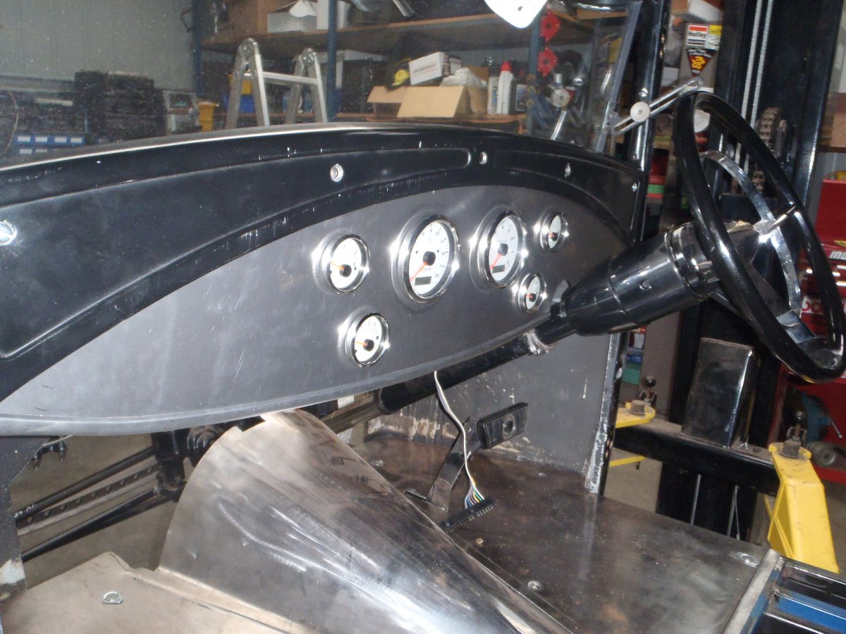

    Fabricated new dash today, unsure of final layout and type of switches to use but happy with result so far, check out pics. Glen P1011249.JPG P1011254.JPG P1011256.JPG P1011251.JPG P1011250.JPG P1011257.JPG P1011258.JPG P1011261.JPG P1011262.JPG
    Stogy, Vic Walter, catdad49 and 5 others like this.
  27. loudbang
    Posts: 40,346
    I like them without the surrounds. :)
    1947knuck and brady1929 like this.
  28. grdra1
    Posts: 680
    grdra1
    I like both formats but I feel without the surrounds the gauges are to far apart, Im unsure at present which way to go, I may paint surrounds the same colour as the dash. I will wait until I have the switches and then decide, I could always make another dash panel and have two - it would only take another day. Glen

  29. grdra1
    Posts: 680
    grdra1

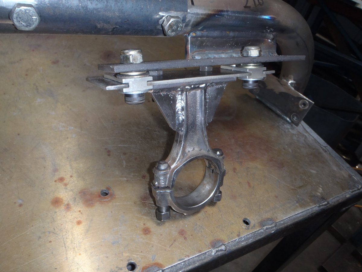

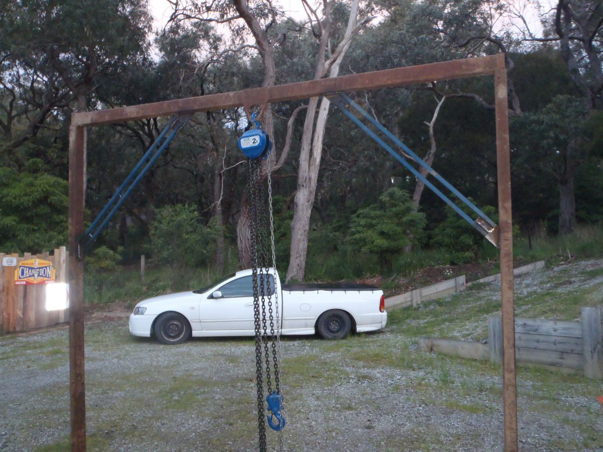

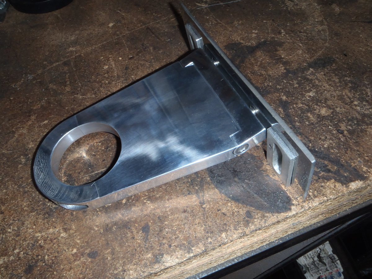

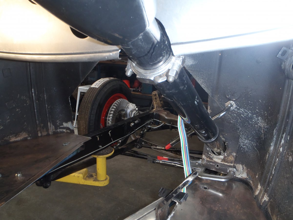

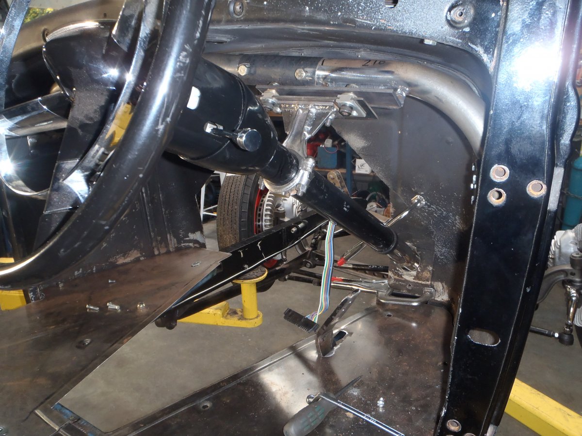

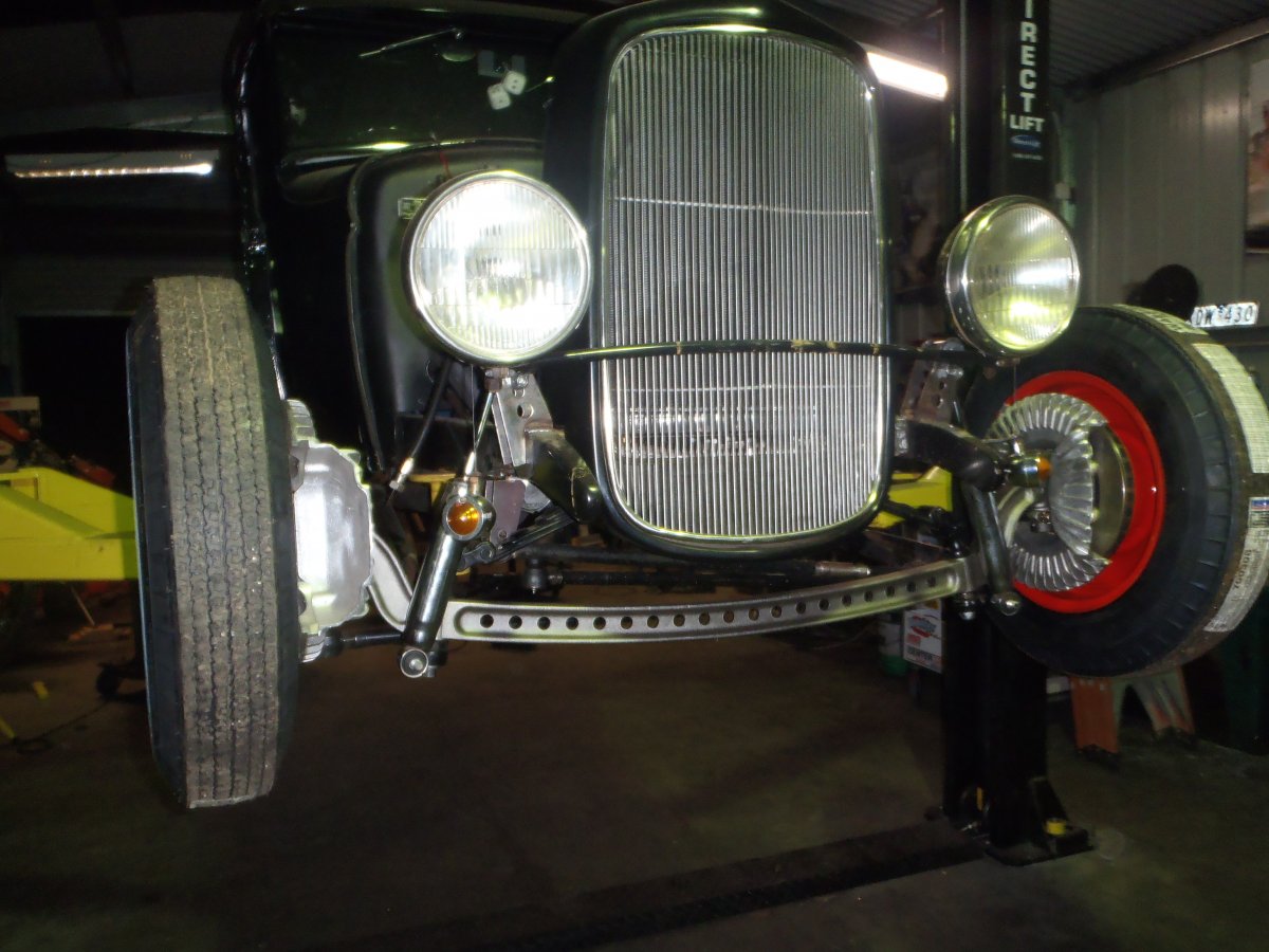

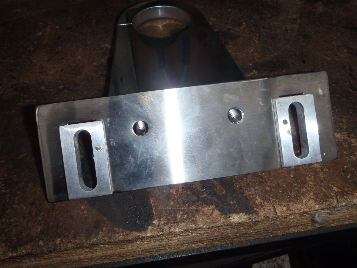

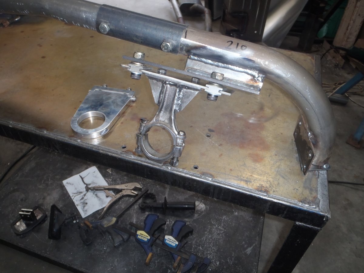

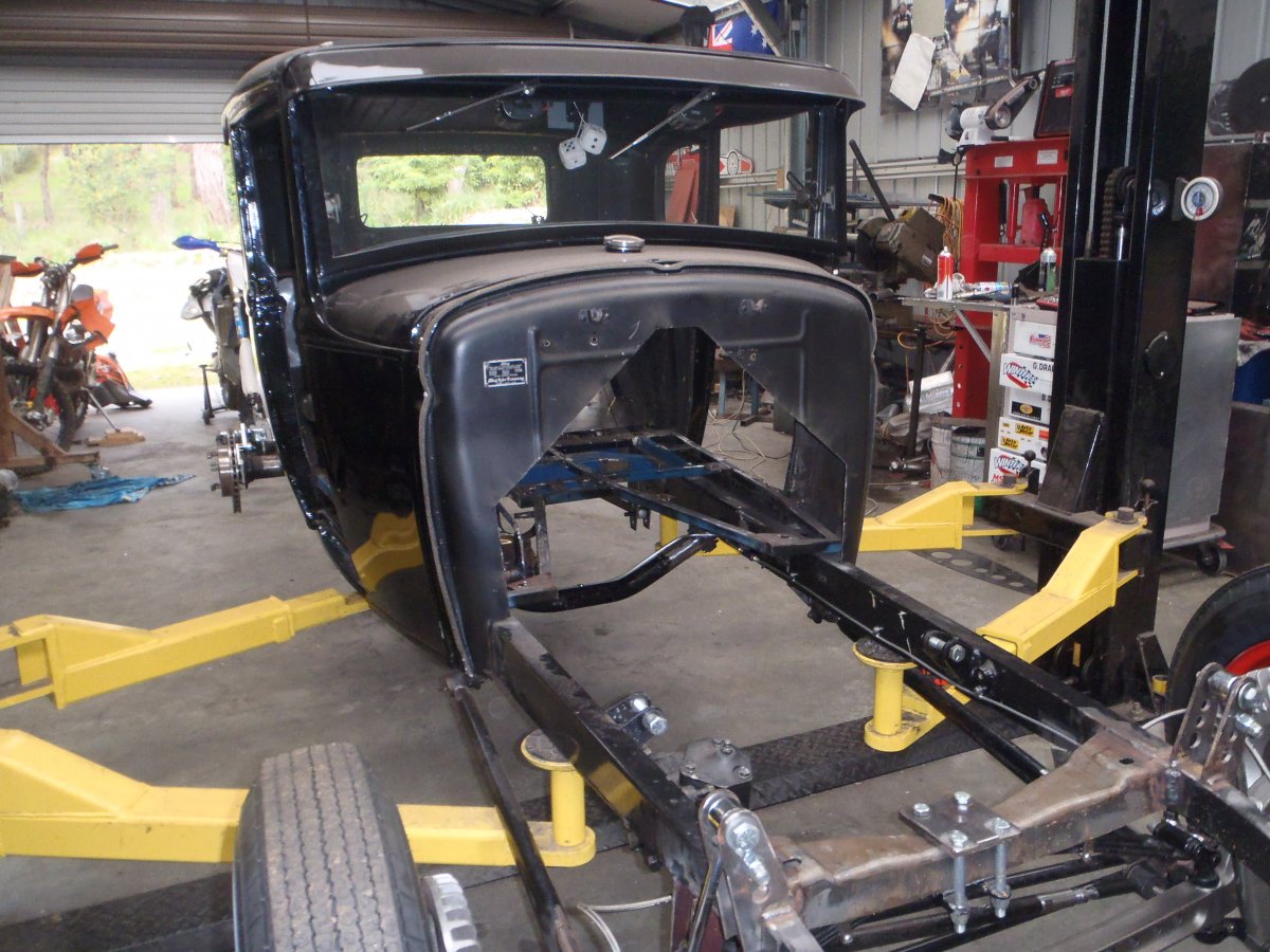

    A few pics of today's progress, mounted breakaway on coloum, pics show billet mount that came with breakaway but I decided to use the old conrod that was previously on car, also braced my mobile hoist as for the last 35 years it was hard to push around by myself (had a mind of its own), now its awesome. Glen P1011285.JPG P1011286.JPG P1011289.JPG P1011291.JPG P1011292.JPG P1011294.JPG P1011296.JPG P1011297.JPG

    Great build, love the fuel tank, any idea how many gallons it will hold?
