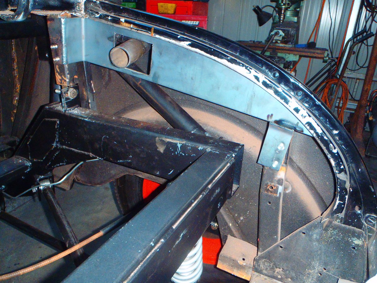

    Guards all done now, not perfect but happy with result as it was my first attempt ( I was going to have some made for me - but glad I gave it a go ). Recently put engine back together with new gaskets, today I will install engine and box for the final time, a few pics. Glen P1010589.JPG P1010593.JPG P1010595.JPG

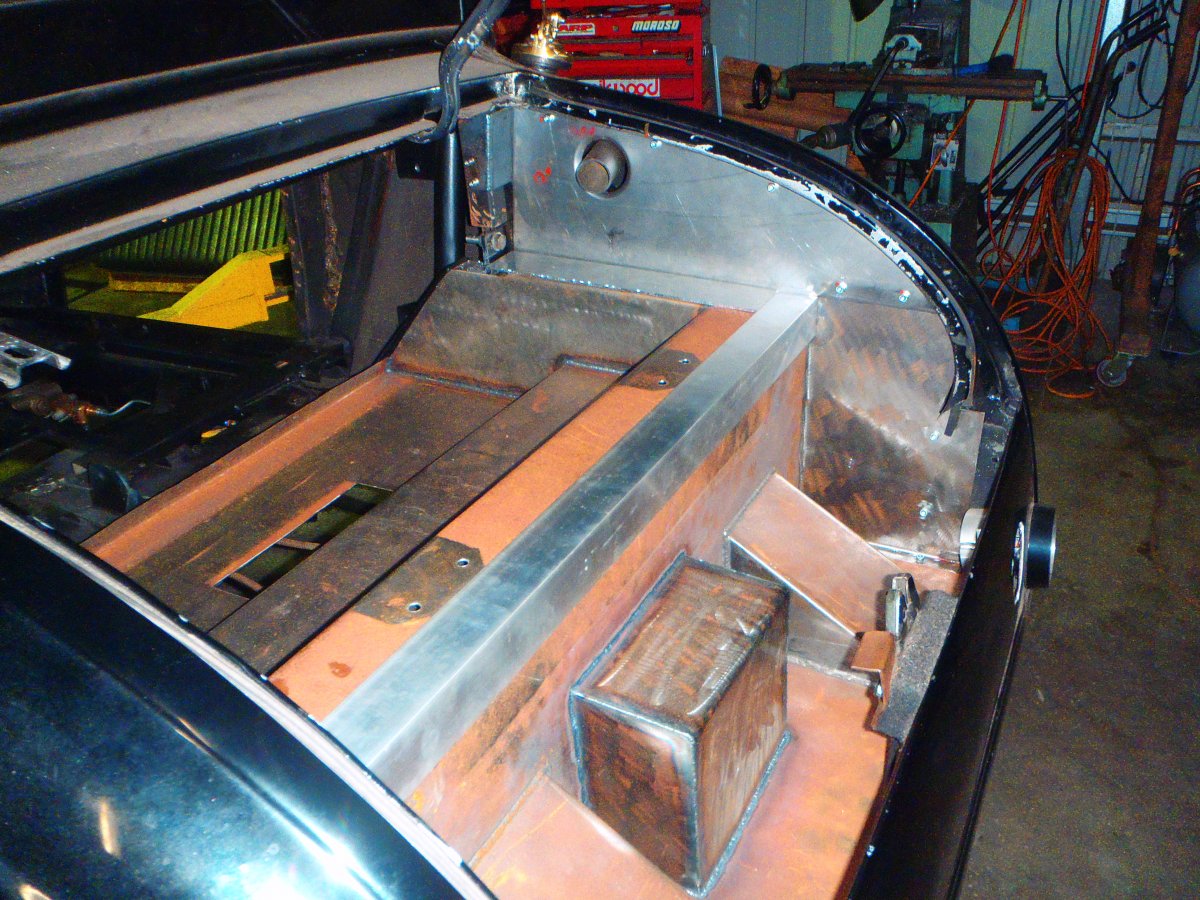

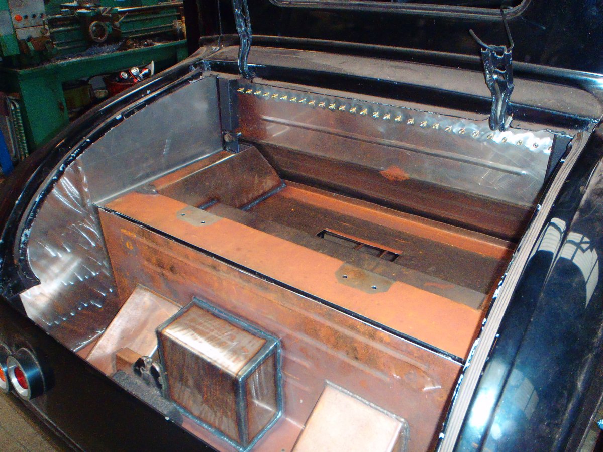

    Been working on trunk ( boot in Aus ) area lately including fuel filler tube, nearly there, also built a power rack as local gym closed - unable to use yet as I tore a rotator cuff by falling off my KTM 300 stupidly, a few pics. Glen P1010603.JPG P1010610.JPG P1010606.JPG P1010613.JPG P1010618.JPG P1010619.JPG

    Thanks Joe, I am happy with what I have done over the past 6 weeks, I have now finished and painted the trunk sheet metal panels. Just waiting for fuel tank to be tested and certified before I can ***emble for the final time. Now working on finishing the cabin area including dash and painting seats etc. Glen

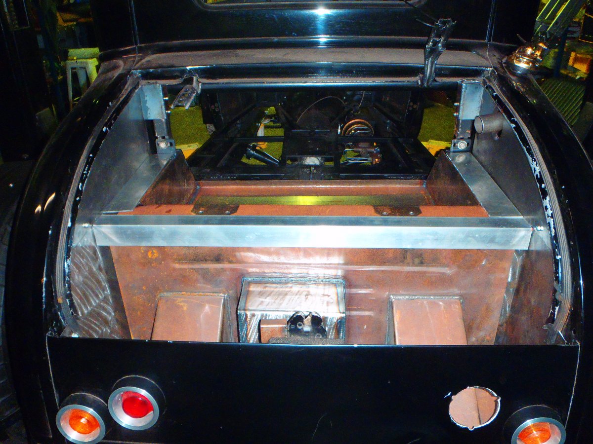

    Trunk area finished now, tank certified and holds 68 litres ( approx 18 gallons ), sanded and clear coated seats, installed roll cage and now working on cabin area. Also needed to add bar to ch***is under engine for registration. A few pics, Glen P1010638.JPG P1010636.JPG P1010635.JPG P1010639.JPG P1010632.JPG P1010629.JPG

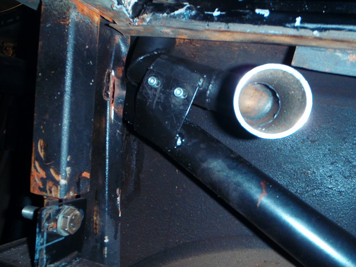

    A few pics of recent progress, modified alternator bracket as to close to frame, fabricated shroud for fan belt, modified and mounted headlight bar, remade rear exhaust pipes as they were hitting new top four link bars, mounted fuel pump and filter and mounted fuse panel and relays. Glen 64.JPG 65.JPG 63.JPG 75.JPG 79.JPG 80.JPG 77.JPG

    wud u mind either sending me pics or posting pics of how the rear fenders are attached...im thinkin about doing that myself

    BigMo if you look back in this thread ( end of page 8 ) you will see how they were done, and Loadbang I agree with you, I like the blackwalls better myself. Glen

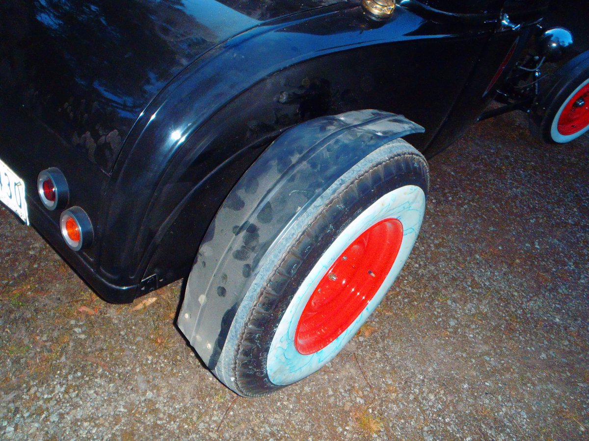

    Took car out for first road test today, my son got to drive car for the first time ( before me ) following build. Brakes initially soft but became better as they bedded in. Car performed awesome except for a small mishap, right rear tyre grabbed guard and bent it a little - probably repairable. At least I learnt that guards need to be approx 1/4 inch above tyre - not 1/8 inch. Damaged happened after hard acceleration test, happy with test and will repair guard tomorrow - I am so glad that my $650.00 rear trye was not rendered useless or the body damaged. Glen 213.JPG 212.JPG 214.JPG 219.JPG 215.JPG 216.JPG 217.JPG 218.JPG

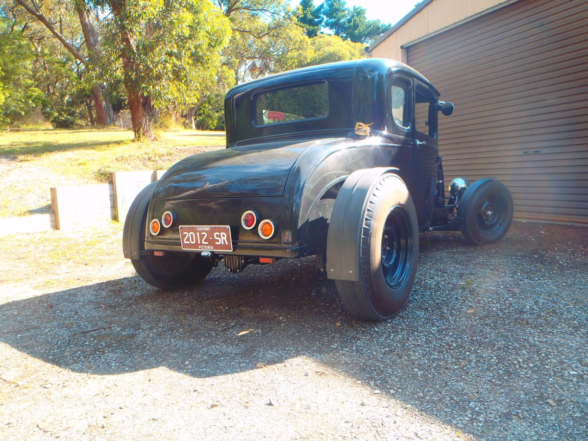

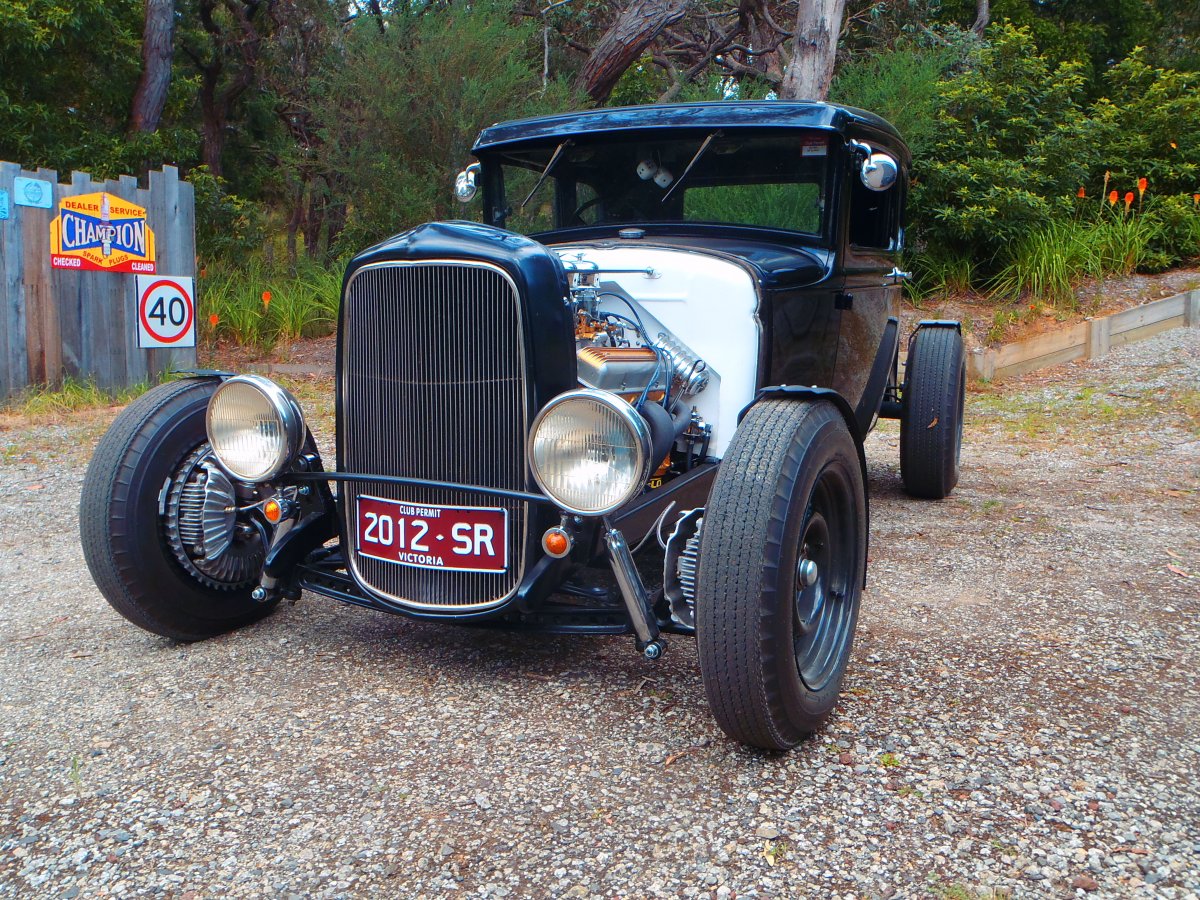

    Thanks Kirky I recently took car to engineer and p***ed the inspection with only minor issues - bump stops on rear shocks and heat shield between exhaust and booster / master cylinder. Then had it inspected by ASRF official and now car is registered on Street Rod club rego. I still have lots that I want to do with this car but at least I can now use it this summer. Glen 264.JPG 270.JPG

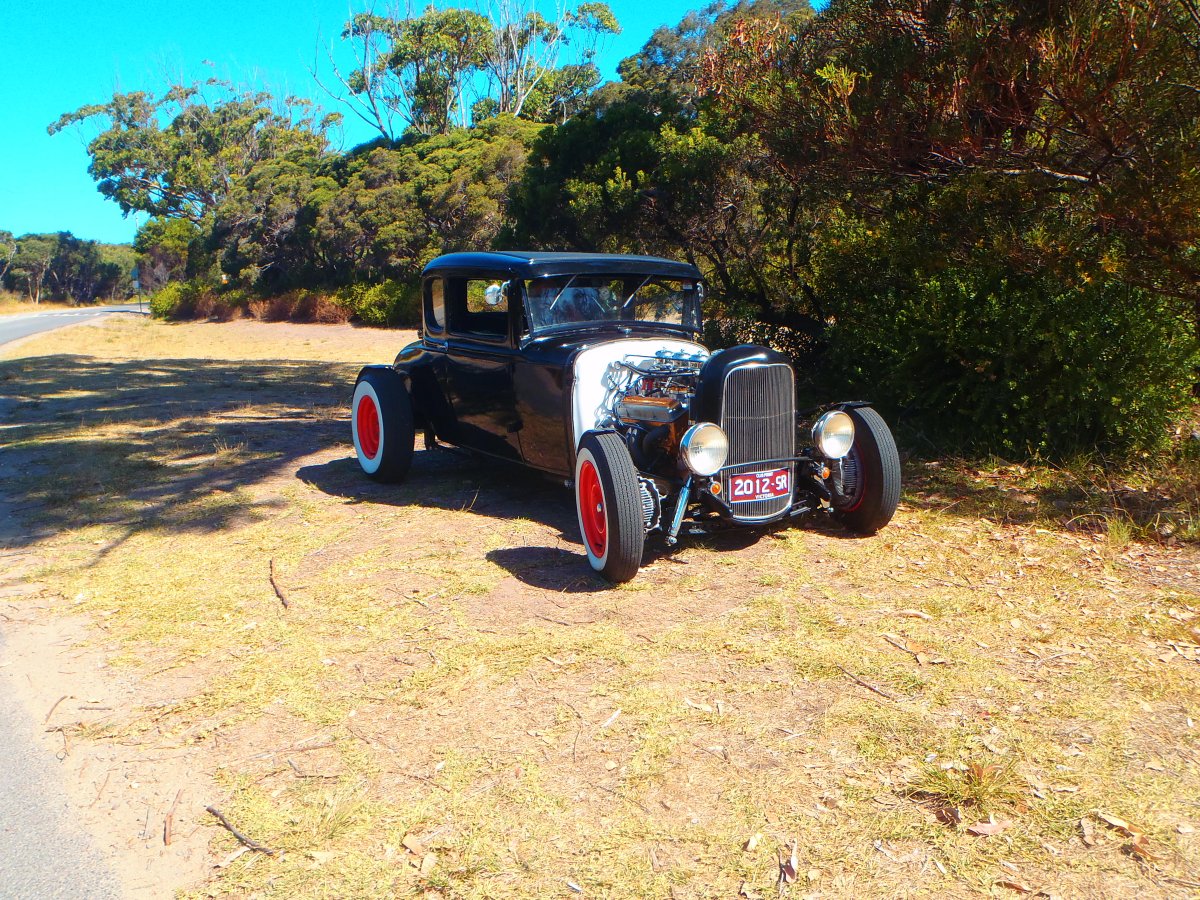

  30. grdra1
    Joined: May 20, 2013
    Posts: 680
    grdra1
    Thanks guys, Im pretty happy with my new year so far, just hope its a better year for all of us than 2020. Been sorting out a few issues lately, a front end wobble at certain speeds, I thought my tailshaft was not aligned properly, after lots of tailshaft / four link adjustments - turned out to be my front rims, the black ones. The red rims are now back on and the car drives nicely. Also have an anoying oil leak from 2 piece timing cover - I have purchased a new performance camshaft from Summit racing K1103 and when cam arrives I will fix leak by puttting stock timing cover back on. The turbo 350 has an anoying clunk sometimes when at slow speeds with no load on it but performs excellent otherwise - will rebuild box at a later date and can live with it for now. Went for my first long drive yesterday approx 120 miles on a beutiful sunny day with my wife, car performed awesome and was fun to drive, noisy and raw but fast when you put your foot down - cannot wait for the new camshaft. Cheers Glen 271.JPG 273.JPG 274.JPG
