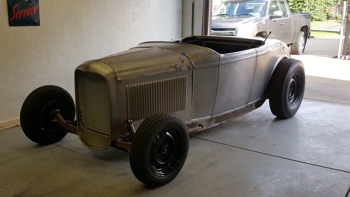

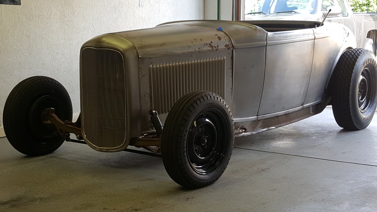

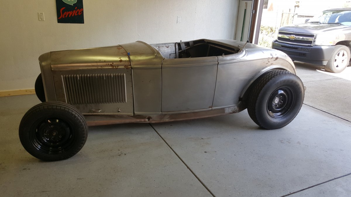

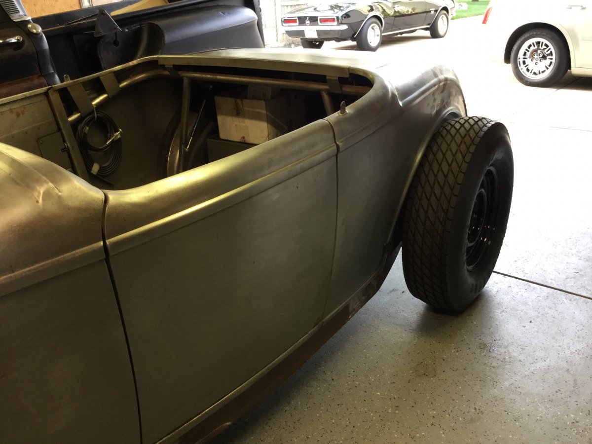

    Well, I drove from Detroit to just north of Chicago and back this past Saturday. I picked up my new deuce roadster project. We pop steel body and rails, most of the hard work already done. Front rails pinched and Bobbed,Frame softly swept up and C notched At the rear. Beautiful turn the work in the floor and trunk area. The guy knew what he was doing, but the project stalled. That’s good for me. My plans are for a traditional build. Most likely mid to late 50s style. 283, multiple carbs, Cowl steering etc. i’m going to separate the body from the frame this weekend and take stock of what I need. Probably get started on it after I get back from Hershey, with a **** load of Parts.

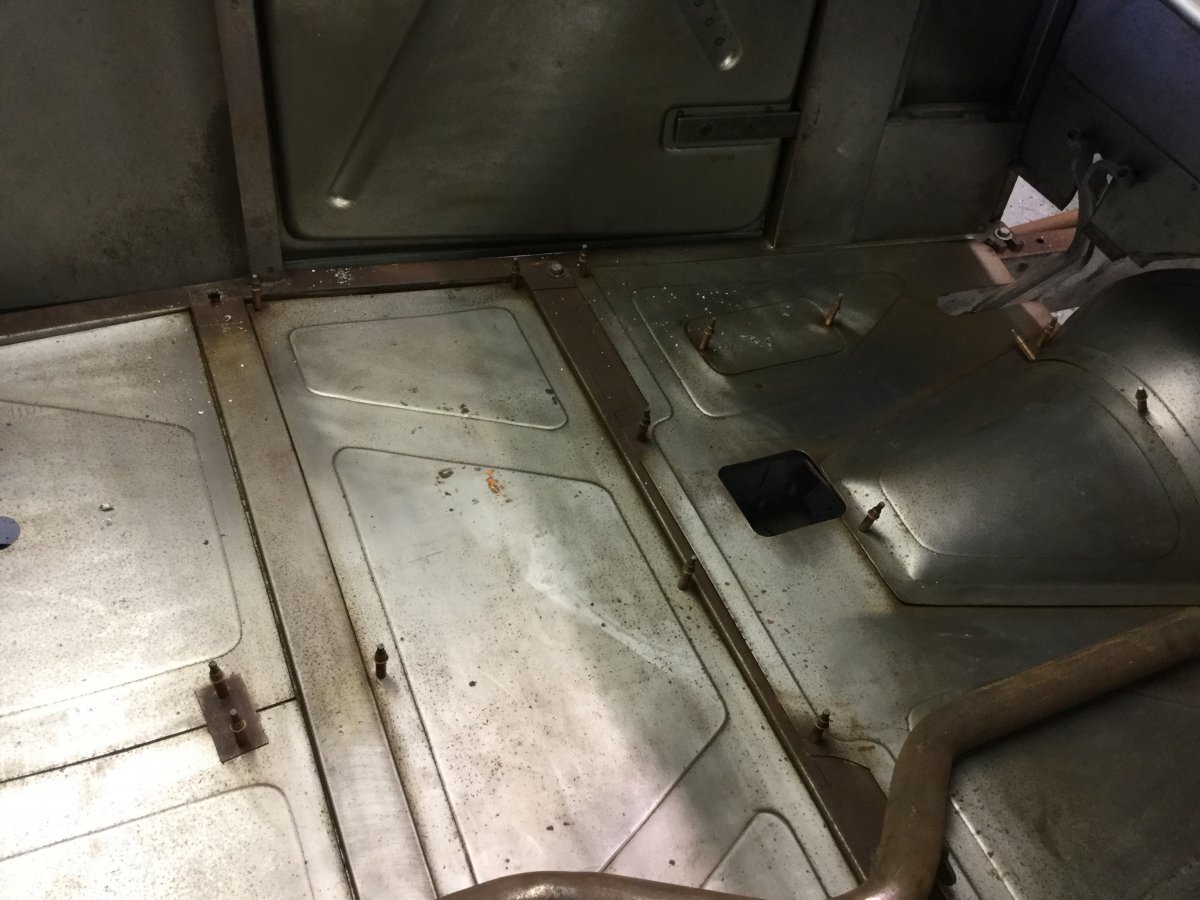

    Nice fab on the floor.

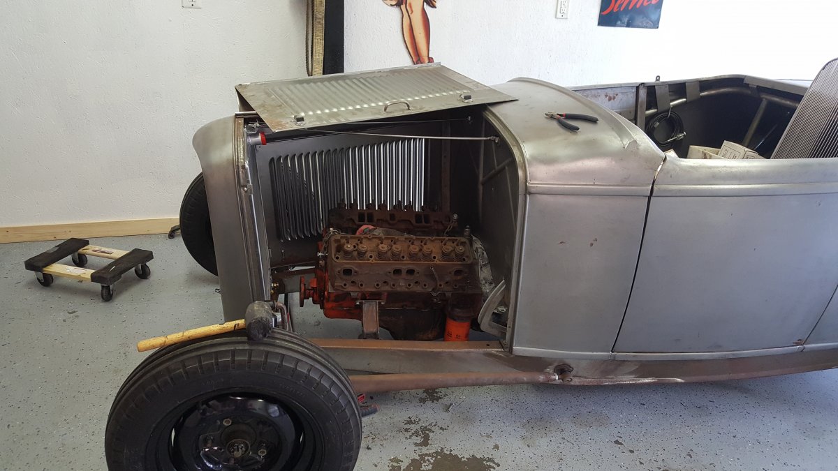

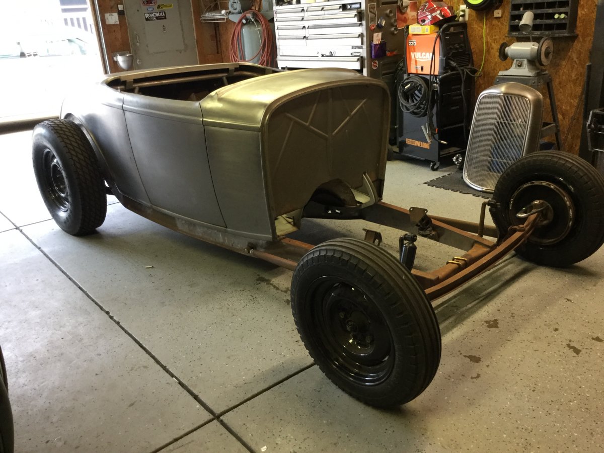

    Working on mock up, motor and trans, radiator mounts etc. Looks good. Pulling body this afternoon.

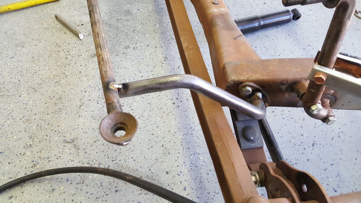

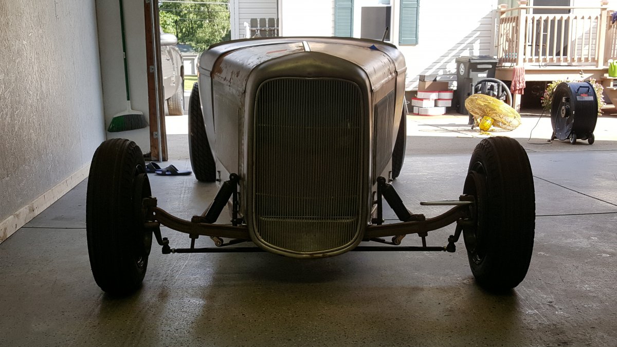

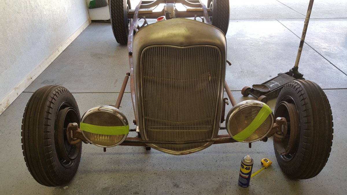

    Just finished building headlight bar. A few more things to find fitment, and ill tear down the frame

    Looks good- hard to tell from the photo but the light mounts look wider than normal and with those big headlights you may want to double check for tire clearance at full lock. Could just be the picture angle though....
  19. terry54999
    Joined: Nov 2, 2009
    Posts: 114
    terry54999
    from livonia mi
    After having looked at the picture I can see what you mean, I have good clearance though I think it's just the angle of the shot. Use the standard 28 model a headlight bar with a slight V. Gives me pretty good clearance at full turn.
  20. x77matt
    Joined: Mar 2, 2004
    Posts: 832
    x77matt
    Awesome. I like the shape of the bar as you took it over the front end. Turned out really clean.

    Thanks, I had built another, much more work, shapes, curves etc. After looking at it, I would call it a little too elegant. So I s****ped it and started again. I need to keep in mind function first and some form as an afterthought. At least in some applications. I have followed some of your roadster build, Very nice. I look forward to seeing it in person. Sadly, I have a repop steel body, raised wheel arches and some mods, but nothing near the repairs you have had to do. its nice to see henrys steel brought back to life.

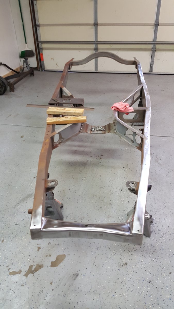

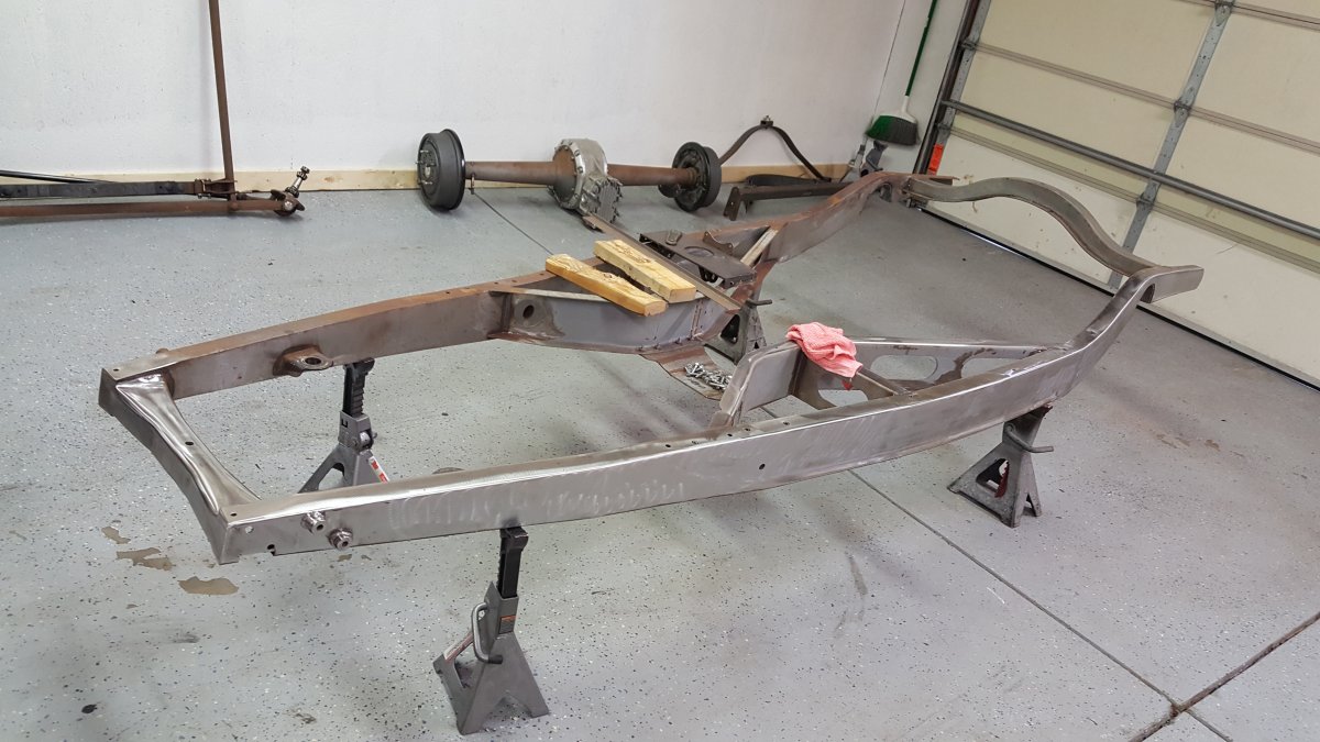

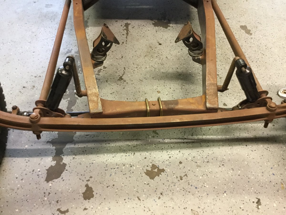

    Finishing up welding and metal finishing on frame. Making progress 20180909_123921.jpg

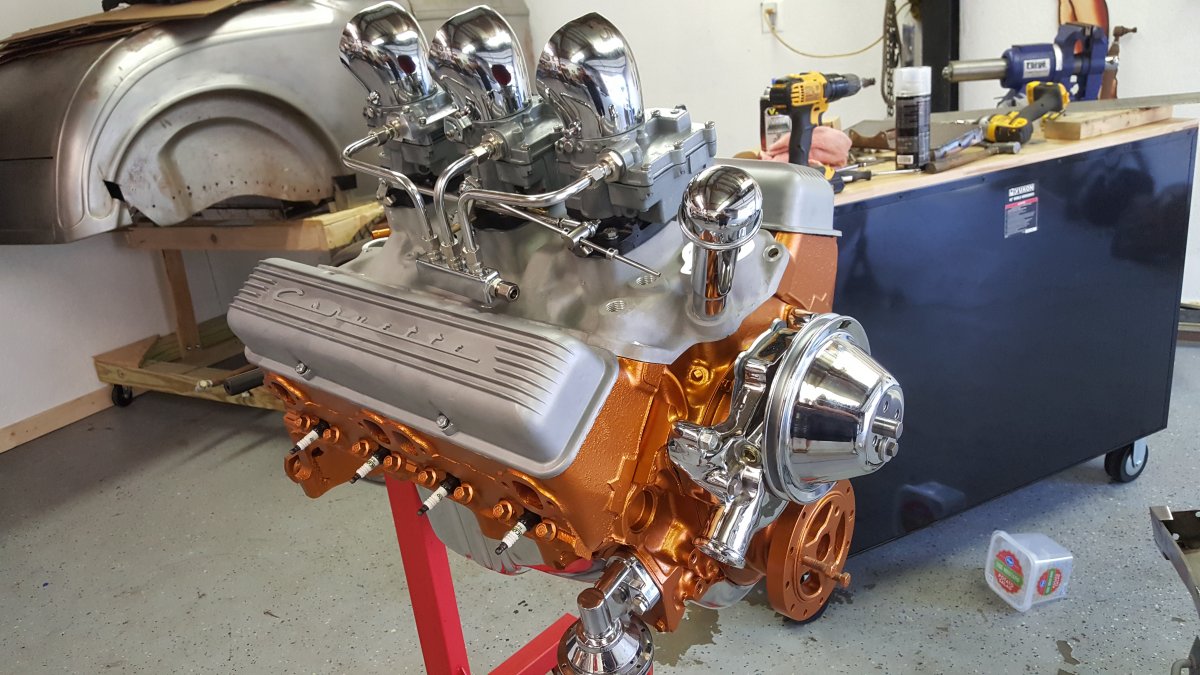

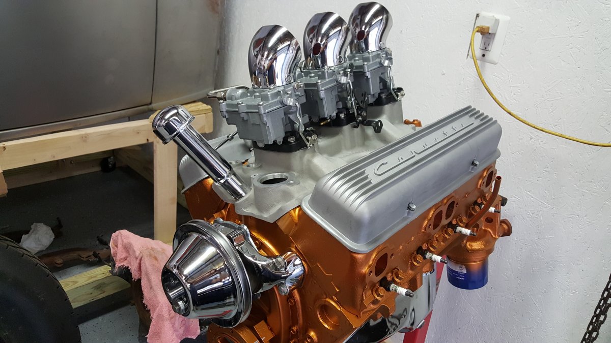

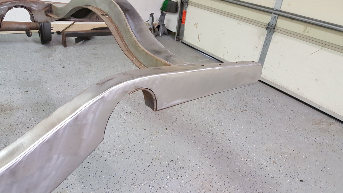

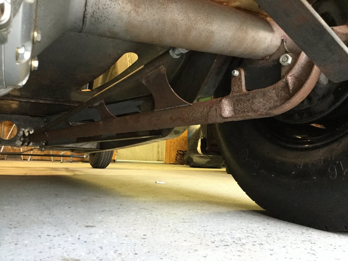

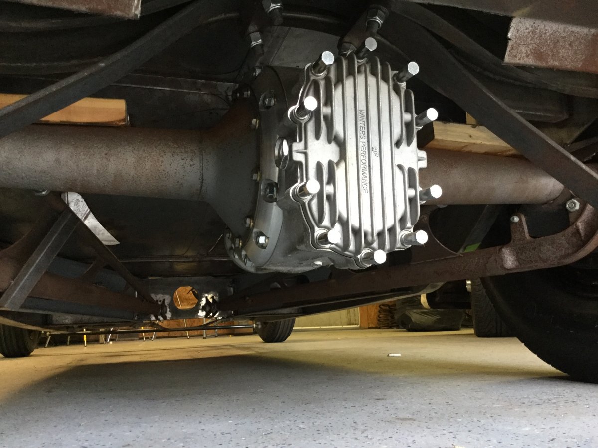

    Is there any internal bracing inside the frame above those C notches? Basically you have turned your frame rail into a 2x1, which is not good. Especially since you have all the weight of the back half of the car BEHIND that notch.
  26. terry54999
    Joined: Nov 2, 2009
    Posts: 114
    terry54999
    from livonia mi
    Triple walled. added center support prior to finishing off boxing. I wouldn't want to drive it if it weren't.
