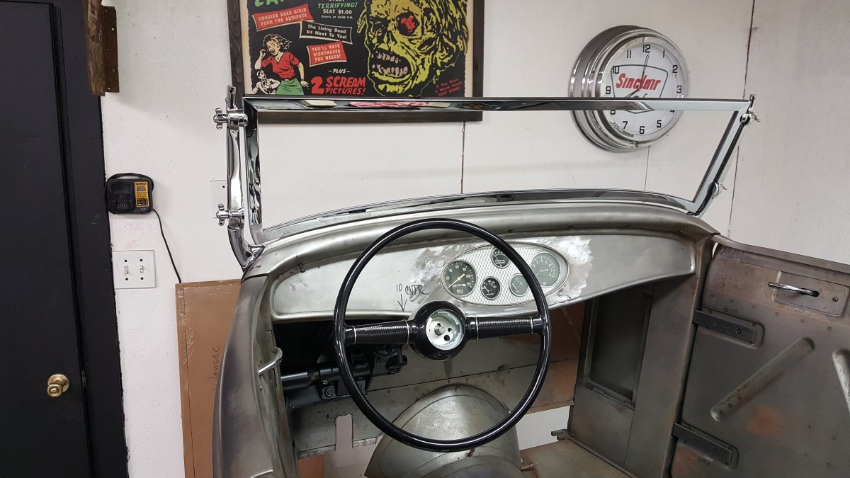

    Had to step away from the ch***is for a little bit, so I went ahead and mocked up my dash cluster. It started out as a box of miscellaneous parts that I bought at Hershey piece by piece. Late twenties Studebaker face bezel and gl***, with 60s style Stewart Warner's. Had to enlarge the two outside holes to accept the rings of the gauges, which come in from behind to give it a little cleaner look. The shape of the gauge bezel mimics the 32 however quite a bit larger. I'm on a budget, and I managed to put this together for just under $200. 20181023_181104.jpg 20181023_181104.jpg

  7. jmikee
    Joined: Mar 1, 2007
    Posts: 196
    jmikee
    from washington
    Very nice what does the back side look like?
  8. terry54999
    Joined: Nov 2, 2009
    Posts: 114
    terry54999
    from livonia mi
    there's a steel flat panel, I mounted the gauges to that and then placed the face over that, effectively sandwiching the gauges in place. Back Looks good enough that I'm not ashamed , and bad enough that I'm glad it won't be seen. LOL

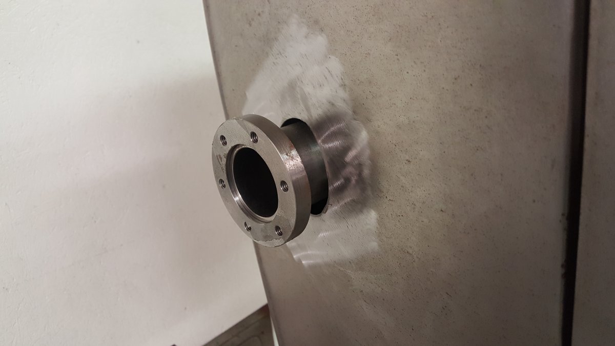

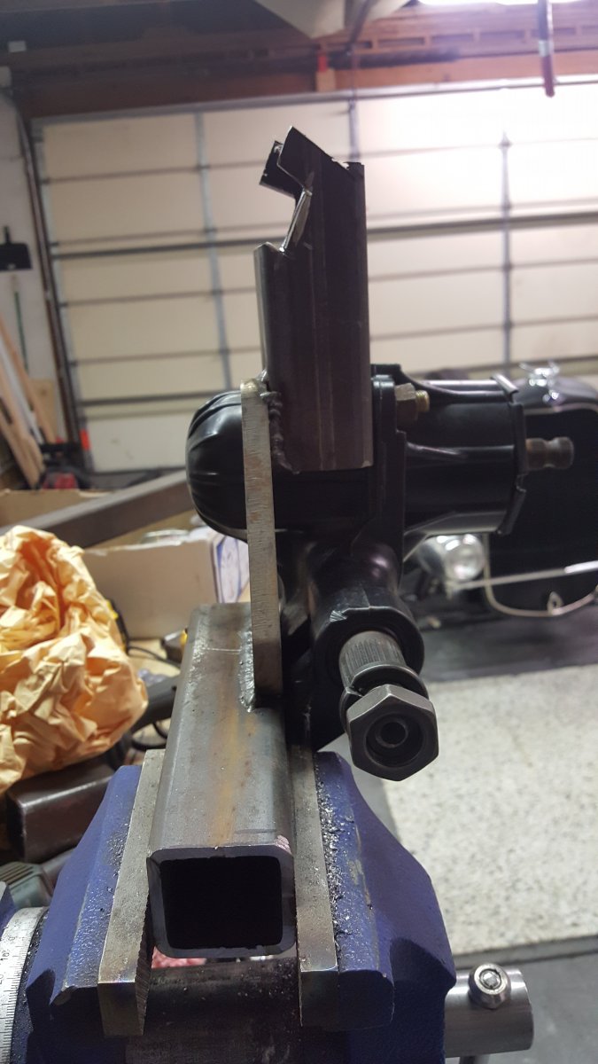

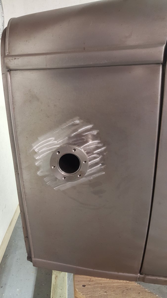

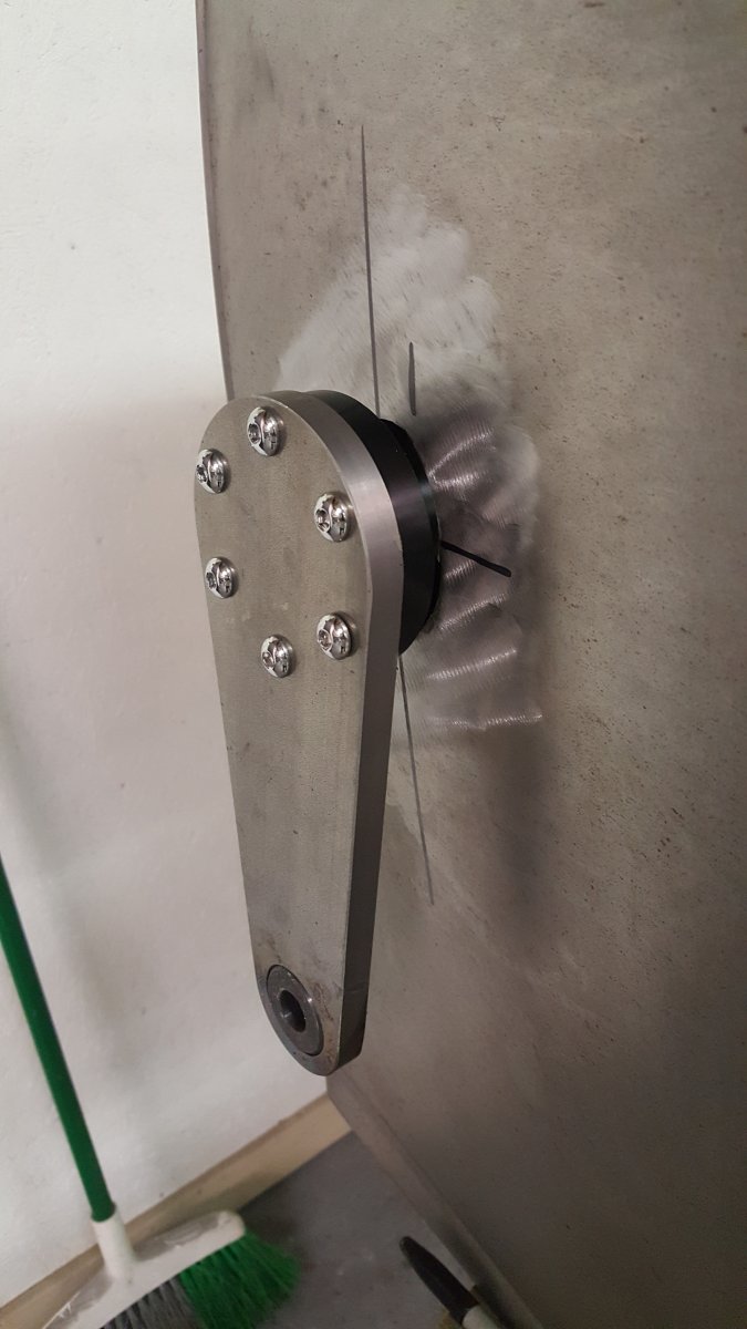

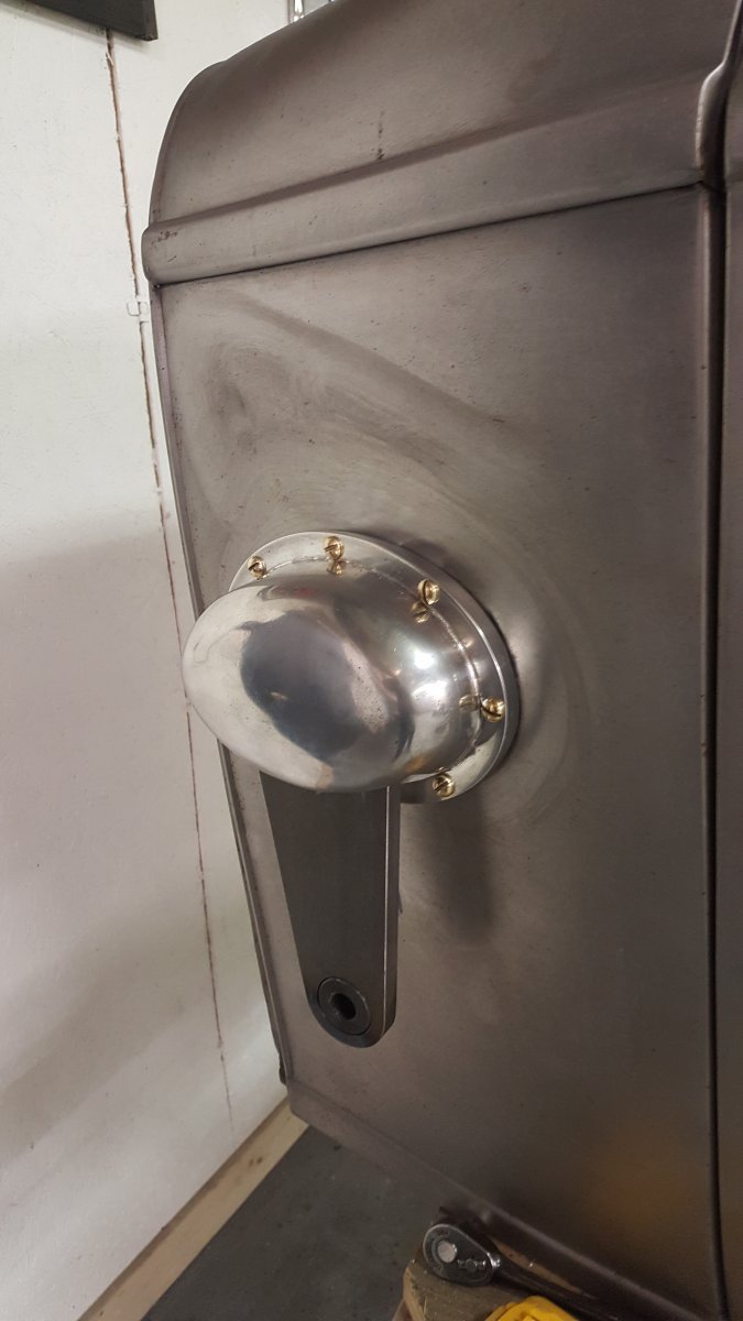

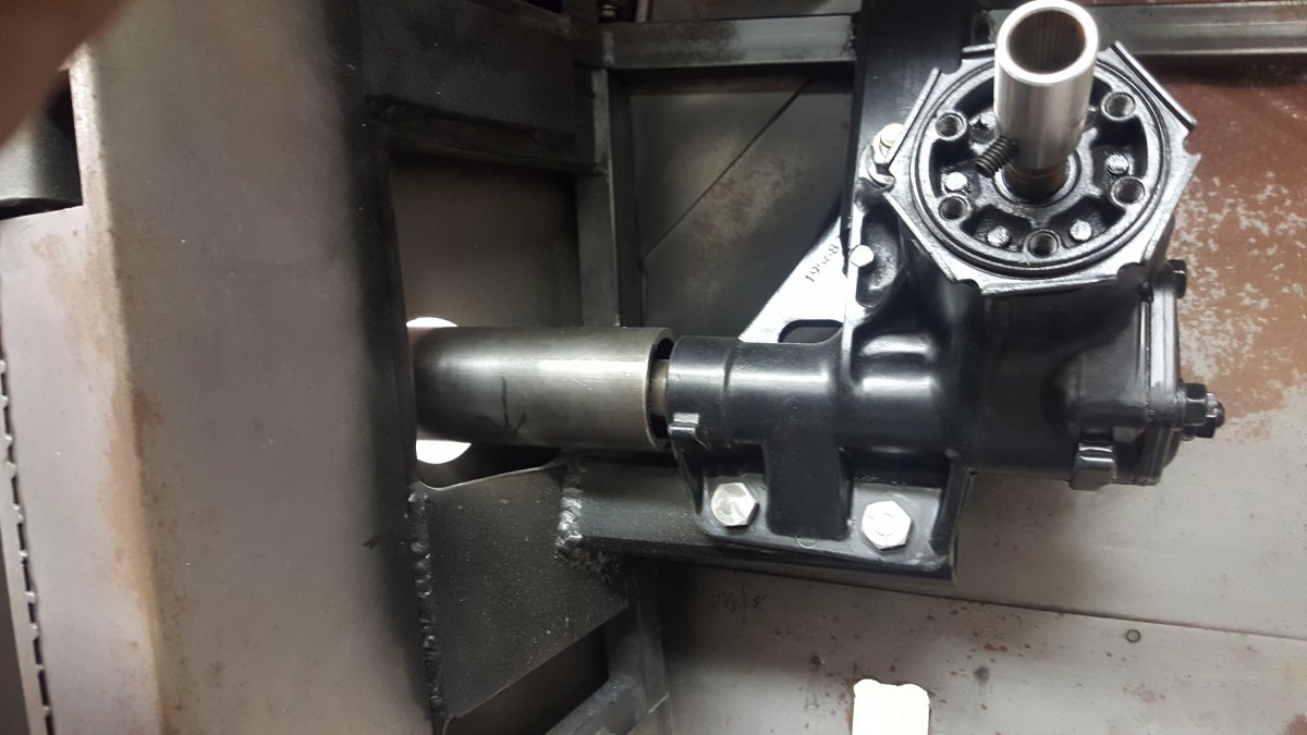

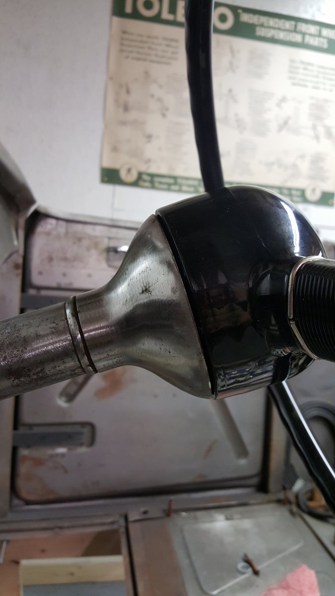

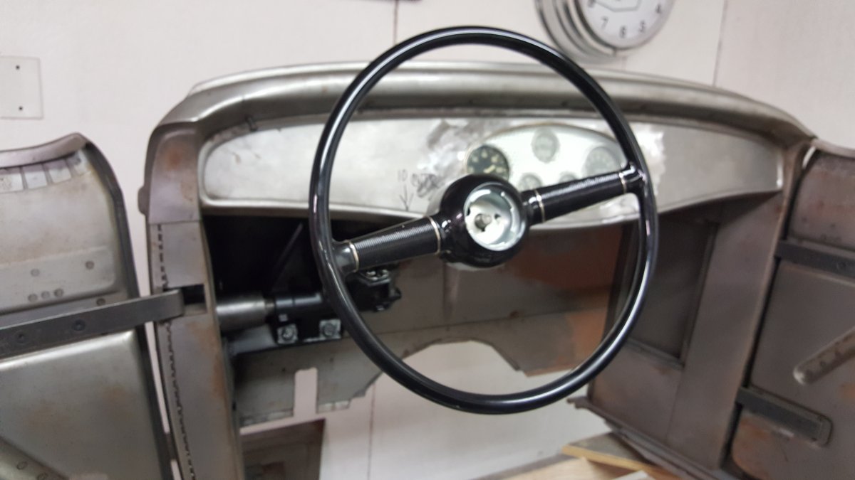

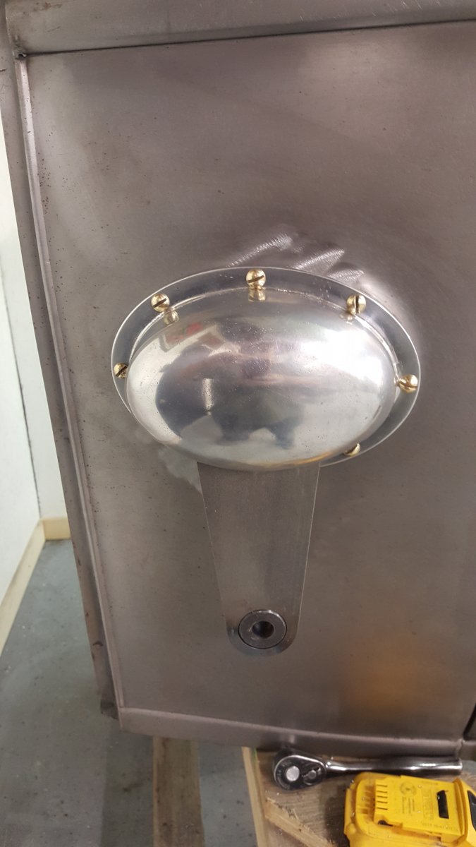

    Got my cowl steering sorted out and installed. A body molar box, 40 pickup column and A lot of steel support. Special thanks to fellow HAMB member Dave at throwback designs, he made the Pittman arm, tube and flanges as well as the awesome cast aluminium blister. Nice stuff. It's a sturdy set up, and I'm very happy with the outcome 20181108_182226.jpg 20181109_155839.jpg 20181110_084926.jpg 20181110_084930.jpg 20181108_182226.jpg 20181109_155839.jpg 20181110_084926.jpg 20181110_084930.jpg 20181111_150142.jpg 20181109_193928.jpg 20181110_084900.jpg 20181113_144431.jpg 20181113_144436.jpg 20181113_144446.jpg 20181113_155132.jpg

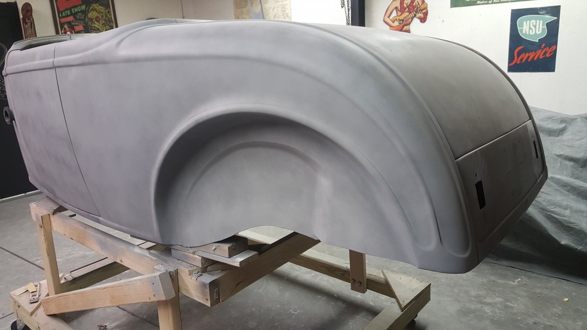

    Getting close to blocking and sealer. Wheel arch raised 2 inches, was a little challenging getting character lines to meet up and look good narrowed. I'm happy with the result. 20181130_223612.jpg

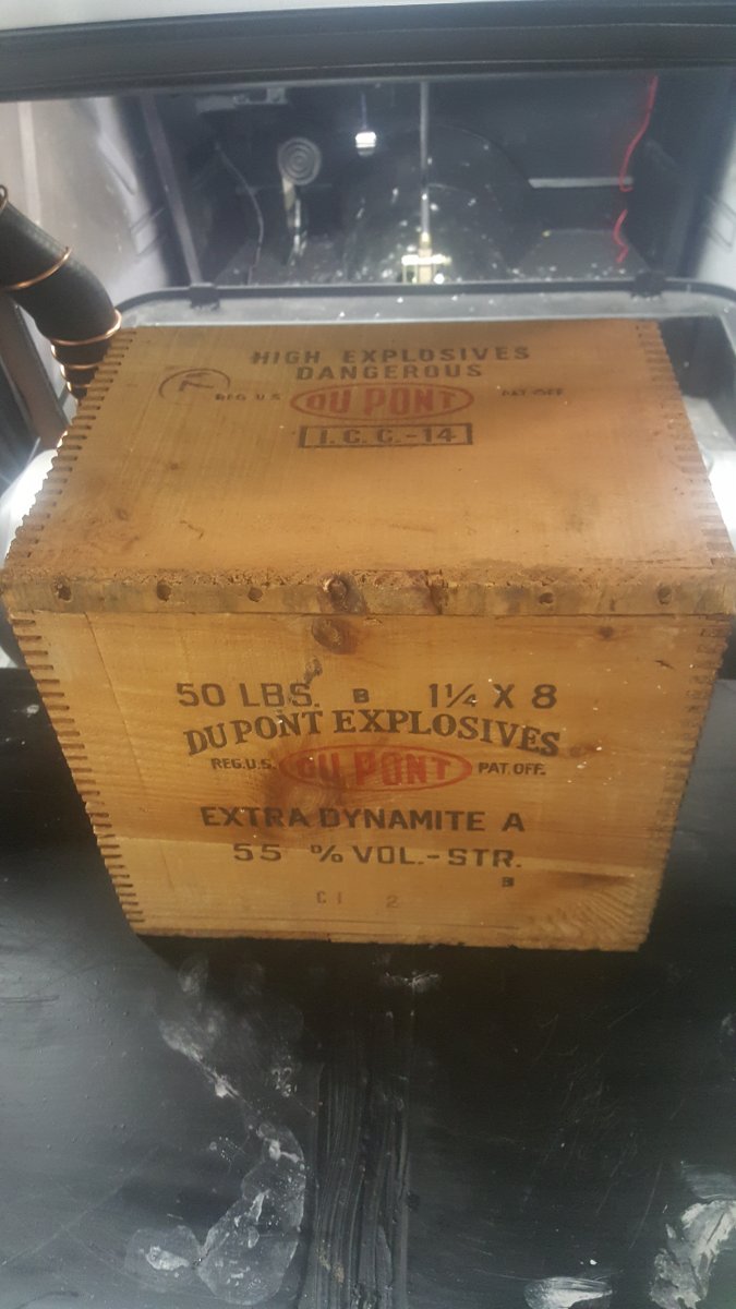

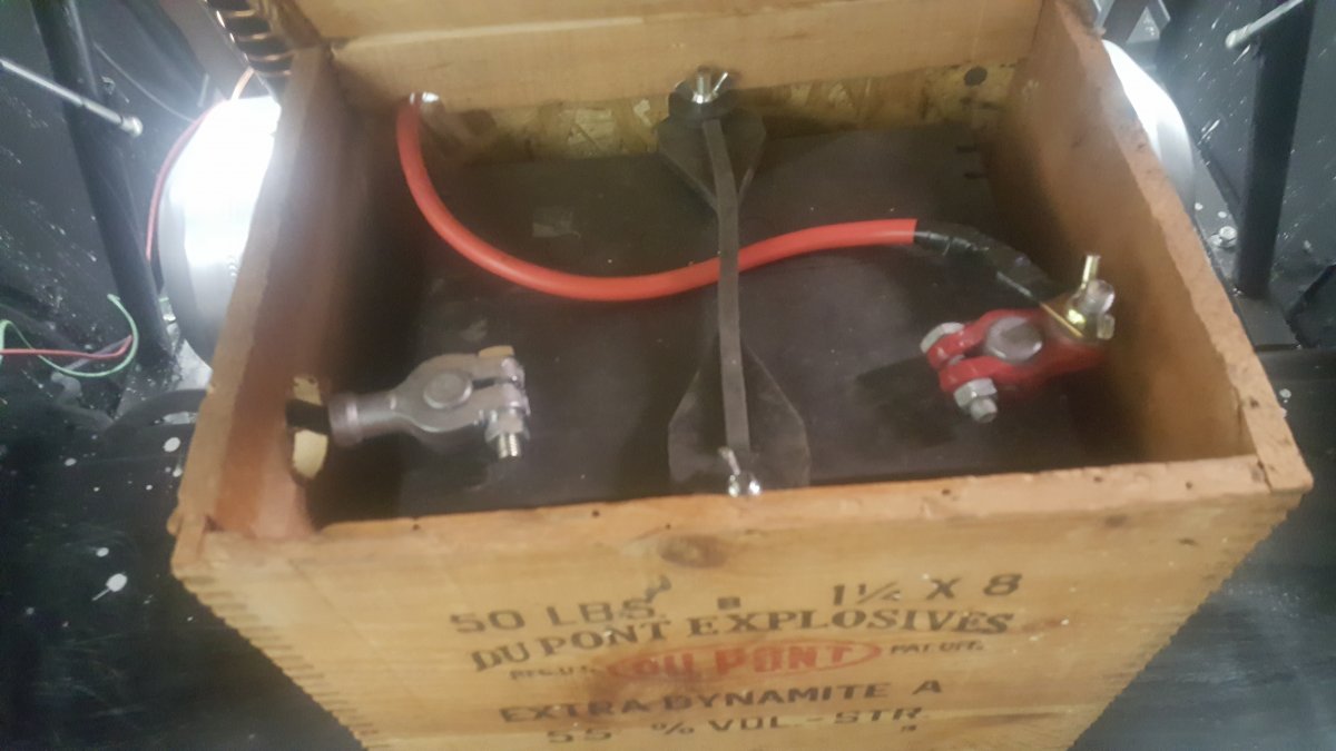

    20181220_204954.jpg 20181220_205002.jpg 20181220_205249.jpg Finished my battery box. 20181220_204950.jpg

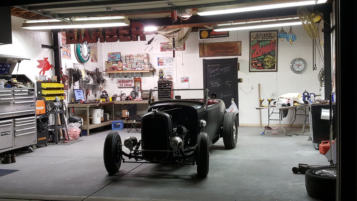

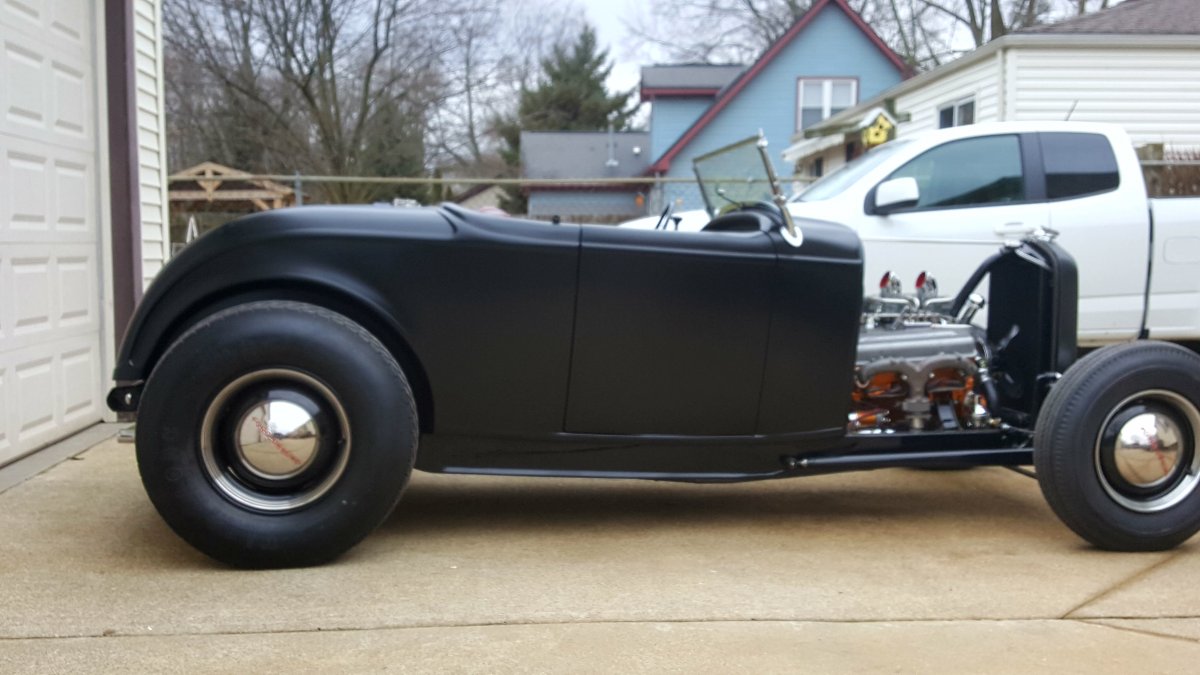

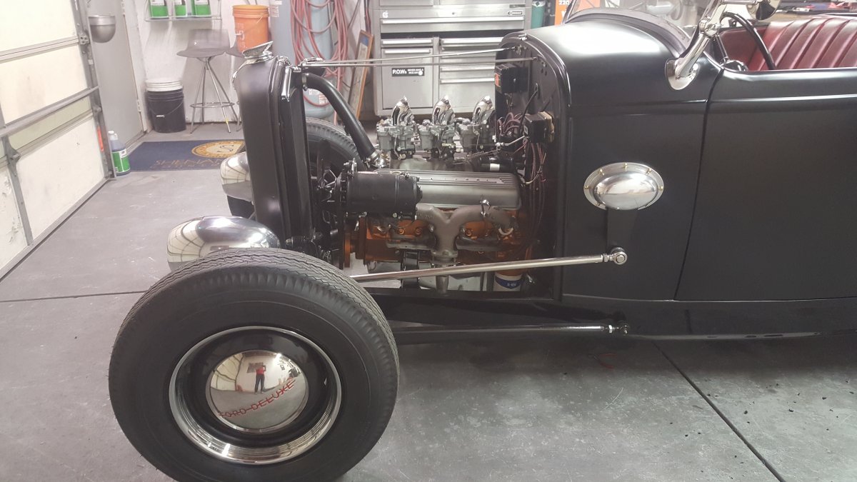

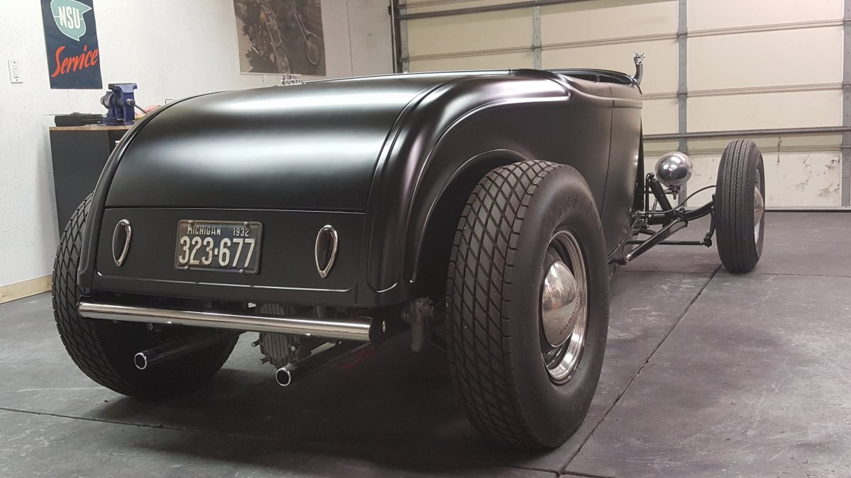

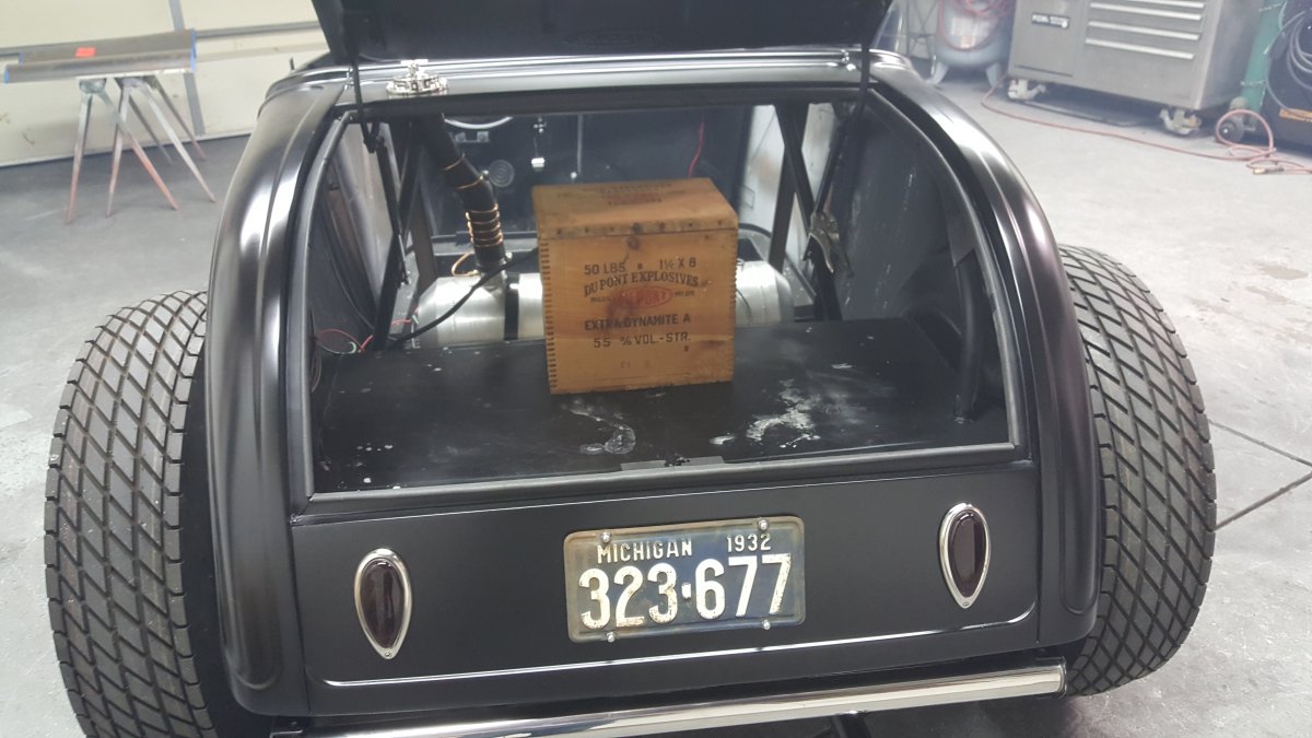

    Took it for its first road test today. 29 degrees outside this morning so it wasn't a long drive. 20190111_212241.jpg 20190101_103611.jpg 20190106_150114.jpg 20190106_150106.jpg
