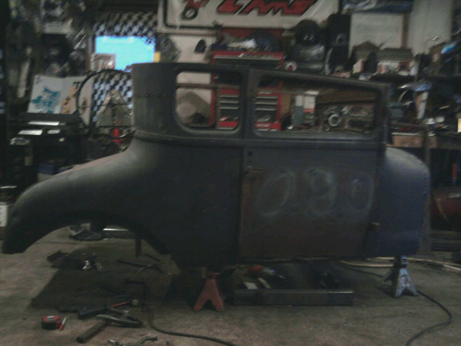

    Well I got my 1927 Model T coupe last sunday , chopped the top monday night . Going to be a kool traditional lil' rod !!! I'm just glad to finally get one !!! Here is the first px. of many to come . 8" out of the back and 9 1/2" out of the front .It will be running a iron duke 4 cyl. with 350 turbo trans. and 9" ford rear . model a axle up front , and spokes all the way around ... I will post pix. of the progress along the way .

    You chopped it in one day? How'd that work out? is everything finished and lined back up or is it just tacked back?

    Top is just tacked up ,and in place . I'm 6 ' tall, so i'm going to have the seat pushed back a little :D !!! The motor and tranny is already together . It should be light , that is for sure .

    That's cool... man cause it took me a couple weeks to get mine back together.... having to split the door tops to get them to line back up was a butt kicker!!!! :D

    The chop on this T was gravy !!! The two 46 chevy truck cabs i did were not so easy :rolleyes: I chopped my model A sedan last summer and had it back together in one day . So i'm behind !!!! lol ..... Will post more pix soon .

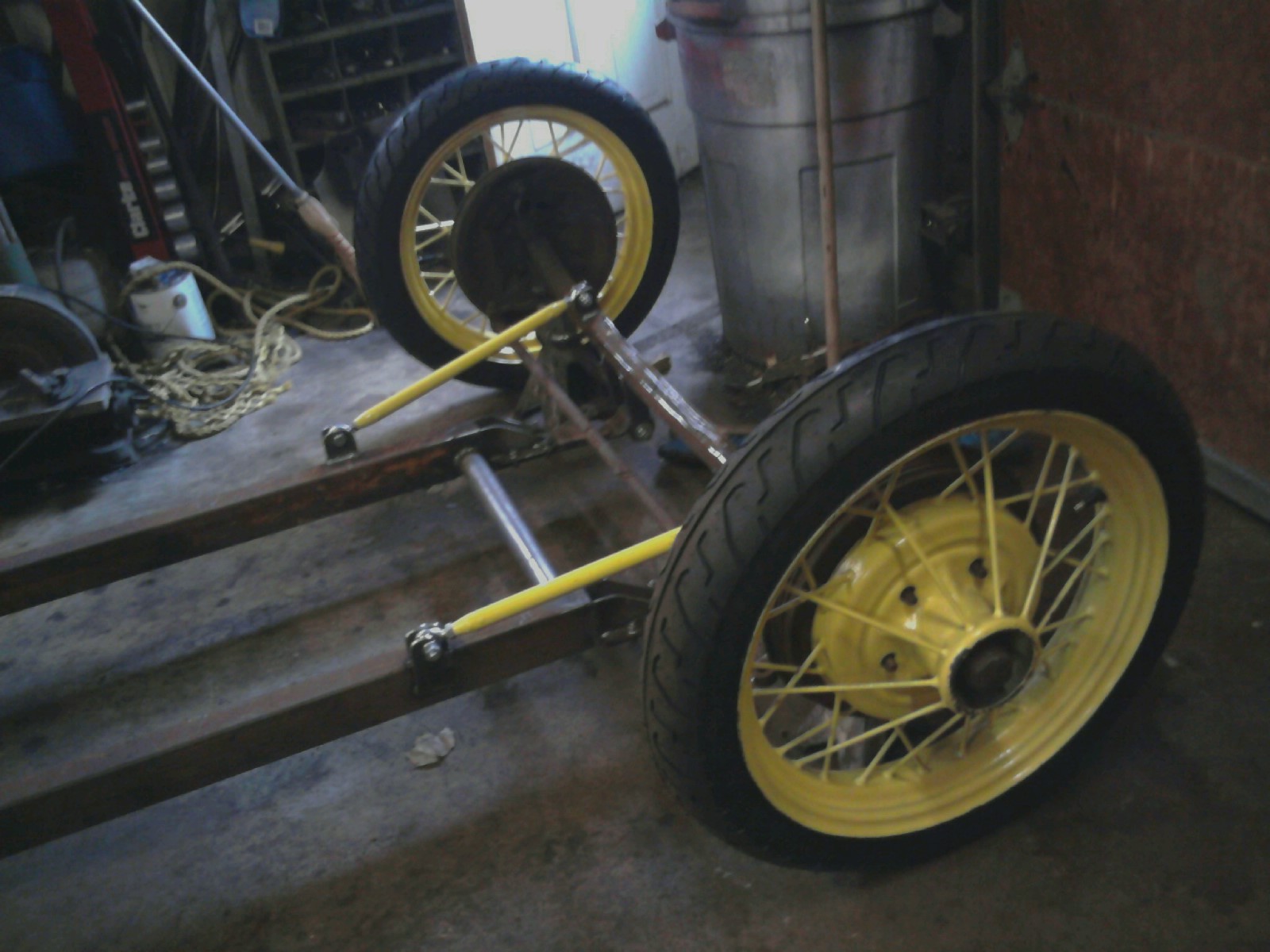

    I got my frame rails almost done ,,, 5 1/2" Z in the rear . Will be using 1/4 eliptical springs front and rear . Old school sprint car setup !! Will post more pix. as get i get more done . I have been trying to get the body done too.

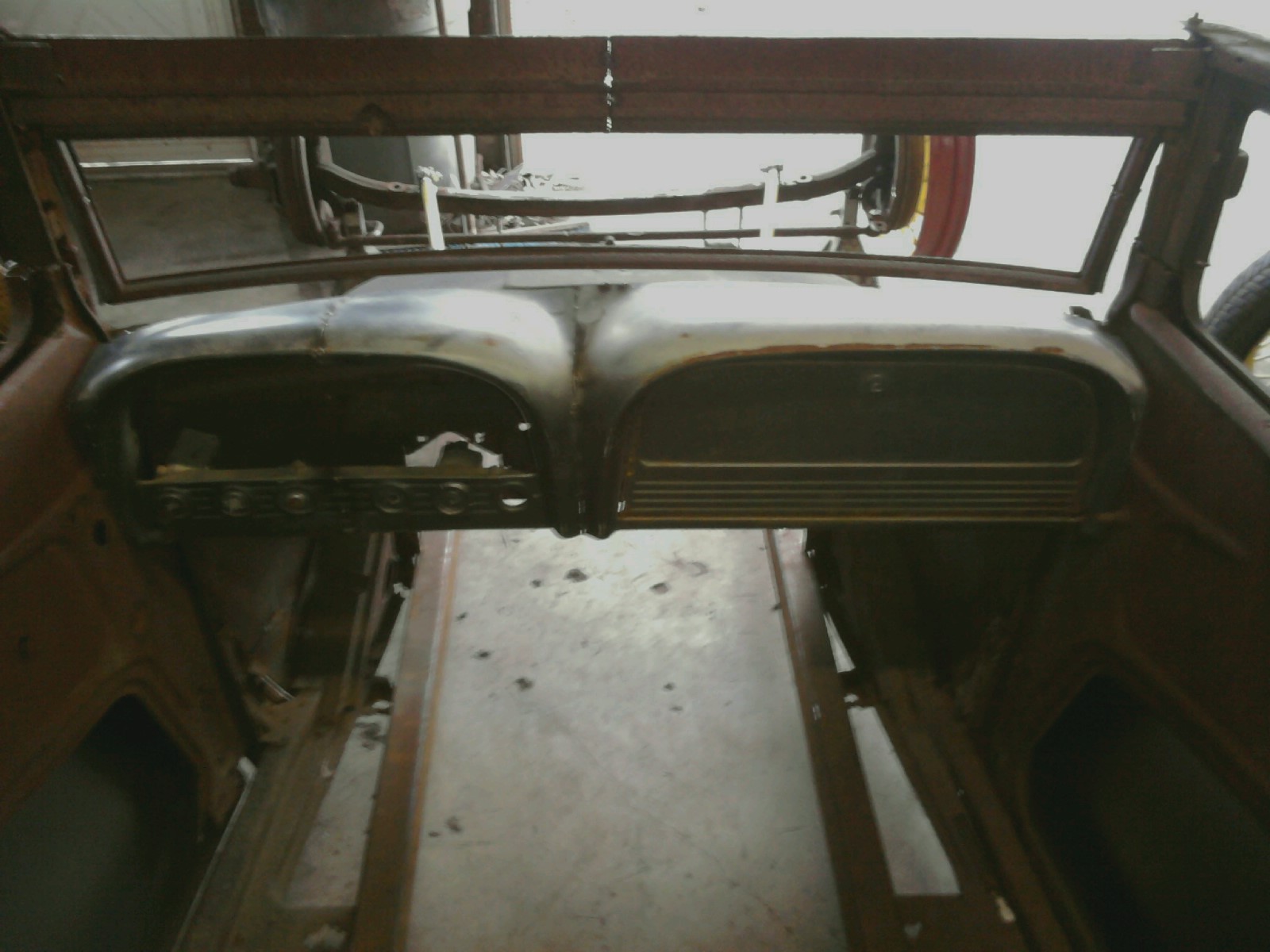

    The dash I started on it tonight !!! (1962 Chevy truck )

    Sweet looking addition

    I got my new front tires today , already on :cool:
