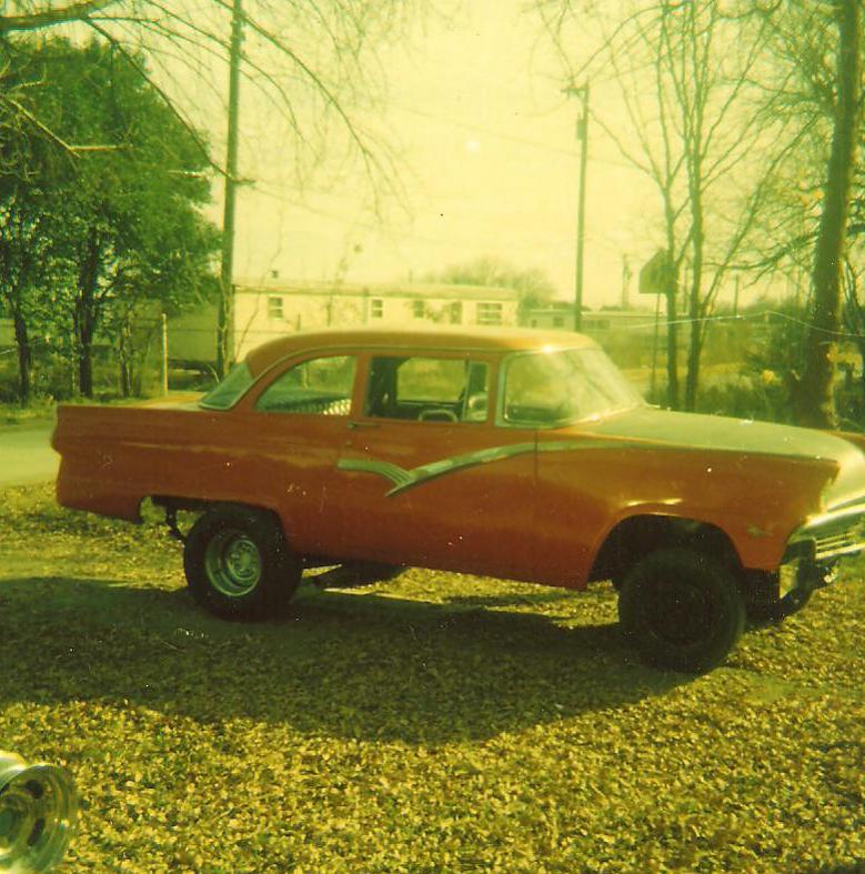

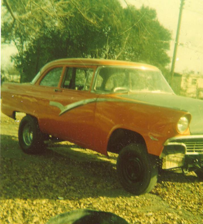

    I was going through some old pictures last night
    and I ran across these! They are of my old 56
    Ford gasser with a altered wheelbase, enjoy!
    Johnny!

  7. Tx-Gasser
    Joined: Jun 18, 2008
    Posts: 54
    Tx-Gasser
    from Tx
    It was a six banger with 3 on the column, my dad, brother
    and myself then removed the whole front steering, a-arms, etc.
    I bought a 66 Ford Econoline front axle and steering column
    that we placed under the front of the car! I had a friend that
    rolled his 69 Boss and the insurance company wrote it off
    so he bought it back for a couple of hundred bucks!
    He gave me the nine inch, 390, and 4 speed for $100!
    We found a front wrecked 55 in a junk yard and got the rear
    fender wells off it! Then the fun began, we moved the rear
    forward two feet and lost the rear seat! The we cut out the
    fender wells and added the pieces off the 55 to move them
    forward!
    While that was happing the motor went to Groff Brothers
    speed shop to be refitted and a cast iron duel quad setup
    added! Headers were home made fender exit type with
    cutouts, we rased the floorboard 2" and added a home made
    rollbar, Hurst floor 4, and mustang seats!
    I was running it at the Double Eagle till it closed and then
    out at San Antonio Dragway on Rittman Road! Here in San
    Antonio with a little street racing on the side! I ran Avation
    fuel ethel mix and was classed as A/Gas!
    A front tire blew and I rolled the car in 1978 at 128 mph broke
    both legs, left arm,and cracked 2 ribs! The the sad end is the
    56 took it last ride to the salvage yard! It was a great car and
    it held about 2 or 3 local records up till the wreck!
    I thought you guys would enjoy looking at something from
    the good ole' days and many nights at the Flame drive-in and
    the Spotted horse here in San Antonio! :cool:
    Have a Merry Christmas and a Happy New one!
    Johnny (TxGasser)
