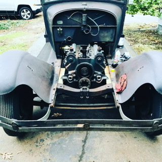

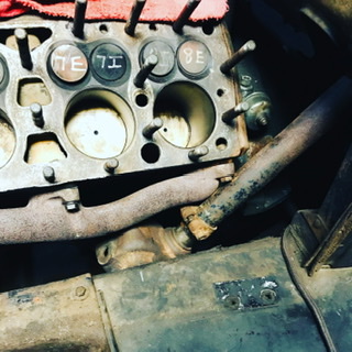

    CFF8778F-09AB-4EDA-8F2D-34BD0A71595F.jpeg 02E9CB1B-71BC-44BC-8FC7-D4BC3D258A9A.jpeg I building this as if someone did in ‘35-6. Sorta like a prototype if Ford would have came out with the V-8 in the years of the Model A. So far everything is lining up nicely. This is where the engine is going to be so time to make some factory looking mounts.

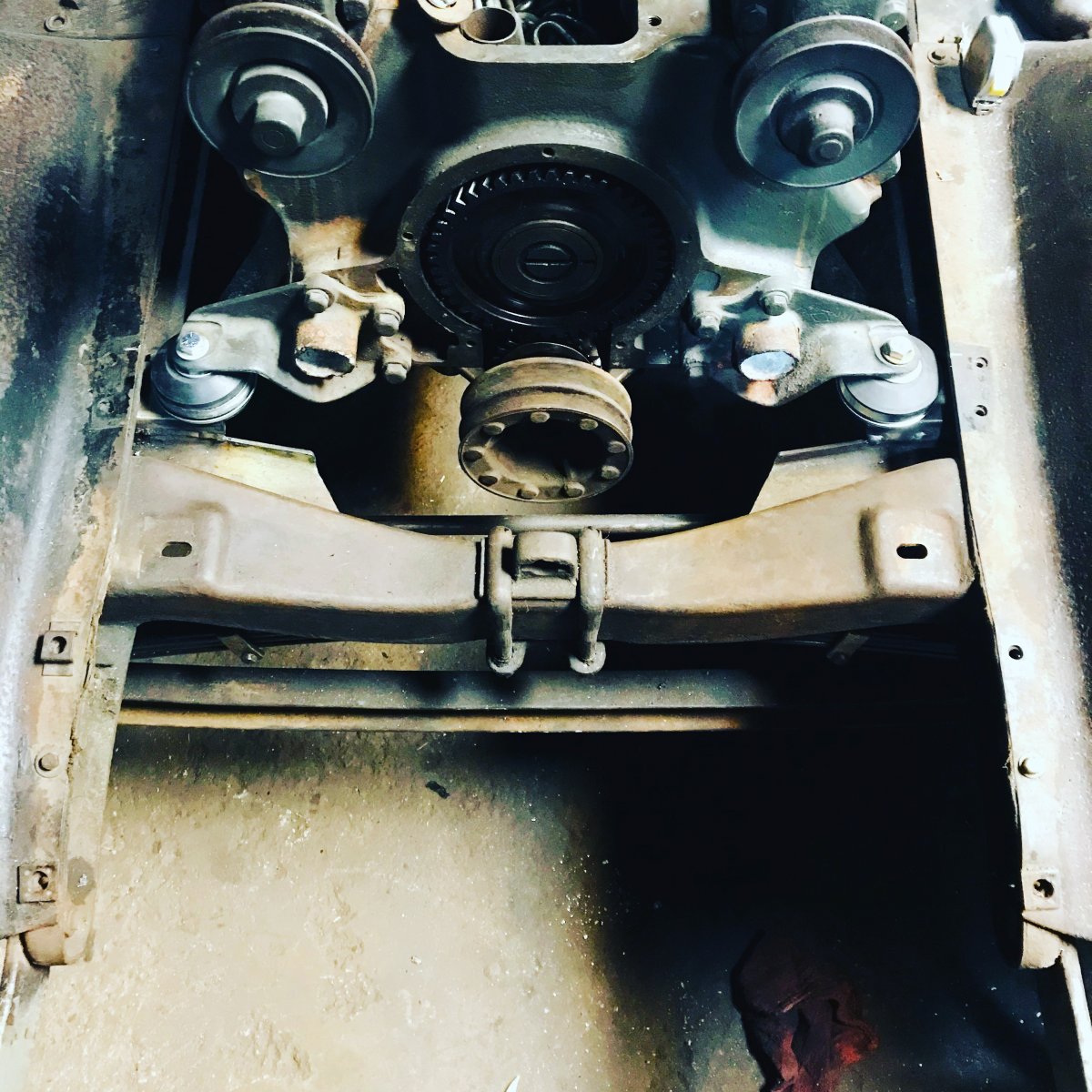

    Front mounts are in. Final welding will be done after the engine comes back out. Time to make the rear trans mount/wishbone mount. I am also going to be running anti chatter rods so those have to be incorporated into the mount as well. EC34C1BD-B2FD-42F4-A79F-E25AD7454D9F.jpeg

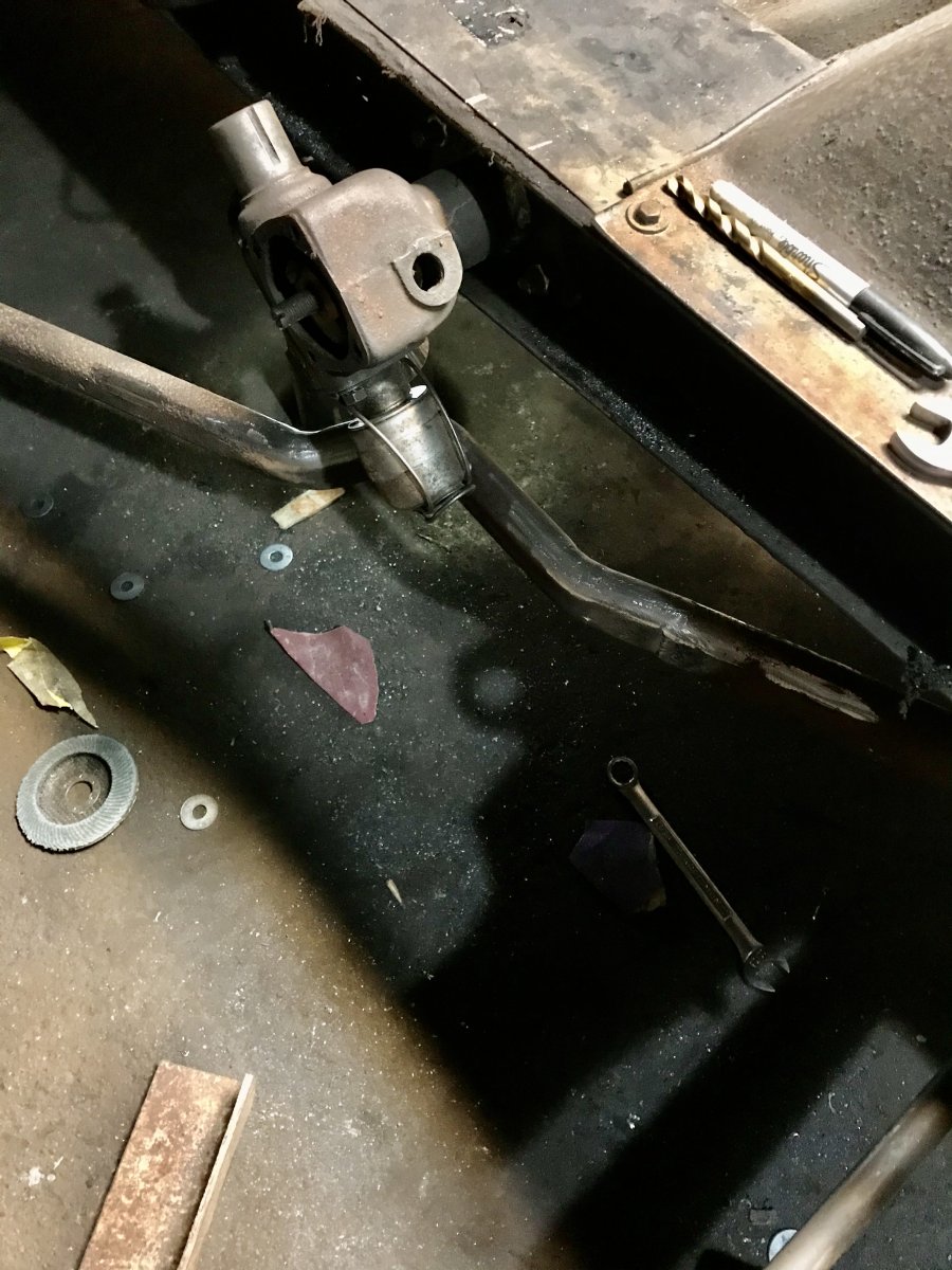

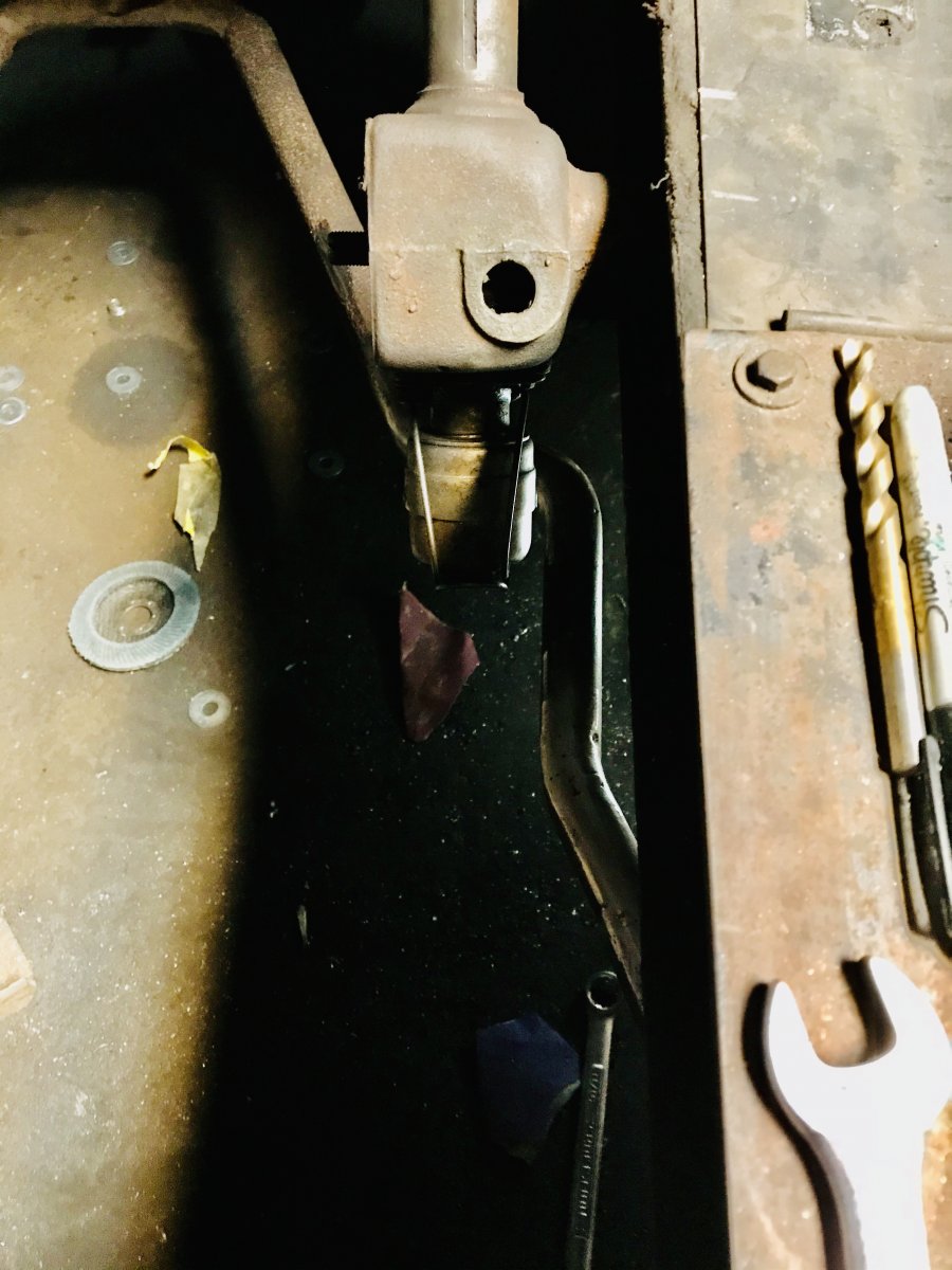

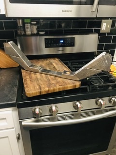

    3CC274B8-37B2-4891-B6DC-97A2A6DAD818.jpeg 562C5EF0-4B0B-41F5-8512-8EE0F7396164.jpeg A523E401-F320-469B-A6CA-8E7D5C8D1A6B.jpeg Crossmember and wishball mount done. Fitting the steering now. The box still has to go into the frame rail about an inch so I think it will work.

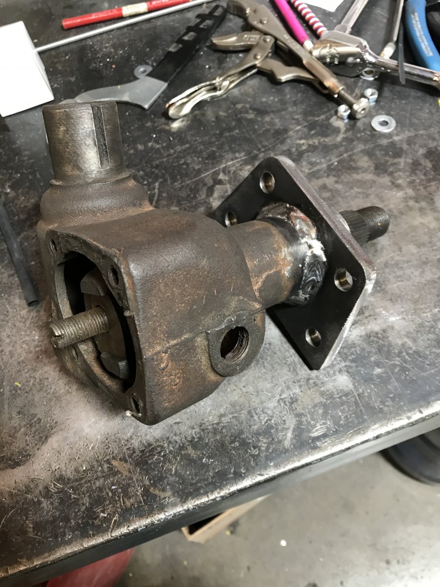

    olskool34
    606C4787-DA78-4C16-80B1-49D306005EE7.jpeg F0BA2351-1135-421C-A22F-E39A96260786.jpeg BB296B74-11FD-4F9D-841A-39286FCCC775.jpeg 2CC6CEA6-21DC-432D-B610-17C01B8A96B5.jpeg I cut the flange off the F-1 box and made a new one that allowed me to square up the box where it was originally. That put the stock headlight switch directly over the ‘32 wishbone. Nothing I could do other than modify the bone to go around it.
