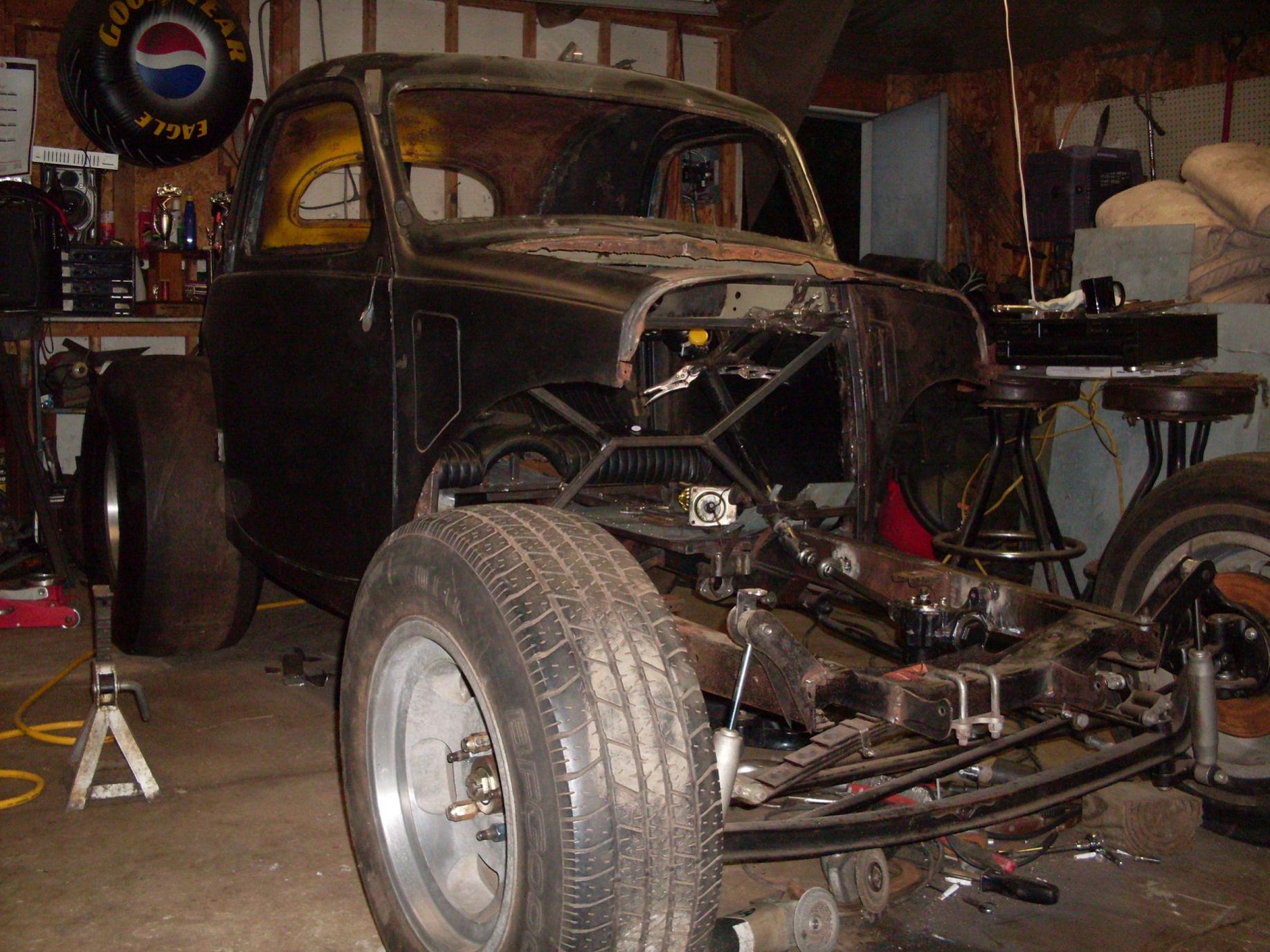

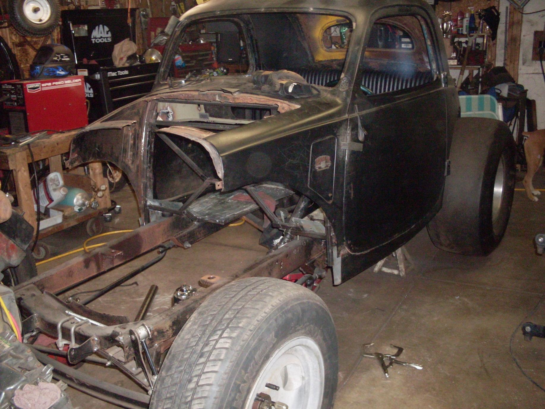

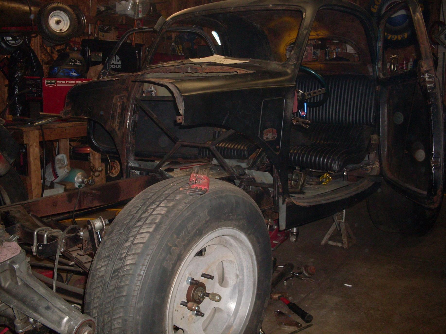

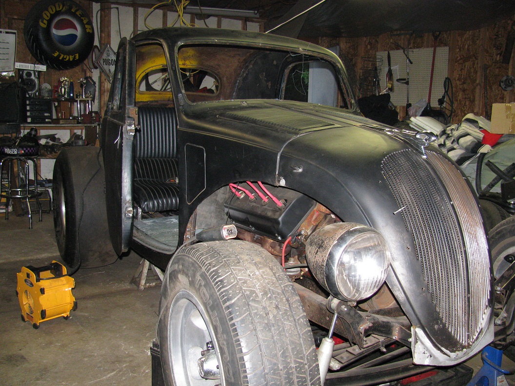

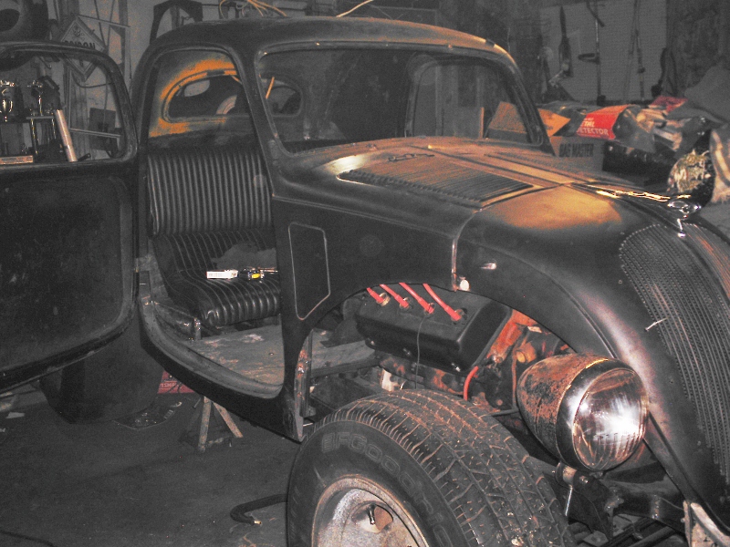

  4. haven't been able to get out to work on Lil Beast in a bit...getting ready to start doing weekend finishing the cincy house....so garage time is going to get harder to find :(

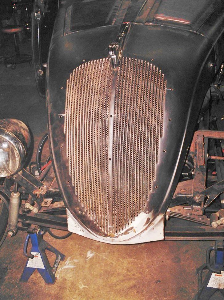

    i dug out the original grille insert that came with the nose i picked up from germany earlier in the build.....heavy duty ****er....and way nicer then i remember:rolleyes:.
    worked tonite on the column drop and final column placement, and pedals...welded in the seat bottom hold downs.
    037 (800x569).jpg .
    ..finally got smart and rasied him up onto the jack stands....all the bending was getting to my old bones:eek:

  6. sure !!!!!!!!!! no problem!!!!!!!!!!! i'll even pay shipping for the both of them..;);););)hahahahh...honestly, i looked at it breifly when i received it ....seen the holes where it bolts on and figured it was toast....releasied last nite, i was too busy staring at the grille...my nose that came with my topolino had all the bars cut out of it....and i i was amazed at the curves the bars add to the frontend.....then i though i should sell it, figured i never use it,,,then i started pricing radiators.....figure if i'm spending $500 for a custom br*** rad, i want all the armour i can get for it....
    besides, it really changes the look from head on....:cool:

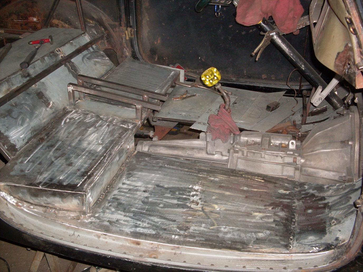

  21. well i went to Bob's tonite and used his drill press to blow all the holes in the remaining front flooring and seat tin.......this torn right side rotator cup and pulled bicesp tear makes hand drilling a *****:mad:...should have p***engers side ****oned up by weekends end.....left side floor pan is cut , but it's on hold till i get the brake and clutch systems in.....should get the last of the driver's side seat tin in also .....which will leave the trans tunnel....been playing with some s**** peices on that:eek:....
    Randy, when i make the first streetable cruise, it'll be by your place....and if it makes it, i'll be buzzin Danny's place too :eek::eek:....but looking to roll the old alley here real soon...even if it is with the M/T slicks....:rolleyes:...
  22. bit more welding today.........

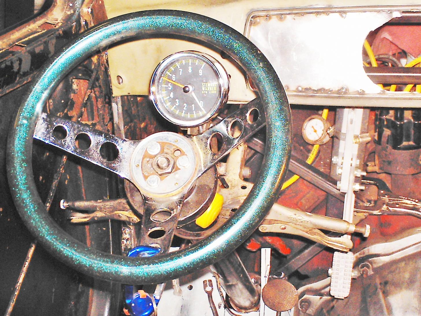

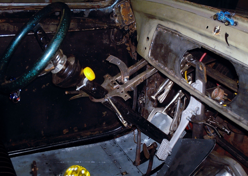

  23. thrashed till 2 am last nite...yanked the hemi and 5 speed, knocked off all the tack welds holding the steering column to gear box off....relocated everything 1/2" more to the left frame rail....hey, ain't much space with 3 pedals in Lil Beast...so far it looks like a better alingment on the borgenson joints....drilled hte double D shaft for 1/4" pins??? (not sure what is best here...pins, bolts???)...waiting for me to wake up enough to weld it all tight....
    lots of surface rust after 2 1/2 years of hanging in the garage....good excuse for sand blastng the frame.....if i ever get it finished:rolleyes:.....looking at templating the firewall out , and detailing the 325 hemi....got a nice lil pile of vintage dress up stuff hanging for it:cool:......still hunting for that unique fuel induction system...man i should have bought that blower intake when i first started this.....

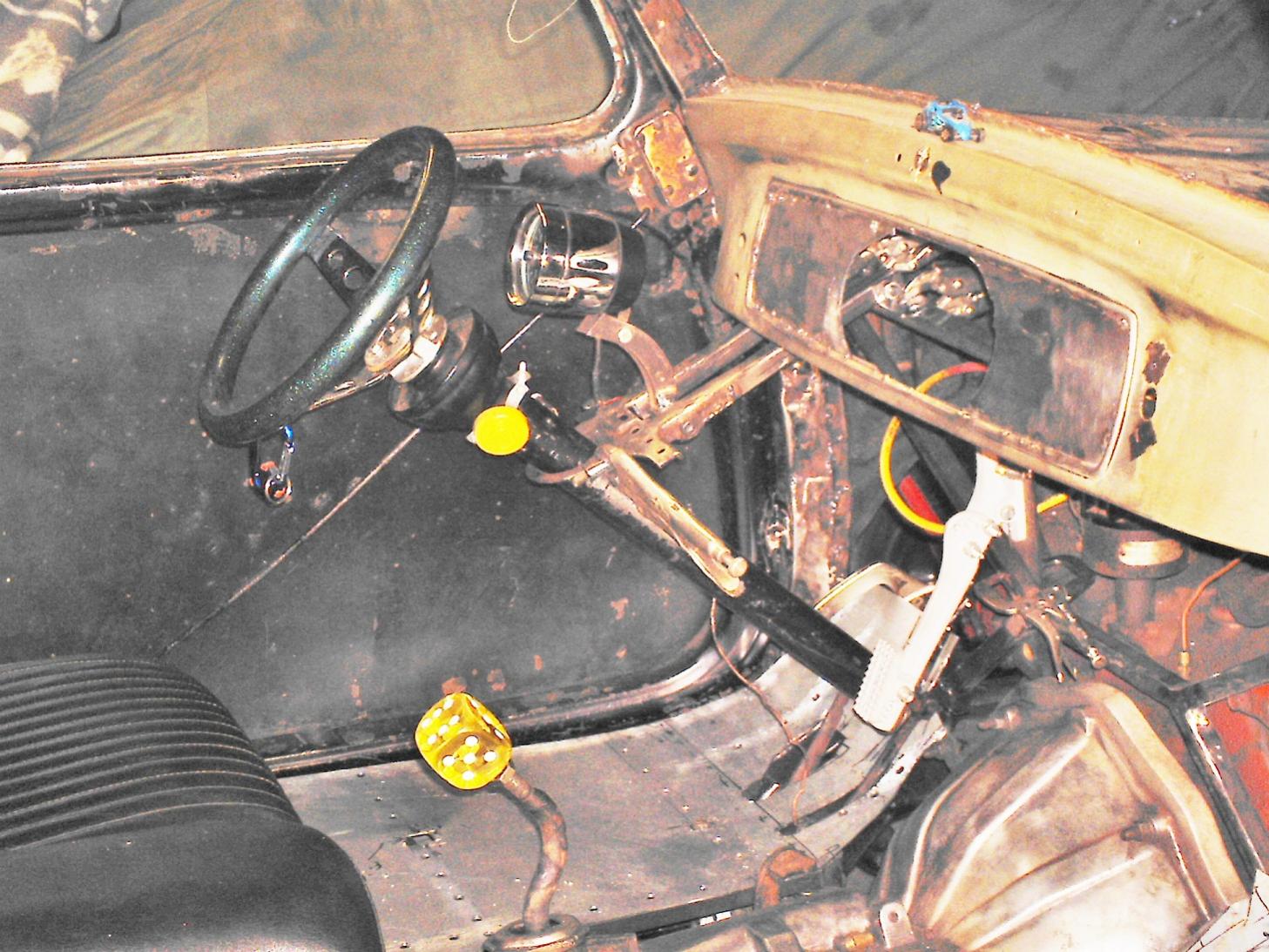

  26. column to steering box in and welded....had to let Lil Beast off the jack stands to get the hemi off the engine hoist...steering is very easy and smooth:D

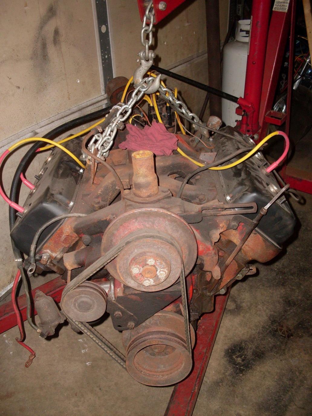

  28. thanks, Bob.........it was a bit of a bummer pulling it, seemed almost like i was going backwards....:eek:....but it made getting the steering aligned easier then eatin pie.....and it's just about time to make up a template for the firewall.....and getting the clutch ***embly with the hyd t/o bearing adjusted with the motor trans out of the car .....
    plus the hemi was purchased as a runner, and i never have stripped the old red paint off it,,,

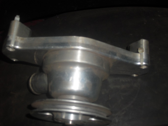

    ,,so it'll get cleaned, and the new valley cover installed...then there's the need to change out the timing cover,as i am going to be running the Lil John's Stuff sbc water pump i've had for about 20 years.......suppoesedly wasn't too many produced by John ****uera???? (can't remember how to spell has name propperly) that have that scripted into the front of em....had the whole set, mounts, timing cover ect, but just down to the w/pump.....people asked all the time who it was made by when i ran it on my blown 400 sbc in my old 72 vega wagon......cool looking peice....
    so i'll look more like a hot rod with the goodies on it....still up in the air over what to feed it with, but it's starting to really look like a 3 X 2 offy for that task...still can't beleive i p***ed up on that blower intake:mad:....if i only knew....:(.......
