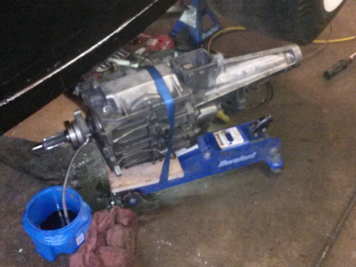

  11. Picked up three 5 speed trans tonite....Joe said it was super clean n tight when he took it apart. ...found that it was what he called a bad install of 5th gear synchro. ...everything else new...we talked and he knows how humid my garage gets...n i haven't moved Beast since Milan dragway trip...gonna pull the rotated bellhousing and see if clutch disc is stuck to the flywheel..otherwise it'll be on Tilton n the bearing... 1454632048372.jpg

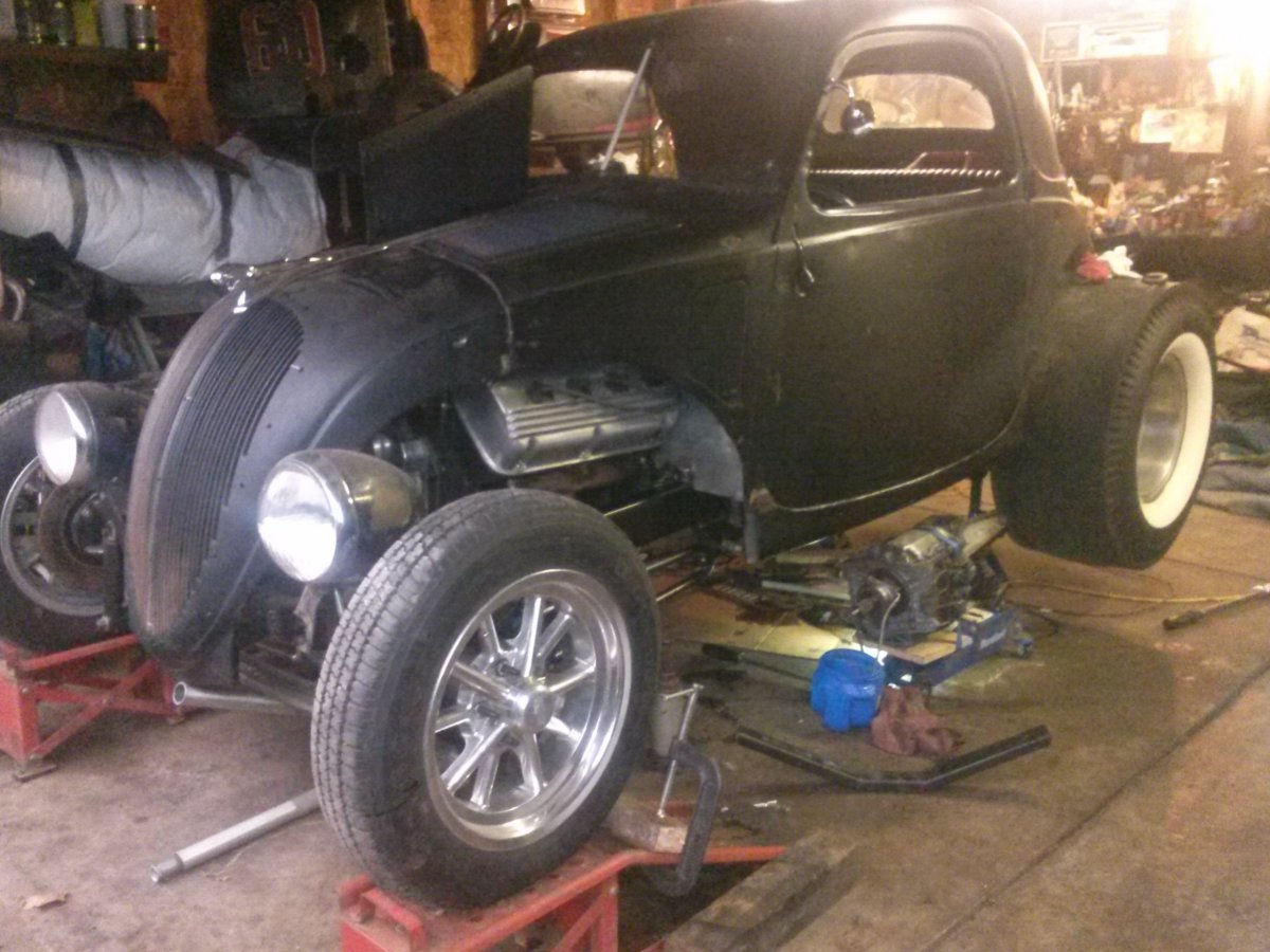

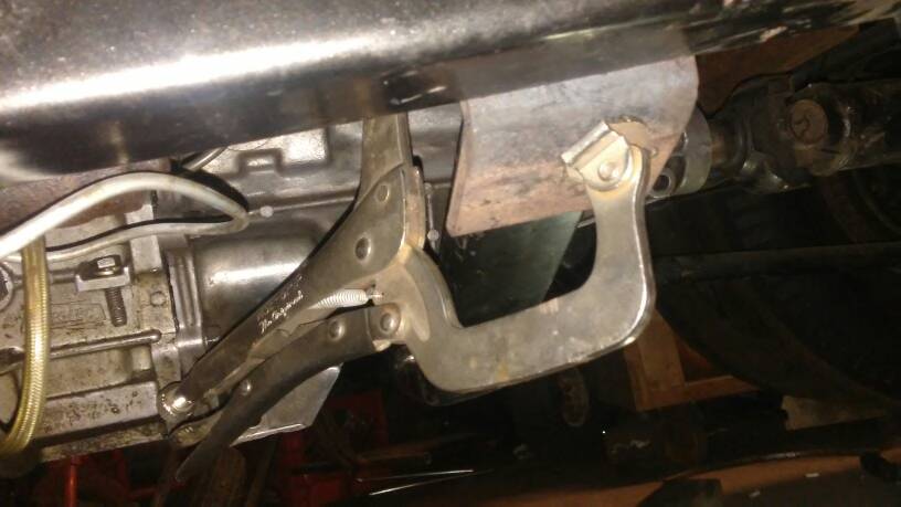

  24. Well I've been laying out the trans crossmember for too long......changed how it was to be 3 times.and came up with this.... 1470193495239.jpg
    Simple setup....bracket gets welded and a gusset, crossmember gets bolted to it...have too tweak both brackets a hair...then weld em up where i cut a relief in them to make them fold up with a crease....i post more pics as i go...mocked up so as to trim crossmember to fit...will do other side tomorrow...then drop car on tires and check engine trans height for proper angles pinion and motor ..have it close on the stands, but guessing on tire compression... 1470193931847.jpg 1470193931847.jpg

  28. Come home tonite, open garage n see Lil Beast down on the ground on all 4 again...been hovering. around the garage since feb....
    Dropped him down last nite to double check trans to pinion angles, and carb mounting surface angle...everything is 1st mocked in place...will scribe location and break down, grind off my frame paint then track and recheck...should be ready to bleed tilton bearing system...if no issues there, will call us willy cause we'll be on the road again
