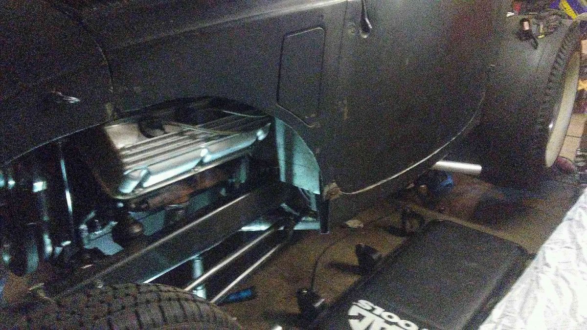

    Brackets fabbed and mocked in...I'll round off the hard 90 corners and probably run drill thru gusset...add a few more lightin holes....lol......
    I'll weld them in tomorrow and drill thru for retaining bolts thru crossmember. Build a new wedge for the angular trans mount.....what happens when ya use a rotated bellhousing for more pedal space...and then change from camaro tailshaft to s-10 to get the shifter out of the back seat...
    Get this mounting issue over with, i can hook up hydraulic lines for bearing..find out if it's good to run or has to be sent to tilton for??

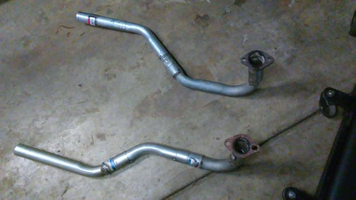

  2. Crossmember is completed..ol Bob went over to his buddy's exhaust...

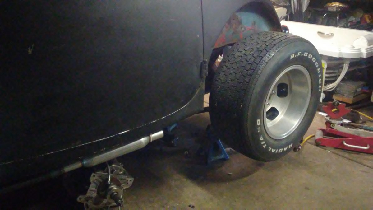

    Test radial mounted.... 20161105_150154.jpg slight difference in height between thesen the pie crust radir's.....could drop the QA coilovers a notch...one left on mounts...wanting to drive it at hiway speed more..like the 17 miles of I-75 each way to work....
