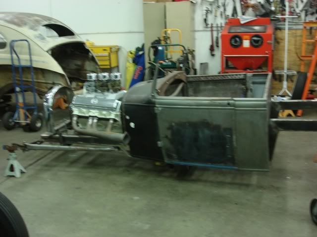

    So, here is where the car sits now. It is a roller (Yea !!!!) and I have installed some of the parts so that I can start making decisions on if I like the look or not. The car is starting to talk to me and tell me how it wants to be, so I am going with that and making changes as we go along.
    These pictures were taken last night after I built a temporary bed out of masonite to see how it should be built out of steel.
    We also had the tonneau cover that Dan had punched with 224 louvers, but never used on his own rpu, so last night I cracked open the case it was in and it looks like we can cut it up and use most of it to cover the back of my bed.
    Final details like color are still up in the air. I am thinking off white suspension and I have never had a red hot rod, so I might find an old timey looking red and satin it slightly to age it. But that could change tomorrow.

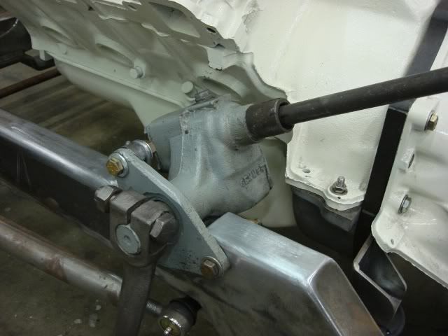

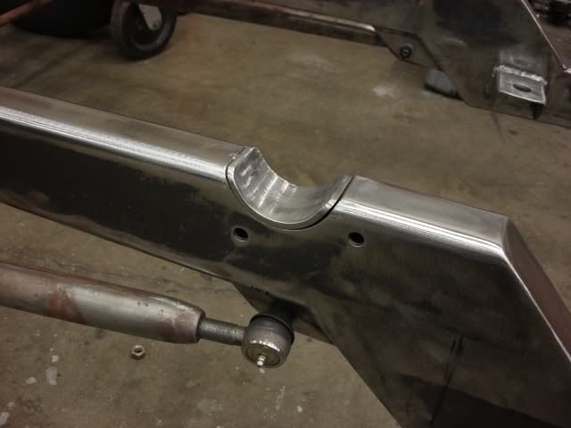

    My project for today was getting more done on mounting the steering box. As I mentioned, I am using a 56 Ford pickup steering box and a 59 (I think) steering arm. The earlier arms had a ball end on them but this one has a tapered hole for the tie rod end.
    When Dan and I wrapped up Friday night we had cut the half moon section out of the top of the frame rail and made a half round section of plate to cover the cutout. We didn't weld that plate on yet because we needed access to the inside of the frame rail so we could insert two round pieces of tubing the exact width of the inside of the frame rails so that when the bolts that hold the steering box to the frame are torqued down they will not **** in the sides of the rail.
    Here is a picture of the rail with that notch for the steering box to drop down into:
    I needed to do it that way because I didn't want the box just perched atop the rail and it also needed to come down about an inch to clear the Olds engine. By dropping it down it also allowed the two bottom bolts of the steering box flange to be below the top of the rail, and that would allow me to p*** the mounting bolts right through the rail. I also had to mount the flange to the outside of the rail because I am using rectangular tubing for my frame and I needed to get the box as far to the left as possible for engine clearance.
    I made a simple jig to hold the steering column shaft at the exact height I needed it to be for a comfortable driving position, and drilled two holes through the frame and flange. Then I made up two spacers to go inside the frame to make is solid where the bolts go through, and I got those welded in place. Since the frame tapers in I had to make a wedge shaped piece to angle the steering flange out a quarter of an inch so the pitman shaft would be in a straight line with the front suspension.
    All that is left now is to weld that half moon piece in place and also weld the small bracket I made up for the 3rd bolt hole on the top of the flange. Once that is all done I can mount the steering arm that goes on the drivers side front wheel and get my drag link ordered from Speedway.
    Here are some pictures from tonight, thanks for looking.
    Don
    I used a carpenters square to make sure my steering column was straight in line with the centerline of the car. I found that I needed a quarter inch thick spacer shim at the front edge of the box flange so that the box would sit straight in the tapered frame. It took some time, but I was able to make a wedgeshaped flange that put it right on the money.
    And here is the steering box and arm bolted in place (temporarily)

    Tonight Dan came over to the shop after work and got the C notch welded into the frame and also got the gusset built and welded on to hold the 3rd mounting bolt on top of the frame. So that is the last of the work to do on the steering box.
    Here is the C notch after it was all finish welded in place.
    And we put the Olds motor back in to see how the steering box cleared it now that it is sitting lower in the frame. We picked up quite a bit of room all around the steering box and it drops down into a pocket where nothing is near it. Almost like we planned it that way. :D
    All I have to do now is make up the top mounts for the front tube shocks and order my draglink from Speedway. That will be about the last of the heavy duty work on the frame and ch***is. After that I can move on to getting the body mounted and start working on the Kugel Komponents 90 degree brake pedal setup under the dash.
