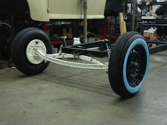

    Last week I took my rear end housing and all the other rear suspension parts to the powder coater to have them done in the same off white as the front end. Tonight I wrapped up the front brakes, so , for the most part, the front end is now completed. Just a few things like the stabilizer to install and that will be it.
    Then I installed the new front tires and wheels and dropped it down on the ground. I'm liking it better all the time. :) I should have my parts back from coating this week (hopefully) and then I can get the thing up on all fours.

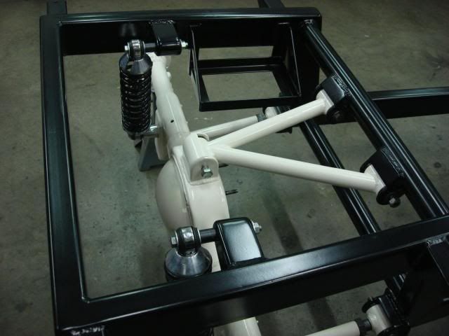

    Tonight I loosely installed the rear end ***embly. I still have to pick up some 9/16 grade 8 bolts to finish it off ( I ran out) and I dialed in the pinion angle "somewhat close" to 3 degrees, but will adjust that more closely when all the weight is on the car.
    It should settle down about 3 -4 inches when the Olds engine, transmission, body, and bed are sitting on the frame, then the rear control arms will be level to the ground. With the coil overs I can adjust the height to get the exact rake I want.
