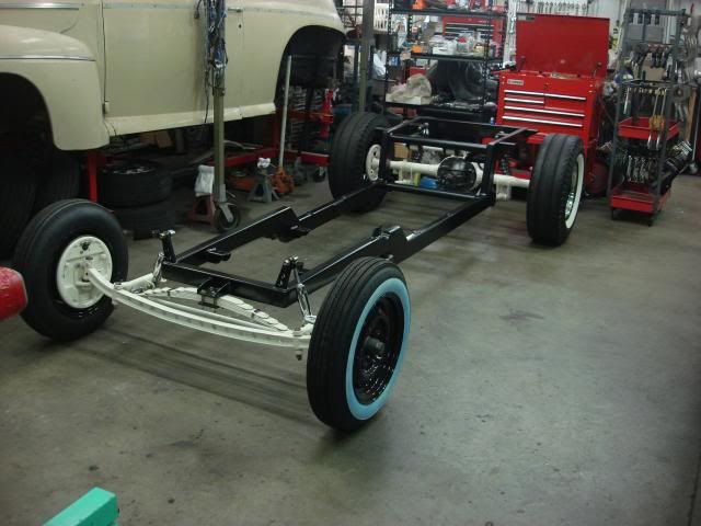

    Thanks guys, I haven't been ignoring you all, I just couldn't find this thread since the changeover. Maybe someone can tell me how to find threads I have started. I can find my "content" but those are just posts. I'm sure it's here somewhere, just don't know how to find it.
    However.................I do have a little update to post. What has been holding me back on getting the car back up on all four wheels is the 8 inch Ford center section. When I tore down the one I was using for powder coating my intention was to simply put a reseal kit in it and go with it. But I found two or three chipped teeth, so I ordered a new gear set and installation kit from Summit. I went with 3.55 gears as a nice compromise.
    I also bought their pinion depth gauge set and bookmarked 4 great videos on YouTube on how to completely rebuild one of these. I tore it all down and then realized I was in over my head, I am not a mechanic but more of a fabricator........things like dial indicators and depth mikes go right over my head. So I took the whole thing down to a good mechanic who has a shop where my shop is and let him rebuild it for me, and to also press new bearings on the axles. This way I know it is done right. I know my limits. :rolleyes:
    Got them back, painted the center section, and last night I got the car back up on wheels. Now I just have to go to NAPA and pickup the brake parts to do a complete brake job on the rear and that should be that. Then I can move onto getting the motor repainted and installed.

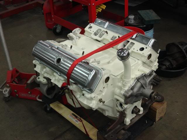

    Thanks, K13. :) Tonight after work the rain held off long enough for Dan and me to get the engine wheeled outside and sprayed. Now I can move onto getting things like the intake installed, the carbs rebuilt and modified for tripower use, and all that other stuff so I can fire it up.
    The color in two of these pictures is darker than it really is, the one lighter picture is more like it. I used Wimbledon White Imron, which is what I originally painted it with years ago.

    This is closer to the true color.

  15. OFT
    Joined: Jun 1, 2005
    Posts: 579
    OFT
    The shot with closer to true color is nice!
    Earl
  16. Don's Hot Rods
    Joined: Oct 7, 2005
    Posts: 8,319
    Don's Hot Rods
    from florida
    Thanks. Yeah, for some reason it photographed darker in some pictures than it is. Maybe the angle or lighting in the shop.

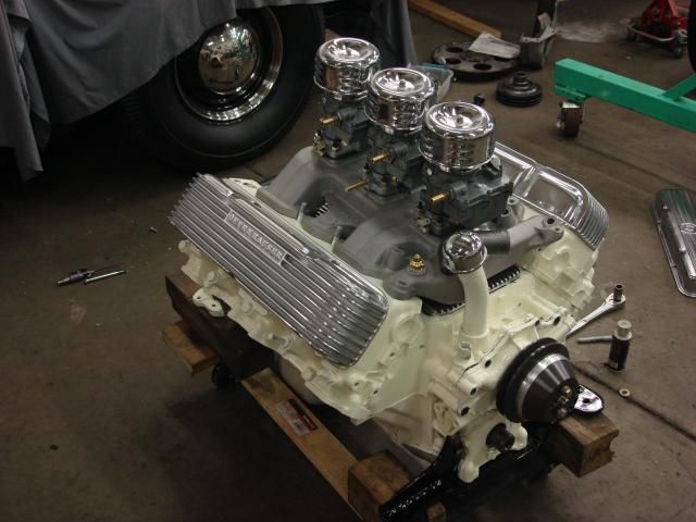

    One of the things I had to get out of the way was rebuilding the 3 Rochester 2 barrel carbs that I am going to use on my car. Over the years I have ac***ulated 6 of the Rochester 2 G carbs and I picked out the best 3 to use. I also bought one of the Speedway tripower conversion kits that has the two bases with no idle circuits to convert the end two carbs to just dumpers.
    It's a good thing I had 6 carbs because all of them were missing pieces and between the 6 I was able to get enough parts to make 3 good ones. It ended up being just a basic rebuild with all 3 carbs getting various modifications to work as a tripower setup. I downloaded the instructions off of Speedways site and it really wasn't all that hard.
    When I ordered my Alodine and etching solution from Aircraft Spruce I screwed up and ordered the clear instead of the one that turns aluminum the golden color. I read their order form wrong, but in the end I am happy with the silvery color they ended up as. This isn't going to be a showcar, but a driver, so I just want it to look ok and run well. I have a NOS Offy intake that these will go on, and as soon as I can get the motor installed in the frame I am going to put this setup on the motor.
    Here are some pictures of how they turned out.

    I also scored some new Offy finned aluminum valve covers from the HAMB cl***ifieds, so those will be going on soon.

    I like the "silver" color on carb's-to me-gives it more of a NOS look.
    Earl
  19. Don's Hot Rods
    Joined: Oct 7, 2005
    Posts: 8,319
    Don's Hot Rods
    from florida
    Thanks, Earl. I was a little disappointed when I let the first carb soak in the Alodine and it didn't start turning gold, but once it was done I kinda liked the look . I would have been happy if it had turned gold, but this is ok too. At least now this stage is over and I can move on to other things on the car.

    My goal was to have the engine back in the frame by the weekend, and for a change I actually hit my target. Tonight I got the last couple of pieces of the engine painted and when they dried my two Sons and I put it down in the frame. :) Still a lot to do before I fire it up, but this is a big step in the right direction. I'm surprised how big the Olds looks in there, especially with the Offy valve covers on it.
    Here are some pictures where we left off tonight:
