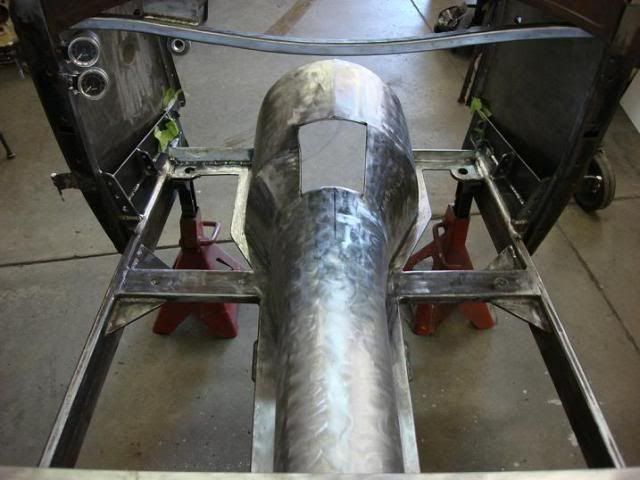

  28. Don's Hot Rods
    Joined: Oct 7, 2005
    Posts: 8,319
    Don's Hot Rods
    from florida
    Tonight I decided to get some more work on the subframe done. Shaping the front part of it around the TH350 trans is a little challenging as it is a different shape on one side than the other, and also , it sits so high in the ****pit. I am using 1 x 2 x 1/8 tubing for the entire subframe and I continued to cut some of that up and fit it into place.
    With the help of a bunch of clamps I finally got it all in there and now we can put it on the bench and weld it up and install it in one piece per side. I am going to add one more short piece of 1 x 2 to each side, midway back so there is solid support under my feet . Once this is welded into the body we can start shaping the trans hump and driveshaft tunnel.
    Here are a few pictures of where I left off tonight. (That 1 x 1 brace across the door jams is only temporary to hold the body in alignment until the subframe gets fully welded .
