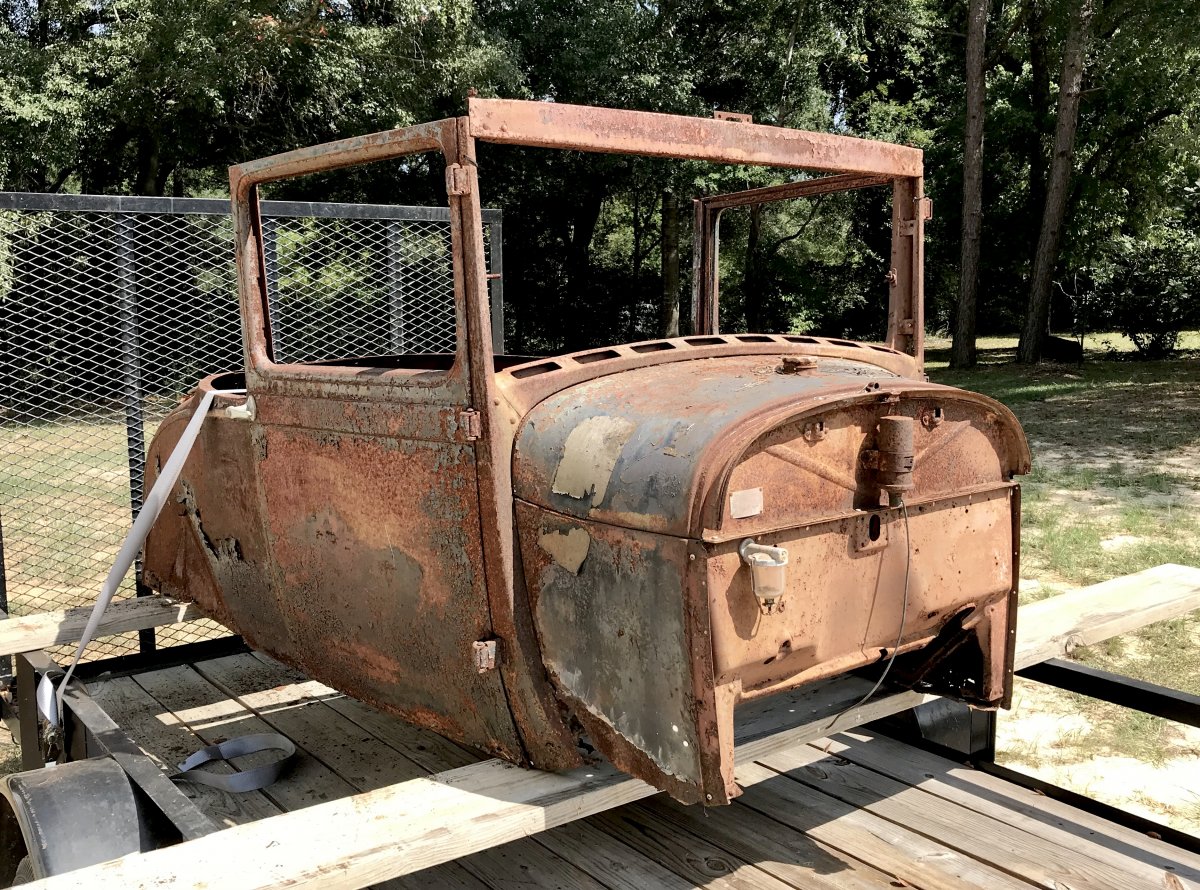

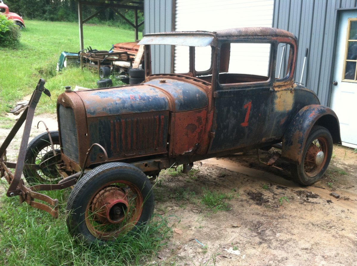

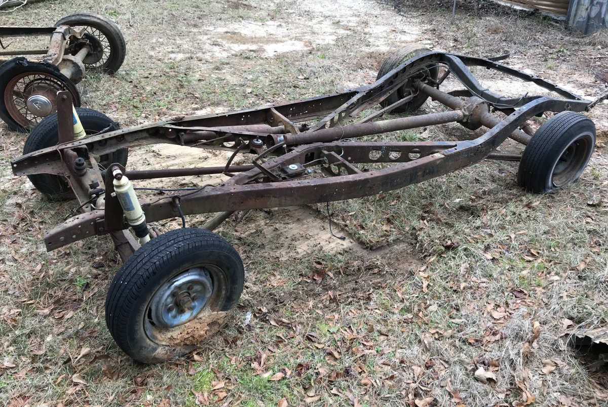

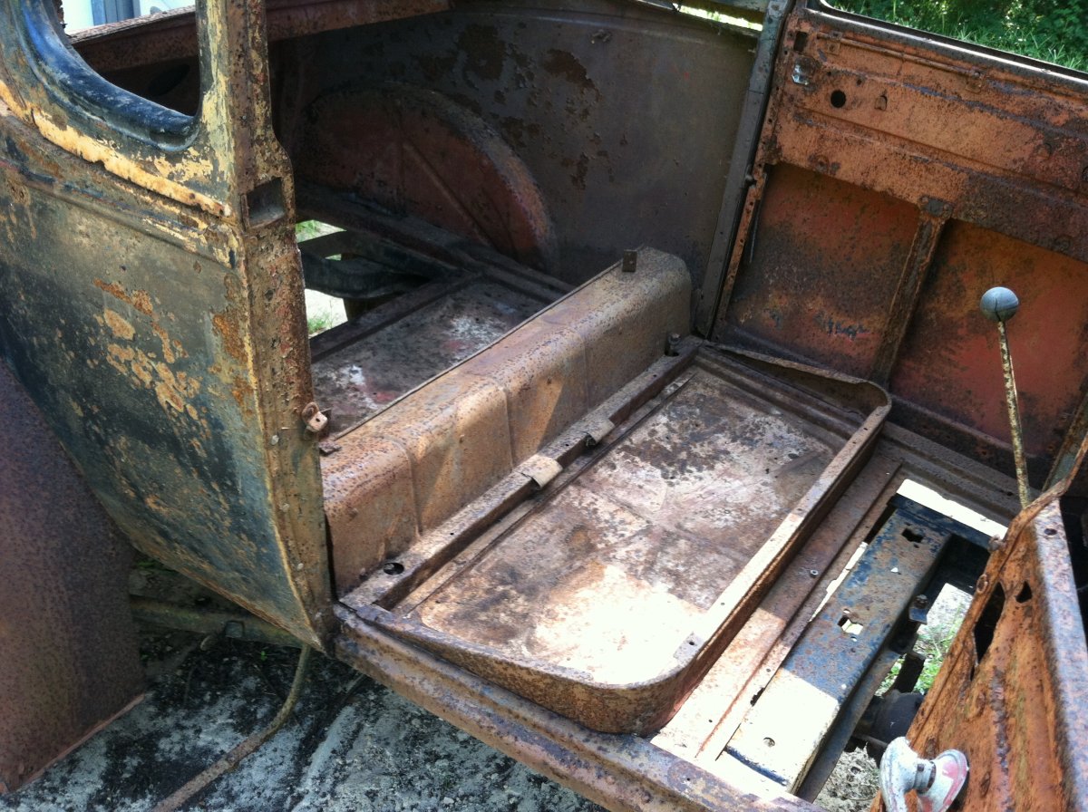

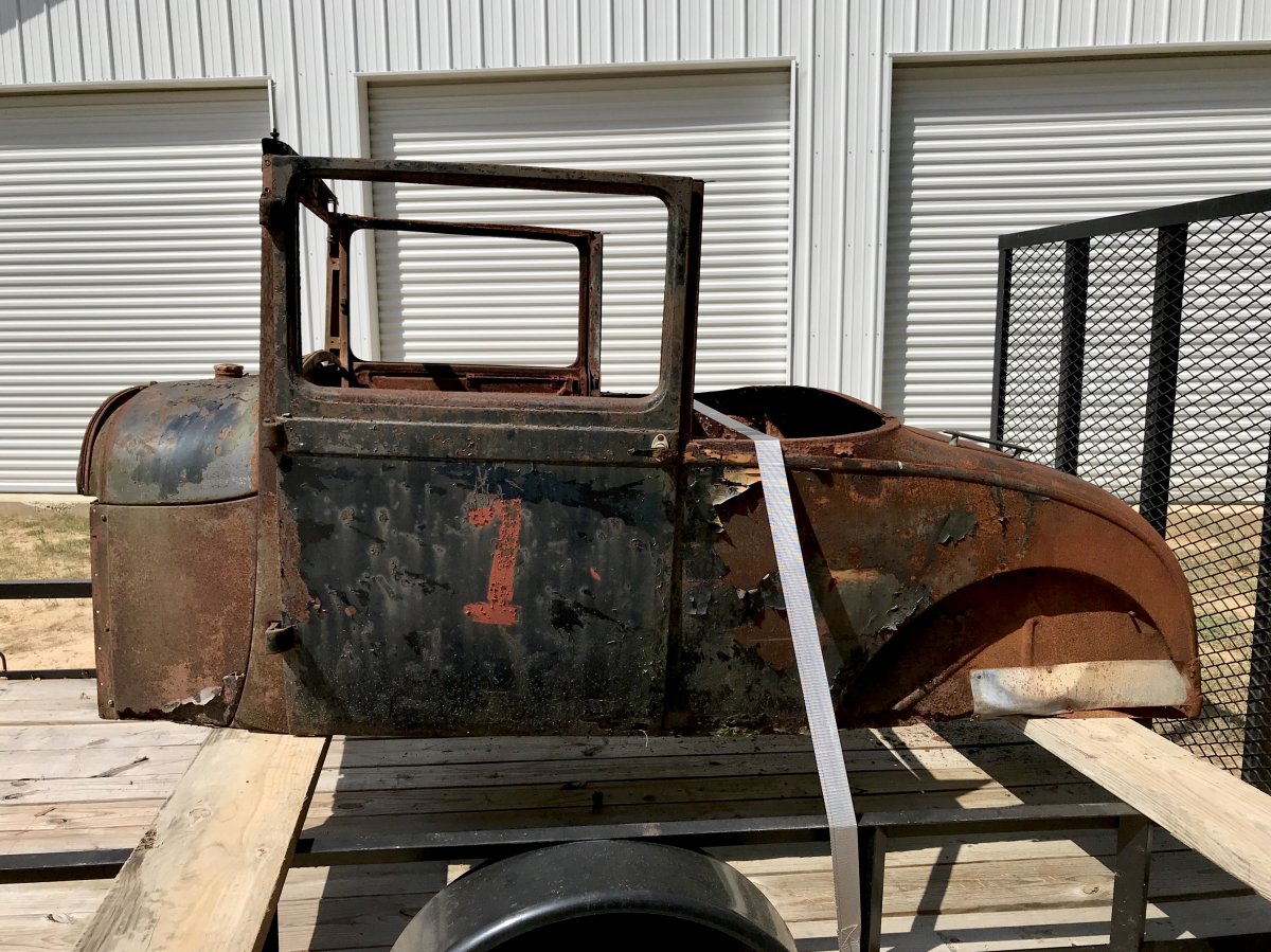

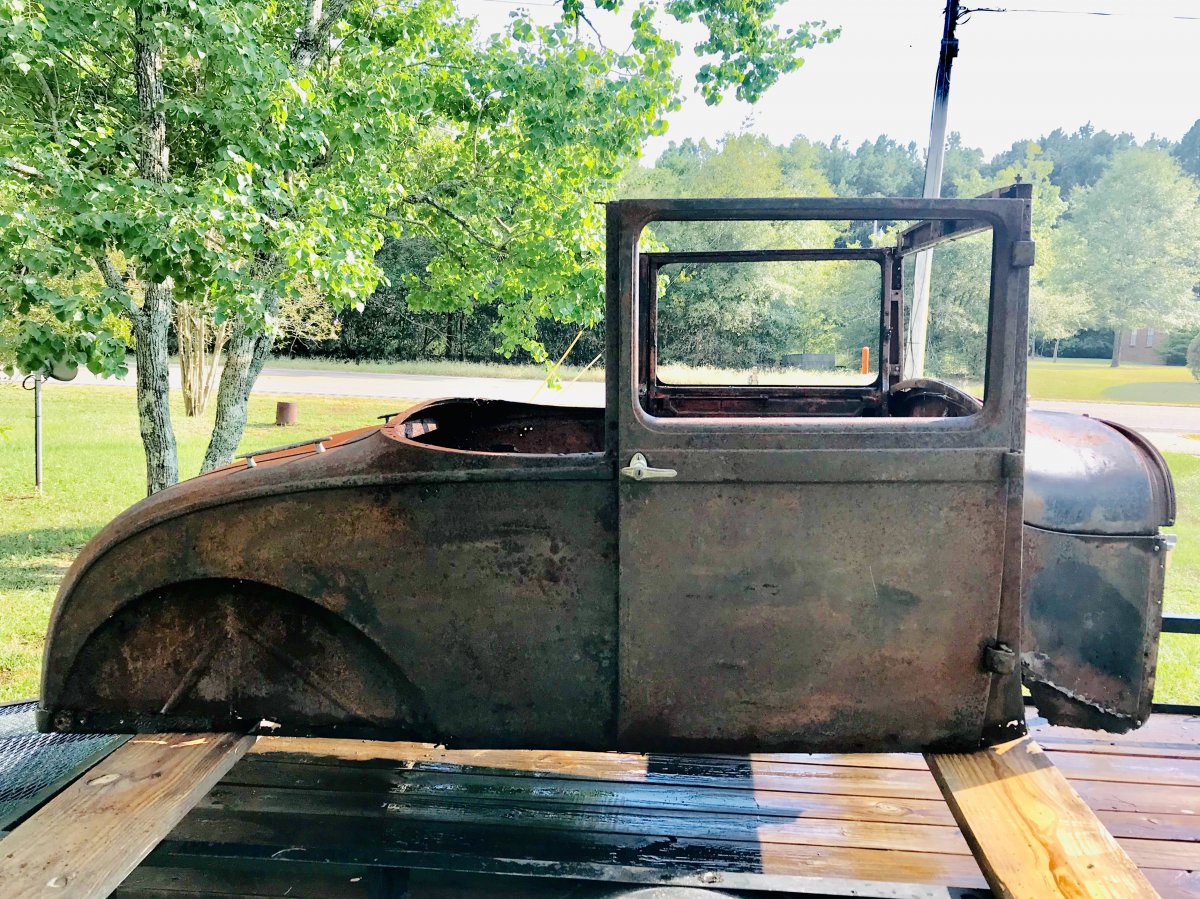

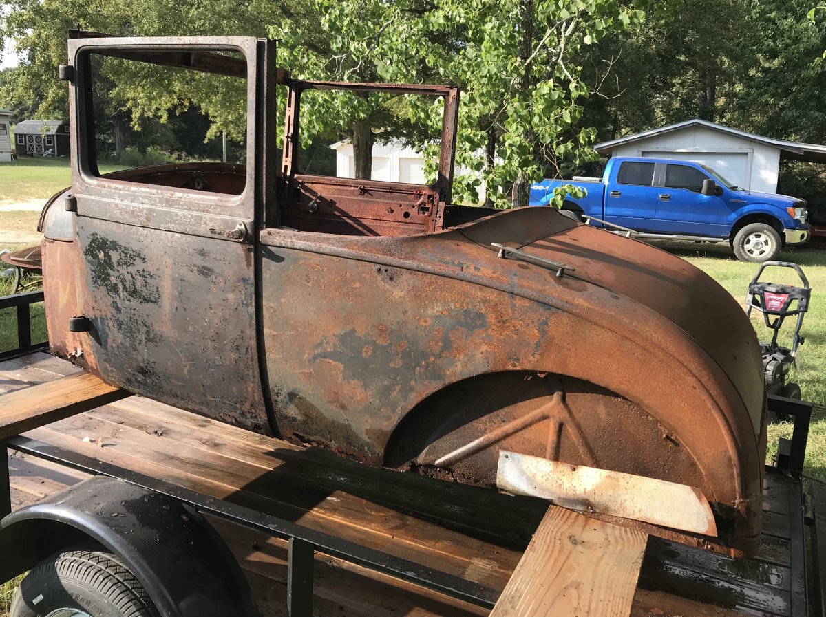

    I got bit by the Model-A bug a while back so I picked up this car. It is pretty rough but not too far gone. I was told that it was taken apart and has been sitting in this condition since the 80's. Unfortunately, from what I was told, the missing pieces were hauled off for s**** years ago. I'm just saving up parts for it now as I finish some other projects and make room for it in the shop. I picked up a 292 y-block, a 3 deuce intake, and a T5 to go in it. The plan is chopped, 32 rails, 18" and 16" wire wheels, etc. If you guys don't mind, please advise me on who makes the best fitting subrails, subrail extensions, cowl panels, and wood kit. Thanks guys. IMG_2903.JPG IMG_2904.JPG IMG_2901.JPG IMG_2906.JPG IMG_2907.JPG IMG_2909.JPG IMG_2908.JPG

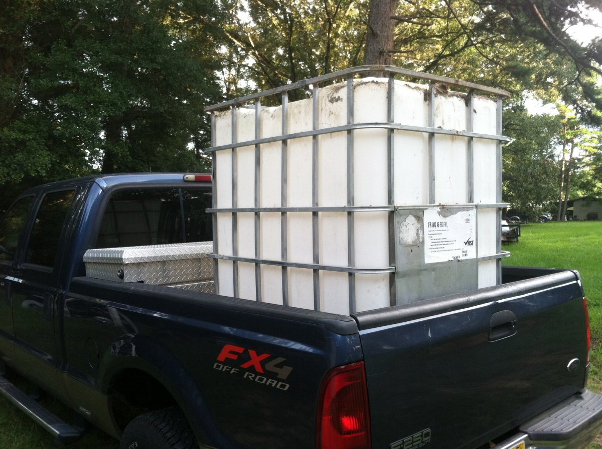

    I picked up this container today. I'm going to cut the top off of it and set it up somewhere behind my shop. I'm thinking mol***es maybe... I should be able to fit all the body panels in there. IMG_2910.JPG

  4. I'm in, this'll be cool.
    Great tank for mol***es, or citric acid.
    I use mol***es, and it works great.
    If I want to strip fast, I use the purple 3M strip discs.
    charleyw, Stogy and kidcampbell71 like this.

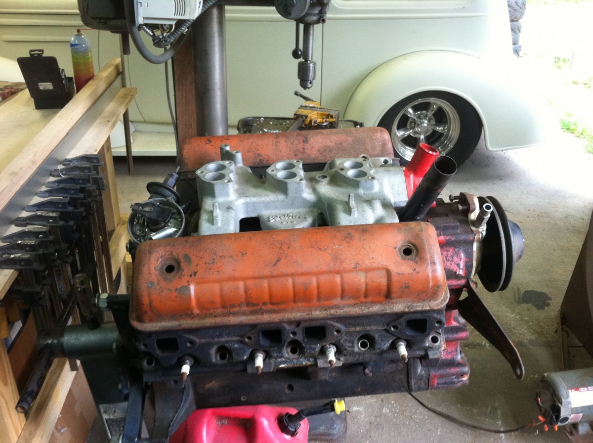

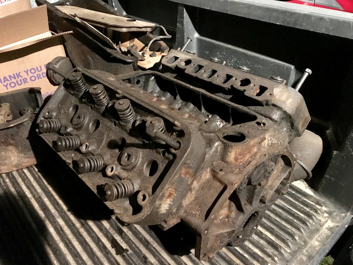

    Thanks for the replies. Here's my engine. It's a '59 292 y-block with 113 heads and a Edelbrock 573 intake. I have a truck bellhousing with side mounts and a T5 transmission to go with it. IMG_2912.JPG
    2Blue2, Stogy and kiwijeff like this.

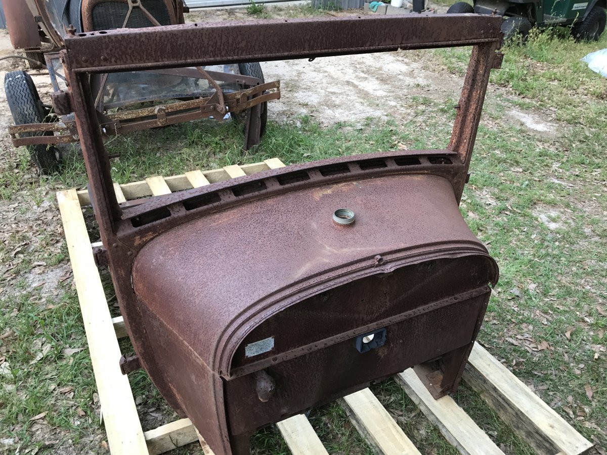

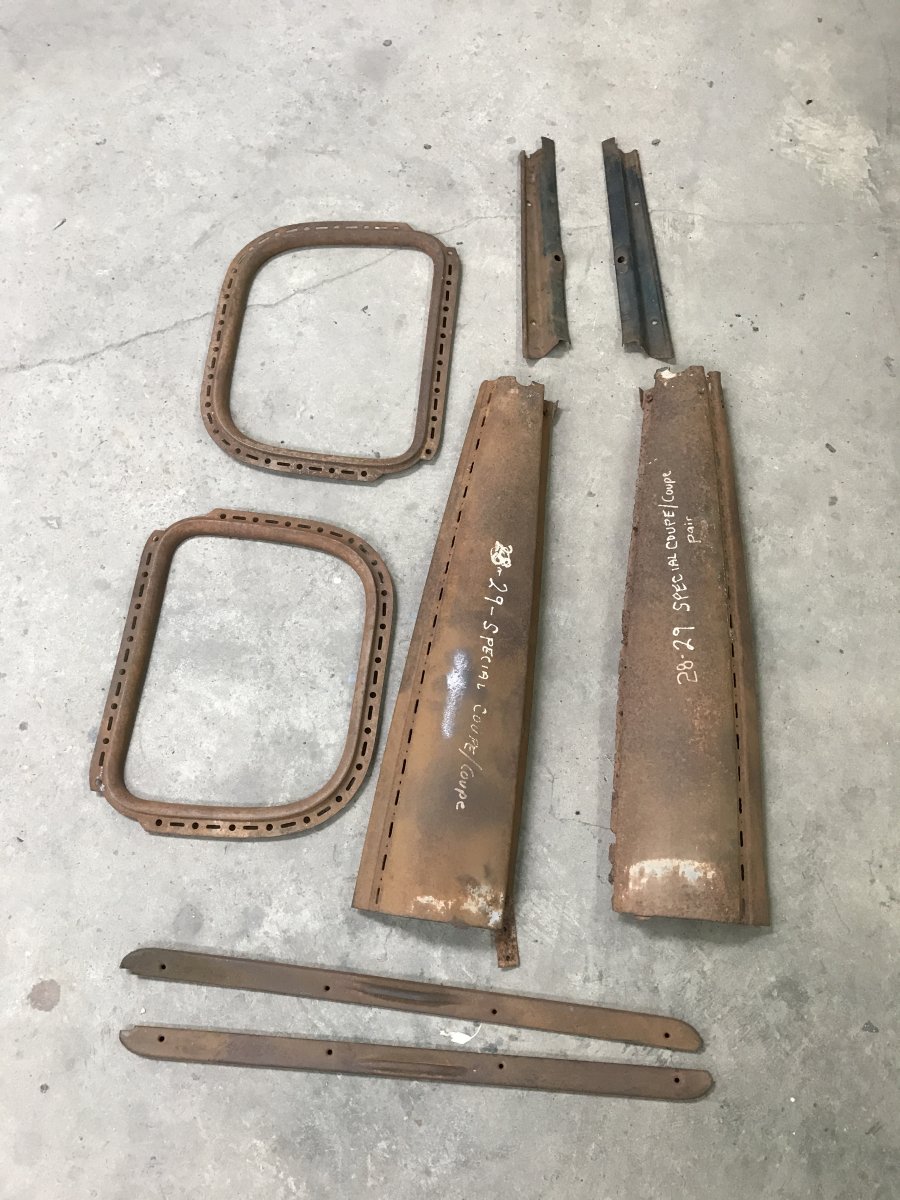

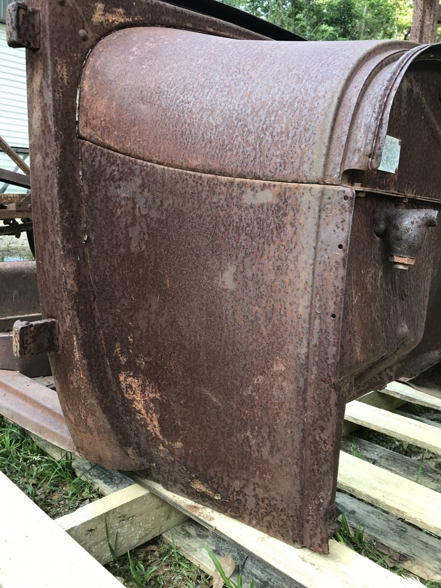

    Hey guys, I haven't posted a update in a while so I thought I'd post a pic of some parts I got in this week. All the parts in the pic were missing other than the roof panels that go over the doors. These roof panels aren't perfect but they are much better than my original panels and can be repaired easily.
    I have a small scale mol***es rust removal test going now. I've had the rumble seat hinges soaking for a week in a 9:1 ratio mix of mol***es and water. If the results are good, I will clean these parts next. IMG_1120.JPG

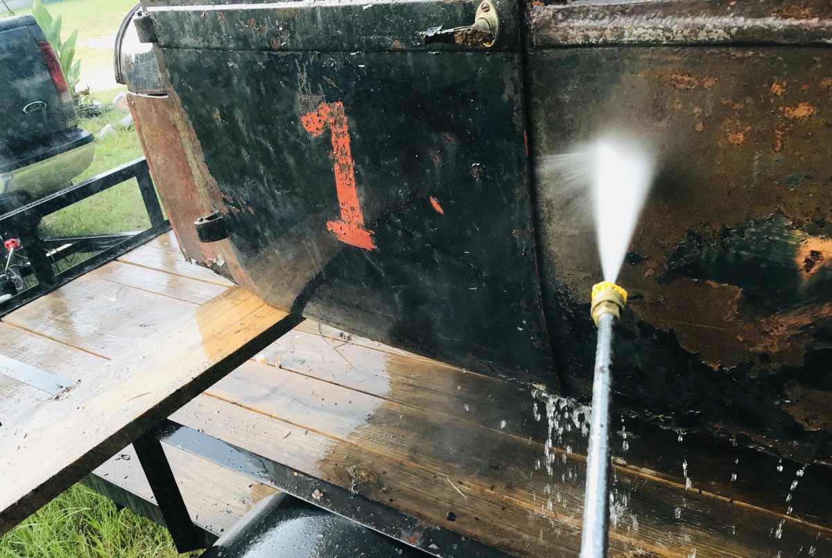

  18. The mol***es ain't rocket science.
    Pull those parts out, blast em with a pressure washer, watch in amazement at the rust come off, and because there will probably be some rust left, throw em back in for another week. Repeat process, untill rust a gone, then neutralise with baking soda.
    They flash rust, before your eyes.
    It's all petty easy stuff, and works great.
    I did a bunch of stuff, and never bothered with getting ratios correct. Worked a treat.
    35chevy, Stogy and kidcampbell71 like this.

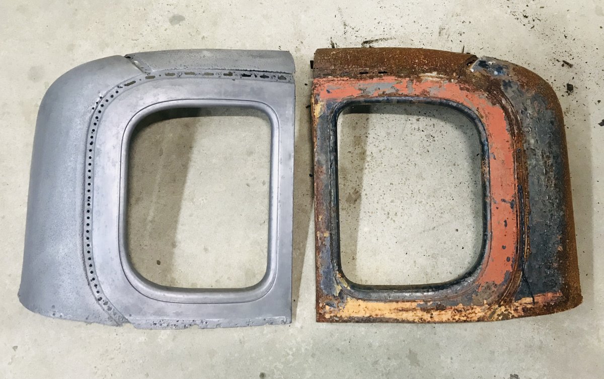

    My small scale mol***es test is working great. I am going to go ahead and start building my tank so I can get started soaking body panels this summer. Here are some before and after photos of some pieces I soaked for two weeks.

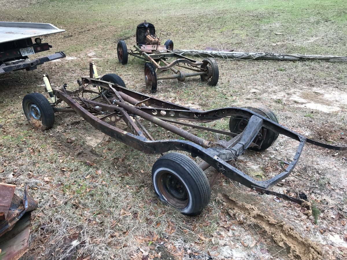

    I saw this cowl and sub-rail section for sale on Facebook, so I made a 5 hour round trip to pick it up last night!
    This cowl is a lot better than the one on the car! I'm happy with this purchase!

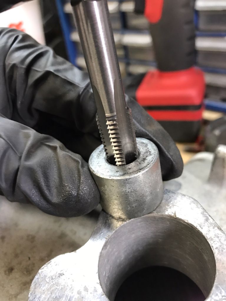

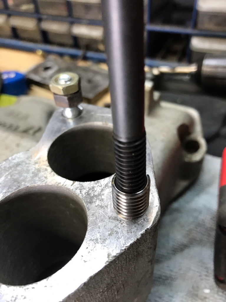

    I recently picked up some carburetors. I have three ECG carbs, and Three ECG-6 carbs to choose from. I've also spent a little time repairing bolt holes in my intake. They were originally 5/16, but in years past they were drilled to 3/8, then stripped again. I repaired the 3/8 holes with helicoil inserts, and used some Dorman 3/8 to 5/16 studs to keep from opening the holes in the carb bases to 3/8. I drilled a hole on the drill press through some flat stock to help me hold the bit straight, and an old EZ-GO golf cart steering rack spacer made for a perfect tap guide. [​IMG][​IMG][​IMG][​IMG][​IMG][​IMG][​IMG]

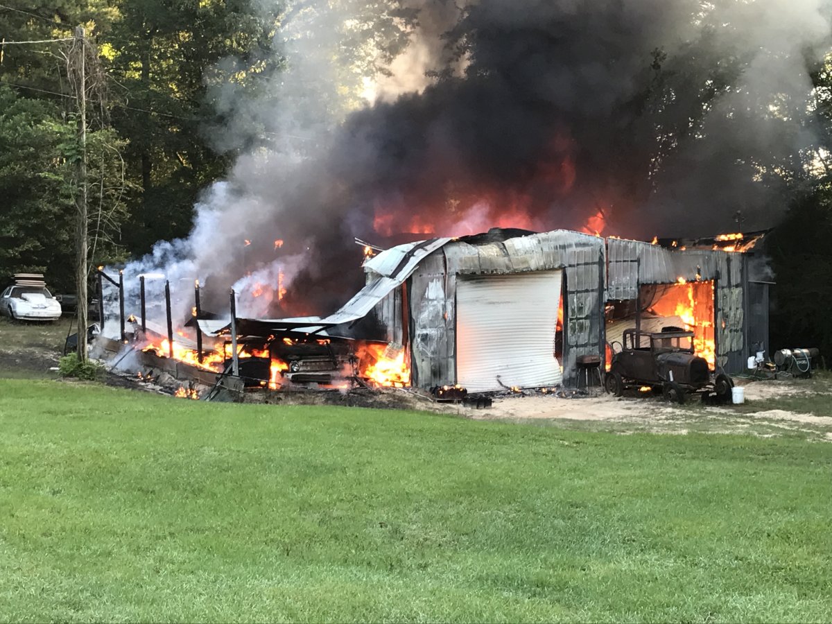

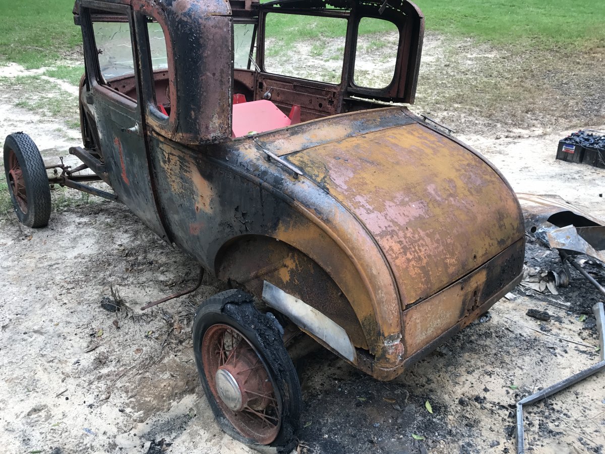

    I know It has been a while since I posted an update. In May 2018 my shop burned and I lost everything but the shell of this car. The car was sitting right in front of the shop and I almost lost it. I lost some paint off the rear quarter panels and trunk and one of the rear tires was burning when the fire department hosed it down. I lost the Y-block, intake and carbs, all the garnish moldings, the panels above the doors, and several other pieces I had bought for the project. I have spent the time since getting a new shop built and trying to get back in gear. I’ve got the car in the new shop now, and I’ve bought some JW garage 32 rails, Steadfast MFG rear sub rail kit, new rear body panel, several patch panels, more garnish moldings, a pair of 55 291 Deaoto hemi engines, and a complete 40 Ford ch***is for the x-member, suspension, and brakes. I’m currently trying to decide on a transmission. I have done some rust removal on a few pieces, and I pulled the body off the frame and pressure washed it inside one out before putting it in the shop. I hope to start posting a few updates soon. It will be slow with trying to finish the shop, and with other projects I have going, but I’m headed in a positive direction!
