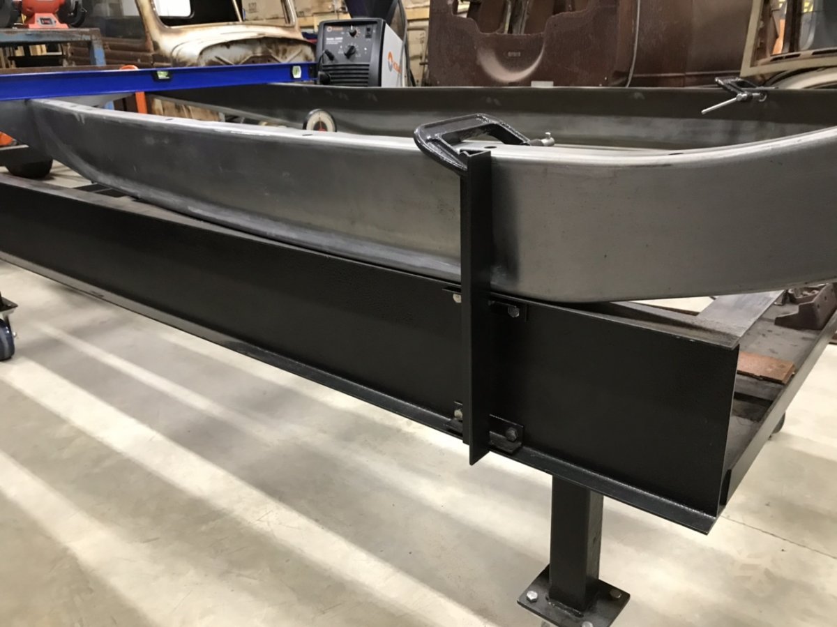

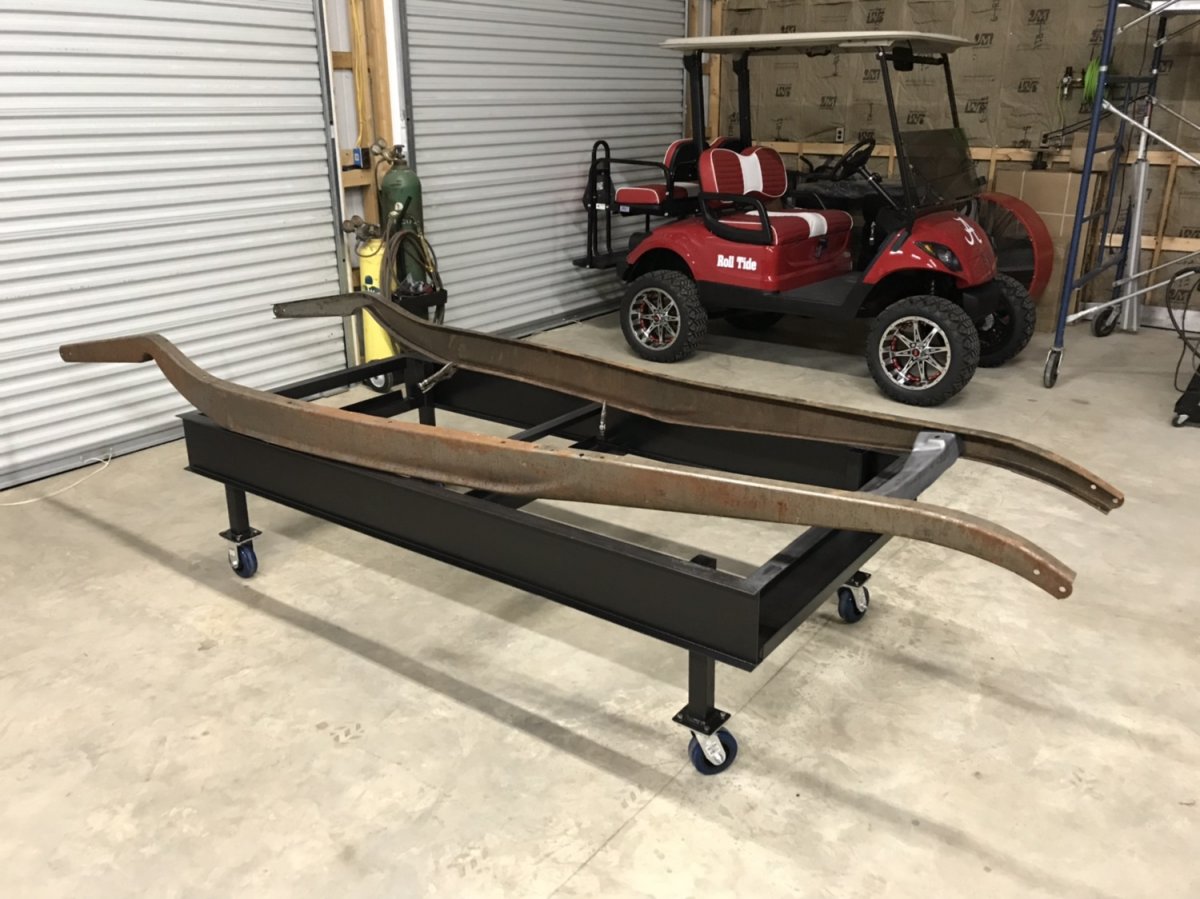

    32 frame time. I put together this table using metal I already had. The 8” I beam that I had was only 7 feet long, so I went with it. It’s just about dead on as far as being square. I spent way too much time on that part. Being my first ch***is build, I’m not sure in some of the techniques. So...
    Do you guys prefer to place the frame rails flat on the table, and build from there? Or, do you place the frame on the table at the angle of the desired rake or stance of the car? Hopefully I didn’t confuse you guys as to my question. Thanks for the help. IMG_6077.JPG IMG_6079.JPG

  3. Tim
    Joined: Mar 2, 2001
    Posts: 20,453
    Tim
    from KCMO
    I would think if your building caster into the cross members like a stock ford has I would at least do the front and rear cross members with it mocked up at the correct rake?
    my thoughts anyhow.
    Stogy and 35chevy like this.

    Seen it done both ways plenty. If it’s not in the frame now I wouldn’t hesitate to cut it before it goes in

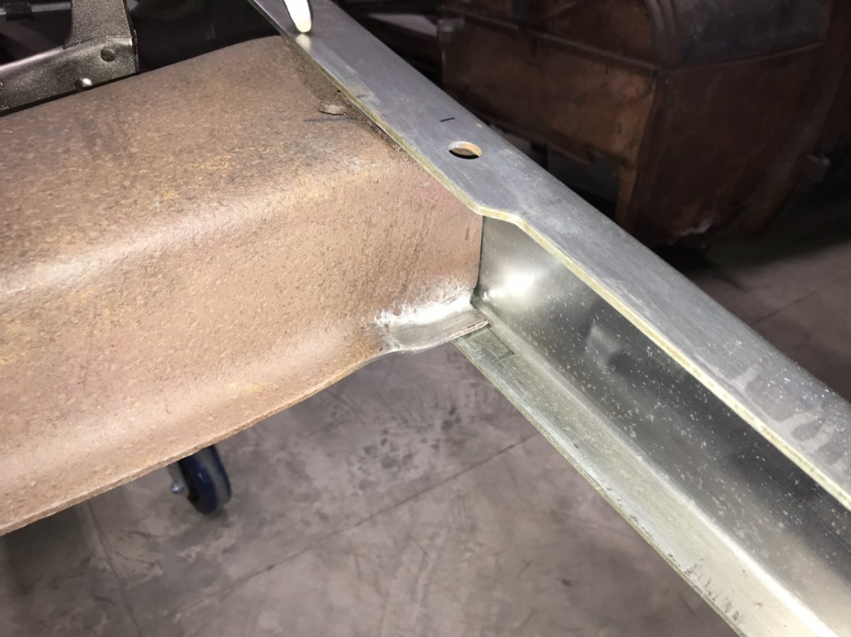

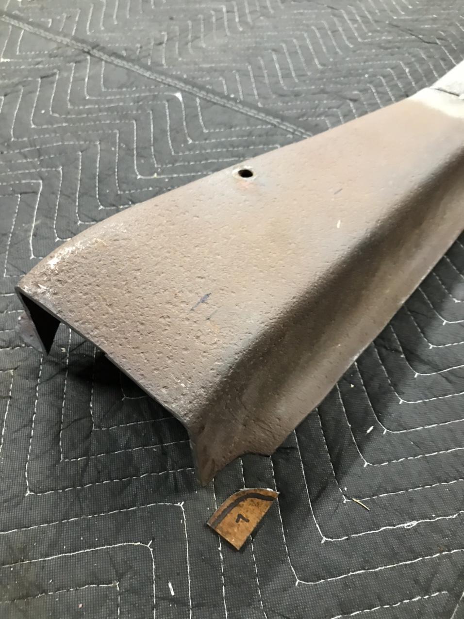

    I worked on the crossmember some tonight. I’m very happy with the way I decided to go about cutting it. For my first time flattening one of these, I think it’s turning out perfect! It’s definitely not looking bad for rough cuts with a reciprocating saw! I cut a 8.5” section out of the center, then cut another 1.5” wedge shaped section out to remove the curved section. I’m happy with it so far.

    Crossmember is ready to blast clean and tack together.

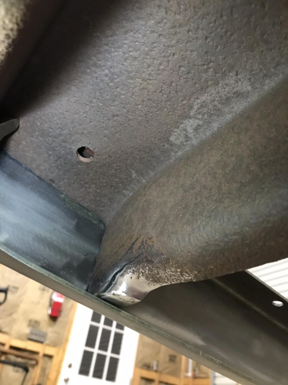

    I was hoping to have the crossmember done over the weekend, but rain slowed me down and I was only able to get enough sand blasting done in the rain to get it ready to weld. I got it cut to length and clamped together. The Wescott drawing that I have don’t show the rear crossmember placement, only the axle centerline. I need to know how far behind the axle to place the crossmember if you guys know. Also thought I’d share my Weiand intake and 4 stromberg 81’s that I just got for the Desoto 291. Now that’s exciting! IMG_1641.JPG IMG_1561.JPG IMG_1563.JPG IMG_1565.JPG

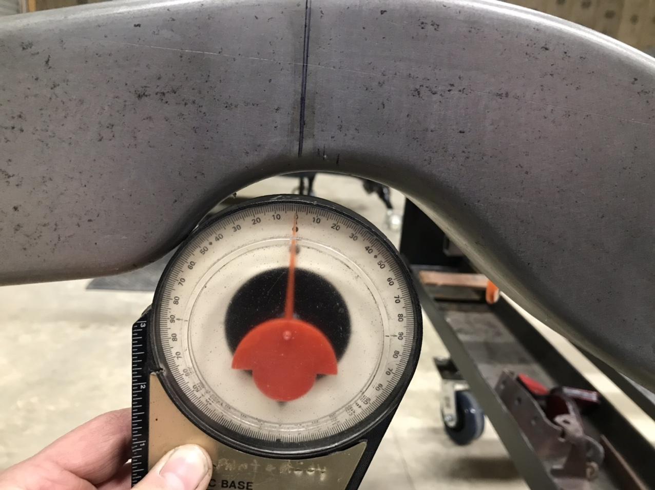

    I finally found the magic numbers... the axle centerline to spring/crossmember centerline is 7.5".

    From what I understand, it doesn't really matter how you set the frame up on the jig. Just do the math to get the crossmembers right. I'm going to stick everything together and establish the ride height before fully welding the crossmembers and setting the engine angle.

    Someone mentioned using the notches in the frame to locate the axle centerline... well, the notches aren’t exactly the same on the left and right rail. The marks I made are the axle centerline verified using multiple measuring points and using the Wescott drawings. The notch on both sides is too far forward with the p***enger side being the further forward than the driver side. I may shift the axle forward 1/4 inch or so to help the situation. The JW rails aren’t dead on, and the holes at the cowl are 1/2” off. I just happened to pick those holes as my starting point and I had a hard time figuring out where I was at because not a single measurement matched the Wescott drawings. I moved to a different set of holes for my starting point and everything was then in the ball park except that one set of holes at the cowl. After realizing they were off, everything made sense. This definitely isn’t a job for someone with OCD. [​IMG][​IMG]

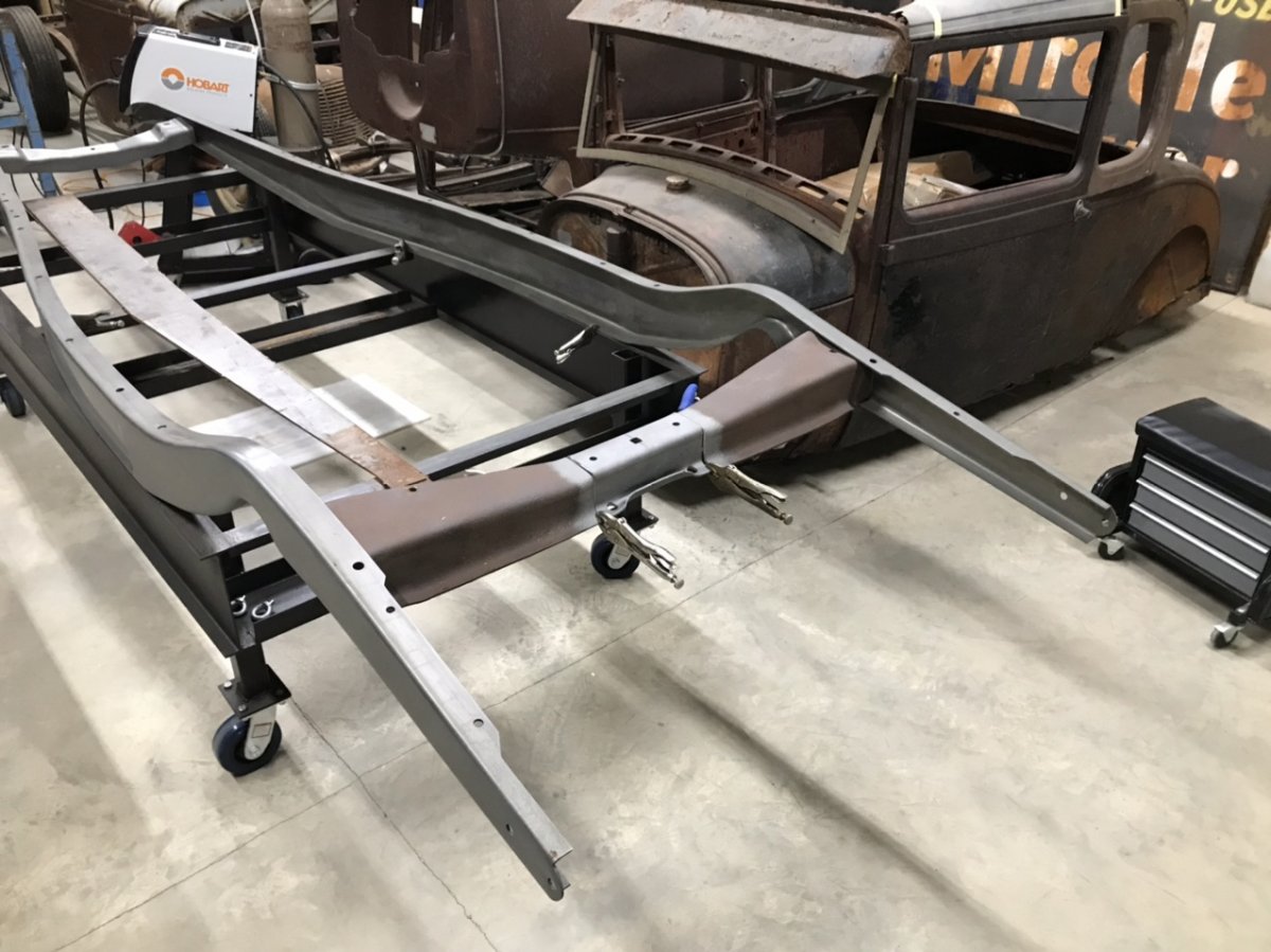

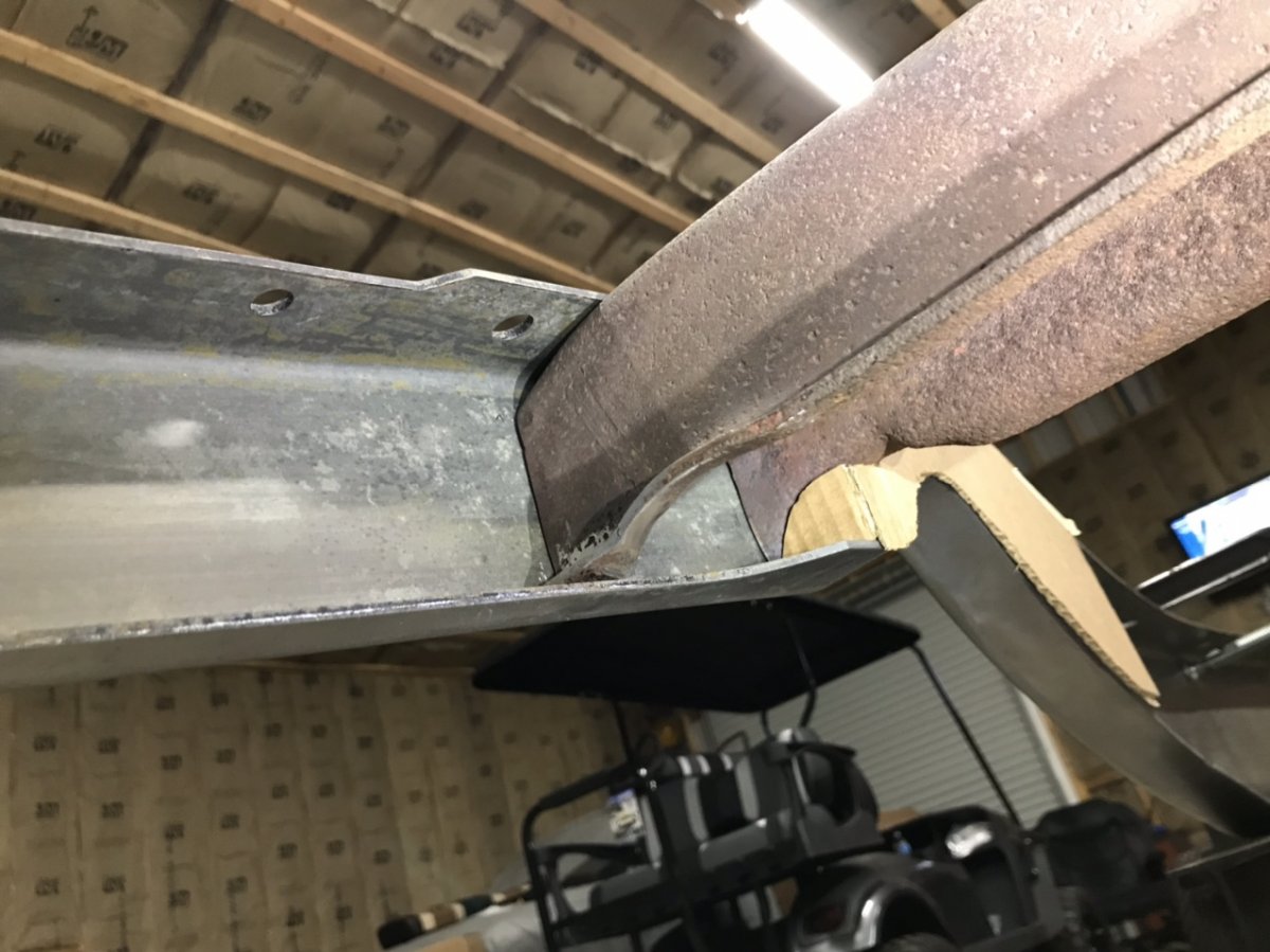

    More crossmember work. I can see why people make them out of tubing. Modifying a stock one is quite time consuming, especially if you’ve never done one before. It looks like the flattened ‘40 crossmember will end up sitting about 2-3 degrees up at the front. That should be ok I hope.

    I finished the rear portion of the crossmember today. Now I have to figure out what to do at the front. The cardboard templates are my current idea. I think I’ll box the frame from the front of the crossmember forward, but I don’t see any reason to box the frame inside the crossmember, or behind it. The area inside the crossmember should be pretty strong after its fully welded and I’ll most likely cut the rear portion of the frame off. If this is a bad idea, I’m listening for better ideas. I’ve never done this hahaha! IMG_2036.JPG IMG_2037.JPG IMG_2041.JPG IMG_2042.JPG IMG_2049.JPG IMG_2051.JPG IMG_2053.JPG IMG_2047.JPG

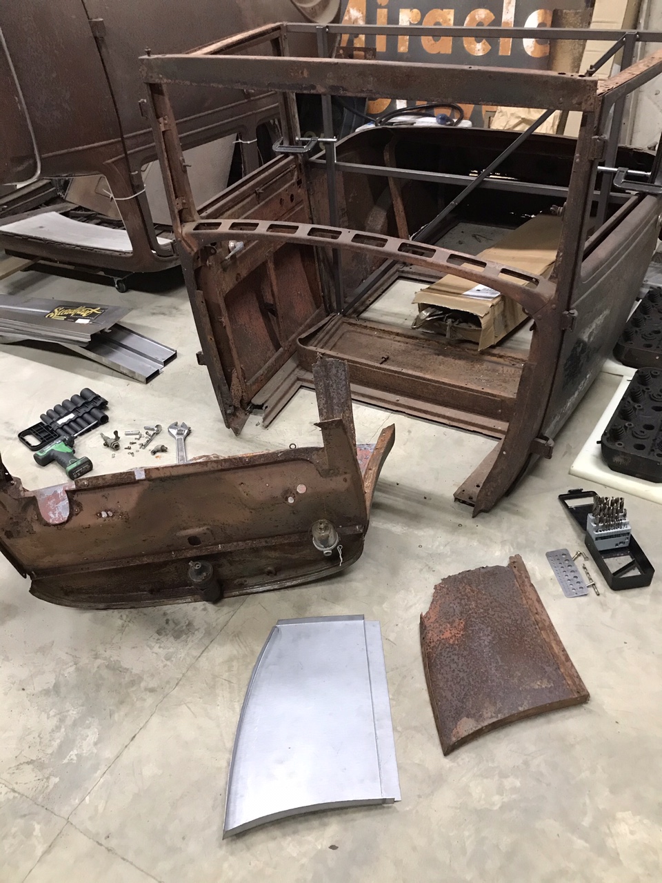

    I can’t go any further on the ch***is until I sit the body up on the rails. I’ve done some reading and talked to some folks and I may need to narrow the whole ch***is. I’ve planned the whole time to pinch it at the cowl, but I may need to pull the rails in at the rear also. The problem I have now is that the body is falling apart. I need to get it squared up before setting it on the ch***is. When I pick it up, it just flops around. Does anyone know this measurement across the top of the door posts? I’ve clamped the doors up tight to the body, and that got it close, but it will still move in and out 1/2” or so in the middle. I need this measurement right so I can make a X brace off this down to the sub rails. Thanks for your help guys.

    I got some bracing in the body and worked on the cowl area some. I just sat the body on the frame, and I need to figure out the best way to find the center of the wheelwell so I can locate the body, and exactly where the rear frame rails should be cut off. Any tips? I’m searching the H.A.M.B. now for good information. IMG_2139.JPG IMG_2391.JPG IMG_2392.JPG IMG_2402.JPG IMG_2403.JPG IMG_2419.JPG IMG_2421.JPG IMG_2423.JPG IMG_3729.JPG IMG_3733.JPG IMG_3735.JPG IMG_3742.JPG
