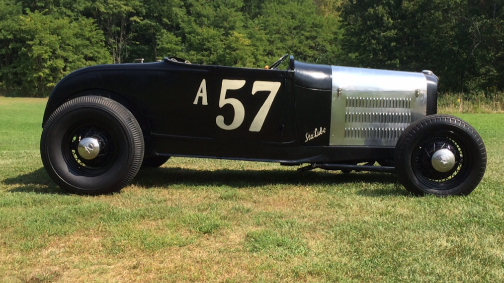

    Thx, Larry.
    Here's a pic after I checked off a few things on the list last night.
    Still a lot of stuff left to do.

    Roadster very cool w/o moon tank. No offense.

  12. unnamed.png last pic looks much better , looking forward to seeing it on the beach ! here is a pic of mine ,we'll have to line them up if we get a chance !

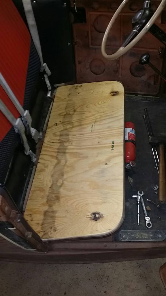

    Before I pulled the rad, I took the rod out for a quick run w/out the Windshield. I quickly remembered why we have them, when I got a face full of road dirt & a bit of coolant from the leaky rad.
    For years, I've been sitting on a stock seat bottom with a shortened riser. The seat cushion itself is about 8" tall. In order to reduce the wind & dirt in my face, I need to sit at least 4-5" lower.
    Started to mockup a new seat bottom last night. In order to keep it comfortable, I plan to cover plywood with 2" foam & a 3" bolster at the leading edge.
    More pix to follow.

    If you plan on driving your car a bunch, be sure you use high density seat foam (from upholstery store) if you're only using 2" for the seat bottom...trust me on this one.
