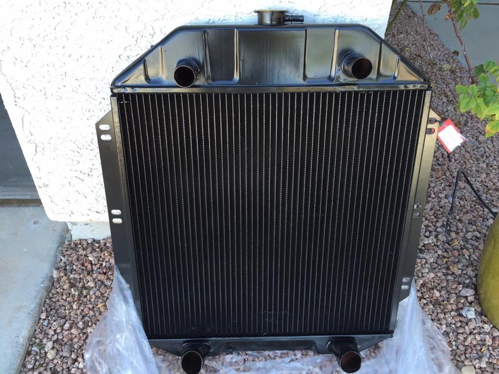

    Since I will need to run offset water necks when I go to install the Compressor/Alternator bracket and the system is already empty, I may as well install the offset water necks now. The radiator is nice and clean, the water pumps look great inside, but man... the heads are still nasty!! I love the zero degree thermostats that they were running!
    The pictures don't give the full 3D image, those hardened bubbles of nasty inside the water jackets were a surprise. I plan to go to Aluminum heads, so not a big worry. I took a very strong magnet and knocked it all out. UPS should be here any minute now with my pristine new radiator... I'll post a comparison pic in case anyone wants to see what the Shoebox-central radiator (ordered from US Radiator) looks like.
    Radiator removed
    Water pump post evapo-rust
    Radiator catching some rays
    Tank all cleaned out
    Edit: Pristine new radiator dropped off at my door in a big, padded box around 3p. The new radiator does NOT come with a pet**** and the old cap will not fit. Finished installing the radiator at 5:30 just as everyone was getting home for the day.
    The offset necks caused an issue with the dress hoses, a quick trip to AutoZone found me a hose that fit and had two 90's in it that I could cut out. While I was there I grabbed the HELP brand pet**** and a 13 lb cap.
    Before:
    After:
    And one final overhead shot.
